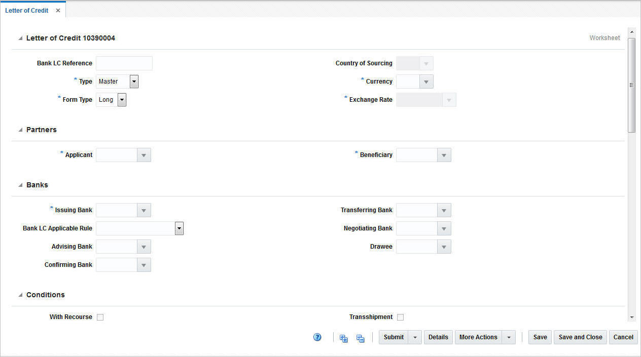

Letter of Credit Window
The Letter of Credit window allows you to view, create and edit a letter of credit. The window contains the following sections:
Figure 2-1 Letter of Credit Window
Letter of Credit
The Letter of Credit ID is populated automatically. The status of the letter of credit is displayed in the top right corner of the window, for example, Worksheet.
In the Letter of Credit section enter the following data.
Table 2-1 Letter of Credit - Fields and Description
| Field | Description |
Bank LC Reference |
Enter the Bank LC Reference. |
Type |
Select the Letter of Credit type from the list. Possible types are:
For more detailed information about possible letter of credit types, see the Letter of Credit Types section. This field is a required field. |
Form Type |
Choose between the following two letter of credit formats.
Country of Sourcing |
Only available, if you select the LC Type Open. Enter, select or search for the appropriate country. |
Currency |
Enter, select or search for the currency of the LC. This field is a required field. |
Exchange Rate |
The exchange rate is populated automatically, based on the selected currency. By default the effective LC/bank rate is displayed in this field. If no LC/bank rate is found, the rate is either defaulted to the consolidation or operational exchange rate. If necessary, edit the displayed exchange rate with the Edit Exchange Rate icon. For more information about how to edit an exchange rate, see the Edit the Exchange Rate section. This field is a required field. |
