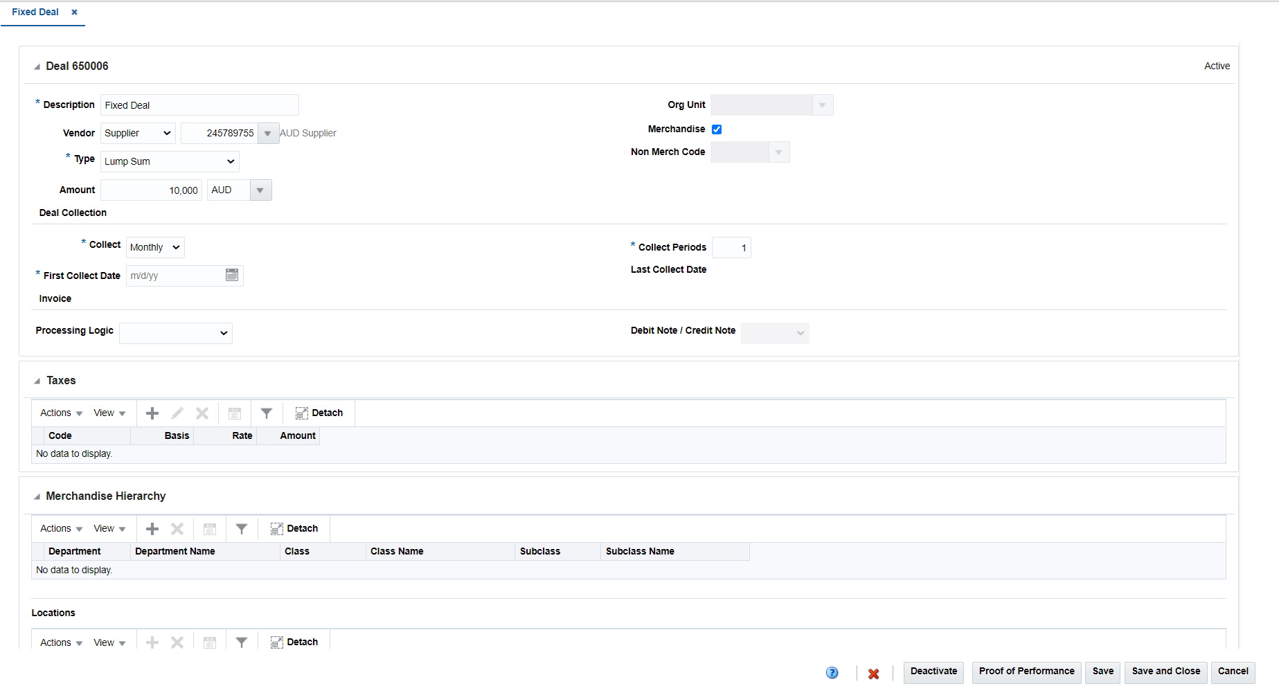

Fixed Deals: Fixed deals allow you to capture one-off payments or a series of payments from a vendor to the retailer. This type of deal caters to certain business setups that require the vendor to give the buyer a fixed amount of money in return for advertising their products for promotional reasons, for in-store demonstrations, or for displaying their merchandise in prime shelf space. A fixed deal comes with a defined amount, duration, billing frequency, and invoicing method. There is built-in logic to auto-generate billing requests for such amounts based on the billing frequency.

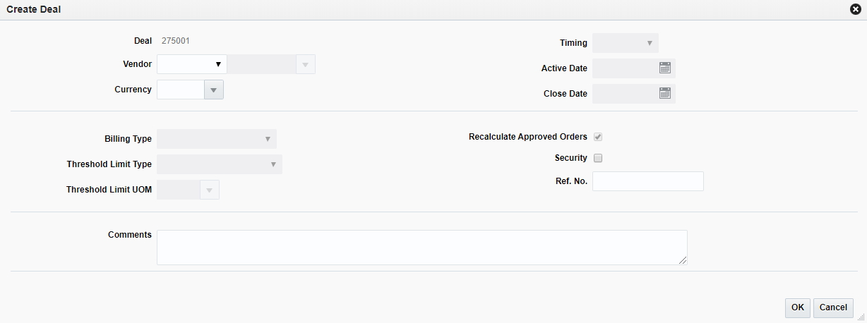

From the Tasks menu, select Deals > Create Deal. The Create Deal pop-up appears.
Figure 4-1 Create Deal Pop-up
The deal number is displayed by default.
In the Vendor field, select the vendor type, enter, select or search for the deal vendor.
In the Currency field, enter, select or search for the currency.
In the Timing field, select the timing of deal:
Annual: A yearlong deal you have with a deal partner. Only one annual deal can be applied to an item at a time. You close the deal manually when it expires, or the deal is closed automatically when you create another annual deal with the deal partner. On selection of Annual, the Billing Type gets defaulted to Off-invoice, and the field is disabled since this is the only possible type of annual deal.
Promotional: A deal that is generally shorter than an annual deal. Multiple and promotional deals can be applied to an item at the same time. The deal closes automatically on the specified end date. Bill Back, Vendor Funded Promotion, Vendor Funded Markdown, Off-invoice, Promotional Consignment Rate and Clearance Consignment Rate can all be promotional deals.
In the Active Date field, enter the date on which the deal becomes active, or click the calendar icon and select the date.
In the Close Date field, enter the date on which the deal ends, or click the calendar icon and select the date.
This field is not required for annual deals.
In the Billing Type field, select the type of deal being created.
If you select Annual in the Deal Timing field, Off-Invoice is the default for the Billing Type and cannot be changed.
Off-Invoice: The deal is reflected as an amount decremented from the cost on the invoice.
Bill Back: The deal income amount is invoiced to the supplier after the goods are purchased. A special type of a bill back is a rebate, which can be calculated on sales, purchase orders or receipts.
Vendor Funded Promotion: The deal income amount is generated based on a part or the entire promotion being funded by the supplier for the items present in the deal.
Vendor Funded Markdown: The deal income is generated based on The vendor contributing a percentage of the retail price discount for each item on hand or by giving a fixed amount for all the items that still remain in stock.
In the Threshold Limit Type field, select the type of threshold limit type. Certain deal types such as Off-invoice and Bill Backs allow the tracking of the threshold limit in terms of units or an amount. This does not apply to the Promotional Consignment Rate and Clearance Consignment Rate types.
In the Threshold Limit UOM field, select the UOM. If units are selected as Threshold Limit Type, you also need to define the Unit of Measure (UOM) that the threshold tracks. It will be disabled otherwise. For PO specific deals, if the Transaction Level Discount is set to Y, the threshold limit type is always Amount.
Select the Recalculate Approved Orders check box. This is only applicable to an Off-invoice deal. This indicates whether approved orders should be recalculated based on the current deal parameters and applies only in case of an off invoice deal. If this is checked, any approved order currently in the system that meets the deal criteria is recalculated based on the new deal once it is approved.
Select the Security check box. This indicator is used to implement user based security for the deal that is currently being created. In case this has been set for a deal, the deal details can be viewed or edited only by users who have the same or higher privileges compared to the deal creator.
In the Ref. No. field, enter a number.
In the Comments field, enter any additional comments as necessary.
Click OK to save any changes. The Deal page appears.
Click Cancel to return to the Tasks menu without saving changes.

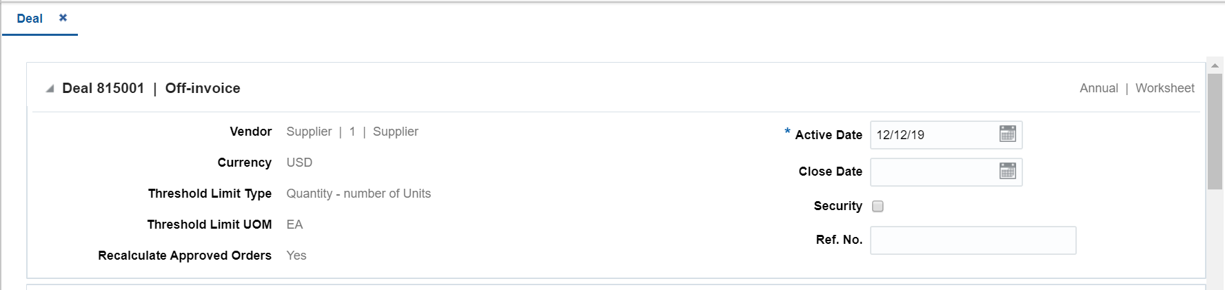

Add Deal Header Information
Figure 4-2 Deal Header
The Deal Header includes the following fields.
Table 4-1 Deal Header - Fields and Description
| Fields | Description |
Title |
The title displays Deal ID and Billing Type with a separator between them to the top left of the head container. The Deal Timing and Deal Status is displayed with a separator between them to the top right of the head container. The possible values for billing type are Off invoice, Bill Back, Bill Back Rebate, Vendor Funded Markdown, and Vendor Funded Promotion. The deal number is populated by default. The possible values for deal timing are Promotional, Annual. |
Deal Status |
The description of the deal status is displayed as text. If you create a deal the status is Worksheet. For more information on deal status, see the Change the Status of a Deal section. |
Vendor |
This field displays the type of vendor, vendor ID, and name. |
Currency |
This field displays the deal currency. |
Threshold Limit Type |
This field displays the threshold limit type. |
Threshold Limit UOM |
This field displays the threshold limit UOM. |
Recalculate Approved Orders |
This field displays as Yes, if the Recalculate Approved Orders check box is checked in the Create Deal pop-up. This field will display as No, if the Recalculate Approved Orders check box is unchecked in the Create Deal pop-up. |
Active Date |
This field displays the date on which the deal becomes effective. |
Close Date |
This field displays the date on which the deal ends. |
Security |
This field displays if the deal was created with user security. |
Ref. No. |
Enter the deal reference number. |
Order No. |
This field displays the order number in case of PO specific deals. |
The Active Date, Close Date, Security, and Ref. No. fields are editable. However, the remaining fields are displayed based on the information entered in the Create Deal pop-up.

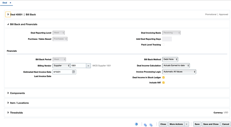

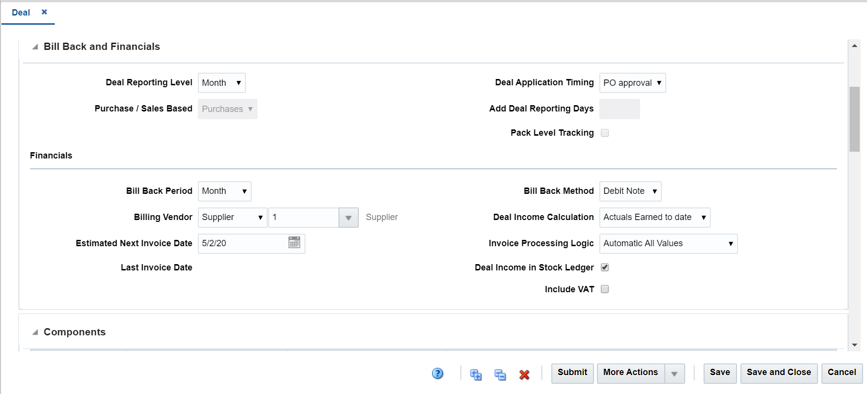

Add Bill Back and Financials Details
The Bill Back and Financials section gets displayed for Bill Back (BB), Bill Back Rebate (BBR), Vendor Funded Markdowns (VFM) and Vendor Funded Promotions (VFP) type deals.
Figure 4-3 Bill Back and Financials Page
The Bill Back and Financials section includes the following fields.
Table 4-2 Bill Back and Financials - Fields and Description
Deal Reporting Level |
The deal reporting level determines the length of the reporting periods that would be created for income generation. The options provided to you depends on the calendar type that is being used in the Merchandising instance. For a 4-5-4 calendar, this can be Week, Month, or Quarter, while for a Gregorian calendar, only Month or Quarter can be selected. Income is calculated once per reporting period. The reporting level also indicates the maximum frequency at which an invoice is raised against the income accrued by the deal. |
Purchase/Sales Based |
Select whether the deal will be based on purchase or sales. Bill Back Deals are always based on purchases, while Bill Back Rebate deals can be based on either purchases or sales. |
Deal Invoicing Basis Note: This does not apply to VFP/VFM deals. |
Select the Deal Invoicing Basis. The options for Deal Invoicing Basis depends on whether the deal is purchase or sales based. Purchase-based deals can have this set to the Approved POs, Net Receipt or Gross Receipt. Sales-based deals do not have timing specified since they are driven by sales records and are applied only when a sale occurs. |
Add Deal Reporting Days Note: This does not apply to VFP/VFM deals. |
This field is used to capture the number of extra reporting days that should be added to the deal actual forecast data to cater to the late postings of the transactions after the deal close date. |
Pack Level Tracking |
For receipt-based Bill Back and receipt or sales-based Bill Back Rebate deals, the indicator for tracking the deal at the pack level is enabled. Select this indicator to generate income for purchase orders which involve receiving at the pack level or sales occurring at the pack level. This is enabled only for receipt based bill back and receipt or sales based bill back rebate deals. |
Rebates sub section: |
Rebate Calculation Type |
Select the rebate calculation type from the list. This field determines the method in which the comparison of thresholds is performed against the actual turnover figures. Here the term turnover refers to the total revenue generated for a period across the merchandise hierarchy for which the deal is applicable. This is defaulted to Linear and disabled for a BB deal, while for a BBR, you can set it to Linear or Scalar. |
Growth Rebate |
A rebate in which the supplier determines the amount of the rebate, based on increased orders over a specified period of time. The Growth Rebate information is available only for Bill Back Rebate deals and is for informational and reporting purposes. Selecting this indicator enables the Historical Period fields and allows a buyer to set up a growth rebate deal by looking up prior receipt or sales values in the data warehouse system. The growth percentage can then be manually applied to these values to come up with thresholds that would be applicable for the current deal. |
Historical Period Start Date End Date |
The start and end dates of the historical period against which growth will be measured for this growth rebate. |
Financials sub section: |
Bill Back Period |
Select the period for how frequently the vendor is billed. This period needs to be at least as large as the reporting period because income calculation is performed only at the end of a reporting period. For the 4-5-4 calendar, the choices for the invoice periods are: Week, Month, Quarter, Half Year or Annual. The same choices apply for Gregorian calendar, except Week. This field remains editable until the first invoice has been raised against the deal. |
Billing Vendor |
This field indicates the vendor to be billed for the specific deal, which can be different from the vendor specified for the deal in Deal Head. Select the vendor type and enter, select or search for the vendor. |
Estimated Next Invoice Date |
The estimated date the next invoice is going to be sent to the vendor. Enter the correct date or click the calendar icon and select the correct date. The effective date for raising the invoice will depend on when the financial month is closed. The estimated next invoice date gets populated initially based on the bill back period. It takes the last day of the period that will be invoiced. After the invoicing batch program Vendor Deal Invoicing (vendinvc) runs, this date is updated with a Gregorian week, month, or quarter, or the 4-5-4 week setup based on the calendar configuration in the system. This date can be modified throughout the deal's lifetime, even after approval until the last invoice against the deal has been processed. |
Last Invoice Date |
This field is updated to hold the last reporting period that was invoiced. Enter the date or click the calendar icon and select the date. |
Bill Back Method |
This indicates whether invoices raised for this deal are in the form of a credit note or a debit note. The option selected here overwrites the supplier's default setup in Invoice Matching. This field remains editable until the last invoice against the deal has been processed. |
Deal Income Calculation |
The basis for calculating the amount earned from the deal. Actual will only generate income on real turnover. Pro-rated calculates income based on forecasts and actual turnover and distributing this income over all open periods. For BB and BBR types of deals, you have the option of calculating the deal income based on the actual values earned until the current date, or of using the method of proration on the forecasted amount. |
Invoice Processing Logic |
Select the method for how invoices will be raised for this deal. You have the following options available in the case of BB and BBR type of deals - Automatic all values, manual all values, automatic positive values, manual positive values only, no invoice processing. This field remains editable until the first invoice has been raised against the deal. |
Deal Income in Stock Ledger |
Select the check box to indicate that deal income accrual should be written to the stock ledger. |

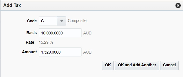

Include Taxes |
In the Global Tax Solution (GTS) setup, the system will support multiple tax codes at the item level within a deal as long as this checkbox is selected. In a non-GTS setup, just a single tax can be linked with the items within the deal. |

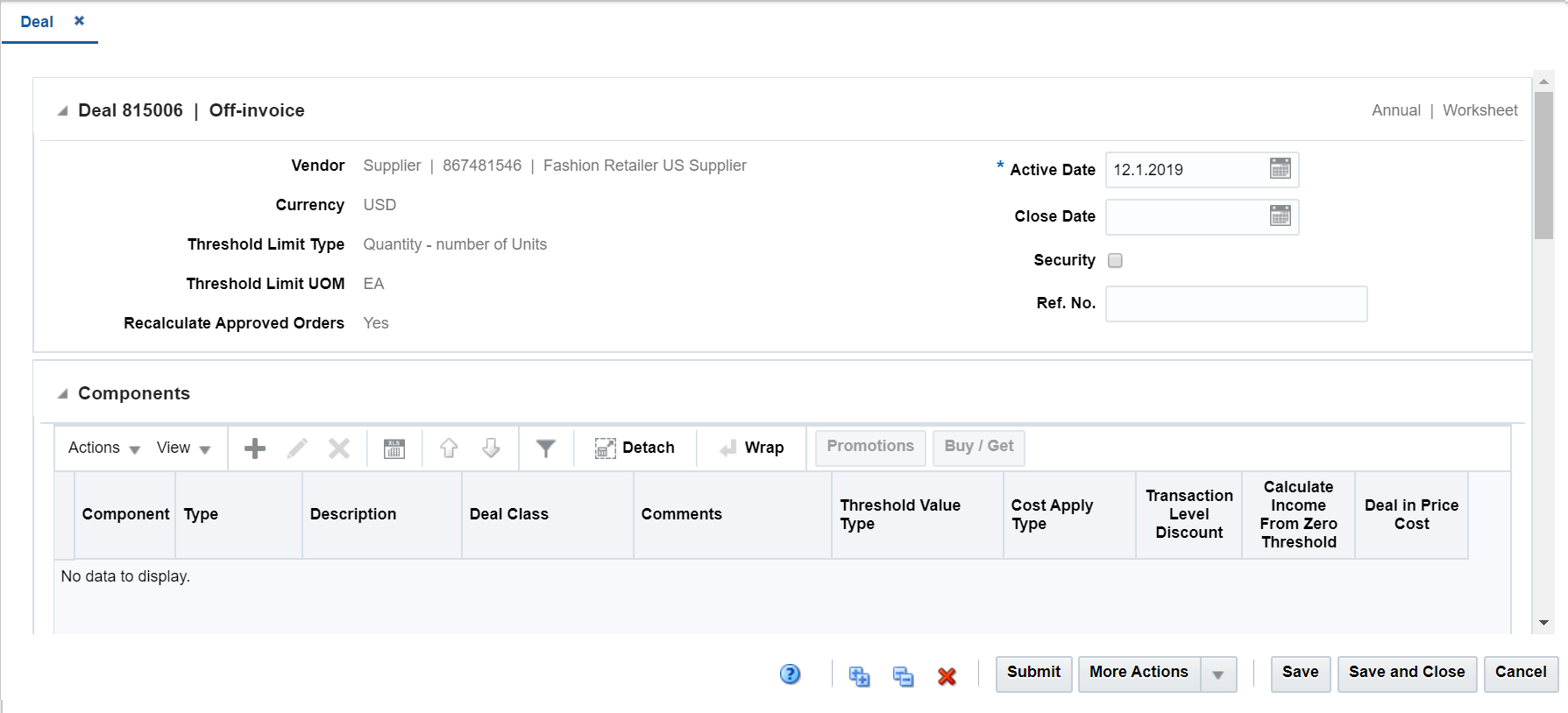

Enter the relevant data and click OK to save the changes. The Deal page appears.
In the Deal page, go to the Components section.
Figure 4-4 Components Section

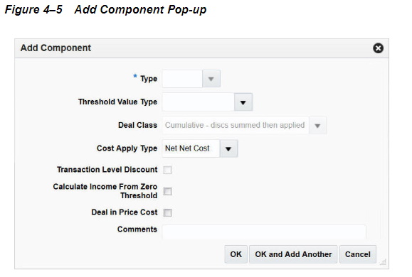

From the Actions menu, click Add or click the Add icon
. The Add Component pop-up appears.
Figure 4-5 Add Component Pop-up

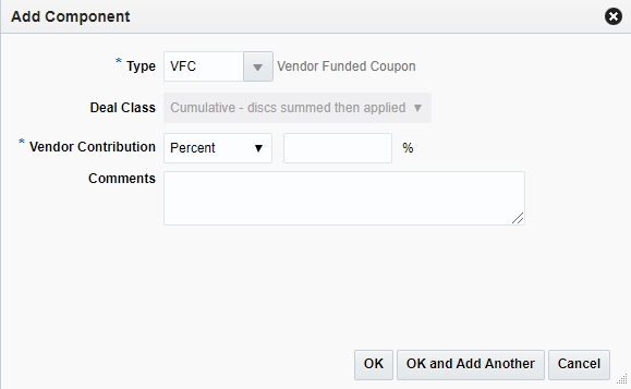

For a Vendor Funded Markdown type of deal, the user can specify the contribution type and the contribution amount of the vendor to the markdown, that can be defined in the form of a value or a percentage in the Add Component pop up. For values, the amount that is specified will be considered in terms of the currency selected for the specific deal.
Figure 4-6 Add Components - Vendor Funded Markdown
Figure 4-7 Add Components - Vendor Funded Markdown Percent

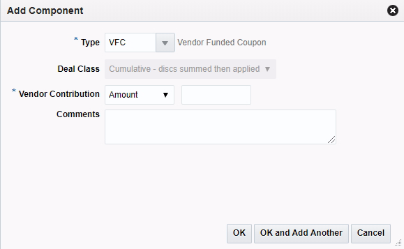

Figure 4-8 Add Components - Vendor Funded Promotion

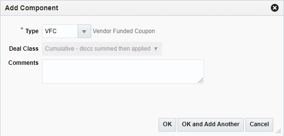

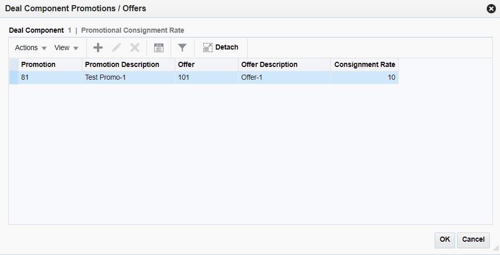

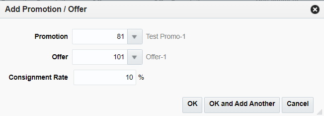

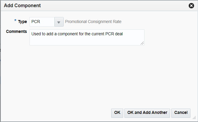

For a Promotional Consignment Rate type of deal, the Add Component pop-up can be used to add one or more components to the deal. For each such component, one or more promotions with individual consignment rates can be added.
Figure 4-9 Promotional Consignment Rate - Add Component

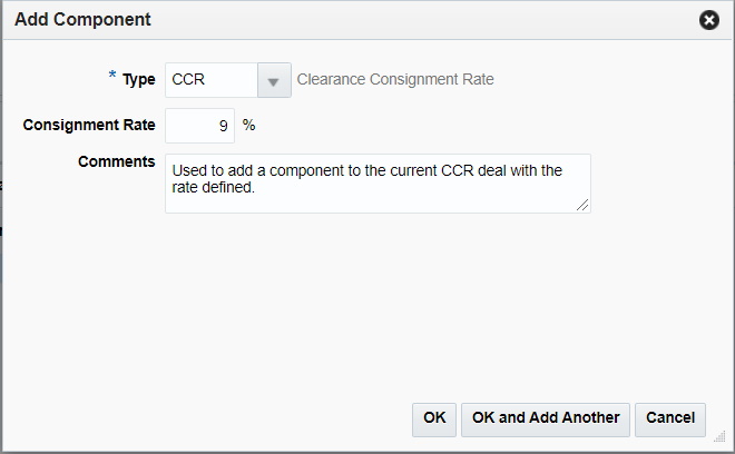

For a Clearance Consignment Rate type of deal, the 'Add Component' pop up can be used to add one or more components to the deal with the deal consignment rate specified.
Figure 4-10 Clearance Consignment Rate - Add Component
In the Type field, select the component type.
In the Threshold Value Type, select the threshold value type. This field is used to capture the incentive type that would be received on attaining the threshold limit of the deal. The options are amount off per unit, percentage off per unit, get units for fixed price or buy/get free or discounted items.
For the deal, in the Deal Class field, select the way in which calculations would be performed in case of multiple deal components. The options are Cumulative, Cascade, or Exclusive.
For a Bill Back, this field will default to Cascade and cannot be changed. For Vendor Funded Promotion and Vendor Funded Markdown, this field will default to Cumulative and cannot be changed.
In the Cost Apply Type field, select how the deal component is used to calculate future costs. The options are Net Cost, Net-Net Cost or Dead Net Cost. The details such as Cost Apply Type is defaulted to Net Cost and can be overridden.
The value in this field is defaulted based on the type of deal you selected, but can be changed.
Select the following check boxes:
Transaction Level Discount - This check box applies to PO-specific off-invoice deals. If this check box is selected on the screen, the deal component applies to an entire PO, receipt or sale transaction. This field can only be selected if the vendor is a supplier. Because these deals apply to the entire order, items and locations are not added to transaction level deals.
Calculate Income From Zero Threshold - This check box is not applicable for off-invoice deals. This indicator is used in cases where the vendor has specified that a minimum threshold needs to be reached before a discount applies and when that threshold is reached, the discount applies against the entire threshold, including the level below the threshold.
Deal in Price Cost - This indicator defines whether the deal is to be used in the pricing cost calculation used by Price Management to determine the margin on the items linked with the deal.
Then choose one of the following options.
Click OK to add the deal component.
Click OK and Add Another to add more deal components.
Click Cancel to return to the Deal Page.

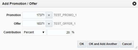

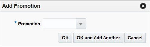

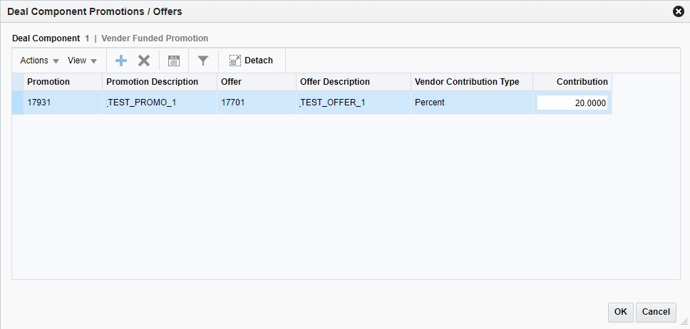

Promotions
While creating a Vendor Funded Promotion, the user can link the one or more promotions and specify the contribution value (percentage or amount) of the vendor for each of them using the 'Deal Component Promotions / Offers' pop up. These promotions need to have their start and end dates within the deal time frame and at least one offer that is not in the Completed or Cancelled status. Once a record is added to the table within the pop up, the user can either select to edit the contribution value or delete the record altogether.
Figure 4-11 Deal Component Promotions Pop-up - Vendor Funded Promotion
Figure 4-12 Add Promotion Pop-up - Vendor Funded Promotion
In case of the Promotional Consignment Rate type of deal, the user can link one or more promotions with their individual consignment rates to each component via the Add Promotion / Offer pop-up.
Figure 4-13 Deal Component Promotions/Offers
Figure 4-14 Add Promotion/Offer
Deal Component Types
Deal component types are a required component while using the Deals functionality in Merchandising. All deals must have at least one component, and the types are a configurable way for retailers to classify the components added to a deal. New component types can be added as desired by implementation to configure the solution to meet your company's needs. The list of valid deal component types is defined by a configurable list of codes and descriptions, which are managed through spreadsheet download and upload processes. These processes are accessed through the main Merchandising task list under Foundation Data > Download Foundation Data and Foundation Data > Upload Foundation Data.

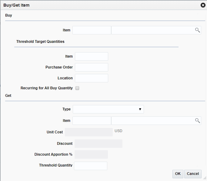

The Buy/Get Item pop-up is only enabled if Threshold Value Type selected is Buy/Get free or discounted items for off-invoice deals.
Add Buy/Get Item
To add buy/get item:
Click Buy/Get Item from the Components section. The Buy/Get Item pop-up appears.
Figure 4-15 Buy/Get Item Pop-up
The Buy/Get Item pop-up consists of the following three sections:
Buy
In the Item field, enter or search an item using the search icon. It identifies the item that must be purchased for a quantity threshold-type discount.
Threshold Target Quantities
In the Item field, enter an item threshold target quantity for the buy item that must be ordered to qualify for the free item.
In the Purchase Order field, enter the threshold target quantity for all locations on the purchase order which the buy item is part of. This is the target level that will be used for future calculation of net cost.
In the Location field, enter threshold target quantity which is the average targeted purchase level per location on the deal. This value will be used in future cost calculations.
Select the Recurring for All Buy Quantity check box. This indicates if the quantity threshold discount is only for the first buy amount purchased (example, for the first ten purchased, get one free), or if a free item will be given for every multiple of the buy amount purchased on the order (example, for every ten purchased, get one free).
Get
In the Type field, select the Get type from the list. Valid options are free, percent, amount or fixed amount.
In the Item field, enter or search for an item using the search icon. This identifies the get item for a quantity threshold-type (buy/get) discount.
In the Unit Cost field, enter the amount. This will be enabled if the Get type selected is Free and identifies the unit cost of the threshold free item that will be used in calculating the prorated quantity discount. It will default to the item/supplier cost, but can be modified based on the agreement with the supplier.
In the Discount field, enter a value. This will be enabled in case Get type is not 'Free'. It will be percent in case get type is Percent otherwise value.
In the Discount Apportion % field, enter a value. This specifies the percentage of the total discount that should be apportioned from the get items unit cost for off invoice deals where buy item is not the same as the get item and Get type is Free. The remaining will be apportioned from the buy item unit cost.
In the Threshold Quantity field, enter a value. This identifies the quantity of the identified get item that will be given at the specified get discount if the buy amount of the buy item is purchased.
Click OK to add the buy/get item information.
Click Cancel to return to the Deal page.

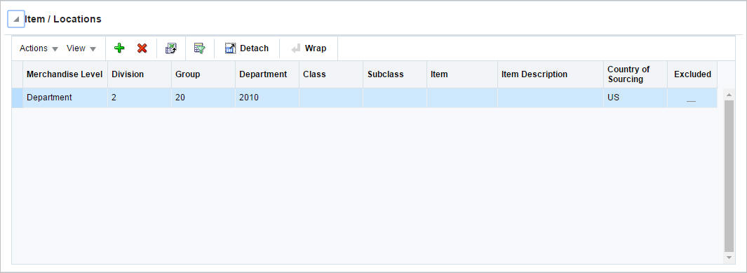

Add Items and Locations
On the Item/Locations section, you can select the items to which the deal components are applied. You can also specify specific locations for the items. Items and items at specific locations can also be excluded from deal component.
The item/location information is set up per component.
Item/Locations - View Menu and Icons
You can customize the view of the table by using the options in the View Menu. For information about this menu, see below and see “View Menu" in the Oracle Retail Merchandising Foundation Cloud Service Do the Basics User Guide.
Figure 4-16 Item/Locations - View Menu
Table 4-3 Item/Locations - View Menu/Icons and Description
| View Menu List | Description |
Saved Views |
Saved views are predefined arrangement of table columns to provide certain specific information by using default and optional columns and is different from the default view. The views available are Merchandise Hierarchy, Organization Hierarchy, and Item Level. For every record you can choose respective saved view to see information related to merchandise hierarchy, organization hierarchy, or item level. |
Add the Item/Locations to a Deal
You can add item/locations to a deal component while creating or editing in the Deal page.
To add the item/locations of a deal:
In the Deal page, go to Item/Locations section.
Figure 4-17 Item/Locations Section

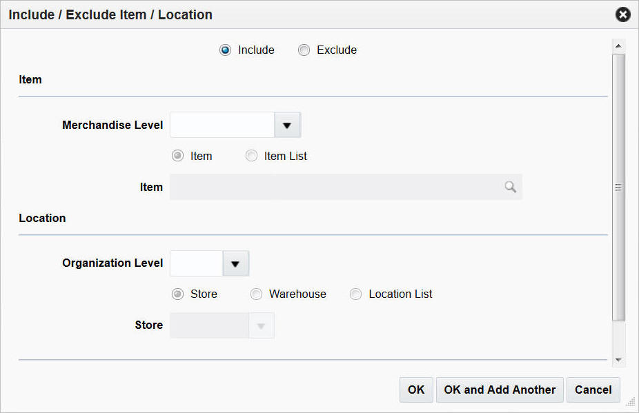

. The Include/Exclude Item/Location pop-up appears
Figure 4-18 Include/Exclude Item/Location Pop-up
Select the include or exclude option to determine if the record is being created for inclusion or exclusion.
In the Item section, select the merchandise level from the Merchandise Level list. Choose the appropriate option to add an item by Item or Item List.
In the Location section, select the organizational level from the Organizational Level list. Choose the appropriate option to add location by Store, Warehouse, or by Location List.
Click OK to add the item/location.
Click OK and Add Another to add more item/locations.

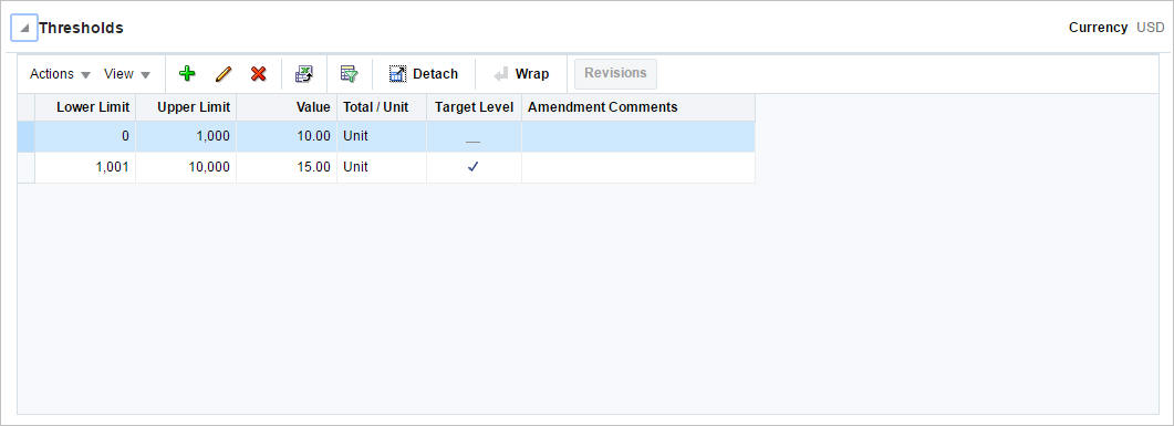

Add Thresholds and Discounts
On the Thresholds section, you can specify the lower and upper limits that need to be reached in order to receive the benefits that are defined as part of the current deal. Multiple thresholds or bands can be defined for a deal. If the threshold value type that was defined for the deal component is set to Amount Off, you have the option to select whether the specified amount needs to be applied per unit or as a total value for the entire threshold band. For example, a vendor might offer the retailer a discount of $1 per unit or a total discount of $50 on buying in excess of 100 quantities. Each component added to the deal can be used as the target level around which cost calculations need to take place. You must indicate the threshold band that is to be treated as the targeted level for a deal component. This threshold band is then used for the future cost and pricing cost calculations.
Add the Thresholds of a Deal
You can add thresholds to a deal component while creating or editing in the Deal page.
To add the thresholds of a deal:
In the Deal page, go to Thresholds section.

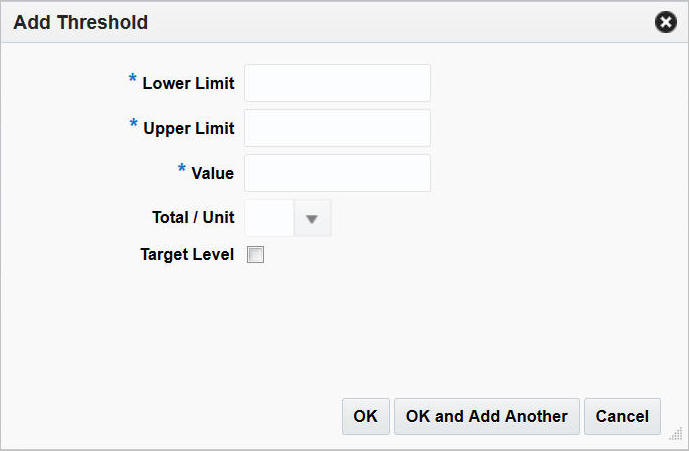

Figure 4-19 Thresholds Section
. The Add Threshold pop-up appears.
Figure 4-20 Add Threshold Pop-up
In the Lower Limit field, enter the value of the lower limit of the deal component. This is the minimum value that must be met in order to get the specified discount. This value will be either a currency amount or quantity value, depending on the threshold limit type of this deal component.
In the Upper Limit field, enter the value of the upper limit of the deal component. This is the maximum value for which the specified discount will apply. This value will be either a currency amount or quantity value, depending on the threshold limit type of this deal component.
In the Value field, enter the value of the discount that will be given for meeting the specified thresholds for this deal component. This value will be either a currency amount or quantity value, depending on the threshold limit type of this deal component.
In the Total/Unit field, select the total or unit. It indicates if the value for deal components for which the threshold type is amount off is amount off by unit or in total.
Select the Target Level check box. This indicates if a threshold level is the targeted purchase or sales level for a deal component. This indicator will be used for cost calculations.
Click OK to add thresholds. You can add more thresholds by clicking OK and Add Another.
Click Cancel to return to the Thresholds section.

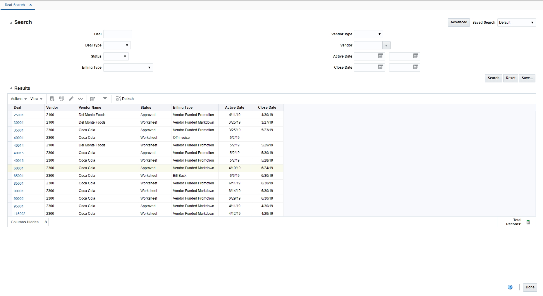

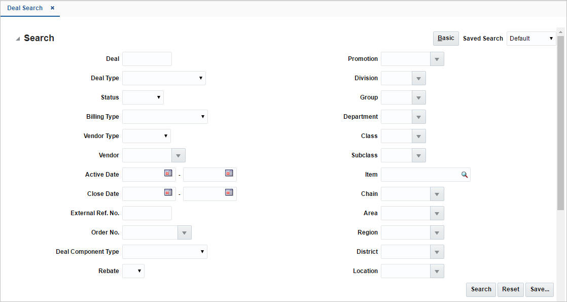

On clicking the Manage Deal link by selecting Deals > Manage Deal, the Deal Search page appears.
In the Deal Search page you can search for deals by specifying various search criteria. You can choose to access deals in the search results in edit or view mode depending on security privileges. There are also options for creating a new deal or creating a new deal from existing.
The Deal Search page includes the following sections:
Search
For more information on the Deal Search page, see the Search for a Deal section.
Figure 4-21 Deal Search Page
Search for a Deal
To search for a deal:
From the Tasks menu, select Deals > Manage Deal. The Deal Search page appears.
You can search for a deal by providing search criteria in the search section. The criteria can be provided either in Basic or Advanced mode, depending on the requirement. Basic is the default mode when the search page is entered. Click Advanced to access the search panel in advanced mode. You can return to Basic mode by clicking Basic.
Search for a Deal Through the Basic Search Criteria
To search for a deal through the basic search criteria:
Enter or select one or all of the following basic search criteria.
Table 4-4 Deal Search - Basic Search Criteria
Fields Description Deal
Enter the deal ID.
Deal Type
Select the deal type. The options are: Annual, Promotional, PO Specific, Vendor Funded Markdown.
Status
Select the status of the deal. The options are: Worksheet, Submitted, Approved, Rejected, Closed.
Billing Type
Select the type of deal being created. The options are Off Invoice, Bill Back, Bill Back Rebate, Vendor Funded Promotion, Vendor Funded Markdown, Promotional Consignment Rate, and Clearance Consignment Rate.
Vendor Type
Select the vendor type.
Vendor
Enter, select or search for the vendor.
Active Date
Enter the date on which the deal becomes active, or click the calendar icon and select the date.
Close Date
Enter the date on which the deal ends, or click the calendar icon and select the date.
You can also click the Saved Search drop down to select one of the saved sets of search criteria. Selecting a saved search will populate the criteria section with saved criteria. If the saved search is selected to run automatically then the search will be executed too.
You can also choose to manage and personalize the saved searches by clicking Personalize in the list. The Personalize Saved Searches page appears.
For more information on the Personalize Saved Searches, see Personalize Saved Search in the Oracle® Retail Merchandising Foundation Cloud Service Do the Basics User Guide.
Click Search. The deals that match the search criteria are displayed in the Results section.
Click Reset to execute the saved search.
Click Save. to save the current set of search criteria as a Saved Search. The Create Saved Search pop-up appears.
For information on the Create Saved Search pop-up, see Create Saved Search in the Oracle® Retail Merchandising Foundation Cloud Service Do the Basics User Guide.
Click Done to close the pop-up.

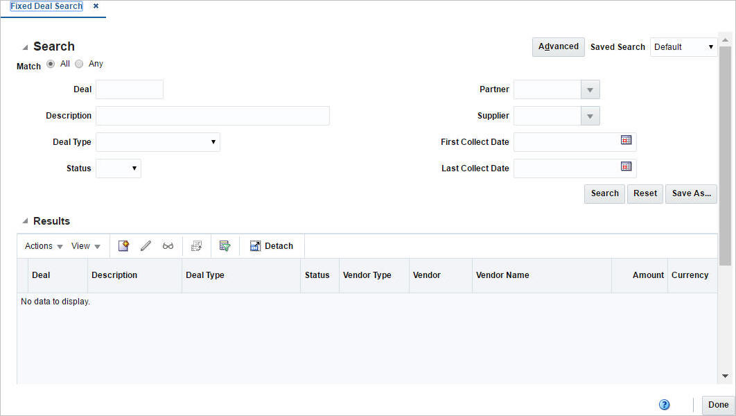

Figure 4-22 Search Section in Advanced Search Mode
To narrow down the search, use the list next to the search fields. For example, determine if the entered value should equal or not equal the search result.
Click on the Saved Search list to select one of the saved search criteria. Selecting a saved search populates the search section with the saved search criteria. If the run automatically function is enabled for the search, the search is executed immediately.
You can also personalize your saved searches by selecting Personalize. The Personalize Saved Searches page appears.
For more information about the Personalized Saved Search, see Personalize Saved Search in the Oracle® Retail Merchandising Foundation Cloud Service Do the Basics User Guide.
Click Reset to clear the search section and results.
Click Save As... to save the current search criteria. The Create Saved Search pop-up appears.
For more information about how to save your search criteria, see Create Saved Search in the Oracle® Retail Merchandising Foundation Cloud Service Do the Basics User Guide.
Click Done to close the page.
Results
The Results section lists the retrieved deals.
Deal Search Toolbar
For information about the toolbar, see “Screen Level Action - Icons and Buttons" in the Oracle Retail Merchandising Foundation Cloud Service Do the Basics User Guide.

Create a Deal
To create a deal, follow the steps below.
From the Actions menu, select Create or click the Create icon
. The Create Deal page appears.
For more information on how to create a deal, see the Create a Deal section

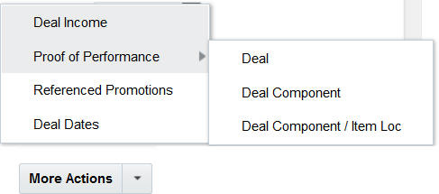

Deal - More Actions Menu
Use the More Actions menu to navigate to the following pages. The More Actions menu contains the following options.
Figure 4-23 Deal - More Actions Menu
Table 4-6 Deal - More Actions Menu and Description
| Action Buttons | Description |
More Actions |
You can navigate to open the following pop-ups by clicking More Actions menu: You can navigate to the following pop-ups from the More Actions menu:

Submit a Deal
You can submit a deal when a deal is created and the deal is in Worksheet status.
To submit a deal:
In the Components section, select Actions > Add or click the Add icon
You need to enter the required information in the following sections before submitting a deal:
Components
Item/Locations
Thresholds
Enter all the required information and click Submit on the page level toolbar. The deal status changes to Submitted.

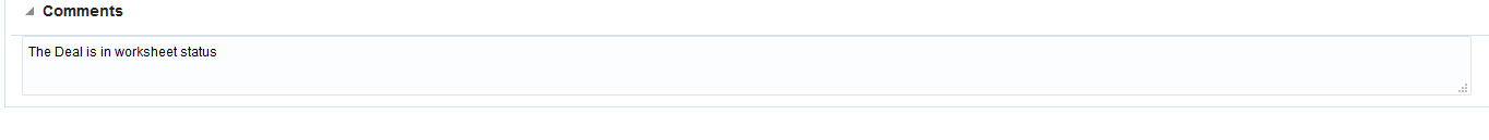

Add Comments to a Deal
To add comments to a deal:
In the Comments section, enter your comments.
Figure 4-24 Comments Section
Click Save to save your changes or click Save and Close to save and close the page.
Click Cancel to discard the changes and close the page.

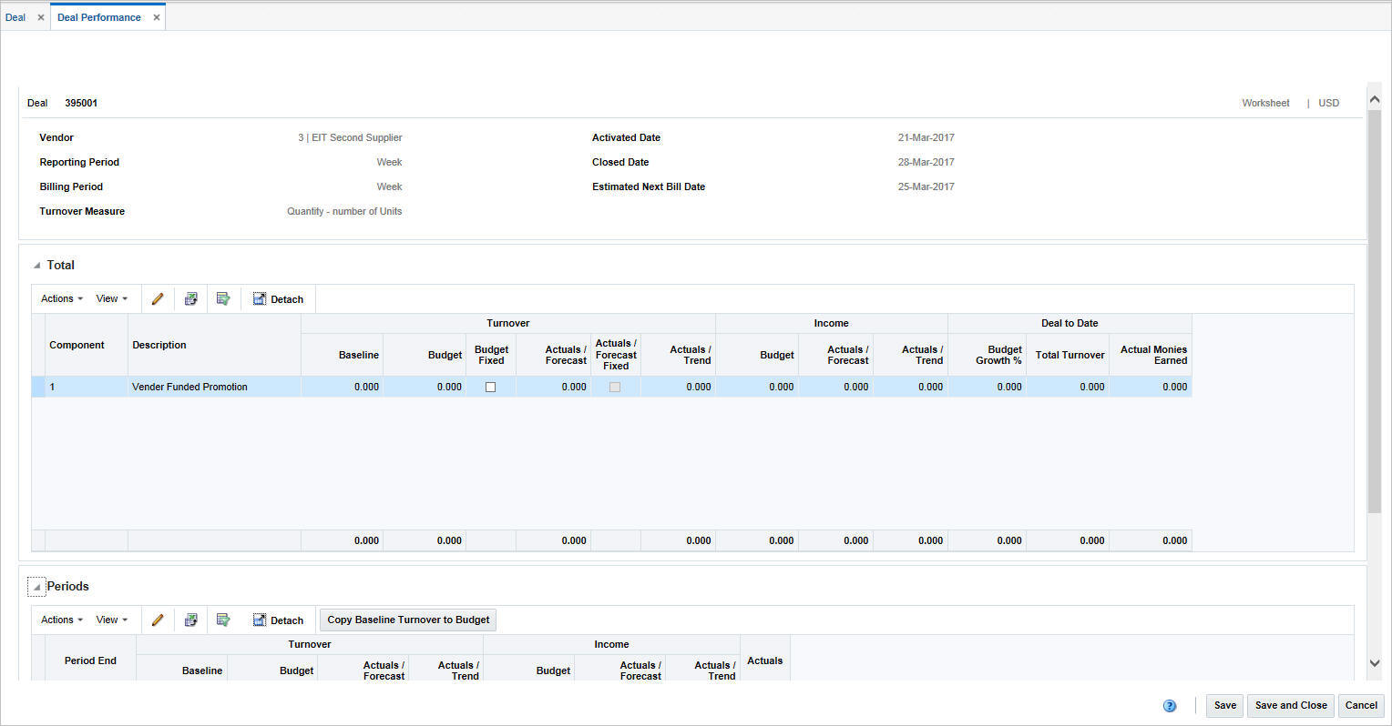

Deal Performance
The Deal Performance page allows you to maintain forecasts for a deal, view period by period performance, and compare the actual deal performance against the actual forecasts.
As actuals are accrued, you can view the actual performance of the deal, at the component level, against the forecasted performance of the deal.
View Deal Performance Page
To view deal performance:
From the Tasks menu, select Deals > Create Deal. The Create Deal page appears.
From the More Actions menu, click Deal Income.
The Deal Performance page appears, which includes Total and Periods section. For more information on Total and Periods, see the Totals and the Periods section.
Figure 4-25 Deal Performance Page
Deal Performance Header
The Deal Performance Header includes the following fields.
Table 4-8 Deal Header - Fields and Description
Title |
The title displays Deal ID to the top left of the head container. The Deal Status and the Currency is displayed with a separator between them to the top right of the head container. The deal number is populated by default. |
Deal Status |
Vendor |
Reporting Period |
The deal reporting level determines the length of the reporting periods that would be created for income generation. The options provided depends on the calendar type that is being used in the Merchandising instance. For a 4-5-4 calendar, this can be Week, Month, or Quarter, while for a Gregorian calendar, only Month, or Quarter can be selected. Income is calculated once per reporting period. The reporting level also indicates the maximum frequency at which an invoice is raised against the income accrued by the deal. If quarterly processing is chosen, based on the end date for the deal, Merchandising may change the date of the final reporting period to an end of month date instead, if the end of the quarter is more than a month away, to allow for faster income realization. For example, if the end date of the deal is set for 17-Jan, but the end of the quarter is 30-Mar, Merchandising changes the last reporting period to 26-Jan, which is the nearest end of month date. |
Billing Period |
This field displays the time period for which invoice would be raised for the deal. |
Turnover Measure |
This field displays whether the turnover from the deal would be measured in quantity or value terms. |
Activated Date |
The activated date is the day from which the deal starts to be applied within the system. |
Closed Date |
The close date is the last day of the deal. This is required only for promotional deals. |
Estimated Next Bill Date |
The Estimated next invoice date gets populated initially based on the Bill Back period. It takes the last day of the period that will be invoiced. After the invoicing batch program Vendor Deal Invoicing (vendinvc) runs, this date is updated with a Gregorian week, month, or quarter, or the 4-5-4 week setup based on the calendar configuration in the system. This date can be modified throughout the deal's lifetime, even after approval until the last invoice against the deal has been processed. |
Totals
The Total section displays the turnover and income values for deal components for all the valid periods. For turnover it has baseline, budget and actual values. It also shows if turnover totals are designated fixed for distribution among periods. For income it shows budget, actual/trend and actual/forecast values. In addition it also shows Budget Growth %, Total Turnover and Actual Monies Earned with respect to total deal to date.

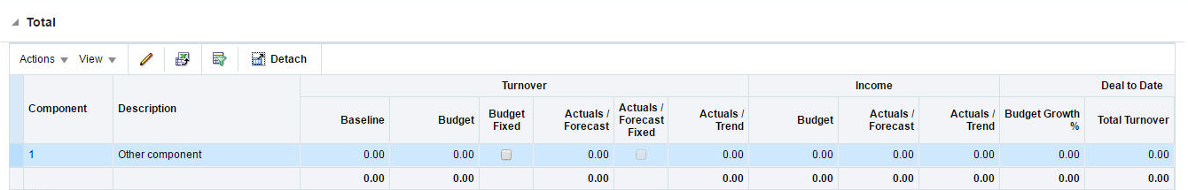

Edit a Total of a Deal Component

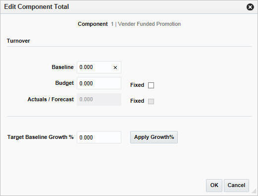

To edit total of a deal component:
From the More Actions menu, click Deal Income. The Deal Performance page appears, which includes the Total section.
Figure 4-26 Total Section
From the Actions menu, click Edit or click the Edit icon
. The Edit Components Total pop-up appears.
Figure 4-27 Edit Component Total Pop-up
In the Baseline field Turnover sub section, enter or edit the previous year's turnover.
In the Budget field Turnover sub section, enter or edit the expected amount of turnover.
In the Actuals/Forecast field Turnover sub section, enter or edit the actuals or forecast amount.
When the budget turnovers are set, select the Fixed check box to the right of the Budget field. Setting the budget Fixed signifies that the total value for the component will remain fixed despite any change in the value specific to any period. Any change will be divided over the other periods. If this is selected than you will not be able to apply growth % over the baseline to populate budget.
Fixed can be checked against Actual/Forecast as well.
In the Target Baseline Growth % field, enter the percentage you expect the baseline to grow.
Click Apply Growth%.
Click OK to save any changes and close the pop-up.
Click Cancel to discard the changes and close the pop-up.
Once a deal is approved, you can change only forecast values. Before that Baseline can also be changed.
This applies for both total and periods section.

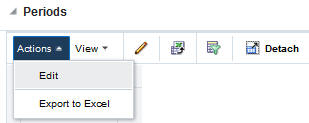

Periods - Actions Menu and Icons
Use the Actions Menu and icons to apply actions to the table. You can perform actions listed below, as well as the actions described in the “Action Menu and Icons" section in the Oracle Retail Merchandising Foundation Cloud Service Do the Basics User Guide.
Figure 4-28 Periods - Actions Menu and Icons

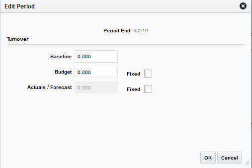

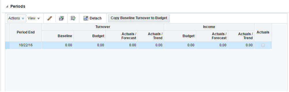

Edit Periods of a Deal Component
To edit periods of a deal component:
From the More Actions menu of the Deals page, click Deal Income. The Deal Performance page appears, which includes the Periods section
Figure 4-29 Periods Section
. The Edit Period pop-up appears.
Figure 4-30 Edit Period Pop-up
The total check boxes are view only. They would be checked if the totals for them have been checked fixed in the totals table.

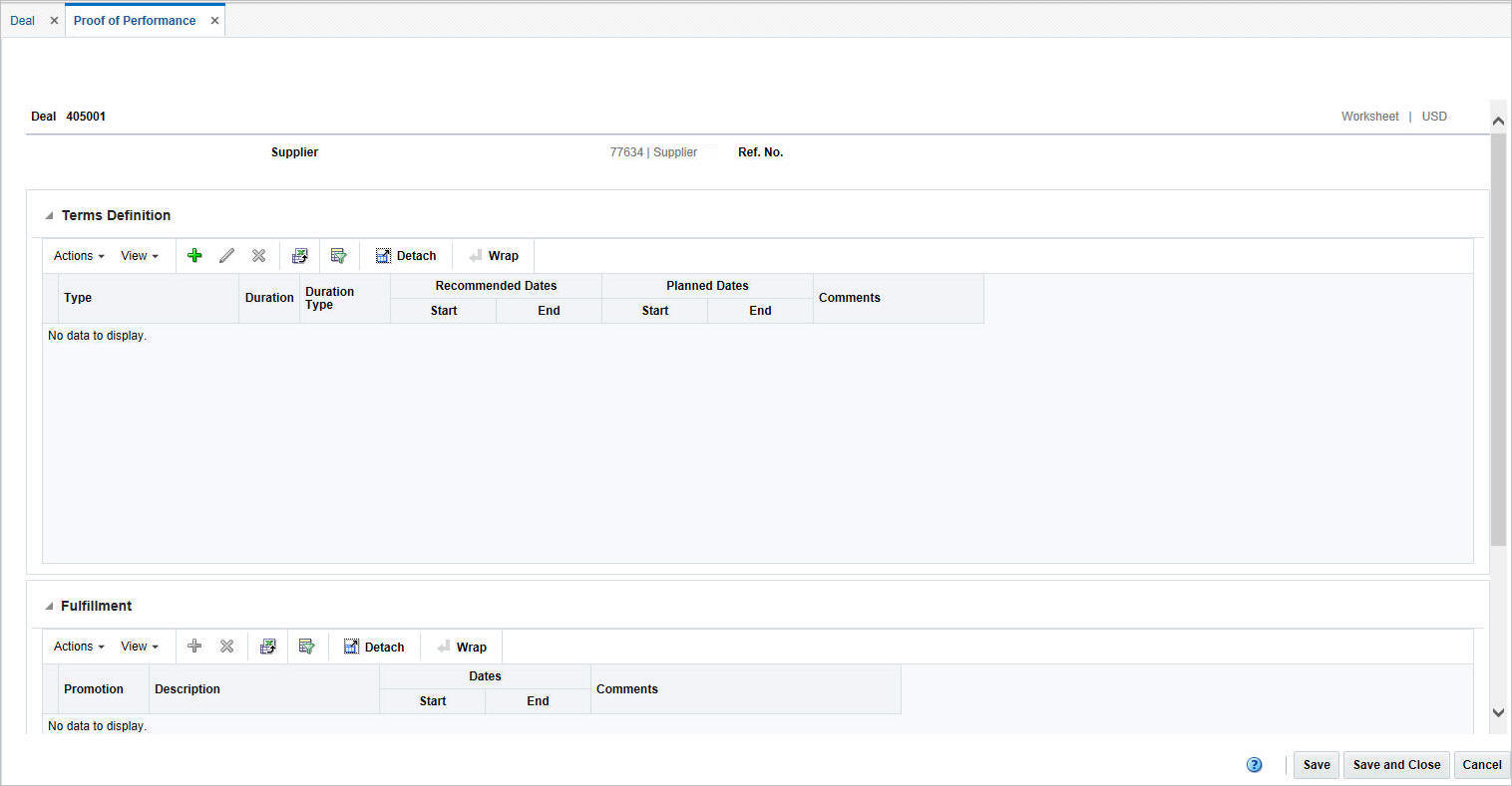

Proof of Performance
You can access the Proof of Performance page from the Deals page, More Actions > Proof of Performance. You can access Proof of Performance (POP) page at one of the following levels through the POP sub menu:
Deal
Deal Component
Deal Component/Item Loc
The POP page is used to define the performance requirements at the deal level, component level, or at the item/location level. This allows the buyer to identify what needs to be done in order to receive the deal discount, which might be an advertisement, coupon distributions or ‘in store' demonstrations of the product. POP terms are used only for informational purposes in Merchandising.
View/Create/Edit Proof of Performance Page
You can select the level at which you want to view, create, or edit for Proof of Performance definitions and fulfillment information. The options are: Deal, Deal/Component, Deal Component Item/Loc.
To view/create/edit proof of performance:
From the More Actions menu of the Deal page, click Proof of Performance, and then click Deal or Deal Component or Deal Component/Item Loc depending on which level you want to define proof of performance.
The Proof of Performance page appears, which includes Terms Definition and Fulfillment sections.
For more information on Terms Definition and Fulfillment, see the Add Proof of Performance Terms Definition and the Add Proof of Performance Fulfillment section.
Figure 4-31 Proof of Performance Page

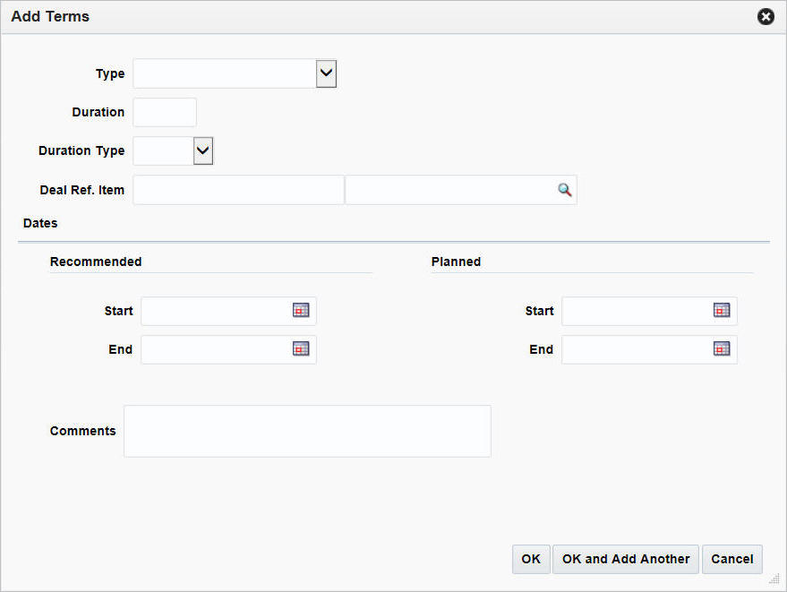

. The Add Terms pop-up appears.
Figure 4-32 Add Terms Pop-up
In the Type field, select type of performance term.
In the Duration field, enter the duration for the duration type for which the terms will be valid.
In the Duration Type field, select the period of time that you have to comply to the terms of the deal.
In the Deal Ref. Item field, enter the deal reference item or search for and select the deal reference item.
In the Recommended Start and End date fields, enter the vendor's recommended start and end dates or click the calendar icon and select the dates.
In the Planned Start and End date fields, enter the date you intend to start and end complying or click the calendar icon and select the dates.
Click OK to save the changes and return to Proof of Performance page.
Click OK and Add Another to add more terms.
Click Cancel to reject all entries and close the pop-up.

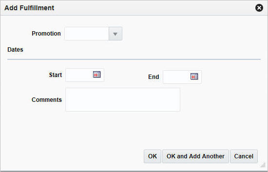

. The Add Fulfillment pop-up appears.
Figure 4-33 Add Fulfillment Pop-up
In the Promotion field, enter, select or search for a promotion.
In the Dates area:
In the Start Date field, enter the start date of the promotion, or click the calendar icon and select a date.
In the End Date field, enter the end date of the promotion, or click the calendar icon and select a date.
Click OK to add fulfillment. You can add more fulfillment by clicking OK and Add Another.
Click Cancel to close the fulfillment pop-up.

Manage Referenced Promotions
The Referenced Promotions option opens the Deal Promotions. This page allows you to associate a deal with a promotion. Multiple promotions can be attached to a deal. The promotion is set up in the pricing system and can then be attached to the deal.
Add Promotions to a Deal
To add promotions to a deal:
From the More Actions menu, click Referenced Promotions.
The Deal Promotions pop-up appears.
. The Add Promotions pop-up appears
Figure 4-34 Add Promotions Pop-up
You can add more promotions by clicking OK and Add Another.
Click Save to save your changes or click Save and Close to save and close the pop-up.

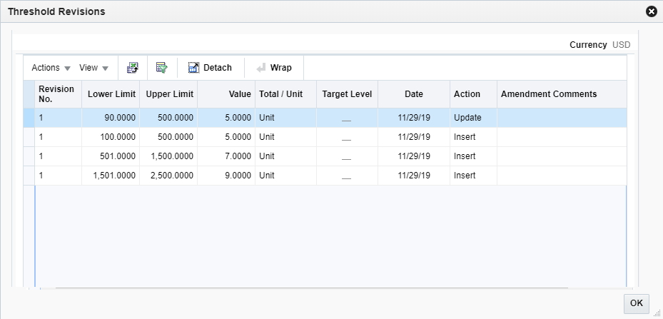

View Threshold Revisions
The threshold revisions pop-up is visible when revisions exist for a threshold.
To view the threshold revisions pop-up:
In the Deal page, go to Thresholds section and then click Revisions. The Threshold Revisions pop-up appears.
Figure 4-35 Threshold Revisions Pop-up

Figure 4-37 Fixed Deal Page

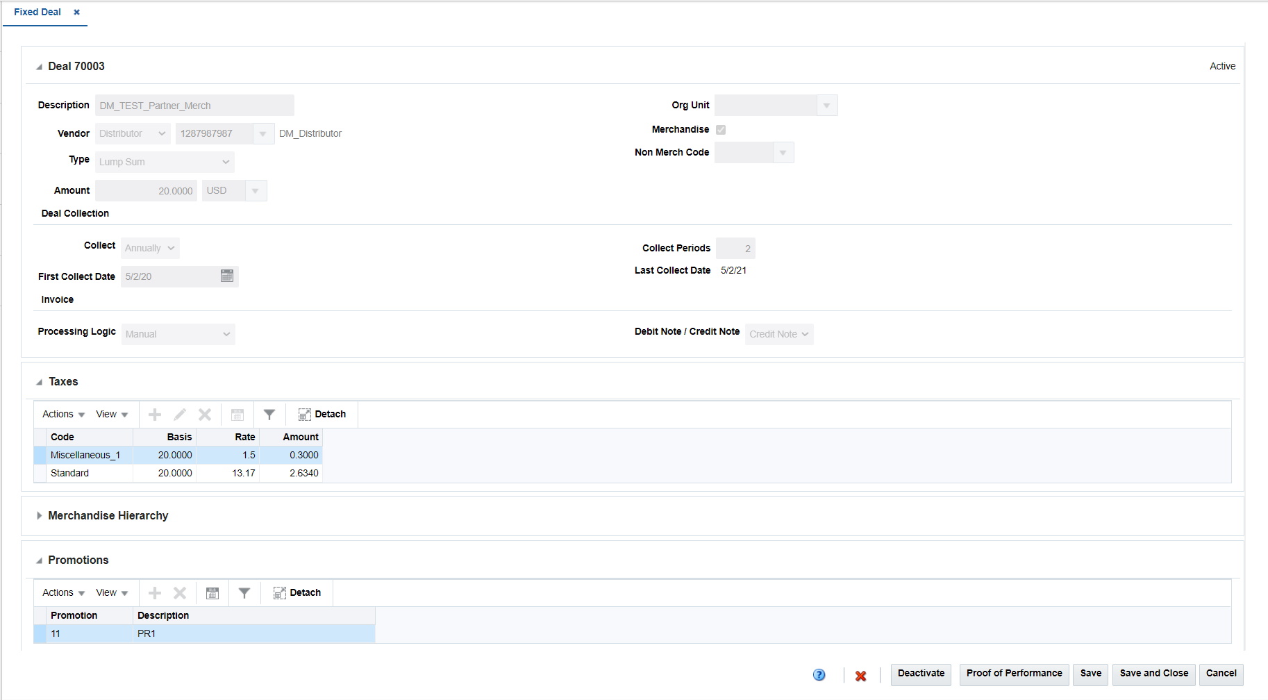

Create a Fixed Deal
To create a fixed deal:
From the Tasks menu, select Deals > Manage Fixed Deal. The Fixed Deal Search page appears.
. The Fixed Deal widow appears.

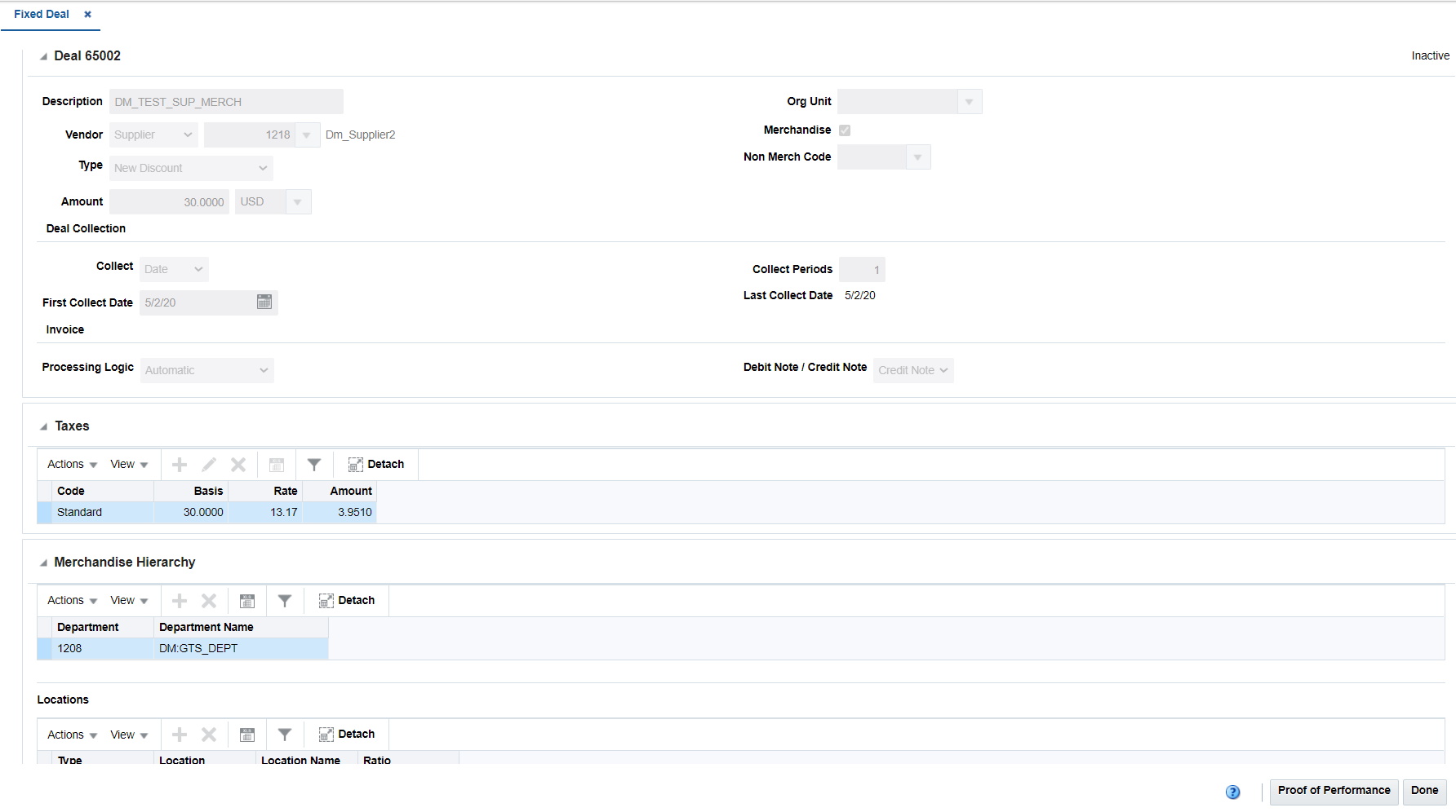

Figure 4-38 Fixed Deal Page
For more information on how to create a fixed deal, see the Create a Fixed Deal section.
Fixed Deal Header
The Fixed Deal Header includes the following fields.
Table 4-11 Fixed Deal Header - Fields and Description
Title |
The title displays Fixed Deal ID to the top left of the head container. The Deal Status is displayed to the top right of the head container. This field contains the deal number by default. |
Description |
Enter a description of the fixed deal. |
Vendor |
Select or search for the type of fixed deal vendor. |
Type |
Select the type of payment. |
Amount |
Enter the payment amount from the supplier. |
Org Unit |
Enter, select or search for an organizational ID. |
Merchandise |
If the deal is associated to the merchandise hierarchy, select the Merchandise check box. For more information on Merchandise Hierarchy, see Merchandise Hierarchy. |
Non Merch Code |
Enter, select or search for the non-merchandise code. The Non Merch field is required only if the Merchandise check box is not selected. |
Deal Collection section: |
Collect |
Select how often payment for the fixed deal is collected from the supplier. If you select Date in the Collect field, the number of collection period is always one. |
First Collect Date |
Enter the date, or click the calendar icon and select the date. The date of the collection of the first amount decided as part of the fixed deal. |
Collect Periods |
Enter the number of collection periods. |
Last Collect Date |
If you enter the date in the First Collect Date field, the Last Collect Date field is displayed by default. The number of times the collection date is to be repeated after the First Collect Date. On each collection date an invoice may be raised based on the invoicing options selected for the deal. |
Invoice section: |
Processing Logic |
Select how invoices are created for the fixed deal. The options of creating invoices are: Automatic, Manual, No Invoice Processing depending on the option selected. |
Debit Note/Credit Note |
Select whether you want to send a Debit or Credit Note request to the supplier. |
Taxes
Multiple tax codes can be supported per merchandise hierarchy or non-merchandise code in the Global Tax Solution (GTS) setup. The Taxes table allows you to manually add one or more taxes relevant to the fixed deal. The tax amount will get split between the set of hierarchies added in the Merchandise Hierarchy table and then further divided into the locations added in the Locations table based on the user defined ratio.
The Add Tax pop-up allows you to add the taxes to the above table.
Figure 4-39 Add Tax

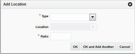

Locations
The Locations section allows you to indicate at which locations the deal is effective.
Create Locations to a Fixed Deal
You can create locations when a fixed deal is created in the Fixed Deal page.
To create the locations to a fixed deal:
In the Fixed Deal page, go to Locations section.
From the Actions menu after entering the header details, click Create or click the Create icon
. The Add Locations pop-up appears.
Figure 4-41 Add Locations Pop-up
In the Type field, select the location type you want to add to the fixed deal. This field is a required field.
In the Location field, enter, select or search for the location. You can also search for a location through Basic or Advanced search.
In the Ratio field, indicate what percentage of fixed deal the location contributes.
Click OK to add the location to the table and close the pop-up.
Click OK and Add Another to add additional locations.

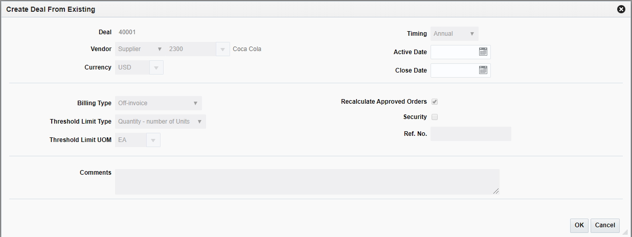

Create from an Existing Deal
To create a deal from an existing deal, follow the steps below.
From the Actions menu, select Create from Existing or click the Create from Existing icon
. The Create from Existing pop-up appears.
Figure 4-42 Create From Existing Pop-up
Click OK to create a deal from an existing deal.
Click Cancel to return to Deal Search page.
Manage Fixed Deals
The Manage Fixed Deals option opens the Fixed Deal Search page. Managing a fixed deal involves performing one or more of the following tasks:
Searching for a fixed deal
Creating a fixed deal
Editing a fixed deal
Viewing a fixed deal
On clicking the Manage Fixed Deal link by selecting Deals > Manage Fixed Deal, the Fixed Deal Search page appears.
In the Fixed Deal Search page you can search, add, create, view, export to Excel, query by example, and detach deals. You can also create deals for items on a specific purchase order.
The Fixed Deal Search page includes the following sections:
Search
For more information on the Fixed Deal Search page, see the Search for a Fixed Deal section.
Figure 4-43 Fixed Deal Search Page
Manage a Fixed Deal
To manage a fixed deal use the Actions menu, View menu and icons in the Merchandise Hierarchy section.
You can access the Terms Definition and Fulfillment sections by clicking the Proof of Performance button. For information on Terms Definition and Fulfillment of a fixed deal, see the Manage Terms and the Manage Fulfillment section.
To search for a fixed deal:
You can search a fixed deal by providing search criteria in the search section. The criteria can be provided either Basic or Advanced mode, depending on the requirement. Basic is the default mode when the search page is entered. Click Advanced to access the search panel in advanced mode. You can return to Basic mode by clicking Basic.
Search For a Fixed Deal Through the Basic Search Criteria
To search for a fixed deal through the basic search criteria:
Table 4-12 Fixed Deal Search - Basic Search Criteria and Description
Search Field Description Match
You can match your search criteria by selecting All or Any radio button.
All - Only deals matching all entered search criteria are shown.
Any - Deals matching each entered search criteria are shown.
Deal
Enter the deal ID.
Description
Enter the description of the deal.
Deal Type
This is the reason for the payment and does not drive any functionality. However, it allows the quick grouping of fixed deals for custom reporting. The options are: Cancel Allowance, Allowance Non Performance, Display Allowance, Early Buy Allowance, New Discount, New Warehouse, Lump Sum, New Item Allowance, Slotting Allowance, New Distribution Allowance, Advertising Allowance, Other Allowance, Scan Based Allowance.
Status
Select the status of the deal. The options are: Active and Inactive.
Partner
Enter, select or search for the type of partner for which you are creating the fixed deal.
Supplier
Enter, select or search for the supplier ID for which you want to create a fixed deal.
First Collect Date
Enter the date, or click the Calendar icon and select the date.
Last Collect Date
Click Search. The fixed deals that match the search criteria are displayed in the Results section.
Manage Terms
The Terms Definition section is used to define proof of performance terms for a given fixed deal. These terms are defined by the deal partner that offers the deal.
Add a Fixed Deal Terms Definition
To add fixed deal terms definition:
From the Tasks menu, select Deals > Create Fixed Deal. The Fixed Deal page appears.
Click Proof of Performance.
The Proof of Performance page appears which includes the Terms Definition and Fulfillment sections.
Figure 4-48 Add Terms Pop-up
In the Type field, select what must be done to comply with the terms of the deal.
In the Duration field, enter the duration for which the terms will be valid.
In the Comments field, add a comment if necessary.
Click OK to the terms and close the pop-up.
Click OK and Add Another to add additional terms.
Figure 4-49 Add Fulfillment Pop-up
In the Dates area:
Click OK to the fulfillment and close the pop-up.
Click OK and Add Another to add fulfillments.
The Promotions page allows you to associate a fixed deal with promotions. You can attach multiple promotions to a fixed deal. The promotion is set up in the pricing system and can then be attached to the fixed deal.
Add Promotions to a Fixed Deal
To add promotions to a fixed deal:
In the Fixed Deal page, go to Promotions section.
. The Add Promotions pop-up appears.
Figure 4-50 Add Promotions Pop-up
In the Promotion field, enter, select or search for a promotion. You can also search for promotions through Basic or Advanced search.
Click OK to add the promotion to the table and close the pop-up.
Click OK and Add Another to add additional promotions.
