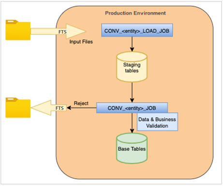

The diagram below shows, at a high level, how the conversion schema is set up in relation to your production environment.

At a high level, for each entity you wish to convert using the conversion APIs in the production environment, you need to perform the following steps:
Place the conversion zip file into the object storage incoming prefix.
Run the
CONV_<entity>_LOAD_JOBbatch process using the Process Orchestration and Monitoring (POM). The batch moves the input files from the object storage to an inbound directory for data processing and loading into the conversion staging tables. There is separate load job for each conversion entity. For example, theCONV_PARTNER_LOAD_JOB_ADHOCjob loads the partner data in the related staging table. -
The above batch process will insert a record with a unique process ID into the
CONV_PROCESS_TRACKERtable. You can monitor the load processing by querying this table using the Merchandising APEX Data Viewer link. The statusEND_IMPORTin the table indicates that load was successful. If there are errors during the data load into the staging tables, then the status is recorded asFAILED_IMPORT. -
In case of errors during the data loading into the staging tables, to debug and troubleshoot the load errors, query the
FILE_UPLOAD_STATUSandFILE_UPLOAD_LOGtables. These tables will provide the details of the files loaded and corresponding load errors. -
Run the
CONV_<entity >_JOBbatch process using the Process Orchestration and Monitoring (POM). This job will perform data and business validation on the imported data in the conversion staging tables and upload the successfully validated records to the main Merchandising tables based on the entity being loaded. For example, theCONV_PARTNER_JOB_ADHOCjob validates and uploads the partner data to relevant Merchandising tables. -
After running step 5, the status in the
CONV_PROCESS_TRACKERtable -COMPLETE_NO_REJECTSindicates a successful load into the Merchandising tables andCOMPLETE_WITH_REJECTSindicates the process completed with some rejected records. The statusEND_VALIDATEin theCONV_PROCESS_TRACKERtable is an intermediate status once the job in step 5 completes data validation and is in the process of business validation and loading to Merchandising tables. -
The successful records are inserted into the Merchandising main tables. Any rejected records are written to the
CONV_VALIDATION_ERRORtable. The reject file is generated and moved to the outgoing prefix in the object storage. You can download the file to view the errored data, make relevant corrections, and reprocess the rejects.
