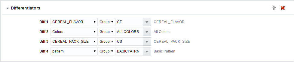

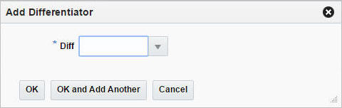

Diffs
A differentiator (diff) is a characteristic that can be used to make items distinct from one another. You can add levels to an item group if you identify a set of diffs or diff groups. Each unique diff or combination of diffs creates a new level in the item group. If you choose not to use diffs, you can manually create item levels.
Once you have selected the diffs, you can create all of the items for that item level, through Merchandising.

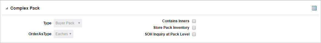

Complex Pack
A complex pack contains different multiple component items.

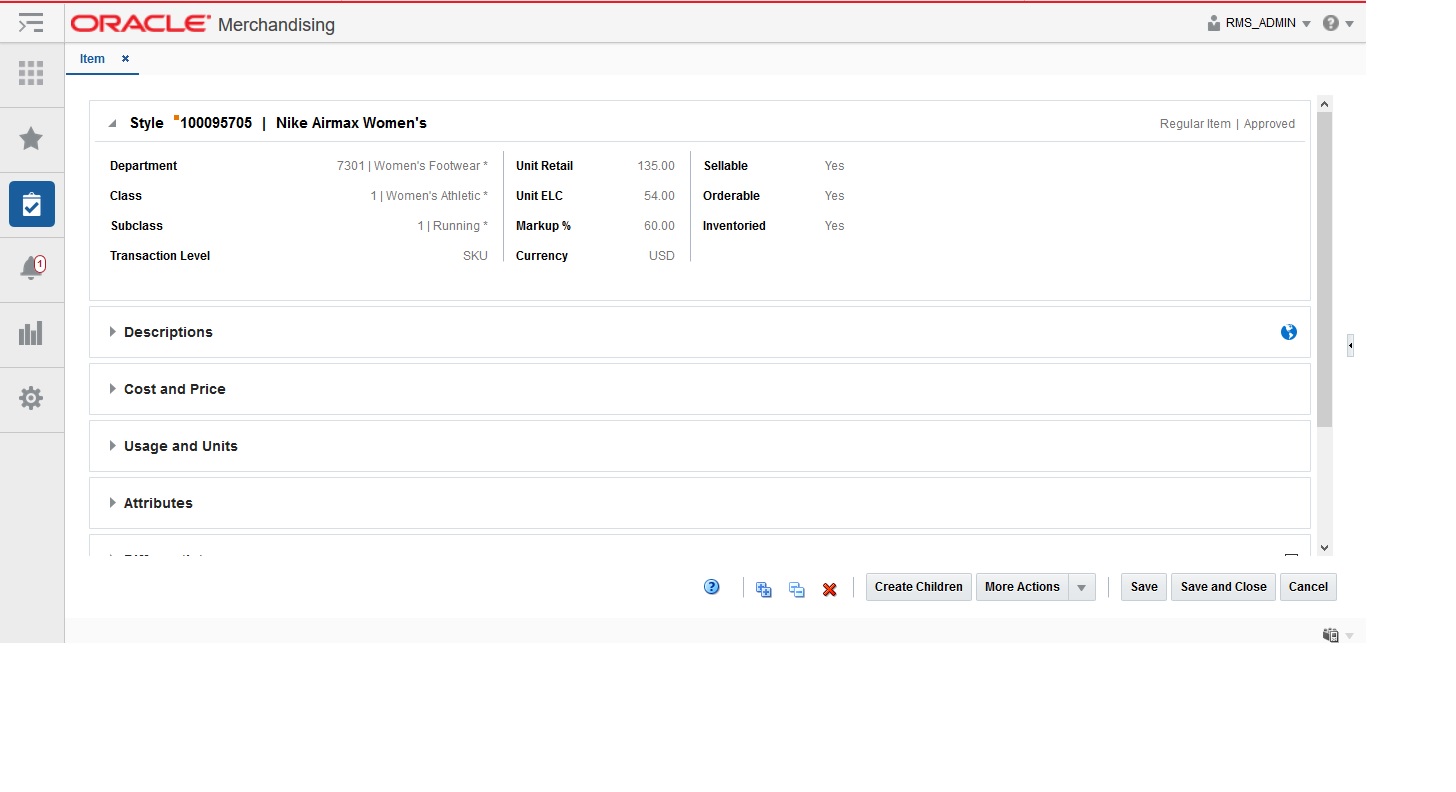

Create an Item
To create an item:

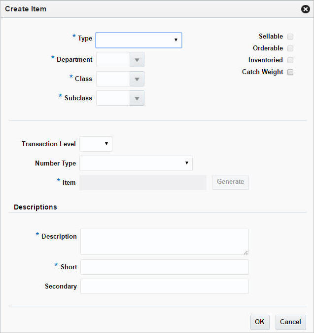

  1. From the Tasks menu, select Items > Create Item. The Create Item page appears.
    Figure 1-1 Create Item Page
    Create Item window
  2. In the Type field, select the following type of items you can create:
    • Regular Item
    • Simple Pack
    • Complex Pack
    • Deposit Contents
    • Deposit Container
    • Deposit Crate
    • Deposit Returned Item
    • Transformed Orderable
    • Transformed Sellable
  3. In the Department field, enter the ID of the department for the new item, select the department, or search and select the department.
  4. In the Class field, enter the ID of the class for the new item, select the class, or search and select the class. You must select a department before you can select a class.
  5. In the Subclass field, enter the ID of the subclass for the new item, select the subclass, or search and select the subclass. You must select a department and class before you can select a subclass.
  6. Select the item type indicators:
    • Sellable: Select this check box to indicate the item is sellable and will be sent to the selling systems (e.g. POS, OMS).
    • Orderable: Select this check box to indicate the item can be ordered, set up, set up on replenishment, and to set up HTS and expenses.
    • Inventoried: Select this check box to track inventory and to have stock on hold in Merchandising.
    • Catch Weight: The Catch Weight functionality allows items that may be purchased and sold in varying weights to be better managed within Merchandising. The Catch Weight items are weighed at the receiving location.
    The indicators that you select for the Level 1 item will be applied to all items in the item group and cannot be changed.
  7. In the Transactional Level field, select the transaction level for the item.
  8. In the Item Number Type field, select the type of item number that you want to associate with the item.
  9. The Item field is the unique number used to identify the product.

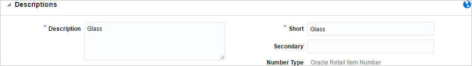

  10. In the Descriptions area:
    1. In the Description field, enter the description of the item.
    2. In the Short field, populates with the item description.
    3. In the Secondary field, enter alternate description of an item. This field can be used to enter the item description used by the supplier.
  11. Then choose one of the following options.
    • Click OK. The Item page appears.
      For more information about this page, see the Item Page section.
    • Click Cancel to reject all entries close the page.

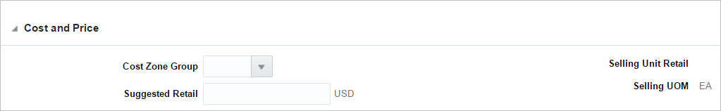

  9. Add the cost zone group.
    Go to the Cost and Price section. In the Cost Zone Group field, enter, select or search for the cost zone group.

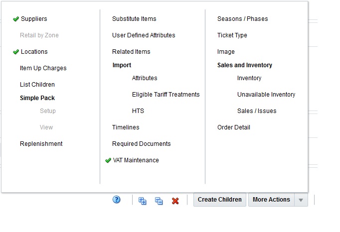

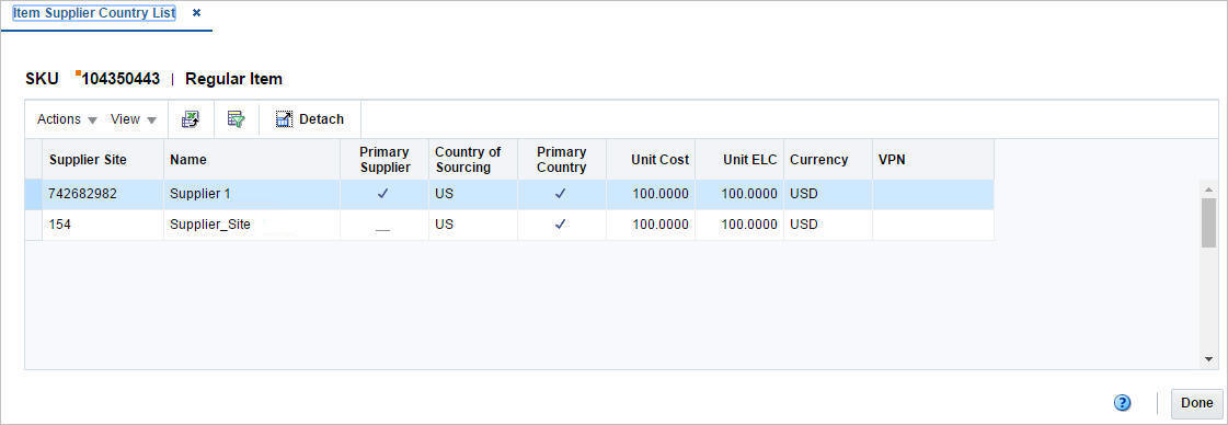

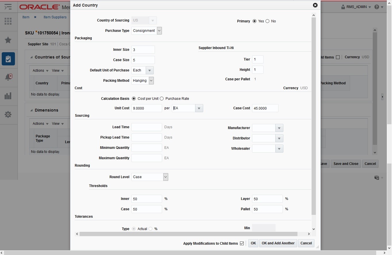

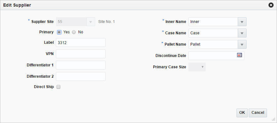

  11. Add a supplier and a sourcing country for the item.
    Select More Actions > Suppliers. The Item Supplier page appears. For more information about this page, see the Add Suppliers section.
    • Add a supplier by selecting Actions > Add, or using the Add icon Add icon.
    • Add a sourcing country for the supplier of the item by select Actions > Countries of Souring, or by clicking the Country of Sourcing button.

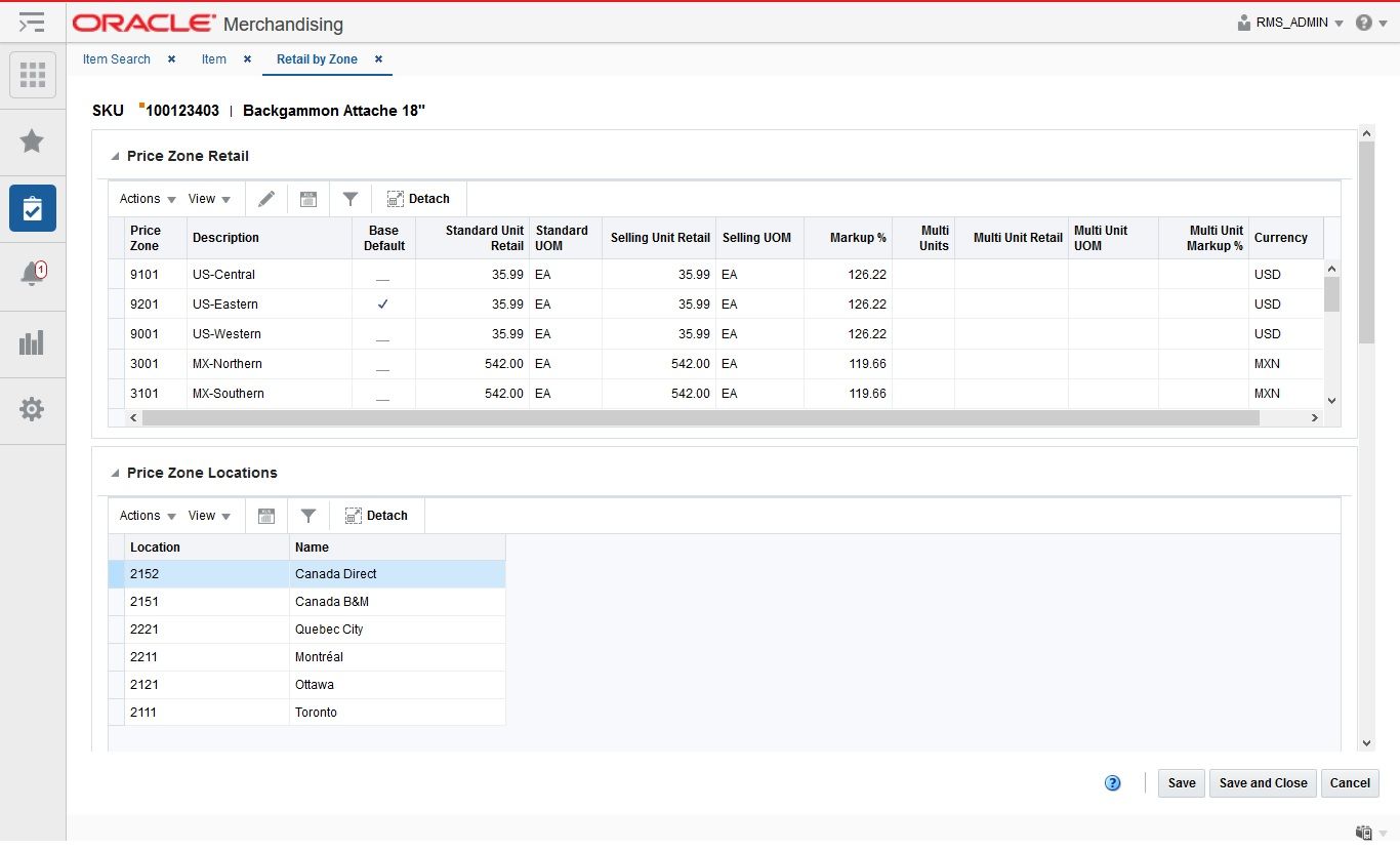

  12. Edit the retail price of the item.
    Select More Actions > Retail by Zone. The Retail by Zone page appears. For more information about this page, see the Define Initial Prices section.

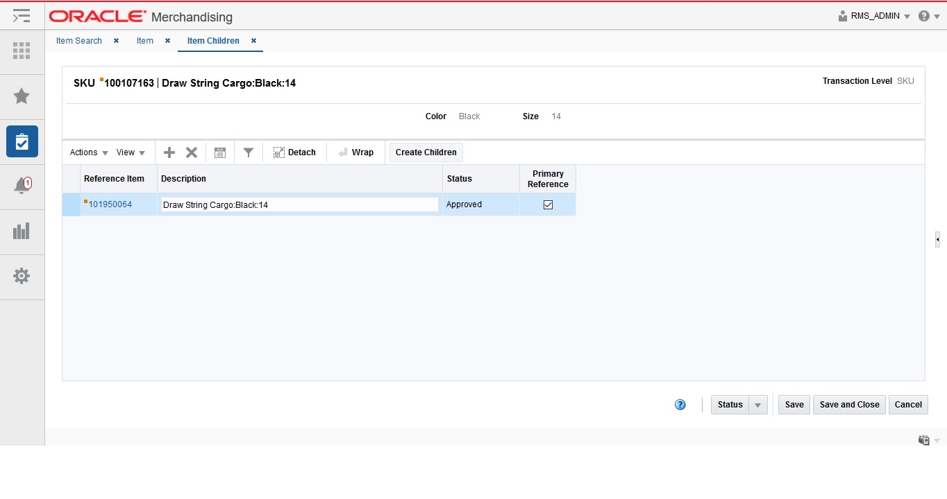

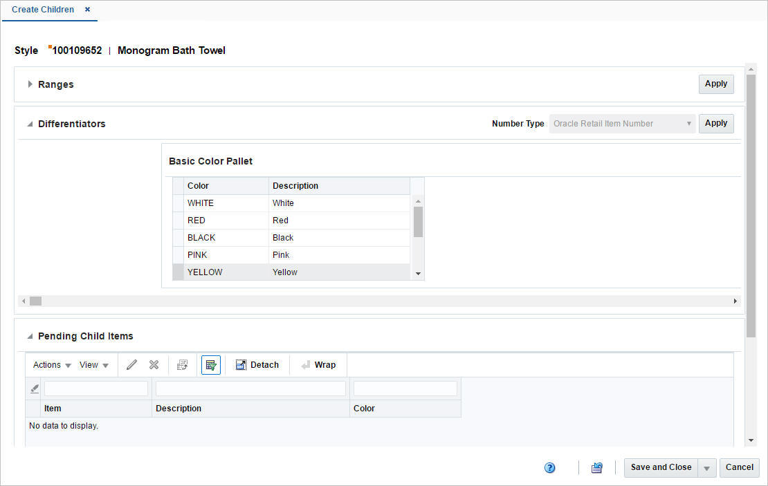

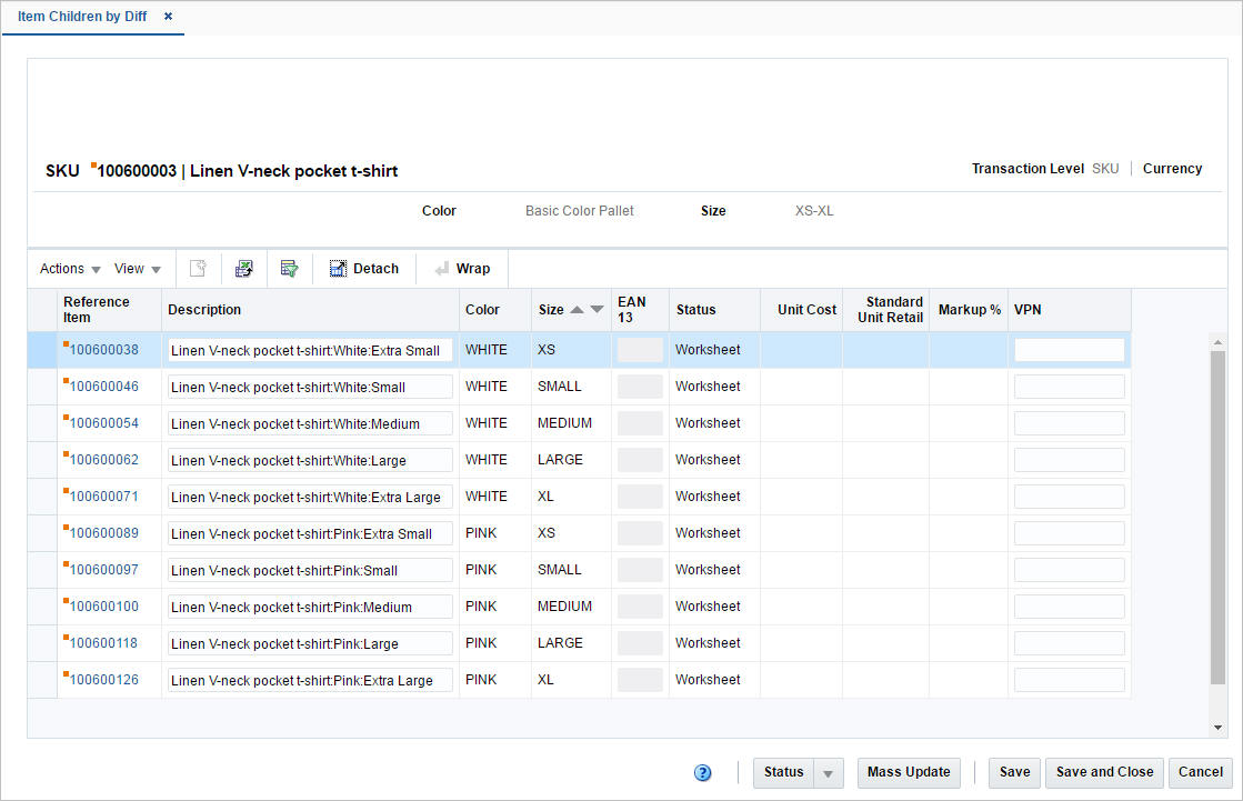

  13. Add child items to the item.
    In the Item page, click Create Children. The Item Children page appears. For more information about this option, see the Item Children section.

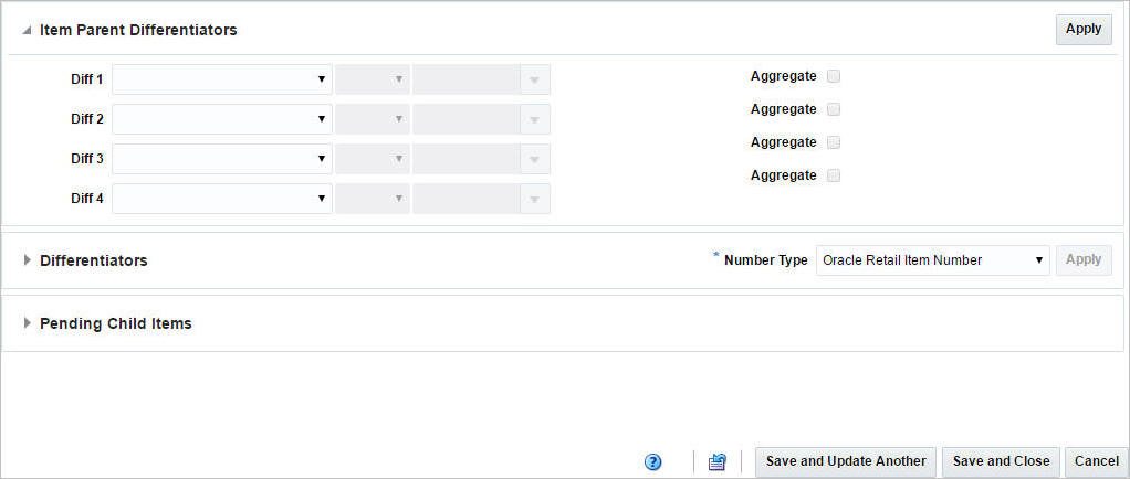

  11. Add the differentiators for the item.
    In the Differentiators section, add the diffs for the item. For more information about this section, see the Differentiators section.

  14. Add child items to the item.
    In the Item page, click Create Children. The Create Children page appears. For more information about this option, see the Create Children Page section.

Item Page
Once you fill in all the details in the Create Item page and click OK, the Item page appears.
The Item page includes the following sections:
Figure 1-2 Item Page
Item Main Page
Item Header
The Item Header includes the following fields:
Table 1-1 Item Header - Fields and Description
Fields Description
Title
The title displays the Item level (SKU/Style/Reference Item), Item ID, and Item Description with a separator between them to the extreme left of the Item page. The type of item and item status is displayed with a separator between them to the extreme right of the Item page. The item number is populated by default.
Item Status
The description of the item status is displayed as text. When you create an item, the status is Worksheet.
The following fields are populated by default: Style, SKU, Department, Class, Subclass, Transaction Level, Unit Retail, Unit ELC, Markup %, Currency, Sellable, Orderable, Inventoried.
Descriptions
Figure 1-3 Descriptions
Descriptions section
This section contains a Translate icon in the top right corner. You can create a translation by using the Translate icon Translate icon.
The Descriptions section includes the following fields:
Table 1-2 Descriptions - Fields and Description
Fields Description
Description
Enter the description of the item.
This field is a required field.
Short
Enter the short description of the item.
Secondary
Enter the alternate description of an item. This field can be used to enter the item description used by the supplier.
Number Type
This field is displayed by default.
Pack
Figure 1-4 Pack
Pack section
The label of the Pack section varies, depending on whether you create a Simple Pack or a Complex Pack.
The top right corner of the section contains the Pack Details icon. If you click the icon, the Pack Item Details page appears. For more information about this page, see the Pack Item Detail section.
The pack section includes the following fields:
Table 1-3 Pack - Fields and Description
Fields Description
Type
For complex packs, select the pack type from the list. Possible types are Buyer Pack or Vendor Pack.
For simple pack the field defaults to Vendor Pack.

Cost and Price
Figure 1-5 Cost and Price
The Cost and Price section includes the following fields:
Table 1-4 Cost and Price - Fields and Description
Fields Description
Cost Zone Groups
Enter the cost zone group ID, or search for and select the cost zone group.
Suggested Retail
Enter the suggested retail price.
Selling Unit Retail
Enter the new retail price.
Selling UOM
Enter the Selling UOM as necessary.

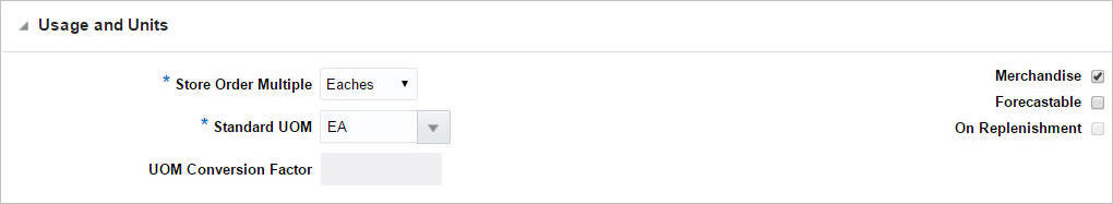

Usage and Units
Figure 1-6 Usage and Units
Usage and Units section
The Usage and Units section includes the following fields:
Table 1-5 Usage and Units - Fields and Description
Fields Description
Store Order Multiple
The unit of measure by which items are shipped to stores.
The store order multiple may be each, inner, or case. The default store order multiple is set up at the item level. Store order multiples for specific locations are set up at the item/location level. Select the Store Order Multiple from the list.
Standard UOM
Enter the standard UOM, or search for and select the standard UOM.
UOM Conversion Factor
This factor will be used to convert sales and stock data when an item is retailed in eaches and does not have eaches as its standard unit of measure.
Merchandise
If the item is merchandised, select the Merchandise check box.
Forecastable
If the item is forecasted, select the Forecastable check box.
On Replenishment
This indicates if the item is put on replenishment.

Differentiators
A differentiator (diff) is a characteristic that can be used to make items distinct from one another. You can add levels to an item group if you identify a set of diffs or diff groups. Each unique diff or unique combination of diffs creates a new level in the item group. If you choose not to use diffs, you can manually create item levels.
Once you have selected the diffs, you can create all of the items for that item level through Merchandising.
Figure 1-8 Differentiators
The Differentiators section includes the following fields.
Table 1-7 Differentiators - Fields and Description
Fields Description
Diff 1-4
Select the Diff 1 from the list.
You can select up to four diffs by clicking the Add icon Add icon. You can delete the diffs by clicking the Delete icon Delete icon.
Group/ID
Select the group or ID from the list.
Diff Value
Select the diff value, or enter, search and select.
Item Aggregate checkbox
This checkbox is only enabled for diff groups.
  • If you select the Item Aggregate checkbox, the Aggregate checkbox is added to the diff group rows.
  • The Aggregate checkbox to aggregate inventory and sales for the item.

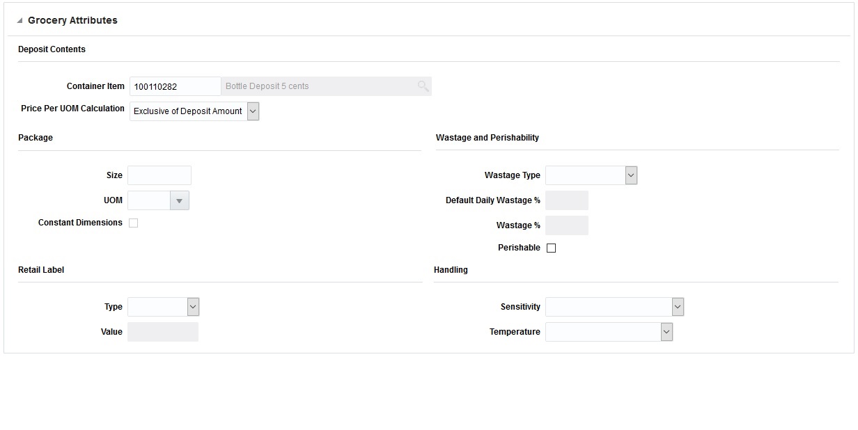

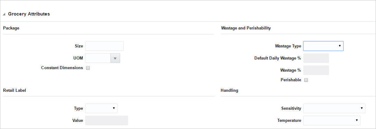

Grocery Attributes
Figure 1-9 Grocery Attributes
Grocery Attributes section
This section is only displayed, if you have the required privilege. The Grocery Attributes section includes the following fields:
Table 1-8 Grocery Attributes - Sections and Description
Sections Description
Deposit Contents area
Only available, if you create a deposit content item. You have to associate a container item to the deposit content item, in this area.
  • In the Container Item field, enter or search for the container item.
  • In the Price Per UOM Calculation field, select the appropriate option from the list.
Package area
  • In the Size field, enter the package size.
  • Enter the unit of measure for a retail package of the current item in the UOM field, or search and select from the UOM list.
  • Select the Constant Dimensions check box to indicate that the dimensions of the product are always the same, regardless of the supplier.
Wastage and Perishability area
  • In the Wastage Type field, select the type of wastage.
  • In the Default Daily Wastage % field, enter the average percentage of spoilage an item is subject to on a daily basis.
  • In the Wastage % field, enter the average percentage of waste an item is subject to over its shelf life.
  • Select the Perishable check box to indicate if the item has short shelf life like fruits, vegetables, bakery items and so on
Retail Label area
  • In the Type field, select the type of retail label applied to the package. In the Value field enter the value associated with the retail label type.
  • In the Value field enter the value associated with the retail label type.
Handling area
  • In the Sensitivity field, select the type of sensitivity from the list.
  • In the Temperature list, select the type of temperature from the list.
Deposit Container area
Only available, if you create a deposit container item.
The table lists the content items associated to the deposit container item.

Item - More Actions Menu
The More Actions menu contains the options listed in the table below.
Figure 1-10 More Actions Menu of Item Page
Table 1-9 More Actions Menu - Buttons and Description
Action Buttons Description
Checkmark icon Checkmark icon
The checkmark icon indicates that data has already been entered for this option.
Required icon Required Not Entered icon
This icon indicates that data is required, but has not been entered.
Suppliers
Opens the Item Supplier page.
Retails by Zone
Opens the Retail by Zones page.

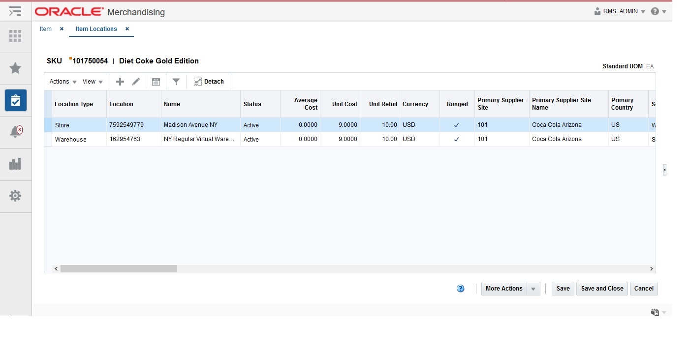

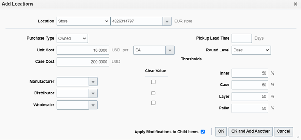

Locations
Opens the Item Locations page.
For more information about this page, see the Item Locations section.

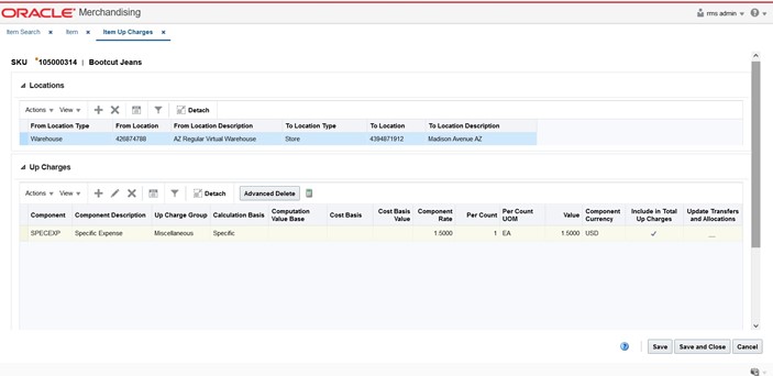

Item Up Charges
Opens the Item Up Charges page.
For more information about this page, see the Add Up Charges section.
List Children
Opens the Item Children/Item Children by Diff page.
For more information about this page, see the Item Children and With Diffs sections.

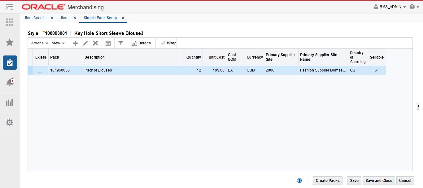

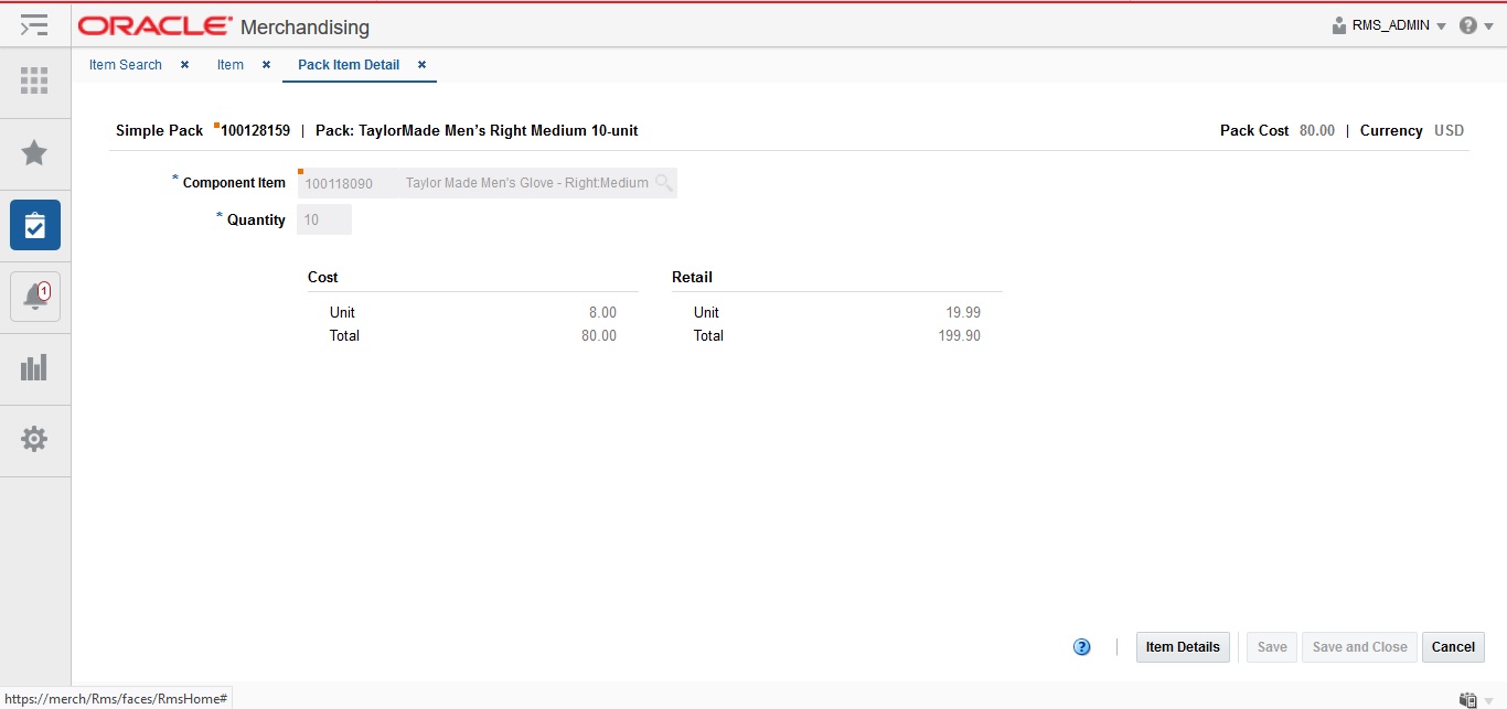

Simple Pack
Select one of the following options from the Simple Pack submenu:
  • Select Setup to open the Simple Pack Setup page.
    For more information about this page, see the Simple Pack Set Up section.
  • Select View to open the Simple Pack page.
    For more information about this page, see the Viewing Pack Items section.
Transformation
Opens the Item Transformation page.
For more information about this page, see the Item Transformation section.
Replenishment
Opens the Manage Replenishment Attributes page.
For more information about this page, see Managing Attributes at the Item Level in the Oracle® Retail Merchandising Replenishment User Guide.

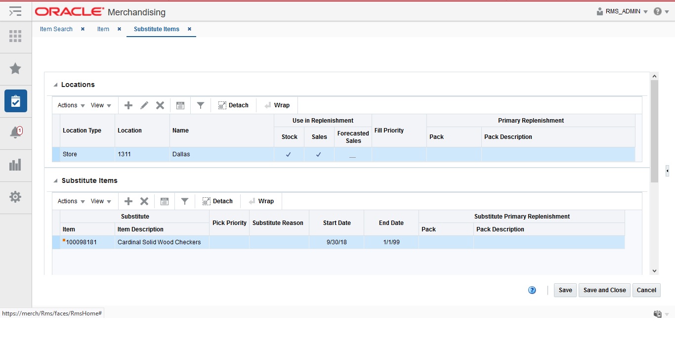

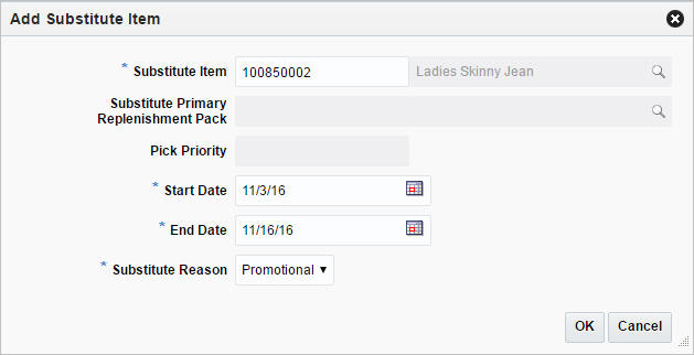

Substitute Items
Opens the Substitute Items page.
For more information about this page, see the Define Substitute Items section.

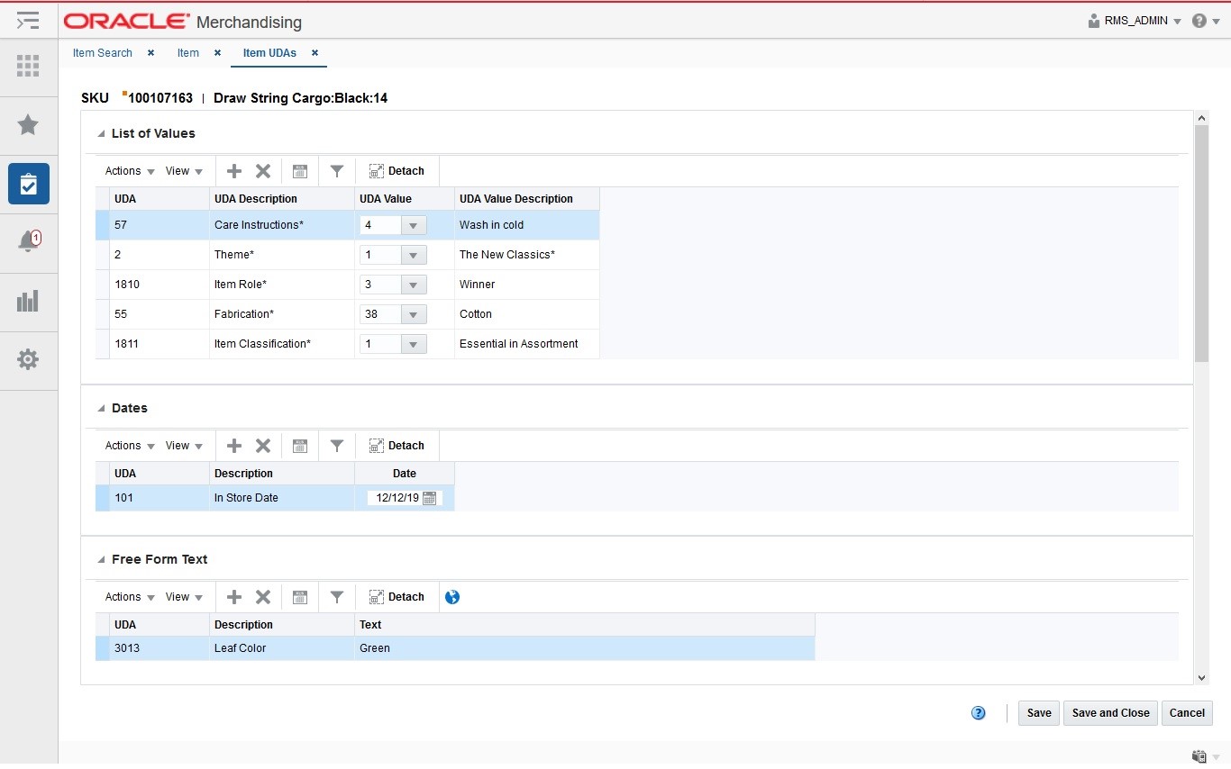

User Defined Attributes
Opens the Item UDAs page.
For more information about this page, see the Manage Item Lists chapter, section "Update User Defined Attributes".

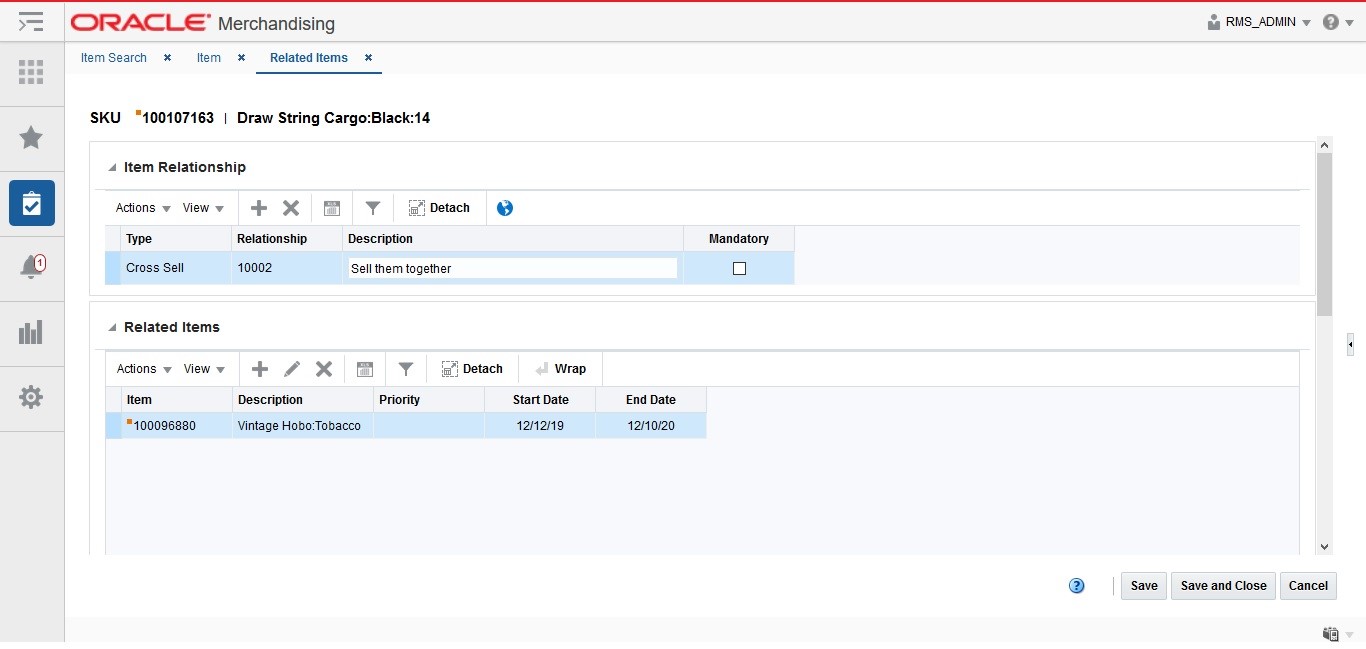

Related Items
Opens the Related Items page.
For more information about this page, see the Add Related Selling Items section.
Import
Select one of the following options from the Import submenu:
  • Attributes
    Opens the Item Import Attributes page.
    For more information about this page, see the Define Import Attributes section.

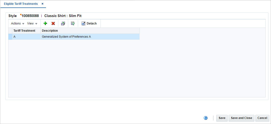

  • Eligible Tariff Treatments
    Opens the Eligible Tariff Treatments page.
    For more information about this page, see the Eligible Tariff Treatments section.
  • HTS
    Opens the Item HTS page.
    For more information about this page, see the Item HTS section.
Timelines
Opens the Timelines page.
Required Documents
Opens the Required Documents page.
For more information about this page, see the Required Documents section in the Oracle® Retail Merchandising Purchase Orders and Contracts User Guide.
VAT Maintenance
Opens the Item VAT page.
For more information about this page, see the Define VAT Rates section.

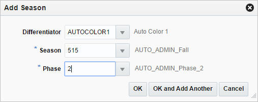

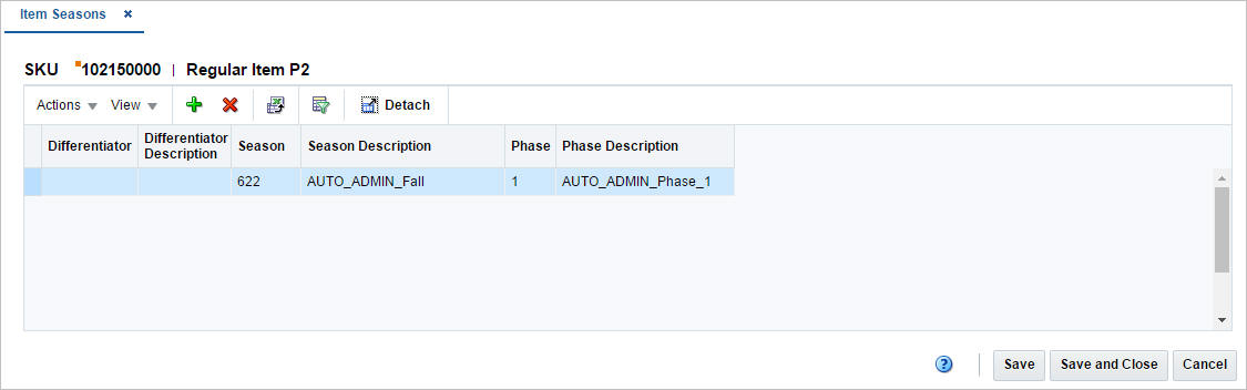

Season/Phases
Opens the Item Seasons page.
For more information about this page, see the Add Seasons and Phases section.
Ticket Type
Opens the Item Tickets page.
For more information about this page, see the Add Tickets section.

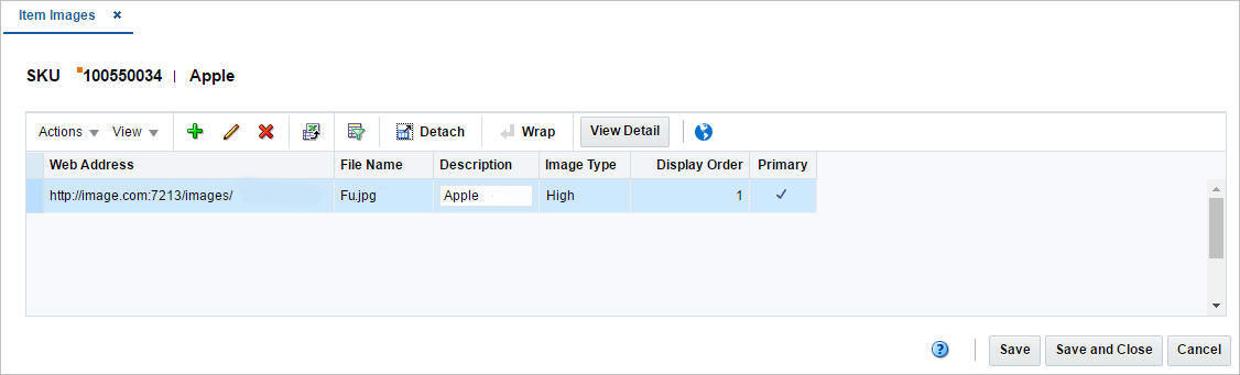

Opens the Item Images page.
For more information about this page, see the Add Images section.
  2. In the Type field, select the deposit item you want to create from the list. Possible options are:
    • Deposit Container: The item for which the deposit is taken. The deposit container item holds the deposit contents item.
    • Deposit Contents: The item that is sold to the customer.
    • Deposit Crate: The item which holds the container and contents items.
    • Deposit Returned Item: The item that is returned to the retailer by the customer and for which the deposit is returned to the customer.
  3. The necessary item type indicators for the selected deposit item are selected by default.
    • Sellable: When selected, indicates that the item is sold and is sent to the POS.
    • Orderable: When selected, the item can be ordered, set up on replenishment, and can have HTS and expenses set up.
    • Inventoried: When selected, indicates that the inventory is tracked and held in Merchandising.
  4. In the Department, Class, and Subclass fields, enter, select or search for the IDs of the merchandise hierarchy.
  5. In the Transaction Level field, select transaction level 1, 2 or 3.
  6. In the Number Type field, select the type of item number that you want to associate with the item.
    If you select Oracle Retail Item Number or UPC-A in the Type field, the item number is automatically added. If you select EAN/UCC-13, you can automatically generate the EAN number by clicking Generate. If you select Manual, the description field accepts alphabetic text and does not validate digit, length, or characters. It is a 12-digit number starting with 3 that includes check digit validation.
  7. In the Description and Short field, enter a description for the item.
  8. Click OK. The Item page appears.

  10. In the Grocery Attributes section add the attributes as necessary.
    Figure 1-11 Grocery Attributes
    Grocery Attributes
    • If you create a deposit content item, you have to associate a deposit container item to the deposit content item.
    • Once associated, the deposit container item lists all associated deposit content items in the Deposit Container table.
      For more information about this section, see the Grocery Attributes section.

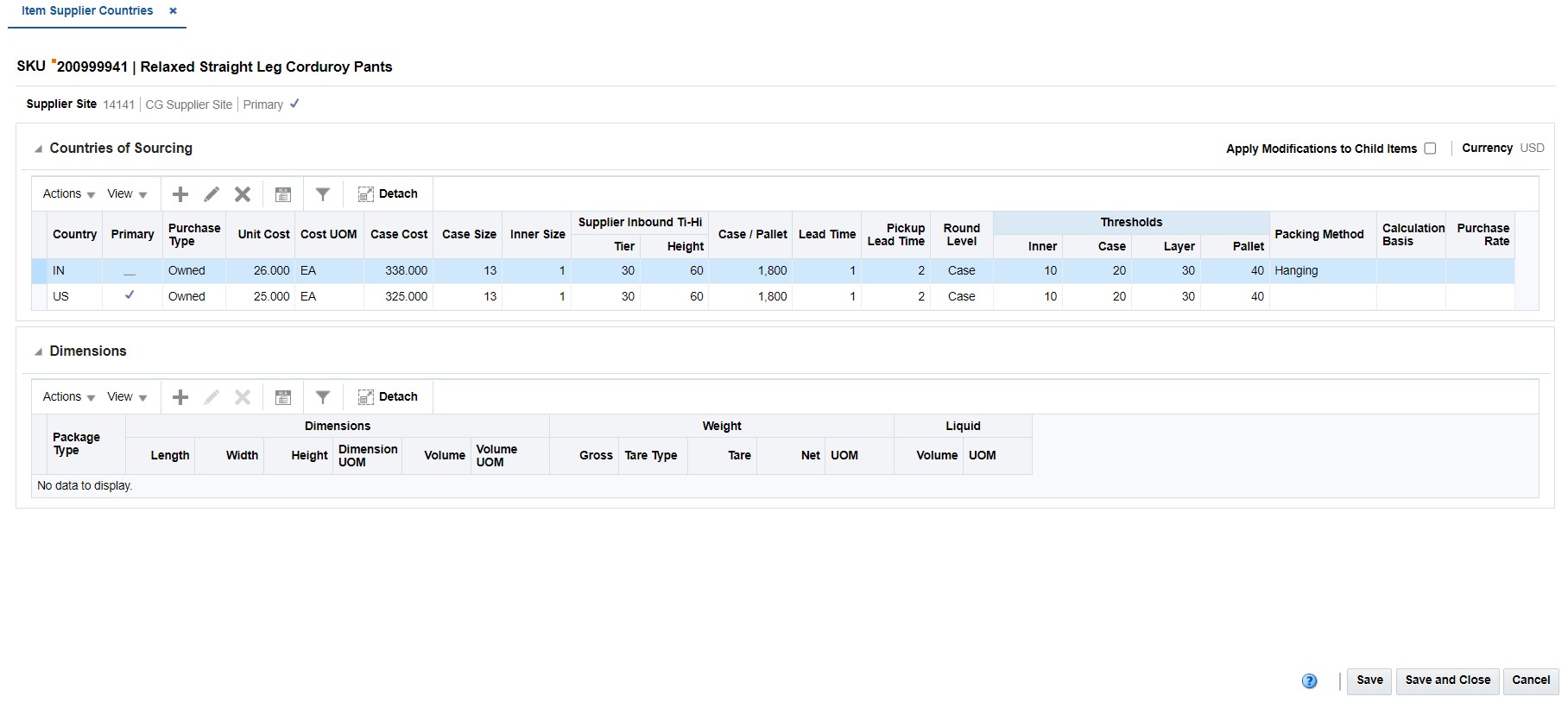

    In the Item page, select More Actions > Suppliers. The Item Supplier page appears. For more information about this page, see the Add Suppliers section
    In the Item page, select More Actions > Retail by Zone. The Retail by Zone page appears. For more information about this page, see the Define Initial Prices section.
  10. In the Attributes section, enter, select or search for the attributes as necessary. For more information about attributes, see the Attributes section.
  11. In the Grocery Attributes section add the attributes as necessary. For more information about this section, see the Grocery Attributes section.
  12. Add a supplier and a sourcing country for the item.
    If you are creating a transformed sellable item, you will not be able to select the Supplier option from the More Actions menu.

  14. Add child items to the item if necessary.
    In the Item page, click Create Children. For more information about this option, see the Create Children Page section or the Item Children section.

  5. Select More Actions > Transformation. The Item Transformation page appears.

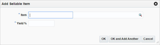

To add sellable items, follow the steps listed below.
  1. In the Sellable Items section, select Actions > Add, or use the Add icon Add icon. The Add Sellable Item page appears.
    Figure 1-13 Add Sellable Item Page
    Add Sellable Item window
  2. In the Item field, enter or search for the sellable item that is created from the orderable item.
  3. In the Yield % field, enter percentage of the orderable item used to create the sellable item.
    The Total Yield % field must equal 100% for the orderable item. The Total Yield % field is calculated by adding the Yield % and the Production Loss % field.
  4. Then choose one of the following options.
    • Click OK to add the current sellable item to the table.
    • Click OK and Add Another to add additional sellable items.
    • Click Cancel to reject all entries and close the page.

Simple Pack Set Up
In the Simple Pack Set Up page you can create and view simple packs that contain the selected component item. A simple pack is a sellable and/or orderable vendor pack with multiples of only one item number as the component item.
When creating a simple pack for a component item, the following information needs to be provided:
  • Type of number, pack number, and pack description
  • Number of units of the component item that make up the pack
  • Primary supplier and country of sourcing for the pack
  • Unit cost of the pack
  • Number of packs in a case, cases on a tier, and tiers on a pallet
  • Base retail price of the pack if it is sellable as a pack
In addition you can define the dimensions, weights, and volumes of cases and pallets. After defining the attributes of the pack, you can choose to copy other details from the component item. The details may include suppliers, stores, warehouses, seasons, user defined attributes, ticketing, required documents, sales taxes, HTS numbers, and expenses.
Figure 1-14 Simple Pack Setup Page
Table
In the table you can create and maintain the packs for the component item.
Creating a Simple Pack from an Existing Item
To create a simple pack from an existing item, follow the steps below.
  1. From the Tasks menu, select Items > Manage Items. The Item Search page appears.
  2. Search for the item that will be the component of the simple pack.
  3. Click Search. The item is displayed in the Results section.
  4. In the Item column, click the item link, or mark a record and select Actions > Edit, or use the Edit icon Edit icon. The Item page appears.
  5. Then select More Actions > Simple Pack > Setup. The Simple Pack Setup page appears.

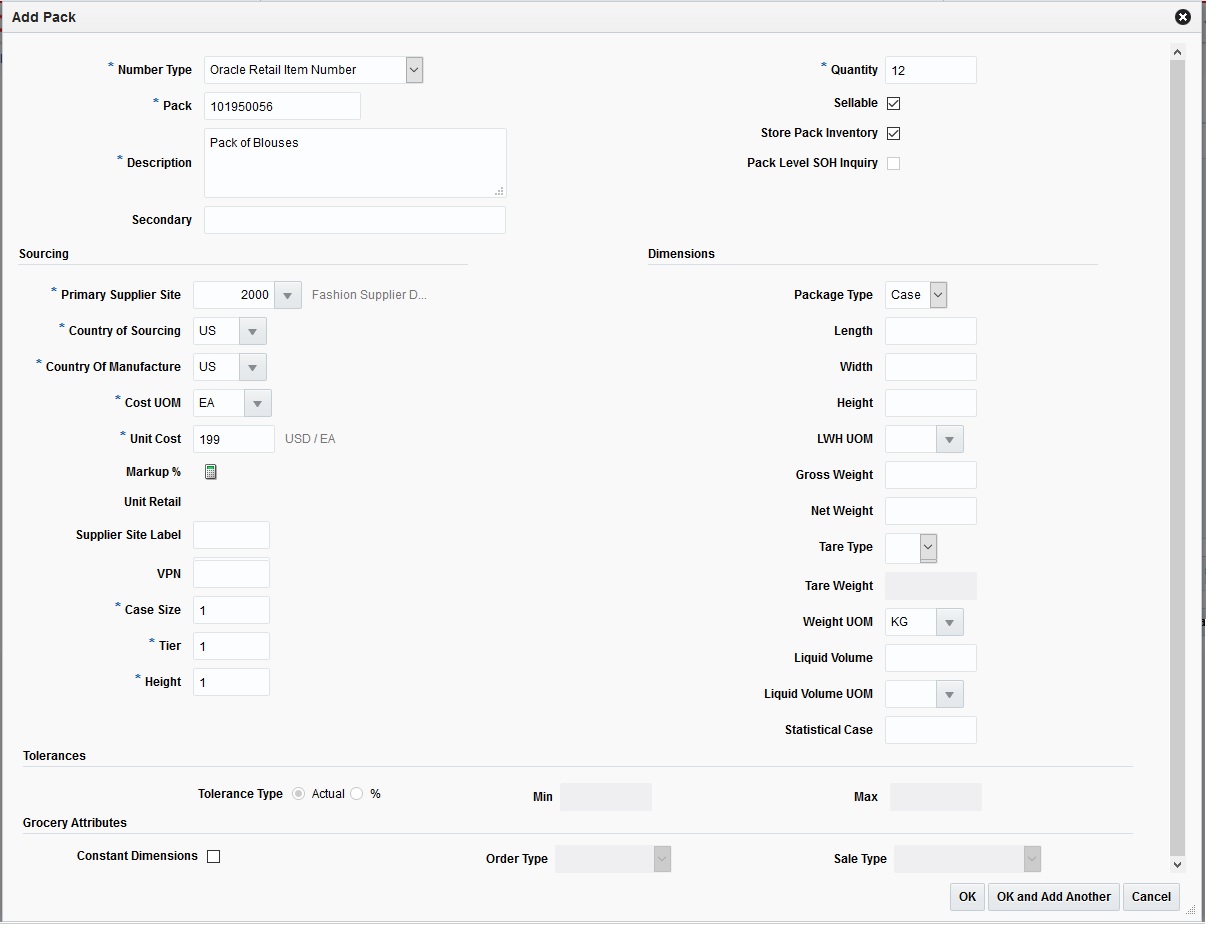

  1. In the table, select Actions > Add, or use the Add icon. The Add Pack page appears.
    Figure 1-15 Add Pack Page
    Add Pack Page
  2. In the Number Type field, select the type of item number that you want to associate with the pack item. This field is a required field.
  3. In the Pack field, enter the pack number of the pack item. This field is a required field.
    If you select Oracle Retail Item Number or UPC-A in the Item Type field, the item number is automatically added. It is a 12-digit number starting with 3 that includes check digit validation.
  4. In the Description field, enter a description for the pack item. This field is a required field.
  5. In the Secondary field, specify the alternate name of the item.
  6. In the Quantity field, specify the number of component items of the pack. This field is a required field.
  7. If you select the Sellable checkbox, the item can be sold and sent to the POS.
  8. The Store Pack Inventory checkbox indicates whether inventory will be tracked at the pack level in SIM for stores.
  9. The Pack Level SOH Inquiry is used by SIM to determine how to reflect SOH for pack items in the store.
  10. The NIC is static checkbox indicates if the Negotiated Item Cost (NIC) is static or not.
  11. In the Sourcing section enter the following information:
    1. In the Primary Supplier Site field, enter, select or search for the primary supplier site. This field is a required field.
    2. In the Country of Sourcing field, enter, select or search for the code for the country. This field is a required field.
    3. In the Country of Manufacture field, enter, select or search for the country. this field is a required field.
    4. In the Cost UOM field, enter, select or search for the unit of measure. This field is a required field.
    5. In the Unit Cost field, enter the cost of the item in the indicated currency. This field is a required field.
    6. The Markup % field displays the percentage the price marked up, based on the supplier's cost.
    7. The Unit Retail field is displayed by default.
    8. The Supplier Site Label field is defined to describe the label or brand for the item supplied by the supplier.
    9. In the VPN field, specify the vendor product number.
    10. In the Case Size field, enter the case size. This field is a required field.
    11. In the Tier field, enter the tier. This field is a required field.
    12. In the Height field, enter the height. This field is a required field.
  12. In the Dimensions section, enter the necessary information about the simple pack.
  13. In the Tolerance section, the following fields are available.
    1. Tolerance Type: This is the unit of the tolerances for catch weight simple packs. The valid values are A (actual) and % (percentage).
    2. Min: This is the minimum tolerance value for the Catch Weight simple pack.
    3. Max: This is the maximum tolerance value for the Catch Weight simple pack.
  14. In the Grocery Attributes section, the following fields are available.
    The Catch Weight and Tolerance areas are enabled only if you select Catch Weight in the Attributes area of the Item page.
    1. Select the Constant Dimensions checkbox, if the pack dimensions are fixed.
    2. The Order Type field gets enabled only for Catch Weight pack.
    3. The Sale Type field gets enabled only for Catch Weight pack.
  15. Then choose one of the following options.
    • Click OK to add the current pack to the table
    • Click OK and Add Another to add additional packs.

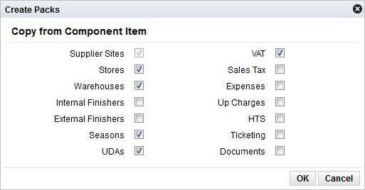

Creating Packs
To create packs follow, follow the steps listed below.
  1. In the toolbar, select Create Packs. The Create Packs page appears.
    Figure 1-16 Create Packs Page
    Create Packs window
  2. Select which details you want to copy from the component item to the simple pack.
  3. Then choose one of the following options.
    • Click OK to add the simple pack to the table. The Exists checkbox is automatically selected and the selected component details are copied to the simple pack.
      When you click Create Packs, component details are copied to the new simple packs. If simple packs already exist, their details are not updated.

Viewing Pack Items
To view pack item, follow the steps below.
  2. Search for and retrieve a simple pack item.
    Figure 1-17 Pack Item Detail - Simple Pack
  2. In the Type field, select simple pack from the list.
  3. The necessary item type indicators are selected by default. If necessary, select the Catch Weight checkbox.
  5. The Transaction Level field, defaults to level 1.
  10. In the Complex Pack section, select the pack type from the list and select the necessary checkboxes.
    For more information about this Complex Pack section, see the Pack section.

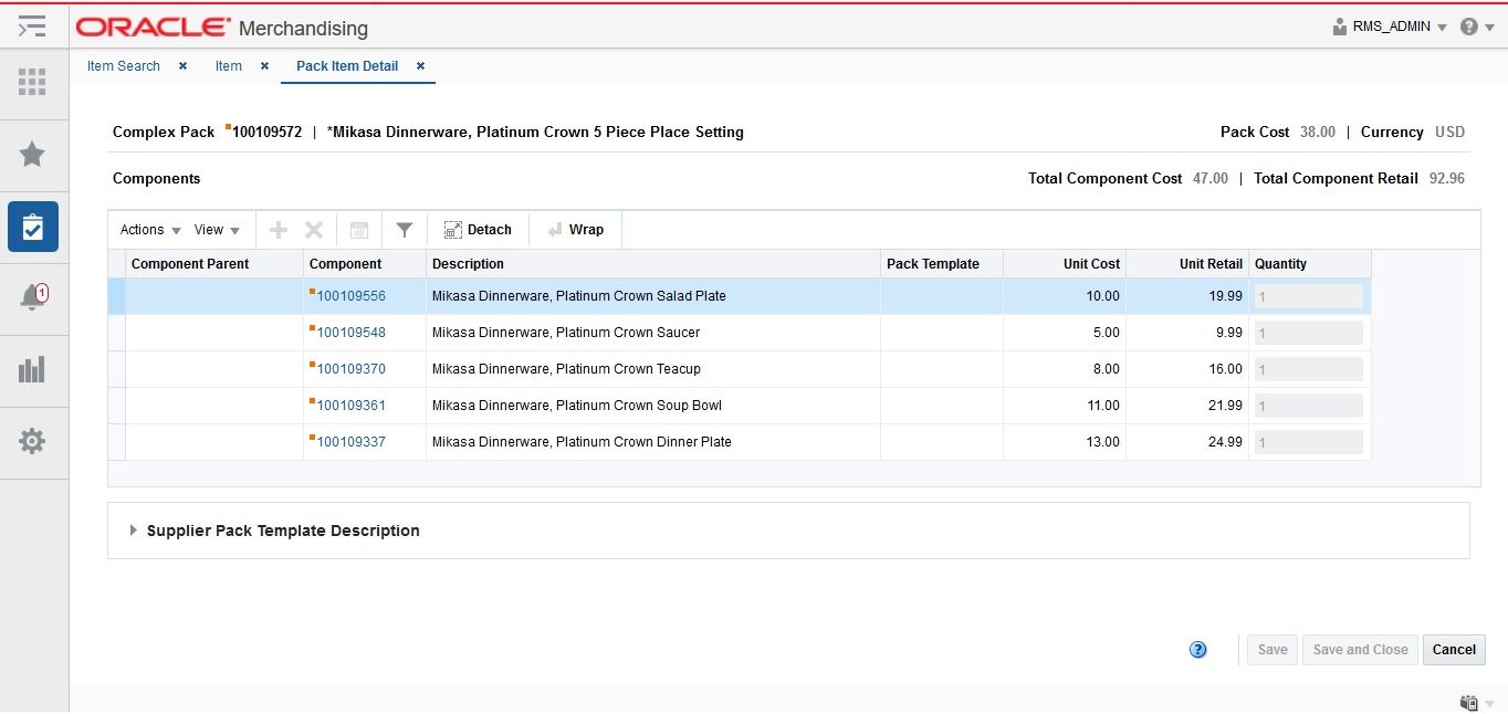

    In the Complex Pack section, click the Pack Details icon. The Pack Item Detail page appears. For more information about the Pack Item Detail page, see the Pack Item Detail section.
  14. Edit the retail price of the item.

Pack Item Detail
In the Pack Item Detail page you can add, edit, delete and view the component items of a pack item. A complex pack may be composed of multiple units of multiple items. A simple pack may be composed of multiple units of one item.
There are some restrictions depending on the how you define the purpose of the pack:
Orderable pack: You cannot add, delete, or edit the component items if the pack is already on order or stocked at any location.
Sellable pack: You cannot add, delete, or edit the component items after the pack item is priced.
The Pack Item Details page varies depending whether you maintain a complex or simple pack.
Simple Pack:
  • Header
    The header displays the label Simple Pack, the pack number and description. The right hand side displays the Pack Cost and Currency.
  • Component
    In this section you can search for a component item. You can add only component item in case of simple packs.
    • In the Component Item field, enter, select or search for the component item.
    • In the Quantity field, enter the quantity for the component item.
    • The Cost and Retail section displays the Unit and Total fields. These fields are populated when you enter the item.
Complex Pack:
Figure 1-18 Pack Item Detail - Complex Pack
Components
The Components section displays a table which contains all the component items that are part of the complex pack. The title displays the Total Component Cost and Total Component Retail in the in right hand corner.
You can edit the Quantity column of the component item directly in the table.
Supplier Pack Template Description
If the pack item is associated with a pack template the table in the Supplier Pack Template Description expands. You can add more suppliers and descriptions in addition to the pack supplier in this section.
You can edit the Pack Template Description column directly in the table.

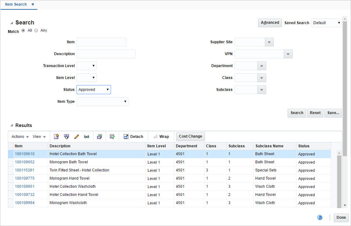

  2. Enter or select search criteria as desired to make the search more restrictive.
  3. Restrict your search to the item type Simple Pack or Complex Pack in Worksheet status.
  4. Click Search. The items that match the search criteria are displayed in the Results section.
  5. In the item column, click the item link, or mark a record and select Actions > Edit, or use the Edit icon Edit icon. The Item page appears.
  6. In the Simple/Complex Pack section, select the Pack Item Details icon Pack Item Details icon. The Pack Item Details page appears.

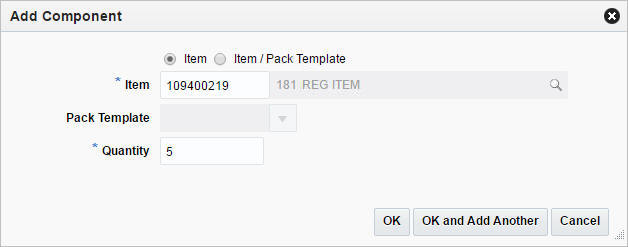

  1. In the Components section, select Actions > Add, or use the Add icon Add icon. The Add Component page appears.
    Figure 1-19 Add Component Page
    Add Component window
  2. Select if you want to add an item or an item/pack template.
  3. In the Item field, enter or search for an item. This field is a required field.
  4. In the Pack Template field, enter, select or search for the template. Only enabled if you select item/pack template.
  5. In the Quantity field, enter the quantity for the component item.
  6. Then choose one of the following options.
    • Click OK to add the component to the table.
    • Click OK and Add Another to add additional components.

  5. Select More Actions > Suppliers. The Item Suppliers page appears.

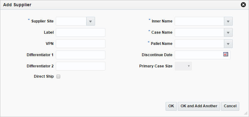

  1. In the Item Suppliers page, select Actions > Add, or use the Add icon Add icon. The Add Supplier page appears.
    Figure 1-21 Add Supplier Page
    Add Supplier window
    1. In the Supplier Site field, enter, select or search for the supplier site. This field is a required field.
    2. In the Label field, enter the supplier label for the item.
    3. In the VPN field, enter the vendor product number.
    4. In the Differentiator fields, enter the diff values, if applicable.
    5. Select the Direct Ship checkbox, if direct shipments from the supplier to the customer are permitted.
    6. The Inner Name, Case Name and Pallet Name fields, are defaulted to the name used by the supplier to refer to the inner, the case and the pallet. These fields are required fields.
    7. In the Discontinue Date field, enter the date at which the supplier discontinues the item or use the Calendar icon to select the discontinue date.
    8. In the Primary Case Size field, select the primary case size from the list.
      This field is only enabled, if the Advanced Inventory Planning application is used.
    9. Select the Apply Modifications to Child Items checkbox, to update the child items.
    10. Then choose one of the following options.
      The first supplier added to the item, is marked as the primary supplier by default. You can change the primary supplier for the item, after you have added additional suppliers.
      For more information about how to change the primary supplier for an item, see the Editing Item Suppliers section.
      • Click OK to save the supplier for the item and close the page.
      • Click OK and Add Another to add additional suppliers for the item.
To edit item suppliers, follow the steps below.
  1. In the Items Supplier page, select a record in the table.
  2. Then select Actions > Edit, or use the Edit icon Edit icon. The Edit Supplier page appears.
    Figure 1-22 Edit Supplier Page
    Edit Supplier window
  3. Edit the fields, as necessary.
    If you want to define the current supplier as the primary supplier for the item, select the Primary option.
    • Click OK to save your changes and close the page.

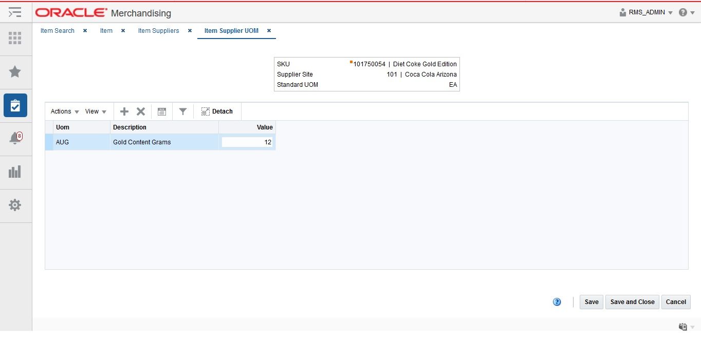

Item Supplier Countries
The Item Supplier Countries page allows you to add, edit, and view the sourcing countries that are associated with an item supplier combination. You can define a Purchase type that captures the Ownership model agreed upon with the supplier for the specific Item-sourcing country combination. Three types of Ownership models are supported namely Owned Merchandise, Consignment and Concession. Consignment and Concession ownership models can be selectively enabled through system option configuration Based on the ownership model you can enter the costs or costing method negotiated with the supplier. Additionally you can maintain location defaults, ordering, case, and packaging information
You can view all countries associated to the item in the table of the Country of Sourcing section. For each country up to four dimension records can be created.
The Item Supplier Countries page contains the following sections.
  • Header
    Depending on the item you have selected, the label of the header varies. The label displays Item Level (SKU/Style/ Reference Item), the item number and item description. Additionally, the header contains the supplier site number and name and indicates whether or not the selected supplier is the primary supplier for the item.
  • Country of Sourcing
  • Dimensions
Figure 1-23 Item Supplier Countries Page
Figure 1-24 Item Supplier - Add Country
Country of Sourcing
The Country of Sourcing section displays the following columns by default.
  • Country
  • Primary
  • Purchase Type
  • Unit Cost
  • Cost UOM (Unit of Measure)
  • Case Cost
  • Case Size
  • Supplier Inbound Tier - Height
  • Case/Pallet
  • Lead Time
  • Pickup Lead Time
  • Round Level
  • Thresholds
  • Packing Method
If the selected item is a parent item, the Apply Modifications to Child Item checkbox is displayed in the right hand corner of this section. Select to checkbox to indicate that the changes are also applied for the child items.

Adding a Country of Sourcing for a Supplier of an Item
To add a new country of sourcing for an supplier of an item, follow the steps below.
  1. In the Countries of Sourcing section select Actions > Add, or use the Add icon Add icon. The Add Country page appears.
    1. In the Country of Sourcing field, enter, select or search for the country.
    2. If you want to define the current supplier as the primary supplier for the item, select the Primary option.
    3. Select the Purchase Type to be associated with the item supplier country combination.
      Valid values of Purchase type are Owned, Consignment and Concession. Consignment and Concession purchase types will be available for selection only if the functionality is selected in system options.
    4. Several fields in the Packaging, Sourcing, Rounding and Tolerances sections default to the suppliers default information. Edit the information as necessary.
    5. Enter the Unit Cost and Case Cost of the Item.
      If the Purchase type is Consignment or Concession item costing can be entered based on either Cost per Unit or Purchase Rate %.
    6. If the selected item is a parent item, the Apply Modifications to Child Item checkbox is displayed. Select to checkbox to indicate that the changes are also applied for the child items.
    7. Then choose one of the following options.
      • Click OK to add the country of sourcing for the supplier and close the page.
      • Click OK and Add Another to add additional countries of sourcing for suppliers.
        The Purchase Type and Costing details captured on an Item Supplier Country record will be used as a default unless location specific exceptions are defined in Item Supplier Country Location.

Viewing an Item Supplier Country List
The Item Supplier Country List page allows you o view the supplier and sourcing country relationships for an item.
To view an item supplier country list, follow the steps below.
  3. Click Search. The items that match the search criteria are displayed in the Results section.
  4. In the Item column, click the item link, or mark a record and select Actions > Edit or View or use the corresponding icons. The Item page appears.
  6. In the toolbar, click Supplier Country List. The Item Supplier Country List page appears.
The Item Supplier Country List page contains the following sections.
  • Header
    The header of the page displays Item Level (SKU/Style/ Reference Item), the item number and item description.
    Figure 1-25 Item Supplier Country List
    Item Supplier Country List window
  • Table
    The table displays supplier site and country of sourcing information.
Item Supplier Country Locations

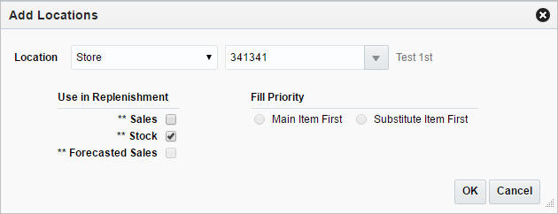

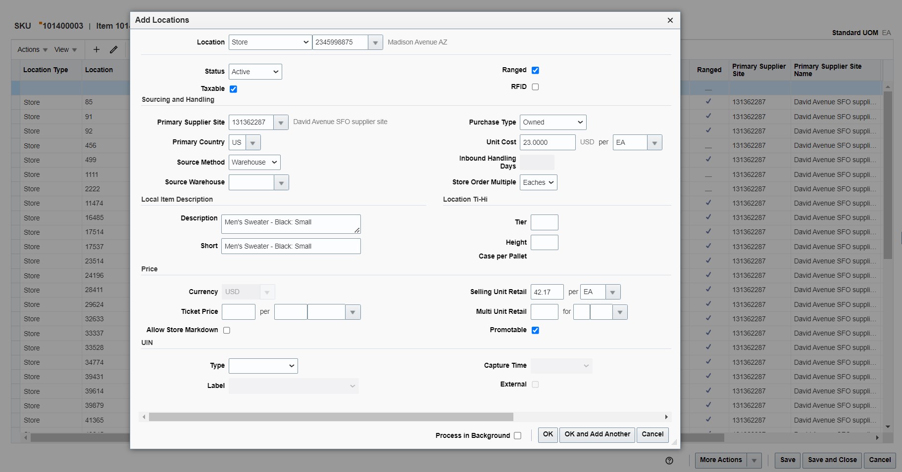

Adding an Item Supplier Country Location Record
To add a new Item supplier Country location exception, follow the steps below.
  1. In the Locations section select Actions > Add, or use the Add icon add icon. The Add Locations page appears.
    Figure 1-27 Add Locations Pop-up
  2. In the Location field, select the Location Type and select or enter the location.
  3. The Purchase Type is defaulted from the Supplier Country of sourcing. Edit this information as necessary. A SKU level item in the Worksheet status will have this field enabled to let you define a value at this level which could be different from the related Style level item.
  4. The Cost defaults from the Supplier Country of sourcing. Edit this information as necessary.
    If the Purchase Type is consignment /concession, then the Calculation basis and the cost or Purchase Rate needs to be specified
  5. The Rounding Thresholds and Lead times default to the values from the Supplier Country of Sourcing. Edit the information as necessary.

Add Supplier Units of Measure
In the Item Supplier UOM page you can add, delete, and view miscellaneous units of measure (UOM) for an item/supplier combination. You must enter a factor that can be used to convert the unit of measure to the standard unit of measure. In this page you can overwrite the unit of measure for all subordinate level items that are supplied by the supplier of the selected item.
The Item Supplier UOM page contains the following sections.
  • Header
    The header displays the item, the supplier site as well as the standard unit of measure.
Figure 1-29 Item Supplier UOM
Item Supplier UOM
Detail
The table displays the following columns by default.
  • Unit of measure (UOM)
  • Description
  • Value
    You can enter the value of the unit of measure directly in the table.
Maintaining Units of Measure for a Supplier
To maintain units of measure for a supplier, follow the steps below.
    The item should be in Worksheet, Submitted, or Approved Status.
  6. In the Item Suppliers page, select Actions > UOM. The Item Supplier UOM page appears.
Adding a Unit of Measure for a Supplier of an Item
To add a new unit of measure for an supplier, follow the steps below.
  1. In table, select Actions > Add, or use the Add icon Add icon. The Add UOM appears.
    1. In the UOM field, enter, select or search for the unit of measure.
    2. In the Value field, enter a value of the UOM.
      • Click OK to add the unit of measure and close the page.
      • Click OK and Add Another to add additional UOMs for the supplier.

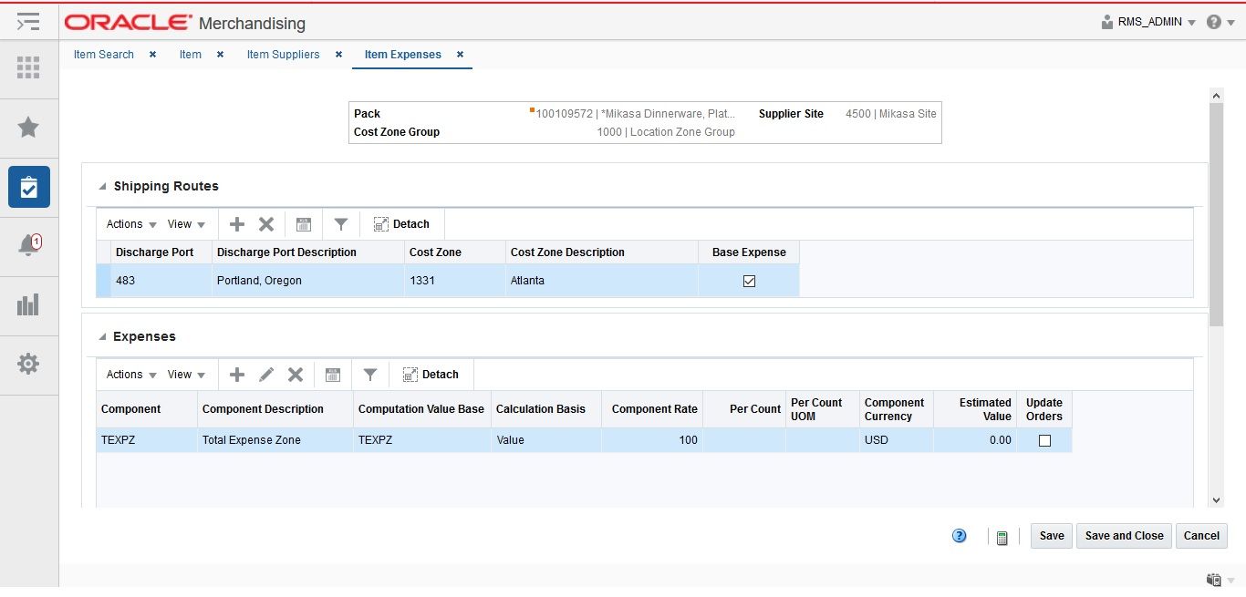

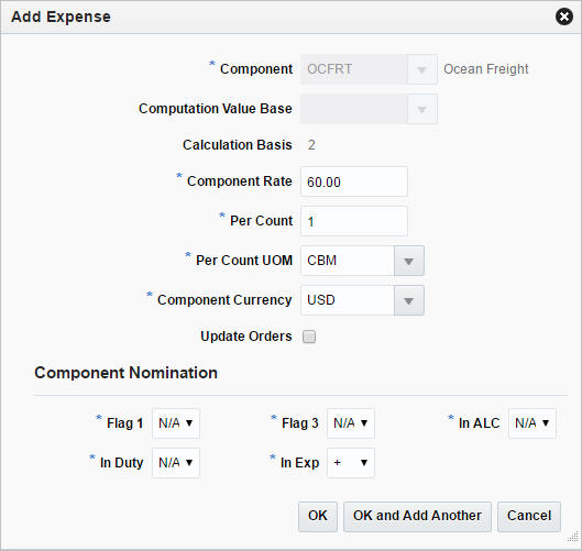

Add Country and Zone Expenses
The Item Expense page allows you to view and maintain shipping routes and importing and exporting expenses associated with an item and shipping route. Expenses are tracked at the following two levels:
  • Country:
    Country-level expenses track the costs of importing merchandise from the country of sourcing, through the lading port, to the discharge port.
  • Zone:
    Zone-level expenses track the costs of sending merchandise from the discharge port to the final destination. This screen can be accessed from Item Suppliers and Item Supplier Country screen.
The Item Expenses page contains the following sections.
  • Header
    When you access the Item Expenses page from Item Supplier page, the header displays the item, supplier site and cost zone group.
    When you access the Item Expense page from Item Supplier Country page, the header displays the item, the supplier site and the country of sourcing.
  • Shipping Routes
  • Expenses
Figure 1-30 Item Expenses Page
Item Expenses Page
Shipping Routes
When you access the Item Expenses page from Item Supplier page, the Shipping ping Rout table displays the following columns by default: Discharge Port, Discharge Port Description, Cost Zone, Cost Zone Description and Base Expense.
Whereas when access the Item Expenses page from Item Supplier Country page, the Shipping Route table displays the following columns by default: Lading Port, Lading Port Description, Discharge Port, Discharge Port Description and Base Expense.
Base Expense:
The Base Expense option indicates whether or not this set of expenses is also the base set of expenses. You can select the Base Expense option directly in the table.
Expenses
The Expenses section displays the following columns by default:
  • Component
  • Component Description
  • Computation Value Base
  • Calculation Basis
  • Component Rate
  • Per Count
  • Per Count Unit of Measure
  • Component Currency
  • Estimated Value
  • Update Orders
Maintaining Item Expenses
To maintain item expenses, follow the steps below.
Access from the Item Supplier page.
  • In the Item Suppliers page, select Actions > Expenses. The Item Expenses page appears.
Access from the Item Supplier Countries page:
  • In the Item Suppliers page, select Actions > Countries of Sourcing, or use the Countries of Sourcing button. The Item Supplier Countries page appears.
  • In the Countries of Sourcing section, select Actions > Expenses. The Item Expenses page appears.
Adding a Shipping Route
To add a new shipping route for an item, follow the steps below.
  1. In the Shipping Route section select Actions > Add, or use the Add icon Add icon. The Add Shipping Route page appears.
  2. When accessed from the Item Supplier page:
    1. In the Discharge Port field, enter, select or search for the discharge port.
    2. In the Cost Zone field, enter, select or search for the cost zone.
    3. The Base Expense option indicates whether or not this set of expenses is also the base set of expenses. Select the Base Expense option, if necessary.
  3. When accessed from the Item Supplier Countries page.
    1. In the Lading Port field, enter, select or search for the lading port.

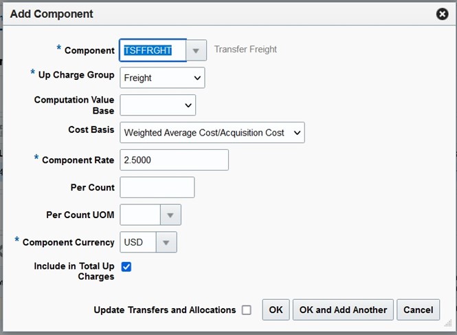

Adding Expenses
To associated expenses with an item and shipping route, follow the steps below.
  1. In the Expenses section, select Actions > Add, or use the Add icon Add icon. The Add Expense page appears.
    Figure 1-31 Add Expense Page
    Add Expense window
    1. In the Component field, enter, select or search for the expense component.
    2. The following fields default to the expense defaults. Edit the information as necessary.
      • Calculation Basis
      • Component Rate
      • Per Count
      • Update Orders
      Required fields are marked with an asterisk.
    3. In the Component Nomination section, edit the fields, if necessary.
      • Click OK to add the expense for the item/shipping route and close the page.
      • Click OK and Add Another to add additional expenses for the item/ shipping route.
Editing Expenses
To edit expenses for an item/shipping route, follow the steps below.
  1. In the Expenses section, select a record in the table.
  2. Then select Actions > Edit, or use the Edit icon Edit icon. The Edit Expense page appears.
In the Retail by Zone page you can view and/or edit the initial retail price that is calculated by zone during the creation of a new item(s). The price zone retail is calculated based on the markup percent defined for the departments primary zone group. Retail values are calculated and displayed for all zones within a departments primary zone group. Locations tied to a zone are displayed in the Price Zone Locations section. You can edit the retail value as necessary prior to submitting or approving the item. Once an item is approved this screen is disabled, future retail price changes are done via the RPM system.
The Retail by Cost Zone page contains the following sections.
Figure 1-32 Retail by Zone Page
Retail by Zone Page
Price Zone Retail
The Price Zone Retail section displays all zones tied to the primary zone group designated for the merchandise hierarchy of the created item(s).
The, Price Zone Locations displays all of the locations tied to a zone that is highlighted in the Price Zone Retail section.
Editing a Retail Price of an Item by Zones
To edit a retail price of an item by zone(s), follow the steps below.
  2. Restrict your search to items in Worksheet status.
  5. Select More Actions > Retail by Zone. The Retail by Zone page appears.
  6. In the Price Zone Retail section, select one or more records in the table.
  7. Then select Actions > Edit, or use the Edit icon Edit icon. The Edit Zone Retail page appears.
  8. The price zone information of the selected record is displayed. Edit the fields, as necessary.
    If you have selected more than one price zone. The Price Zone field shows Multiple. Update the Markup % and the multi-units fields as necessary.
    1. In the Selling Unit Retail field, enter the new retail price. Then select the selling unit of measure.
    2. In the Markup % field, enter the percentage the price is marked up, based on the supplier's cost.
    3. Update the appropriate multi-units field as necessary.
  9. Then choose one of the following options.
    • Click OK and Edit Another to edit additional price zones.

Maintaining Item Locations
To maintain item locations, follow the steps below.
Access from the Item page:
  • Select More Actions > Locations. The Item Locations page appears.
Adding Locations
To add a new location for an item, follow the steps below.
  1. In the Item Locations page, select Actions > Add, or use the Add icon Add icon. The Add Locations page appears.
    Figure 1-34 Add Locations Page
    Add Locations Page
  2. In the Location field, select the location type from the list. Then choose the location.
  3. The system displays the information of the selected location.
  4. Add the information at the item location level that is different at the location than at the item level.
    Edit the displayed information in the following sections:
    1. Status of the Item
    2. Sourcing and Handling information
      • Primary Supplier Site – Enter or select a primary supplier site for the location if it's different from the one specified at the item level.
      • Primary Country – Enter or select a primary country for the location if it's different from the one specified at the item level.
      • Purchase Type – This field is available only when consignment/concession functionality is used in the system. Select a value to specify ownership type of item if it's different from what's defined at the item supplier country level. A SKU level item can have a different purchase type compared to the style item.
      • Calculation Basis – Only available when purchase type is consignment or concession. Specifies if the costing of the item will be based on per unit cost or a purchase rate.
      • Specify unit cost or purchase rate depending on the calculation basis specified.
      • Source Method – Select if the default source method for the location will be supplier or warehouse.
      • Source Warehouse – Default source warehouse for the location.
      • Store Order Multiples – Specify the multiple in which item needs to be shipped from a warehouse to the location.
      • The Ranged checkbox determines if the location is ranged intentionally for replenishment/selling or incidentally ranged by the Merchandising transaction when the item is not ranged to a specific location on the transaction.
      • Inbound Handling Days – Specify inbound handling days for warehouses.
    3. Location Item Description
    4. Tier - Height information
    5. Costing information
      Edit the information for the pack and the unit.
    6. Type of the Unique Identification Number Type (UIN)
      • In the Type field, select the UIN type from the list. This number is used to identify the instance of the item at the location.
      • In the Label field, select the UIN label from the list. This number will be displayed in SIM.
  5. If the selected item is a parent item, the Apply Modifications to Child Items checkbox is displayed. The checkbox indicates whether or not the updates are also applied to the child item. The checkbox is selected by default.
  6. The Process In Background checkbox determines if the ranging of items to the selected locations happens immediately or the ranging is submitted in the background.
    This checkbox must be checked if the list of locations ranged is big, so that you do not have to wait for the ranging to complete. Submitting the ranging to background disables this page and the Item page goes into View mode.
    You can check Asynchronous Job Log for status of the ranging happening in background.
    • Click OK to add the location for the item and close the page.
    • Click OK and Add Another to add additional locations for item.

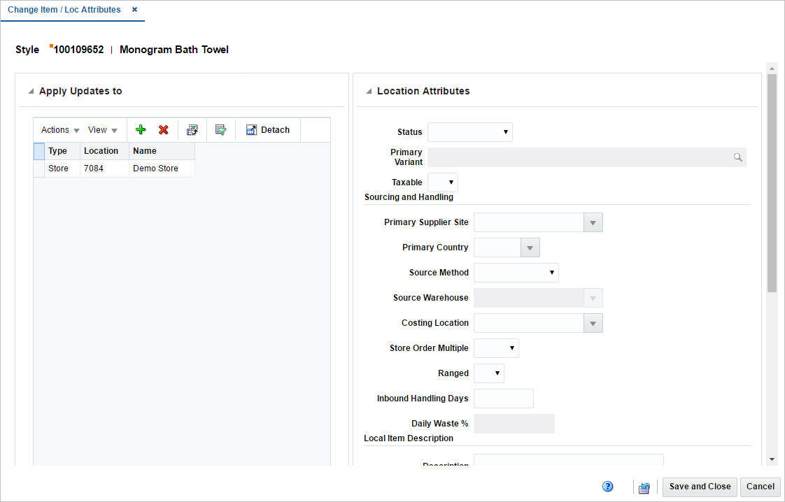

Item Location Traits
The Item Location Traits page is used to define and maintain item attributes at a single location or at multiple locations. Some of these attributes are downloaded at the Point of Service (POS) or a ticketing system, while others are entered for information only and drive no processing.
The Item Location Traits page contains the following sections.
  • Header
    The header contains the item number and description.
  • Apply Updates To
    This section contains the following subsections:
    • Note:
      Only available if you selected the Mass Change > Locations Traits option in the Item Locations page.
    • Customer Order Attributes
    • Grocery Attributes
Figure 1-35 Item Location Traits Page
Table
In this table you can add and delete locations for the item attributes.

Create Child Items
Merchandising provides the option to define three possible levels of hierarchy for items. Names of these levels are configurable. Depending on the industry and type of items, number of levels is utilized while creating items. A child item is an item that exists below another item, called the parent item, in the item hierarchy.
For example, fashion retailers usually utilize all three levels of item hierarchy to represent the style, SKU, and barcode items. In this case, the style is considered the parent item, and the SKU, usually differentiated by color and size, is the child of the parent and the barcode is a child of the SKU. SKU level is generally designated as transaction level, or where inventory and sales are tracked.
Hardline and grocery retailers generally utilize only two levels of item hierarchy where first level is the SKU, or transaction level, and the level below represents one or more barcodes. In this case the SKU is the parent and the barcode is the child item.
Therefore, depending on the business requirements, child items can be created for transaction level items using differentiators, or without differentiators for sub-transaction level items, such as barcodes.
With Diffs
In the Item Children by Diff page you can edit child items created with differentiators, generate EAN13s or create grand children.
You can perform the following actions in this page.
  • Edit the description and other details of level 2 or level 3 items that were created with differentiators.
  • Generate EAN13s.
  • Create children of level 2 transaction level items.
The Item Children by Diff page contains the following sections.
  • Header
    The header displays the Item Level (SKU/Style/ Reference Item), the item number and the item description. Additionally the transaction level and the currency are displayed in the right hand corner. The differentiator groups/values associated with the parent item are displayed.
Figure 1-36 Item Children by Diff Page
Item Children by Diff window
Table
The table lists the child items. The item level description, description, EAN 13, status, unit cost, standard unit retail, markup % andVPN are displayed by default.
You can edit the Description, the EAN 13 and the VPN (Vendor Product Number) column directly in the table.
Maintain Item Children by Diff
To maintain item children, follow the steps listed below.
  4. In the item column, click the item link, or mark a record and select Actions > Edit, or use the Edit icon Edit icon. The Item page appears.
  5. Click More Actions > List Children. The Item Children by Diff page appears.
Mass Update
To perform a mass update, follow the steps below.
  1. Click Mass Update. The Mass Update page appears.
    Figure 1-37 Mass Update Page
    Mass Update window
  2. The Supplier Site field is populated with the parent item's primary supplier and the Price Zone field is populated with the price zone group's base zone.
  3. In the Differentiator Group field, enter, select or search for a diff group.
  4. If a diff group is selected. The Differentiator field enables, enter, select or search for the appropriate diff.
  5. Select the Generate EAN 13 checkbox, to generate EAN 13 for the child items.
  6. In the Update Supplier Information section, enter the values as necessary.
    1. In the Unit Cost field, enter the unit cost, if necessary.

Item Children
The Item Children page is used to create a subset of items from an item that is already entered into Merchandising. In this screen, you can perform the following actions:
  • Edit level 2 or level 3 items that were created without differentiators.
  • Edit the description of items at level 2 or level 3 of an item group.
  • Use the Actions menu to edit details for the selected level 2 or level 3 item.
The Item Children page contains the following sections.
  • Header
    The header displays the Item Level (SKU/Style/ Reference Item),, item number and the item description. Additionally the transaction level is displayed in the right hand corner. If the parent item has differentiators associated, all differentiators are displayed.
Figure 1-38 Item Children Page
Item Children Page
Table
The table lists the child items. The columns Reference Item, Description, Status and Primary Reference Item are displayed.
You can edit the Description column directly in the table.
  5. Click More Actions > List Children. The Item Children page appears.
