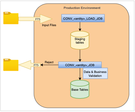

The diagram below shows, at a high level, how the conversion schema is set up in relation to your production environment.
Conversion Diagram
Loading to Staging Tables
The conversion load jobs load the data from input files into the conversion staging tables in the production environment. There is a load job created in POM for each entity supported for the data conversion through the production conversion API. There are no input parameters required for running these jobs.
The common tables that are available for monitoring and troubleshooting any errors reported during data loading to staging tables are described below:

Loading to Merchandising Main Tables
The conversion job invokes data checks & business validations to ensure the correctness of data being migrated. The records that are successfully validated will be moved to the main Merchandising tables. The job picks up the process IDs where the status in the CONV_PROCESS_TRACKER table is END_IMPORT or END_VALIDATE. There are no input parameters required for running this job. The job also invokes the rejection process, which generates the reject files for any errors and moves them to the OUT directory, so that you can manually correct them and reload the records to trigger a fresh file upload against that data. There is a conversion job created in POM for each entity supported for the data conversion through the production conversion API.
The common conversion tables that are available for monitoring and troubleshooting any errors reported during data validation and upload to the main tables are described below:

Conversion Process Flow
At a high level, for each entity you wish to convert using the conversion APIs in the production environment, you need to perform the following steps:
  1. Place the conversion zip file into the object storage incoming prefix.
  2. Run the CONV_<entity>_LOAD_JOB batch process using the Process Orchestration and Monitoring (POM). The batch moves the input files from the object storage to an inbound directory for data processing and loading into the conversion staging tables. There is separate load job for each conversion entity. For example, the CONV_PARTNER_LOAD_JOB_ADHOC job loads the partner data in the related staging table.
  3. The above batch process will insert a record with a unique process ID into the CONV_PROCESS_TRACKER table. You can monitor the load processing by querying this table using the Merchandising APEX Data Viewer link. The status END_IMPORT in the table indicates that load was successful. If there are errors during the data load into the staging tables, then the status is recorded as FAILED_IMPORT.
  4. In case of errors during the data loading into the staging tables, to debug and troubleshoot the load errors, query the FILE_UPLOAD_STATUS and FILE_UPLOAD_LOG tables. These tables will provide the details of the files loaded and corresponding load errors.
  5. Run the CONV_<entity >_JOB batch process using the Process Orchestration and Monitoring (POM). This job will perform data and business validation on the imported data in the conversion staging tables and upload the successfully validated records to the main Merchandising tables based on the entity being loaded. For example, the CONV_PARTNER_JOB_ADHOC job validates and uploads the partner data to relevant Merchandising tables.
  6. After running step 5, the status in the CONV_PROCESS_TRACKER table - COMPLETE_NO_REJECTS indicates a successful load into the Merchandising tables and COMPLETE_WITH_REJECTS indicates the process completed with some rejected records. The status END_VALIDATE in the CONV_PROCESS_TRACKER table is an intermediate status once the job in step 5 completes data validation and is in the process of business validation and loading to Merchandising tables.
  7. The successful records are inserted into the Merchandising main tables. Any rejected records are written to the CONV_VALIDATION_ERROR table. The reject file is generated and moved to the outgoing prefix in the object storage. You can download the file to view the errored data, make relevant corrections, and reprocess the rejects.
