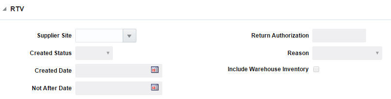

RTV |
Select the RTV. The RTV section appears. For more information on the RTV, see the Create with an RTV section. |
Create with an RTV
Once you select the RTV checkbox, the RTV section appears in the Mass Return Transfer page.
Figure 4-2 RTV
The RTV section includes the following fields.
Table 4-2 RTV - Fields and Description
Fields | Description |
Supplier Site |
Enter, select or search for the supplier site. |
Created Status |
Select the status the RTV will be created in. The options are: Input, Output, and Manual. |
Created Date |
Enter the date the RTV is created, or use the Calendar icon to select a date. |
Not After Date |
Enter the last date the transfer can occur, or use the Calendar icon and select a date. |
Return Authorization |
Enter the return authorization number of the supplier. |
Reason |
Select the reason you are creating the RTV. |
Include Warehouse Inventory |
Select this option to indicate warehouse inventory is included in the creation of the RTVs. |

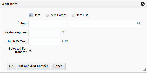

Add Items
The Items section displays item information such as the item number, item description, quantity and cost information.
To add items to a mass return transfer, follow the steps below.
In the Mass Return Transfer page, go to the Items section.
From the Actions menu, select Add or click the Add icon
. The Add Item pop-up appears.
Figure 4-3 Add Item Pop-up
Select any one of the following options: Item, Item Parent, or Item List.
In the Item field, enter the item or search and select from the list. This is a required field.
If you have selected Item Parent or Item List then you will have to enter, search or select Item Parent and Item List respectively to add items to MRT.
In the Restocking Fee % field, enter the percentage that is applied for restocking fees.
In the Unit RTV Cost field, enter the Unit RTV cost for the item
The Selected For Transfer checkbox is selected by default. This indicates whether the transfer for the item should be created when the MRT is approved or not.
Then choose one of the following option.
Click OK to add the item and close the page.
Click OK and Add Another to add additional items.
Click Cancel to reject all entries and close the page.

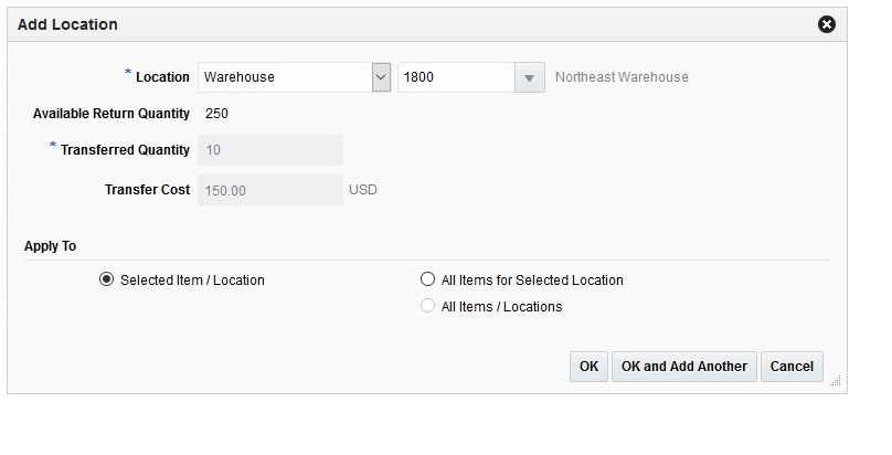

Add Locations
The Locations section allows you to indicate at which locations the transfer is effective.
Figure 4-4 MRT Add Locations Pop-up
To add the locations to the mass return transfer, follow the steps below.
In the Mass Return Transfer page, go to Locations section.
After entering the header details, select Actions > Add, or click the Add icon
. The Add Locations page appears.
Select the location type from the list. Then enter, select or search for the location.
The available return quantity is displayed.
In the Transfer Quantity field, enter the quantity you want to transfer.
In the Transfer Cost field defaults to the transfer cost associated to the location.
The Transfer Price field defaults to the transfer price associated to the location.
In the Apply to section, select if you want to apply the changes to the selected item/location, all items for selected locations or all item/locations.
Click OK to add the location and close the page.
Click OK and Add Another to add additional locations.

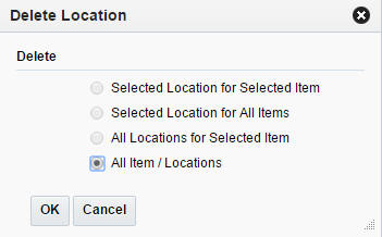

Advanced Delete
To select delete location options, follow the steps below.
From the Actions menu, click the Advanced Delete button.The Delete Location pop-up appears.
Figure 4-8 Delete Location Pop-up
You can delete any one of the following options:
Selected Location for Selected Item
Selected Location for All Items
All Locations for Selected Item
All Item/Locations
Then choose one of the following options.
Click OK to delete the locations.
Click Cancel to reject all entries an close the pop-up.
