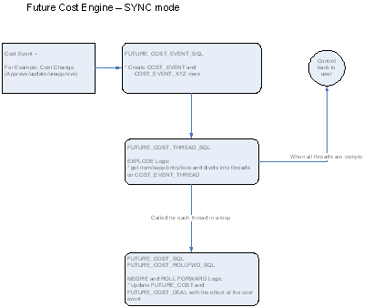

Synchronous
When running in synchronous mode, the Future Cost Engine is run in the same transaction as the client that calls it. For example if the cost change event is configured to run in synchronous mode, the work done in the Future Cost Engine for the approval of a cost change runs in the same transaction as the flipping of the status of the cost change to ‘A' status. That means the user in the screen will have a busy cursor until the Future Cost Engine completes.
Cost event types with an EVENT_RUN_TYPE set to ‘SYNC' on COST_EVENT_RUN_TYPE_CONFIG will run in synchronous mode.
Figure 9-1 Future Cost Engine - SYNC Mode

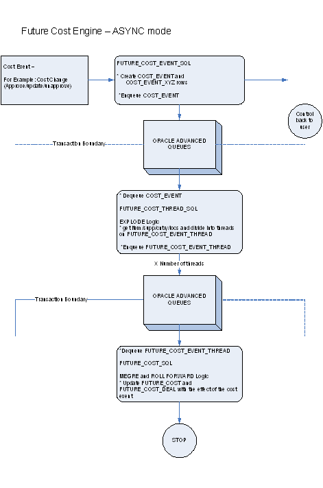

Asynchronous
When running in asynchronous mode, the Future Cost Engine is run in a separate transaction than the client that calls it. For example if the cost change event is configured to run in asynchronous mode, the work done in the Future Cost Engine for the approval of a cost change runs in a different transaction as the flipping of the status of the cost change to ‘A' status. This means that control returns to the user in the screen while the Future Cost Engine runs in the background.
Cost event types with an EVENT_RUN_TYPE set to ‘ASYNC' on COST_EVENT_RUN_TYPE_CONFIG runs in asynchronous mode.
Figure 9-2 Future Cost Engine - ASYNC Mode

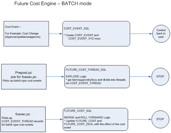

Batch
When running in batch mode, the Future Cost Engine is run during the nightly batch run. For example if the cost change event is configured to run in batch mode, the work done in the Future Cost Engine for the approval of a cost change runs during the next batch run after the approval of the cost change.
Cost event types with an EVENT_RUN_TYPE set to ‘BATCH' on COST_EVENT_RUN_TYPE_CONFIG runs in batch mode.
The fcexec.pc batch program and its associated prepost pre job contain logic to run the Future Cost Engine in batch mode.
Figure 9-3 Future Cost Engine - Batch Mode

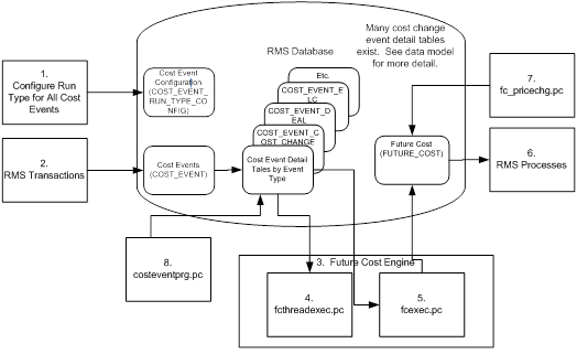

Future Cost Process
This process focuses on batch runs of the future cost engine.
Figure 9-4 Future Cost Process
Administrators configure the system (COST_EVENT_RUN_TYPE) to define which cost events types will be processed synchronously, asynchronously or in batch. Configuration by cost event type also determines some threading and chunking parameters.
Merchandising transactions that should drive future cost recalculation write Cost Events (COST_EVENT and cost event type specific tables).
Future Cost Engine recalculates future cost
This process flow focuses on batch recalculations, but synchronous or asynchronous processes could easily be substituted in this step.
fcthreadexec.pc prepares threads for processing
fcexec.pc recalculates future cost and writes it the future cost table (FUTURE_COST)
Merchandising processes use future cost information to determine investment buy, margin, and so on.
fc_pricechg.pc performs special calculation of pricing cost for franchise locations
costeventprg.pc purges aged cost events from the working cost event tables.
