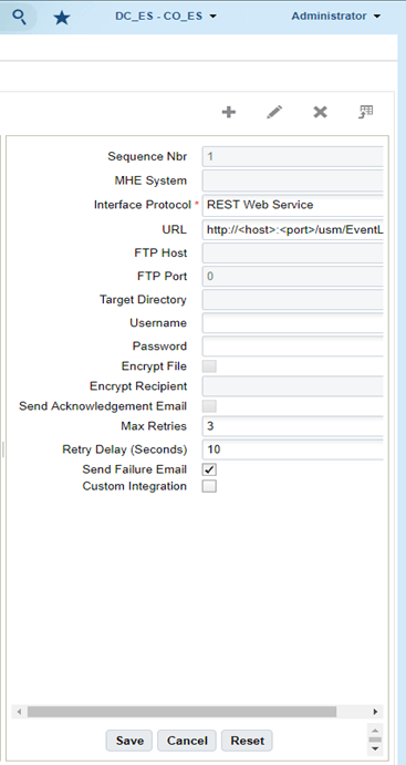

Configure Outbound Interfaces
Outbound interface configurations must be created in WMS Cloud for each facility, one for each of the following exports:
  • Inventory History
  • Outbound Loads
  • Outbound Manifest
Inventory History Export
The Inventory History export is used to communicate updates to receipts, for purchase orders, transfers and allocations, stock order status updates, and inventory adjustments. To configure this for export, set the interface format to XML on the Output Interface Configuration for Inventory History Export.
Although these exports require configuration in WMS, these are not customizable integrations. Only the activity codes described in this section are supported in the base integration.
Next, create three targets for Inventory History Export, using the appropriate host and port for your implementation in the URL definition. The target creation can be done in the WMS Cloud application under the Output Interface Configuration tab.
Figure 5-1 Output Interface Configuration
Target 1: Receipts
URL: http://<host>:<port>/usm/EventListener.do?app=rib-lgf&family=Receiving&type=ReceiptMod

For ALL of the targets listed above, include the following:
  • Interface Protocol = REST Web Service
  • Username = <username for your XXX account>
  • Password = <password for your XXX account>
If the account password expires or is changed, it needs to be changed here as well.

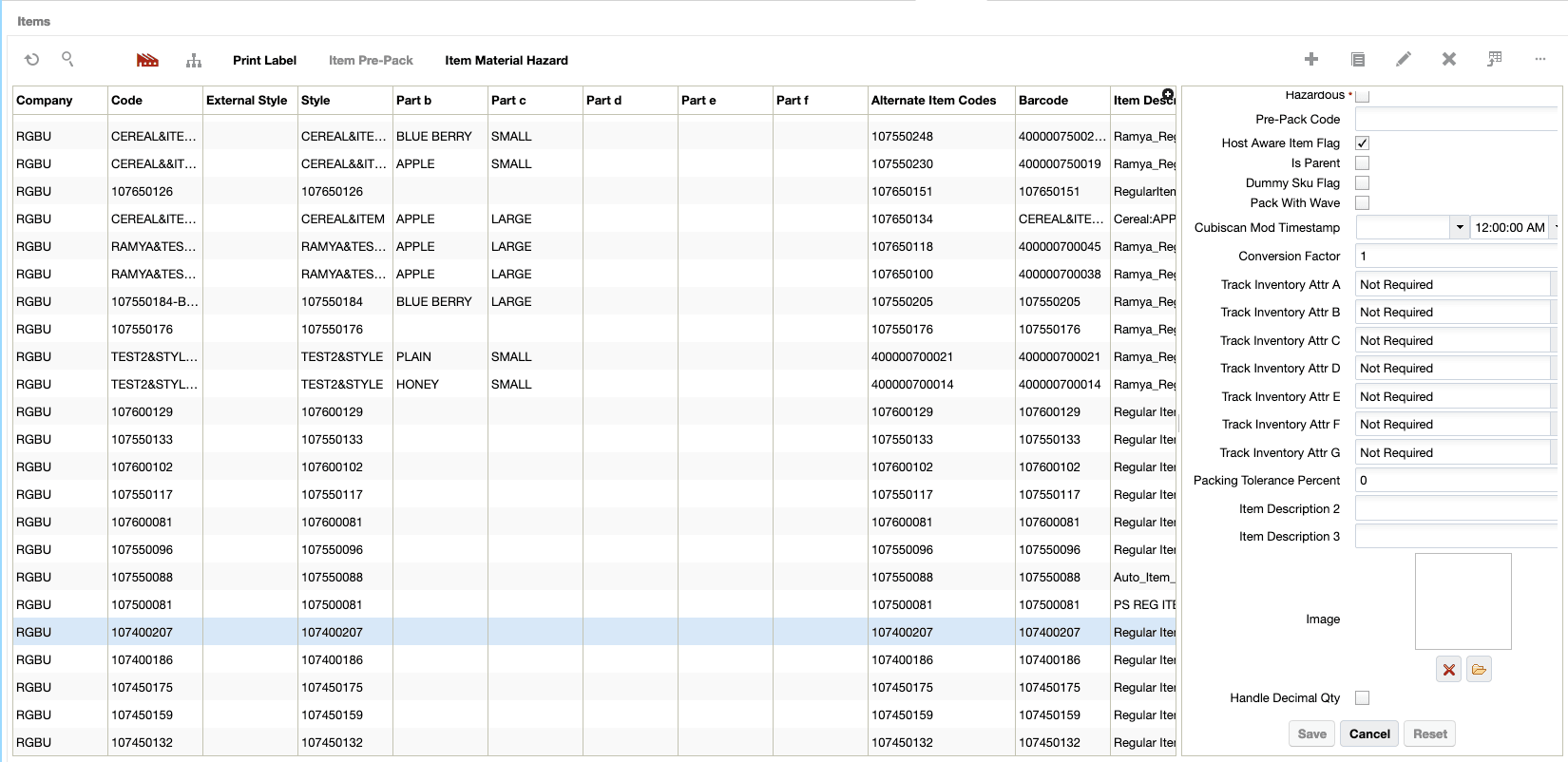

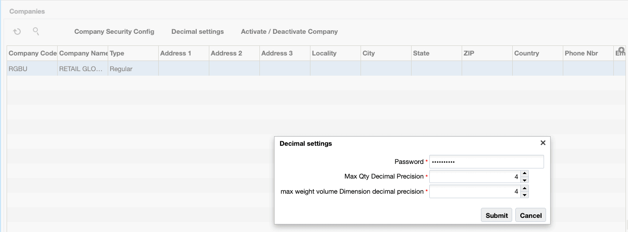

Decimal Support
Merchandising supports up to 4 decimal places for quantity and currency values. Hence, it must be ensured that WMS Cloud is also configured to support that many decimal places as well. This is done using the Companies view in WMS Cloud by clicking on the Decimal Settings option. You will need to configure both the Max Qty Decimal Precision and the Max Weight Volume Dimension Decimal Precision.
Decimal Settings
Next, decimal tracking has to be enabled on the items that would be handled in decimal quantities. In the Items view, select the item and click on the edit icon. In the edit pane, check the Handle Decimal Qty check box.
Items Screen with Handle Decimal Quantity Checkbox

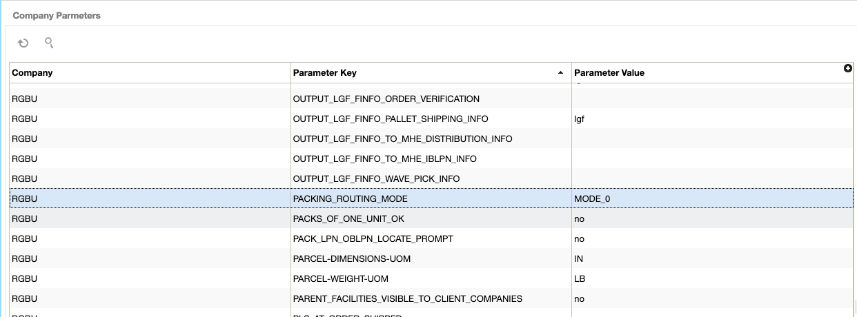

Packing Routing Mode
To support the Ship Via configurations described below, the company level parameter PACKING_ROUTING_MODE should be set to mode_0.
Packing Routing Mode Parameter

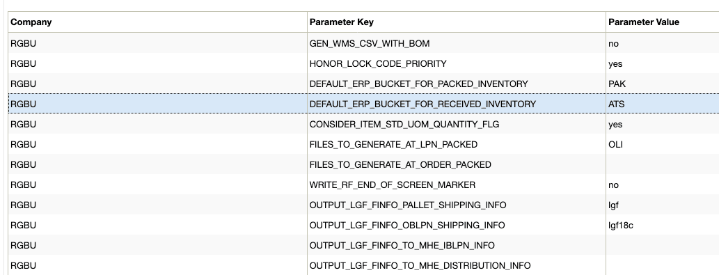

Default Inventory Status
For inventory adjustments, you will also need to configure the value ATS into the DEFAULT_ERP_BUCKET_FOR_RECEIVED_INVENTORY parameter in the Company Parameters page, as shown in the image below. This is used to differentiate inventory adjustments that are moving inventory out of stock completely in the warehouse (which is sent to Merchandising as a null disposition) and those that would move inventory from a locked status to available status in the warehouse, or vice versa.

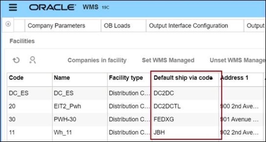

Ship Via Configuration

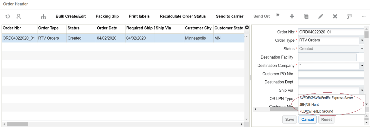

The Ship Via code is used by WMS Cloud to determine the carrier that should be used for shipping and is required for all order types. For B2C orders, this will be communicated from Merchandising based on the information sent from OMS. However, for other order types, B2B and RTV, Merchandising doesn't communicate a preferred carrier. For B2B orders, it is recommended that you set a default at the facility level to prevent having the user from having to enter a value manually for each shipment. This can be done by doing the following:
  • At the company level, configure the Packing Routing Mode, as described above.
  • At the facility level, select the default ship via code to use for B2B orders. For B2B orders, the Ship Via code must not be longer than 4 characters in order to correctly map to Merchandising.
Default Ship Via Code
For the RTV order type, this will have to be manually selected for each order.

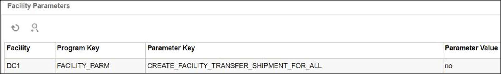

Create Facility Transfer Shipment for All
This parameter is used by WMS Cloud to enable automatic creation of an ASN in the destination facility. However, the shipment created doesn't contain the order number, which means it cannot be used to communicate the order number as expected by Merchandising on receipt at the destination facility. Instead, when integrated with Merchandising, the inbound shipment will be created by the integration layer based on the outbound ASN from the shipping facility, including the order number, so this parameter should be set to N.
facility parameters

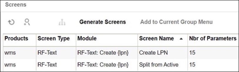

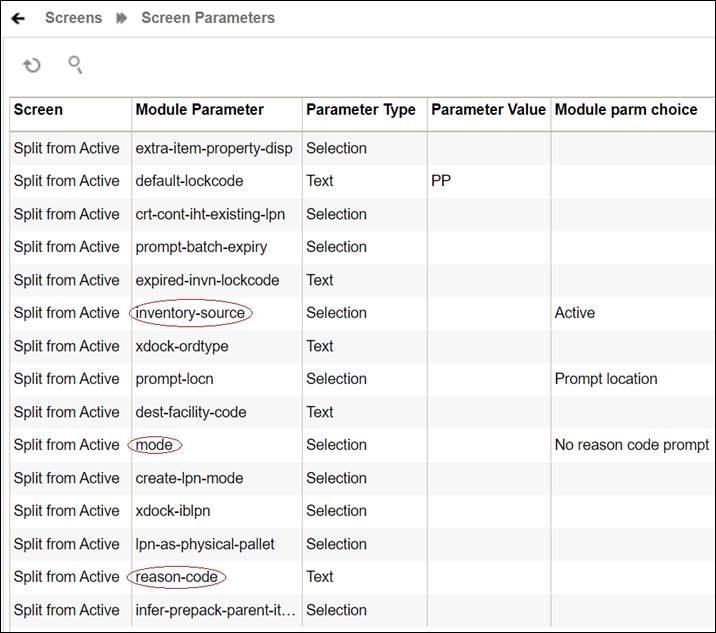

Create LPN
Create {lpn} (or Createlpn) is an RF option in WMS Cloud that can be used to add to inventory or move inventory out of an active location. Usually, two different screens are used to handle these two functions.
If you plan to use the Createlpn RF option to move inventory out of an active location by setting the inventory-source to Active, then it is mandatory that you configure it to have the mode set to No reason code prompt in order to properly integrate with Merchandising.
In the example below, you can see that two modules have been created, one to add inventory and one to move inventory out of active, called Split from Active.
RF Configuration
Then, in the screen below, the inventory-source and mode have been configured as required to Active and No reason code prompt, respectively.
Screen Parameters Set

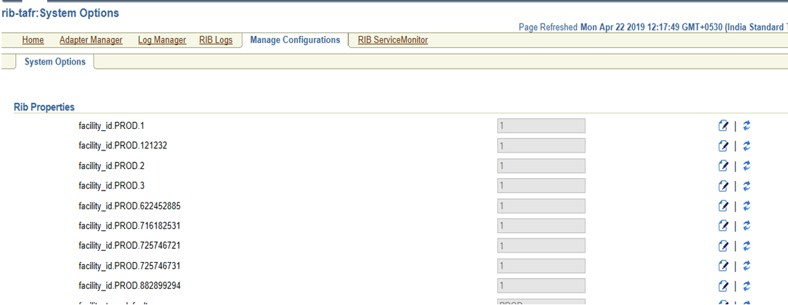

Configure RIB
When being sent from Merchandising to WMS Cloud, data passes through an application called RIB-TAFR (Transformation Addressing Filtering Routing). As part of the standard RIB configuration, the warehouse facility IDs need to be configured in the RIB in order for the TAFR logic to filter and route messages. This is done by the Oracle Cloud Operations team. Once you have your warehouse facilities set up in WMS Cloud, you will need to provide these IDs to the Oracle Cloud Operations team for them to do this configuration. More details can be found in the Oracle Retail Integration Bus Operations Guide.
Figure 5-4 RIB Warehouse Facility IDs
