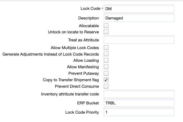

Lock Codes
Lock codes in WMS Cloud are similar to inventory status codes in Merchandising. These need to be coordinated between the two solutions in order to properly map locked inventory in WMS to Merchandising. There are two components of this in WMS Cloud and two components of this in Merchandising that should be configured. First, in WMS Cloud, when creating the lock code, you will also configure an ERP bucket that this lock code should map to. This is because in some cases two lock codes can be assigned for an item in WMS Cloud, but in Merchandising it will always only have one unavailable status at a time. You can also define a priority for the lock code. If used, this will determine which is used to update Merchandising in the case that two are added or removed. Both the lock code and ERP bucket values must exist in Merchandising. See "Appendix - Activity Codes" for details on how they are translated in the integration.
Both the lock code and ERP bucket value will also need to be created as Inventory Status Codes setup in Merchandising. Then, if you wish this code to update an unavailable inventory bucket in Merchandising, you must also map the status code to an inventory status in Merchandising. This allows you to track fewer unavailable statuses in Merchandising than in WMS, if desired. Any inventory status codes that are not mapped to a status in Merchandising will update stock on hand, but not the non-sellable quantity in Merchandising. These codes are used in processing integrations for receipts of POs and stock orders, inventory adjustments and RTVs.
The example below shows how this might be configured:
Table 4-2 WMS Cloud
| Lock Code | ERP Bucket |
DM - Damaged |
TRBL |
IR - In Repair |
TRBL |
Table 4-3 Merchandising
| Inventory Status Code | Inventory Status |
DM - Damaged |
1 - Damaged |
IR - In Repair |
1 - Damaged |
TRBL - Trouble |
1 - Damaged |
In this case, both the lock codes in WMS Cloud are mapped to the same unavailable bucket in Merchandising.

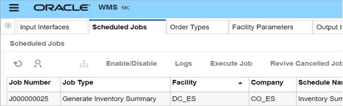

Export the results of the count from WMS Cloud by scheduling an Inventory Summary export (see below for more information on scheduling jobs).
Figure 4-1 WMS Scheduled Jobs
Configure the output interface.
Figure 4-2 WMS Output Interface Configuration
