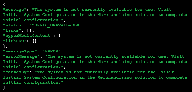

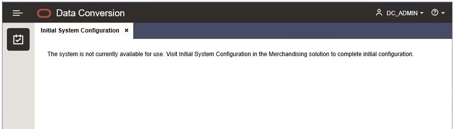

Pre-Initial Configuration Use of REST Services, Integrations, BDI and Batches
All REST services, integrations, BDI, batches invoked through Process Orchestration and Monitoring (POM) will throw an error message indicating that access is not allowed until the initial system configuration process is complete.
When a REST service is accessed prior to initial system configuration, it will respond with an error message indicating the status of initial system configuration. The response should inform the client that initial system configuration must be complete before further actions can proceed. A similar error will also be presented when SOAP web services are invoked. Here's how such a response would be structured in JSON format:

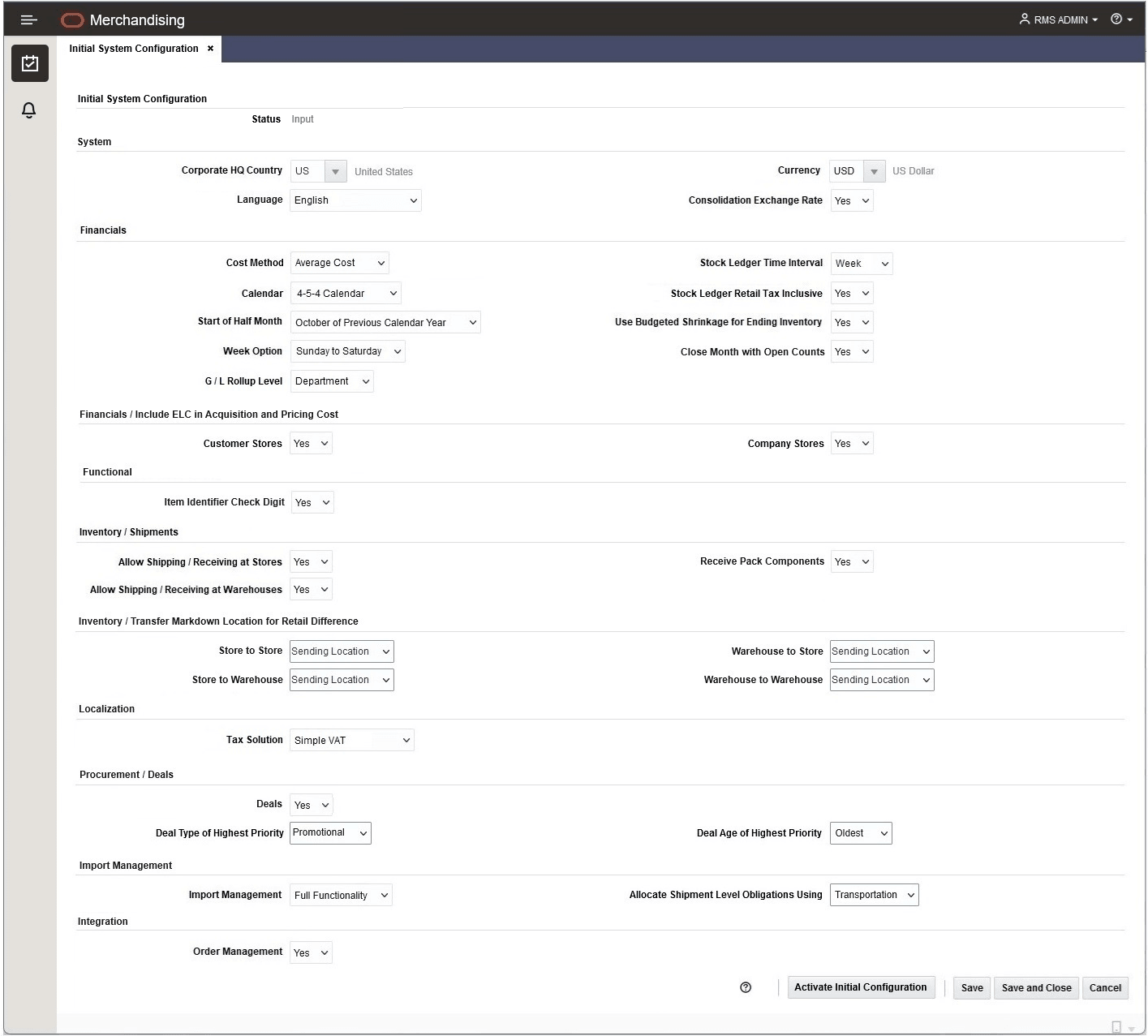

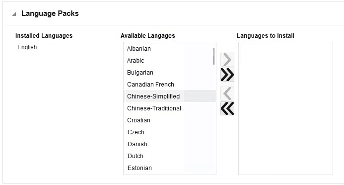

Performing Initial System Configuration
Upon provisioning a new Merchandising environment, the Initial System Configuration screen will be displayed by default upon entering the Merchandising solution.
The sections below outline the system optionsFoot 1 or configurations that must be provided at the beginning of your Merchandising implementation through the Initial System Configuration screen. Even if you are not planning to use certain features right away, you may want to consider some of the items now as they are not easily changed later. It should also be noted that some of these attributes are not able to be updated using the Merchandising screens. If you need to update some of these attributes in a production environmentFoot 2, an SR will need to be logged to have the Oracle Cloud Operations team assist in making these updates in a cloud services implementation.

System Options Required During Initial System Configuration
The options listed below are those that you will be asked to provide during initial system configuration of your Merchandising environments upon provisioning, as they drive how other options are defaulted and how some seed data is loaded into the solution. It is important to review these options and make sure they are well understood as many cannot be changed after initial implementation. The initial system configuration system options must be provided in order to gain full access to the system, you can enter one or more values and click Save or Save and Close to save your progress until you have had a chance to review and enter a value for all of the options. When ready, you can click the Activate Initial Configuration button to complete initial system configuration of the system. The system options required during initial system configuration are described below, in the groupings in which they are presented in the screen.

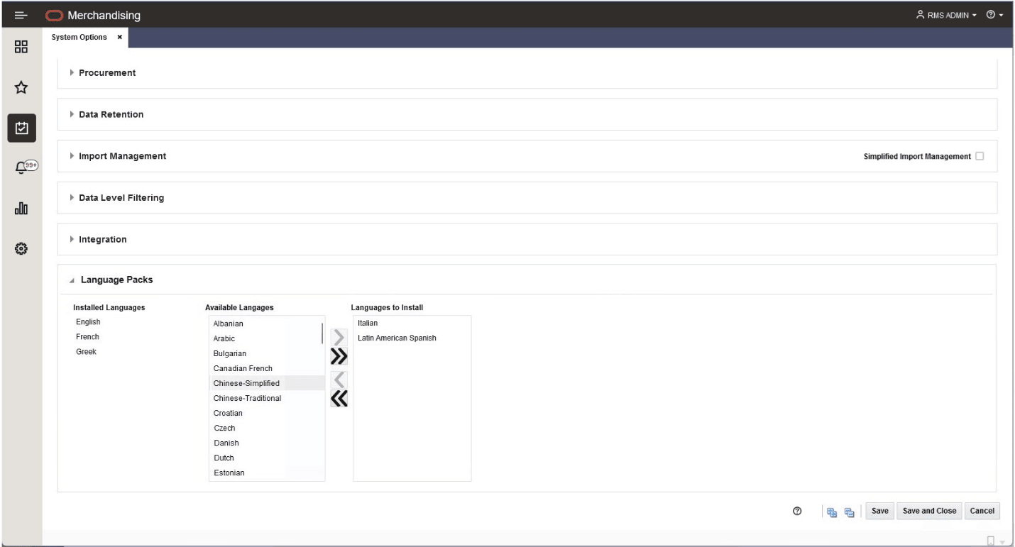

Language Packs
This section displays the language packs that have been installed in the system, along with a list of available languages that can be installed. You may select from the available list and add languages to the Languages to Install list and initiate the installation one or more languages.
Upon system provisioning the English language pack will be installed as the initial primary language for all environments. During Initial System Configuration, the desired primary language will be selected in the Initial System Configuration screen. If English is selected, it will remain the only installed language upon the completion of initial system configuration, otherwise, the newly selected primary language will also be installed during initial system configuration. When the System Options screen is first entered, if English has been selected as the primary language, English will be the only Installed Language listed, but if any other language is selected as the primary language, two languages will be displayed under Installed Languages, English and the selected primary language. After that point, users can select one or more additional languages to install whenever desired.
Figure 2-1 System Options with Language Packs Section Expanded
There are three language lists, Installed Languages, Available Languages and Languages to Install. Each language is stored in the database on the Language table (lang) which contains a Language Installation Status (LANG_INSTALLED). This status has three values:
Installed (Y) - indicates the language is installed and will display on the System Options screen under the Installed Languages list.
Not Installed (N) – indicates the language is not installed and will display on the System Options screen under the Available Language list.
Installation in Progress (P) – indicates the system is processing the installation of the language pack and will display on the System Options screen under the Languages to Install list which will temporarily be relabeled to ‘Installation in Progress’ while the installation process is executing.
Upon opening the System Options screen, the Installed Languages list will contain all languages with a Language Installation Status of Installed (Y). The Available Languages list will contain all languages with the Language Installation Status of Not Installed (N). The user can select one or more available languages and shuttle them over to the Languages to Install list:

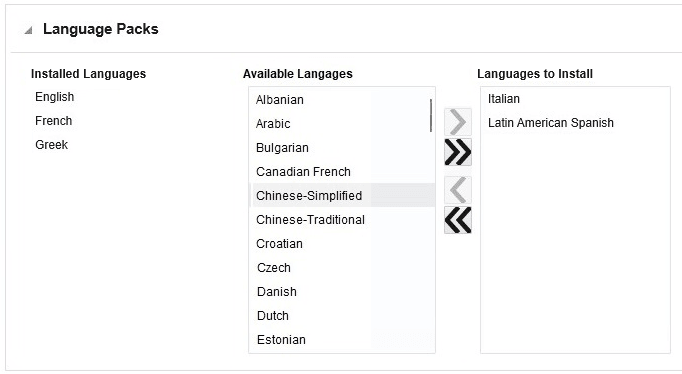

Figure 2-2 Detailed View of Language Packs Section
Installing a Language
Via the shuttle component you are able to select additional languages to install by selecting the desired language from the Available Languages list and moving it to the Languages to Install list using the arrow buttons.
Once a language has been added to the Languages to Install list and the changes have been committed by clicking the Save or Save and Close button in the System Options screen, the language will be installed via an asynchronous process. A confirmation message will display informing you that the installation process will be initiated, that until the process is complete you cannot install additional languages, that once installation is complete it cannot be undone, and asking if you wish to continue. If you say yes to the confirmation message, the installation process will be executed.
Once the process is initiated, Language Installation Status, which is not displayed in the screen, will be updated from Not Installed (N) to Installation in Progress (P), to indicate the installation is processing. While the language installation status is set to Installation in Progress (P), the Languages to Install shuttle title will be temporarily changed to Installation in Progress thus showing the languages that are presently being installed. The shuttle buttons will be disabled so you are unable to add or remove any additional available languages to be installed until the installation of the currently selected languages is complete.
Once the asynchronous process is completed, the languages will be removed from the Installation in Progress list, the list title will be set back to Languages to Install, and the newly installed languages will appear in the Installed Languages list. You may add additional languages and when Save or Save and Close is clicked again, the installation of the additional language will be initiated in the same manner as described above.
Once installed, a language cannot be removed. However, until you click Save or Save and Close in the System Options screen, you are able to move languages back and forth from Available Languages list to Languages to Install list in the shuttle until the screen is saved.

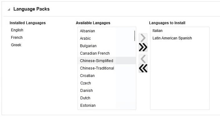

Figure 2-3 Language Packs Section after Initial System Configuration when English is Selected as the Primary Language
For example, if English is selected as the primary language, after Initial System Configuration when you enter the System Options screen the Language Packs container will look as follows:
You may move one or more languages from Available Languages, such as Chinese-Simplified, Dutch and French to the Languages to Install list, but until you click Save or Save and Close, you can move any of the languages back to Available Languages.
If French has been selected as the primary language, and subsequently you installed Greek and then later entered the System Options screen to also install Italian and Latin American Spanish, the screen would look as follows:
Figure 2-4 Language Packs Section if Primary Language is French, Greek has been Installed, and Italian and Latin American Spanish are Selected for Install
