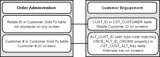

How are synchronized customers linked? A pair of synchronized Order Administration and Customer Engagement customer records are linked by matching customer numbers:
  • Order Administration: the Relate Id in the Customer Sold To table identifies the customer ID in Customer Engagement
  • Customer Engagement: the Alternate key in Customer Engagement identifies the customer number in Order Administration. The ORCE_ALT_ID_OROMS setting in Working with Customer Properties (PROP) defines the alternate key type for the Order Administration customer number in Customer Engagement.
This image shows how synchronized customers are linked.

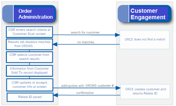

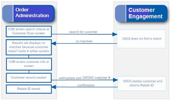

When the Customer Contacts the Call Center
Overview: A customer can also create an order by contacting the call center. When the customer contacts the call center to place an order, request a catalog, create a customer membership outside of order entry, or update name and address information, the CSR needs to first search for the customer in order to keep the Customer Engagement and Order Administration customer records in sync and prevent creating duplicate records. The process when a customer contacts the call center is:
  • Search Customer Engagement first: When the CSR performs a search, Order Administration first checks in Customer Engagement for any matches. Unlike the process used for the order API, the customer search can send various criteria to Customer Engagement. If the CSR selects a customer from the search results and enters any updates, Order Administration syncs these updates with the Customer Engagement customer record.
  • Search Order Administration second: If the CSR’s search does not find any matches in the Customer Engagement database, Order Administration checks for any matches in its Customer Sold To table. When the CSR selects and works with a Order Administration record, Order Administration sends the current information to Customer Engagement, creating the customer record there and stores the returned ORCE customer ID with the customer record.
  • Create customer if no match: If there are no matches in either database, then the CSR can create a new customer, and Order Administration sends the new customer record to Customer Engagement, then stores the returned ORCE customer ID with the new customer record.
Examples of these processes are provided below.
Searching Customer Engagement for the Customer
When the customer contacts the call center to place an order, request a catalog, create a customer membership outside of order entry, or update name and address or other information:
Searching:
  • The CSR enters the search criteria at the Customer Scan Screen.
  • There is at least one customer record in Customer Engagement that matches the search criteria.
  • The Results tab at the Customer Scan screen displays the names, home addresses, email addresses, and primary phone numbers of any customers in the Customer Engagement database matching the search criteria. The Results tab displays the error message Maximum search results exceeded, please refine your search if the number of matching records exceeds the Customer Lookup Limit system configuration setting in Customer Engagement. In this situation, you need to make your search criteria more specific to make sure that you can find the customer record you are looking for.
Selecting a customer from the Customer Engagement search results:
  • If the CSR selects a record from the Results tab:

Searching Order Administration for the Customer in Classic View
Searching:
  • There are no records in Customer Engagement that match the search criteria, but there is at least one match in the Order Administration Customer Sold To table.
  • The Results tab at the Customer Scan screen displays the names, home addresses, email addresses, and primary phone numbers of any customers in Order Administration’s Customer Sold To table that match the search criteria.
Selecting a customer from the Order Administration search results:
  • If the CSR selects a record from the search results:
    • Order Administration retrieves the current information from its Customer Sold To table.
    • When the CSR updates or accepts the customer information, Order Administration sends an add/update message to Customer Engagement.
    • Customer Engagement creates the customer record, assigning the Order Administration customer number as an alternate key, and sends the Customer Engagement customer number to Order Administration.
    • Order Administration updates the Customer Sold To record with the Relate Id.
This image shows Selecting a customer from the Order Administration search results:
Creating a New Customer
Searching:
  • There are no records matching the search criteria in either Customer Engagement or Order Administration.
  • The results do not include any records.
Creating the customer:
  • When the CSR enters the information on the new customer:
    • Order Administration creates the customer record in its Customer Sold To table.
    • Order Administration sends an add/update message to Customer Engagement.
A diagram to show the flow between OACS and Customer Engagement

Which tables? Customer records are stored in:
  • Order Administration: the Customer Sold To table, except where noted below.
  • Customer Engagement: the CST_CUSTOMER table.
For more information: See the Information that is not mapped for a listing of some of the fields that are not mapped as part of the Customer Engagement customer integration.

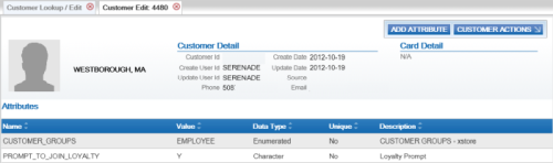

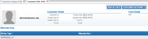

Displaying in Customer Engagement:
  • Order Administration customer number: select Alternate Key.
  • Relate ID: labeled the Customer Id.
This image shows the customer detail information in the Relate Alternate Key.
Customer number
Alternate key OROMS_ID
Indicates the Alt Key Type of the alternate key in Customer Engagement that maps to the Order Administration customer number.
This field is available for display in Customer Engagement by selecting Alternate Key in the Customer Lookup /Edit option.
Customer Engagement automatically creates this entry for a customer when you send the customer to Customer Engagement interactively or through the Customer Engagement Add or Update Customer Message if it does not already exist based on the ORCE_ALT_ID_OROMS setting in the Customer Engagement Properties file. In this situation, Customer Engagement also adds a row to the CST_ALT_KEY_TYPCODE table in the Customer Engagement database if it does not already exist.
Relate id
Customer ID
The Relate id:
  • is not displayed on any screen in Order Administration
  • is an alphanumeric field in the Order Administration Customer Sold To table

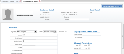

Displaying in Customer Engagement: Under Customer.
This image shows the customer displayed in Customer Engagement.

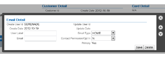

Address
Only the customer’s HOME address in Customer Engagement is mapped to Order Administration. If more than one HOME address exists in Customer Engagement, the system uses the primary HOME address. This information is required in order for Order Administration to create the customer record correctly.
Customer Engagement automatically creates an Address type of HOME when it receives a customer from Order Administration interactively or through the Customer Engagement Add or Update Customer Message. In this situation, Customer Engagement also adds a row to the CST_ADDR_TYPCODE table for ADDRESS_TYPECODE HOME in the Customer Engagement database if it does not already exist.
No address validation in Customer Engagement: Unlike Order Administration, Customer Engagement does not require an address for a customer, and does not validate that the address includes certain required components; for example, no address lines are required. To prevent problems in Order Administration, it is important that any other means you use to create customers in Customer Engagement, such as through your e-commerce site, always creates a home address when you use the Customer Engagement customer integration. If a home address does not exist in Customer Engagement, Customer Engagement displays the customer in Order Administration without an address. Also, if certain fields for the home address are not defined in Customer Engagement, these fields will be blank when you display the customer in Order Administration. However, when you update the customer’s address in Order Administration so that is passes validation, the system will also update the customer’s home address in Customer Engagement
Displaying in Customer Engagement: Select Address.
This image shows the customer address information.

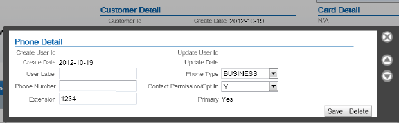

Phone numbers
The phone numbers in Order Administration map to the soft-coded Telephone types based on the Customer Engagement Properties.
Customer Engagement automatically creates the Telephone type codes of HOME, BUSINESS, and FAX or MOBILE when it receives a customer from Order Administration interactively or through the Customer Engagement Add or Update Customer Message. In this situation, Customer Engagement also adds rows to the CST_PHONE_TYPCODE table for types of WORK, HOME, and FAX or MOBILE in the Customer Engagement database if they do not already exist.
Phone number extensions are not mapped between Customer Engagement and Order Administration.
Phone numbers in Order Administration are stored in the Customer Sold To Phone # table. Any formatting is removed from the phone number before sending to Customer Engagement.
Removing a phone number: If you delete a phone number in either Customer Engagement or Order Administration, the system deletes the associated phone number in the other system.
Displaying in Customer Engagement: Select Phone. Optionally, highlight a phone number to open the Phone Detail window.
This image shows the customer phone detail in Relate.

Email address
In Order Administration, the primary email address is stored in both the Customer Sold To table and the Customer Sold To Email table. Additional, non-primary email addresses are stored only in the Customer Sold To Email table.
Only the HOME email address that is flagged as primary in Customer Engagement is eligible to be included in the integration.
Customer Engagement automatically creates an Email type of HOME when it receives a customer from Order Administration interactively or through the Customer Engagement Add or Update Customer Message. In this situation, Customer Engagement also adds a row to the CST_EMAIL_TYPCODE table for EMAIL_TYPECODE HOME in the Customer Engagement database if it does not already exist.
Displaying in Customer Engagement: Select Email. Optionally, highlight the email address to open the Email Detail window.
This image shows the customer email information detail.
N/A
Primary
Set to Yes in Customer Engagement.
Email address
Email type: HOME
Only the HOME email address that is flagged a primary is eligible to be included in the integration. If the customer has any other email type in Customer Engagement, but not a HOME email type, the email address(es) are not passed to Order Administration.
Any trailing spaces are removed.

Displaying in Customer Engagement: Select Attributes.
This image shows the customer attributes in Relate.

  • Relate Id: Customer Engagement customer number = Relate Id in the Order Administration Customer Sold To table
  • Customer number: Customer Engagement alternate key record whose Alt Key Type matches the ORCE_ALT_ID_OROMS setting in Working with Customer Properties (PROP) = the Order Administration customer number
  • E-commerce ID: Customer Engagement alternate key record whose Alt Key Type matches the ORCE_ALT_ID_WEB setting in Working with Customer Properties (PROP) = the e-commerce site’s customer number. From the ecommerce_id passed in the CWOrderIn message, and saved as the E-commerce ID in the Customer Sold To table only if the order API was unable to synchronize the Order Administration and Customer Engagement customer records
  • Primary email address: an email address for the customer in Customer Engagement = the customer’s primary email address in Order Administration
