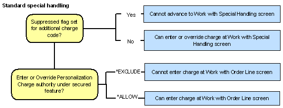

Standard special handling: The following chart summarizes how the system controls access for standard special handling formats:

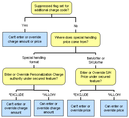

Custom special handling: The following chart summarizes how the system controls access for custom special handling formats:

Screen | You can enter or override special handling charge/price if: |
Special handling type = standard Authority under the Enter or Override S/H Price secured feature is *ALLOW |
Special handling type = standard Display of the special handling screen is not suppressed |
Special handling type = custom Display of the special handling screen is not suppressed And:

Suppress S/H window |
Indicates whether to suppress the display of the Work with Special Handling Screen or the Work with Custom Special Handling Screen when you add an item with special handling in order entry. You might want to suppress display in order to automatically add a charge to the Handling bucket on an order without requiring the order entry operator to complete or accept the information on the special handling screen. Valid values are:
Not a valid entry for an additional charge code that does not have a Special handling format. |
Additional considerations when suppressing the special handling screens: Displaying special handling screens on demand: If the automatic advancement to the special handling screen is suppressed, you cannot display the screen on-demand. For example, a special handling screen is not available by selecting Special Handling for an item in order entry or order maintenance. However, you can still advance to the Display Special Handling or the Display Custom Special Handling screens in standard order inquiry, or display special handling information in streamlined order inquiry, regardless of the setting of this field. If you would like to prevent the special handling screen automatically but retain the ability to display it on demand, use the Bypass S/H flag instead of the Suppress S/H window flag. Entering returns through order entry: If a special handling format is set to suppress display and applies to the order detail line, then the handling charge will be automatically added to the order as a credit when you create a return by entering a negative quantity in order entry. However, if the special handling format is not set to suppress display, you advance to the special handling screen and have the option of accepting or rejecting the charge. Note: This flag causes the special handling charge to be added to the order automatically when you use interactive order entry. For example, the charge is not added automatically through the generic order message (order API).Does not control screen flow in Contact Center. Optional. |
