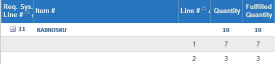

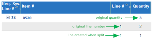

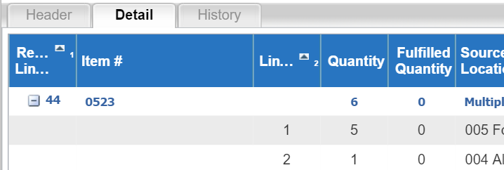

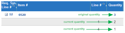

Is line split? Provided the Allow Split Order preference is selected, a line can split if:
Even if your preferences support splitting lines or partial status update, this does not necessarily mean that the lines on an order will split. Split lines at Detail tab: If any line on the order is split, you need to expand the requesting system line number at the Details tab in order to see and work with the details for all lines and see additional options: Non-split lines at Detail tab: If none of the lines on the order are not split, the details and options are displayed when you open the Detail tab: For more information: See Selecting a Location for a Delivery Order for some of the different scenarios that are possible in creating or updating detail lines on delivery orders if you have Order Orchestration configured to split orders or order lines. Also, see Updating Order Status at the Line or Unit Level for an overview on processing partial status updates for order lines. |
Req. Sys. Line # (Requesting system line number) |
The line number identifying the order line in the requesting location. From the line_item_no passed in the submit order message. A single line from the requesting system can create multiple order lines in Order Orchestration if the Allow Split Line preference is selected. Also, a line can split as the result of a partial status update if the Allow Partial Updates preference is selected. Even if a line is not split in Order Orchestration, the requesting system line number can be different from the line number in Order Orchestration. For example, this situation can occur if the placed (originating) location sends only the third line on a multi-line order to Order Orchestration; in this case, the line number in Order Orchestration is #1. If split: If any lines on the order are split, you need to expand the line to see additional details and options. Click the plus sign next to the requesting system line number to expand: |
Line # |
The order line number assigned by Order Orchestration. May be different from the requesting system’s line number if the system did not send all of the order lines to Order Orchestration for fulfillment and the version specified in the submit order message was lower than 3.0, or if an order line is split. If split: If any of the lines on the order are split, the Item # is before the Order Orchestration Line # and is always displayed, even if you have not expanded the line by clicking the plus sign next to the Req. Sys. Line # (Requesting system line number); however, the Line # and other fields are not displayed until you click the plus sign. Examples of line splitting:
Different line numbers even if not split: It is possible for the Order Orchestration line number and requesting system line number to differ if, for example, the requesting system sends line 3 of a multi-line order to Order Orchestration (requesting system line number); when the Routing Engine creates the order, it assigns a line number of 1 because it is the only order line received from the requesting system. Line numbers might not be consecutive: If the Routing Engine splits a line or receives a partial status update, the line numbers assigned in Order Orchestration to the resulting split lines might not be consecutive. For example, a system sends 3 lines, which produce lines 1, 2, and 3. Subsequently, the Routing Engine receives a partial update for line 1 and creates line 4 for the quantity in the updated status. If not split: If none of the lines on the order are split, just a single line number is displayed. |
Item # |
The system product code for the user’s Default Organization. If the user’s Default Organization is not the same as the organization associated with the order, the system product code for the fulfilling location is displayed. Up to 26 positions. If split: If any of the lines on the order are split, the Item # is before the Order Orchestration Line # and is always displayed, even if you have not expanded the line by clicking the plus sign next to the Req. Sys. Line # (Requesting system line number). No item #? If your user ID is not assigned a Default Organization through the Users screen, the Item # might not be displayed here. Note: You can display the item description by moving your cursor over the item code. |
Quantity |
Original quantity: If the line is split, the quantity displayed on the first line without a current line number is the quantity of the item that was originally assigned to the Fulfilling Location or Sourced Location. This quantity might differ from the quantity originally submitted to Order Orchestration if the Allow Split Line preference is selected, and the Routing Engine initially split the line across multiple fulfilling or sourcing locations. Also, the original quantity in Order Orchestration might subsequently be split across multiple order lines in Order Orchestration if the original fulfilling or sourcing location rejects the assignment and the Routing Engine splits the line when it reassigns it, or if a location submits a partial status update. Current quantity: The quantity that is currently assigned to the fulfilling, sourcing, or pickup location. This quantity might be different from the original quantity if the Allow Split Line preference is selected, and the Routing Engine split the line across multiple fulfilling or sourcing locations after it was initially rejected by the first location, or if a location submits a partial status update. Not split: If the line is not split, the original and current quantities are the same. If none of the lines on the order are split, then just a single quantity is displayed. |

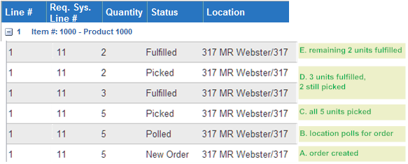

This tab displays the status history for each line on the order, created whenever a line is:
The History tab lists records for each item in reverse chronological order (newest to oldest). A single transaction can create multiple history records if the transaction splits the line due to a partial status update or reassignment of a rejected order to multiple fulfilling locations. Optionally, you can collapse the history for an item by clicking the box next to the line number. Note: Status history and changes to the Under Review indicator are tracked at the line level even if the organization does not split orders or order lines. |

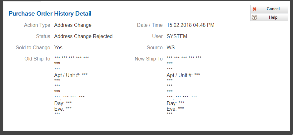

Order History Detail - Address Change Window
Purpose: Use the Order History Detail - Address Change window to review the changes made to the shipping address on a delivery order. The old ship to address is on the left side of the window and the new updated ship to address is on the right side of the window with the changes indicated in red for comparison.
Used for the Store Connect module.
Submitting address changes: A store associate with authority to edit the shipping address can update the address in Store Connect.
Customer name anonymized? If the customer data on an order has been anonymized (deleted and replaced with asterisks), the customer name is displayed as:
See Anonymizing Data for background.
How to display this window: Select the icon () in the Details column at the History tab of the Order screen. This icon is displayed only if a store associate updated the shipping address on a delivery order in Store Connect.
Fields at this window
Field | Description |
User |
The user ID of the person who performed the activity. |
Date / Time |
The date and time when the shipping address change was received. Format is based on the settings defined through the Users screen. |

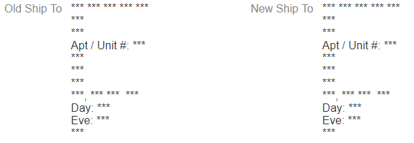

Old Ship To |
The ship-to name and address before applying the change. Includes:
Customer anonymized? If the customer data on an order has been anonymized, asterisks are displayed for the ship-to information. See Anonymizing Data for background. |
New Ship To |
The ship-to name and address with the changes indicated in red. Includes the same name and address fields as the Old Ship To. Note: The system does not flag changes in case; for example, updating the country from US to us, in red.Customer anonymized? If the customer data on an order has been anonymized, asterisks are displayed for the ship-to information. See Anonymizing Data for background. |

Line # |
The line number of the item on the order in Order Orchestration. How might the line numbers be different? It is possible for the line number, requesting system line number, and original line number to differ; for example:
Different line numbers even if not split: It is possible for the Order Orchestration line number and requesting system line number to differ if, for example, the requesting system sends line 20 of a multi-line order to Order Orchestration (Requesting system line number); when the Routing Engine creates the order, it assigns a line number of 1 because it is the only order line received from the requesting system. Line numbers might not be consecutive: If the Routing Engine splits a line or receives a partial status update, the line numbers assigned in Order Orchestration to the split lines might not be consecutive. For example, a system sends 3 lines, which produce lines 1, 2, and 3. Subsequently, the Routing Engine receives a partial update for line 1 and creates line 4 for the quantity in the updated status. |
Original Line # |
The line number from which this line was split. Set to 0 if the line was not split after initial order creation. |

Quantity |
The quantity that is currently assigned to the fulfilling, sourcing, or pickup location. This quantity might be different from the Original quantity if:
Original Quantity |
The quantity of the item that was originally assigned to the fulfilling or sourcing location. See the Quantity field, above, for a discussion. |

Address Change Requests | ||||
Address Change |
You submit an address change request for a purchase order in New Order status. |
WS |
New Order |
Address Change Automatically Applied |
Address Change |
You submit an address change request for a purchase order in In Process or Held status. |
WS |
unchanged |
Address Change Requested |
Address Change |
The vendor declines an address change request. |
UI |
unchanged |
Address Change Rejected |
Address Change |
The vendor accepts an address change request, either at the Purchase Order Change Requests screen or automatically when a line returns to New Order status after the vendor releases the line from hold, ships a partial quantity and returns the line to New Order status, or voids (but doesn’t reprint) the pack slip. |
UI |
unchanged |
Address Change Approved |
Address Change |
The vendor ships a purchase order with an outstanding address change request. This message is written only for the first item on the shipment. |
UI |
Shipped |
Address Change Auto Rejected |

Purchase Order History Detail
Purpose: Use the Purchase Order History Detail window to review:
an address change applied automatically to a line because you submitted the change when the line was in New Order status
an address change you requested when a line is in In Process or Held status; these address changes do not apply until the vendor accepts them
Used for the Supplier Direct Fulfillment module.
Submitting address changes: The system originating the purchase order, such as Order Administration or CWDirect, can submit an address change through the SetDSAddress Change message.
Automatically rejected? Address change requests are not available for review in this window if they arrive when the line is already in Cancelled or Shipped status. These address change requests are automatically rejected.
Address changes for different lines on the purchase order: Even though the address change request is related to the purchase order header, Order Orchestration evaluates the status of the individual lines on the purchase order when determining whether to apply the change, reject it automatically, or submit it to the vendor for review.
Example: A purchase order is in Open status, with one line in In Process status and one line in Shipped status. The vendor needs to approve or reject the address change for the line in In Process status. The address change is automatically rejected for the line in Shipped status.
What if you submit multiple address changes for the same line? If you submit a second or third address change for the same In Process or Held line before the vendor has accepted or rejected the previously rejected change, Order Orchestration automatically rejects the previous address change. In this situation, when you display the Purchase Order History Detail window, only the name and address information for the most recent address change is displayed.
If you submit multiple address changes for a New Order line before the vendor generates the pack slip, each address change is automatically applied, and is displayed at the Purchase Order History Detail window.
Customer data anonymized? If the customer data on a purchase order has been anonymized (deleted and replaced with asterisks), asterisks are displayed for the Old Ship To and New Ship To customer name, address, phone numbers, and email address:
The address change data is anonymized regardless of whether the address change applies automatically, is accepted by the vendor, or is rejected by the vendor.
How to display this window: Select the icon () in the Details column at the History tab of the Purchase Order screen. This icon is displayed only if there is an address change request that was received when the line was in New Order, In Process, or Held status.
Available if Use Vendor Portal is selected at the Tenant screen. Only users with Purchase Order Inquiry authority can display this window. See Roles for more information.Window displayed for multiple history records? If the address change was:
accepted by the vendor = The window is available next to the history record marking both when the address change was requested and when the vendor approved the address change. The status indicated in both windows is Address Change Approved.
rejected by the vendor = The window is available only next to the history record marking when the address change was requested. The status indicated is Address Change Rejected.
Action Type |
Always set to Address Change. |
Date / Time |
The date and time when the address change request was received. Format is based on the settings through the Users screen. |
Status |
The current status of the address change (not the status at the time the history record was created). Possible statuses are:
User |
The user ID of the person who performed the activity:
Sold To Change |
Indicates whether the sold-to address for the purchase order is the same as the shipping address, so you request that both addresses be changed. Possible settings:
Source |
Indicates where the activity originated. Possible settings:
Old Ship To |
This information is from the CreateDSOrder message. Note: Not all of the information above might be available for each customer. Replaced with asterisks? If the customer data on a purchase order has been anonymized (deleted and replaced with asterisks), asterisks are displayed for the Old Ship To and New Ship To customer name, address, phone numbers, and email address. |
New Ship To |
Note: The ship-to name and address with the changes indicated in red. Includes the same name and address fields as the Old Ship To. This information is from the SetDSAddress Change message. Replaced with asterisks? If the customer data on a purchase order has been anonymized (deleted and replaced with asterisks), asterisks are displayed for the Old Ship To and New Ship To customer name, address, phone numbers, and email address. |
