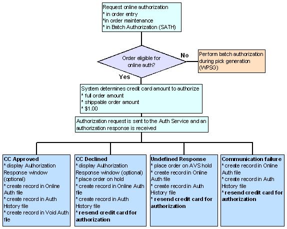

1. The system determines if the order is eligible for online authorization. In order to receive a credit card authorization during order entry:
  • the On-line Authorizations (B89) system control value must be selected.
  • the order type defined for the order must be eligible for online authorizations (the On-line authorization field is set to Window (on-line eligible and display window) or Without Window (on-line eligible and do not display window).
  • the order must have a credit card, stored value card, or debit (Switch) card payment method.
  • the order must be in an open or suspended status. Note: You can authorize a credit card payment during order maintenance when the order is on hold; regardless of whether the payment is authorized, the order remains on hold.
  • the arrival date on the order cannot be greater than the current date.

2. The system determines the amount to authorize.
What Credit Card Amount is Sent for Authorization?
  • If the Online Auth Verification Only (I96) system control value is selected, the system processes online authorizations for $0.00 for the purpose of validating the card. During batch authorizations, the system authorizes the card for the shippable dollar amount and voids the online authorization for $0.00.
  • If the Online Auth Verification Only (I96) system control value is unselected, the system looks at the setting of the Authorize Full Amount During Order Entry (G99) system control value to determine the amount sent for authorization.

3. The system sends the authorization amount to the service bureau. If there is an amount to authorize for the credit card, the system sends an authorization request in online format to the service bureau.
4. The service bureau sends back a response. The service bureau sends an authorization response to Order Administration.
There are 3 types of responses you can receive from the service bureau.
  • R = an authorization response is received, such as declined or approved
  • T = the program timed out before an authorization response was received
  • U = an undefined response
Additionally, if an authorization response is received, the service bureau sends back an authorization response code, AVS response code (if performing address verification), CID response code (if performing credit card identification verification), authorization code, and date.

What Happens When a Credit Card is Approved?
When a credit card is approved during order entry, the system:
  • Select Authorization Response Option Window
  • places the order on hold if a hold reason code has been defined for the vendor response. Typically, if an authorization is approved, the order is not placed on hold. However, if the credit card is approved but fails address verification or card identification verification, you may want to place the order on hold.
  • once you accept the order, you return to the Select Customer Sold To For Order Screen, or the Customer Selection Screen if you are a CTI user.
  • processes any end-of-order updates and sends the order to the Order Async.
  • creates a record in the On-Line Authorization table indicating the order number, that the credit card has been approved, the dollar amount authorized, the transaction sequence number, and the authorization number. The status for this authorization is *UPDT, indicating the online authorization has completed.
  • creates a record in the Authorization History table indicating the credit card has been approved, the authorization number, the date the credit card was authorized, and the dollar amount authorized. If you reject an order after the credit card has been approved, the system removes the record in the Authorization History table. You can review authorization history at the Display Authorization History Screen.
  • creates a record in the Void Authorization table indicating the order number and the dollar amount eligible for void. If you reject an order after the credit card has been approved, the system removes the record from the Void Authorization table.

What Happens When a Credit Card is Declined?
When a credit card is declined during order entry, the system:
  • displays the Select Authorization Response Option Window if a vendor response pop up window message has been defined, the On-line authorization field for the order type is set to Window (on-line eligible and display window), and a Response time is defined for the service bureau. The message should indicate the credit card has been declined and any action you should take to correct the decline or inform the customer. From this window, you can accept the order or return to the order to make any corrections.
  • places the order on hold: If a hold reason code is defined for the vendor response, the system assigns this hold reason code to the order payment method and places the order header on AT (Declined Credit Card) hold. If the response received is not defined for the service bureau, the system places the order payment method on AV (Invalid Response Code) hold.
  • once you accept the order you return to the Select Customer Sold To For Order Screen, or the Customer Selection Screen if you are a CTI user.
  • creates a record in the On-Line Authorization table indicating the order number, that the credit card has been declined, the dollar amount submitted for authorization, and the transaction sequence number. The status of this authorization is *UPDT, indicating the online authorization has been completed.
  • creates a record in the Authorization History table indicating the credit card has been declined, the reason why the credit card was declined, the date the credit card was declined, and the dollar amount submitted for authorization. If you reject the order after the credit card has been declined, the system removes the record from the Authorization History table. You can review authorization history at the Display Authorization History Screen.
You can send the credit card up for authorization again during order maintenance, using the Performing Batch Authorization (SATH) menu option, or during pick slip generation if the Batch/on-line field for the service bureau contains a C (on-line and batch authorizations).
When Communication Failures Occur
Communication failures can occur if the system times out before a response is received. If communication failures occur and you do not receive a response from the service bureau, the system:
  • does not display the Select Authorization Response Option Window since a vendor response was not received.
  • accepts the order and returns you to the Select Customer Sold To For Order Screen, or the Customer Selection Screen if you are a CTI user.
  • creates a record in the On-Line Authorization table. The status of this authorization is:
  • RDY, indicating online authorization has not been performed.
  • SENT, indicating the online authorization transmission failed after the credit card was sent to the service bureau for authorization.
  • RCVD, indicating the online authorization transmission failed after a response was received from the service bureau, but final updates could not be completed. This may occur if the Online Authorization integration job became inactive. The authorization does not complete processing until the job is active. Once the Online Authorization integration job is active, the system updates the status of the authorization to *UPDT.
  • creates a record in the Authorization History table indicating the credit card is waiting for authorization, the date the credit card was sent for authorization, and the dollar amount waiting for authorization.

What Happens When an Undefined Response is Returned?
When an undefined response is returned, the system:
  • does not display the Select Authorization Response Option Window since this vendor response has not been defined for the service bureau.
  • places the order on AVS hold.
  • creates a record in the On-Line Authorization table indicating the order number, that the credit card is waiting for authorization, the dollar amount waiting for authorization, and the transaction sequence number. The status of this authorization is *RDY, indicating online authorization has not been performed.
You can resend the order for authorization during order maintenance, using the Performing Batch Authorization (SATH) menu option, or during pick slip generation if the Batch/on-line field for the service bureau contains a C (on-line and batch authorizations).

Online Authorization Process
This image shows the online authorization process.
