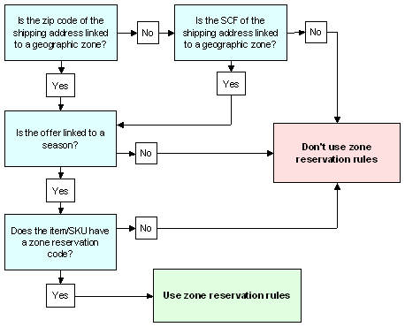

For an order line to be eligible for zone reservation processing:
- The item/SKU must be assigned a zone reservation code in the item table to identify it as a zone reservation item.
- The offer associated with the order must be linked to a season in the offer table
- The shipping address must be assigned to a geographic zone. The system uses ZIP codes or SCF codes to identify geographic zones.
- For each zone reservation code, you must define zone date windows for all geographic zones in the country.
In order for the system to search for a zone in order entry or maintenance, the Bypass Geographic Zone Searching in Order Entry/Order Maintenance (H55) system control value must be unselected.Zone Reservation Rules

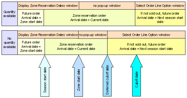

Standard Zone Reservation Rules
If the Use Alternate Zone Reservation Logic (I52) system control value is unselected, items which are eligible for zone reservation processing in order entry follow these rules based on the current date:
Prior to the season start date:
- The order line is taken as an open order, but is not reserved.
- The backorder status = F (Future order).
- The arrival date of the order = the zone start date.
- The system presents the Display Zone Reservation Dates Window if you have flagged the order type to display zone date windows.
After the season start date but prior to the zone start date:
- The backorder status = Z (Zone reservation).
- The arrival date of the order line = the current date.
After the zone start date but prior to the deferred cutoff date:
After the deferred cutoff date (backorder cutoff date) but prior to the cutoff date:
- If stock is available, the order follows the rule listed above.
- If stock is not available, the order line follows the rule below.
After the cutoff date, the Select Order Line Option Window presents two options:
- Sell out the order line
- Take the order line as a future order (backorder status = F) with an arrival date = the next season's start date
Future orders: An order line taken outside the season as a future order will have a future Arrival date and a backorder status of F (Future order). Future order lines are reserved or backordered during the Evaluate Future Orders periodic process. The order is then selected for pick slip generation when the zone opens, since this date is the arrival date for the order line.

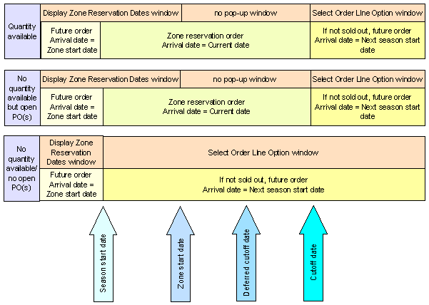

Alternate Zone Reservation Rules
- If the item has an available quantity or any open purchase orders:
- If the item has no available quantity or open purchase orders,
After the zone start date but prior to the cutoff date:
