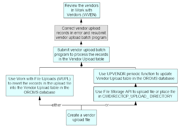

Vendor upload process:
You can also schedule this process to run periodically by setting up the VNUPLD function using the PRF0086 program. See Scheduling Jobs for background.In this topic:
- Create Vendor Upload File
- Transfer the Vendor Upload File to Order Administration
- Submit Vendor Upload Screen
- Vendor Upload Process
- Vendor Upload Errors
- Vendor Upload Table (VNDUPL)
- Vendor Upload Error Report
Use the File Storage APIand run the UPVENDR Upload Vendor File (Program name PFR0134, Parameter VNDUPL) periodic function, or
Use the Work with File Uploads (WUPL) menu option to select and process the Vendor Upload file. The system inserts the records in the Vendor Upload file into the Order Administration Vendor Upload table. See File Upload Process for processing information.
