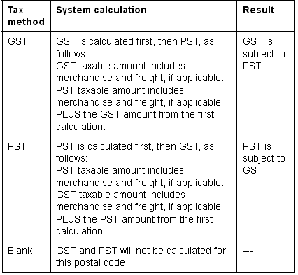

GST/PST method |
Determines the sequence in which the Canadian Goods and Services Tax (GST) and the Provincial Services Tax (PST) are calculated. If you do not define a calculation method, the system does not charge either GST or PST on orders to this SCF even if you have defined GST or PST rates. Valid GST/PST tax calculation methods:
Optional. |
