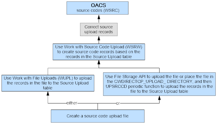

Once you upload records to the Source Upload table, you can use the Work with Source Code Upload File (WSRW) menu option to change, delete, or display source upload records and then transfer the records to the Source Code table.
When you transfer the source code records, the system validates each record in the Source Upload table:
- If a source upload record contains any errors, the system flags the record with a status of E and includes the record on the Source Code Upload File Exception Report. You can correct source upload records that are in an error status by selecting OK on the Change Source Code Upload File Screen (1 of 2).
- If a source upload record does not contain any errors, the system transfers the record to the Source Code table and displays the record on the Source Code Upload File Processed Listing. See Working with Source Codes (WSRC).
- Source code upload process: The following flowchart explains how the system creates a Order Administration source code using information defined in the Source Upload table.

Instructions:
Select Process File to submit the transfer from the Source Upload table to the Source Code table. A message indicates that the source code transfer has been submitted.
The job validates that:
- The value defined in the Source code field is unique for the company you are working in.
- The Company, Consumer/business, Freight method, House account code, Price method, Type, Description, Breakeven amount, Restricted, Display on O/E select, Division, and Offer fields contain information.
- The Consumer/business, Freight method, House account code, Price method, Type, Exclude service charge, Promotion pricing, Display on O/E select, Exclude from flexible option, Exclude promotion, Division, Promotion code, Offer, Source category, Freight table, FPO payment code, and Price table fields contain valid values.
If a record passes all of the edits performed, the system:
- prints the source upload record on the Source Code Upload File Processed Listing. This report lists all source codes created through the source code upload.
- creates a Order Administration source code. You can review or maintain the source code in Working with Source Codes (WSRC).
- deletes the record from the Source Upload table.
If a record does not pass all of the edits performed, the system:
- prints the source upload record on the Source Code Upload File Exception Report. This report lists all of the source upload records that contain errors.
- retains the source upload record in the Source Upload table until the record is fixed or deleted. You can correct errors that exist on a source upload record on the Change Source Code Upload File Screen (1 of 2).
