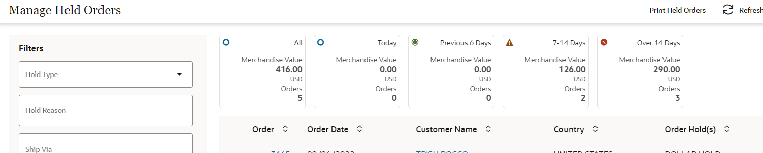

illustrates Manage Held Orders page

Held Order Summary Total Tiles
The tiles display the information below for the orders currently included in the Held Order List.
Period: Totals are displayed for the following periods:
  • All: The total number of orders and merchandise value for all orders matching the filter criteria, regardless of date. Includes a hollow blue circle (illustrates blue circle) icon in the upper left.
  • Today: The total number of orders and merchandise value for all orders matching the filter criteria that were initially created on the current date.
    • Does not include ship-tos or items added to existing orders that were created earlier than the current date.
    • Includes a hollow blue circle (illustrates blue circle) icon in the upper left.
    • The circle around the merchandise total for Today, if any, uses blue to indicate the percentage of the total open merchandise it represents for all orders matching the filter criteria; see the description of the Merchandise Value, below, for a discussion.
  • Previous 6 Days: The total number of orders and merchandise value for all orders matching the filter criteria that were initially created on the previous 6 days.
    • Does not include ship-tos or items if they were added to existing orders on the current date.
    • Includes a green bullseye (illustrates green bullseye) icon in the upper left.
    • The circle around the merchandise total for Previous 6 Days, if any, uses green to indicate the percentage of the total open merchandise it represents for all orders matching the filter criteria; see the description of the Merchandise Value, below, for a discussion.
  • 7-14 Days: The total number of orders and merchandise value for all orders matching the filter criteria that were initially created from 7 to 14 days before the current date.
    • Does not include ship-tos or items added to existing orders on the current date or the last 6 days. I
    • Includes a orange triangle (illustrates orange triangle) icon in the upper left.
    • The circle around the merchandise total for 7-14 Days, if any, uses orange to indicate the percentage of the total open merchandise it represents for all orders matching the filter criteria; see the description of the Merchandise Value, below, for a discussion.
  • Over 14 Days: The total number of orders and merchandise value for all orders matching the filter criteria that were initially created more than 14 days before the current date.
    • Does not include ship-tos or items added to existing orders on the current date or during the last 14 days.
    • Includes a red circle (illustrates red circle) icon in the upper left
    • The circle around the merchandise total for Over 14 Days, if any, uses red to indicate the percentage of the total open merchandise it represents for all orders matching the filter criteria; see the description of the Merchandise Value, below, for a discussion.
