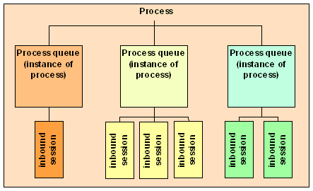

Inbound process structure: Underneath each inbound process at the Work with Integration Layer Process Screen are one or more process queues. Multiple process queues are useful for inbound messages, so that you can receive and process messages from more than one remote system. For example, you might receive inventory transactions from both a warehouse management system and a POS system.
When there are multiple process queues, each queue is an instance of the Inbound program for the process; however, each queue should have a unique Inbound job name so that you can identify and troubleshoot each process separately.
The # inbound sessions for each process queue can be one or more. For example, you might set the number of inbound sessions higher for the process queue that processes orders from your web storefront, to prevent delays; however, you might require only one inbound session for orders you receive from a remote order entry service, because you receive these orders at a scheduled time, and an immediate response is not required.

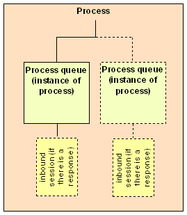

Outbound process structure: Underneath each outbound process at the Work with Integration Layer Process Screen are one or more outbound queues. Multiple outbound queues allow you to send outbound messages to more than one remote system. For example, you might send item information to your POS system and warehouse management system. If you define more than one outbound queue, the system creates a copy of the outbound message for each additional queue whose Enabled field is selected.
An outbound process requires an inbound session only when a response from the remote system is expected.
This image shows the outbound structure process
