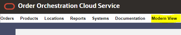

Advancing to Modern View
Advancing to Modern View: The Modern View option, enabling you to advance to Modern View, is available to the right of the Documentation drop-down at the top of the Classic View screen.
Illustrates the Modern View link at the far right of the drop-down menu options.

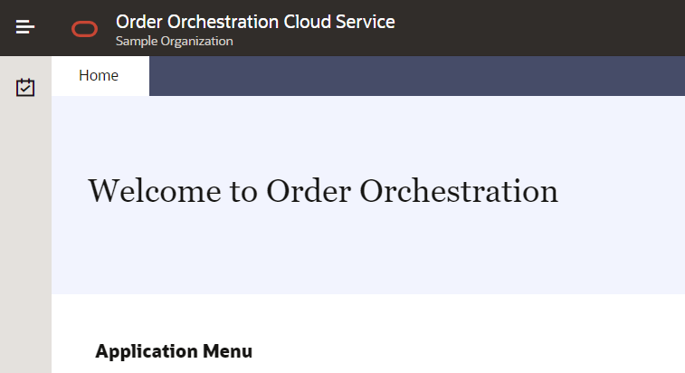

Illustrates the Modern View home screen.

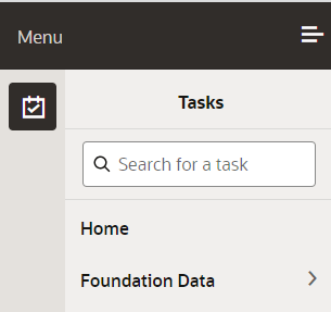

Menu and Tasks
Menu: In addition to selecting an option from the Modern View home screen, you can also expand the menu by expanding the icon in the upper left, and then use the menu options to advance to a specific option.
Illustrates the menu structure.
Select the Tasks icon (displayed below the word “Menu” in the above illustration) to expand the Tasks menu as illustrated above.
You can advance to a menu option by searching for it, or by selecting it from the Foundation Data menu. You can also return to the home screen from another screen by selecting Home.

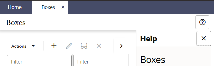

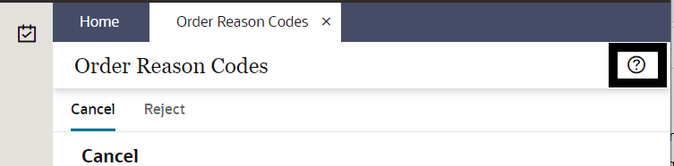

Screen-specific help: For each of the above screens, a screen-specific help option is available by clicking the help icon in the right of the screen title bar. The help panel slides open to the right.
Illustrates the help icon to the far right of the Order Reason Codes screen title.
The help topic then opens in a panel to the right of screen.
Illustrates the help panel open to the right.
You can close the help panel by selecting the X.

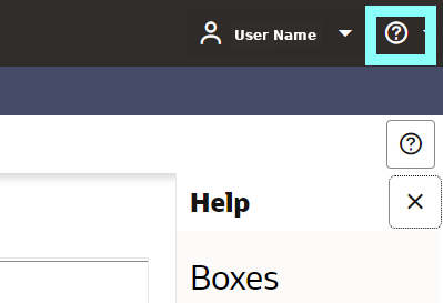

Entire help set: The entire Order Orchestration help contents, including both Modern View and Classic View screens and overviews, are available in two ways:
  • By clicking the help icon in the upper right corner of the screen, next to your user name.
    Illustrates the help icon next to your user ID.
  • Clicking the Help icon at the bottom of a screen-specific help topic (Illustrates the link to the full help set.) opens the entire help set with the current help topic displayed.

How to display this screen: Select Boxes from the Modern View home screen. See the Modern View Overview for background.
Only users with Boxes authority can display this screen. See Roles for more information.
Option Procedure
create a new box definition
  1. Optionally, select a different organization. See the Modern View Overview for background.
    You must complete the Preferences screen for an organization before you can select it.
  2. Select Add from the Actions menu or select the Add icon (Illustrates the Add icon.) to open the Add Box window.
  3. Complete each of the required fields, and optionally select any of the check boxes. See Fields at the Add Box, Edit Box, and View Box Windows, below, for details on fields.
  4. Select OK or press enter to create the box, or select Save and Add Another to continue creating boxes.

Order Reason Codes
Purpose: Use this screen to work with reason codes used by store associates or managers in Store Connect to:
  • reject a delivery, ship-for-pickup, or pickup order, or a line on a delivery, ship-for-pickup, or pickup order
  • cancel a pickup, ship-for-pickup, or delivery order, or a line on a pickup, ship-for-pickup, or delivery order
Cancel or reject reasons: Use the Cancel or Reject tabs at the top of the screen to work with either cancel reasons or reject reasons.
Auto Cancel Reason: You can also use this screen to create the Auto Cancel Reason to use when an unclaimed pickup or ship-for-pickup order is not picked up within a specified number of days. Note that you should not deactivate the Auto Cancel Reason code specified at the Preferences screen. See Auto-Cancel Unclaimed Orders for background.
Using an API to work with order reason codes: You can also use an API to create, update, review, count, or delete order reason codes. See the Web Services Guide on My Oracle Support (2953017.1) for more information.
How to display this screen: Select Order Reason Codes from the Modern View home screen. See the Modern View Overview for background.
Only users with Order Reason Codes authority can display this screen. See Roles for more information.
Option Procedure
switch between Cancel and Reject reason codes
Use the Cancel and Reject tabs below the screen title to switch between the two types of order reason codes.

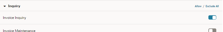

    At this tab, individual feature and menu authority assignments are grouped under different menu headings. See the Menu Authority Fields, below, for details.
    • To assign or remove authority to an individual feature or menu option, such as Invoice Inquiry in the Inquiry group, use the Allow flag.
      Illustrates selecting a single menu option.
    • To assign or remove authority to an entire group of features or options in a group, such as the Inquiry group, select Allow or Exclude All.
      Illustrates selecting an entire group, such as the Inquiry group.

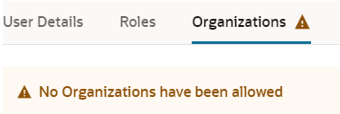

No organizations allowed? The tab indicates if the user is not currently assigned to an organization. Even if the user is flagged as Active, assignment to an organization is required to use Order Orchestration or Store Connect.
Illustrates the tab titles and message when the user is not assigned to any organizations.
