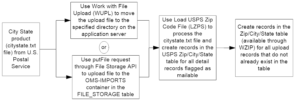

Upload Process
- Download the City State Product from the USPS web site.
- When you receive the City State product:
- Use the putFile request message in the File Storage API to upload the file to the OMS-IMPORTS container in the FILE_STORAGE table; otherwise,
- Use the Work with File Uploads (WUPL) menu option to copy the data file to the location on your application server specified in the CWDIRECTCP_USPS_UPLOAD_ FILE property. The file name matching is case-sensitive.
- Use the Load USPS File
Screen to submit the LZPS job, which uses the contents of the
ctystate.txt
data file to create records in the Zip/City/State table if these records do not already exist. The job performs the following steps:- Deletes any existing records in the USPS Zip/City/State work table
and creates a record in this table for each eligible entry from the
ctystate.txt
data file. A record in the data file is eligible for upload if it is flagged with a D (detail) and is also flagged as mailable. See the Fields in the USPS Zip/City/State Table for mapping details. - Compares the data in the USPS Zip/City/State work table with the existing records in the Zip/City/State table. If a record in the work table does not exist in the Zip/City/State table, the job creates it.
