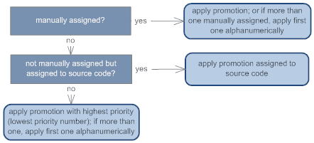

About Messaging Promotions
Purpose: You can use a promotion to display a pop-up message in order entry by:
- entering up to four lines of pop-up message text for the promotion code through the Work with Promotion Values menu option;
- assigning the promotion code to one or more source codes through the Work with Source Codes menu option.
When you have entered header information for an order whose source code is associated with the promotion, the promotional pop-up window opens. The window opens only for the range of dates you specify for the promotion. If you also set up pop-up window messages for the source code, this window opens first, and then the window with the promotion window opens.
Single promotion message: You can set up only one promotion message to display in order entry for each source code.
Message-only promotions through the order API: If the CWOrderIn message specifies a message-only promotion and the Allow Manual Entry of Promotion Code (I63) system control value is selected, the message-only promotion applies to the order and the API writes an Order Transaction History message, such as SPRING13 - CHECK OUT OUR SPRING SPECIALS applied by web. These messages are available for review at the Display Order History Screen. See the Generic Order Interface (Order API) for background on using the order API.
For more information see the Order Administration Web Services Guide on My Oracle Support (ID 2953017.1).
Message plus discount: You can set up a promotion that will both display a pop-up message and apply a discount to the order. See About Discount Promotions

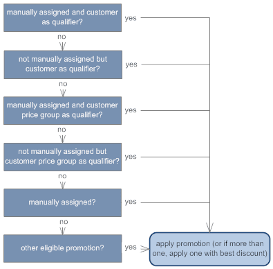

How does an order qualify? You can set up an order, freight, or additional freight promotion that will apply to every order you take; to do so, do not complete any of the qualifying fields for the promotion. The promotion can apply to the order as long as the current date falls within the date range specified for the promotion.
Use once?
For the other promotion types, or if you want to restrict an order, freight, or additional freight promotion to only certain orders, your selection criteria can include:
- source code (used on order header) or offer (associated with the source code used on the order header). You can also exclude source codes from a promotion by selecting the Exclude promotions field for the source code. Typically, you would exclude a source code from promotions when you have set up a promotion that specifies an offer, and you want to include most of the source codes associated with that offer except for a few.
- pay type (even if this pay type is not the only one on the order)
- merchandise total
- total item quantity (minimum or maximum)
- shipping location, such as restricting a freight or additional freight promotion to a range of SCF codes or to the continental U.S.A. (freight or additional freight promotions only)
- customer or customer price group
- order history (including first-time buyers who have never placed an order, or never received an order shipment)
- item categories
- ship via priority
Important:
The system evaluates promotion qualifiers on an “all or nothing” basis; in other words, if you set up a promotion to qualify based on source code, pay type, and merchandise total, and an order does not match all of these qualifiers, none of the discounts or overrides of the promotion will apply to the order. To apply the promotion to any order matching either the source code, pay type, or merchandise total, set up a separate promotion for each.See the Cautions Related to Promotions.

Promotion Hierarchy: Best Way
Best way promotion hierarchy: The Best Way Promotions (K44) system control value indicates whether to try to apply the promotion of each type (with the exception of BOGO promotions; see Best Way Promotion Hierarchy for BOGO Promotions specifically called out for the order or customer, or that provides the highest discount. With this system control value selected, the system uses three basic criteria:
- Manual entry? Manually-entered promotions (entered at the Enter Promotion Code Screen or passed in the inbound order message) are preferred over system-assigned promotions (applied automatically because the order is eligible and the Required entry flag is unselected). However, if the Allow Manual Entry of Promotion Code (I63) system control value is unselected, it is not possible to manually enter a promotion code.
- Customer or customer price group assignment? When you specify a customer price group for a promotion, the system prefers this promotion to those without a customer price group assignment. However, when you specify a particular customer number for a promotion, this gives the promotion higher priority than promotions with just a customer price group promotion.
- Best savings? If a promotion is not differentiated through manual entry, customer assignment, or customer price group assignment, the system selects the promotion of each type that provides the highest total discount dollar value. In the case of a freight promotion, a ship via override is determined to be the best value.
As a result, the system selects among eligible promotions using the hierarchy illustrated below:
If the Allow Manual Entry of Promotion Code (I63) system control value is unselected, manual entry of a promotion is not possible, so the hierarchy is simpler:
- Customer qualifier? Is the customer specified at the Work with Qualifying Customer/Price Groups Screen?
- Customer price group qualifier? Is the customer assigned to a customer price group specified at the Work with Qualifying Customer/Price Groups Screen?
- Best savings? If the customer does not qualify based on customer number or price group, or if the system must select among more than one promotion with the same qualifier, it selects the promotion of each type that provides the highest total discount dollar value.
When the Best Way Promotions (K44) system control value is selected, BOGO promotions do not use the same hierarchy as other promotion types; instead, they use a simpler hierarchy:
- Manually assigned? Manually-entered BOGO promotions (entered at the Enter Promotion Code Screen or passed in the inbound order message) are given higher priority than system-assigned promotions (applied automatically because the order is eligible and the Required entry flag is unselected). However, if the Allow Manual Entry of Promotion Code (I63) system control value is unselected, it is not possible to manually enter a promotion code.
- Assigned to source code: If there is a BOGO promotion specified for the source code and no other BOGO promotion was manually entered, the promotion from the source code applies. (The promotion must be manually entered or passed in the order API, or have the Required entry flag unselected, as described above.)
- Priority: If no BOGO promotions are manually applied or assigned to the source code, the system checks for BOGO promotions that are not flagged for Required entry. If there is more than one, the BOGO promotion with the highest priority (lowest priority number) applies. If the eligible BOGO promotions have the same priority number, the system applies the first one alphanumerically.
