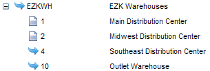

| Location Type | |
| Location |
                               A location. The location code is also displayed. Note: Rules assigned at the location level are eligible to be applied only if another activity, such as an inventory import, updates the product location.  |
                               Rule assigned? A blue
arrow ( Note: To refresh the display of the blue arrows based on your activity at this screen, close the Probable Quantity Location screen and re-enter. |
