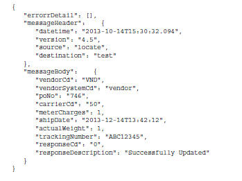

Sample setDSShipConfirm Response Message
The following sample indicates that the shipment was successfully confirmed.

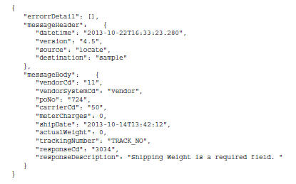

Troubleshooting the setDSShipConfirm Response
If the response does not include at least one purchase order, the responseCd
and responseDescription
indicate
the shipment confirmation was unsuccessful.
Sample Unsuccessful Response
The following sample indicates that the request did not specify a valid carrier associated with the vendor.
Response Codes and Descriptions
The following table lists possible response codes and descriptions returned if shipment specified in the request message could not be confirmed.

vendorcD | alphanumeric | The number assigned by the retailer to identify the vendor fulfilling the drop ship order. From the vendorCd in the setDSShipConfirm Request Message. |
vendorSystemCd | alphanumeric | The vendor system code assigned by the retailer. From the vendorSystemCd in the setDSShipConfirm Request Message. |
poNo | alphanumeric | From the poNo in the setDSShipConfirm Request Message.
carrierCd | alphanumeric | From the carrierCD in the setDSShipConfirm Request Message. |
meterCharges | numeric | From the meterCharges in the setDSShipConfirm Request Message. |
shipdate | datetime | From the shipDate in the setDSShipConfirm Request Message. |
actualWeight | numeric | From the actualWeight in the setDSShipConfirm Request Message.
trackingNumber | alphanumeric | From the trackingNumber in the setDSShipConfirm Request Message. |
responseCD | numeric | Set to 0 if the acknowledgement was successful. See Troubleshooting the setDSShipConfirm response on page 7- 2 for information on other possible response codes. |
responseDescription | alphanumeric | Set to Successfully Updated if the acknowledgement
was successful. See Troubleshooting the setDSShipConfirm response on page 7-2 for information on other possible response descriptions.
