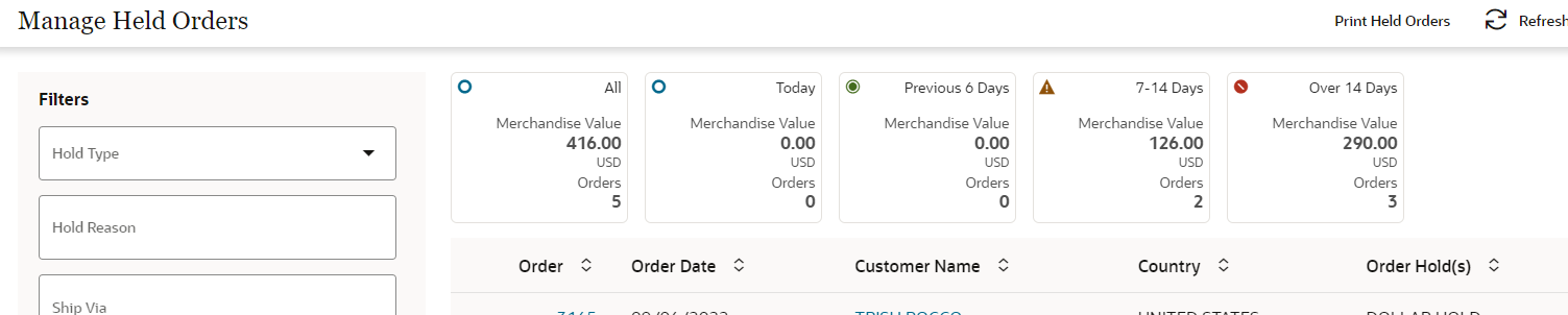

11 Manage Held Orders
Overview: Use the Manage Held Orders page to review held orders, including total open merchandise values and counts broken out by time period. You can also use this page to generate the Held Order by Reason Code report, or advance to the Customer Order List or Order Summary page.
How to display: Select Manage Held Orders from a menu, or click on the bar chart for a hold reason at the Held Order Summary page and select View Holds.
When you advance to the Manage Held Orders page from the Held Order Summary page, the held orders displayed on the page are filtered by the selected hold reason. It may take a few seconds for the filter to be applied.
All orders that are assigned the hold reason are displayed at the Manage Held Orders page, regardless of whether the hold was assigned by the system, or as a user hold.
Required authority: To advance to this page, you need full ALLOW (not DISPLAY) authority to the ERHO menu option. See Setting Up Menu Options (WOPT) in the Classic View online help for background.

Filter the Displayed Held Orders
Apply one or more of the Filters and click Filter to update the Held Order List and the Held Order Summary Total Tiles. If you apply multiple filters, only orders that match all filters are displayed; however, filtering on order number or customer number overrides other filters. See the list of Filters for more information.
Optionally, click Reset to clear the currently entered filters. You can then click Filter to display all held orders.

Filters
Hold Type: Filters the Held Order List to orders that have that hold type applied. Can select one type.
Hold Reason: Filters the Held Order List to orders that have the selected hold reason code(s) applied. Can select one or more, clicking Filter after selecting each hold reason, to select orders that have each selected hold reason applied. If necessary, click to the right of any hold reason that has already been selected to display the list of additional hold reasons.
Filtering is not supported for the Awaiting Credit Card Auth (CW) hold, and this hold reason is not displayed in the Held Order List. If the CW hold is the only hold reason assigned to the order, the order is not displayed.Ship Via: Filters the Held Order List to orders that use the selected ship via(s), including any ship-tos for an order with multiple ship-tos. Can select one or more ship vias, clicking Filter after selecting each ship via. If necessary, click to the right of any ship via that has already been selected to display the list of additional ship vias.
Country: Filters the Held Order List to orders whose sold-to customers have addresses in the selected country(ies). Can select one or more countries, clicking Filter after selecting each country. If necessary, click to the right of any country that has already been selected to display the list of additional countries.
New Customers Only: Select to filter the Held Order List to orders whose sold-to customers were newly created for the held orders. The ship-to customer is not considered for filtering.
Date From: Filters the Held Order List to orders created on or after that date. Can select or enter a date that is not later than the To date.
Date To: Filters the Held Order List to orders created on or before that date. Can select or enter a date that is not earlier than the From date.
Order Number: Filters the Held Order List to the entered order. Can enter a single order. When you specify an order number, any additional filters are ignored.
If you enter a 4-digit number in a date field, your entry is interpreted as the year, and the current day and month are filled in. For example, if you enter 2022 and the current date is April 1, the date is filled in as 4/1/2022, depending on the date format for your locale.Customer Number: Filters the Held Order List to orders where the specified customer is the sold-to customer. Can enter a single customer number. When you specify a customer number, any additional filters besides order number are ignored; the results are filtered based on order number if you enter both a customer number and an order number.
Use one or more of the above filters and click Apply Filters to restrict the displayed orders, as well as the totals displayed in the summary tiles, to those matching your selections.
The tiles display the information below for the orders currently included in the Held Order List.
Period: Totals are displayed for the following periods:
- All: The total number of orders and merchandise value for
all orders matching the filter criteria, regardless of date. Includes
a hollow blue circle (
) icon in the upper left.
Today: The total number of orders and merchandise value for all orders matching the filter criteria that were initially created on the current date.
Does not include ship-tos or items added to existing orders that were created earlier than the current date.
Includes a hollow blue circle (
The circle around the merchandise total for Today, if any, uses blue to indicate the percentage of the total open merchandise it represents for all orders matching the filter criteria; see the description of the Merchandise Value, below, for a discussion.
Previous 6 Days: The total number of orders and merchandise value for all orders matching the filter criteria that were initially created on the previous 6 days.
Does not include ship-tos or items if they were added to existing orders on the current date.
Includes a green bullseye (
The circle around the merchandise total for Previous 6 Days, if any, uses green to indicate the percentage of the total open merchandise it represents for all orders matching the filter criteria; see the description of the Merchandise Value, below, for a discussion.
7-14 Days: The total number of orders and merchandise value for all orders matching the filter criteria that were initially created from 7 to 14 days before the current date.
Does not include ship-tos or items added to existing orders on the current date or the last 6 days. I
Includes a orange triangle (
The circle around the merchandise total for 7-14 Days, if any, uses orange to indicate the percentage of the total open merchandise it represents for all orders matching the filter criteria; see the description of the Merchandise Value, below, for a discussion.
Over 14 Days: The total number of orders and merchandise value for all orders matching the filter criteria that were initially created more than 14 days before the current date.
Does not include ship-tos or items added to existing orders on the current date or during the last 14 days.
Includes a red circle (
The circle around the merchandise total for Over 14 Days, if any, uses red to indicate the percentage of the total open merchandise it represents for all orders matching the filter criteria; see the description of the Merchandise Value, below, for a discussion.
Merchandise Value: The total current merchandise value for the held orders currently included in the Held Order List for the period.
About currency: If the Multi Currency by Offer (E03) system control value is selected, the merchandise balances are converted into the Local Currency Code (A55) by multiplying the order’s total open merchandise balance by the conversion rate defined for the currency through Work with Currency (WCUR). For example, if the order currency is US dollars, the local currency is the Euro, and the current conversion rate is .9, then an order total of $100.00 is converted to a total of 90 Euros. Note that this is the conversion rate is recorded in the Order Header Extended table when the order was created.
Otherwise, if the Multi Currency by Offer (E03) system control value is not selected, the merchandise balances for the orders are not converted. In the above example, the order merchandise total of $100.00 is used to calculate the total open merchandise value, even if other orders included in the total used different currencies.
Note that the Held Order by Reason Code report lists amounts in the order currency, and is broken out by currency. See Held Order by Reason Code Report Contents for more information.
Updates to an existing order: When you change an existing order, such as adding any items or ship-tos, the merchandise value increases for the period that includes the original order date. For example, if you add an item to an order created yesterday, its merchandise total is included in the Previous 6 Days period.
Orders: The total number of held orders included in the Held Order List for the period. Orders with multiple ship-tos increase the count by just one.
Held Order List
Shows the held orders matching any currently-applied filters. Displayed in ascending order by date (newest to oldest) and then by order number (lowest to highest, if the order numbers were not assigned in chronological order).
Order (Order Number): Click the order number to open the Order Summary page for the order.
Customer Name: Just the customer’s first and last names are displayed; but if there is no last name, the company name is displayed. Click the customer’s name to open the Customer Order List for the customer.
New customer indicator: The word NEW indicates that no previous orders have shipped to the sold-to customer.
Country: Just the country description is displayed.
Order Hold(s) (Hold Reason): The description of each hold reason assigned to the order is displayed.
- If the hold is assigned to a specific ship-to on a multi-recipient order, the ship-to number is displayed in parentheses.
- If there is a pay type hold related to a specific credit card, such as a miscellaneous fraud match, the payment type description is displayed, and the last 4 positions of the credit card are displayed in parentheses.
(User) appears to the right of the hold reason description for a user hold.
- A hold reason of [object Object] indicates that the system assigned a hold reason code that has not been configured in the Work with Order Hold Reason Codes (WOHR) menu option in Classic View. Use the Classic View menu option to review the order hold reason and create the hold reason code to resolve the issue.
- The Awaiting Credit Card Auth (CW) hold reason is not displayed.
