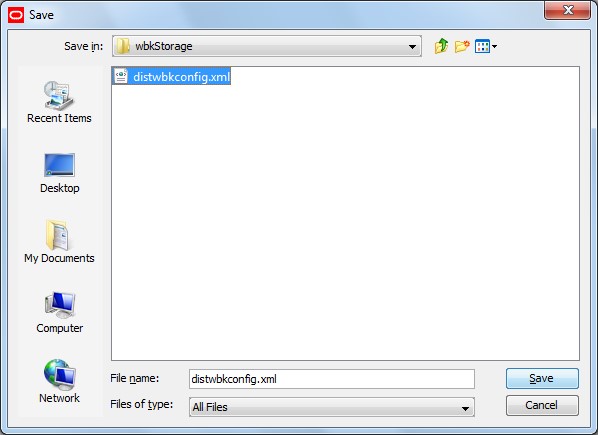

Creation of New Resource
Perform the following steps to create a new resource.
Upon launching the Deployment Tool from the Utilities menu of the Configuration Tool, the user will select to create a new resource of the desired type.
Using the UI controls present in the view designed for the desired resource, the user will enter the information contained within the resource.
The user saves the created resource as a file on the user's local system.

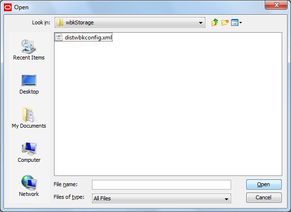

Modification of an Existing Resource
Perform the following steps to edit an existing resource.

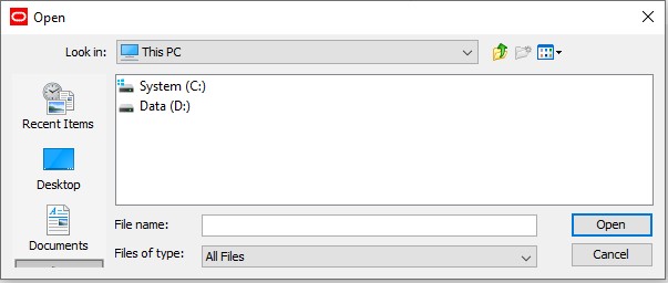

The original resource file must be transferred from the system containing the RPASCE application to the user's local system.
Upon launching the Deployment Tool from the Utilities menu of the Configuration Tool, the user will select to open an existing resource of the desired type. When prompted by the tool, the user will select the file on their local system.
Figure 12-2 Open Window for Opening an Existing Resource
Description of "Figure 12-2 Open Window for Opening an Existing Resource" -
Using the UI controls present in the view designed for the desired resource, the user can inspect the content of the resource and modify it as desired.
The user saves the modified resource to their local system.

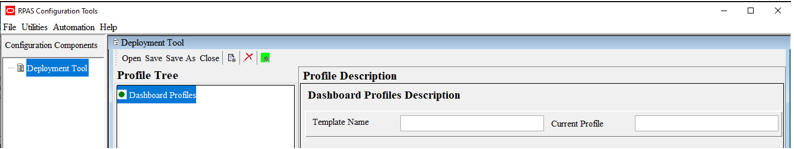

User Interface
The Configuration Tools is extended with an option to open the Deployment Tool. This option is accessed as a menu item in the Utilities menu of the Configuration Tools workbench. Once opened, the Deployment Tool is represented within the Configuration Manager tree to allow users to navigate between it and any other open tools. Selecting the Deployment Tool menu item when the tool is already open will cause the tool to close; if any resource is currently being edited within the tool, the user will be prompted to save this resource before closing.

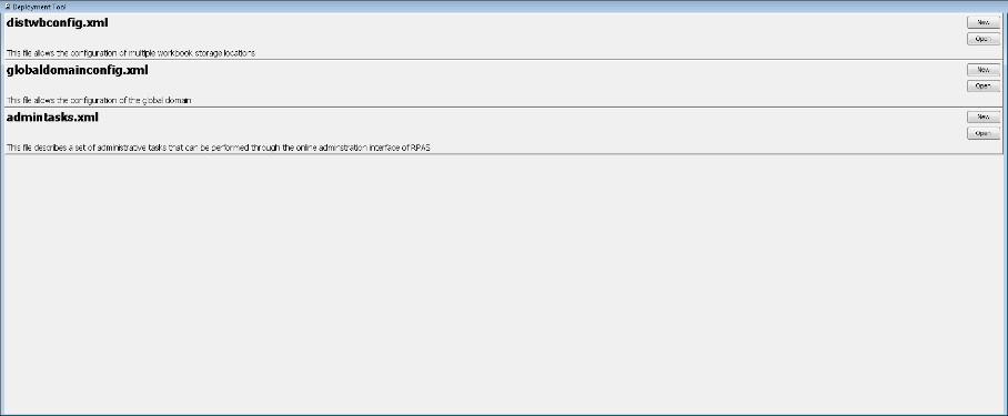

When first opened, the Deployment Tool presents the user with the set of deployment resources it supports. For each resource, the user can select between creating a new resource and opening an existing resource file.
When a new resource is created or an existing resource is opened, the Deployment Tool changes to present a resource-specific set of UI controls that can be used to specify the information for that specific resource. The user can then modify the resource and upon saving the specified information will be translated into the appropriate format. The functionality of each of these resources is described in detail in the following pages.
Navigate: In the Configuration Tools workbench pane, select Utilities and then Deployment Tool.
Result: The Deployment Tool window opens in the workspace.

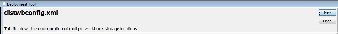

Deployment Tool - Distributed Workbook Storage
The initial resource to be implemented within the Deployment Tool
is Distributed Workbook Storage or distwbconfig.xml
. This resource is used to specify the locations of some storage
locations across which workbooks created for a application can be
balanced.
The initial set of workbook storage locations can be supplied at PDS creation time in the form of an XML resource. The Deployment Tool will allow users to specify the information required by this resource and will use that information to create the XML resource file on the user's local system so that it can be migrated to the RPASCE application host system and used.
Creation of a New Resource

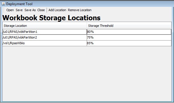

To configure a new workbook storage location resource, click New located in the upper right-hand corner of the distwbconfig.xml
resource.
Figure 12-5 Distributed Workbook Storage Resource
Description of "Figure 12-5 Distributed Workbook Storage Resource"

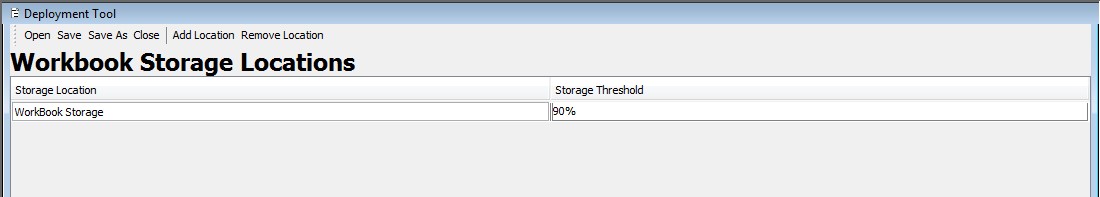

The Workbook Storage Locations window opens in the workspace.
The Workbook Storage Locations Window
Figure 12-6 Workbook Storage Locations Window
Description of "Figure 12-6 Workbook Storage Locations Window"
Upon creating a new storage location or upon selecting an existing partition, users will set values for the following attributes:
Storage location root – The location on drive that will serve as the root of the workbook storage
Storage location threshold – A threshold (in disk usage percentage) beyond which the storage location will not be used for the creation of new workbooks.
Figure 12-7 Workbook Storage Locations Thresholds Window
Description of "Figure 12-7 Workbook Storage Locations Thresholds Window"

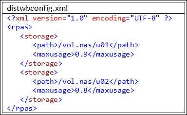

Contents of distwbconfig.xml Resource
As part of the deployment information managed by Configuration Tools, design requires an extra configuration file “distwbconfig.xml" to be created. This file should contain the complete information of the distributed workbook storage, including its root directory and various parameters it may have. Meanwhile, the format of the file conforms to other similar configurations we already have.
Top node of <rpas> is needed to conform to other RPASCE configuration files. Within <rpas> tag, the <storage> tag is used to specify the settings of each workbook storage location. There can be multiple entries for <storage> within the <rpas> tag.
Within each <storage> tag, currently we require two tags:
<path> tag specifies the root directory of the distributed storage. This root directory must exist otherwise RPASCE considers the configuration as invalid and throws exception when it parses this file. However, it is not necessary for the directory to be empty at the application creation time since such storage device can be shared by multiple RPASCE applications.
Usually, the directory specifies the path that is outside the root of the global application, where the extra storage is mounted. Note that if the RPASCE administrator also wants to save workbooks under the application as before, a workbook storage location must be added where the parent directory of the application is specified in the <path>.
<maxusage> tag specifies the max usage level for the storage. If the workbook size stored in this storage location grows over this threshold, RPASCE does not allow new workbooks to be in order to prevent possible disk full failure. The level is represented as a percentage of the total volume of the storage. When specifying the safe level, we should keep in mind that workbook size usually doubles when opened due to the checkpoint directories. As a result, the administrator should allow extra room in the max usage level so that it is buffered against workbook open action. The actual percentage also depends on the typical workbook size of the application and the total storage capacity. If the typical workbook size is small while the storage device is larger, the max usage level can be higher in percentage, and vice versa.

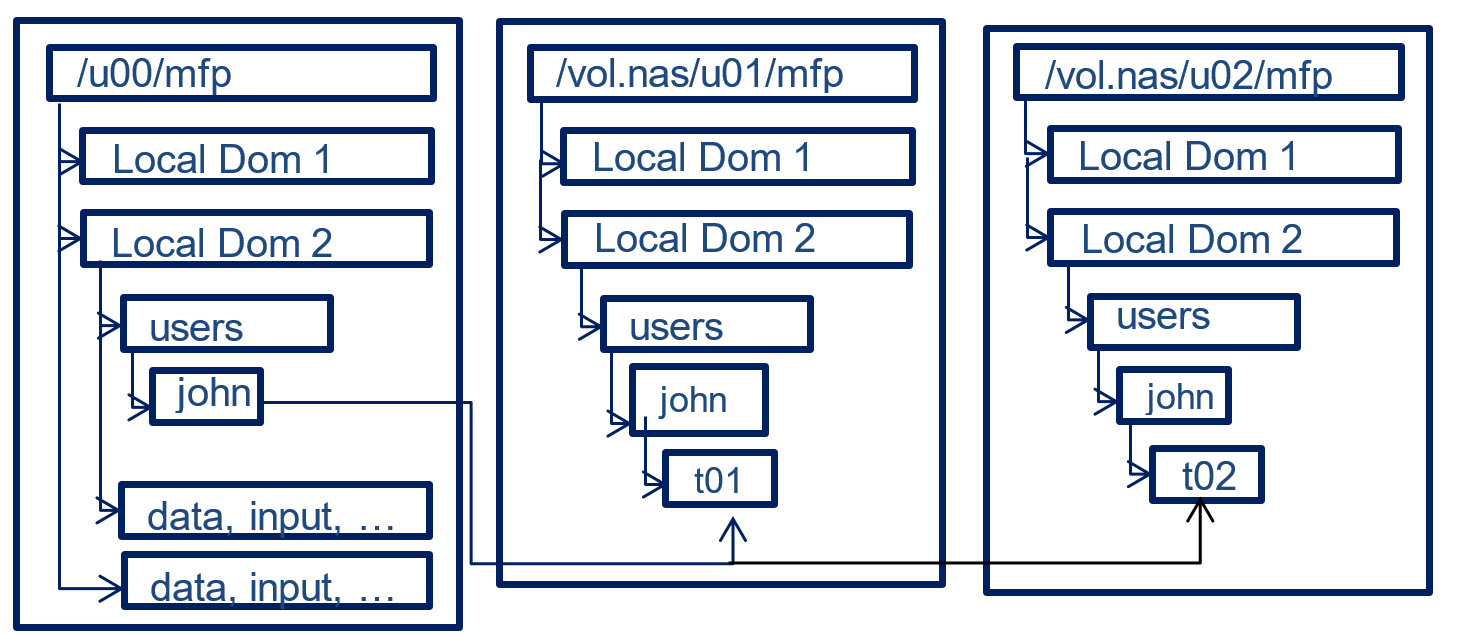

Directory Structure of the Distributed Workbook Storage
In the configuration file, the RPASCE administrator specifies the root directory of the distributed storage, which must be an existing directory. RPASCE will manage the directory structure beneath the root directory such that it reflects the same directory structure as in a regular RPASCE application, including a directory for master application, all local application directories under the master application, users and user-id directory under each application. Eventually the workbooks will be stored within the user-id of the workbook owner.
These are the reasons to maintain similar directory structures:
The distributed storage may be shared by multiple RPASCE applications. So, the master application is needed as a direct subdirectory within the distributed storage root.
RPASCE workbook names are unique within a single application, but not unique across applications. Both ldom1 and ldom2 may have workbook t00001, though they are completely different workbooks. The local application path is put right beneath the master application directory.
In the original RPASCE application, the local application storage may be partitioned using globaldomainconfig.xml so that each local application may use a different storage. Here, since we are in the distributed storage already, no need to further complicate the local application directory. All local application subdirectories within a master application are located on the same directory level.
In other RPASCE functionality, such as workbook copy, RPASCE assumes the workbook's parent directory is the user-id and users of the application. So, the users/user-id directory must also exist in the distributed storage directory structure.
Figure 12-9 shows the directories of a Merchandise Financial Planning application with two distributed storage locations assigned to it, and a user ,john, who has already built two workbooks in a local application:
Figure 12-9 Example of Distributed Storage Directories
Description of "Figure 12-9 Example of Distributed Storage Directories"
If no distributed workbook storage is specified for the application, workbooks are saved exactly as before.
If the RPASCE administrator put the root directory of the application as an entry for distributed workbook storage, together with other distributed storage locations, the existing application directory will be used to store workbooks as well. The only caveat here is that RPASCE might create ldom0 right beneath the master application’s directory to store the workbook but the real local application ldom0 with its data, input, and so on, may be stored in another location as specified by globaldomainconfig.xml.
Since RPASCE only requires the root directory to exist at the time of configuration, RPASCE automatically creates any subdirectories on demand when a new workbook is to be stored in the distributed storage. As a result, actions such as adding new user, adding new local application, removing user, or removing a local application have no impact on the directory structure of the distributed storage. When a user is removed from the application, all workbooks belonging to this user are removed from the application, and from the distributed storage, but the user's directory will stay in the distributed storage, though it must be empty. When a new user is added to a application, the user's directory is created in the application, but not in the distributed storage. Only when this new user builds a new workbook, is the user's directory created in the distributed storage.
Note that the storage location should not reside inside a application or any other places which may be moved or deleted frequently or outside of the control of RPASCE. In that event, the application loses access to the workbooks in that storage.

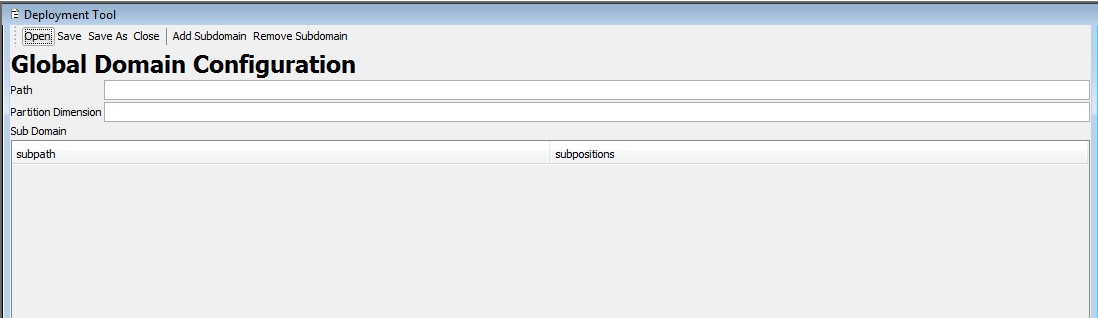

Deployment Tool – Global Domain Configuration
This release of the Deployment Tool will include support for the creation and maintenance of the domain partitioning resource called globaldomainconfig.xml. This resource is used to specify the path to the master domain, the partition dimension in the master domain, the path to the sub-domains and the list of positions, from each sub-domains, on the partition dimension.
Figure 12-10 Global Domain Configuration Resource
Description of "Figure 12-10 Global Domain Configuration Resource"
To configure a new workbook storage location, click New located
in the upper right-hand corner of the globaldomainconfig.xml
resource. You are taken to the Global Domain Configuration window.
To access an existing resource, click Open located in the
resource. You are presented with the files saved on their local
system.

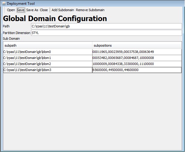

To add a sub-domain, click Add Subdomain.
Figure 12-11 Global Domain Configuration Window
Description of "Figure 12-11 Global Domain Configuration Window"
To remove a sub-domain, the user clicks the Remove Subdomain menu option.
To access an existing resource the user clicks the Open button located in the upper right-hand corner of the globaldomainconfig.xml resource. The user is presented with the files saved on their local system.
The initial set of globaldomainconfig can be supplied at domain creation time in the form of an XML resource. The Deployment Tool will allow users of the Configuration Tool to specify the information required by this resource and will use that information to create the XML resource file.
When opening an instance of this file, the user will be presented with the path to the master domain, the partition dimension in the master domain, the path to the sub-domains and the list of positions, from each sub-domain, on the partition dimension. When creating a new resource, all this information will be empty. Upon creating a new global domain configuration or upon selecting an existing global domain configuration, users will be able to set values to the following attributes:
Path - The path to the master domain
Partition Dimension – how each of the local domain must be partitioned based on position groupings.
Subpath – the path to the sub-domain
Subpositions – the list of positions, in each sub-domain, on the partition dimension.
Figure 12-12 Global Domain Configuration Sub-Domains
Description of "Figure 12-12 Global Domain Configuration Sub-Domains"

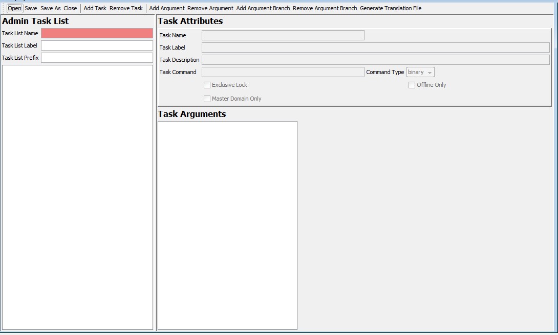

Administrative Task View
A new view has been added to the Deployment Tool to support the configuration of administrative task resources. This view is used to create a standard set of tasks packaged as a part of RPASCE, by creators of applications to create application specific tasks and by customers and/or implementers to create task resources for implementation specific tasks.
The new view supports creating new resources or opening and modifying existing resources. When a resource is created or opened, users of the Deployment Tool will be presented with a set of controls to create, modify, or remove the functional elements of the administrative task resource.

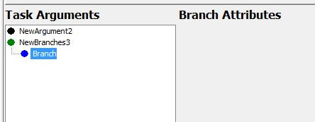

Within the view, users create and modify administrative tasks. New tasks are created through a menu bar action; existing tasks may be inspected or modified by selecting them from the administrative task list on the left side of the view. When viewing an existing task, additional menu bar actions allow the creation of arguments, argument lists and argument branches. A final set of menu bar actions will allow the removal of existing tasks, arguments, argument lists or argument branches.
Once a task is selected, the upper area of the view allows inspection and modification of task properties. Underneath the task properties is a navigation tree to allow selection of arguments, argument lists and argument branches. The center component under the task properties will be a set of controls to specify the properties of the selected argument, argument list or argument branch.

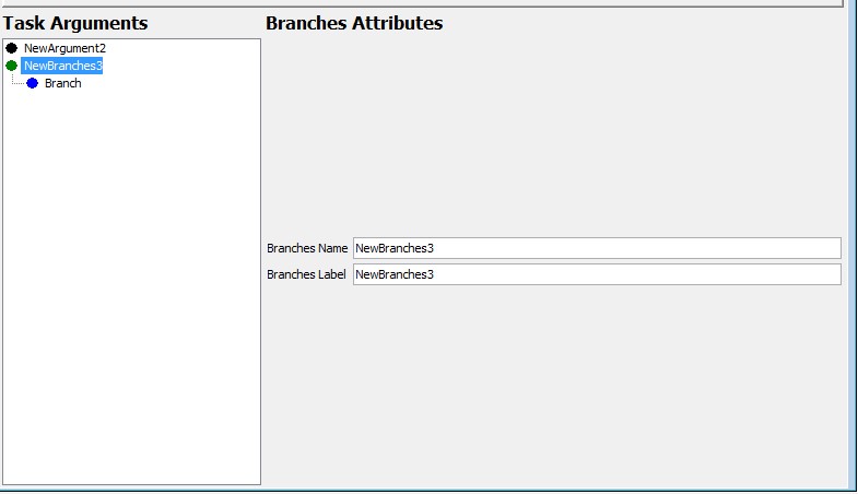

argument-branches
argument-branch
argument

Admin Task List Element
Every administrative task resource will have as its root element the <rpas> element that is common to all rpas XML resources. This root element will contain a single child element, the admin-task-list element. The admin-task-list is primarily a container for the admin-task elements contained within the resource but will does support the following properties:
label – a user label used to describe the tasks contained within this resource

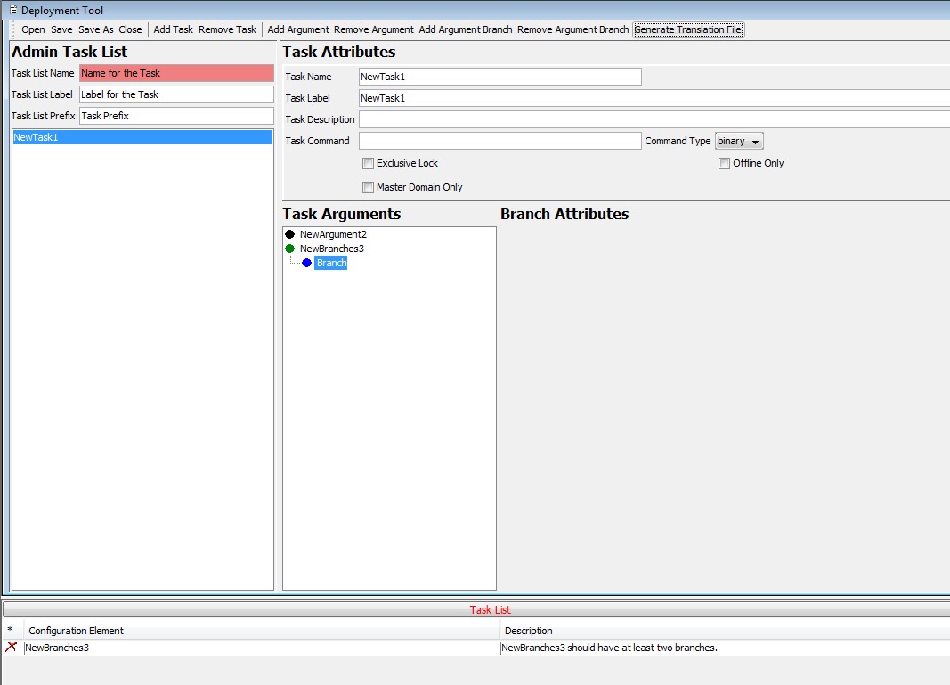

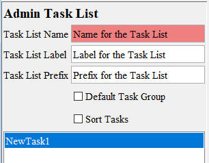

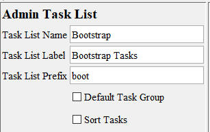

Create a New Task
Upon creating a new task, you can set values for the following values:
Task List Name. Text field for entering the name of the Task List.
Task List Label. Text field for entering the label of the Task List.
Task List Prefix. Text field for entering the prefix for the Task List.
Default Task Group. If the check box is selected, then a default task group in the Select Task page in RPASUI can be selected.
Sort Tasks. If the check box is selected, then the tasks within the task list will be sorted by task labels.
After the values have been entered, the user clicks Add Task to add the new task to the Task List.
Adding a new or selecting an existing task loads the properties of that task into the Task Attributes panel and populates the Task Arguments tree with the arguments (if any) defined for that task.

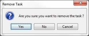

Remove a Task
This removes the currently selected administrative task from the list of tasks contained within this adminTasks resource.
Figure 12-16 Admin Task List with Task Selected for Removal
Description of "Figure 12-16 Admin Task List with Task Selected for Removal"
Click Remove Task and the confirmation window opens.
Click Yes to remove the task and the task is then removed from the Admin.

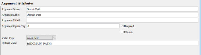

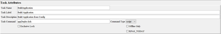

Task Attributes Element
Each admin-task element represents a single administration task that can be launched through the online administration interface. These elements represent an RPASCE executable or executable script. The contents of the admin-task element define the task and its properties. Each admin-task element supports the following properties:
Task Name – a user name identifying the administrative task
Task Label – a user label identifying the administrative task
Task Description – a longer description of the activity performed by this task
Task Command – the command performed by this task
Command Type –whether the command is an executable binary or script
Exclusive Lock – checked if the command requires an exclusive lock on the application; unchecked otherwise
Offline Only - checked if the command requires all currently active DBServer processes to be halted prior to execution of the task; unchecked otherwise
The administrative task view of the Deployment Tool allows users to configure values for each of the previous attributes. It will also allow users to create the argument-list element that describes the arguments to the command represented by the admin-task element.
Task Argument List Element
The argument-list element is used to describe the group of argument elements that make up the set of parameters passed to a command within an administrative task. The argument-list has no properties; it serves as a container for argument elements.
Argument Element
The argument element contains the definition of a single argument passed as a parameter to a command within an administrative task. Each argument element contains a set of properties that describe the usage and appropriate values for the argument. These properties are:
Argument Name – a user name identifying the argument.
Argument Label – a user label identifying the argument.
Argument Option Tag – the argument flag (an example is –d).
Required – checked if the argument is required, unchecked if the argument is optional.
Editable – unchecked if the argument can be modified within the Administrative Task Workbook, checked if the argument is fixed.
Value Type – User can select one value type from the drop-down list that contains the following terms: simple text, single select sort list, multi select sort list, switch-only, single select unsort list, multi select unsort list, text, date, datetime. For arguments that have a switch-only value of 0, this property holds a value for the additional parameter. If the value of the editable property is 1, then this value is a default that may be modified within the Administrative Task Workbook. If the value of the editable property is 0, then this value is fixed.
Default Value – Specify the default value.
To add an argument the user clicks on Add Argument. The Argument Attributes Window is opened in the workspace.
The argument is added according to the following rules:
If the argument tree has no selection or if the current selection is an argument not contained within an argument branch, the argument will be added to the argument list of the task.
If the current selection is an argument contained within an argument branch or is an argument branch, the argument will be added to the argument list of the argument branch.
Argument Branch Element
In order to support the use of RPASCE utilities that have multiple valid sets of arguments, the argument list element also allows the definition of an argument-branches element. Each argument-branches element represents a choice between sets of arguments. Argument-branches elements then in turn contain an argument element and, optionally, an argument-list element representing the arguments required by the utility when that usage of the utility is required.
As an example, consider the loadhier utility. This utility can be used to perform multiple operations:
loading a single hierarchy data file, executed by the –load operation
loading multiple hierarchy data files, executed by the –loadAll operation
purging hierarchy data, executed by the –purgeAll operation
In order to support the previous commands, the task definition for the loadhier utility would require an argument-branches element with three child argument-branch elements, one describing the usage for each of the three commands. When using the Administrative Task Workbook, the user would be required first to select the desired command and would then supply the information for the arguments associated with that argument list's arguments.
The argument-branch element is used to organize the arguments associated with one of the set of choices represented by an argument-branch element. Each argument-branch contains an argument element. This argument element represents the desired choice for the argument-branch. In cases where a choice in an argument-branch requires more than a single argument, an argument-branch may also optionally include an argument-list element containing the additional arguments for the branch.
To add an argument branch, the user clicks on Add Argument Branch. This adds a new argument to the currently selected administrative task and the Branch Attributes window opens in the workspace.
When creating argument-branches, it is required to have at least two argument-branch options. Otherwise, a configuration element error will be generated in the Configuration Tools Task List.
Figure 12-21 Task List Error Due to Only Creating One Branch
Description of "Figure 12-21 Task List Error Due to Only Creating One Branch"
To see the Branch Attributes, highlight the desired argument branch. Selecting an argument or argument branches will populate the Argument Attribute panel with the properties of the argument or argument branch.
Figure 12-22 Argument Attribute Panel (Populated)
Description of "Figure 12-22 Argument Attribute Panel (Populated)"
Remove Argument Branch
Select Remove Argument Branch to remove the currently selected argument branch from the argument list of the administrative task. If the branch to be removed is the only branch contained within its branches, the user is prompted to allow the now-empty branches to be removed as well.
Generate Translation File
Select Generate Translation File to create a pair of resource files within the directory containing the admintask.xml currently loaded into the UI. These files can be used to support translation of the content present within the admin task list.
Figure 12-23 Generate Translation File Button
Description of "Figure 12-23 Generate Translation File Button"
You are prompted to save the admin task prior to generating the translation file. This ensures that the translation file is saved in the same directory as the admin task list xml.

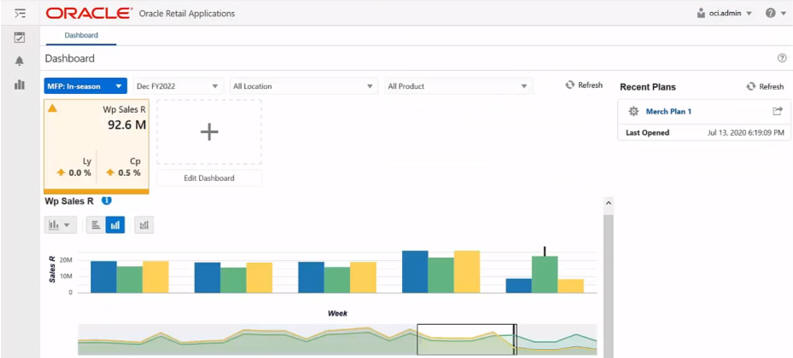

The RPASCE platform contains a home page that users view and interact with when logging into the system. This page is called the Dashbord, and it provides summary information in the form of health-check metrics about a user's plans as well as summary information about exceptions present in that user's area of responsibility.
The Dashboard provides at-a-glance information in order to offer guidance to the user about areas of their information that require attention. This allows users to better organize the time and effort they spend in the application.
Within the system, a Dashboard is a hybrid of a traditional workbook containing the information backing the display and a new view representation consisting of information provided in a set of tiles, each of which can be selected to provide supporting information. The supporting information is presented in charts that display lower-level information about the summary information presented within the tile.
Because the dashboard is a hybrid of traditional RPASCE workbooks and a new visual representation, the process of configuring an RPASCE Dashboard consists of two components. First, a workbook must be configured in the application that defines the data available within the dashboard and how it is created and maintained within that workbook. Second, a resource file that defines the presentation layer configuration that determines how that information is made available in the form of tiles. Their detail charts must be created and deployed to the client tier in a manner like existing taskflow resources.

To access an existing resource, click Open which is located in the upper right-hand corner of the DashboardSettings.json entry. The user is presented with the files saved on their local system.
Once a dashboard settings resource is opened, its contents will be loaded into the DashboardSettings.json View.

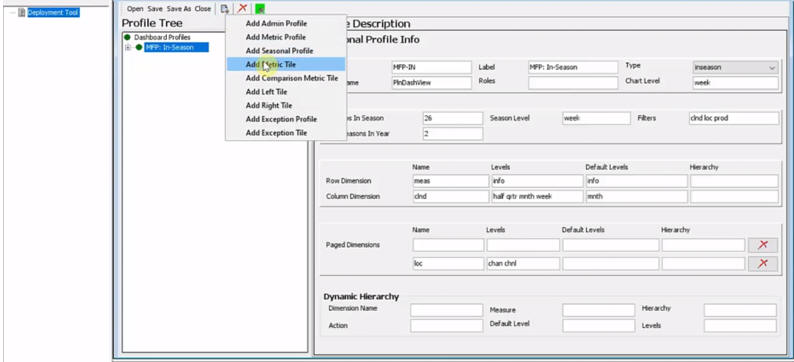

Within the DashboardSettings.json view, users are presented with a navigation pane on the left, containing a tree structure of the entities making up a dashboard settings configuration such as dashboard profiles and the tiles they contain. When an entity is selected within the navigation pane, its information is loaded into the content pane on the right. This allows users to view and modify that entity's information. Profiles and tiles can be created and deleted through actions present on the top toolbar.

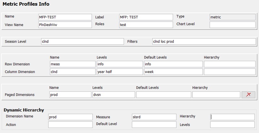

Metric Profile Element
A Metric Profile represents a collection of tiles containing metric information accessible by a user within the Dashboard. Each user typically has access to one or more profiles, depending on that user's role, and each profile aligns with an aspect of their role's responsibility. For example, users of planning applications may have access to both Pre-Season and In-Season Dashboard profiles that contain information about upcoming or current seasons, respectively. Users can select which of the profiles they wish to view through a selector control in the RPASCE Client.
Metric Profiles contain information in the form of tiles that provide summary information about their area of the business. This information often takes the form of Key Product Indicators or other health-check metrics such as actual performance versus performance in prior periods or versus the planned performance.
Metric Profiles contain not only the set of tiles that are associated with that profile but also a set of common information that defines how the Dashboard is presented when that profile is selected.
Figure 12-26 Metric Profile Information in the DashboardSettings.json View
Description of "Figure 12-26 Metric Profile Information in the DashboardSettings.json View"
The set of properties defined for a Metric Profile is:
Name–an internal identifier for the profile.
Label–the user facing label for the profile.
Type–the type of profile will be metric. This field is read-only.
ViewName–the name of the view configured in the dashboard workbook that supports this profile.
ChartLevel–the default level to use in filters for detail charts in this profile.
Filters–the whitespace-separated list of dimensions that must be presented as filters in the dashboard when this profile is being displayed. In order to accommodate positions with differing position label lengths, each dimension may optionally provide a width value in the format <dimension>:<length>.
Dynamic Hierarchy- used to create hierarchical roll-ups based upon the attribute values of positions.
Additionally, the view contains information describing how to lay out dimensions across the row, column, and page axes of the detail chart. Each profile contains one Row Dimension, one Column Dimension, and as many additional paged dimensions as are needed, based upon the intersection of the view configured in the View Name.
The properties defined for a dimension entry are:
Name–the name of the dimension being assigned.
Levels–the set of levels in the assigned dimension that must be made available in the chart filter controls.
Default Level–the initial level in the dimension that must be selected within the chart filter controls.

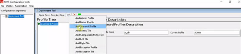

To add a new metric profile to the dashboard settings configuration, click Add Metric Profile action (located under Add) from the toolbar. A new profile entry is added to the navigation pane and selected in the content pane so that its information can be entered.
To remove an existing metric profile from the dashboard settings configuration, select the profile and click Remove from the toolbar. A confirmation window opens.
Click Yes to remove the current metric profile from the configuration.

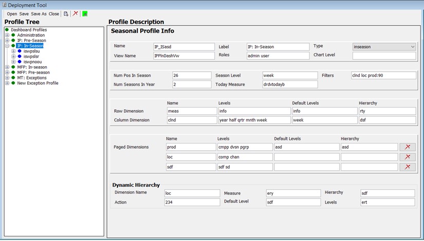

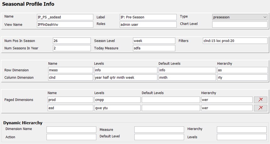

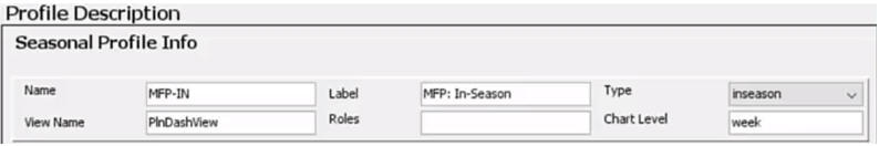

Seasonal Profile Element
The properties defined for a Seasonal Profile are:
Type–the type of profile. Supported types include preseason, inseason, and exceptions. Seasonal profiles must use either preseason or inseason from the drop-down field.
Num Pos In Season–the number of positions in the seasonLevel that make a season.
Num Seasons In Year–the number of seasons in a calendar year. In cases where the product of the numPosInSeason and NumSeasonInYear values does not align with a calendar year, the dashboard will build with a logged warning.
Dynamic Hierarchy–used to create hierarchical roll-ups based upon the attribute values of positions.
Figure 12-27 Seasonal Profile Information in the DashboardSettings.json View
Description of "Figure 12-27 Seasonal Profile Information in the DashboardSettings.json View"
To add a new metric profile to the dashboard settings configuration, click Add Seasonal Profile (located beneath Add) from the toolbar. A new profile entry is added to the navigation pane and selected in the content pane so that its information can be entered.
Click Yes to remove the current seasonal profile from the configuration.

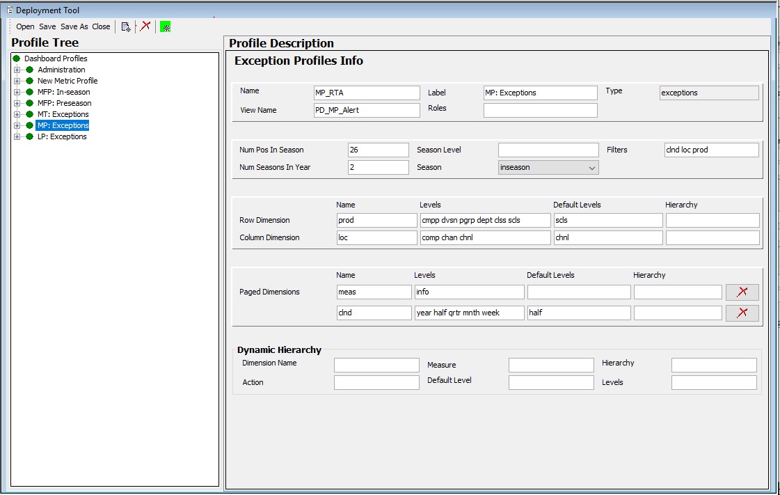

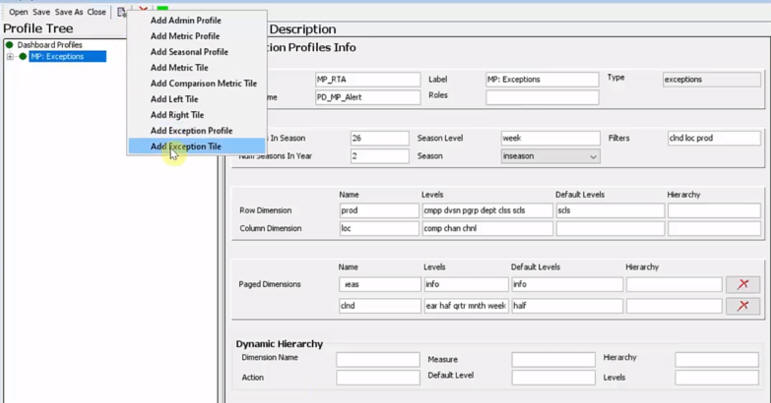

Exception Profile Element
An Exception Profile represents a collection of tiles containing exception information accessible by a user within the Dashboard. As with Metric Profiles, a configuration can contain multiple Exception Profiles, and different users may have access to one or more of the available profiles, based upon their role.
Unlike Metric Profiles, Exception Profiles containing tiles that report on the count and nature of exceptions as defined by the application are intended, in an exception-driven planning model, to provide guidance to the user about what aspects of the business require their time and attention.
Exception Profiles contain not only the set of tiles that are associated with that profile but also a set of common information that defines how the Dashboard as a whole is presented when that profile is selected.
Figure 12-28 Exception Profile Information in the DashboardSettings.jsonView
Description of "Figure 12-28 Exception Profile Information in the DashboardSettings.jsonView"
The properties defined for an exception profile are:
Label the user-facing label for the profile.
Type–the type of profile is exceptions. This is a read-only field.
seasonLevel - the level in the calendar dimension used to define a season in conjunction with the numPosInSeason and numSeasonInYear attributes (for example, week)
season - the seasonality timeframe that this Exception dashboard profile can show. This season property can be set to either inseason, preseason, or both. If none is specified, then this property defaults to inseason.
Filters-the whitespace-separated list of dimensions that must be presented as filters in the dashboard when this profile is being displayed. In order to accommodate positions with differing position label lengths, each dimension may optionally provide a width value in the format <dimension>:<length>.

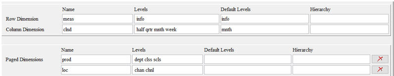

When created, a Dashboard Profile (Metric/Seasonal/Exception) contains no Page Dimension entries. Click Add Page Dimensions (inside the asterisk button from the tool bar) to add entries.
Click Remove (located within the page dimension entry) to remove Page Dimension entries for the Dashboard Profile (Metric/Seasonal/Exception).
Figure 12-29 Page Dimension Entry Showing Remove
Description of "Figure 12-29 Page Dimension Entry Showing Remove"
Level– the set of levels in the assigned dimension that must be made available in the chart filter controls.
Hierarchy–the hierarchy (for dimensions with multiple hierarchies) to be used within the filters of the dashboard.
To add a new exception profile to the dashboard settings configuration, click Add Exception Profile (located beneath Add) from the toolbar. A new profile entry is added to the navigation pane and selected in the content pane so that its information can be entered.
To remove an existing exception profile from the dashboard settings configuration, select the profile and click Remove in the toolbar. A confirmation window opens.
Click Yes to remove the current exception profile from the configuration.

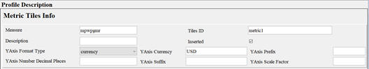

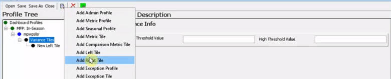

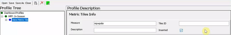

Metric Tile Element
A Metric Tile provides information about a specify KPI or other health-check information. Each tile provides the value of the corresponding metric scoped to the set of positions defined by the filters of the dashboard profile containing the tile. Each tile can support zero, one, or two supporting metrics to provide additional information about the main metric.
The configuration of a Metric Tile consists of supplying information about the metrics displayed in that tile as well as information used to create the detail chart that is displayed when that tile is selected in the Dashboard.
Figure 12-31 Metric Tile Information in the DashboardSettings.json View
Description of "Figure 12-31 Metric Tile Information in the DashboardSettings.json View"
The set of properties defined for a Metric Tile is:
Measure–the measure containing the information to be displayed in the metric tile and its supporting chart.
Inserted–true if the tile must be initially visible in the profile. Users may show and hide available tiles from within the Client.
Tiles ID - a string that serves as a unique identifier for the tile. This property can be used when more than one metric tile contains information for a single measure (for example, the same base value with different comparison metrics in each tile). This property is optional; if a value is not provided, the value for measure will be used. However, when multiple tiles use a single measure, the UI may not be able to provide the correct information for things such as tile description.
Description - a short description of the information provided by the tile that can be displayed in the tile info Window.
The Metric Tile element can contain yAxisFormat. For yAxisFormat properties, see "Configuring the Unit of Measurement Display in Dashboards".
To add a new metric tile to the current metric profile, select the metric and click Add Metric Tile action (located beneath Add) in the toolbar. A new tile entry is added to the navigation pane and selected in the content pane so that its information can be entered.
To remove an existing metric tile from the dashboard settings configuration, select the tile and click Remove in the toolbar.
The confirmation window opens.
Click Yes to remove the current metric tile from the configuration.

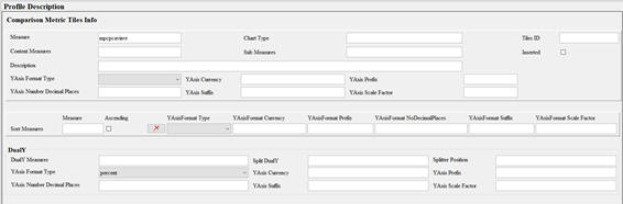

Comparison Metric Tile Element
The properties defined for a Comparison Metric Tile are:
Figure 12-32 Comparison Metric Tile Information in the Dashboard Settings JSON View
Description of "Figure 12-32 Comparison Metric Tile Information in the Dashboard Settings JSON View"
Measure–the name of the measure that is the primary metric displayed in the tile.
Content Measures –an optional list of measures to be used within the supporting chart for this tile. If no value is given, then the measures used in the tile will be displayed within the chart.
Chart Type–the type of chart to display for this metric tile. Supported values are bar and line.
Sub Measures–an optional list of measures to be displayed underneath the main metric within the tile. Space on the tile constrains the maximum number of subMeasures to three.
Sort Measures–an optional list of measures that can be used to sort the information displayed within the chart. The contents of the sortMeasures array are a list of JSON objects with the following properties:
Measure–The name of the measure that is used to order the chart.
Ascending–True or false, depending on whether the ordering must be ascending (true) or descending (false).
DualY–a JSON object used to support the use of dual-Y axis scales. By specifying the dualY property, it is possible to display a secondary set of values with independent scaling, either within the same chart as other measures or in a secondary chart displaying underneath the primary chart. The properties supported by DualY are:
measure – A list of measures to display in a splitY chart.
splitDualY– Either on or off. When on, the dualY measures displays in a separate chart. When off, a single chart with two y-axis scales will be displayed.
splitterPosition–When splitDualY is set to on, this value will provide the ratio of space on the y axis to be given to each of the displayed charts. Valid values are 0 to 1.
The Comparison Metric Tile element can contain yAxisFormat. For yAxisFormat properties, see "Configuring the Unit of Measurement Display in Dashboards".
To add a new comparison metric tile to the current metric profile, click Add Comparison Metric Tile (located beneath Add) in the toolbar. A new tile entry is added to the navigation pane and selected in the content pane so that its information can be entered.
To remove an existing comparison metric tile from the dashboard settings configuration, select the tile and click Remove in the toolbar.
Click Yes to remove the comparison metric tile from the configuration.

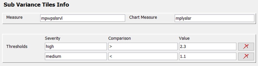

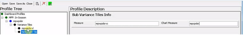

Within the Sub Variance Tiles Info panel is located the Thresholds entity. It has the following three fields:
Severity–sets the severity level to high, medium or low based on the severity
Comparison–sets the comparison operators (‘>', ‘<', ‘=')
Value–sets the severity value
Thresholds entry can be removed by clicking the Remove button () located within each threshold's entry.

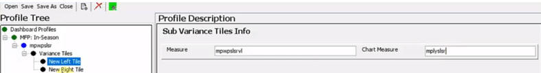

The properties defined for a Left Variance or Right Variance element are:
Measure–the measure containing the value to display in the tile and use for the evaluation of thresholds.
Plan–a short label to identify the supporting value in the tile.
Chart Measure–the measure whose data should be displayed within the detail chart for this tile when it is selected.
To add a supporting metric to a tile, select the tile's variance element and click either Add Left Tile or Add Right Tile (located beneath Add) in the toolbar (to create an entry for the left or right slots, respectively). A new left or right variance element is added to the navigation pane and selected in the content pane so that its information can be entered.
To remove an existing left or right variance element from the configuration, select the element and click Remove in the toolbar. A confirmation window opens.
Click Yes to remove the selected left or right variance element from the configuration.

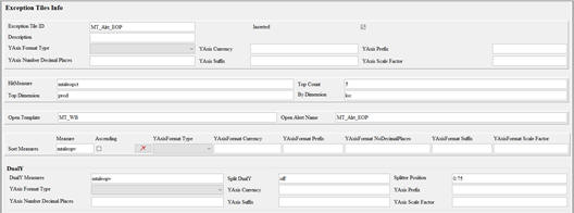

Configuring an Exception Tile consists of providing information about the exception to be displayed and optionally information to support the ability to launch from the Dashboard into the appropriate step and Real Time Alert to resolve the exception.
Figure 12-35 Exception Tile Information in the DashboardSettings.jsonView
Description of "Figure 12-35 Exception Tile Information in the DashboardSettings.jsonView"
The set of properties defined for an Exception Tile is:
Exception Tile ID–an internal name to identify the tile.
Hit Measure–the measure containing exception hit count information for the tile.
Top Count–the number of positions in Top Dimension to display within the detail chart for the tile.
Top Dimension–the dimension used to organize hit count information in the detail chart. In the chart, the information is displayed as a series of charts, one for each position in Top Dimension being displayed.
By Dimension–the dimension forming the series displayed in the charts created for the positions of Top Dimension.
Open Template–the template into which the user can launch to resolve the exception displayed in the tile.
Open Alert Name–the Real Time Alert in the configured template that is used to drive the exception resolution in Alert Navigation Mode. The value entered for this property must match the case of the name of the Real Time Alert.
DualY–a JSON object used to support the use of dual-Y axis scales. By specifying the dualY property, it is possible to display a secondary set of values with independent scaling, either within the same chart as other measures or in a secondary chart displays underneath the primary chart. The properties supported by DualY are:
splitDualY– Either on or off. When on, the dualY measures display in a separate chart. When off, a single chart with two y-axis scales will be displayed.
The Exception Tile element can contain yAxisFormat. For yAxisFormat properties, see "Configuring the Unit of Measurement Display in Dashboards".

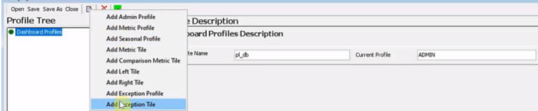

To add a new exception tile to the configuration, select an exception profile and click Add Exception Tile (located beneath Add) in the toolbar. A new exception tile is added to the navigation pane and selected in the content pane so that its information can be entered.

From the Configurator, select New to initially create a Dashboard Setting Configuration or select Open to load an existing resource and then delete the content of that resource in order to create the blank one. Figure 12-36 shows a blank Dashboard Setting Configuration.
Figure 12-36 Blank Dashboard Setting Configuration
Description of "Figure 12-36 Blank Dashboard Setting Configuration"
Next, create a new Seasonal Profile, shown in Figure 12-37.
Figure 12-38 shows an In-Season profile created with the name MFP-IN and the label MFP: In-Season to match. The view to be displayed in the Dashboard workbook has a View Name of PlnDashView. This profile is available to all MFP application users and is not restricted to a particular single role, so the Roles field is left blank. In order to restrict the profile view to MFP planners only, the Roles field must be filled with the role of MFP planners’ user group. The level to be displayed in the charts for the time series is the week level, so the value of week is entered into the Chart Level field. Data is most commonly viewed as a time series at week level.
Because the Seasonal Profile is selected, the dashboard will draw a time horizon based on seasonality. Two fields must be configured. Seasonal type can be either the current period (InSeason type) or in the coming period (PreSeason type). In Figure 12-38, the Configurator selected the Inseason type. The season must be defined, as shown in Figure 12-39 The configuration divides a fiscal year into two seasons in which each season has 26 weeks. The filters available at the top of the Dashboard UI are clnd loc prod for a standard three-dimensional Dashboard workbook.
Next, define how to lay out dimensions across the row, column, and page axis of the detail chart in the Dashboard view. Each profile contains one row dimension, one column dimension, and as many additional paged dimensions as needed, based upon the intersection of the view configured in the View Name field. In Figure 12-40, Row Dimension is at meas dimension and info is the default level. If no levels are specified, the lowest level will be used as the default for the display. The Hierarchy field was originally designed to tell the Dashboard which branch the branch hierarchy to use; however, the Dashboard can now determine this automatically, and this field is often left blank.
Since this is a seasonal profile, the Column Dimension field is set to clnd to display calendar on the x-Axis in order to see time series. The Levels field is used to determine at which levels the dashboard displays the data inside the chart. In Figure 12-40, there are four level options available: half, qrtr, mnth, and week. To see aggregated data for the default level, enter mnth.
Next, configure the dimensions Product and Location. They are configured as page dimensions. Since by default there is only one Paged Dimension object in the blank profile, a second Paged Dimension object is added. The Default Levels fields are left blank, which means the lowest level specified in the Levels field will be used as the default.
This seasonal profile does not use dynamic hierarchy, so the Dynamic Hierarchy fields are left blank. If dynamic hierarchy is used, values must be entered into the Dynamic Hierarchy fields. Users must enter the name of dimension affected by the dynamic hierarchy into the Dimension Name field, the measure containing the information for setting up the dynamic hierarchy mapping into the Measure field, the hierarchy that representing the branch inside the dimension that uses the dynamic hierarchy, the menu ID of the menu item into the Action field, the Default Levels, and Levels. See Seasonal Profile Element for details.
Creating a Metric Tile
Next, right click the MFP: In-Season profile and select Add Metric Tile to add a new metric tile, as shown in Figure 12-41.
In the Metric Tile Info interface shown in Figure 12-42, enter the name of measure for the tile. If the dashboard is to be used in a Retail Home implementation, the tile must be uniquely identified and the Tiles ID field requires a unique name, since more than one tile may reference the same measure. However, since this is not the case in the current example, the Tiles ID field is left blank. The Inserted check box is selected, indicating that this tile is visible by default in the Dashboard UI and no editing for setting visible tiles is required.
Next, add additional metrics for the tile. Click the + sign next to the new metric tile to display the Variance Tiles menu item and select it to add the variance tile. Supplement the main metric tile by adding a left tile and a right tile.
The left tile is used to compare the current year sales with the last year sales. The measure name mpwpslsvl shown in Figure 12-44 is the variance of the current year sales in comparison to last year sales; that is the value shown in the tile itself. The measure that holds the historical sales data will be visible inside the chart.
The right tile, shown in Figure 12-45, displays the comparison to the current plan. As before, the measure appearing in the tile is the actual variance itself (mpwpslsrvs), but inside the chart, the metric that holds current sales data mpcpslsr is displayed.

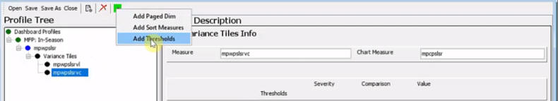

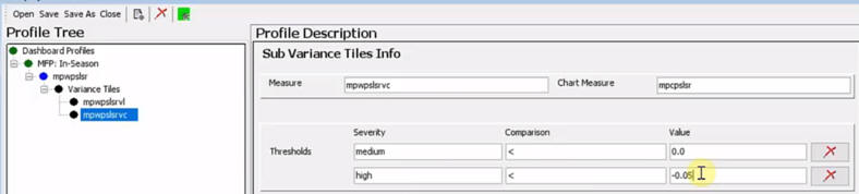

The final step is specifying the thresholds. Thresholds can be specified for either the left tile or the right tile. In Figure 12-46, the right tile has two thresholds, one medium and the other severe or high, for the variance to the current plan. Right click the right tile (mpwpslsrvc tile) shown in Figure 12-46, then click Add Thresholds to add one threshold. Repeat this step to add the second threshold.
The first threshold is a medium threshold. If sales do not perform to the plan, the variance is less than 0, and the Dashboard UI flags it as medium error. The badge inside the tile on Dashboard UI will show that it is not performing up to the current plan.
The second threshold is a high threshold. If the variance is more than five percent less than the plan, then it is flagged as a high error. The red badge in the UI indicates this, as shown in Figure 12-47.
The results of the Dashboard Seasonal Profile configuration are shown in Figure 12-48.

As in Example 1: Creating a Dashboard Seasonal Profile, starting from an (nearly) empty file, this example describes the steps to create the exception profile. For greater detail regarding the components used, see Example 1.
Complete the fields in the Exception Profiles Info interface as described in this section. The Type field is pre-populated with exceptions. A view name, profile name, and profile label are provided. The Roles field is left blank so that the Dashboard profile view is available for all users of the application.
The standard, two half seasons with 26 weeks within each season, is configured. A fiscal year contains two seasons. The filters used to range data in the Dashboard UI contain clnd loc prod. The Exception Profile supports performing exception-based processes in pre-season planning. Users can select the inseason, pre-season, or both as the season type. As in the Seasonal Metric Profile, if inseason is selected, the Dashboard will center itself in the time period containing today. If preseason is selected, it will determine which period today is in and will center on the upcoming time period so that users can resolve exceptions in the preseason planning.
The Product dimension is configured as the Row Dimension and Location as the Column Dimension. That means that the exceptions are first grouped by product, then further grouped by location. The Levels contain levels available in Filters that users can range down. As in the Metric Profile, the hierarchy field is usually left blank since the Dashboard can determine the value.
The paged dimensions have two dimensions, one at meas and the other at clnd. The default level is at dimension half, a higher level, so that users can drill down the data to lower levels defined within the Levels field.
This configured Exception profile does not use the Dynamic Hierarchy feature. If the Dynamic Hierarchy is used, then the corresponding information must be entered.

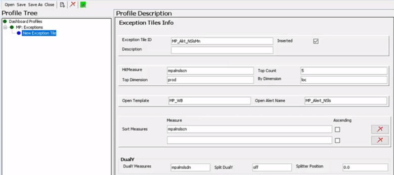

Right click the MP:Exception profile and select Add Exception Tile from the drop-down list, as shown in Figure 12-50.
The alert of interest in is the Min Sales count. Enter the corresponding information is entered into the Exception Tiles Info interface. See Exception Profile Element for a detailed explanation of each component.
To begin, an explicit Tile ID is required for every Exception Tile (but not necessarily for a Metric Tile). The Inserted check box is selected by default so that this tile is visible in the Dashboard UI.
The HitMeasure field has the measure name mpalnslscn, indicating the measure containing the exception hit count information for the tile. The Top Dimension entered is the Product dimension, and By Dimension is Location dimension. The Top Dimension and By Dimension override the settings in the profiles if they are different. Note that in the example, these two settings are the same. The TopCount is set to 5 so that when users view the alert hits by product and location dimensions, they will start out with the top five products in the RPASCE UI display.
Next, configure the ability to launch out of the Dashboard into the workbook in order to resolve exceptions displayed in the tile. Enter the workbook template to be launched into the Open Template. Enter the real time alert name into the Open Alert Name.
In addition to simply ranking the display based on those products that have the most alert hits, users can also use Sort Measures to group data based on the metric values. In this example, the check box for Ascending is deselected for the first sort measure, so the data is sorted in descending order.
The DualY section is optional. Once configured, it is used to display a secondary metric inside the chart when the user is looking at the information. The DualY section contains an optional configuration to display alert hits on a different scale via a split DualY. With Split DualY, instead of one chart, users see a distinct, secondary chart that stacks on the other in the RPASCE UI display. In this example, the Split DualY is not used, and the field contains off and Splitter Position 0.0.

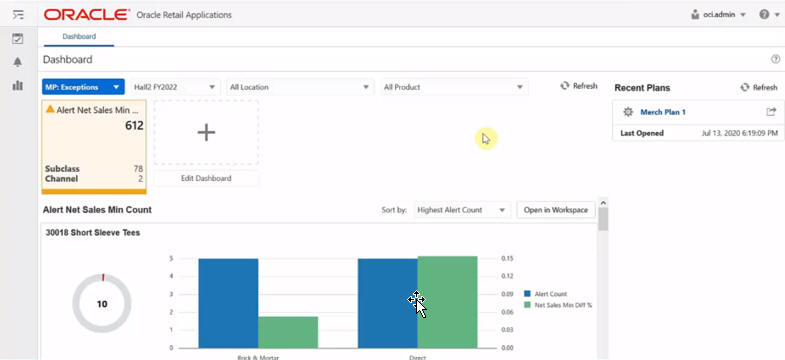

Dashboard Exception Profile Instance in the RPASCE UI
Figure 12-52 shows the Dashboard instance in the RPASCE UI. In the MP: Exceptions profile, users can view the exception Tile, the Location, Product and the optional levels within each hierarchy. Users can launch the workbook from the Open in Workspace option. The Sort By option contains an additional sorting metric specified by the Sort Measure configuration. Alert hits are broken out first by product, then by location dimension. The second metric Net Sales Min Diff % plugged into the DualY configuration is also in the chart. There is one range for the alert hit and a second range for the diff percentage.

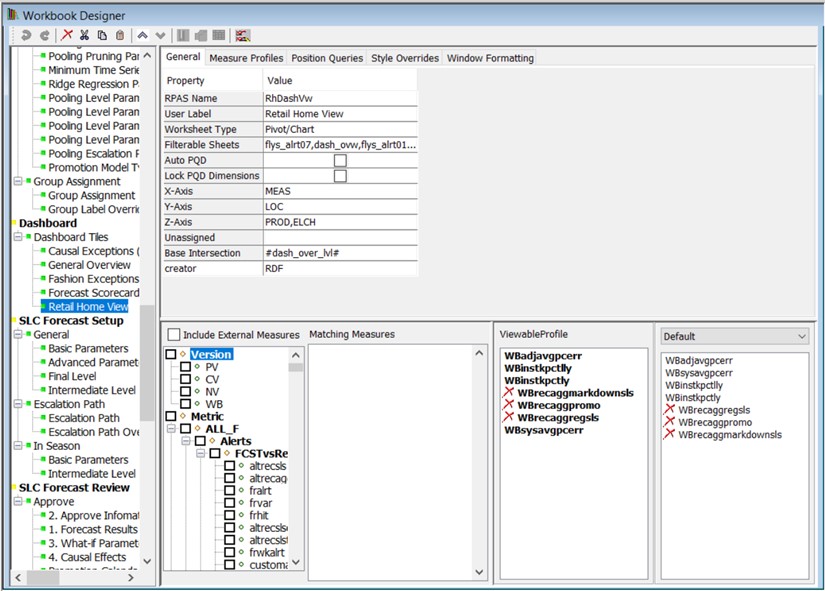

Create a Retail Home-specific worksheet in a Dashboard workbook.
The Dashboard Workbook can be an existing regular Dashboard Workbook or a new Dashboard Workbook dedicated to Retail Home. The Retail Home worksheet must be populated with all the Retail Home tile measures, calculation rules, and any special expression libraries that are required to produce measure data. This separate retail-home-specific worksheet in the Dashboard workbook can start life as a copy of the existing application-level dashboard worksheet (for example,
PlnDashVw
), renamed toRhDashVw
and modified as required. This worksheet must have all the tile measures. Any special rules to produce measure data (such as a rollup over a certain number of weeks up to the current date) can be used in this worksheet. See Configuring Dashboards in RPASCE for how to configure a Dashboard workbook and its worksheets.Figure 12-53 Retail Home Worksheet Added to the Regular Dashboard Workbook
Description of "Figure 12-53 Retail Home Worksheet Added to the Regular Dashboard Workbook" -

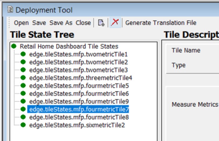

This file resource, often called the Retail Home Dashboard Settings file, is a JSON encoded text document that contains information about the dashboard tile states and their tiles that is used by the client to organize and present the data contained within the dashboard workbook. The Deployment Tool contains an interface for the creation of the content of the Retail Home Dashboard Settings resource. Using this tool, the person performing the configuration can interact with a graphical user interface that is similar to other Configuration Tools-based interfaces and the tool will generate the appropriate JSON file content. Like other Configuration Tools interfaces, this allows the people performing the configuration to focus on what information they want to present in the configuration (as defined in terms of measures, RPASCE views, and so on) and let the tool manage the generation of the appropriate file resources.
RetailHomeConfig.json View
The RetailHomeConifgs.json View can be used to create, delete, and modify the contents of a Retail Home Dashboard Settings file resource using a set of actions represented through buttons, menu items, and text forms. This information is organized around a set of entities that describe the view layer of the Retail Home Dashboard, such as dashboard tile states and metric tiles.
By representing this information in a user interface, the tool allows users to work with an organized form of the information that can be easily navigated and modified. Then, through the Save action, the information present within the interface can be written into the appropriately formatted JSON file by the tool, allowing users to concentrate on the content and allowing the tool to manage the encoding process.

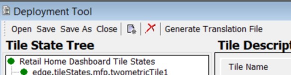

The RetailHomeConfig.json View can be accessed from the main Deployment Tool screen through the RetailHomeConfig.json item.
RetailHomeConfig.json Option in Deployment Tool

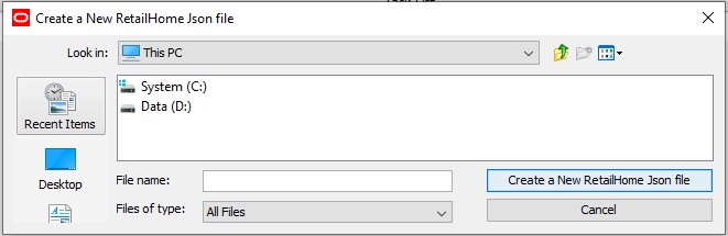

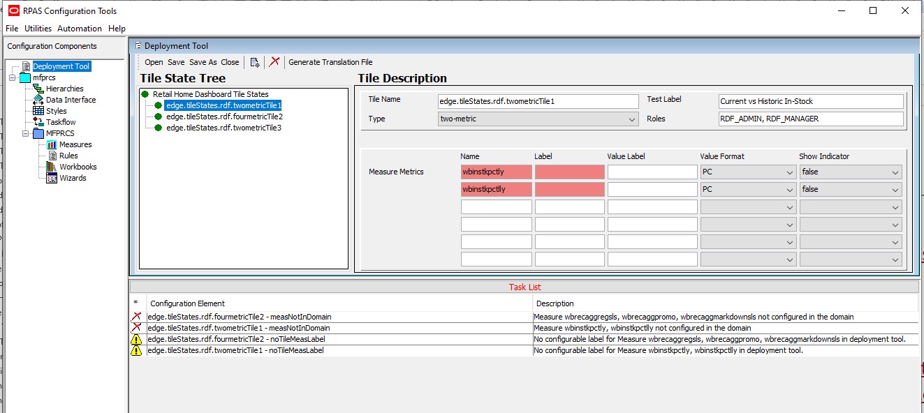

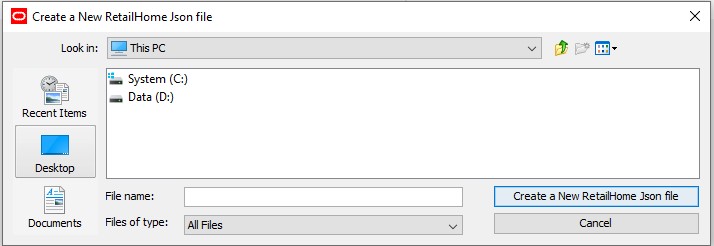

To access an existing resource, the user selects Open, located in the upper right-hand corner of the RetailHomeConfig.json entry. The user is presented with the files saved on the local system. The user can also use the New action to create a new Retail Home Dashboard Settings resource. Select New and the following window displays. The user can specify the name of the Retail Home JSON file. If the file name does not end with a .json suffix, Tools will add it automatically.
Figure 12-55 Create a New RetailHome JSON File Window
Description of "Figure 12-55 Create a New RetailHome JSON File Window"
Once a dashboard settings resource opens, its contents are loaded into the RetailHomeConfig.json View.
Figure 12-56 RetailHomeConfig.json View with Loaded Resource
Description of "Figure 12-56 RetailHomeConfig.json View with Loaded Resource"
Within the RetailHomeConfig.json view, users are presented with a navigation pane on the left, containing a tree structure of the entities making up a Retail Home dashboard settings configuration such as dashboard tilestates and the tiles they contain. When an entity is selected within the navigation pane, its information is loaded into the content pane on the right. This allows users to view and modify that entity's information. Metric tiles can be created and deleted through actions present on the top toolbar.
RetailHomeConfig.json Resource Contents

Template, Worksheet, and TileStates Definition

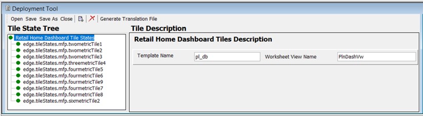

The tree root on the left side of the Navigation pane defines the template name, worksheet view name, and the tileStates.
Example Template and Worksheet Configuration for Retail Home Dashboard
Figure 12-57 Example Template and Worksheet Configuration for Retail Home Dashboard
Description of "Figure 12-57 Example Template and Worksheet Configuration for Retail Home Dashboard"
Table 12-1 provides more detailed descriptions for each of these three parameters.
Table 12-1 Retail Home Dashboard Parameters
Parameter | Type | Required | Description |
templateName |
String |
Y |
The template name for the dashboard workbook. For example, in MFPRCS it is pl_db. |
worksheetViewName |
String |
Y |
The name of the worksheet view in the dashboard workbook that has the dashboard data. It must be same as configured within the dashboard workbook. For example, in MFPRCS it is called |
tileStates |
Object |
Y |
An array of tile state objects. Choose a unique name field for each tile state. Only one tilestates object is supported currently. |
Here is an example of the JSON content at the top level of RetailHomeConfig.json file. Note that the templateName
and worksheetViewName
must be the same as configured in the Dashboard Workbook.
{ "templateName": "pl_db", "worksheetViewName": "PlnDashVw", "tileStates": [ ... ] }

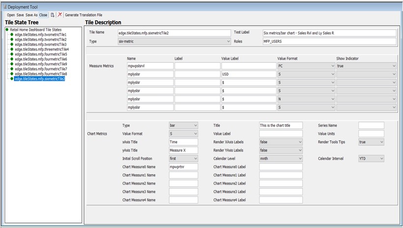

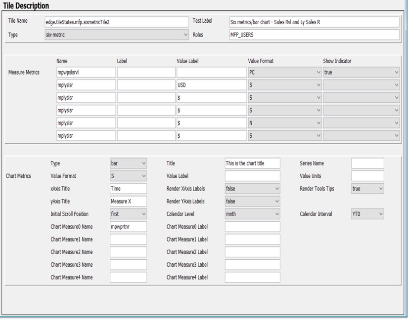

The Tilestates can contain one or more metric tile objects that are displayed in the right-side Tile Description pane.
name – A required property. It is the tile ID, string identifier. This must be unique across all the metric tiles.
type – A required property, indicating metric tile type. It must be two-metric, four-metric, or six-metric. Two-metric means one to two measures, and no chart. Four-metric means one to four measures and an optional chart. Six-metric means one to six measures and an optional chart. In brief, the only difference between the 4-metric type and the 6-metric type is that 6-metric displays up to six measures and 4-metric shows only the first four.
testLabel – A required property. Title of the tile. Used only in the test harness. In Retail Home it is the application name (same for all tiles in the application).
roles – A required property. A list of role names separated with a comma whose users are authorized to see this tile in Retail Home. Not used in the test harness.
measures – A required property. A list of JSON array objects. A list of one or more measure metrics to be displayed in the tile. Specify one to two measures for two-metric, one to four measures for four-metric, and one to six measures for six-metric.

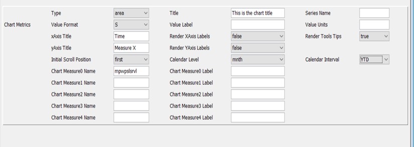

chart – An optional property. An object defining a chart to be displayed underneath the metrics. The chart is only displayed in four- and six-metric tiles.
Here is an example of the JSON format illustration of a metric tile.
{ "name": "tile1", "type": "four-metric", "testLabel": "Four metrics/area chart - Sales Rvl and Ly Sales R", "roles":"MFP_PLANNERS, MFP_USERS", "measures": [ ... ], "chart": { ... } },
Users can add or delete a metric tile using the top menu item.
To add a new metric tile to the Retail Home dashboard settings configuration, highlight a Metric Tile in the left navigation pane, click Add New Node (located beneath Add) from the toolbar. A new tile entry is added to the navigation pane and selected in the content pane so that its information can be entered.
To remove an existing metric pane from the Retail Home dashboard settings configuration, select the tile and click Remove from the toolbar. The confirmation window opens. Click Yes to confirm.
Measure Metrics Definition

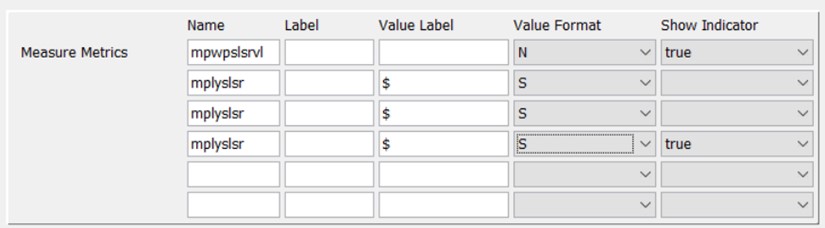

The Measure Metrics section can contain multiple Measure objects. The properties defined for a Measure object are:
name - A required property. The RPASCE name of the measure. No extended measure.
Label - An optional property for the measure label override. If not specified, the RPASCE measure label will be used. If MultiSolutionBundle.properties has a resource key entry called
<tile-id>.<measure-name>.retailhome.measure.label
then that is used. In other words, measure labels can be localized for retail home purposes. See “Generate Translation File" section for details about the translation of labels. -
valueLabel - An optional property. An additional label to display underneath the measure value.
valueFormat - An optional property for measure value Format. The drop-down list contains blank, PC, S, and N. These represent: PC - Percent (.01 = 1%), S - Short (1000 = 1K), N - Number (1000 = 1,000).
showIndicator - An optional property. True or False. By default, this property is false. This flag controls whether the up or the down icon is displayed in the dashboard.
Here is the JSON format for one Measure object.
{ "name": "mplyslsr", "label": "Measure Label Override", "valueLabel": "$", "valueFormat": "S", "showIndicator": "true" }
Here is an example of an array of tile measure objects. Note that some optional properties are not specified for certain tile measures.
"measures": [ { "name": "mpwpslsrvl", "valueFormat": "N" }, { "name": "mplyslsr", "valueLabel": "$", "valueFormat": "S" }, { "name": "mplyslsr", "valueLabel": "$", "valueFormat": "S" } ]
Figure 12-60 shows the measure definition section in the content pane.
Figure 12-60 Measure Metrics Section Example
Description of "Figure 12-60 Measure Metrics Section Example "
You can select the optional Value Format and Show Indicator from their lists.
Chart
The Chart metrics is an optional JSON object used with four-metric and six-metric types only. If no chart is configured for the Retail Home Dashboard Settings, all fields in the Chart section must be left blank.
The properties defined for a Chart object are:
chartType - A required property. Values include line, bar, area, or total.
measures - A required property. An array of chart measure objects. One or more measures to plot in the chart. Only one measure is supported for line/bar/area charts. These charts display the measure's values over the weeks or months before the current date, from the current year.
Totals chart is unique. You must specify at least two measures. The totals chart shows the values of the measures rolled up across all time, side by side in the horizontal bar. The maximum number of chart measures that can be specified is five. See next section for a discussion of the measure object format.
title - An optional property. The title displays above the chart.
renderTooltips - Optional. Hide or show tooltips on the chart. Default is true.
seriesName - Optional. True or False. By default, this property is false. This flag controls whether the up or the down icon is displayed in the Label for the tooltip. Applies to line, bar, and area charts.
valueFormat - Optional. Formats the output of values in the chart. Takes the same values as metrics items.
valueLabel - Optional. Prefix for values. Applies to total charts only.
valueUnits - Optional. Suffix for values. Applies to total charts only.
xAxisTitle - Optional. Label for the x-axis. Applies to line, bar, and area charts.
renderXAxisLabels - Optional. Default is false. Show or hide tick labels on the x-axis. Applies to line, bar, and area charts.
yAxisTitle - Optional. Label for the y-axis. Applies to line, bar, and area charts.
renderYAxisLabels - Optional. Default is false. Show or hide tick labels on the y-axis. Applies to line, bar, and area charts.
initialScrollPosition - Optional. The end of the chart to start at if there are too many items to show at once. Options are first and last. Default is first. Applies to line, bar, and area charts.
calendarLevel - Required if the Chart metric is configured. Defaults to the level name corresponding to month. (In MFP it is MNTH, for example). Users can select week or mnth from the drop-down list.
calendarInterval - Required if the Chart metric is configured. Currently, only YTD is supported.
Here is an example of the JSON format for the chart object.

Open the Application Configuration First

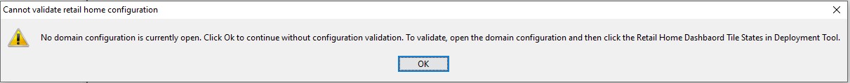

To validate Retail Home Dashboard Settings with its application configuration, open the application configuration first in the Configuration Tools before clicking the Open or New button in the Retail Home View of the Deployment Tool. Otherwise, a window will display to warn the User.
Figure 12-62 Cannot Validate Retail Home Configuration Window
Description of "Figure 12-62 Cannot Validate Retail Home Configuration Window"
Once the user selects OK, the File Selection Window displays. The user can either select Cancel to go back to the Configuration Tools to open an application configuration for validation or select Open or Create a Retail Home JSON File to proceed without validation.
Figure 12-64 Create a New Retail Home JSON File Window
Description of "Figure 12-64 Create a New Retail Home JSON File Window"
The Retail Home Dashboard configuration contains the dashboard workbook template name. Using that information, Retail Home Deployment Tool searches open application configurations to determine which application contains the dashboard workbook and then obtain the reference to that application object. If the Retail Home dashboard workbook is configured with the same workbook template name in more than one application configurations, then the deployment tool will use the reference to the first encountered application configuration in the search path.
Validation Criteria
For both Metric Measures and Chart Measures, if they do not meet following criteria, the behavior will be flagged as an error in the TaskList pane in the RH deployment tool. The measure:
Does not exist within the dashboard workbook template.
Is hidden within the dashboard workbook template.
Is neither Integer nor Real type.
For both Metric Measures and Chart Measures, if they do not meet following criteria, the behavior will be flagged as a warning in the TaskList pane in the RH deployment tool. The measure:
Does not have a configured label in deployment tool.
For Chart Measures, if they do not meet following criteria, the behavior will be flagged as an error in the TaskList pane in the RH deployment tool. The measure:
Does not contain a level of the calendar dimension within its base intersection.
Note that, as for all other tools TaskList error/warning messages in general, users can still save the Retail Home Dashboard Settings before the validation Tasklist error/warnings are completely resolved.
Figure 12-65 Retail Home Dashboard Settings Validation Errors and Warnings
Description of "Figure 12-65 Retail Home Dashboard Settings Validation Errors and Warnings "
Retail Home Translation Resources
In order to support the localization of the strings provided to Retail Home, RPASCE must provide an extracted internationalization of the information passed by the Retail Home web service. This resource, when translated, allows the web service to retrieve strings localized into the appropriate language when serving requests and, in conjunction with any strings translated by the RPASCE Server (for strings representing metadata pulled from the PDS), allows users to view their Retail Home data in the language of their choice.
The Retail Home Dashboard Configuration tool provides a menu button Generate Translation File in the upper right menu to pull translation labels from the Retail Home Dashboard Configuration. This button must only be used when any change to the RetailHomeConfig.json has been made and saved. Click this button to generate a base resource file called RHResources.properties. This file is generated within the same directory where the RetailHomeConfig.json file is stored. The resource file RHResources.properties can be translated into various languages/locales and accessed at run-time by the Retail Home web service through the Java ResourceBundle APIs.
Figure 12-66 Generate Translation File Menu Button
Description of "Figure 12-66 Generate Translation File Menu Button"
The following table lists those strings that are set in the Retail Home JSON configuration file that require internationalization, along with the algorithmic formula to generate the key for that string in the RHResources.properties.
Table 12-2 Strings that Are Set in the Retail Home JSON Configuration File
