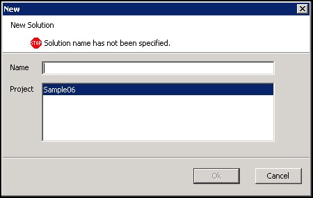

Create a Solution
Complete the following steps to create a solution.
Navigate: From the File menu, select New and then Solution. The Figure 4-1 opens.
  1. In the Name field, enter the name of the solution.
  2. In the Project field, select the project in which the solution is to belong. Multiple projects will be listed if multiple projects are currently open.
  3. Click OK to save any changes and close the window.

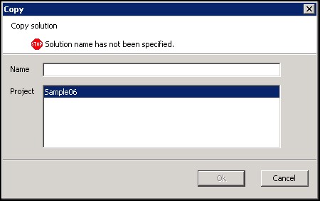

Copy a Solution
Complete the following steps to copy a solution.
  1. Select the solution to be copied.
  2. Right-click in the Configuration Components pane and click Copy. The Copy solution window opens.
    Figure 4-2 Copy Solution Window
    Description of Figure 4-2 follows
    Description of "Figure 4-2 Copy Solution Window"
  3. Type the new name for the solution in the text box.
    This is the name that the solution is called after it has been copied.
  4. Select the project where the solution is to be copied.
  5. Click Finish to save the copied solution in the specified project.

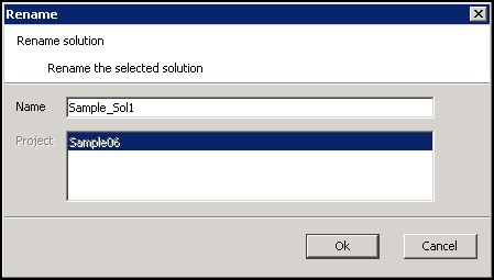

Rename a Solution
Complete the following steps to rename a solution.
  1. Select the solution to be renamed.
  2. Right-click in the Configuration Components pane and select Rename. The Figure 4-3 opens.
  3. Delete the old name from the resulting field and type the new name.
  4. Click OK to save the new name.

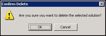

Delete a Solution
Complete the following steps to delete a solution.
Select the solution to be deleted.
Right-click in the Configuration Components pane. The Figure 4-5 opens.
Figure 4-5 Confirm Delete Window
Description of Figure 4-5 follows
Description of "Figure 4-5 Confirm Delete Window"
Click OK to complete the deletion.

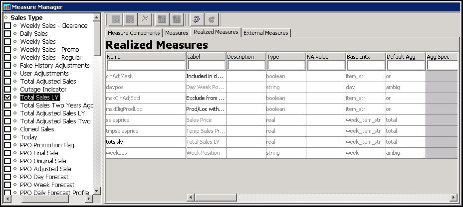

The Measure Manager window allows you to define major and minor components of measures and to specify properties for each component. Once the component structure is defined, the Measure Manager generates measures by combining the components that are selected. You may then select (realize) the valid measures and further update the properties for individual measures.
Figure 4-6 Measure Manager Window
Description of Figure 4-6 follows
Description of "Figure 4-6 Measure Manager Window"
Measure Properties
This section describes the fields displayed in the Measures tab.
Inheritance
Measure properties are inherited at the component level. The properties defined for a component are inherited by the minor components that belong to that component and to the measures that are associated with that component unless it is overridden at a lower level.
When a measure can inherit a property from more than one of the components that construct it, the measure inherits from the component that belongs to the highest major component in the component tree. For many properties, it is a good practice to set the properties for just one major component or for minor components in just one major component branch.
Overriding
Measure property inheritance can be overridden at the minor component or at the measure level. Once a property is set at a lower level, changes made to that property at a higher level will no longer be inherited at that lower level.

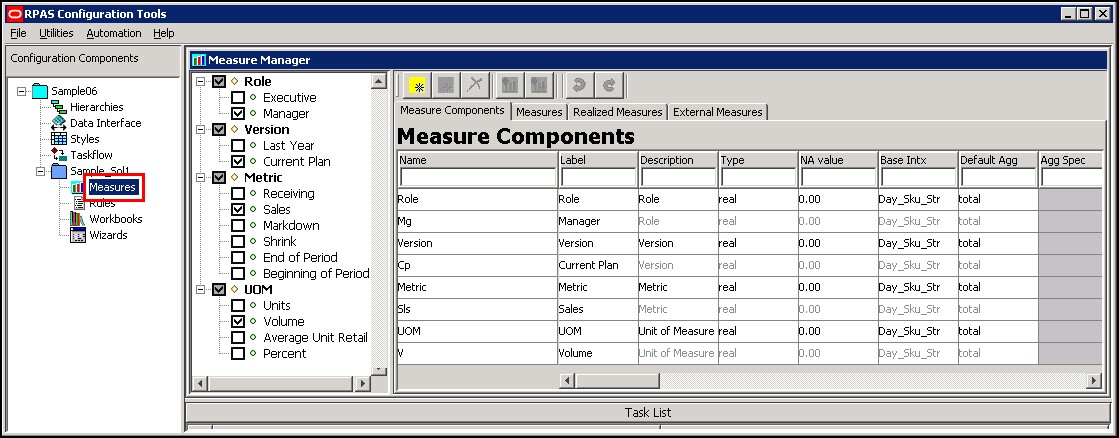

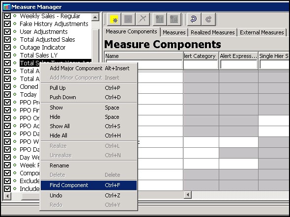

Create a Major Component
Complete the following steps to create a major component.

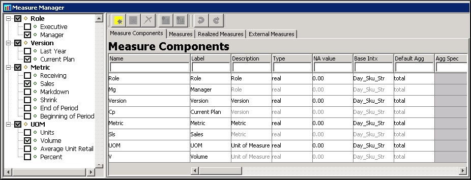

Navigate: In the Configuration Components pane, select Project then Solution then, Measures and then the Measure Components tab. The Measure Manager window opens in the workspace.
Figure 4-7 Measure Manager Window - Measure Components Tab
Description of Figure 4-7 follows
Description of "Figure 4-7 Measure Manager Window - Measure Components Tab"
  1. Right-click in the left-hand pane of the Measure Manager window and select Add Major Component or click Add Major Component. The major component displays in the Measure Manager navigation tree with a default name.
    Figure 4-8 Measure Manager Navigation Tree
    Description of Figure 4-8 follows
    Description of "Figure 4-8 Measure Manager Navigation Tree"
  2. To change the component name, right-click on the component and select Rename, or select the component from the navigation tree and then modify its Label field from the Measure Components tab.

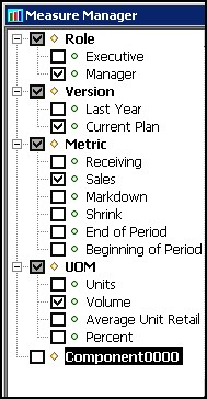

Create a Minor Component
Complete the following steps to create a minor component.
Figure 4-9 Major Measure Component Selected
Description of Figure 4-9 follows
Description of "Figure 4-9 Major Measure Component Selected"
  1. Select the major or minor component that the new minor component is to be added beneath. In Figure 4-9, NewMajorComponent is selected.
  2. Choose one of the following methods:
    • Right-click the Measure Definition navigation tree and select Add Minor Component.
    • Click Add Minor Component.
    • Press Insert.
    The minor component displays in the Measure Manager navigation tree with a default name.
    Figure 4-10 New Minor Component
    Description of Figure 4-10 follows
    Description of "Figure 4-10 New Minor Component"
  3. To change the name, right-click on the component from the navigation tree and select Rename. You can also select the component from the navigation tree and modify the Label field from the Measure Components tab.
Defining Measure Component Properties
Complete the following steps to define the Measure Component properties.
Once components have been created, open the Measure Manager and select the Measure Components tab.
Select the major or minor components you want to view from the Measure Manager navigation tree. The selected components display in the Measure Components tab.
Figure 4-11 Measure Components Tab
Description of Figure 4-11 follows
Description of "Figure 4-11 Measure Components Tab"
Specify the information for the component properties (for example, Name, Label, Description, and so on), which will apply to the measures that are inheriting property values from the component.
The values that are entered for major components are inherited by the child minor components and the auto-generated measures. Not all properties need to be entered for all components. Properties that are grayed out in the component properties table cannot have a value in the current context. Typically, this is based on the data type of the measure. For example, only components of Boolean data type can have an alert category or an alert expression.

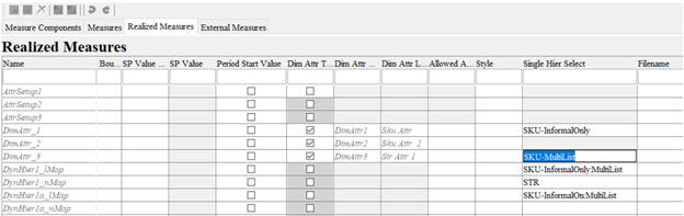

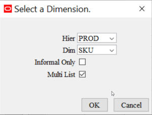

Single Hier Select
This property is only valid for components that have a Type (data type) of string and non-picklist. It specifies that cell contents are to be entered by users using the Single Select Widget. This is a widget in the RPASCE Client that presents the end user with a view of the positions along the dimension set in the configuration. The user may then select any single position. When a user double clicks the Single Hier Select field, a Select a Dimension window pops up where the user must select the hierarchy and dimension whose positions will be displayed to the user in the RPASCE Client.
Figure 4-12 Select a Dimension Window
Description of Figure 4-12 follows
Description of "Figure 4-12 Select a Dimension Window"
For the Single Hier Select measures that have both Agg State and Base State properties set to READ, the pop-up dialog box contains an additional Multi List check box. Users can select the Multi List check box to enable the Multi Item Display on RPASCE UI, so users can see a concatenated list of positions that meet different criteria for a measure (For example, alert or promotion) so that users can see which positions have alerts or offers and what details that apply to them.

Find a Component
  1. Right-click in the Measure Manager navigation tree and select Find Component. The Input window opens.
    Figure 4-14 Find Component Menu Option
    Description of Figure 4-14 follows
    Description of "Figure 4-14 Find Component Menu Option"
  2. Type in the name of the desired component and click OK. The tree will scroll to bring the specified component into view.
  3. Select the desired component.
    The full name (case sensitive) of the component is required in order to find it. If there is no component with the exact name entered, the tree will not scroll.

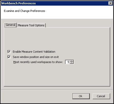

Disabling Measure Content Validation
For some cases you may disable the full validation (for instance, when performing a number of changes to measure properties that require switching back and forth between multiple tools). Validation can then be manually initiated from the Rule Definition window by selecting Perform measure content validation from the Rule Definition toolbar. Complete the following procedure to turn off real-time validation.
  1. Select File and then Tools Preferences. The Workbench Preferences window opens.
    Figure 4-16 Workbench Preferences – General Tab
    Description of Figure 4-16 follows
    Description of "Figure 4-16 Workbench Preferences – General Tab"
  2. Clear the Enable Measure Content Validation check box.
  3. Click OK.
Working with Measures
Measure Manager Overview
The Measure Manager allows you to create and name measures by selecting major and minor components that are already defined. By default, the measures inherit the properties that are defined for the components. To create a measure, select the components that will be used to construct measures. The Measure Manager will generate measures for all of the combinations of selected components. This saves you from the tedious task of manually creating all required measures.
Figure 4-17 Measure Manager Components
Description of Figure 4-17 follows
Description of "Figure 4-17 Measure Manager Components"
You may then override the properties for individual measures by entering them the same way as on the Measure Components tab. Once properties are overridden at the measure level, changes made at the component level will no longer spread down to that measure as it will retain the overridden value. An overridden value can also be restored to its inherited value or you may override an inherited value to be unspecified.
When a measure is auto-generated by the Measure Manager, it cannot be edited or used in any other configuration component such as rules and workbooks until it is realized. A measure does not need to be realized if it is not going to be used.
The Measures tab displays all auto-generated measures for the selected components.
Figure 4-18 Measure Manager Measures Tab
Description of Figure 4-18 follows
Description of "Figure 4-18 Measure Manager Measures Tab"

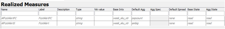

The Realized Measures tab only displays those measures that are realized.
Figure 4-19 Measure Manager Realized Measures Tab
Description of Figure 4-19 follows
Description of "Figure 4-19 Measure Manager Realized Measures Tab"
Realized and Unrealized Measures
Complete the following steps to access the Measure Manager window - Measures Tab.
Navigate: In the Configuration Components pane, select Project, then Solution, and then Measures. The Measure Manager window opens in the workspace.
  1. Select the Measures tab.
    Figure 4-20 Measure Manager Measures Tab
    Description of Figure 4-20 follows
    Description of "Figure 4-20 Measure Manager Measures Tab"
  2. In the components tree, select the check boxes for the components that will be filtered. The Measure Manager will show measures using all the combinations of selected components. This process filters the list of prototype measures that are shown from all combinations of components to the combinations of components that have been selected. It uses those components to determine which prototype measures to show.
Realizing a Measure
  1. Select the components that are used for the measures to be realized.
  2. Select the check box in the Realized column for each auto-generated measure to be realized.
Unrealizing a Measure
  1. Select the components that are used for the measures to be unrealized.
  2. Clear the check box in the Realized column for each auto-generated measure to be unrealized.

  1. In the Measure Manager window, select the Measures tab.
    • Clear the check boxes next to the components to hide.
    • Select the component used in the measures to hide.
  3. Right-click in the Measure Manager navigation tree and select Hide or press the spacebar.
Hide All Measures
  2. Right-click the Measure Manager navigation tree, and select Hide All.
Sort Measures by Property Value
In the Realized Measures tab, measures can be sorted by property value.
  1. Select the Realized Measures tab.
  2. Hold down the control key (Ctrl) and click in the filter field at the top of the table for the property of the measures to be sorted.
    The measures are sorted in alphabetical order according to the value of the property.
Filter Measures by Property Value
In the Realized Measure tabs, the configuration administrator can filter measures by property value.
  1. In the Realized Measures tab, click in the filter field at the top of the table for the property of the measures to be filtered.
  2. Enter the value on which ti filter the measures.
    This field is case sensitive.

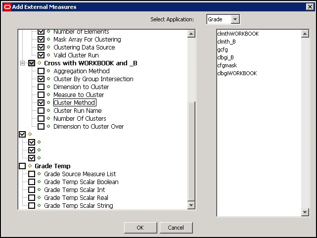

Import a Measure
You may only import a measure into a solution for a project that has at least one other solution.

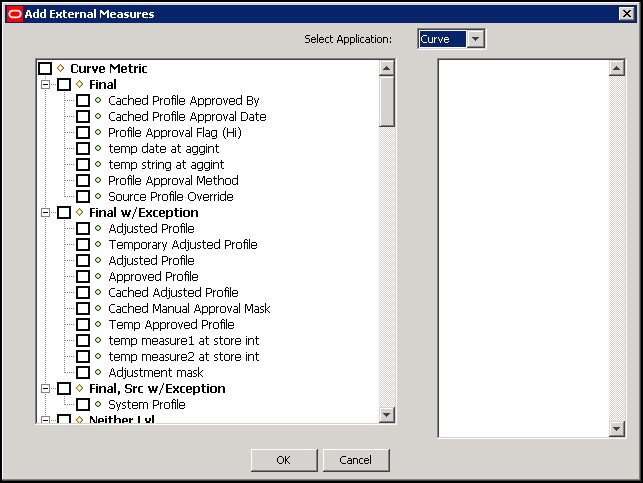

  1. Select the External Measures tab, and click Import Measure on the toolbar. The Figure 4-22 opens.
    Figure 4-22 Add External Measures Window
    Description of Figure 4-22 follows
    Description of "Figure 4-22 Add External Measures Window"
  2. In the Add External Measures window, select the solution in which the desired measure is defined.
  3. Use the measure selector (left-hand side) to select the measures to import.
    Figure 4-23 Selecting Measures to Be Imported
    Description of Figure 4-23 follows
    Description of "Figure 4-23 Selecting Measures to Be Imported"
    External measures that are already imported display in bold.
  4. From the right-hand list, select the measure to import and click OK. The selected measures display in the External Measure tab.

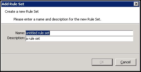

  1. From the toolbar, click New and select Rule Set, or select Create/Rule Set from the right-click menu. The Figure 4-25 opens.
    Figure 4-25 Add Rule Set Window
    Description of Figure 4-25 follows
    Description of "Figure 4-25 Add Rule Set Window"
  2. Complete the following:
    1. In the Name field, enter the name of the rule set.
      A rule set name can be a maximum of ten alphanumeric or underscore characters. It must not have a name that is the same as any other rule set that exists in the project.
    2. In the Description field, enter a description of the rule set.
    3. Click OK to save any changes and close the window. The rule set displays in the Rules navigation tree.

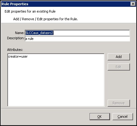

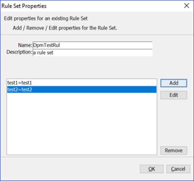

Edit Rule Set Properties
Navigate: In the Configuration Components pane, select Project, then Solution, and then Rules. The Rule Definition window opens in the workspace.
  1. In the Rule Definition window, select the rule set, right click, select Edit Properties, then select Rule Set. The Rule Set Properties Window opens in the workspace.
    Figure 4-26 Rule Set Properties Window
    Description of Figure 4-26 follows
    Description of "Figure 4-26 Rule Set Properties Window"

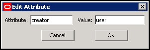

  2. In the Rule Set Properties window, Click Add to open the Edit Attribute window in order to add a new rule set attribute.
    Figure 4-27 Rule Set Edit Attribute Window
    Description of Figure 4-27 follows
    Description of "Figure 4-27 Rule Set Edit Attribute Window"
  3. To edit an existing rule set attribute, select the attribute/value pair and then click Edit. The Edit Attribute window opens in the workspace. The window is pre-populated with the selected rule set attribute and value that the users can edit.
  4. To remove an existing rule set attribute, select the attribute/value pair and then click Remove.

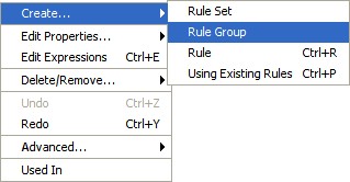

  1. In the Rule Definition window, select the rule set to be used to create a new rule group.
  2. From the toolbar, click New and select Rule Group, or select Create – Rule Group from the right-click menu.
    Figure 4-29 Rule Group Menu Option
    Description of Figure 4-29 follows
    Description of "Figure 4-29 Rule Group Menu Option"

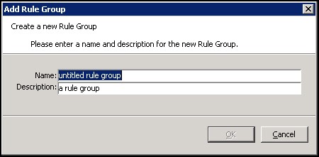

    The Figure 4-30 opens.
    Figure 4-30 Add Rule Group Window
    Description of Figure 4-30 follows
    Description of "Figure 4-30 Add Rule Group Window"
  3. Complete the following:
    1. In the Name field, enter the name of the rule group.
      A rule group name can be a maximum of 16 alphanumeric or underscore characters. It must not have a name that is the same as any other rule group that exists in the project.
    2. In the Description field, enter a description of the rule group.
    3. Click OK to save any changes and close the window. The new rule group displays in the Rule Definition tree window.

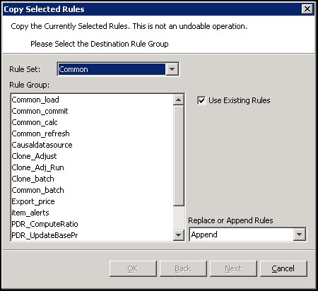

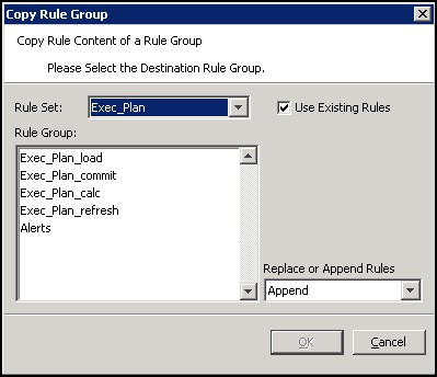

Copy a Rule Group
If two rule groups are similar, it may be beneficial to copy one rule group into the other to prevent having to create a rule group from scratch. When copying the rules of a rule group into another rule group, it is possible to specify whether existing rules will be used or copies of the rules will be created. The Use Existing Rules check box defaults to using any existing rules in the rule pool. If this check box is selected, the copy rule group operation will use the same rules that the source rule group has. If this check box is unchecked, the copy rule group operation will create copies of the rules and use those copies for appending to or replacing rules in the destination rule group.
The rule group to be copied into must already exist. A new rule group cannot be created through this process.
Navigate: In the Configuration Components pane, select Project, then Solution, and then Rules. The Figure 4-28 opens in the workspace.
  1. In the Rule Definition window, select the rule group to be copied.
  2. From the toolbar, click Advanced, and select Copy Rule Group. The Copy Rule Group window opens.
    Figure 4-31 Copy Rule Group Window
    Description of Figure 4-31 follows
    Description of "Figure 4-31 Copy Rule Group Window"
    1. Using the Rule Set list, select the destination rule set.
    2. From the Rule Group area, select the desired destination rule group.
    3. Using the Replace or Append Rules list, select either:
      Replace – To overwrite all rules that already exist in the destination rule group.
      Append – To add to the rules already in the destination rule group.
    4. Click OK. The Confirm Operation window opens.
  4. Click OK. The rules are copied to the selected rule group.

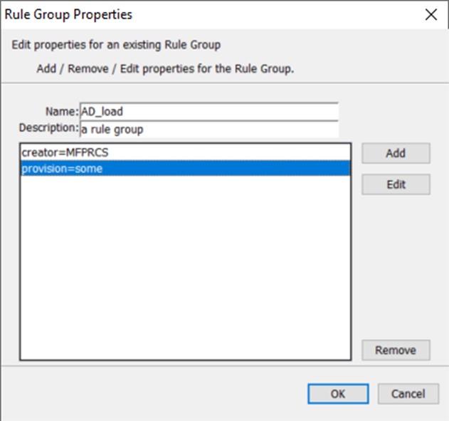

Edit Rule Group Properties
  1. In the Rule Definition window, find the rule set containing the rule group to be modified. Select the rule group, right click, select Edit Properties, then select Rule Group. The Figure 4-32 opens in the workspace.
    Figure 4-32 Rule Group Properties Window
    Description of Figure 4-32 follows
    Description of "Figure 4-32 Rule Group Properties Window"

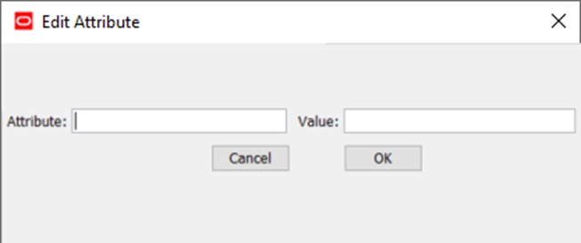

  2. In the Rule Group Properties window, click Add to open the Edit Attribute window in order to add a new rule group attribute.
    Figure 4-33 Rule Group Edit Attribute Window
    Description of Figure 4-33 follows
    Description of "Figure 4-33 Rule Group Edit Attribute Window"
  3. To edit an existing rule group attribute, select the attribute/value pair and then click Edit. The Edit Attribute window opens in the workspace. The window is pre-populated with the selected rule group attribute and value that the user can edit.
  4. To remove an existing rule group attribute, select the attribute/value pair and then click Remove.
Measure Validation in the Rule Definition Window
If Enable Measure Content Validation is not selected in the Workbench Preferences window, measure content validation is turned off in the Measure Manager. Measure validation must be manually initiated in the rule tool. See Measure Validation within the Measure Manager.
From the Rule Definition window, click Perform Measure Content Validation on the Rule Definition toolbar.

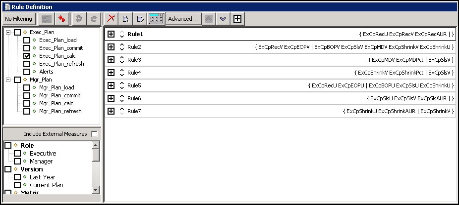

Rule Definition
The Rule Definition tool allows the configuration administrator to define, organize, and manage rule sets, rule groups, and rules. It also allows for the creation of expressions and addition of expressions to rules.
Rules are groups of expressions that describe the relationship between measures.
When a rule has multiple expressions, those expressions are given a priority sequence to help the calculation engine select a calculation path that follows business priorities. When given a choice, the calculation engine will always select the highest priority expression in the rule that is available to be selected. Considerable care should be taken in the design of rules to ensure that appropriate expression priorities are established. The business priority may vary from implementation to implementation, and it may vary from one type of plan to another in the same implementation.
Rules are also given a priority sequence within a rule group to help the calculation engine select a calculation path that follows business priorities. When given a choice, the calculation engine will always select the highest priority rule that needs to be calculated.
Those who are configuring the calculation requirements of a solution are expected to fully understand the operation of the RPASCE calculation engine.

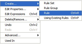

    • From the toolbar, click New and select Rule.
    • Click Create..., then Rule from the right-click menu.
    • Press Ctrl+R.
    The Figure 4-35 opens.

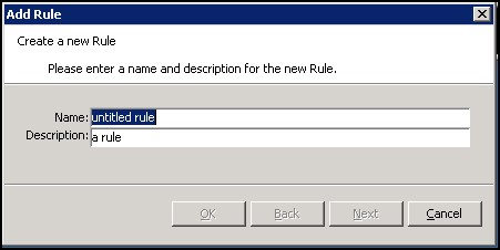

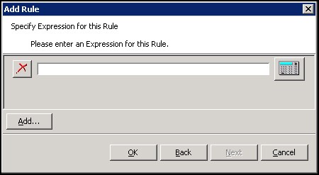

  3. In the Name field, enter the name of the rule.
    A rule name can be a maximum of 24 alphanumeric or underscore characters. It must not have a name that is the same as any other rule that exists in the project. Rule names may start with a letter or an underscore but may not start with the letter r or R followed by a number.
  4. In the Description field, enter a description of the rule.
  5. Click Next. The Expression Builder window of the Add Rule window opens.
    Figure 4-36 Specify Expression for Add Rule
    Description of Figure 4-36 follows
    Description of "Figure 4-36 Specify Expression for Add Rule"

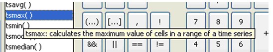

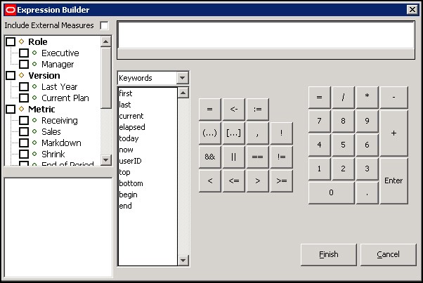

  6. Type the expression in the input box or complete the following to use the Expression Builder.
    1. Click Expression Builder (located to the right of the text box). The Expression Builder window opens.
      Figure 4-37 Expression Builder Window
      Description of Figure 4-37 follows
      Description of "Figure 4-37 Expression Builder Window"

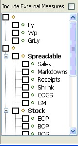

    2. In the upper left-hand pane, select the measure components to filter measures to be visible for pasting into the expression. If External Measures are required in the expression, check the Include External Measures check box. Realized measures meeting the filtering conditions are displayed in the lower left-hand pane.
      Figure 4-38 Include External Measures Check Box
      Description of Figure 4-38 follows
      Description of "Figure 4-38 Include External Measures Check Box"
    3. In the lower left-hand pane, double-click any measures to be used in the expression to get the measure name pasted at the insertion point in the expression.
      Place the mouse over the name of a function, procedure, keyword, or modifier to see a tooltip that explains its function.
    4. From the drop-down list, select a category of functions, procedures, keywords, or modifiers. Double-click on a specific function, procedure, keyword, or modifier to be used in the expression, and (if appropriate) outline syntax pasted at the insertion point in the expression.
      Figure 4-41 Category Options List
      Description of Figure 4-41 follows
      Description of "Figure 4-41 Category Options List"
      The outline syntax of a function, procedure, keyword, or modifier is pasted with components of the syntax separated with braces {}. When the insertion point is in a component of the outline syntax in the expression, you will see a description of the component at the bottom of the expression window. When the insertion point is in a component of the outline syntax, anything that is entered or pasted replaces the whole component.

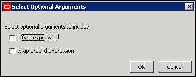

      If the function, procedure, keyword, or modifier that is pasted has optional arguments (for example, the cover function has optional arguments for an offset expression and a wrap-around expression), you will be presented with the following window to select which of the optional arguments to use in the expression. Note that all arguments are positional, so if a later argument is selected, all earlier arguments will be automatically selected. If an earlier argument is cleared, then all later arguments are automatically cleared.
      Figure 4-43 Select Optional Arguments Window
      Description of Figure 4-43 follows
      Description of "Figure 4-43 Select Optional Arguments Window"
      If the function, procedure, keyword, or modifier that is pasted has repeating arguments (for example the min function finds the minimum of a variable number of expressions), a window opens to select how many of the repeating arguments to use in the expression.
    5. Use the keyboard or buttons to add the appropriate mathematical operators and constants to construct the expression.
    6. When you have defined the expression as needed, click Finish and close the window.

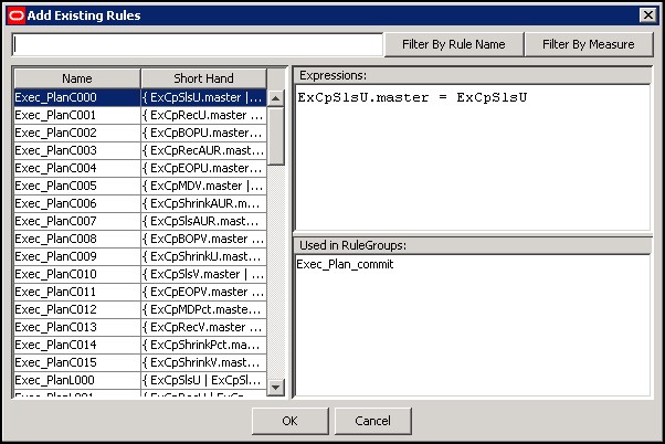

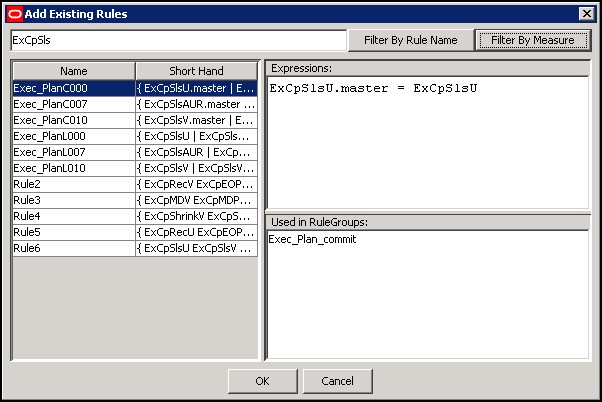

Add an Existing Rule to a Rule Group
Using the Add Existing Rules window, you may select multiple rules to add to a rule group. If at least one of the selected rules is already in the rule group, the OK button will gray out disallowing the operation until that rule is cleared. When multiple rules are selected, the expression and rule group displays will go blank. However, if there is only one selected rule, the rule's expressions and the list of rule groups that use the rule will be displayed.
  1. In the Rule Definition window, select the rule group to be used to add an existing rule. If the rule is to be placed in a particular position in the sequence of rules in the rule group, select the rule in which the new rule is to precede.
    • From the toolbar, click New and select Using Existing Rule.
    • Select Create – Using Existing Rule from the right-click menu.
    • Press Ctrl+P.
    The Figure 4-45 opens.
    Figure 4-45 Add Existing Rule Window
    Description of Figure 4-45 follows
    Description of "Figure 4-45 Add Existing Rule Window"
  3. Filter by Rule Name or by Measure and view the associated expressions to find the correct rule. Filtering means that all data are compared, but only matching data is allowed to pass through. In order to filter by Rule Name or by Measure, type a filter string (for instance, ExCpSls in the input box directly under the Title Bar. Click Filter by Measure, and only those measures with ExCpSls display.
  4. Click the rule in the table to select it.
  5. Click OK to save changes and close the window.
    The rule is placed higher than the rule that was selected at the start of the process in the sequence of rules in the rule group or at the end of the rule group if no rule was selected.

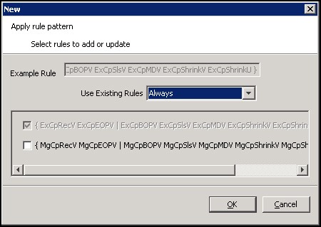

Apply a Rule Pattern to Create New Rules or to Update Existing Rules
The Apply Rule Pattern functionality allows you to create new rules or update existing rules according to a pattern established by a selected base or template rule. The rule tool recognizes inherent similarities or patterns in measure components used in some rules when compared to the base or template rule. Based on these similarities, the rule tool allows for the creation of new rules or update of existing rules to fit the pattern set by the base or template rule.
When the Apply Pattern capability is enabled, there is a possibility that some of the New or Updated rules will have the same expressions as a rule that already exists in the rule pool. If this happens, the Similar Rules Found window opens and provides the option of using the existing rule or actually creating a new one.
  1. In the Rule Definition window, select any rule group that contains the rule to use as the pattern basis.
  2. Select the rule whose pattern is to be used as a basis for creating or updating rules.
  3. From the toolbar, click Advanced and then select Apply Pattern, or right-click and select Advanced and then, Apply Pattern.
    A Figure 4-47 opens containing a set of rules that are presented for selection. This set is composed of rules whose measures follow the selected rule's pattern in terms of the individual measure components used. The set of rules are composed of potential new rules or potential updated rules.
    Figure 4-47 New Apply Rule Pattern Window
    Description of Figure 4-47 follows
    Description of "Figure 4-47 New Apply Rule Pattern Window"
    Example:
    Consider a configuration with three components in the measure naming scheme:
    • a version (such as Wp)
    • a metric (such as Shrink)
    • a unit of measure (such as V)
    If the selected base rule is:
    { WpShrinkU WpShrinkAUR | WpShrinkV }
    ...then the rules:
    Rule1: { WpSlsU WpSlsV WpSlsAUR | }
    ...and
    Rule2: { WpRecU WpRecV WpRecC | }
    ...would fit the pattern and be included in the list.
    Rule1 fits the pattern because its measures use the same measure components with the exception of the metric component. For the Metric component, the base rule uses Shrink, and Rule1 uses Sls consistently. In this case, the tool will present the rule:
    { WpSlsU WpSlsAUR | WpSlsV }
    ...as a possible update for Rule1.
    The update results in the conversion of Rule1 to a rule that uses the same measures as the original Rule1, but it has the expression pattern of the base rule.
    Rule2 fits the pattern because it uses the same Version as the base rule. For the Metric component, the base rule uses Shrink, and Rule2 uses Rec consistently. Unlike Rule1, Rule2 uses C as the Unit of Measure in one of its measures. This is not an exact fit like Rule1. In this case, the tool will present the rule { WpRecU WpRecAUR | WpRecV } as a possible new rule. Notice that this rule is forced to be an exact fit as Rule1 was.
  4. Select the rule replacement policy in the Use Existing Rules drop-down menu. This allows the user to select, on a rule-by-rule basis, which rules to reuse and which to re-create. By default, this is set to Always.
    • When Always is selected, rules that already exist elsewhere in the configuration will always be used in place of the newly generated rules.
    • When Never is selected, new rules will always be created, even if an identical rule already exists elsewhere in the configuration.
    • When Prompt is selected, the Rule Locator window will be presented for each rule whose expressions already exist elsewhere in the configuration.
  5. From the list of possible new and updated rules, select those to be updated or added to the rule group. In either case, if rule reuse is specified in Step 4, a new rule will not be created, but the rule existing elsewhere in the configuration will be used in its place.
  6. Click OK.
    A selected rule that is labeled New Rule will be added to the end of the rule group. The new rule's name will default to the template rule's name suffixed with a number to keep the name unique. A selected rule that is labeled Update Rule is already in the rule group and will be replaced. This means that the old rule will be removed and replaced with a new rule whose expressions follow the base rule's expression pattern. In both cases, the rule will follow the pattern of the base rule's expression.

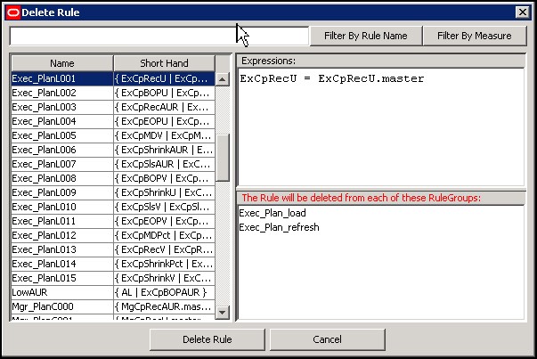

Delete a Rule from All Rule Groups
This procedure deletes the rule from all rule groups that contain this rule as well as from the Rule Pool. If the desired action is to remove the rule from a rule group, but to retain it in other rule groups, follow Remove a Rule from a Rule Group.
  1. In the Rule Definition window, select any rule group that contains the rule to be deleted.
  2. Select the rule to be deleted.
    If multiple rules are selected, only the last selected rule is deleted.
  3. From the toolbar, click Delete and select Delete Rule, or select Delete, then Remove, and then Delete Rule from the right-click menu. The Figure 4-48 opens.
  4. Verify that the rule selected in the table is the rule to be deleted or click to select a different rule in the table.
  5. Click Delete Rule to delete the rule and close the window.

    Figure 4-49 Rule Properties Window
    Description of Figure 4-49 follows
    Description of "Figure 4-49 Rule Properties Window"
  4. To edit the name of the rule, enter a new name in the Name field.
  5. To edit the description of the rule, enter a new description in the Description field.
  6. To edit attributes for a rule:
    1. Select the attribute to edit.
    2. Click Edit. The Figure 4-50 opens.
      Figure 4-50 Edit Attribute Window
      Description of Figure 4-50 follows
      Description of "Figure 4-50 Edit Attribute Window"
    3. Update the information as necessary.
    4. Click OK to save any changes and close the window.
  7. To remove attributes from a rule:
    1. Select the attribute to delete.
    2. Click Remove. The attribute is removed from the display box.
  8. Click OK to save any changes and close the window.

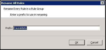

Rename All Rules in a Rule Group
Complete the following steps to rename all rules in a Rule Group.
  1. In the Rule Definition window, select the rule group that contains the rules to rename.
  2. From the toolbar, click Advanced and select Rename All Rules, or select Advanced – Rename All Rules from the right-click menu. The Figure 4-51 window opens.
  3. In the Prefix field, enter a prefix up to ten characters in length, which is the start of all rule names.
  4. Click OK. The Figure 4-52 window opens.
  5. Click Yes.
    All of the rules in the rule group are renamed with the prefix followed by a 4-digit numeric identifier generated by the rule tool. The rule tool will maintain the order that the rules were in before they were renamed, and it uses that order in generating the numeric identifier.
    Since rules may appear in more than one rule group, use of this feature may generate rule names that look out of place in other rule groups, especially if the prefix implies the rule group.
Filter Rules in a Rule Group
Complete the following steps to filter rules in a Rule Group.
  1. In the Rule Definition window, select a rule group.
  2. In the Rule Definition window, click Rule Filtering.
    Figure 4-53 No Filtering Button in Rule Definition Window
    Description of Figure 4-53 follows
    Description of "Figure 4-53 No Filtering Button in Rule Definition Window"
    This is a dynamic button, and the text changes depending on the current filter mode.
  3. Select one of the following options:
    • Disable Filtering – All rules display.
    • Filter by Measure – Works in conjunction with the measure components box in the bottom left corner of the screen. Rules are filtered to show those whose measures conform to the selected component scheme.
    • Filter by Size – Rules are filtered to show those with more than one expression.
    • Filter by Validity – Only invalid rules display.
    When rule filtering is active, the buttons used to reorder rules in the rule group are unavailable.

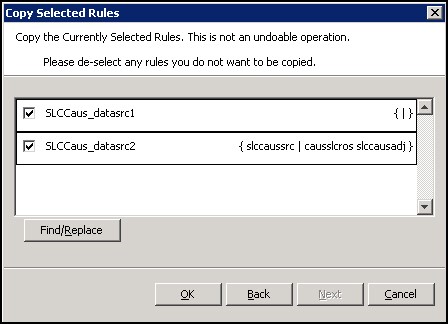

Copy Selected Rules to Another Rule Group
Complete the following steps to copy selected rules to another Rule Group.
When copying selected rules of a rule group into another rule group, it is possible to specify whether existing rules will be used or copies of the rules will be created. The Use Existing Rules check box defaults to using any existing rules in the rule pool. If this check box is selected, the copy selected rules operation will use the same rules that the source rule group has. If this check box is not selected, the copy selected rules operation will create copies of the rules and use those copies for appending to or replacing rules in the destination rule group.
When the user uses the Find/Replace feature, it is possible that a changed rule will have the same expressions as a rule that already exists in the rule pool. If the Use Existing Rules check box is selected, the Similar Rules Found window opens. You have the option of using the existing rule or creating a new one.
  1. Select the Rule Group that contains the rules to copy, and select the individual rules to be copied.
    To select multiple rules, press the Ctrl key and click the rules to select, or click one rule and hold Shift key as selecting another rule, which selects all rules between the two that have been selected. A selected rule is indicated by a bold rule name.
  2. Complete one of the following methods:
    • From the toolbar, click Advanced, and select Copy Selected Rules.
    • Select Advanced – Copy Selected Rules from the right-click menu.
    • Press Ctrl+C.
    The first Figure 4-55 opens.
    Figure 4-55 Copy Selected Rules Window (1)
    Description of Figure 4-55 follows
    Description of "Figure 4-55 Copy Selected Rules Window (1)"
  3. In the Rule Set field, select the copy's destination rule set.
  4. In the Rule Group area, select the desired copy's destination Rule Group.
  5. Check the Use Existing Rules check box if the rules should be added to the destination Rule Group. If the User Existing Rules check box is clear, copies of the selected rules are created for the destination Rule Group instead.
    If the Find or Replace functionality is used, copies are created for affected rules even if the Use Existing Rules check box is checked.
  6. In the Replace or Append Rules field, select:
    • Replace – To remove all rules that already exist in the destination rule group before the copy.
    • Append – To add to the rules already in the destination rule group.
  7. Click Next. The second Figure 4-56 opens. This window allows you to select or clear rules from those originally selected to copy when the check box beside the rule name is selected.
    Figure 4-56 Copy Selected Rules Window (2)
    Description of Figure 4-56 follows
    Description of "Figure 4-56 Copy Selected Rules Window (2)"

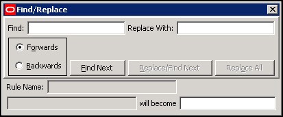

Find and Replace Measures in the Copied Rules
The ability to find or replace in the copy rules is a very powerful and useful feature. This feature can be used to build a collection of rules and clone them to a very similar collection of rules. For example, a collection of rules that calculate a series of variances with one version can be cloned to produce rules that calculate a series of variances with another version.
  1. Click Find/Replace. The Figure 4-57 opens.
    Figure 4-57 Find/Replace Window
    Description of Figure 4-57 follows
    Description of "Figure 4-57 Find/Replace Window"
  2. In the Find field, enter the portion of the measure to replace.
    The Find function is case sensitive.
  3. In the Replace With field, enter the string to replace the portion of the measure name.
  4. Complete one of the following:
    • Select Forwards to search the rules in order
    • Select Backwards to search the rules in reverse order.
    Searching Forwards proceeds from left to right starting with the first measure of the first expression of the first selected Rule and will go through all expressions in all selected Rules. Similarly, searching Backwards flows in the reverse direction starting with the right most measure of the last expression in the last Rule selected.
  5. Click Find Next. The first candidate measure to be replaced displays in the bottom left field.
  6. Complete the following as needed:
    • Click Replace/Find Next to replace the current candidate measure and display the next candidate measure.
    • Click Replace All to replace all instances in all the selected Rules of the current candidate measure. For example, if a search for Wp finds WpRecV, click Replace All to complete a replace on all instances of WpRecV in all the selected Rules.
    • Click Find Next to skip over that occurrence of the portion of the measure name and go onto the next one.

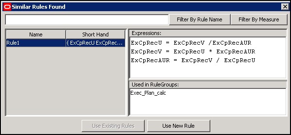

    The Figure 4-58 opens.
    Figure 4-58 Similar Rules Found Window
    Description of Figure 4-58 follows
    Description of "Figure 4-58 Similar Rules Found Window"
  7. Replace the rules.
    Using the Figure 4-58, you can replace a portion of the rules (for instance a prefix) either for all instances of the rules or only for the new instances (where the old instances are not affected).
    Example:
    Suppose you create a series of rules for the Executive (Ex) Calc Rule Group and you want to use these as a model for the Manager (Mg) Calc Rule Group. Each of these original rules contains expressions with the Ex prefix. Each such instance needs to be replaced with Mg.
    1. Click Use Existing Rules to replace every instance of Ex.
    2. Click Use New Rule to replace the new instances of Ex without affecting the previous rules that contain Ex.
  8. Click X to close the Figure 4-57.
  9. Click OK.
  10. Click Yes to confirm.
    The copies of the rules are placed in the target rule group. These copies have names that start with as many characters as possible from the name of the original rule and end with an underscore and number.

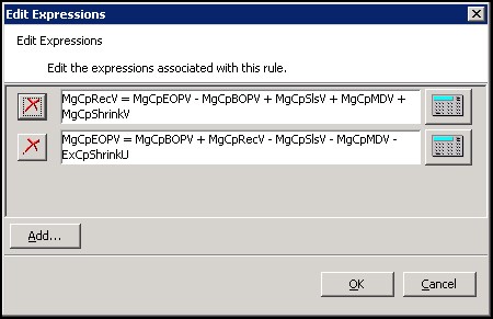

Edit an Expression in a Rule
Complete the following steps to edit an expression in a Rule.
  1. In the Figure 4-28, select the rule whose expression is to be edited.
    • From the toolbar, click Expression Builder.
    • Select Edit Expressions from the right-click menu.
    • Press Ctrl+E.
    The Figure 4-60 opens.
    Figure 4-60 Edit Expressions Window
    Description of Figure 4-60 follows
    Description of "Figure 4-60 Edit Expressions Window"
  3. Choose one of the following methods to edit an expression:
    Edit the expression in its text box.
    Click Expression Builder for the expression to edit. The Figure 4-61 opens. Use the Expression Builder to make necessary changes and click Finish when complete.
    Figure 4-61 Expression Builder Window
    Description of Figure 4-61 follows
    Description of "Figure 4-61 Expression Builder Window"
  4. Click OK to save the changes and close the window.

Add an Expression to a Rule
Complete the following steps to add an expression to a Rule.
  1. In the Rule Definition window, select the rule that will have an expression added.
    • Press Ctrl+E.
  3. Click Add to add a new expression in the Edit Expressions window.
  4. Choose one of the following methods:
    • Enter the expression in its text box.
    • Click Expression Builder for the expression to edit. The Figure 4-61 opens.
      Use the Expression Builder to define the rule and click Finish when complete.
  5. Click OK to add the expression.

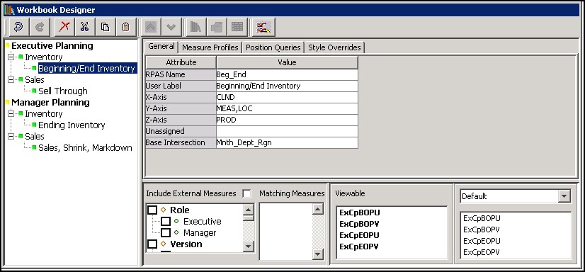

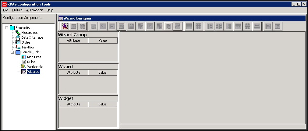

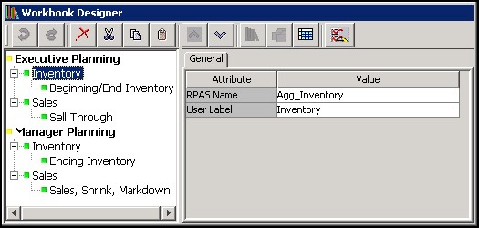

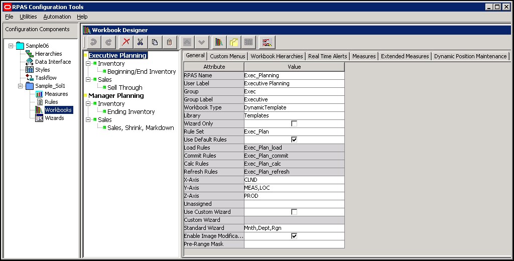

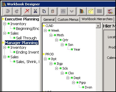

Workbook Designer
The Workbook Designer provides a visual represent of your workbooks, workbook tabs, and worksheets.
Figure 4-62 Workbook Designer Window
Description of Figure 4-62 follows
Description of "Figure 4-62 Workbook Designer Window"
The Workbook Designer contains the following areas:
  • Workbook Tree - The workbook tree provides a visual representation of the workbooks, workbook tabs, and worksheets. In the example provided, Executive Planning and Manager Planning are workbooks. Inventory and Sales are workbook tabs. Beginning/Ending Inventory and Sell Through are worksheets, which are contained in the Inventory and Sales workbook tabs.
  • Workbook Toolbar - This toolbar is used to complete common tasks. The buttons available depend on the item selected in the Workbook Designer window.
  • Workbook Tabs - The workbook tabs are used to define property at the workbook level. The tabs displayed depend on whether a workbook, workbook tab, or worksheet is selected from the Workbook tree. In Figure 4-62, Executive Planning (a workbook) is selected. The seven workbook tabs displayed are available to define specific properties for your workbook. For information on these tabs, refer to Workbook Tabs.

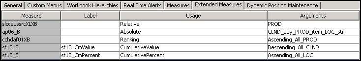

Participation Measures Overview
An extended measure or participation measure is a measure that contains the value of the current positions as a proportion of the value at a Parent level, for example, sales as a percent of the class sales. These measures can be viewed and edited, and they may be preconfigured through the RPASCE Configuration Tools or dynamically defined in the RPASCE Client in a worksheet.
Typical uses of this functionality are to define measures that are percentage participations of sales measures. Typically, these are either to a fixed level (such as class) so the participation of each item to the class can be viewed and manipulated, or they are to the next level up in the product hierarchy.
The following procedures use the sample product hierarchy structure as shown in Figure 4-63
Figure 4-63 Sample Product Hierarchy Structure
Description of Figure 4-63 follows
Description of "Figure 4-63 Sample Product Hierarchy Structure"
Note the following important points when using this feature:
  • Changing the percentage of the extended measure will cause the values of the underlying measure to change to reflect the newly set percentage.
  • Multiple extended measures can be defined for the same underlying measure; however, only one extended measure or the underlying measure can be edited before calculation occurs. All other versions will be protected.
  • The value of an extended measure is a fraction between zero and one. You must format the measure to be displayed as a percentage if desired.

When a workbook is selected from the Workbook Designer window, the following tabs display in the workspace:
Refer to these topics for information on using these tabs to define the workbook properties.

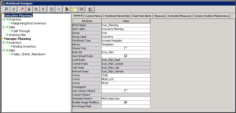

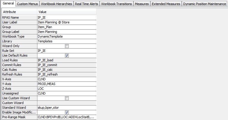

General Tab

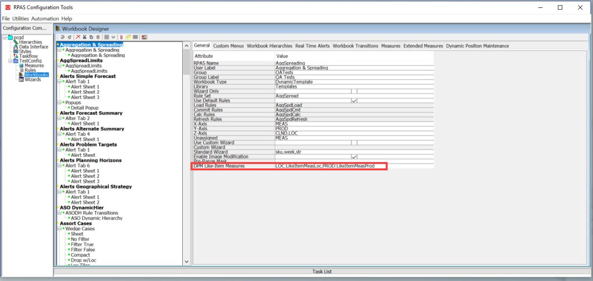

This section describes the default fields that display on the General tab.
RPAS Name
This is the RPAS internal name of the workbook.
User Label
This is the label that the end user sees when selecting which workbook to build.
Group
In the RPASCE Client, workbooks are grouped together under tabs (workbook template groups) to make it easier for the end user to find and select the needed workbook when solutions have multiple workbooks. This is the internal RPAS name of the group that this workbook belongs to.
Group Label
In the RPASCE Client, workbooks are grouped together under tabs (workbook template groups) to make it easier for the end user to find and select the needed workbook when solutions have multiple workbooks. This is the label the end user sees of the group to which this workbook belongs to. If different labels are entered for the same workbook group against different workbooks, the workbook group label shown to the end user will effectively be arbitrary.
Workbook Type
This property is reserved for use when custom extensions are written. It enables the custom extension to determine the type of the template where the template type has a meaning defined by the custom extension writer. When there is no custom extension, this field is set to the value DynamicTemplate by default.
Library
When the Workbook Type is not DynamicTemplate, it needs to be associated with a relevant custom shared library. This field holds the name of that library. When there are no custom extensions, this field is set to Template by default. The name entered here needs to be consistent with the custom extension. For example, if a value of ABCTemplate is entered in this field, the custom library needs to be named ABCTemplateLib and the directory where the custom extension looks for configuration files in the application will be repos/ABCTemplates.
Wizard Only
The Wizard Only option is only used under circumstances when custom code is to be executed in a batch job at the end of the wizard process (which typically uses custom wizards) instead of building and opening a standard workbook. The selections made in the wizards are passed to the custom code. Therefore, a workbook with the Wizard Only option selected is not a workbook. However, the workbook infrastructure is used so that the process can have a name and label and be assigned to a workbook group. This allows end users to select a Wizard Only template using the same process as workbooks. Workbooks that have the Wizard Only option selected do not need tabs or worksheets defined, but they do need a name, label, and workbook group.
Rule Set
Selects the rule set to use with the workbook. The list of rule sets to select from includes all the rule sets in the same solution as the workbook template.
Use Default Rules
Select this option to use the default rules (Load, Commit, Calc, and Refresh) associated with the rule set. If this option is selected, the Load Rules, Commit Rules, Calc Rules, and Refresh Rules properties are unavailable. If the option is not selected, the Load Rules, Commit Rules, Calc Rules, and Refresh Rules properties are enabled.
Load Rules, Commit Rules, and Calc Rules
Select the rule group to apply for each rule group type. Only rule groups from the selected rule set are offered.
Refresh Rules
When the Use Default Rules option is not checked, Refresh Rules is enabled. Select the rule groups to use as refresh rule groups. When enabled, click in the Refresh Rules field. The Figure 4-65 opens.
Figure 4-65 Select and Order Multiple Rule Groups Window
Description of Figure 4-65 follows
Description of "Figure 4-65 Select and Order Multiple Rule Groups Window"
Use this window to specify which groups are available and used to refresh the workbook.
Partial data in a workbook can be refreshed by refreshing with a rule group that only updates some of the measures in the workbook. The order that the rule groups appear is the order in which they display to the end user when presented with a choice of refresh rule groups within the workbook.
  1. In the Available Rule Groups column, select the rule group to add, and drag it to the Selected Rule Groups column.
  2. Click OK to save any changes and close the window.

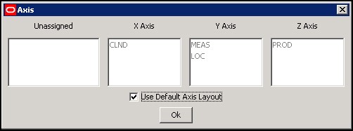

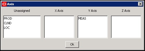

X Axis, Y Axis, Z Axis and Unassigned
These properties are used to define the default axis layout of the worksheets in the workbook (that is, which hierarchies appear in each axis). Before the hierarchies appear in the Axis window, you must make sure that the database and base intersection have been assigned from the Measure Manager.
The measures must also be made viewable.

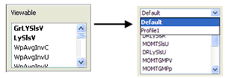

  1. To make measures viewable, right-click in Default and select Add Matching.
  2. Click in the X-Axis, Y-Axis, Z-Axis, or Unassigned field. The Figure 4-66 opens.
  3. Drag the hierarchies to the appropriate axis column.
    The hierarchies that appear in this process are the hierarchies used by measures placed on worksheets in the workbook. If no worksheets have yet been built, then no hierarchies appear in this process.

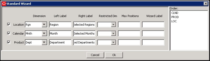

Select the dimensions to be selected by the end-user in the standard wizard, which presents a series of two tree selection panes to select the positions in the scope of the workbook to be built.
  1. Click in the Standard Wizard field. The Figure 4-67 opens.
    Figure 4-67 Standard Wizard Window
    Description of Figure 4-67 follows
    Description of "Figure 4-67 Standard Wizard Window"
    Hierarchies used in the lowest base intersection for the measures used in the rule set assigned to the workbook will be displayed. For each hierarchy, there will be a choice of dimensions. The dimensions offered will be the lowest dimension in that hierarchy that is used in the base intersection of a measure in the rule set assigned to the workbook, plus all higher dimensions.
    For a hierarchy in the workbook for which a wizard is not available, all the positions in the PDS will be pulled into the workbook. If position level security has been applied to the user, a subset of the position will be pulled in.
  2. Select the check boxes next to the hierarchy names to enable the hierarchies for which that the end user in the RPASCE Client should select positions.
  3. Dimension: Select the desired dimension from each of the enabled hierarchies.
    The dimension selected is the lowest dimension offered to the end-user in the scope selection wizard during the workbook build process. However, the workbook requires positions at the lowest dimension offered. Therefore, if the selected dimension is higher than the lowest dimension offered, the scope of the workbook includes all of the positions in that lowest dimension that are descended from the positions selected from that higher dimension.
  4. Left Label and Right Label: (Optional) Enter the left and right labels for each hierarchy. These labels will be displayed on the left and right trees of the corresponding 2-tree wizards during the workbook build process. If these fields are left blank, no labels will be displayed over the hierarchy trees.

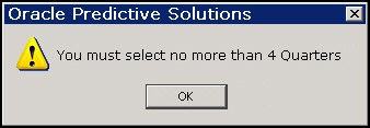

  5. Restricted Dim and Max Positions: For applications such as pricing, a retailer might want to restrict the selection of SKUs in a planning workbook to only one category. A planner may be allowed to plan several categories within a department, but only one category per plan. Per the retailer's business process, a category would establish a coherent set of SKUs, the cross-item effects of which could be considered meaningful for a price optimization algorithm. Mixing in SKUs from two or more categories could be considered as polluting the cross-item effects, and therefore an undesirable situation. What may also be required for this application is the ability to select SKUs or Classes that comprise a subset of possible SKUs or Classes within the Category, but not the whole category.
    With this latter requirement, a single-select wizard at the category level would not allow the user to filter subsets of SKUs or Classes. What is required is the ability to make multiple selections at the SKU or Class levels in a standard RPASCE Two Tree selection wizard, while still ensuring that only one Category is used. Even though this can be achieved through the disciplined selection of SKUs and Classes in a Two Tree Wizard, RPASCE allows for setting up a hard constraint so that the wizard itself can keep the user from selecting subsets in more than one Category by displaying an error message and preventing the user from proceeding to the next wizard page until the constraint has been satisfied.
    The constraint can be easily established within the Standard Wizard definition window in the Workbook Definition tool of the Configuration Tools. Two new fields are available for every Two Tree selection page in the standard wizard, one where the user selects the level from the hierarchy (Restricted Dim field), and another where the user enters the maximum number of selectable positions from that level (Max Positions field). These fields are optional, and if left empty, there is no limit on the number of positions that may be selected using the wizard. These fields are also available for Two Tree pages used in custom wizards.
    Another possible business application of this feature is to constrain the length of the planning period. A retailer may want the planners to never plan more than 12 weeks at a time, and it may not matter whether these weeks belong to the same quarter or not. In such a case, the retailer will want to establish the constraint of 12 at the week level, the lowest level where the selection is made. The planner may select at the quarter level, thus automatically selecting all the weeks in the Quarter; however, RPASCE will ensure that whatever the definition of the Quarter is, it does not contain more than 12 weeks.
    Apart from the functional ability to restrict selections to coherent set of positions provided by the Max Positions feature, this feature also allows system designers to constrain the size of workbooks by limiting the maximum number of positions that a user can add to a workbook. In the past, users have been known to add all positions to a workbook because such a selection is easy to make. They may only require 5-10% of those positions, but they still add them all because they can easily work with the desired subset in the workbook. System designers would like to prevent such abuse of the flexibility that workbooks provide, primarily because such abuse leads to wastage of disk space and because it slows down online performance due to the extra work that RPASCE has to do with unnecessary positions. System designers may therefore constrain the workbook to, for example, not include more than 500 SKUs at a time. The number 500 may not have any functional meaning but may be chosen because it does not constrain functionality in any way while still helping to constrain the size of the workbooks.
    This is a patchable feature, for example, existing configurations can be enhanced to benefit from this feature.
  6. Wizard Label: To attach a custom label to a wizard page, enter the desired label in this field. If this field is left blank, the wizard page will be given the default label.
  7. Order: Adjust the order of the hierarchies as necessary by dragging them in the order pane. This will be the order that the position selection wizards are presented during the workbook build process.

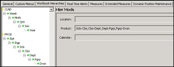

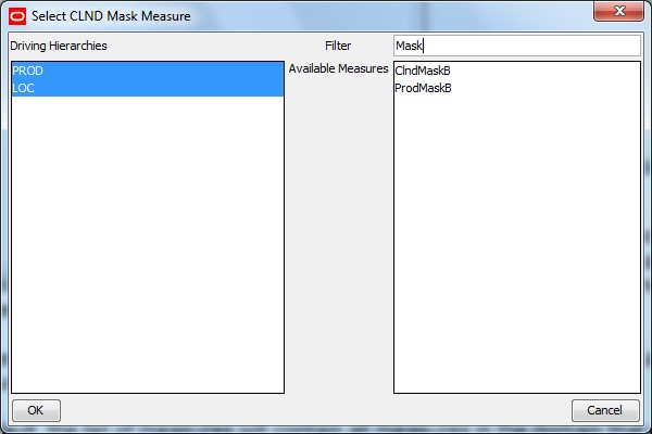

Hierarchy Pre-Ranging
Hierarchy pre-ranging allows you to filter available positions for selection in two-tree wizards based on relationships established at a specific intersection between the positions of two or more hierarchies. For example, you can set pre-ranging up so that when users select the time period Fall 09 in the wizard, the subsequent SKU selection screen will only display Fall-specific products, such as sweaters and jackets.
Hierarchy pre-ranging can be enabled for both standard wizards and for two-tree wizards in custom wizards; however, in custom wizards the behavior is guaranteed only if two-tree wizards are used as is, that is, their code is not overridden by the implementation team.

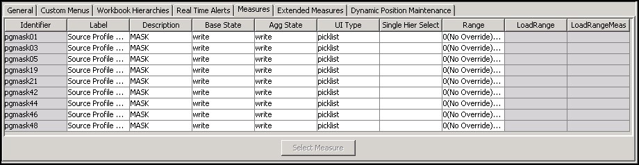

Pre-ranging is achieved by setting up one or more Pre-range Mask measures for the workbook. Each hierarchy in the workbook template can be optionally assigned a pre-range mask measure. Each of the hierarchy-specific mask measures must contain a dimension that ties back to one or more hierarchies that display in the wizard, along with one or more dimensions along which we want to pre-select relevant positions. Multiple hierarchies can share a common mask measure. The masking function is applied in the order of the wizard pages such that the selections of a wizard page may affect the list of available positions on any subsequent wizard page, but the selections of wizard page do not affect the list of available positions on a previous page if you click Back to return.
This approach allows:
  • One or more hierarchies within the workbook template not to be ranged, reducing the processing time and storage space.
  • The mask measure only needs to contain the target hierarchy plus optional conditioning hierarchies at its base intersection, reducing the number of hierarchies per mask measure and thus storage space as well.
  • The same mask measure can be used to range a common set of hierarchies in different workbook templates.
Example:
In a workbook template that contains PROD, LOC, and CLND hierarchies, two different mask measures are used: measure prodmaskloc (sku,str) to range down the positions that display in the LOC wizard, and measure locmaskclnd (str,week) to range down the positions that display in the CLND wizard. In the ConfigTools, “PROD:,LOC:prodmaskloc,CLND:locmaskclnd are specified in the Pre-Range Mask field under the General tab in the Workbook Designer tool.
Assuming the order of the wizard pages is PROD, LOC, and CLND, this is how the masks are applied:
  • All positions in the PROD hierarchy are available for selection as PROD is not masked.
  • Available positions for LOC hierarchy depend on the PROD hierarchy selections combining with the masking values of measure prodmaskloc.
