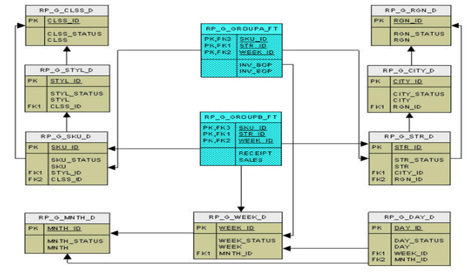

The data of retail business is multi-dimensional by nature, with typical dimensions including Product, Location, Calendar, Supplier, and so on. In the data mart schema, we use the data model called a de-normalized snowflake schema, which is built from the applications' configuration. Figure 3-2 shows a sample Entity Relationship Diagram (ERD) of the data model.
Figure 3-2 PDS Entity Relationship Diagram
Description of Figure 3-2 follows
Description of "Figure 3-2 PDS Entity Relationship Diagram"
The ERD shows two fact tables and their parent dimension tables (including all the roll-up dimension tables). The data model is a snowflake (as opposed to star) because there is a dimension table for each dimension level. It is de-normalized because each dimension table contains all the higher levels (not just the immediate parent). The data mart schema may contain hundreds of such snowflakes.
Because of the highly configurable nature of RPASCE applications (dimensions, measures, rules, workbook templates, and so on, are configured), the data mart schema is dynamically created, that is, dimension tables and fact tables are dynamically created from the application configuration. The data mart schema also contains a fixed set of metadata tables whose content is dynamically populated with application metadata. Batch calculation rules are dynamically translated into PL/SQL blocks and stored in PDS for IN-DB calculations.

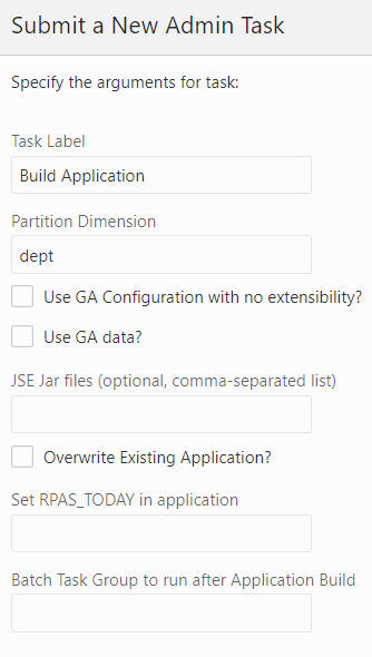

Building PDS
To build PDS for an application, users must have the application configuration and partitioninfo.xml uploaded to the Object Storage. In addition, the input files for dimensions and facts should optionally be loaded. For details, see Oracle Retail Predictive Application Server Cloud Service Implementation Guide.

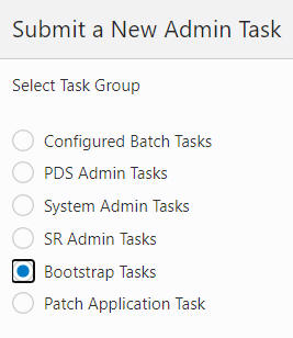

PDS can be built from the UI by completing the following steps:

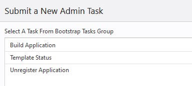

  1. From Online Admin Tools > Submit a New Admin Task, select Bootstrap Tasks, as shown in Figure 3-3.
  2. Select Build Application, as shown in Figure 3-4, and click Next.
  3. Provide the parameter values, as shown in Figure 3-5, and click Next to schedule or run the task.
    Figure 3-5 Build Application Parameters
    Description of Figure 3-5 follows
    Description of "Figure 3-5 Build Application Parameters"
  4. Select Run ASAP or Run on Schedule and enter the appropriate parameters, as shown in Figure 3-6.
    Figure 3-6 Build Application Schedule Parameters
    Description of Figure 3-6 follows
    Description of "Figure 3-6 Build Application Schedule Parameters"

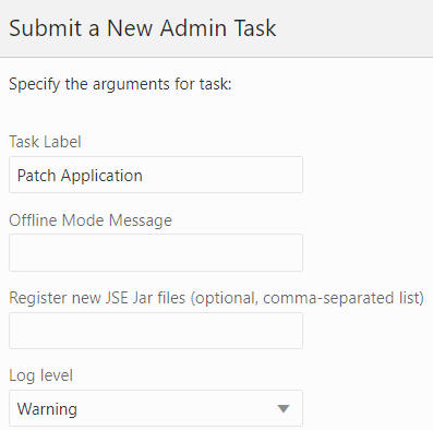

Patch PDS

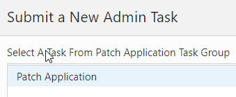

When changes occur in the application configuration, the already-deployed application can be patched. The Patch Application task is designed for this purpose.
To run the Patch Application task, first upload the application configuration <appName>_config.zip to the config folder in the Object Storage.
Then, complete the following steps.
  1. From Online Admin Tools > Submit a New Task, select Patch Application Task, as shown in Figure 3-7, and click Next.
    Figure 3-7 Patch Application Task
    Description of Figure 3-7 follows
    Description of "Figure 3-7 Patch Application Task"
  2. Select Patch Application, as shown in Figure 3-8, and click Next.
  3. Complete the Patch Application parameters, as shown in Figure 3-9, and click Next to schedule or run the task.
    Figure 3-9 Patch Application Parameters
    Description of Figure 3-9 follows
    Description of "Figure 3-9 Patch Application Parameters"

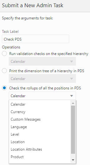

Check PDS

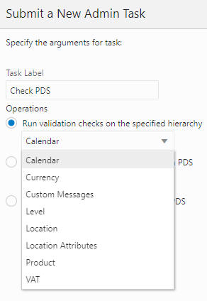

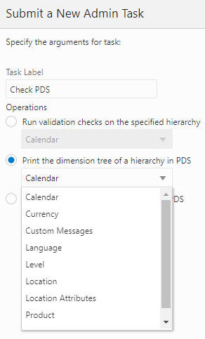

Use the Check PDS task to obtain diagnostic information from PDS. The user can select one of the following operations to perform.
Run validation checks on a specified hierarchy

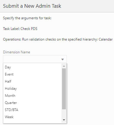

The user must provide the hierarchy for the validation to be conducted. As shown in Figure 3-10 and Figure 3-11, the user can provide the dimension level to further limit the validation. If the value is left blank, the operation will perform the validation on all dimensions of the hierarchy.
Figure 3-10 Validation Checks on Specified Hierarchy
Description of Figure 3-10 follows
Description of "Figure 3-10 Validation Checks on Specified Hierarchy"
Figure 3-11 Calendar Arguments for Specified Hierarchy
Description of Figure 3-11 follows
Description of "Figure 3-11 Calendar Arguments for Specified Hierarchy"
Print the dimension tree of a hierarchy in PDS
This operation prints the dimension tree using the PDS hierarchy information.The user is required to select the hierarchy to be printed, as shown in Figure 3-12.
Figure 3-12 Print Dimension Tree
Description of Figure 3-12 follows
Description of "Figure 3-12 Print Dimension Tree"

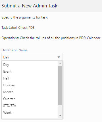

Check the rollups of all the positions in PDS
This operation is used to detect rollup corruption at dimension/level. As shown in Figure 3-13 and Figure 3-14, the user must first provide the hierarchy name and select the dimension for the validation. If the Check All option is enabled, the operation will perform the same rollup validation for all the dimensions that are rollups from the selected dimension. For example, if Day is selected and Check All is enabled, then, in addition to the Day dimension, Month, Quarter, Half, and so on, will also be validated.
Figure 3-14 PDS Rollups for Calendar
Description of Figure 3-14 follows
Description of "Figure 3-14 PDS Rollups for Calendar"

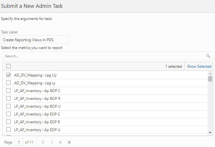

Create Reporting Views in PDS

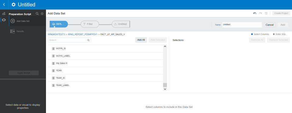

This operation is used to create database views for facts that can be selected. The views are used by Oracle Analytic Server (OAS) for data visualization/reporting. The facts, as shown in the OAT task Figure 3-16, are configured with Report Categories. (See Oracle Retail Predictive Application Server Cloud Edition Configuration Tools User Guide for details.) Note that the facts in the drop-down list are shown by their labels, which are created at configuration time. Navigation through various metrics is controlled using the Page numbering or Page Navigation options that are available in the bottom left corner of the screen.
There are two types of fact views that can be created using this OAT task.
The first type is for regular facts such as sales or inventory facts. These views have the naming convention fact_<reportCategory>_v. They contain the dimension levels from the facts’ base intersection and all rollup levels.
The second type is for attribute measures/facts. They have the naming convention of attr_<reportCategory>_v. In RPASCE, the attribute measures/facts can be one-dimensional or two-dimensional. Unlike the views for regular facts, the attribute views only contain the base dimension level of the attribute measures. In OAS, the attribute views are meant to be joined with regular fact views so that the report designers can do grouping/aggregation by various attributes (for example, product size, color).
Figure 3-16 Create Reporting Views in PDS
Description of Figure 3-16 follows
Description of "Figure 3-16 Create Reporting Views in PDS"
The same fact labels are used as column names in the OAS UI fact views, as shown in Figure 3-17. The fact labels are used as column names in OAS UI with the following restrictions:
  • If the label length is greater than 128 bytes, it will be truncated to 128 bytes (because of column length limit in Oracle DB).
  • Double quotes (") will be replaced with a white space, as they are not allowed in column names.
  • Duplicate labels are not allowed within a fact view. When a duplicate is encountered, it is truncated to 125 bytes, then a unique sequence number (up to three digits) is appended, in order to make the column name unique.
The columns of the attribute view tables are named after the attribute labels for which those columns contain data. However, the columns names must be altered to the following extent: Oracle does not allow a column name that is identical to a keyword in SQL. As an example, the attribute label Size cannot be used as a column name because Size is an SQL keyword. In cases where an attribute label happens to be identical to a SQL keyword, the underscore character '_' will be added to the end of the column name. For our example attribute Size, the column users of OAS will instead see SIZE_.
Due to the way OAS generates SQL queries on the Oracle Database, in order to pull data for reports, the column names will all be forced to upper case. While this is an inconvenience for users of OAS, it avoids a issue in which the use of mixed case can result in OAS generating bad queries that cause errors when attempting to pull data from the Planning Data Store. For exampl,e, the attribute name Color will appear as a column in OAS as COLOR.

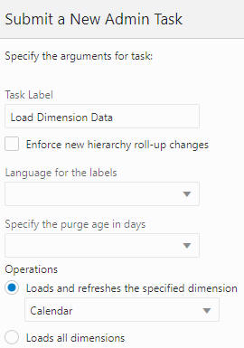

Load Dimension Data, shown in Figure 3-18, is used to load hierarchy information into the PDS from one or more flat files.
Figure 3-18 Load Dimension Data
Description of Figure 3-18 follows
Description of "Figure 3-18 Load Dimension Data"
Options
  • Language for the labels. Sets the language for the labels provided in the flat file. The default is English.
  • Enforce new hierarchy roll-up changes. When an incoming flat file contains only partial hierarchy data, it is possible that the data has different rollup positions than the records in PDS. Use this option to enforce the rollup from the flat file and apply it to all instances in PDS. If this option is not checked, the task will fail if it detects different rollups in the incoming file and in the records in PDS.
  • Specify the purge age in days. Use to auto purge records that have not been seen from the load file by the number of days specified in this field. If a value is not specified, the purge age defined by the configuration will be used.
  • Operations. Choose between loading a particular dimension (the dimension file must exist) and loading all dimensions. This allows the system to load the dimensions if the corresponded data files have been uploaded.

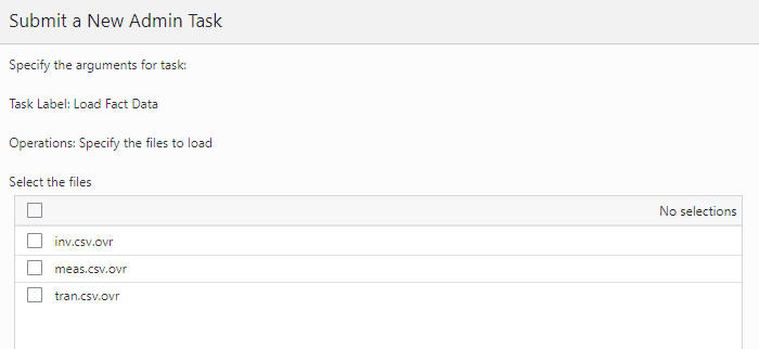

Load Fact Data

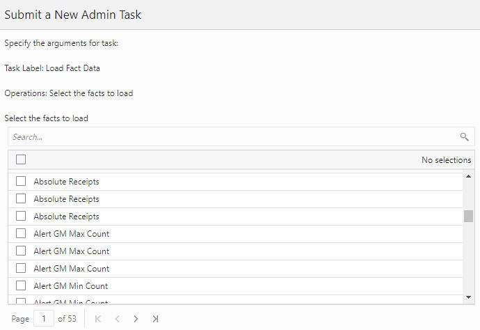

Use this task, shown in Figure 3-19, to load measure data into the PDS from flat files. Once present in the PDS, this data is available to any application that shares that measure throughout PDS. Prepare the flat files and place them in the Object Storage under "<SubNamespace>/planning/incoming/input. See Oracle Retail Predictive Application Server Cloud Service Implementation Guide for details regarding uploading and downloading batch files to the Object Storage.
The format of the data file must be CSV with a header line.
Multiple facts in the same fact base intersection, regardless of whether they are shared or non-shared measures, can exist in one data file.
The header line must contain the names of the fact base dimension, and the names of facts. The dimension names are listed in the order of their hierarchies. The non-shared measures must have their names prefixed with the fact prefix override.
For example, the input file of dh10wd2x.csv.rpl contains loading data for facts ut_dh10wd21n, ut_dh10wd21l, ut_dh10wd31n, and shared fact dh10wd31l.
sku,str,ut_dh10wd22n,ut_dh10wd22l,ut_dh10wd21n,ut_dh10wd21l,ut_dh10wd31n,ut_dh
10wd31l
sku_22200001,str1000,A01_B01,A01_B01,SK_ST1000,SK_ST1000,WORLD,WORLD
sku_22200001,str0959,A03_B03,A03_B03,SK_ST0959,SK_ST0959,INDIA,INDIA
sku_22200003,str1000,A01_B01,A01_B01,SK_ST1000,SK_ST1000,WORLD,WORLD
Administrators must pay close attention to the extension of the input file. RPASCE supports the following types of loads (identified by file name extension):
  • .ovr (Overlay): Existing values in the measure are overlaid with the values in the input file. Any values not included in the input file are not changed.
For string type measures, an empty cell in the .ovr file is treated as a valid string; as a result, the Load Fact Data task overwrites the previously loaded string with an empty string. For other measure types, an empty cell in the .ovr file is treated as invalid data. It is discarded and the previously loaded value is retained.
  • .rpl (Replace): The existing data for the facts specified in the data file is cleared, and the values in the input file are taken as the new values for the facts. Existing values for cells that do not exist in the load file are switched to NA. In other words, all data at the base intersection for the facts are removed before cells are populated with the data from the incoming file.
  • .inc (Increment): Increment mode must only be used with numeric measures/facts in which the load file contains incremental values. Therefore, if a cell had a value of 2 and the .inc file provided a value of 3 for the cell, then the new value for the cell is 5 (2 incremented with 3).
The Load Fact Data task allows multiple facts to be loaded from a single file. The multiple facts must have the same base intersection. If the data file contains multiple facts and the option Specify the files to load, all facts (specified in the header line) within the selected data file will be loaded. If a fact is in the header line but does not exist in the application, the corresponding column will be ignored and other facts will be loaded.
If this task skips records for any reason, a warning will be printed out to the log file that can be obtained from the OAT dashboard. The maximum number of skipped records that can be output to the log is 1000. After that, any further reject records will be skipped silently.
Options
  • Run in Trickle Feed mode. When this mode is enabled, loadFactData will use a transactional type of query for inserting and committing. Data will either be all loaded to the PDS or not loaded at all; a partial load is not permitted. This is intended for small data feeds only.
  • Do not clean input files used after the load. By default, data files are removed from the source location. Enable this option to have the file(s) remain at the original location after the load.
  • Operations

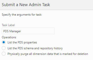

PDS Manager
Use PDS Manager, shown in Figure 3-22 to perform various PDS operations.
  • List the PDS properties. Print the list of properties for PDS.
  • List the PDS schema and repository history. Print the history and the schema.
  • Physically purge all dimension data. Purge all deleted dimension data and associated fact data from the PDS.

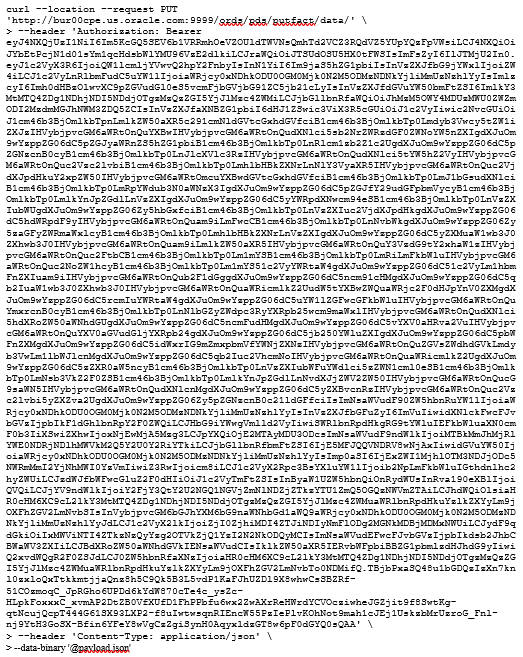

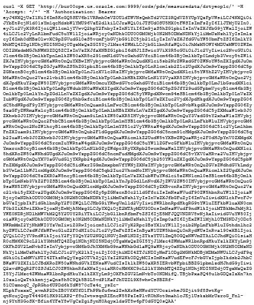

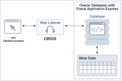

Planning Data Schema Default Web Services (through ORDS)
PDS is a common database platform shared by multiple applications. PDS is built with pre-created web services for measure metadata and measure data. The default web services are automatically available after PDS is built. Web services map to the PDS read-only schema in the database and uses Oracle Restful Services.
Apex User Creation
The types of users in Apex are:
  • Workspace Admin - Responsible for creating workspaces and additional users. This access is only provided to the Oracle/AMS team.
  • RPAS_READ_ONLY_WORKSPACE - Provides viewer access to the workspaces. This user cannot create additional users. These users can access the default web services. If the customer requires a user to be a rest API developer who can log into and build restful services on the PDS read-only schema, the customer must send email to the Oracle/AMS team.

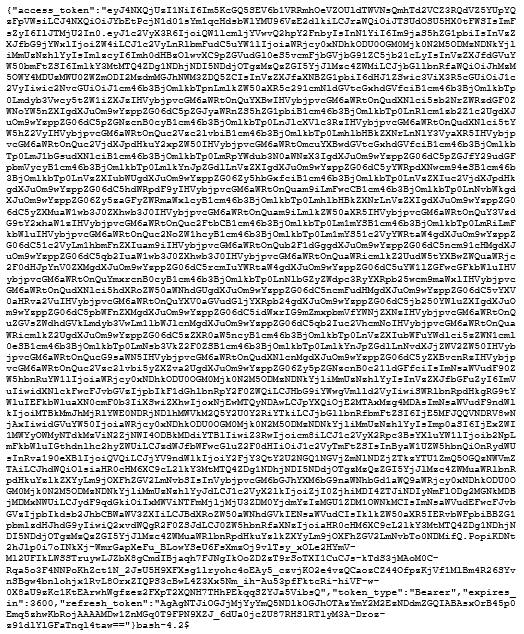

The Oracle/AMS team shares the base url for the web service during provisioning to the customer. This can be accessed by a user in the OCI IAM with the following group association: RPAS_ORDS_GROUP (for example, https://---wts.oracleindustry.com:443/ords).
Any users who are not part of the above group will not be able to access the web service. For more fine-grained control, it is possible to create multiple groups and map groups to specific rest urls.
In order to control access to the restful services to specific groups in OCI IAM, contact your Oracle/AMS Workspace Admin.

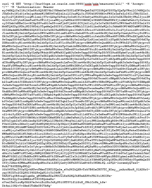

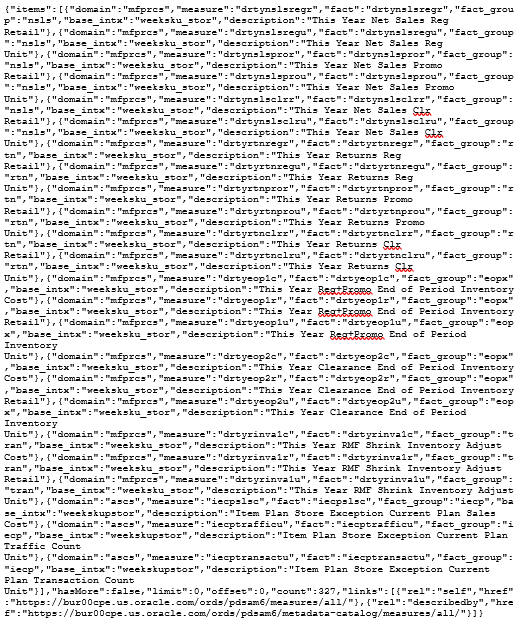

The default web services includes the following data:
  • The metadata web service exposes the following metadata for all measures in PDS: application, measure, (mapped) fact, base intersection, and description.

Figure 3-23 shows a high level architectural diagram of PDS (Oracle Database) with ORDS. Web services are accessible from any web service client (a web browser is an example of web client) through an ORDS Listener, which is deployed on a Tomcat server. Within the database, an ORDS enabled read-only schema provides access to the necessary database objects.
Figure 3-23 PDS - ORDS Architecture
Description of Figure 3-23 follows
Description of "Figure 3-23 PDS - ORDS Architecture"

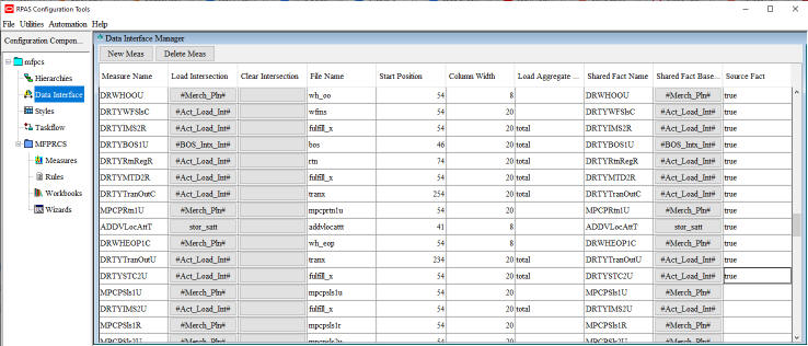

RPASCE also offers the PUT (write) web service that allows customers to write/update source facts in PDS. Source facts are the facts that are usually loaded (not calculated) whose mapping measures are flagged in the application configuration.
See the last column on the right in Figure 3-24 for source facts.
Figure 3-24 Integration Configuration
Description of Figure 3-24 follows
Description of "Figure 3-24 Integration Configuration"
Example URL for PUT service below.
https://<cust>-<env>-<app>-wts.oracleindustry.com:443/ords/pds/putfact/data/
The payload of the web service will be in a JSON format that can support input data for a fact at any intersection.
Here is a sample JSON file.
"fact_names": ["DRTYEOP1C"]
"intersection": ["week","stor","sku"]
"data_rows": [
                      ["w01_2017","900002","1005",1],
                      ["w01_2017","900002","1008",1]
OCI IAM Authorized Access to PDS Web Services in Apex/ORDS

Get Bearer Token
The access_token (Bearer) identifies your client access in Oracle Identity Cloud Service and will be used for subsequent REST API calls. This token is encoded following the JSON Web Token (JWT) standard. Replace the following credentials with the correct values for your environment.
curl -i -u "<IDCS-client-id>":"<IDCS-client-secret>" \
https://<idcs-tenant-id>.<IDCS_URL> \
-H 'Content-Type: application/x-www-form-urlencoded' \
-H 'Host: <idcs-tenant-id>.<IDCS_URL>' \
-d 'grant_type=client_credentials' -d 'scope=urn:opc:idm:__myscopes__'
Example Bearer Token Rest Call
curl -i -u "a3399f80531e4eff82637f0ba5c7d49d":"d3e376c2-d5fb-4d3b-b2d0-3bd52df6f5eb" \
https://idcs-148d8548c42947c983343db9b2e378ec.identity.c9dev2.oc9qadev.com/oauth2/v1/token \
-H 'Accept: application/json' \
-H 'Accept-Language: en' \
-H 'Accept-Version: 1.3.0' \
-H 'Host: idcs-148d8548c42947c983343db9b2e378ec.identity.c9dev2.oc9qadev.com' \
-d 'username=oci.admin&password=OracleRetail1&grant_type=password&scope=urn%3Aopc%3Aidm%3A__myscopes__%20offline_access' --tlsv1.2
You will see output that contains the following:
  • The Access Token request output in JSON format. The return contains the attributes access_token, token_type, and expires_in.
  • The access_token(Bearer) identifies your client access in Oracle Identity Cloud Service and will be used for subsequent REST API calls. This token is encoded following the JSON Web Token (JWT) standard.
    To check the JWT token, you can copy the access_token and verify its value using: https://jwt.io/#debugger-io
  • The token_type identifies the Access Token as a Bearer token type. In future requests, you will use this token type to identify your token in the Authorization header of your request.
  • The expires_in identifies the validity period of the Access Token.
Caution:
These bearer tokens may expire and may have to be regenerated in case a 401 Authorization Required error occurs.

Invoke Read PDS Web Service - Read all Measures
Output
All measures.
Figure 3-27 All Measures Output
Description of Figure 3-27 follows
Description of "Figure 3-27 All Measures Output"

Invoke Read PDS Web Service - Retrieve Data from a Fact
Replace the bearer token with the value received in Get Bearer Token
Note that these bearer tokens may expire and may have to be regenerated if a "401 Authorization Required" error occurs.
Figure 3-29 Retrieve Data from Fact
Description of Figure 3-29 follows
Description of "Figure 3-29 Retrieve Data from Fact"
Sample Output
