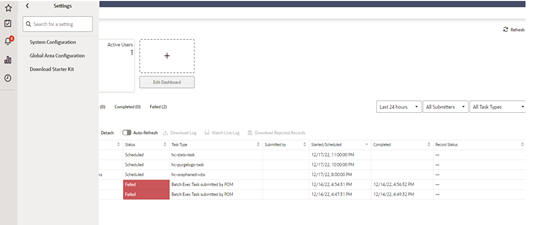

System Configuration provides administrators with the capability to update client-side system properties from the application. The administrator can now update various properties relating to administration status tasks, alert, chart, dashboard, export, image, logging, and separators, and format properties from the application. This feature lets you manage and support your team's operational needs.
The administration user can access the self-service feature from the Settings icon available at the bottom of the left sidebar menu.
You can use the system configuration to manage the following:

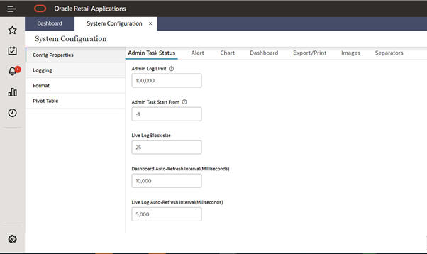

Admin Task Status
Use this tab, shown in Figure 16-3, to update the properties related to administration task status. The following properties can be updated:
Admin log Limit - Specify the number of lines in the administration logs. The range of permitted values is between 5,000 and 200,000.
Admin Task start from - Define the logging start from start (0) or end (-1) of the file.
Live Log Block Size - Enter the block size of the live log. The range of permitted values is between 20 and 30.
Use short name for entities - Toggle button to indicate whether you require short names for the entities in the status.
Dashboard Auto-Refresh interval - Update the auto-refresh interval time for the administration dashboard in milliseconds. The range of permitted values is between 1,000 and 86,400,000.
Live Log Auto-Refresh interval - Update the auto-refresh interval time for the live log. This is in milliseconds. The range of permitted values is between 1,000 and 86,400,000.

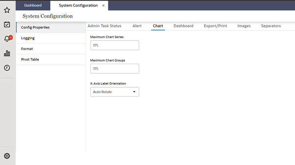

Chart
Use this tab, shown in Figure 16-5, to update the chart properties. The following properties can be updated:
Maximum chart series - The maximum number of series allowed in charts. The range of permitted values is between 100 and 200.
Maximum chart group - The maximum number of groups allowed to plot in charts. The range of permitted values is between 100 and 200.
X-axis Label Orientation - Select x-axis label orientation. The auto-rotate option is used to select the orientation of the x-axis labels, depending on the number of items in charts. The horizontal orientation option is used to display the x-axis label horizontally.

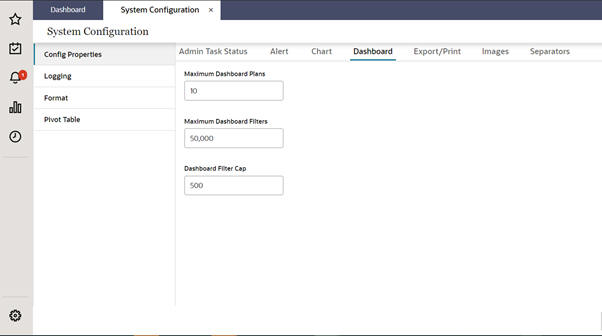

Dashboard
Use this tab, shown in Figure 16-6, to update the properties related to dashboards.
Maximum Dashboard Plans - The maximum number of plans for a dashboard. The range of permitted values is between 0 and 50.
Maximum Dashboard Filter - The maximum number of filters permitted in a dashboard. The range of permitted values is between 0 and 100,000.
Dashboard Filter Cap - The filter cap for a dashboard. The range of permitted values is between 0 and 1,000.
Show Retail Home Tasks - Toggle button used to show/hide retail home tasks.

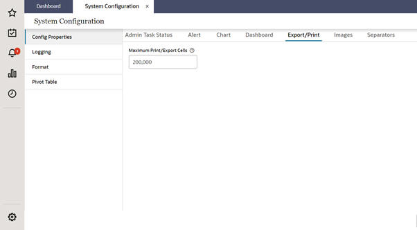

Export/Print
Use this tab, shown in Figure 16-7, to update the properties related to export and print functionality. The following properties can be updated:
Maximum print/Export cells - The number of cells that can be exported from the system. The range of permitted values is between 0 and 5,000,000.
Note that in the Export/Print tab, you can set the property for the maximum print/export cells. If this property is set to 0, all the cells are exported. However, an out-of-memory error may occur on the server, depending on the size of the data being exported. Use this setting with caution. Users can use the export All slice feature for exporting a large amount of data.
Even if the property is set to 0 to export all the cells, the export will comply with the Excel limit. Excel supports only 1048576 rows and 16384 columns. If the data you are exporting exceeds this limit, you will see one of the following failure messages:
There are too many rows in the view. The file cannot be exported with more than 1,048,576 rows and 16384 columns. Please reduce the amount of rows and try again.
There are too many columns in the view. The file cannot be exported with more than 1,048,576 rows and 16384 columns. Please reduce the amount of columns and try again.
Cell Image height and width - Use this to provide the cell image height and width allowed during export. The range of permitted values is between 50 and 200.
Large Image height and width - Use this to provide the large image height and width allowed during export. The range of permitted values is between 100 and 500.
Image Type - Specify the type of image to be exported in the output file.

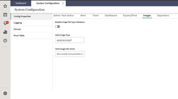

Images
Use this tab, shown in Figure 16-8, to update the following image-related properties.
Disable Image file type Validation - Toggle button to indicate whether or not you require file type validation for the images in your system.
Valid image type - The image file types that are valid for your application.
Valid Image URL hosts - The valid URL hosts for your application.

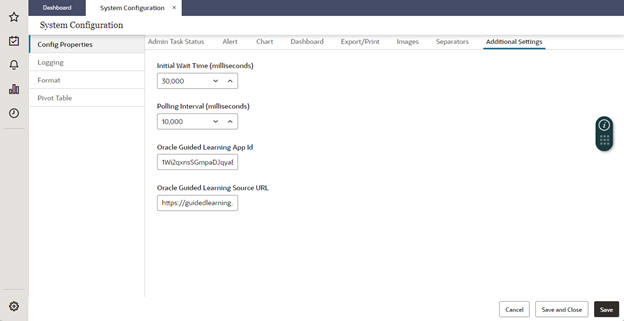

Additional Settings
This tab, shown in Figure 16-13, is hidden by default and can be accessed via Online Admin Tools.

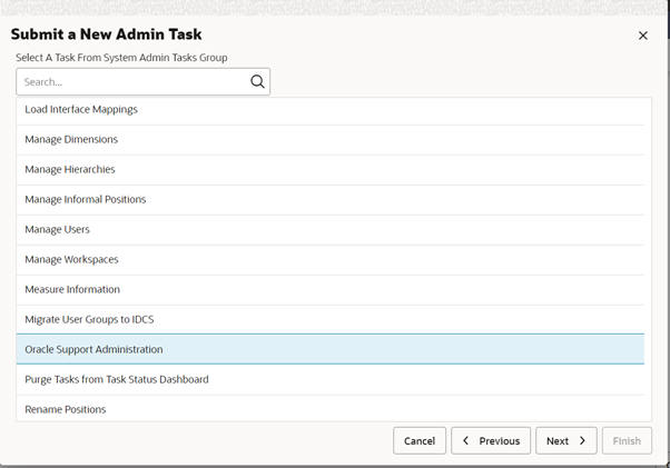

Launch Online Admin Tools and select the System Admin Tasks. Click Next.
Select Oracle Support Administration, as shown in Figure 16-11.
Figure 16-11 Oracle Support Administration
Description of "Figure 16-11 Oracle Support Administration" -
Select the appropriate settings, as shown in Figure 16-12, and submit the task.
Figure 16-12 Oracle Support Administration Settings
Description of "Figure 16-12 Oracle Support Administration Settings" -
Once the task is complete, the Additional Settings tab, shown in Figure 16-13, becomes visible and the settings/configuration properties selected in the task are available.
Oracle Guided Learning
Customers can realize their cloud application's value more quickly with Oracle's Digital Adoption Platform, Oracle Guided Learning (OGL). OGL accelerates user adoption with guided and contextual learning and also helps to manage continuous business change. In an OGL-enabled environment, users will see guided content from Oracle.
Customers can further customize the content as per their business need. There are two new properties under Additional Settings to configure for OGL, shown in Figure 16-12:
Oracle Guided Learning App ID- the unique identifier for your OGL account
Oracle Guided Learning Source URL - source from which to pull the guides and content

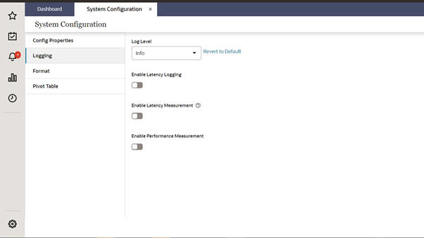

Logging
Use this tab, shown in Figure 16-14, to set the log level and enable/disable latency-logging, latency-measurements, and performance-measurements. You must save and log in again in order for the changes to take effect.
Log Level
Use the log level drop-down list to select appropriate log levels. The RPASCE Client application supports the following log levels.

Enable Latency Logging
Use the toggle button to enable or disable latency logging. Once enabled, the network latency from the user browser to the application is measured and logged at defined intervals. This can help the customer administrator to work with Oracle support on any network latency-related performance issues.
Enable Latency Measurement

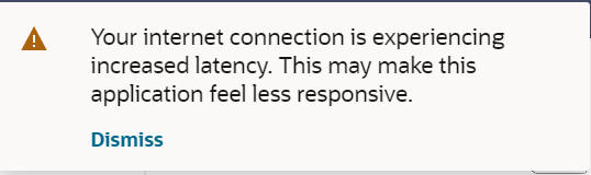

Use the toggle button to enable or disable latency measurement. Latency measurements depends on Latency Logging and so that must also be enabled, along with latency measurements.

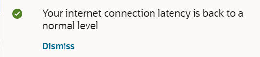

Once this is enabled, users will see the following warning when their network latency exceeds certain thresholds.
They will see the following information once their network latency returns to normal.
Enable Performance Measurement
Use the toggle button to enable or disable performance measurement. Once this is enabled, the performance timing icon appears on the left task menu (after the user logs in again). The performance values for the current user can be exported or displayed using appropriate sub-menu links.

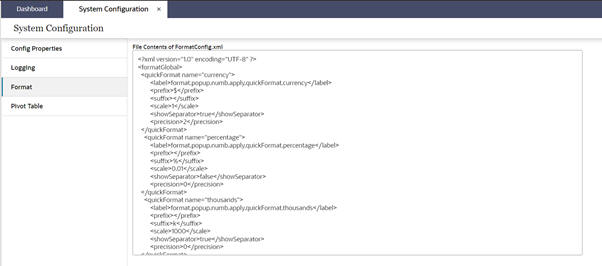

Format
Use this tab, shown in Figure 16-17, to change the FormatConfig.xml file, which controls the formatting properties for the application (that is, currency, percentage, and millions separator).
To save your changes, click Save or Save & Close.
To apply the saved changes, you must re-log into the application.
Figure 16-17 File Contents of FormatConfig.xml
Description of "Figure 16-17 File Contents of FormatConfig.xml"

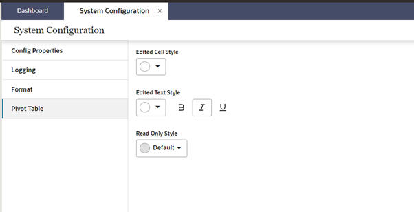

Pivot Table
Use this tab, shown in Figure 16-18, to change the format style of edited uncalculated cells. You can update the color of the edited cell background, edited cell text color, and style.

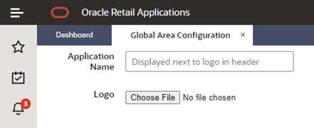

Global Area Configuration
The Global Area Configuration page allows an administration user to configure certain components of the branding area, including the application name and the logo.
The PLATFORM_SERVICES_ADMINISTRATOR_ABSTRACT group must be assigned to the user in IDCS or OCI IAM or the user will experience a 403 forbidden error after attempting to save.
Figure 16-19 Global Area Configuration Page
Description of "Figure 16-19 Global Area Configuration Page"
The Global Area Configuration page can be reached through the Settings menu (Settings > User Interface > Global Area Configuration). After making changes, including updating the application name and uploading the logo, on this page, click Save or Save and Close to apply the new settings. To revert to the default settings, remove the custom value and click Save.

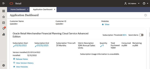

Monitoring Subscription Usage in Retail Home
All Oracle Retail cloud service subscriptions include a subscription metric that defines in some way the capacity of the systems provisioned as a part of the subscription. The actual metric varies across Oracle Retail cloud services.
For RPASCE applications, the subscription metric is tens of millions of annual sales in units, or 10M annual Sales Units, as it often appears.Users with administrative rights for Retail Home can view information on the quantity of units defined for their subscription and see information on actual usage over time for RPASCE application subscriptions (and any other Oracle Retail cloud service subscriptions) as well as for the AI Foundation component that is a part of every Oracle Retail cloud service subscription.This information is accessible on the Application Dashboard screen of Retail Home, shown in Figure 16-21.
Figure 16-21 Retail Home Application Dashboard
Description of "Figure 16-21 Retail Home Application Dashboard"
For more information on accessing the Application Dashboard, as well as information on the information presented on that screen, refer to the chapter "Application Dashboard" of the Oracle Retail Home Administration Guide.
