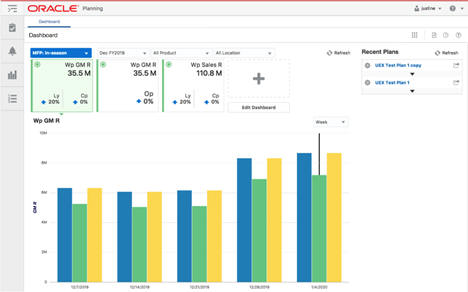

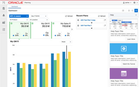

Figure 7-1 shows the view of a dashboard and the help icon. The help topics for the dashboard can be seen on the right-hand panel in Figure 7-2.
Figure 7-1 Contextual Help Dashboard Window
Description of "Figure 7-1 Contextual Help Dashboard Window"

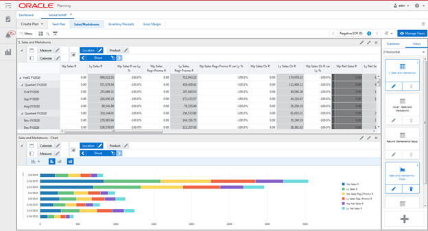

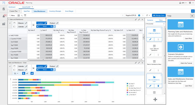

Figure 7-3 MFPRCS Workspace
Figure 7-4 MFPRCS Workspace Displaying Help Topics
Description of "Figure 7-4 MFPRCS Workspace Displaying Help Topics"

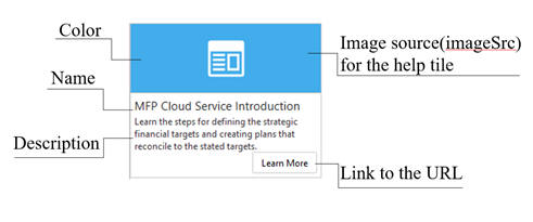

The help topic tile is a visual representation of the topic. Figure 7-5 displays the properties.
The retailer and the implementer decide together which help topics should be available for each workspace or view within the customer's specific RPASCE workflow. Up to three contextual help tiles can be displayed on an individual view. More can be configured if desired; these are visible through scrolling.
Table 7-2 describes the available attributes that can be specified during the contextual help requirements definition for each help tile:
Table 7-2 Available Attributes

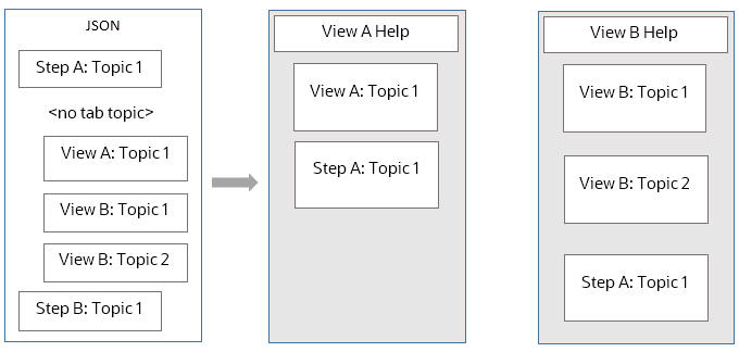

When multiple views are displayed in a workbook, the help topics for the visible view are displayed in a specific order. The lower priority topics are dropped from the set presented to the user. The order from highest to lowest of relevant topics is as follows:
Application-specific information about the view currently displayed.
Application-specific information about the tab currently active.
Application-specific information about the step currently active.
Application-specific information about the task being performed in the workspace.
Platform-specific information.
