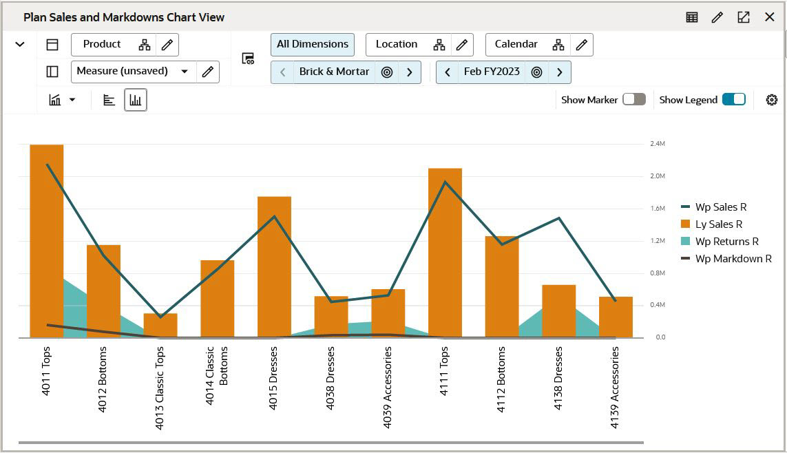

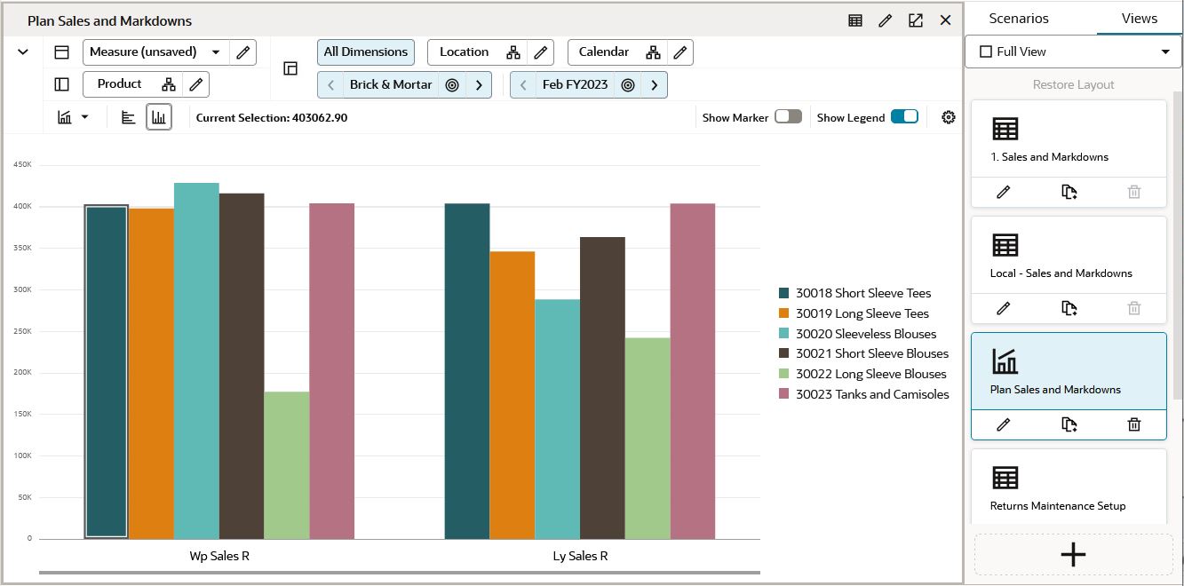

You can view the chart in the Full view mode.
Figure 10-1 Chart in Full View Mode

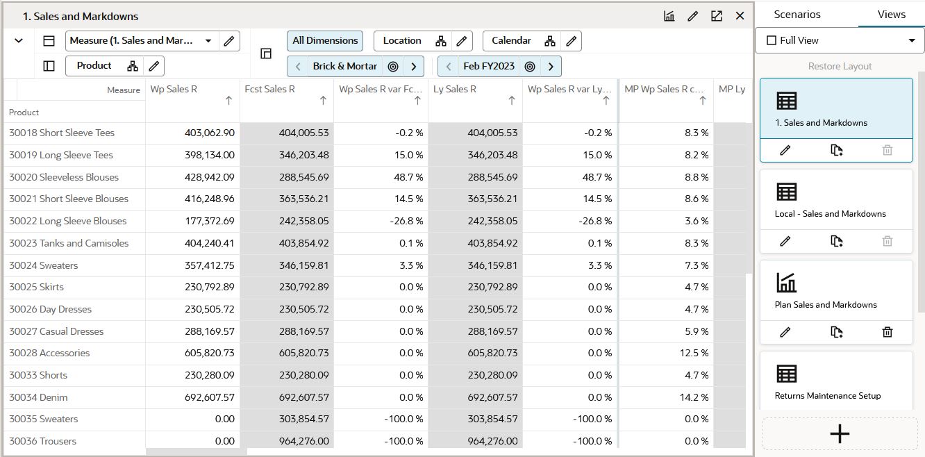

Creating a Chart
You can create a chart for any of the existing views containing the same or different data. It can be helpful to have a pivot table view and a chart view open at the same time to make changes to the pivot table values and see the results in the chart value.
Click Plus in the View Management Drawer.
Figure 10-4 Creating a Chart

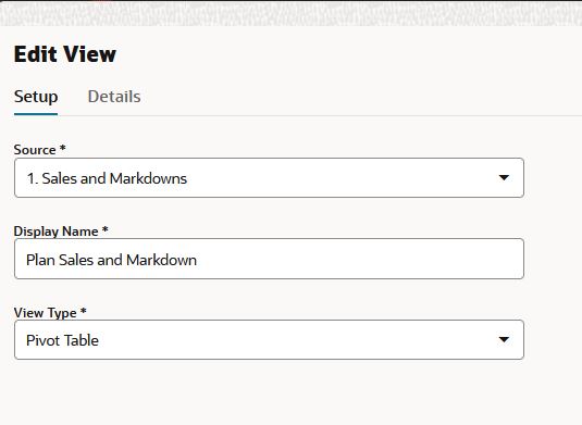

In Edit View, Select a Source and select from the existing views. This example uses Determine # (number) of Options as the source. All data that exists in the Determine # (number) of Options view is available in the new chart view being created.
Figure 10-5 Select a Source
In the Edit View window, enter a name for the new view. Here, it is a name similar to the source.

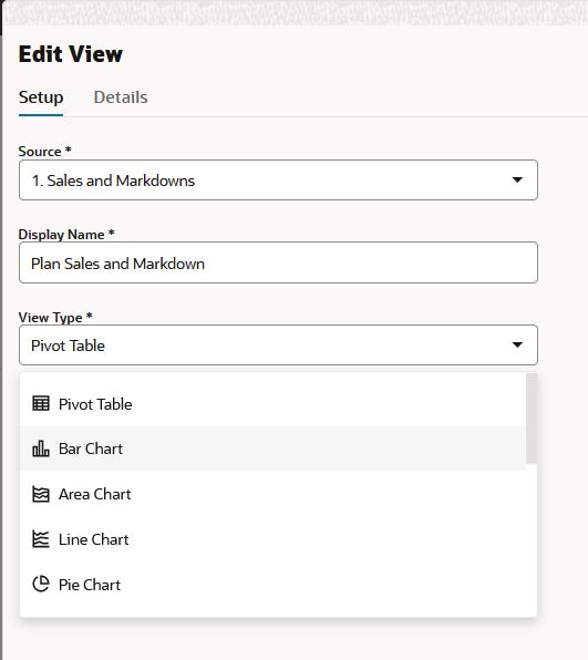

Select the type of chart from the list.
Figure 10-7 Chart Type

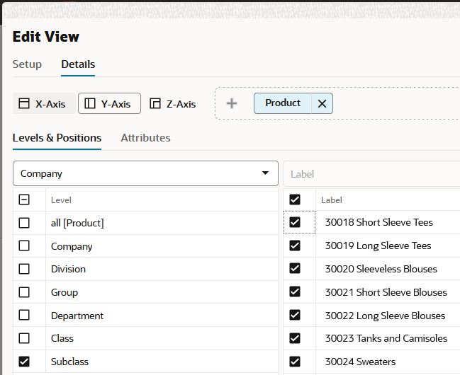

Click the Details tab to add, remove, or rearrange any levels or positions on the chart and click OK.
Figure 10-8 Chart Details

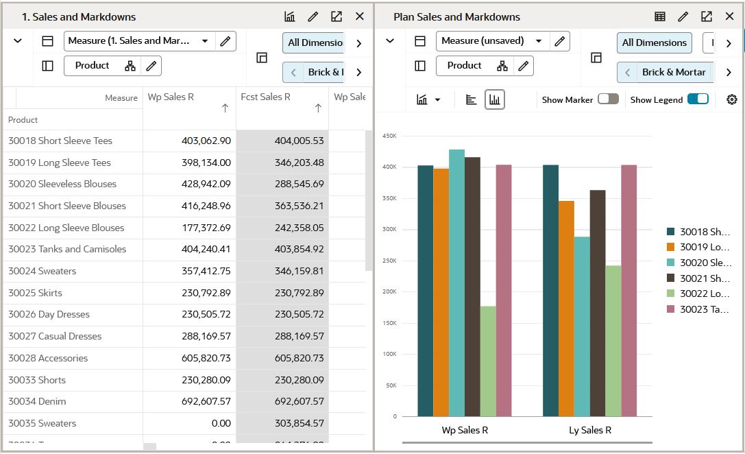

Drag the new Chart view tile into the content area to view the chart.
Figure 10-9 Chart View

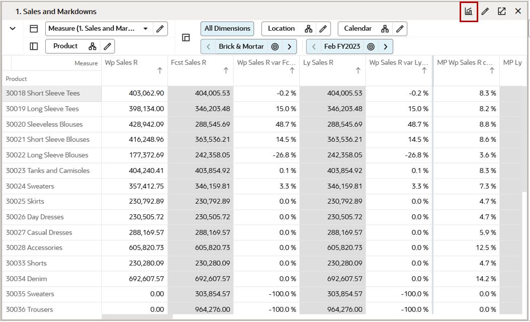

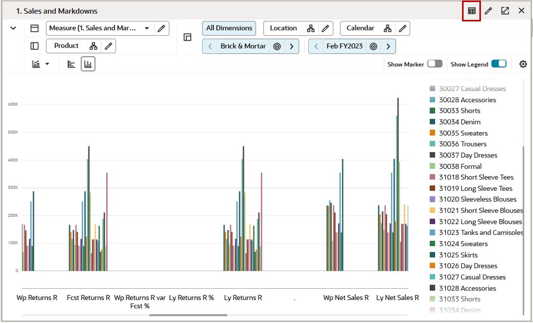

Another way to create charts in the existing tile view is to click the Charts icon (Figure 10-10 on the content area. This option helps you to switch between pivot table and charts with just one click. It allows you to view data in a graph format for analyzing data. You can revert back to the pivot table when you click the Pivot Table icon (Figure 10-11).
Figure 10-10 Switch to Charts Icon
Figure 10-11 Switch to Pivot Table Icon
Data in Charts

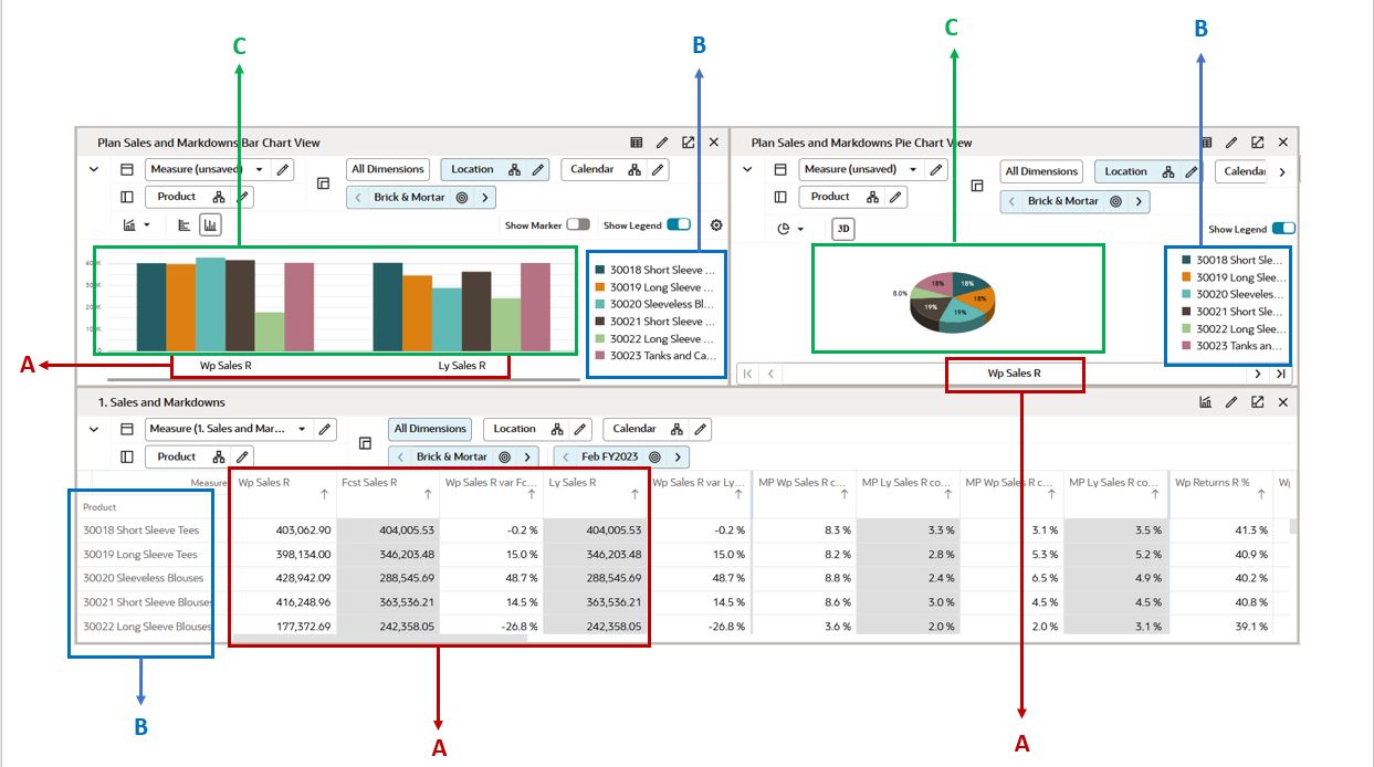

In chart view, the positions on row are represented as series. The data values in a column are plotted together as a group.
Figure 10-12 Data Mapping in Charts
Key for Figure 10-12:
A:X-axis Data Mapped as a Group (red)
B: Y-axis Data Mapped as a Series (blue)
C: Data for all the Series belonging to a Group (green)

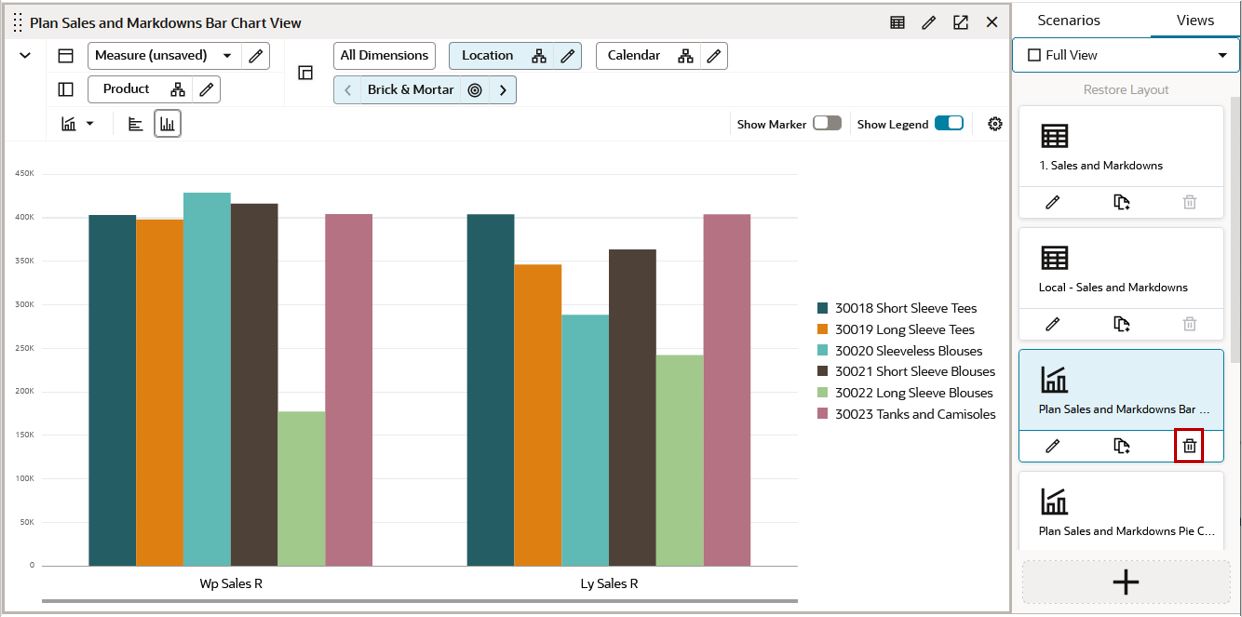

Deleting a Chart
To delete a chart, you delete the chart view from the View Management Drawer. Default views cannot be deleted.
Click Delete on the chart view in the View Management Drawer:
Figure 10-14 Deleting a Chart

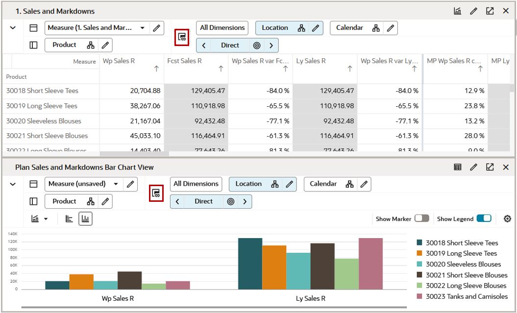

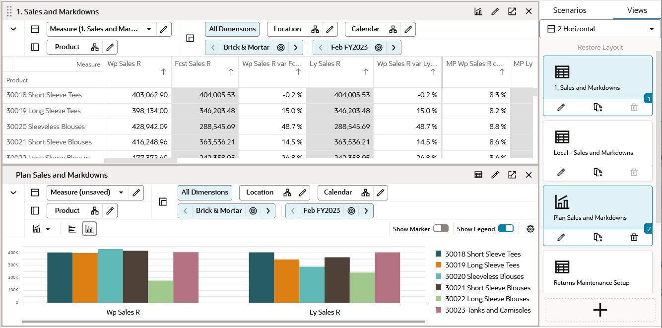

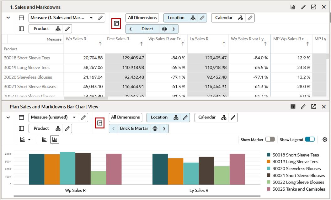

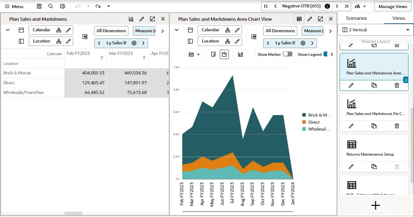

Synchronize the Z-Axis with Charts

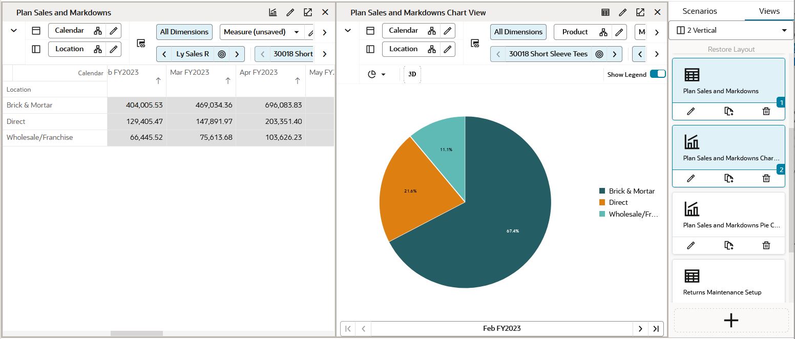

It can be helpful to have a pivot table view and a chart view open at the same time to make changes to the pivot table values and see the results in the chart value. By enabling the Synchronize Z Axis button with both views displayed, you can scroll through positions on the Z axis, and both views will stay in synch.
In the View Layout list, select any option except for Full View. In this example, 2 Horizontal has been selected.
Figure 10-15 Select View Layout

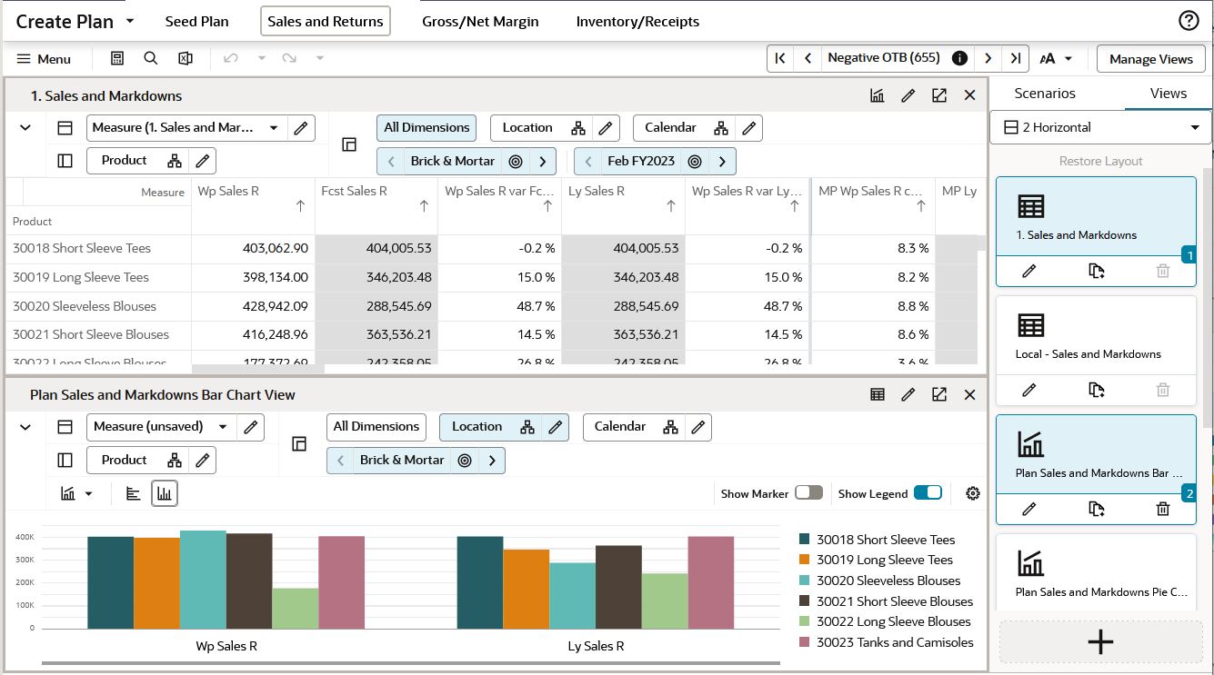

Add at least two views to a layout by dragging the View Tiles from the View Management Drawer. In this example, the Determine no of Options tile and the Determine no of Options Chart View Cluster A tile have been dragged into the layout.
Figure 10-16 Add Chart View to Layout
Click Synchronize Z Axis to activate it.
Figure 10-17 Activate Synchronize Z Axis
The activated Synchronize Z Axis button displays in blue on both tiles. Both views have scrolled to the same Product position.
Figure 10-18 Synchronize Z Axis

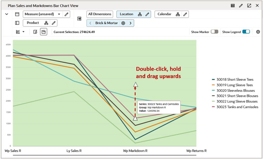

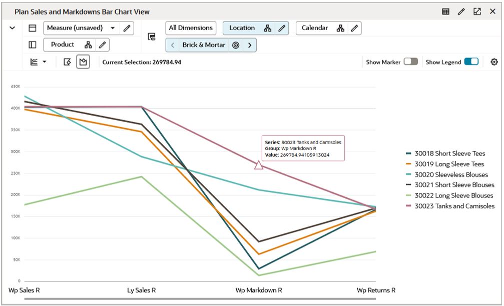

Dragging the Chart Line
Perform the following steps to edit a chart by Dragging the chart line:
Change the view to the chart view. When you bring the cursor to the point of intersection, the marker is highlighted and the cursor changes to pointer finger.
Figure 10-19 Chart View - Marker Point Highlight
Double-click and then hold and drag the marker point where the data change is required. To increase the value of data, drag upwards and to decrease drag the point of intersection downwards on the chart layout.
When you move the point of intersection, you can see the value of the current selection changing on the chart tool bar.
Figure 10-20 Drag the Chart Line Upward to Increase the Data Value
Figure 10-21 Edit Result after Dragging a Chart Line

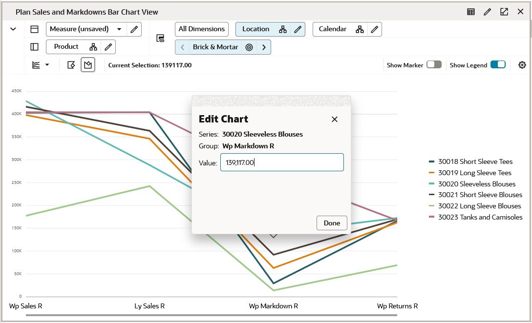

Using the Edit Window to Edit Charts
Perform the following steps to edit charts using the Edit Window:
Change your view to the chart view. Bring the cursor to the point of intersection, the marker ID is highlighted and the cursor changes to pointer finger.
Click the point of intersection where the data change is required and an Edit Chart dialog box opens. The edit chart dialog box shows the description of Series, Group and text input box for Value.
Figure 10-22 Chart View - Edit Chart Dialog Box
Enter the data value in the Value input box and click Done to accept. To cancel, click X and the value is not updated.
Figure 10-23 Edit Value in the Dialog Box
Figure 10-24 Edit Result in the Chart View

A multi-group chart shows data for multiple columns or groups. For example, the chart in Figure 10-25 plots WP Sales R values for Missy Short Sleeve Sweaters across 10 different locations over time (three months).
Figure 10-25 Multi-group Chart

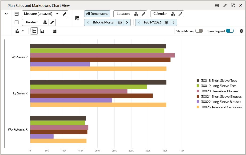

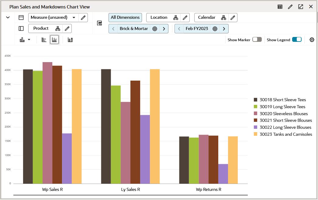

Bar Chart

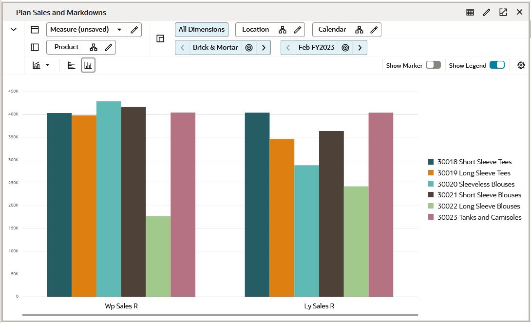

In a Bar Chart, the data is represented as a series of vertical or horizontal bars. It can be used to examine trends over time or compare items at the same time (for example, sales for different products in different quarters).
Figure 10-26 Bar Chart

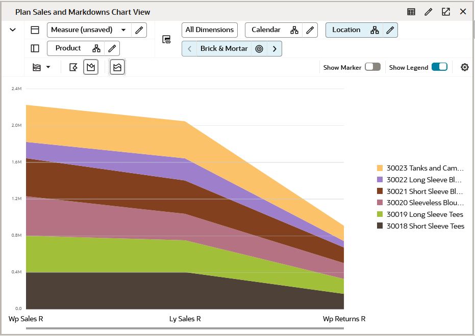

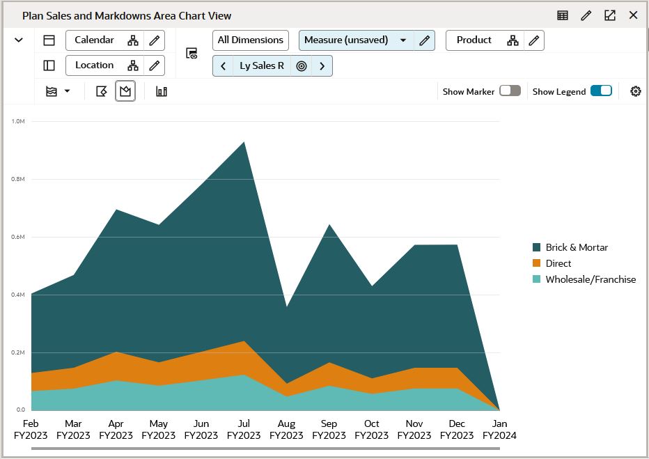

Area Chart
In an Area chart, the data is represented as a filled-in area. An area chart can be used to show trends over time, such as sales for the past 12 months. Area charts require at least two groups of data along an axis.
Figure 10-27 Area Chart

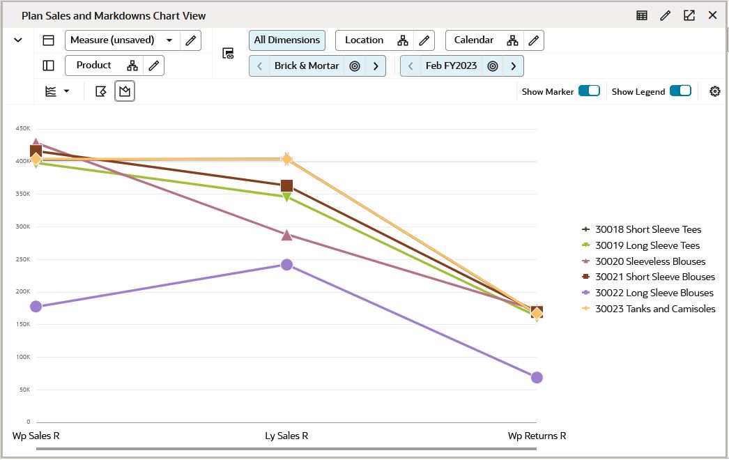

Line Chart
In a Line Chart, the data is represented as a line, a series of data points, or data points connected by a line. Line Charts require data for at least two points for each member in a group.
Figure 10-28 Line Chart

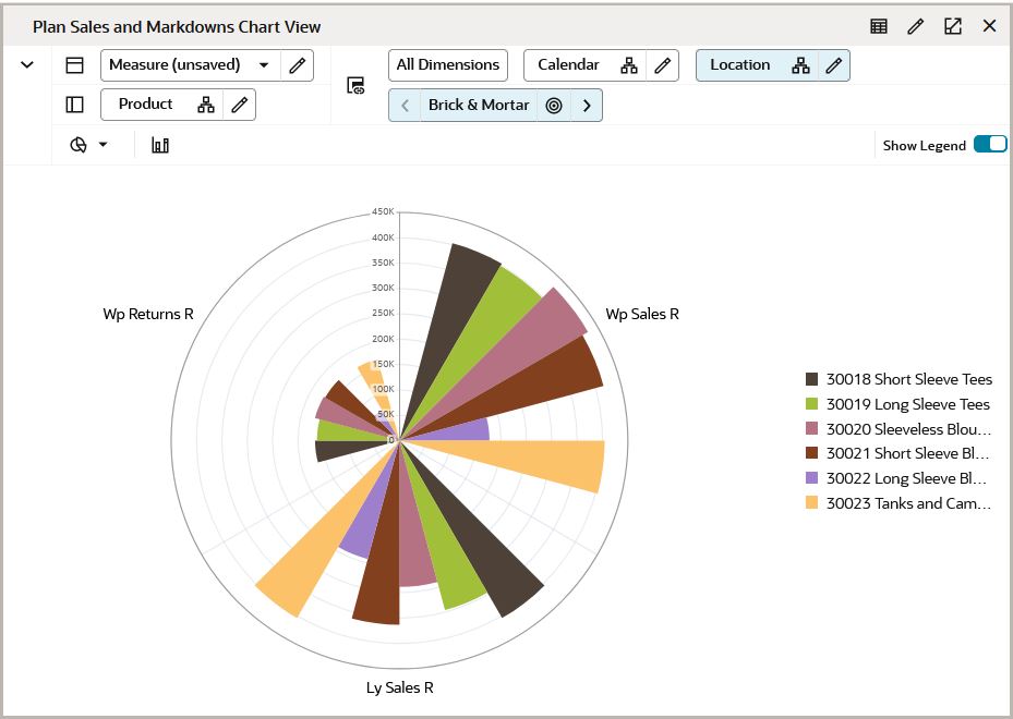

Polar Chart
A Polar Chart is a diagram in which a point of origin is surrounded by a curve whose radius at any given point is proportional to the magnitude of some property measured in the direction of that point.
Figure 10-30 Polar Chart

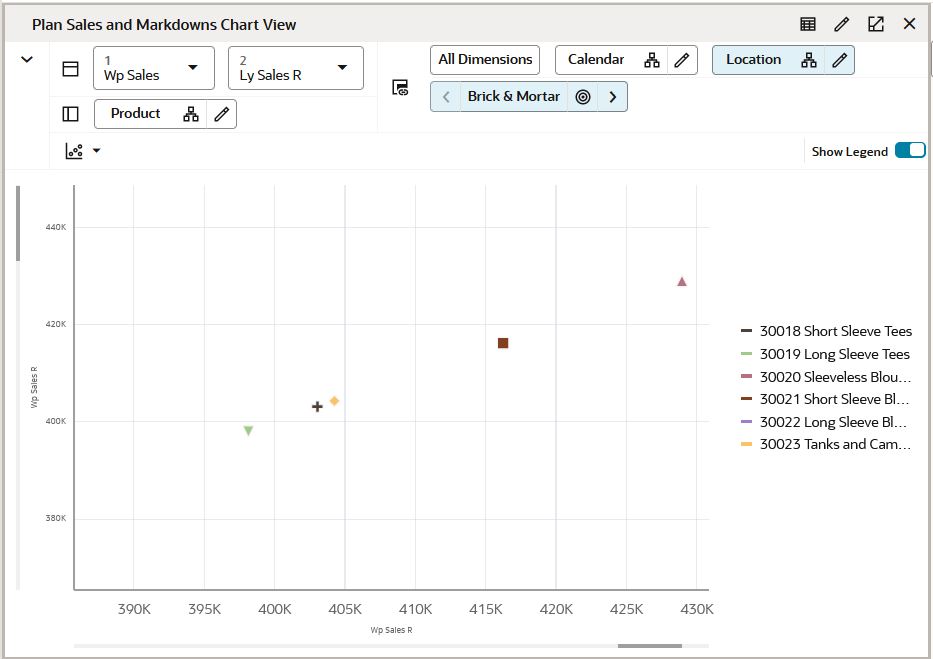

Scatter Chart
A Scatter chart displays two variable for a set of data which helps in comparison of data and understand the relationship between two variables. Usually the independent variable is plotted along the horizontal axis (x-axis) and the dependent variable is plotted on the vertical axis (y-axis). The scatter chart has a different view as scatter chart needs two measure values to display the chart.
Figure 10-32 Scatter Chart

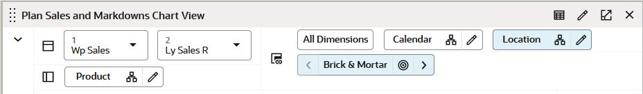

Perform the following steps to plot scatter chart:
Select the chart type Scatter Chart from the chart drop-down list in Edit view.
Figure 10-33 Edit View Scatter Chart Type

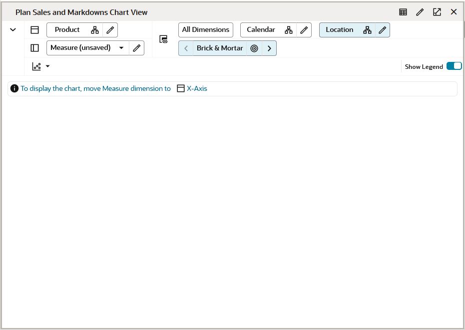

To plot a scatter chart, bring the Measure dimension to X-axis in the workspace view. In case the measure dimension is in different axis then a message appears on the chart area to move the measure dimension to X-axis.
Figure 10-34 Measure on the X-axis
Select two measures for which you need to plot the scatter chart using the drop-down list 1 and the drop-down list 2. Measure 1 is the plot at y-axis on the chart and Measure 2 is plot at x-axis on the chart.
Figure 10-35 Scatter Chart Measure Drop-down List
Figure 10-36 Scatter Chart

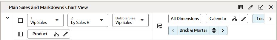

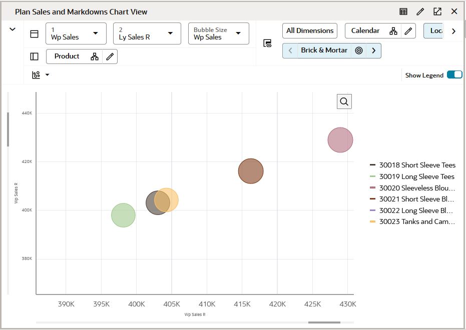

Bubble Chart
A Bubble chart is a multi-variable graph where three variables of the data display as bubbles in the chart. Two variables are plotted through the x-axis and y-axis. The third variable is represented by the size of the bubble. You can use a Bubble chart to compare and show the relationship between categorized bubbles by the use of positioning and proportions or size of bubbles.
Figure 10-37 Bubble Chart
Perform the following steps to plot a bubble chart:
Select the chart type Bubble Chart from the chart drop-down list in Edit view.
Figure 10-38 Edit View Bubble Chart Type
To plot a bubble chart, bring the Measure dimension to the X-axis in the workspace view. In case the measure dimension is in a different axis then a message appears on the chart area to move the measure dimension to X-axis. The Bubble size will plot size of the bubble.
Figure 10-39 Measure on the X-axis
Select three measures for which you need to plot the bubble chart using the drop-down list 1, the drop-down list 2 and the Bubble Size drop-down list. Measure 1 is the plot at y-axis on the chart and Measure 2 is plot at x-axis on the chart. The Bubble Size plots size of the bubble.
Figure 10-40 Bubble Chart Measure Drop-down List
Figure 10-41 Bubble Chart

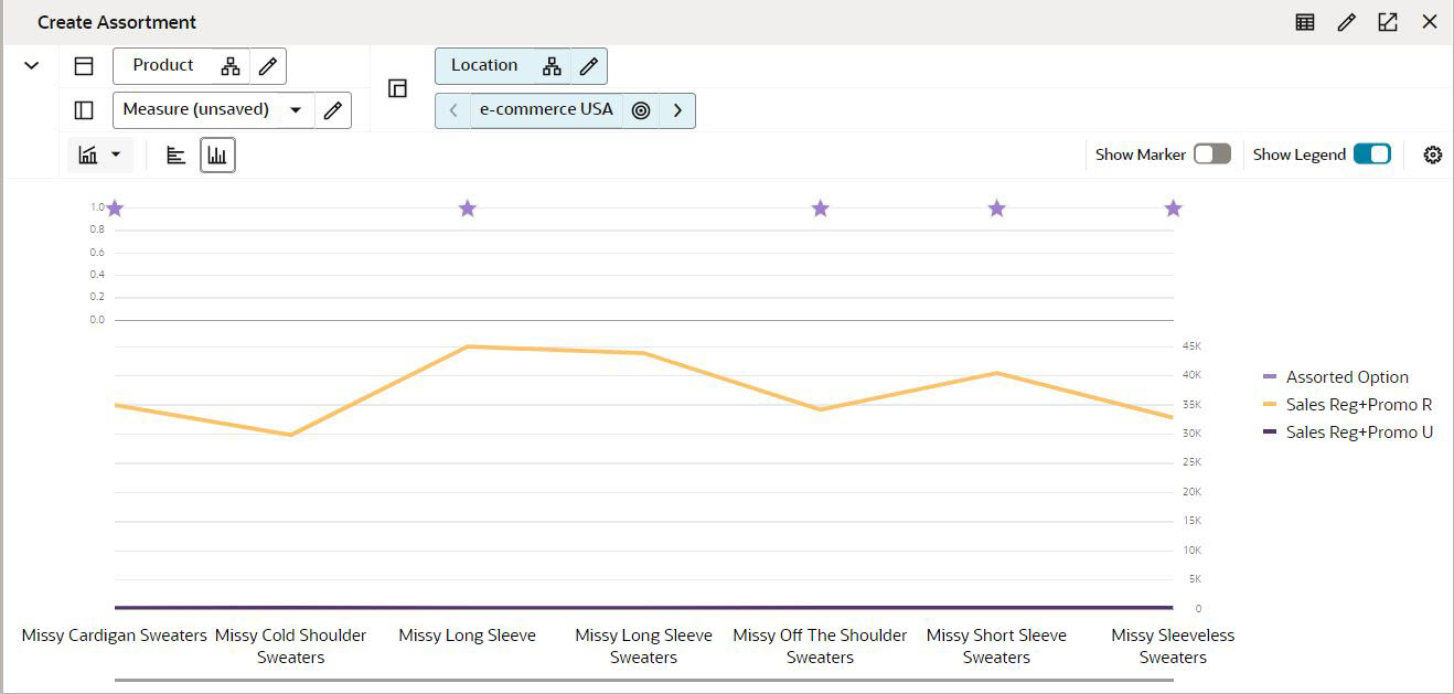

Boolean Charts
Boolean data can also be represented in chart along with other measures. Boolean measure data is represented in chart if the value of Boolean is True. Visual representation of Boolean in a chart helps the user to understand the data better and enables the ability to review the data visually. Examples of Boolean data include calendar events such as promotion weeks, selling weeks, stock-outs, and so on. To plot a Boolean measure, select the custom chart option, Click Setting and change the Boolean measures to Top Axis from Axis drop-down and click OK. The Boolean measure is plotted on the top area of the chart to display separately. This provides a clear indication of the Boolean measure and make it easier for you to read the Boolean measures along with other measures. The Boolean data is presented by colored symbols in the charts. Multiple Boolean measures in a single chart represented by different color symbols.
For example, the Figure 10-44 shows WP Assorted Item and WP Copy Sales - Boolean Measure against Sales R, Sales U and Sales AUR.
In the chart the Purple Star symbol represents the assorted items that is, WP Assorted item Boolean Value = True.The Red Tag symbol represents the WP copy sales Boolean value = True.
The Boolean measure WP Assorted Item and WP Copy Sales are represented separately on the chart area along with Sales U, Sales R and Sales AUR.
Figure 10-44 Boolean Data in Chart

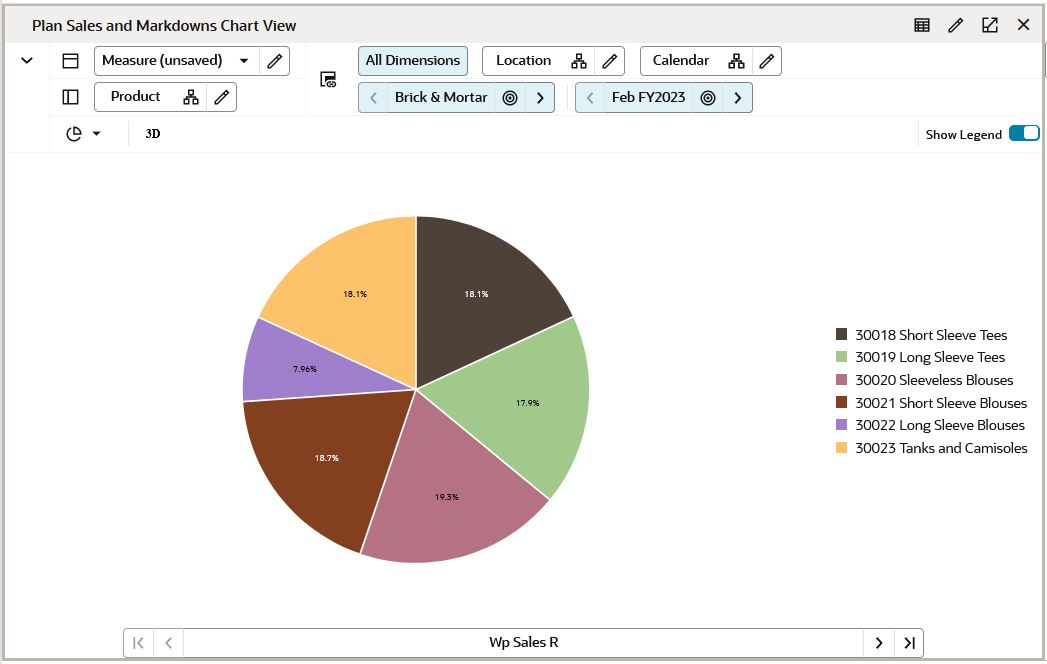

Pie Chart
In a Pie Chart, the data is represented as sections of a circle. Pie charts can be used to show the relationship of parts to a whole.
In Figure 10-46, because this is a single-group chart, only one quarter is shown at a time.
Figure 10-46 Pie Chart

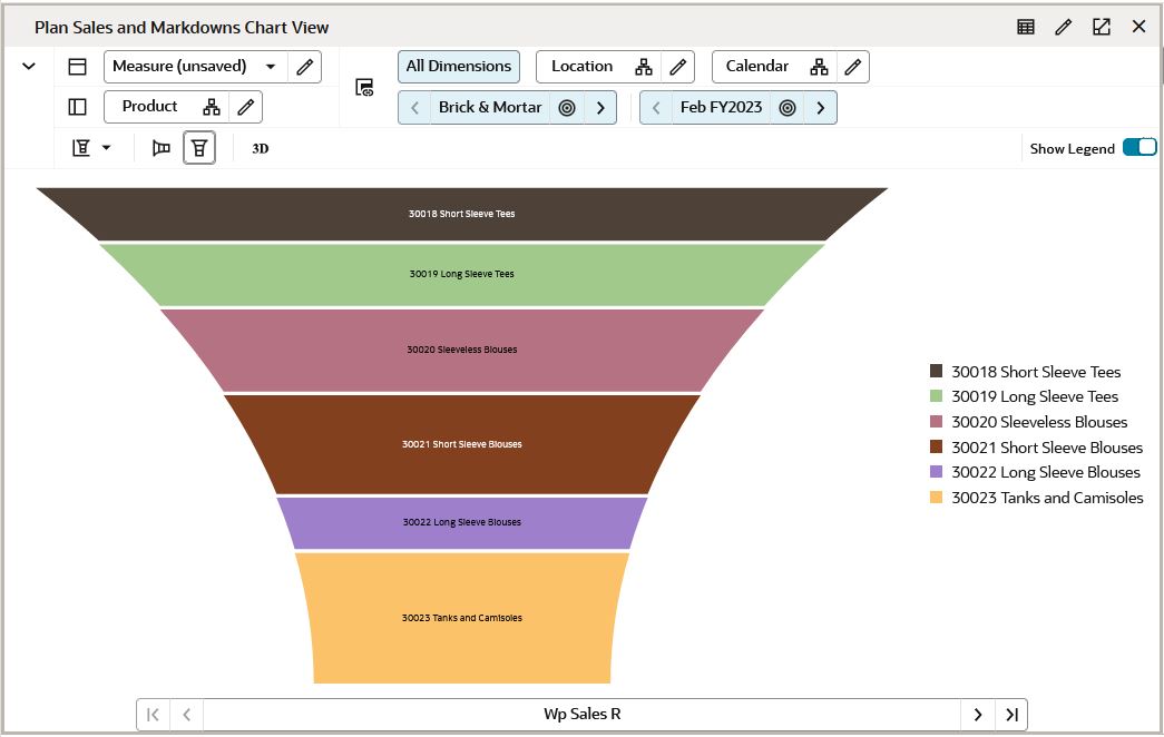

Funnel Chart
Funnel charts are useful for viewing data for stages of a process, such as the stages of a sales process. The area of a funnel slice is proportional to its value for the corresponding stage.
Figure 10-47 Funnel Chart

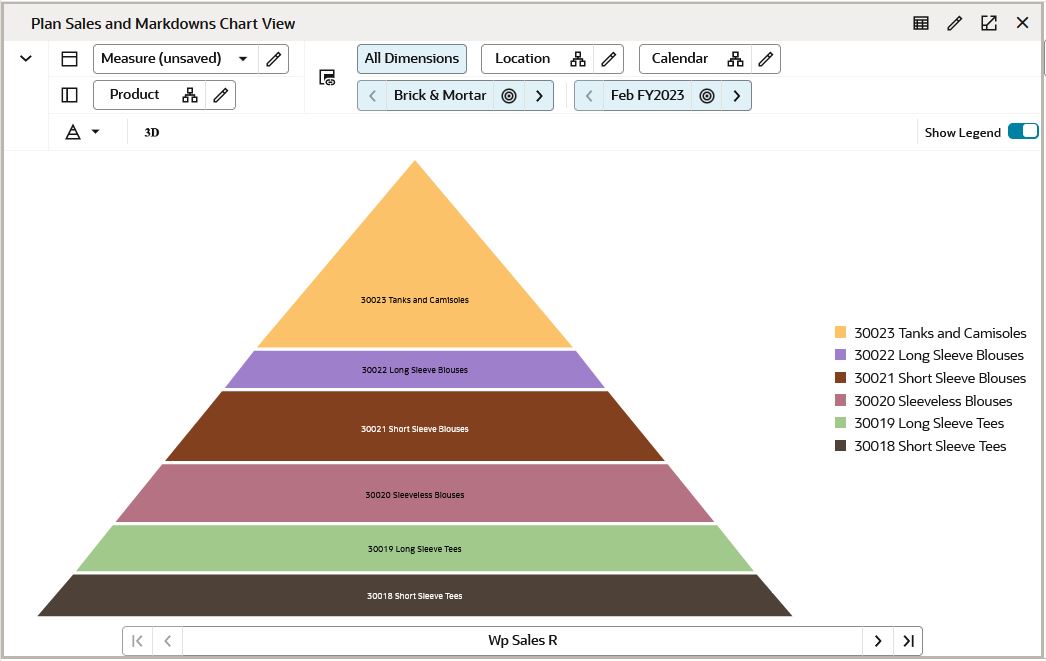

Pyramid Chart
A pyramid chart has the form of a triangle with lines dividing it into sections. Each section contains a related topic or idea. Because of the triangular shape, each section is a different width from the others; this width indicates a level of hierarchy among the topics. For example, the widest section may contain a general topic and the narrowest section may contain a much more specific topic from within that general topic. However, the width is not visually representative of the quantity beyond larger or smaller.
Figure 10-48 Pyramid Chart

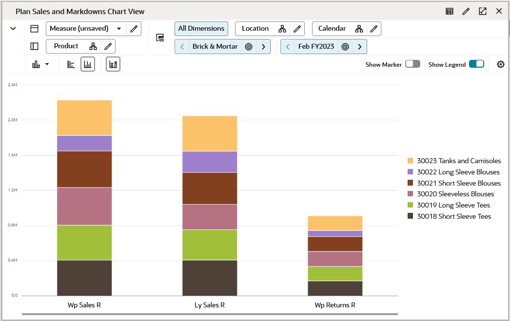

Stacked charts help in displaying the cumulative magnitude of two or more data series. They are useful in representing a data value as a sum of two or more values. Each data series can be distinguished by the color of its section in the stack.
Figure 10-49 Stacked Chart

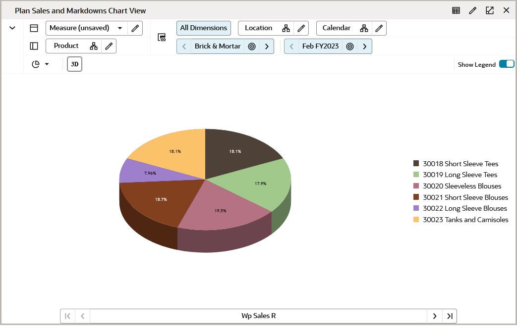

The 3-D charts icon shown in Figure 10-50 rotates the chart into a 3-D display.
Figure 10-50 3-D Chart

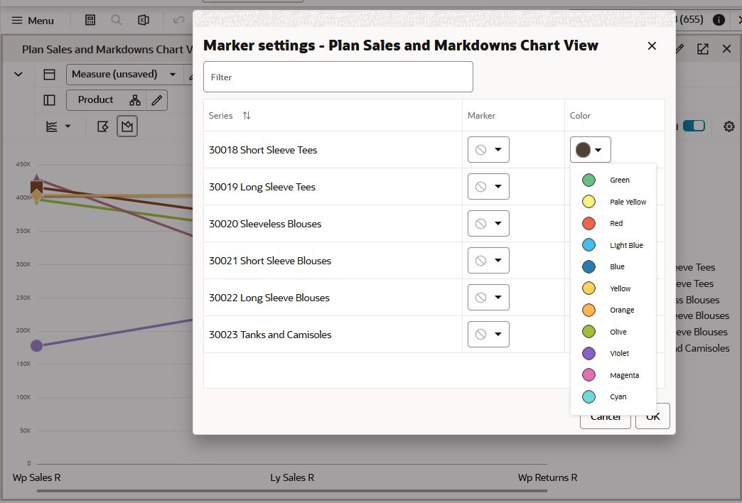

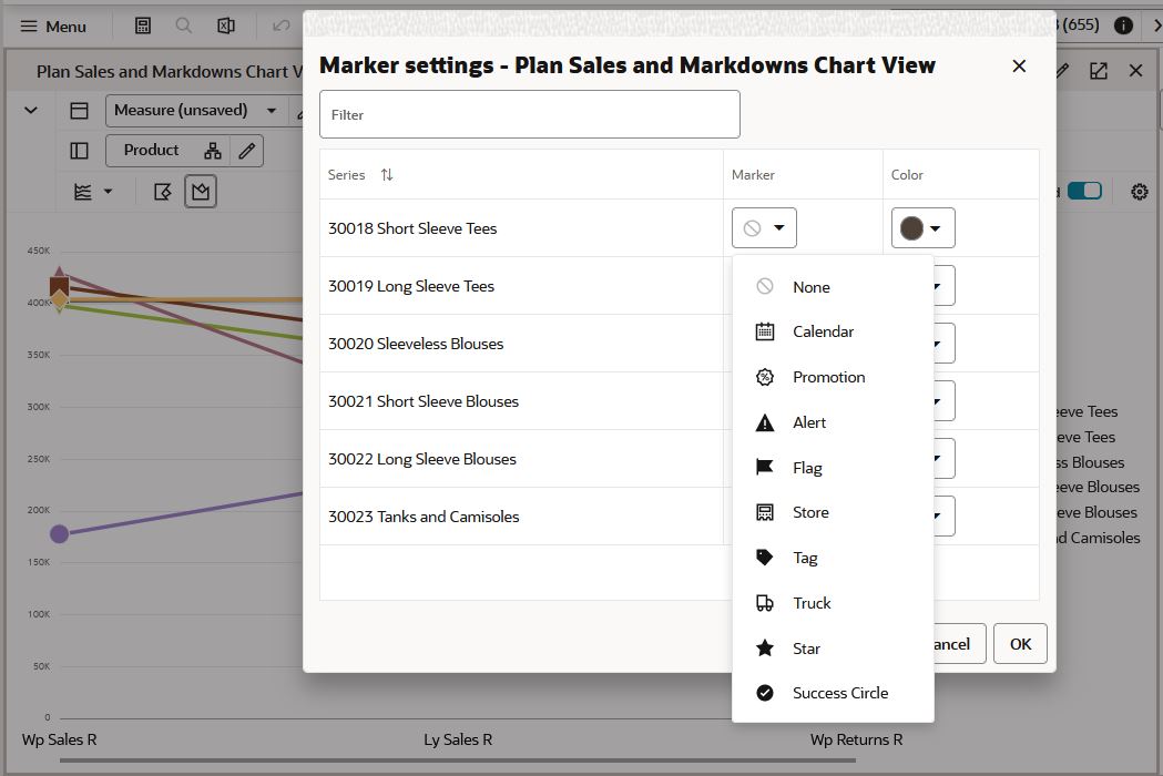

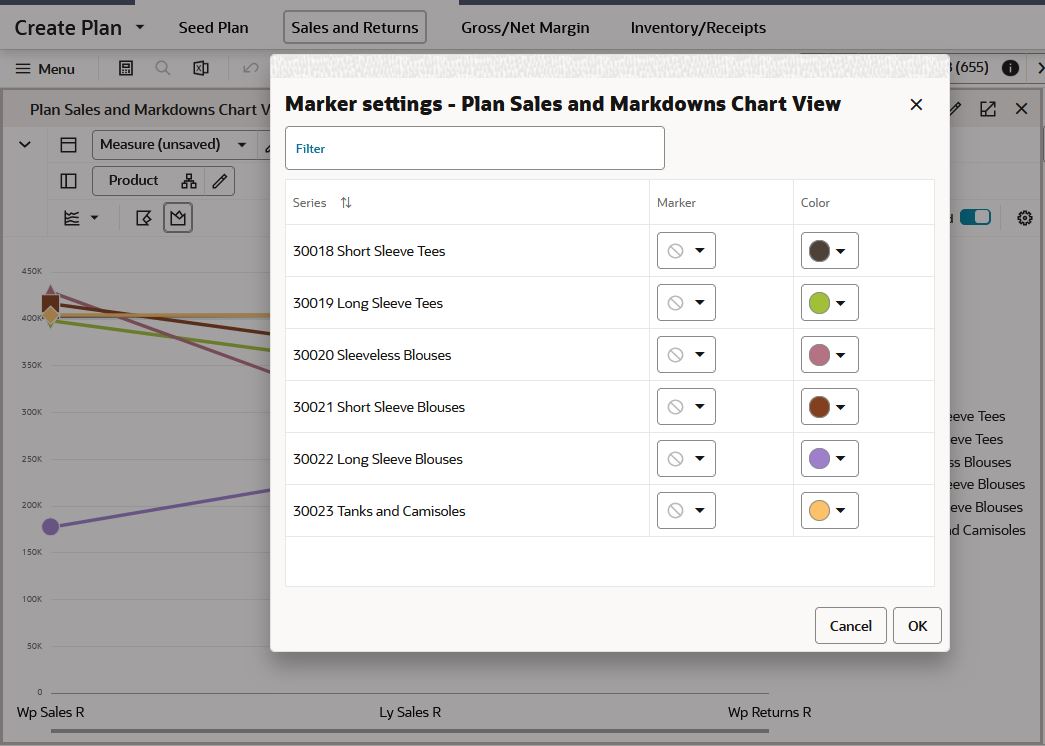

Chart setting allows you to edit the marker symbol and color for the series mapped on the chart. Ability to assign the different symbols helps you to identify the markers clearly for measures plotted on the charts. You can also assign colors to the series mapped on the charts.
The Edit Marker window shown in Figure 10-56 has the list of the series mapped on the chart. You can edit the marker symbol and color from the available list shown in Figure 10-57 and Figure 10-58 next to each series.
Figure 10-56 Chart Setting Window
Figure 10-57 Edit the Marker
Figure 10-58 Edit the Color
