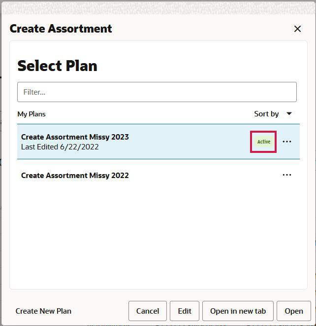

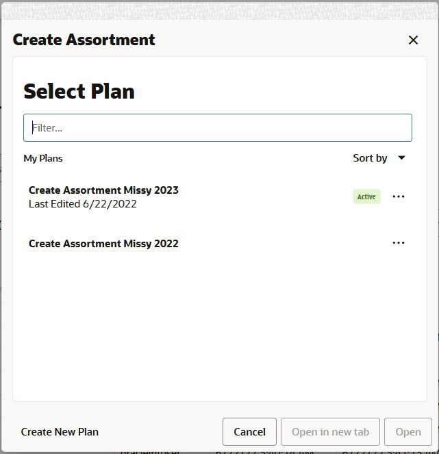

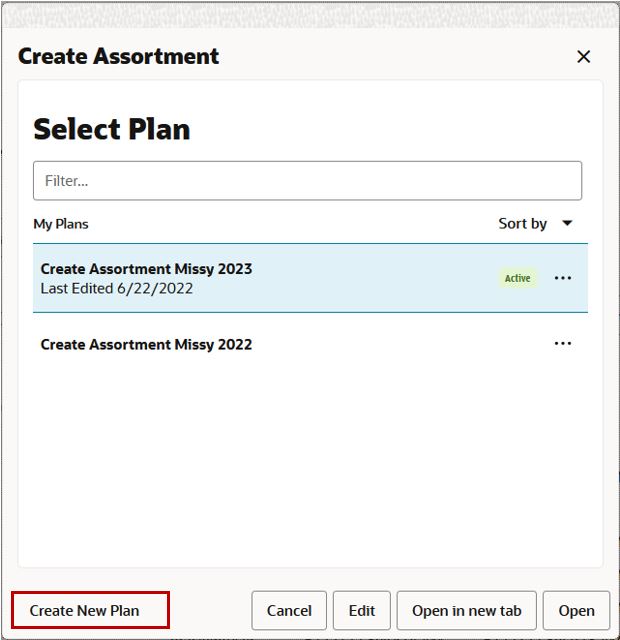

Figure 6-1 shows the segments that are already defined. You can create a new segment at any time by selecting the link in the lower left hand corner.

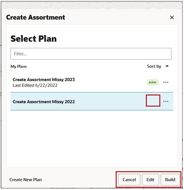

Active next to a segment means that the segment is active, that is, a workspace has already been built for that segment. This means that the workspace can be opened, either in this browser tab or another one.
Figure 6-2 Create Assortment Active Segment
Conversely, a segment without Active, must have its associated workspace built before that workspace can be opened.
Figure 6-3 Create Assortment Inactive Segment

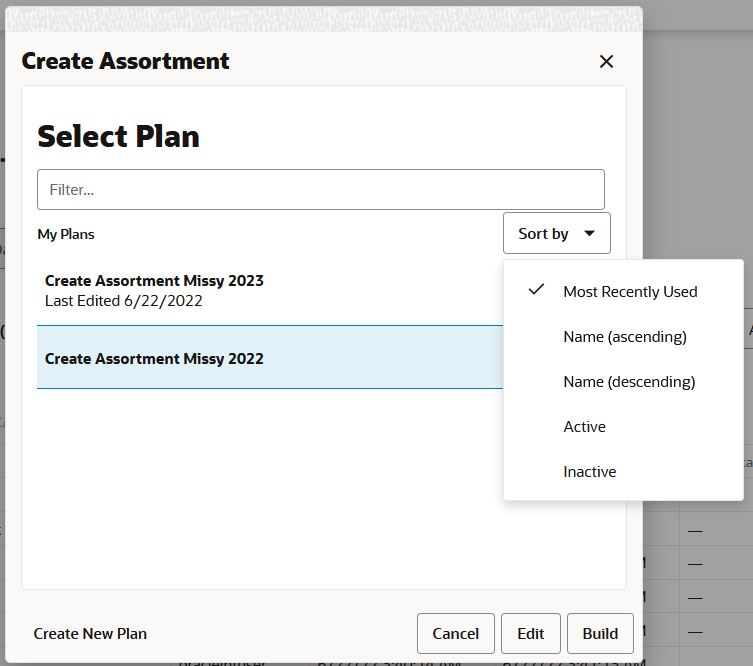

In order to find a particular segment, you can sort and filter the segment entries.
To sort the entries, select an option in the Sort by list.
Figure 6-4 Segments Sort By List
The Sort by options are:
Most Recently Used: The segments are displayed in the same order as they appear in the Most Recently Used section of the dashboard.
Name (ascending): The segments are sorted in alphabetical order.
Name (descending): The segments are sorted in reverse alphabetical order.
Active: The active segments are sorted alphabetically.
Inactive: The inactive segments are sorted alphabetically.

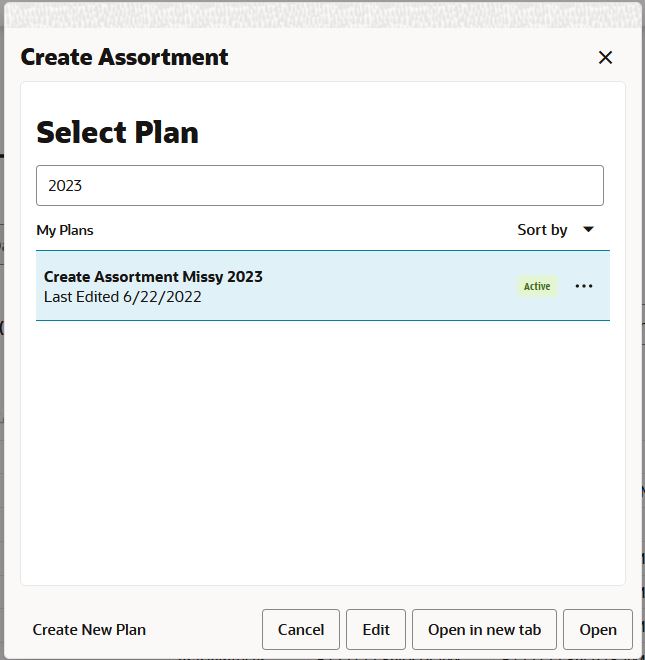

To search for a particular segment, type text into the search box. As shown in Figure 6-5, the value 2023 has been entered into the Select Plan search box. The list of segments displayed include only those with the value 2023 in the label.
Figure 6-5 Segment Search
Creating a New Segment

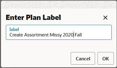

If no segments exist, the Enter Plan Label window is opened using the Segment window. Enter the plan label and click OK. You see the Segment Wizard.
A new segment can be created either with Create New Planbutton in the lower left corner. You are prompted for a label for that segment, and then taken to the Segment Wizard (see Wizards). If you select any of the segments, then the buttons, Edit, Open in new tab, and Open are enabled.
Figure 6-6 Create New Segment

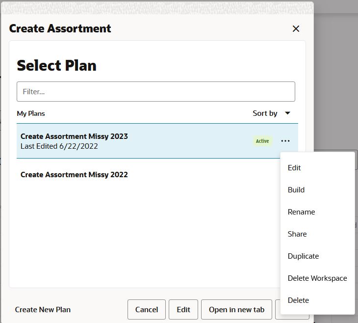

Action Menu
In order to take action on a segment, click the Action Menu icon next to the segment. A context menu appears, with these options: Edit, Build, Rename, Duplicate, Delete, Delete Workspace, and Share.
Figure 6-7 Segment Action Menu

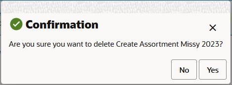

Deleting a Segment
In order to delete a segment, select Delete from the Action menu. At the confirmation window, click Yes to delete the segment. The workspace must be closed before it can be deleted.
Figure 6-8 Deleting a Segment
Deleting a segment also deletes the workspace it is associated with. Make sure that you have finished working with the workspace before deleting the segment

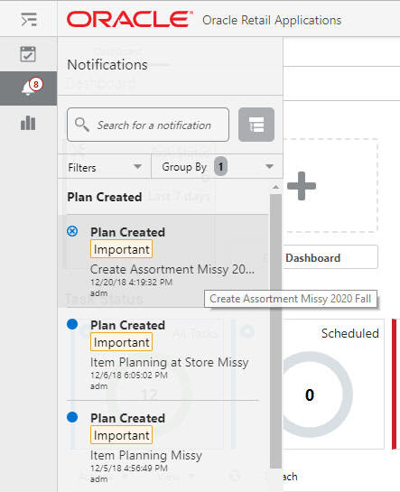

Note that once the segment is submitted for building, the segment is locked until the operation is completed. If any of the operations on the segment, such as open, edit, delete, build, or rename, are performed, then all of them will fail and an error similar to the following message appears, 'Create Assortment Missy2019' is being re-created and cannot be edited during this time. Try again in a few minutes, or check notifications to see when it can be edited again. If the problem persists, contact your administrator.
Users are generally notified about the segment build status in the notification. If the status has a value of Failed, contact the application administrator who can view the online administration task log files to determine the cause of the failure. Usually, the segment build process completes within a specified time with the arrival of the notification. If the user does not receive the notification within 24 hours, then the segments will be unlocked automatically.
Figure 6-9 Building a Segment

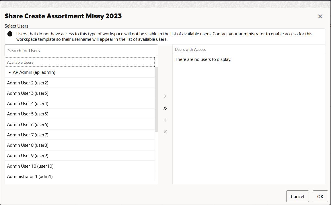

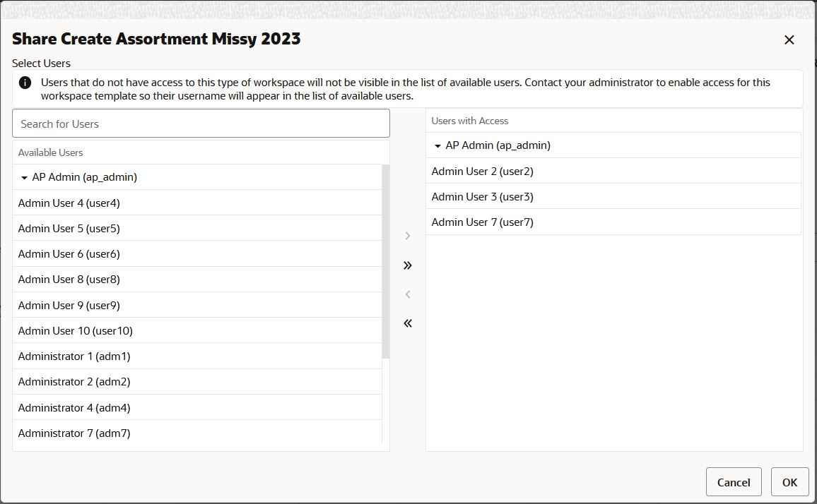

The following steps describe how you can share your existing segment with other users.
Next to the existing segment that you want to share, click the Action Menu and then click Share.
Figure 6-13 Share a Segment
RPASCE displays the Figure 6-14 where you can select the user to share the segment with.
You can select one or more users to share the segment with. Locate users by using the Search for Users box. Move available users by selecting the user and then using the > arrow to move them to the Users with Access pane.
Remove access for users by selecting them and then use the < arrow to move them to the Available Users pane. Use the double arrows (either << or >>) to move all users between the panes.
Figure 6-14 Select Users Window
The shared segment is available to the other users with access while creating the same segment under the same taskflow. Figure 6-15 shows the segment AS_CreatePlan_Missy_FY1 that is available for the Analyst3 under the same taskflow.
Figure 6-15 Select User to Share a Segment

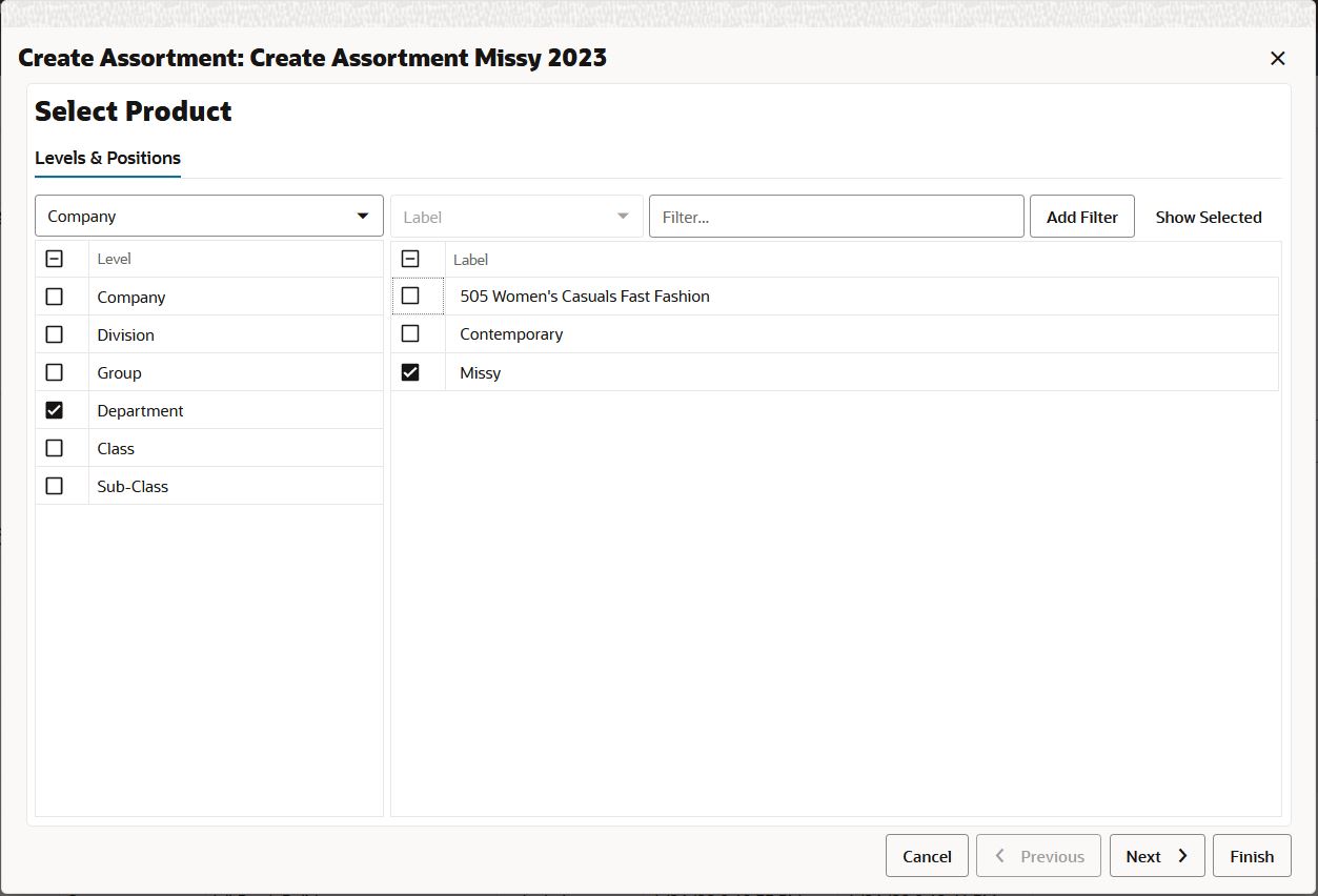

When you select Create New or Edit in the Segments window, a wizard opens. The wizard take you through a set of screens to select the positions for each dimension in the workspace.
When you select Create New options, no level in the wizard is pre-selected and no position is shown in the position area. Only when you select a level, the positions for the respective level appear in the wizard.
Figure 6-16 Create New Plan Wizard

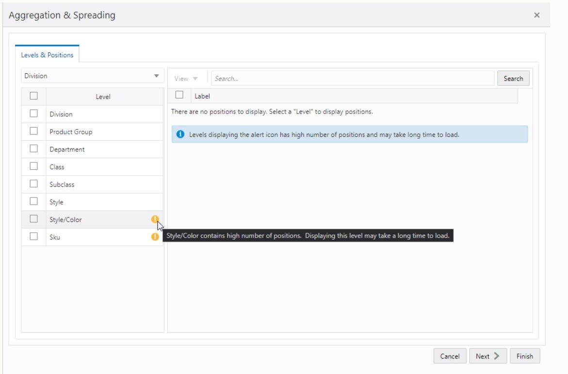

If any level has a higher number of positions then an alert icon appears next to the level and the position area displays a message, Levels displaying the alert icon have high number of positions and may take long time to load.
When you hover over the alert icon next to a level, it displays a message which states: The level contains high number of positions and displaying this position may take longer time to load. The default position count threshold is set at 50,000 positions. Positions with more than 50,000, are considered higher and the alert icon appears next to the level. The position count is configurable by an administrator as per the requirement.
Unicode characters are accepted when creating the segment label.Figure 6-17 Wizard with a High Number of Positions
To load positions faster into the wizard, choose a higher level in the wizard, such as department which has a fewer number of positions. You can still select the level with alert icon if you need to select or clear positions at that level, but it may take time for wizard to load those positions.
When you create a new segment again, the wizard step defaults to the last selections. If the prior selections made in wizard are at the child level with a high position count, then it will impact the loading time of wizard. To improve the wizard loading time, choose to work with higher levels with less position count. This improves the position loading time when you open the wizard the next time.

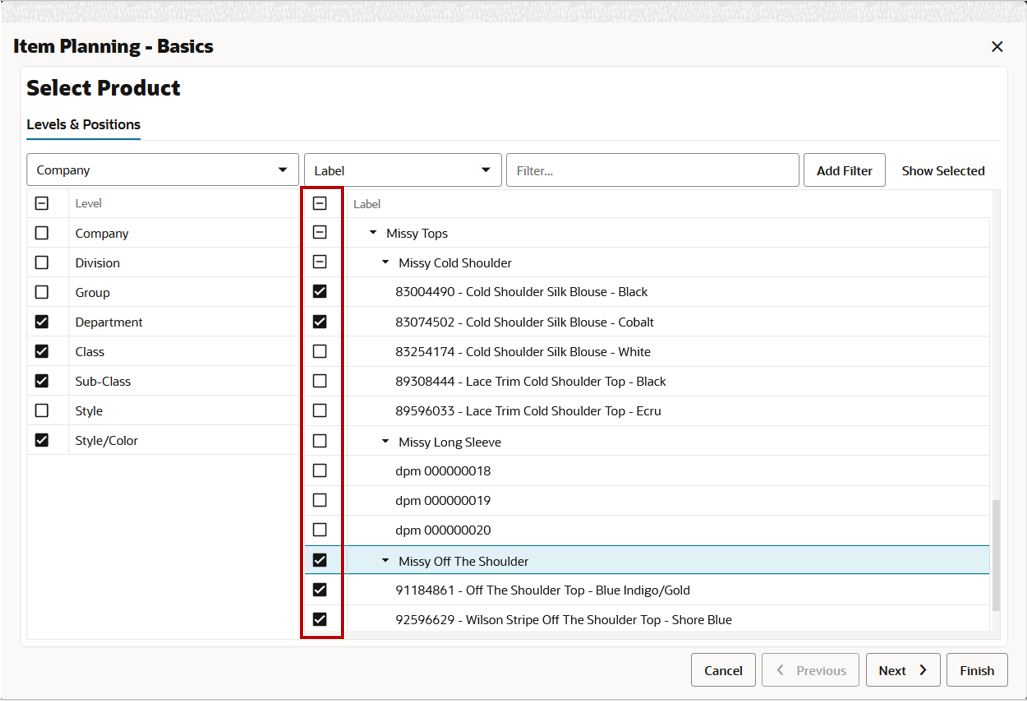

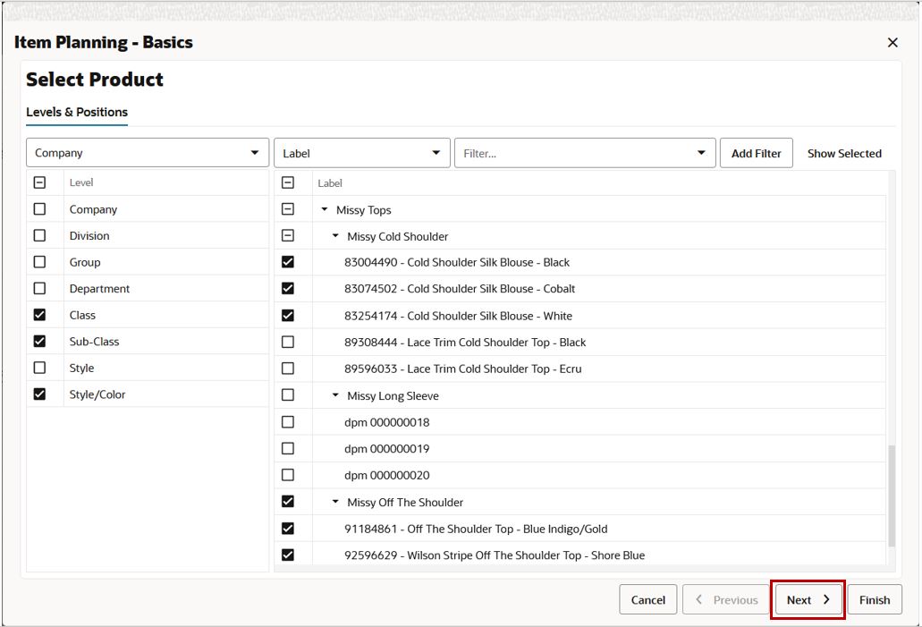

Level and Position Selector
To select a level or position, complete the following steps.
Once in the wizard, select the positions for each dimension by selecting the checkbox next to the position.
You can view alternate branches of the hierarchy or dimension by using the Branch Selector list. When you select a different branch in the list, you will notice that different dimensions are displayed in the Levels and Dimensions area.
Note that if you select a large number of positions, it may impact the time required for the workspace to open. Select only the positions required for the current task.
Figure 6-18 Select Positions

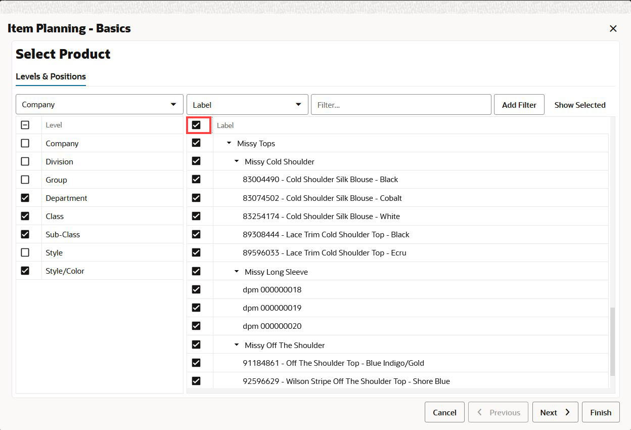

To select all positions, click the top of the column next to all the positions.
Figure 6-19 Select All Positions
To change the level of the positions to select from, place a check next to the desired level in the top left of the screen.
Figure 6-20 Change Position Levels

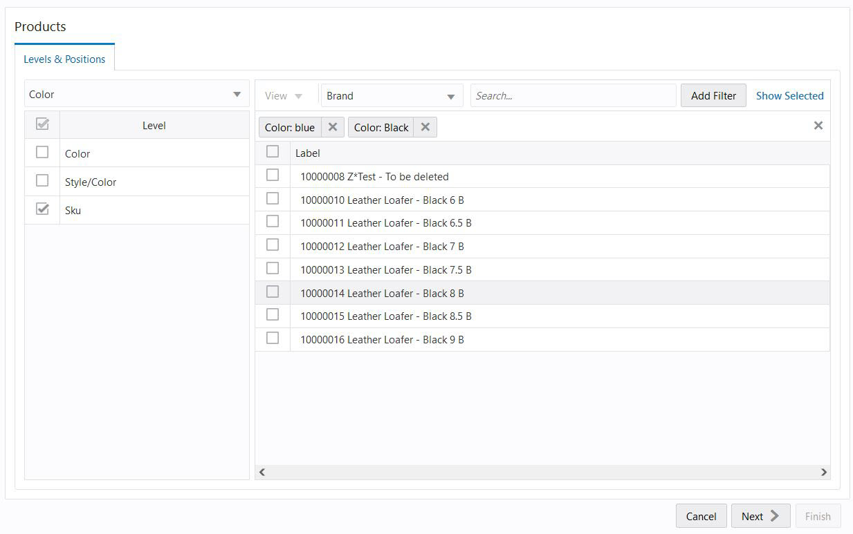

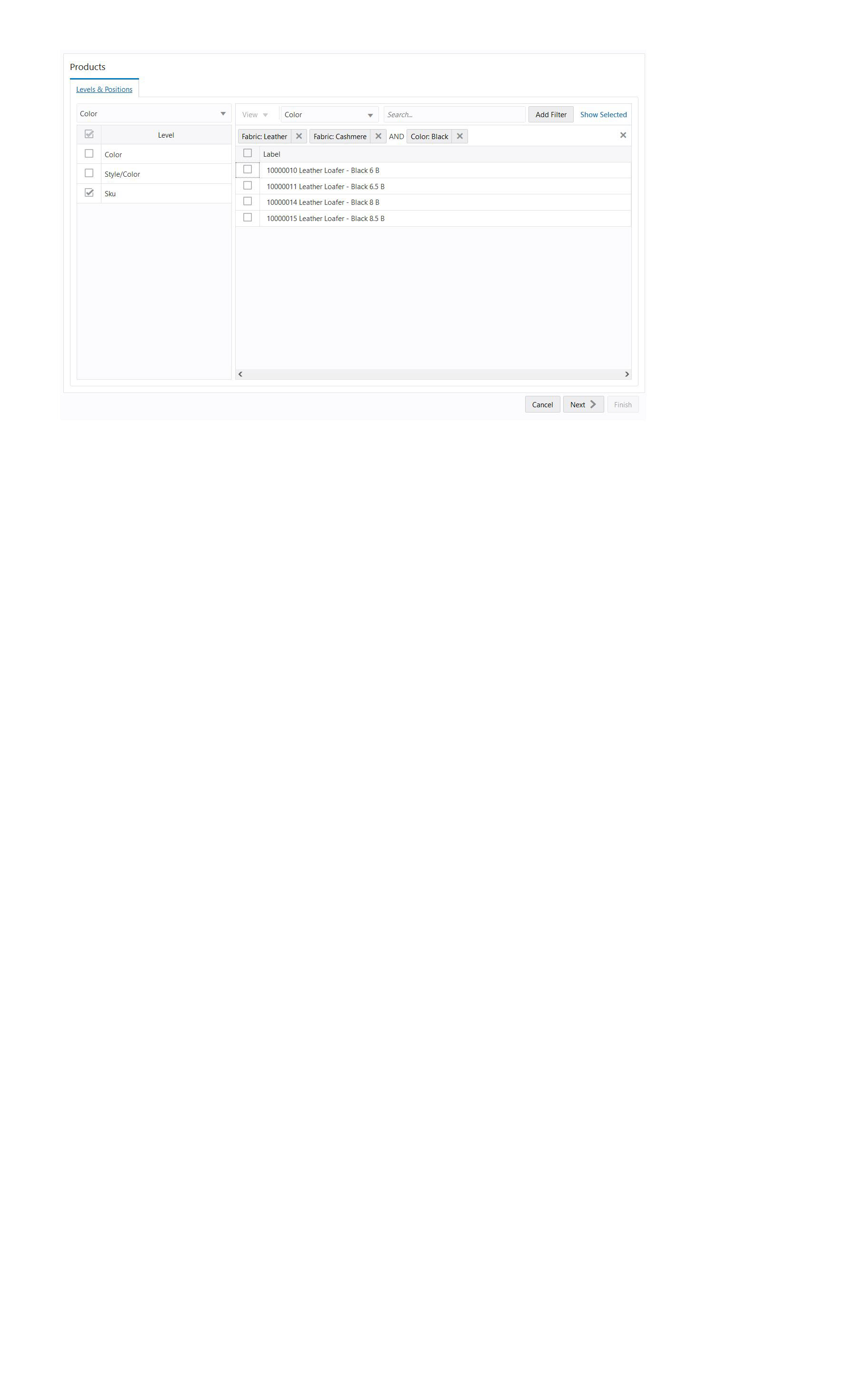

Filter Positions by Attribute
You can filter the positions by attributes when you create your plan. This allows you to examine the different options that you care about and make decisions. The attribute filter is visible only when attributes are associated with at least one of the selected levels. The filter picklist is by default set to the label attribute.
Select the required attribute as a filter and search for the positions that have the attribute value you selected. For example, you can search positions with more than one attribute. This helps you group the positions in the wizard based on attributes. The filter applied with the same attributes are applied with the logical operation OR. For example, if you search for positions with attribute colors of black and red, then the result displays all of the positions with the color red and the color black. The filter applied with different attributes are applied with the logical operation AND. For example, if you search for the position with the Brand X and the color Blue then the result positions are of the Brand X and the color Blue.
Figure 6-21 Filter Position - Single Attribute
Figure 6-22 Filter Position - Multiple Attributes
The user can also filter product based on status such as active and non-active. By selecting the attribute, Active Status, the user is presented with options like Active Since 2019, Non-active, and so on. This will help the user to easily filter out any non-active item to exclude in their selection.

Next, Previous, Finish
Once you have made your position selections for a dimension, click Next or Previous to move to the next or previous dimension selection screen. If all positions for all dimensions have been selected, click Finish to complete the workspace build and close the wizard.
Figure 6-26 Next Dimension

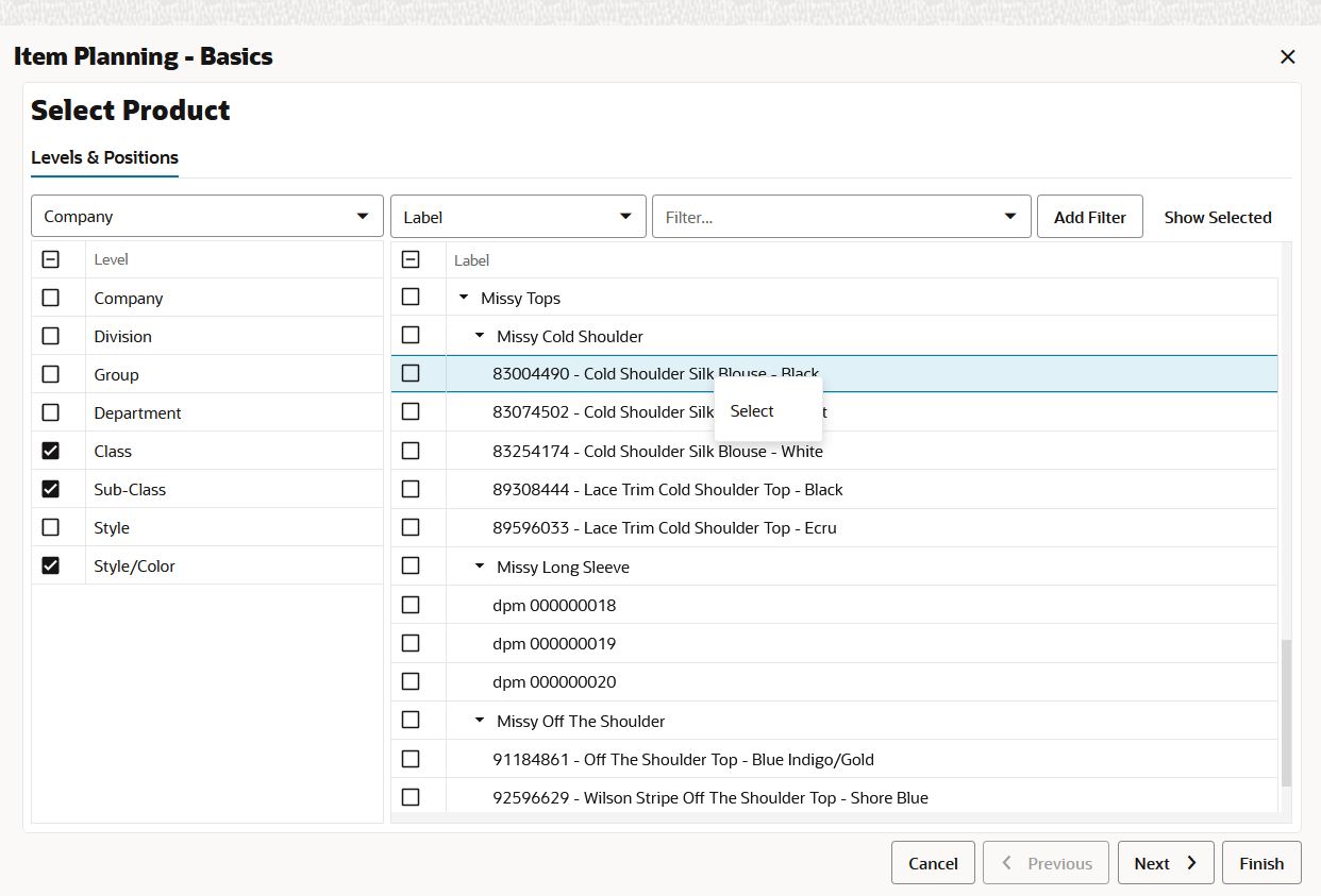

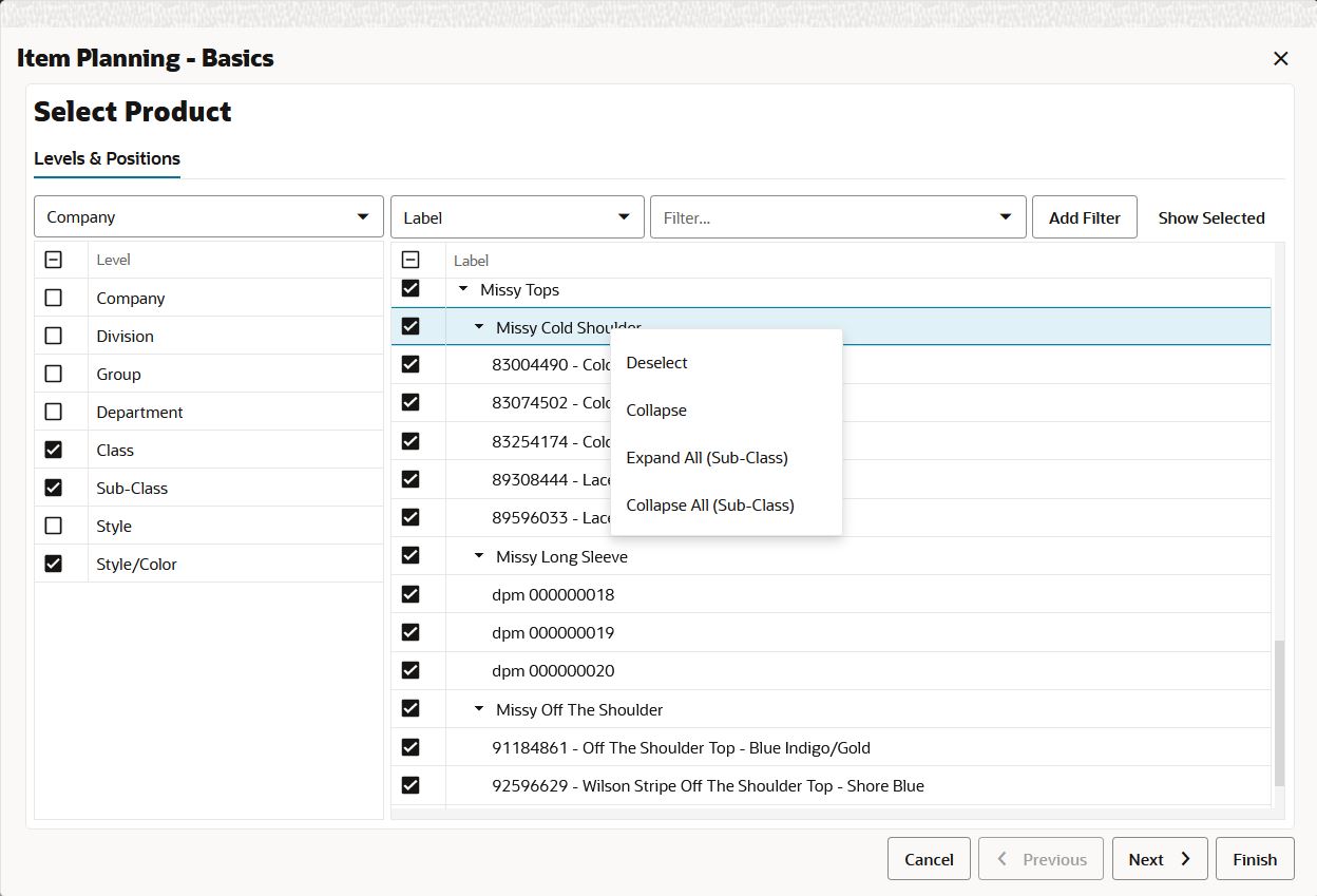

Select and Deselect Positions in the Wizard
You can also select and deselect positions using the context menu (right-click) option. This option is an alternative to select or deselect positions in wizard. You can use context menu option to select or deselect multiple positions simultaneously.
To select a position, right-click on the position and choose Select. Similarly, to deselect a position, right-click on a selected position and choose Deselect.
When you want to select or deselect multiple positions, select multiple positions by Using a mouse drag with a Shift or Ctrl key and right-click to opt for Select or Deselect positions.
Figure 6-27 Wizard Context Menu Select Position
Figure 6-28 Wizard Context Menu Deselect Position

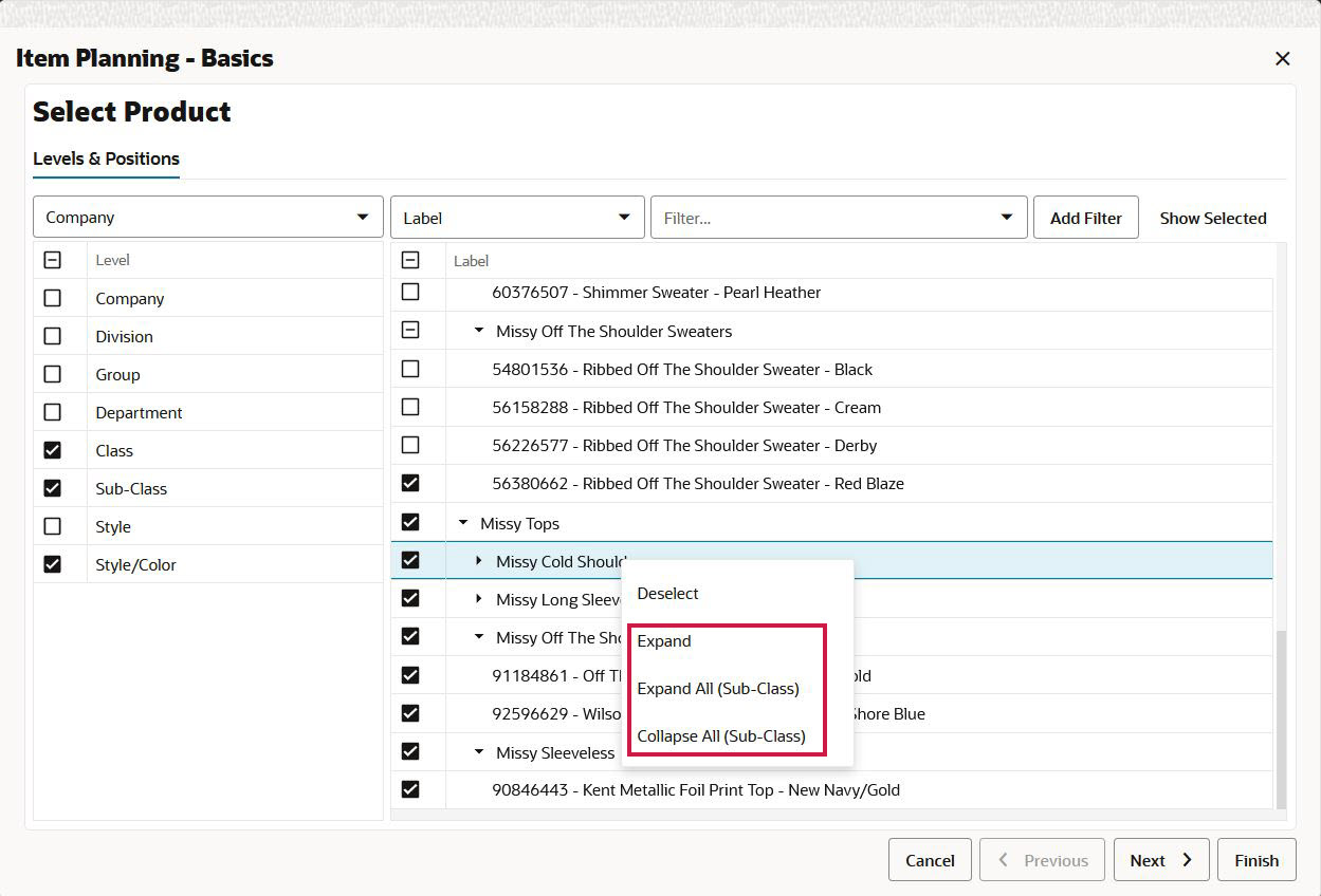

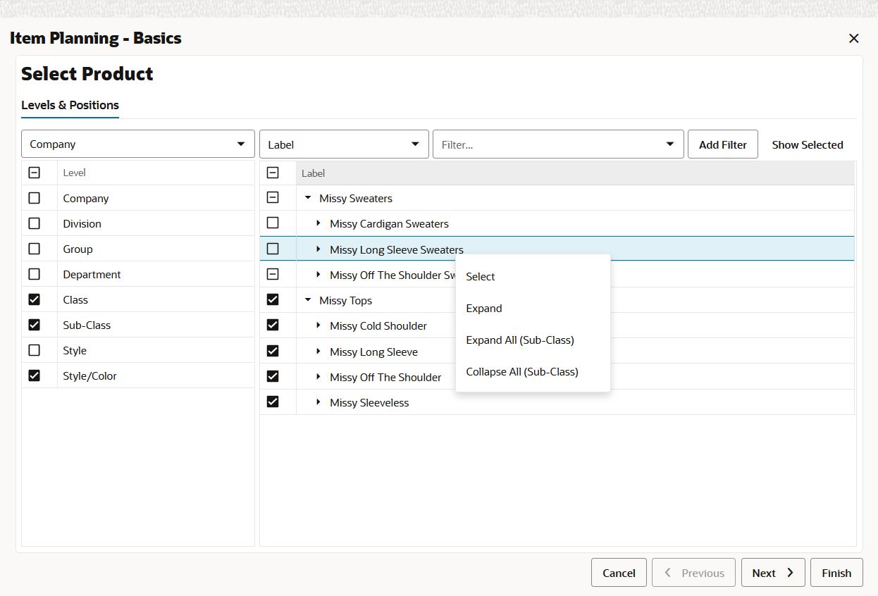

Collapsing and Expanding Positions in the Wizard
Collapse functionality allows a planner to group the child level positions to parent level. Expand functionality allows a planner to drill-down parent level to view all the child level positions. Collapse and expand function helps you to see all the positions in edit view that is meaningful to you.
To collapse or expand the dimension position you can use context menu (right-click) option. You can right-click on a parent level position and select Expandto see all of the child positions. Similarly, to group the child level position, you can right-click on the parent position and select Collapse.
Figure 6-29 Wizard Expand Position Level
Figure 6-30 Wizard Collapse Position Level
Collapse All and Expand All
The same functionality of collapse has been extended to Collapse All which collapses all the child level positions for the selected dimension level in wizard. And Expand all function expands all the child level position for the selected dimension level in wizard. The selected dimension level is specified next to Collapse All or Expand All in the context menu. With this function, you can quickly collapse or expand view the list of positions as desired.
Figure 6-31 Wizard Collapse All
Figure 6-32 Wizard Expand All

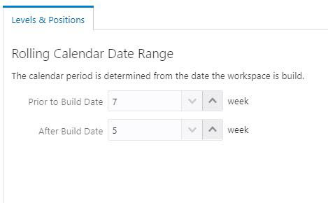

Rolling Calendar
When selecting Calendar dimension, you have the option to use a rolling calendar rather than the predefined time periods that are available from the wizard. This enables you to use a range of time periods that are relative to the current date. As time passes, the calendar favorite updates the range of time to be in relation to the new date.
To use the rolling Calendar, feature you must enable the rolling calendar feature from the Configuration Tool.
The length of the time periods is determined by the lowest level of the Calendar dimension presented in the wizard. For instance, if the lowest level in the wizard is Week, then when you select the time range in the rolling calendar option, you choose the number of weeks to include.
To use the rolling calendar feature, complete the following:
In the calendar step of the workbook wizard, select the Use Rolling Calendar option
Figure 6-33 Use Rolling Calendar option
Set the Rolling Calendar Date Range.
Figure 6-34 Rolling Calendar Date Range
In the Prior to Build Date field, either use the arrows or enter the desired number to select the number of time periods in relation to today's date for the start period. For instance, if the workbook's lowest calendar level is week and you want the time period to begin seven weeks in the past from today's date, you would enter 7.
In the After Build Date field, either use the arrows or enter the number of weeks in relation to today's date that you want the time period to end.

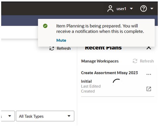

Asynchronous Build
Click Finish and the workspace begins building in the background. You can work on other tasks and workspaces while this is occurring. When the workspace build is complete, you will receive a Toast notification. You can see the status of the task in Administration dashboard under Administration Profile.
Figure 6-35 Asynchronous Build
When you select a workspace from the Tasks module, the Segment window is displayed.
Figure 6-36 Asynchronous Build Notification
