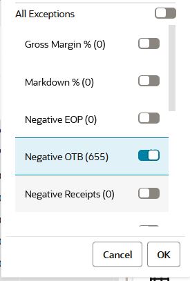

Click All Exceptions and then OK to select all the exceptions for alert navigation.
Figure 15-2 Select All Exceptions for Alerts
You can select the exceptions to be displayed using the sliders. You can display multiple exceptions or all exceptions. Note that the active alert is highlighted in blue. In Figure 15-3, the active alert is the Negative OTB alert. You must select the active alert for display before you can click OK.

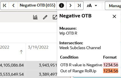

Click on the information icon to launch the alert summary of the currently selected alert. It displays the alerted measure, intersection, alerted condition, and format that was chosen to highlight the alerted cells. This summary also contains the configured condition message for each condition in the alert.

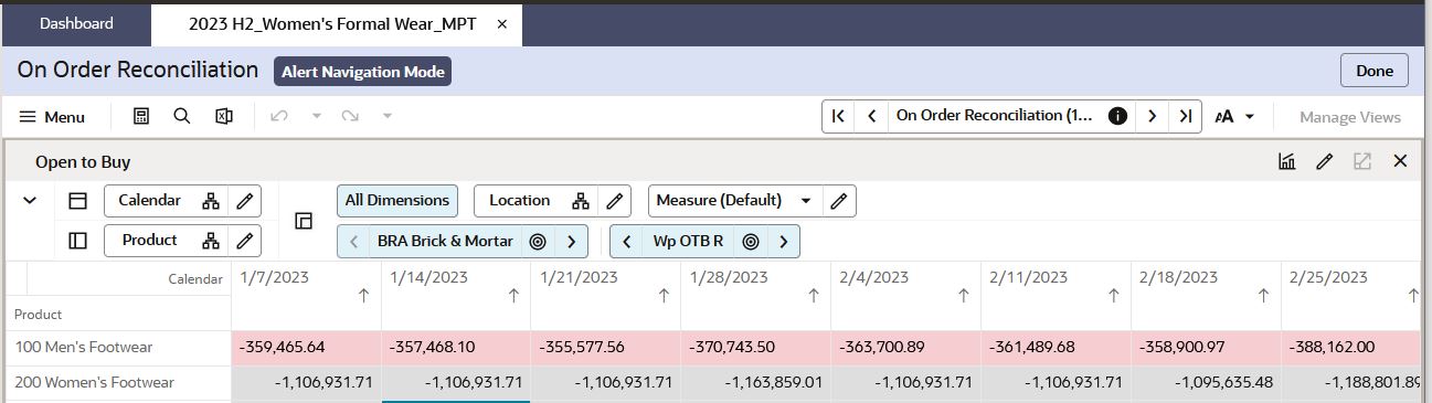

Alert Navigation

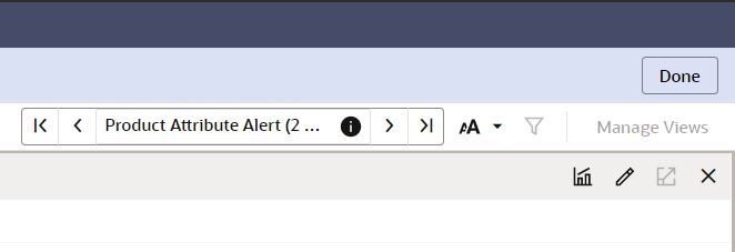

Clicking on the first, left, right, or last arrow launches the alert navigation mode. Use this to navigate between the various alerted intersections present in the specified view.
Figure 15-5 Enter Alert Navigation Mode

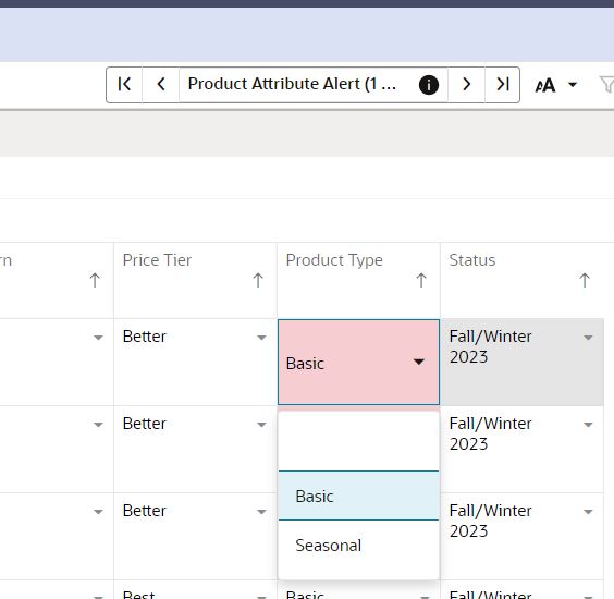

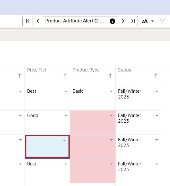

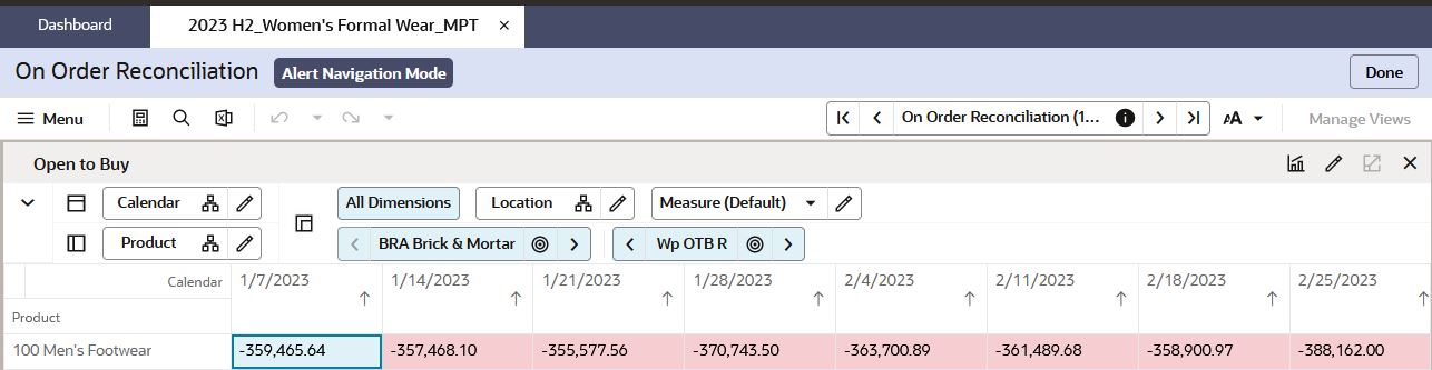

You can see that now you are in alert navigation mode, as highlighted in Figure 15-7. The alerted cell is highlighted in red, and the selected cell is highlighted in black.
Figure 15-6 Alert Navigation Mode

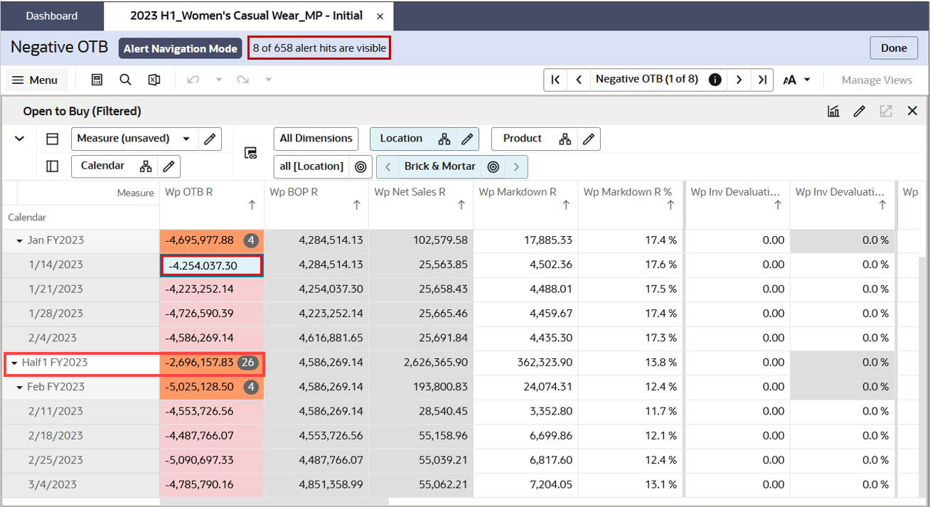

When you start alert navigation, some of the alerted cells may be hidden from the view. When this happens, you will see a message indicating how many of the total count are visible; you can only navigate through those that are visible. This can occur when positions of the alerted cells are hidden (probably most common), or if the alert's Target Measure is hidden. Use Edit View to make these visible. This can also happen when the alert intersection is not visible, but starting navigation will make those levels visible.Figure 15-8 shows the message that appears. In this case, Half 1 FY2023, which contains 26 hits, are hidden.
Figure 15-8 Hidden Alerts
Hidden Alerts
Figure 15-9 View Alert Intersections

To exit the alert navigation mode, click Done. To hide the alerts, deselect the Alert in the Exception list. When you re-enter the alert navigation mode, you are taken to the same alerted position that you exited from.

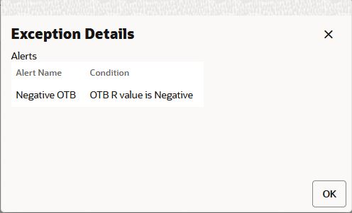

Exception Details
Cells with alert hits display the formatting of the highest priority alert on the cell that is enabled for display. You can right-click on the cell and select Exception Details in the context menu for a single cell selection. This brings up the Exception Details pop-up window, shown in Figure 15-13, which lists each alert hit on the cell in priority order, using the configured Alert Label and Condition Message of the hit. Only the alerts selected for display (the slide toggle in the alert selector) are included in this list. The condition name is displayed as a number for rollup cells.
Figure 15-13 Example Exception Details Context Menu

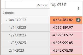

Note that if a rollup alert is configured, you will see a badge in rollup cells that displays the count of how many cells at the alert intersection have that alert. Figure 15-14 shows a rollup badge with alerts at Week rolling up to a count on Month.
Figure 15-14 Rollup Badge
Rollup Badge

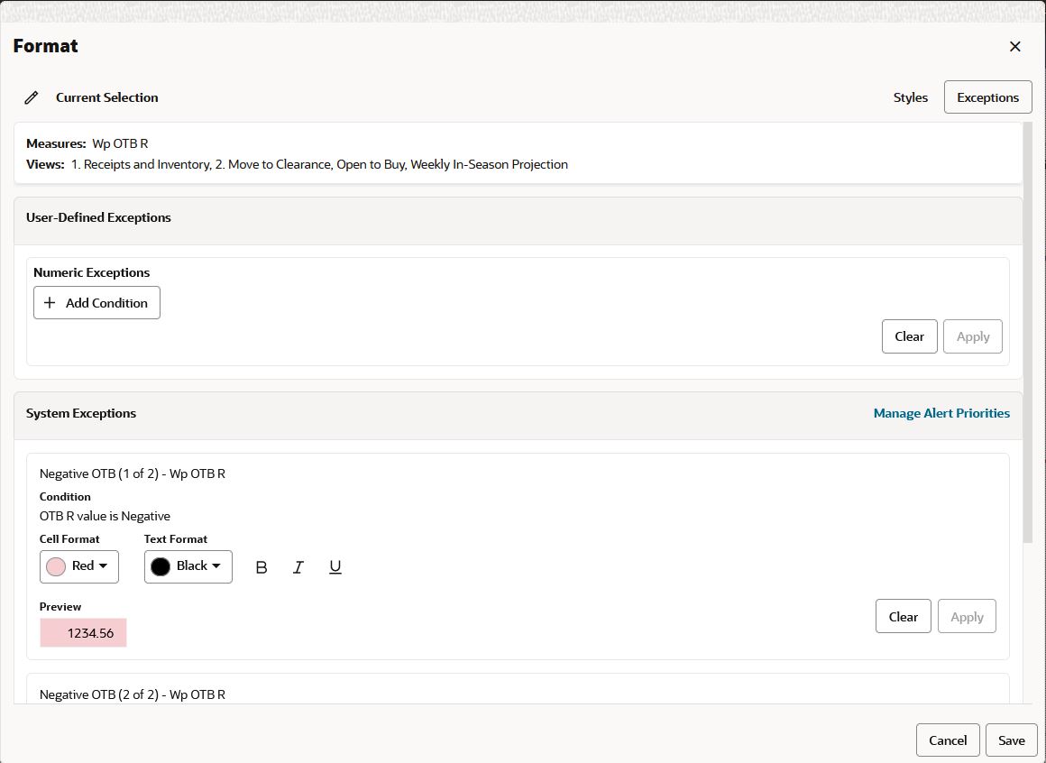

Alert Formatting
Click Format to edit styles and exceptions. The current format applied to the active alert, along with a summary of the calculation for the conditions, can be edited. You cannot add any system exceptions, as they are added in the RPASCE configuration. You can add any user-defined exceptions and specify the preferred format used to notify you and prioritize the condition over the system alert. The alert priority can be specified in the alert definition when multiple alerts are raised on the same target measure cells. You can prioritize the user-defined exception over the system exception also. You can also save or delete the Alert styles for you or your group.
