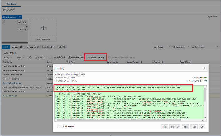

Time Zone
RPASCE in the cloud environment always runs in the UTC time zone. All the downloaded log files, as well as the live logs you view, display information in the UTC time zone only.
The following message is displayed in every log file for all OAT tasks:
<B 2021-08-31T15:17:15.154Z r:D op:?> Note: Logs displayed below uses Universal Coordinated Time(UTC).
Note that when you schedule an OAT task or view the timestamps for a task in the dashboard, the time will match your browser time zone. This is done to prevent confusion when you are scheduling the task.

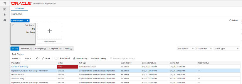

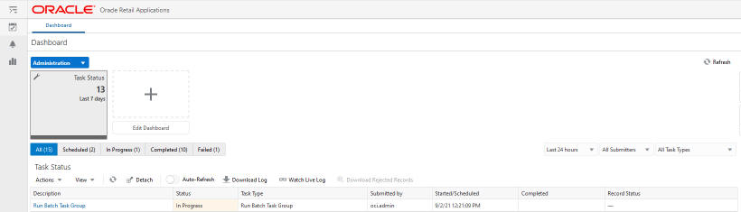

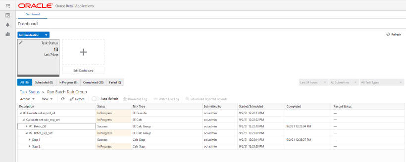

Drilling Down to Actual Logs
The Dashboard provides the functionality to drill down through the OAT task log files for long-running OAT tasks. This is useful for monitoring tasks that are in a running state; it can also be used to drill down to failed tasks and open the log files.
Figure A-2 shows drilling down to actual logs.
Figure A-3 shows drilling down to actual logs for a running task.

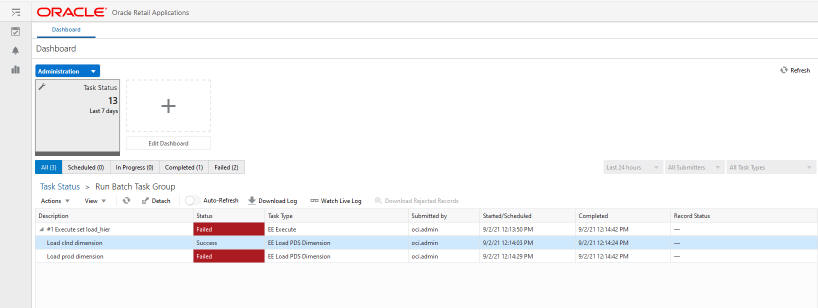

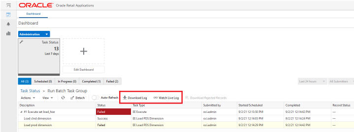

Figure A-4, Figure A-5, and Figure A-6 show drilling down to actual logs for a failed task.
Figure A-4 Drilling Down - Failed Task Part 1
Description of "Figure A-4 Drilling Down - Failed Task Part 1"
Figure A-5 Drilling Down - Failed Task Part 2
Description of "Figure A-5 Drilling Down - Failed Task Part 2"
Figure A-6 Drilling Down - Failed Task Part 3
Description of "Figure A-6 Drilling Down - Failed Task Part 3"

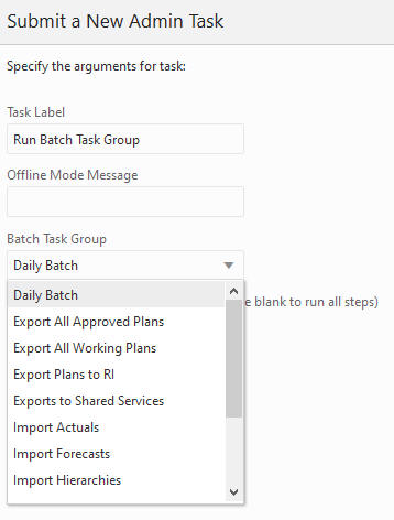

Missing Batch Task Group in OAT Wizard
After uploading the batch control files to the PDS, if you see that a batch task group is missing from the drop-down list, check the batch control file batch_oat_list.txt that was uploaded. This file holds keys to the value seen in the dropbox.

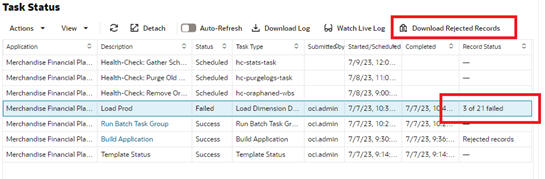

Download Rejected Records
Load Dimension Data and Load Fact Data can generate rejected records. These rejected records are stored separately from the normal log files. The Download Rejected Records button is only activated when rejected records are generated in the process.
Figure A-8 Rejected Records
The lines contained in the rejected record file may be different than the original data file because of the different column order between the data file vs. the configuration or data file that contains unused columns. The user must use the root position names to look up the original line in the source.
