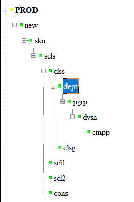

The patching process supports adding new dimensions or removing existing dimensions. The new dimensions can be added anywhere in the hierarchy. Changes to the existing roll-up relationship of existing dimensions are not supported by the patching process.

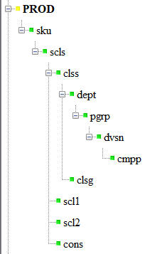

The following example shows PROD hierarchy in original configuration, and some changes made to it.
Figure 6-1 shows the original configuration.

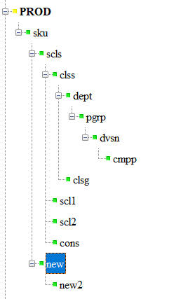

Figure 6-2 shows an example of adding new dimensions (new, new2) to construct a new branch off the existing hierarchy.
Figure 6-3 and Figure 6-4 show more examples of adding new dimensions in two cases.
