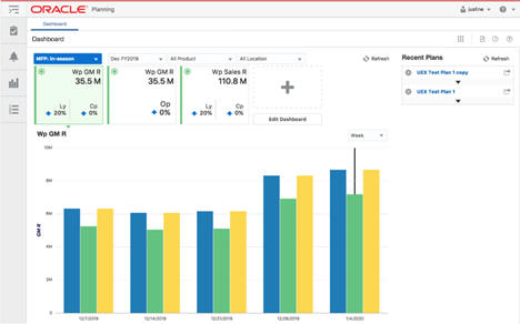

Dashboard
The help topics for the dashboard can be divided into two categories:
All–The generic topics related to the product are added to this category.
Report–This consists of topics related to dashboard, such as its effective usage, the analysis of the metrics, and so on.
Figure 7-1 shows the view of a dashboard and the help icon. The help topics for the dashboard can be seen on the right-hand panel in Figure 7-2.

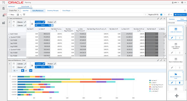

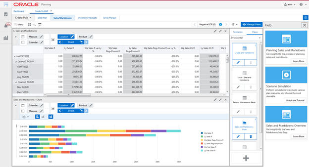

Workspace
Workspace is defined as the space for the workbooks and their related view content. Here the topics are aligned with respect to the different levels of the taskflow. Figure 7-3 and Figure 7-4 illustrates the workspace for the product MFPRCS. Here, the Step, Tabs, and View are visible.

Figure 7-4 MFPRCS Workspace Displaying Help Topics
Description of "Figure 7-4 MFPRCS Workspace Displaying Help Topics"

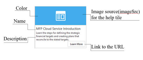

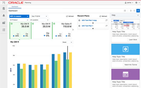

}]Help Topic Tile
The help topic tile is a visual representation of the topic. Figure 7-5 displays the properties.
The retailer and the implementer decide together which help topics should be available for each workspace or view within the customer's specific RPASCE workflow. Up to three contextual help tiles can be displayed on an individual view. More can be configured if desired; these are visible through scrolling.
Table 7-2 describes the available attributes that can be specified during the contextual help requirements definition for each help tile:

Note that the mandatory fields for the tile are URL and Type. The remainder of the fields can be empty. Also note, on a help tile, that the document type labels the help link button as 'Learn More' & 'video' type labels it as 'Watch the Tutorial'.

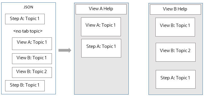

Figure 7-6 displays an example of a JSON object containing all the three levels and the help topics related to each of them. The maxTopics define how many topics must be visible on RPASCE. If, for a particular level, there are fewer than maxTopics topics, it fetches the remaining topics from its parent. Figure 7-6 also shows that the maxTopics for workbooks is set to 2, and it overrides the maxTopics for the root, which is set to 3, for the workbooks level. Since there is no maxTopics set for reports, the value for maximum topics for this level is capped to 3, which is fetched from the root level.
When multiple views are displayed in a workbook, the help topics for the visible view are displayed in a specific order. The lower priority topics are dropped from the set presented to the user. The order from highest to lowest of relevant topics is as follows:
Application-specific information about the view currently displayed.
Application-specific information about the tab currently active.
Application-specific information about the step currently active.
Application-specific information about the task being performed in the workspace.
Platform-specific information.

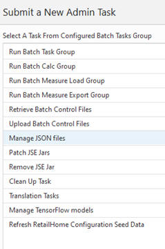

Retrieving or Updating the InContext Help JSON File
You can update or retrieve the help JSON file using an OAT task. This provides the flexibility to view the list of available help resources and modify them as needed.
Make sure the following environment variables are set:
APP_NAME
OUTGOING_FTP_PATH
INCOMING_FTP_PATH
Complete the following steps to submit the OAT task.
Open Submit a New Admin Task.
Select Configured Batch Tasks under Task Group and click Next.
Select Manage JSON files from the list of available tasks and click Next.
Figure 7-8 Configured Batch Task Group Tasks
Description of "Figure 7-8 Configured Batch Task Group Tasks" -
Provide a task label and select the type of operation to be performed.
Retrieve JSON files to FTP. This operation fetches the help JSON file from the RPASCE application. When this task is run, the help JSON file (with other JSON files) is bundled as a tar.gz with the label <solution_name>_json.tar.gz and is placed under the OUTGOING_FTP_PATH. The help JSON file is also prefixed with the solution name <solution_name>HelpConfig.json
