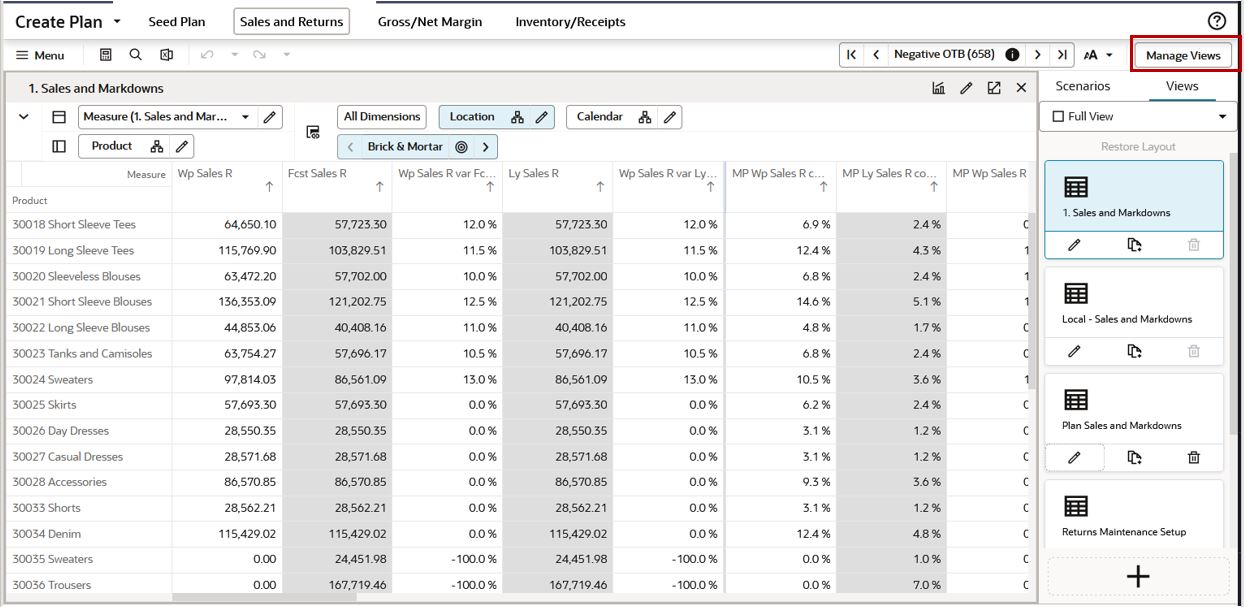

View Management Drawer
Use the View Management Drawer to select the visible views, add new views, modify or delete an existing view, and change the view layout. Click Manage Views to show or hide the View Management Drawer.
By default, the View Management Drawer is not displayed. Click Manage Views to open the View Management Drawer.

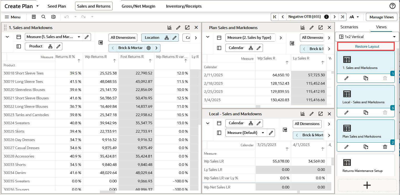

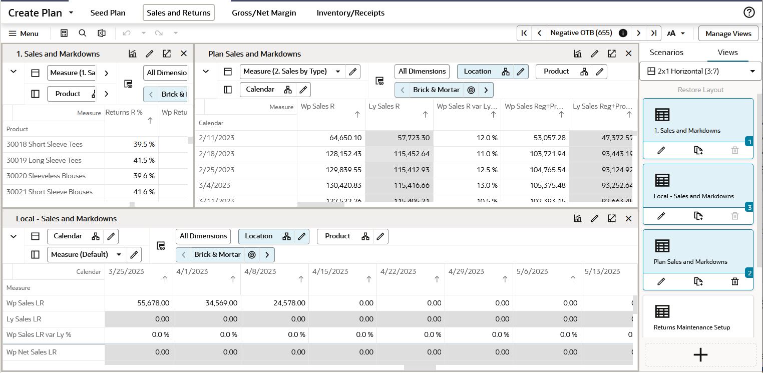

Re-Size View Layout
The view layout size can be adjusted manually to make the layout optimal for data review. Views can easily be adjusted when you select then hold and drag the vertical or horizontal dividing space between the views. When moving the horizontal diving space, the minimum height of each view can be no less than 20% of the width. When moving vertical diving space, the minimum height of each view can be no less than 15% of the width.
Use the Restore Layout link to reset views back to the default size of the selected view option. Restore Layout is accessed from Global menu Views option or directly from top of the view tile. Figure 9-15 shows the link for Restore Layout.
Figure 9-15 Restore Layout

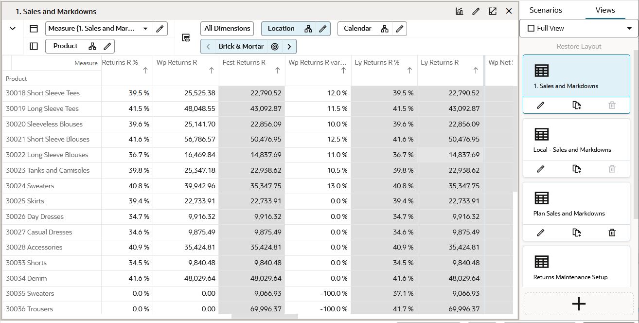

View List
The available views are listed on the right side of the screen in the View Management Drawer, as shown in Figure 9-16.
Figure 9-16 View List

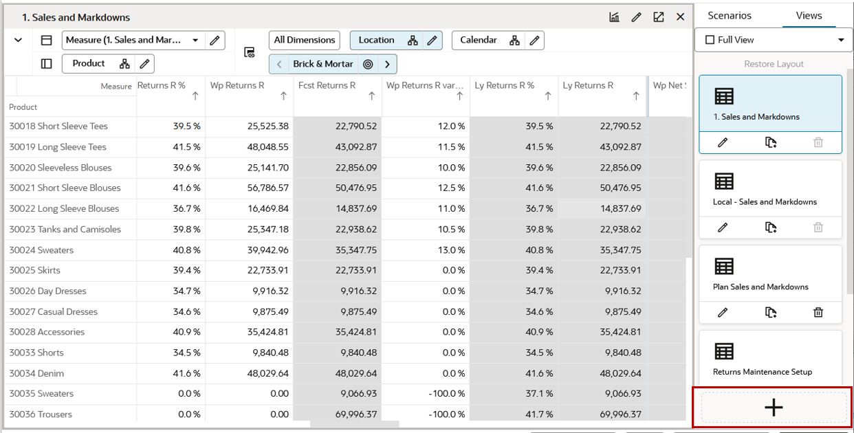

Creating a View
You can create a new view containing a new selection of measures in the form of a pivot table or many chart views.
To create a new view, click Plus in the View Management Drawer.

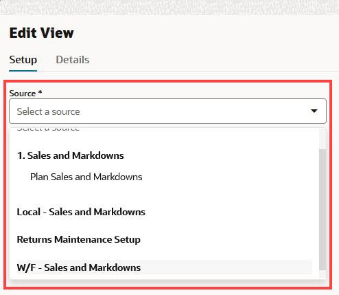

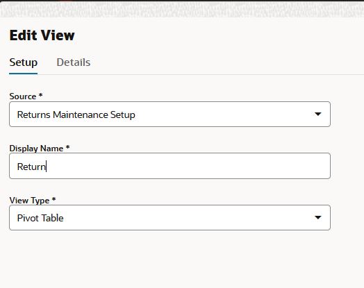

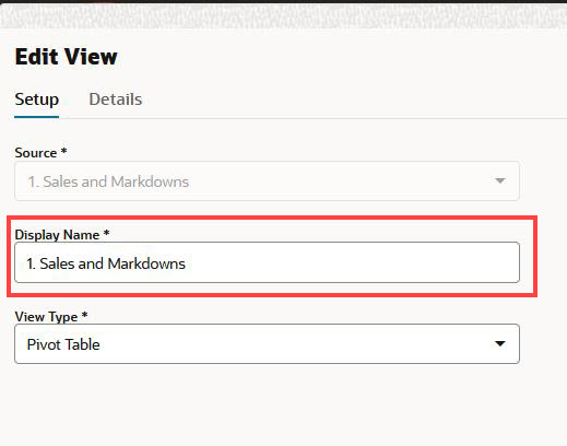

In Edit View, on the Setup tab, select a Source from the list. The options are limited to the other existing views in the View Management Drawer.
Figure 9-18 Edit View Setup Options
Enter a Display Name. If creating a chart view, consider using a similar name to the source view.
Figure 9-19 Display Name

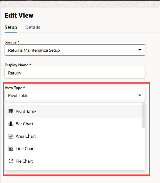

Select the type of view to be created, such as Pivot Table, Line Chart, Pie Chart, and so on.
Figure 9-20 Type of View

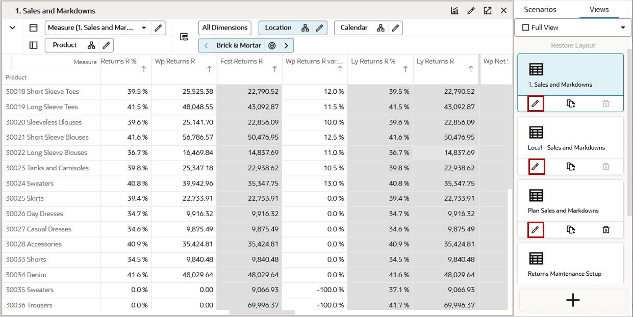

To modify a view, complete the following steps:
Click the Edit view icon on the View tile in the View Management Drawer.
Figure 9-21 Modifying a View

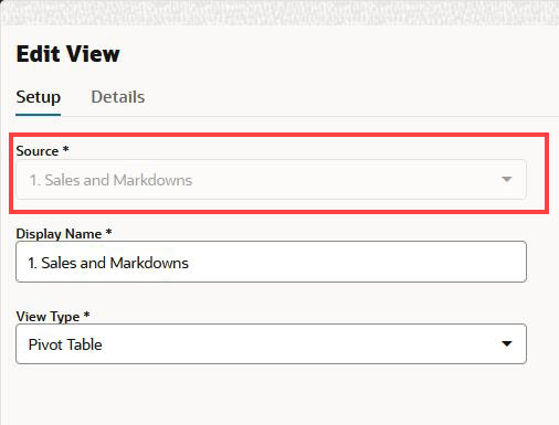

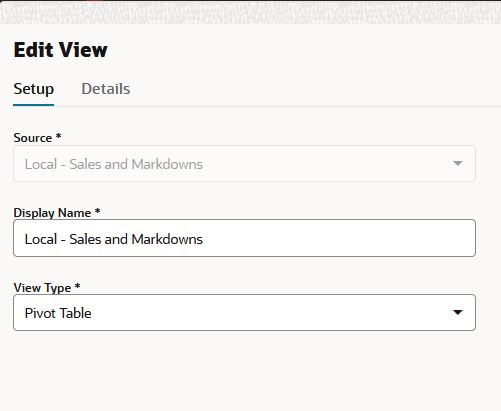

Follow the same steps as in "Creating a View", excluding selecting a Source. Since the view has already been created, the Source list is unavailable.
Figure 9-22 Edit View > Source Menu (unavailable)

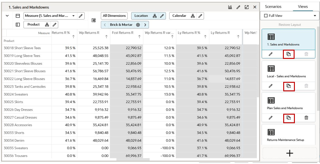

Copying a View
To make a copy or a duplicate of a view, you can click the Duplicate View icon on the View tile in the View Management Drawer. It creates a duplicate of the view with the Display name of View Name> Copy 1. You can create a new view and use the original view as the source.
Click Plus to open Edit View.
Figure 9-23 Copying a View
In the Source list, select the view to make a copy of. Complete the rest of the required fields.
Figure 9-24 Selecting a View

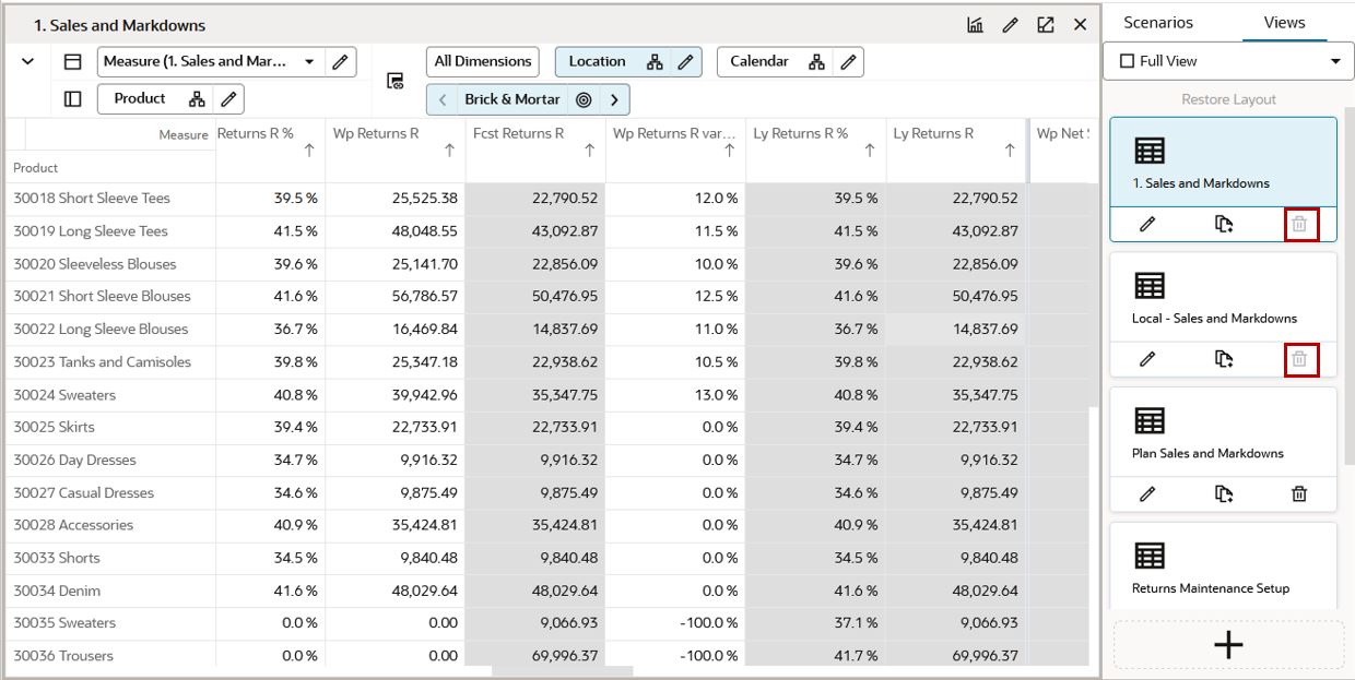

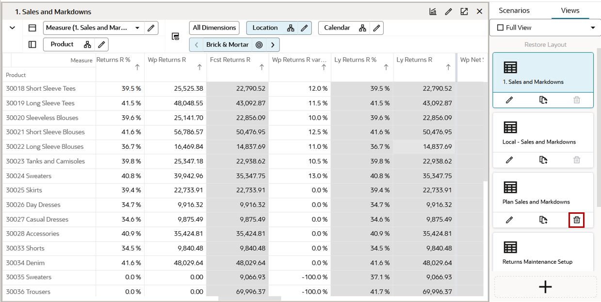

Deleting a View
To delete a view from the View Management Drawer, click the Delete View icon on the View tile in the View Management Drawer.
Figure 9-25 Deleting a View
You cannot delete the views defined in the system task flow. For such views, the Delete icon is disabled.
Figure 9-26 Disabled Delete Option

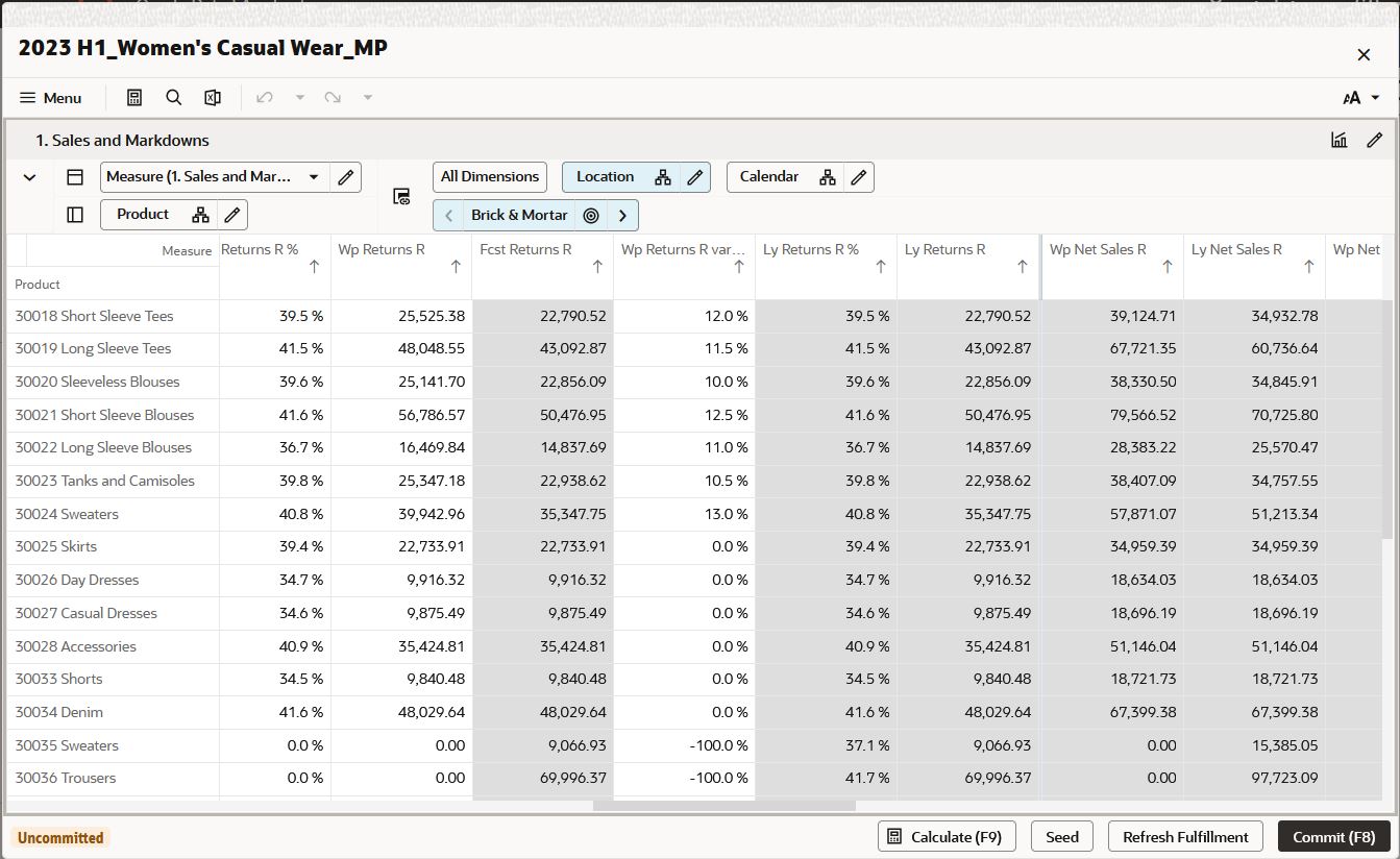

Working with Views
Views are associated with each step within the business workflow. Views are displayed as a spreadsheet-like or a chart type with the multidimensional data selected at the dimension levels in Edit view. Each view includes a set of measures relevant to the step that help you view and analyze information, and make decisions.

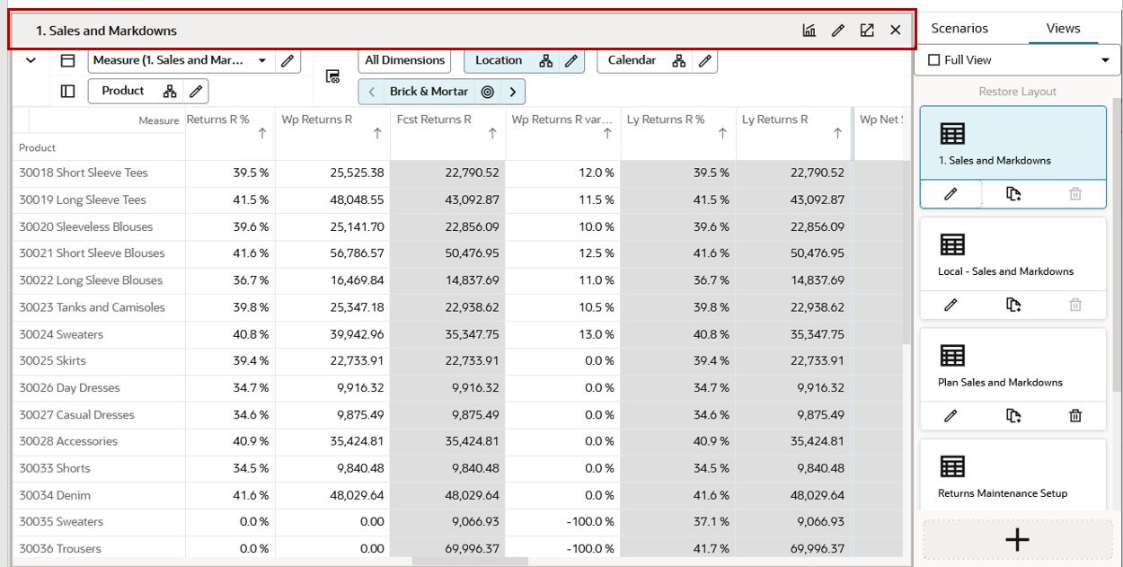

View Title Bar
The View Title Bar contains the name of the view being displayed and the buttons for Edit, Expand, and Close.
Figure 9-27 View Title Bar
The Edit button opens the Edit View window where you can change the view name, change the view type, rearrange the axes, modify the dimension levels, choose the measure profile, add or remove measures, hide and unhide positions, and so on. For more information on how to perform the previously mentioned steps, see Editing Views.

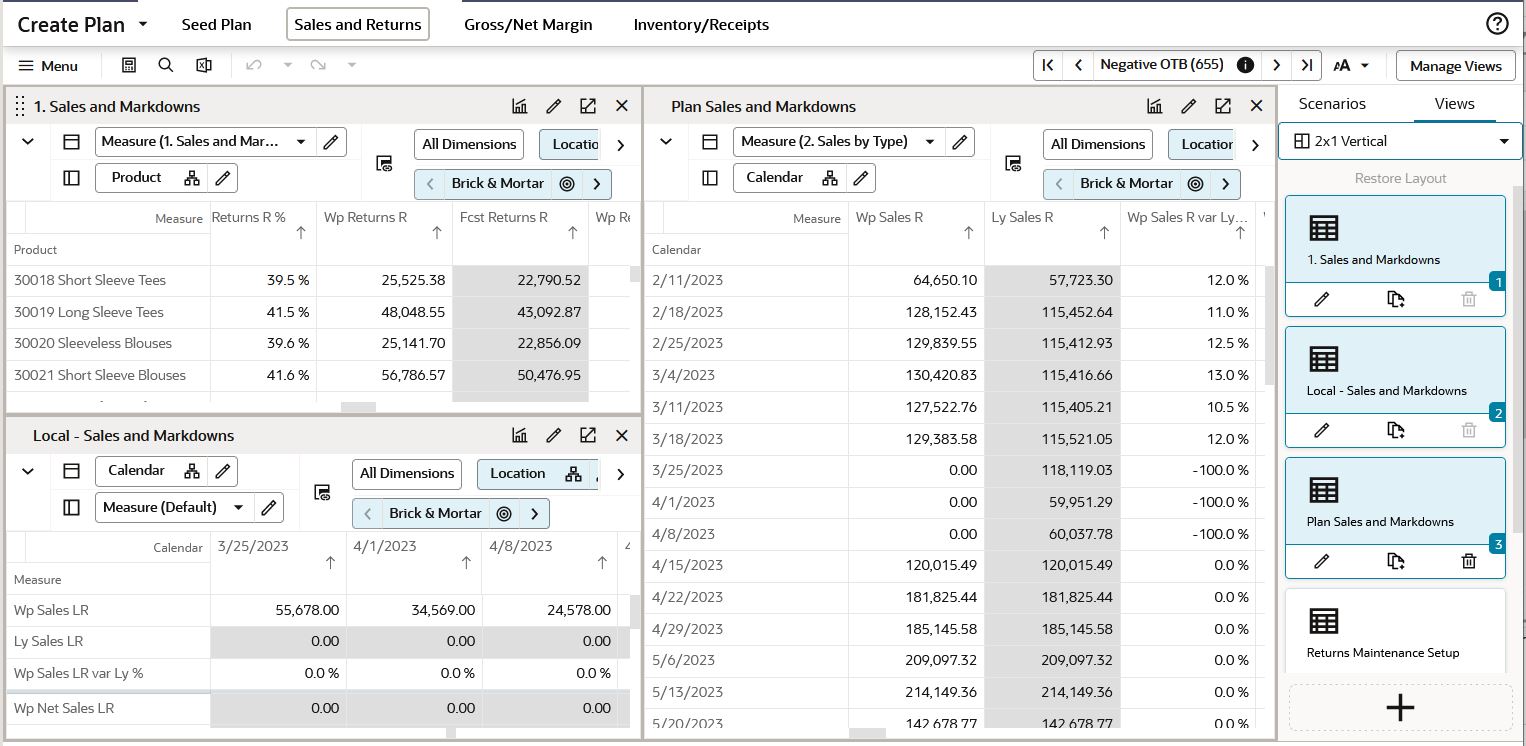

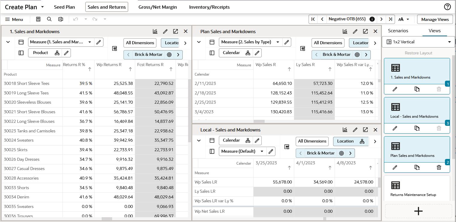

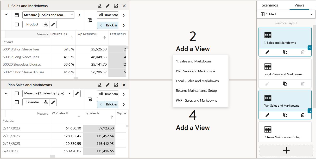

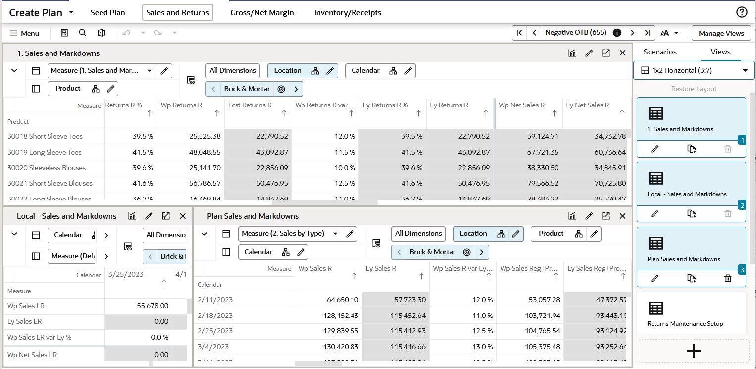

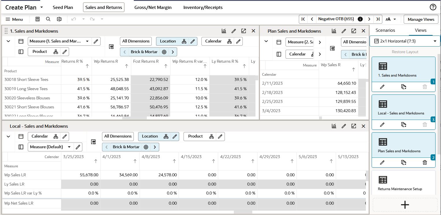

Adding a View to a Layout

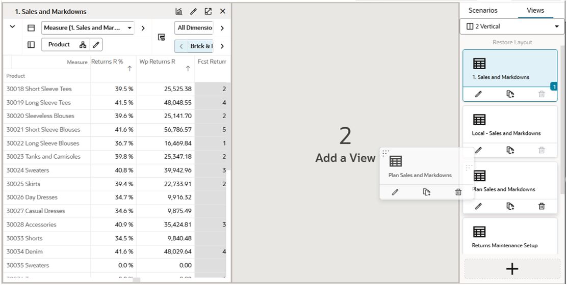

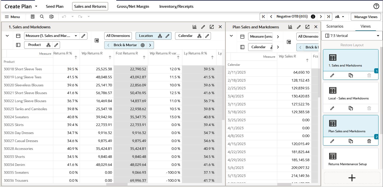

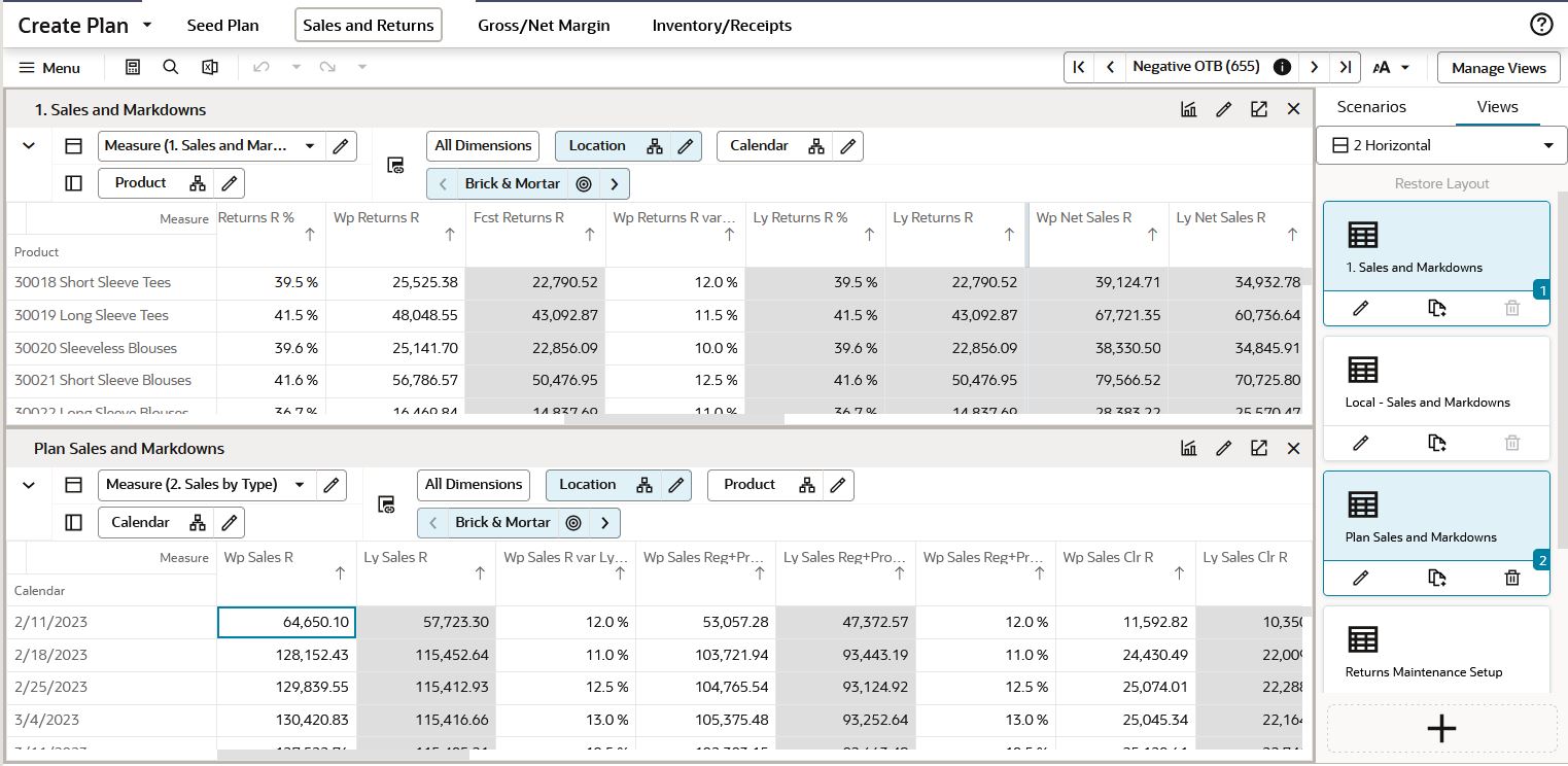

To add a view to a layout, click the view to replace the current active full view or drag the view from the View Management Drawer to a location on the layout. If the layout is 4 Tiled, 2 Horizontal, or 2 Vertical, you can drag multiple views to the different locations on the layout.
You can click the view you want to see to add it to a blank layout section. It will fill the sections sequentially. To see a different view later, drag and drop the view in the required section.
Figure 9-31 Adding a View to a Layout (Drag and Drop)
You can also add a view in a layout section by clicking the Add View button and selecting the required view from the list.
Figure 9-32 Add a View

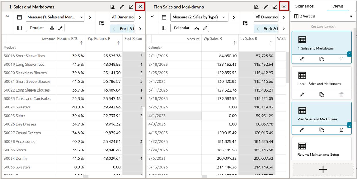

Removing a View from a Layout
To remove a view from a layout, click the X in the upper right corner of the view.
Figure 9-33 Remove View from Layout

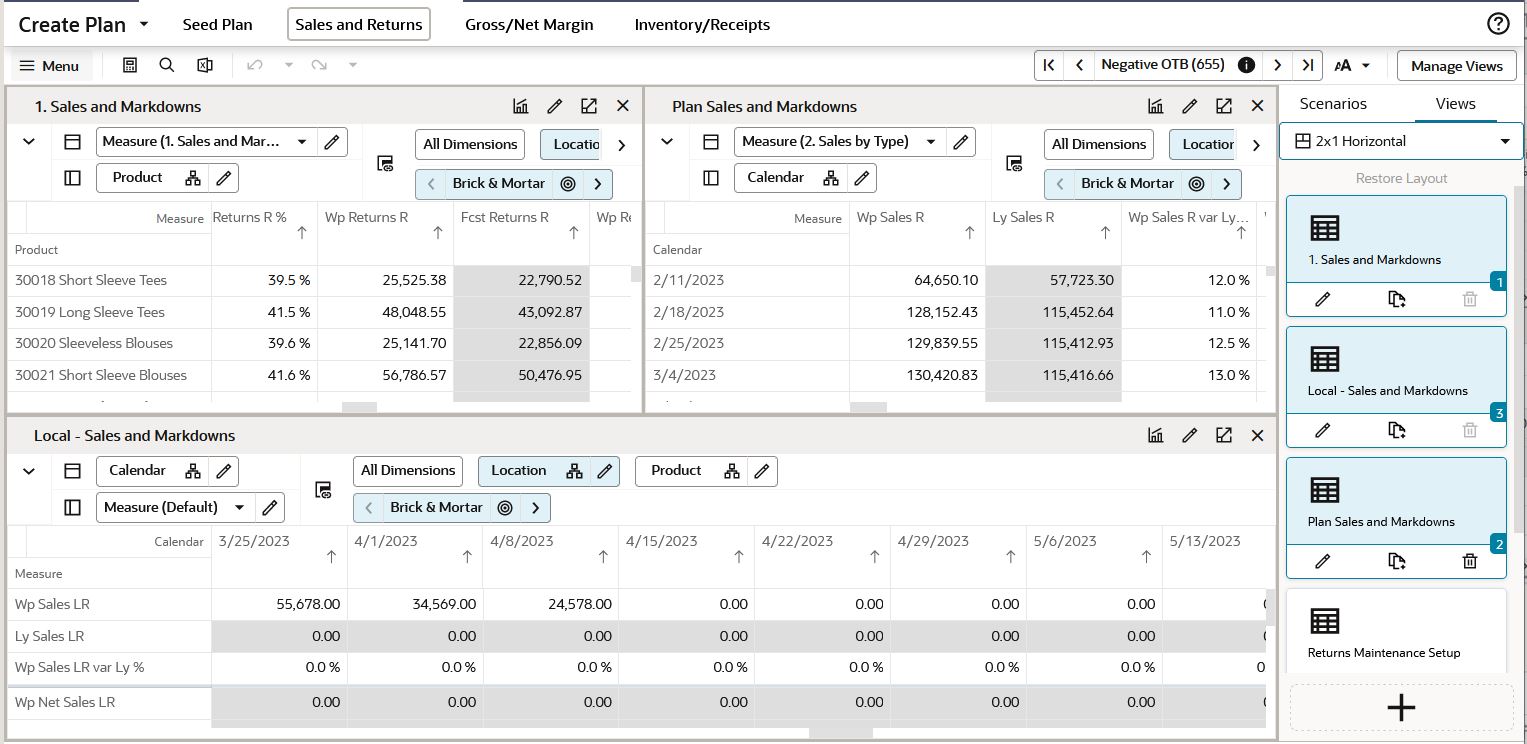

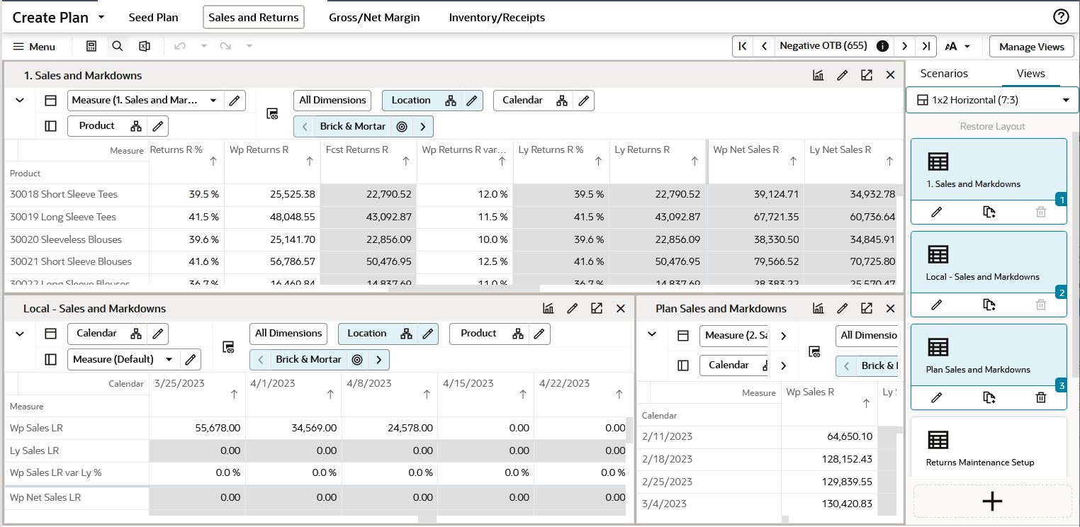

Moving a View
If a view is already displayed in the layout, drag that view from the View Management Drawer to any different location in the layout, then left click the location to drop the view.
In the example shown in Figure 9-34, to move the view Local - Sales and Markdowns from the layout location 3 to layout location 2, drag the view Local - Sales and Markdowns from the View Management Drawer to layout location 2.
Figure 9-34 Moving a View (Drag and Drop)
You can also click the Add View button in layout location 2 and select Local - Sales and Markdowns from the list in order to move the view from location 3 to location 2.
Figure 9-35 Moving a View (Add View Button)

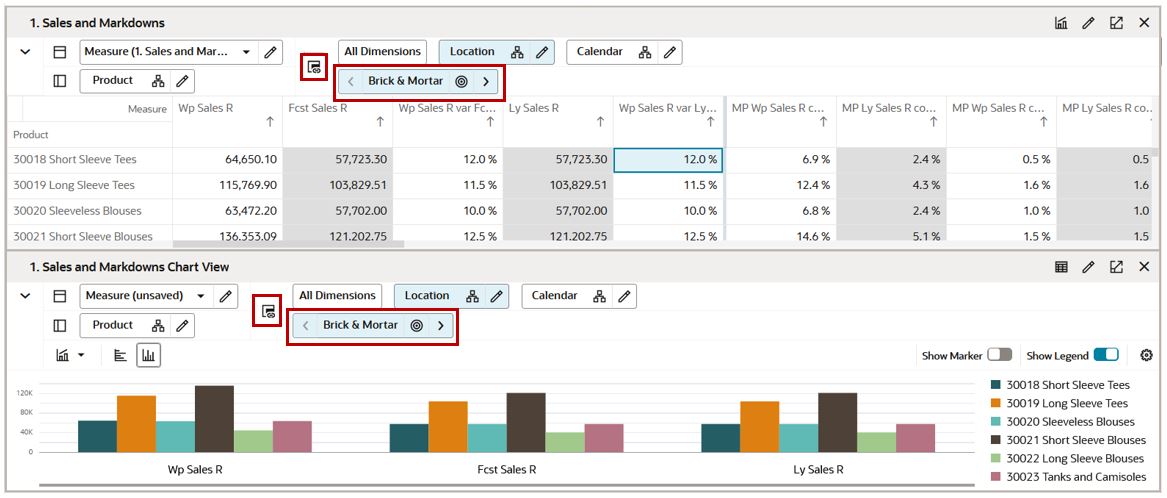

Synchronize Z-axis Scrolling
Synchronized Z-axis Scrolling lets you simultaneously scroll through the z-axis of multiple views. When Synchronized Z-axis Scrolling is enabled, all views that contain the same slice dimension scroll to the new slice position when one of those views is scrolled to a new position. When scrolling is disabled, scrolling through slice positions in one view does not affect the slice position display of other views.
Synchronized Z-axis Scrolling works for all views within a single workspace, and it remains enabled as you move through the views, tasks, and steps within that workspace. When Synchronized Z-axis Scrolling is enabled, and if the same dimensions (one or all) exist on the page edge of another view, you will see the values for the current position on the synchronized dimension that is on page edge of this view. This means that the page edge of the current view is in sync with the page edge of the view on which you enabled page edge synchronization. The Page Edge and Dimension Tiles area is not visible.
Synchronized Z-axis Scrolling is useful when you want to compare multiple views containing the same page or slice dimension. Synchronized Z-axis Scrolling may be saved using formatting.
To enable Synchronized Z-axis Scrolling, click Synchronize Z-axis in the Z-axis and Dimension Tiles area, as shown in Figure 9-38 and Figure 9-39.
