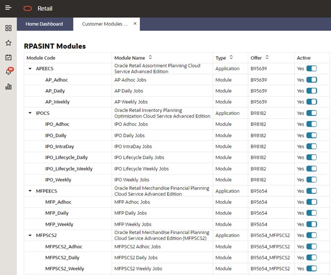

The following figure shows MDF modules from the Customer Modules Management page of Retail Home
Figure 8-2 MDF Modules from Customer Modules Management of Retail Home

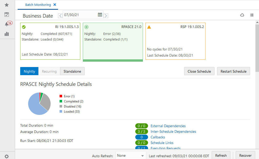

The POM Batch Monitoring page, shown in Figure 8-3, is the dashboard for the batch process flows and jobs. On the monitor page, each job can be viewed and acted on and the business date can be viewed and modified. The business date is passed to RPASCE as the value of RPAS_TODAY for batch execution. The Nightly batch include all jobs in the process flow in Table 8-1. The Standalone batch includes only the ad-hoc job.

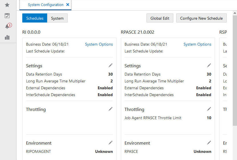

POM System Administration
On the POM System Administration page, shown in Figure 8-4,schedule properties can be modified that include System Options, Settings, Throttling, and Environment.

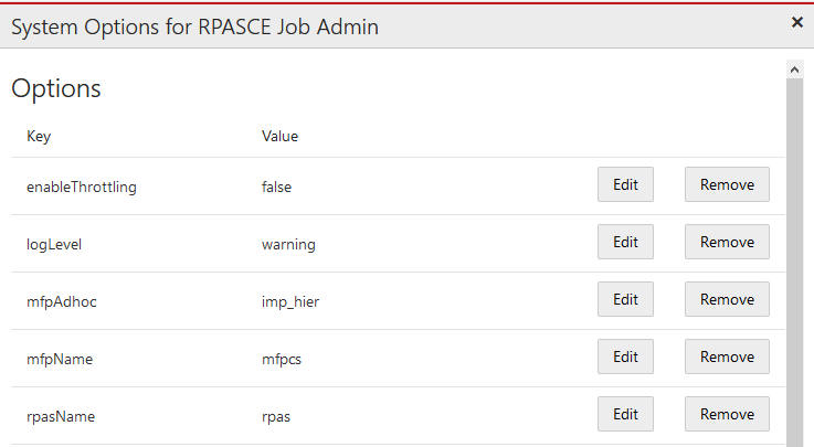

The System Options, shown in Figure 8-5, contain some values that are used in the job parameters. The logLevel is used by the server to determine the detail level of the log for the jobs. The values can be error, warning, information, debug, or all, with increasing details. The mfpAdhoc is used by the ad-hoc job as its batch control set name. The System Options variable is referred to as #SysOpt.{name} in the job parameters attribute.

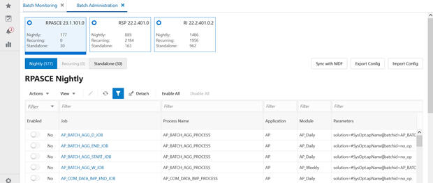

POM Batch Administration

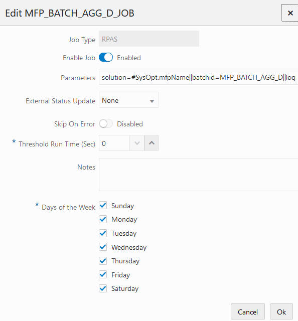

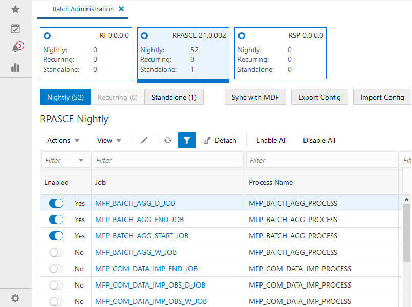

On the POM Batch Administration page, shown in Figure 8-6, each job in the Nightly batch can be enabled/disabled or modified. Clicking on the job brings up a dialog box, shown in Figure 8-7, where dependencies can be modified.
Figure 8-7 Editing POM Batch Administration Dependencies
Description of "Figure 8-7 Editing POM Batch Administration Dependencies"
In the Edit dialog box, the parameters consist of name and value pairs separated by double vertical bars in the following format:
solution=#SysOpt.mfpName||batchid=MFP_BATCH_AGG_D||loglevel=#SysOpt.logLevel||rpastoday=#JobCtxt.businessDate
The #SysOpt values come from the System Options of the schedule, which can be modified from the System Configuration page. It is not recommended to modify the parameters on the Edit page. Instead, the System Options value must be changed.
When the parameter rpastoday is specified, a job with same batchid and rpastoday parameter values will be executed on the RPASCE server only once. The POM can restart this job multiple times, and the RPASCE server will take different actions based on the current job status. If the job has completed successfully, the RPASCE server will simply return the current status and the existing log without executing the job. If the job status is failed, cancelled, or aborted, the RPASCE server will resume execution from the last failed step and skip all successful steps. If the rpastoday parameter is not specified or a new singledailyrun=false option is added to the parameter list, any job submitted to the RPASCE server will trigger a new instance of execution.
The Days of the Week check boxes are used to enable the job on the checked day. For example, for a weekly job, only Saturday is checked.

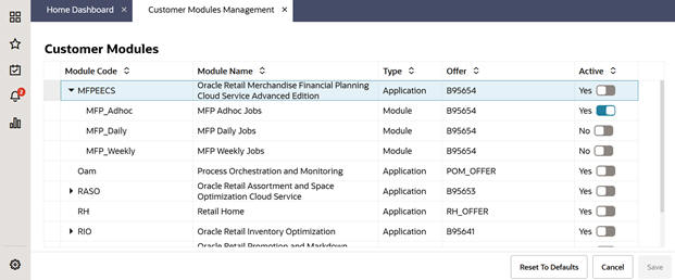

Controlling POM Batch Execution Using Retail Home Customer Module Management
RPASCE Cloud Services provide support for Customer Module Management through Retail Home. Customer Module Management provides a mechanism for customers to see which services they are subscribed to and provides a framework to manage enabling and disabling optional modules for those services.
Figure 8-8 Customer Module Management Page of Retail Home
Description of "Figure 8-8 Customer Module Management Page of Retail Home"
The RPASCE application define three modules for every subscription. These three modules - Daily, Weekly, and Ad Hoc - correspond to the three modules used for specifying POM batch schedules, as described above. Customers who wish to disable the batch jobs defined for one or all of these modules can do so by disabling the module within the Customer Module Management screen of Retail Home.
This can be valuable in cases where a customer wants to avoid running any POM batch activities for a given subscription. For example, a customer who had purchased multiple subscriptions but who is implementing the subscriptions in a phased manner can disable the modules for all RPASCE applications except the initial implementation. When the implementation of the next application begins, the POM batch schedules for that application can then be enabled, and so on.
In order for the changes made through enabling or disabling modules within the Customer Module Management screen to be applied to POM batch schedules, customers must access the POM Batch Administration task and perform the Sync with MDF operation. This will cause POM to query Retail Home for an up-to-date list of modules that are and are not enabled and enable and disable the POM schedules to reflect the status of the enabled modules.
Figure 8-9 POM Batch Administration Screen with Sync with MDF Action
Description of "Figure 8-9 POM Batch Administration Screen with Sync with MDF Action"

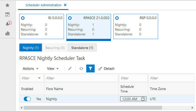

POM Batch Scheduling

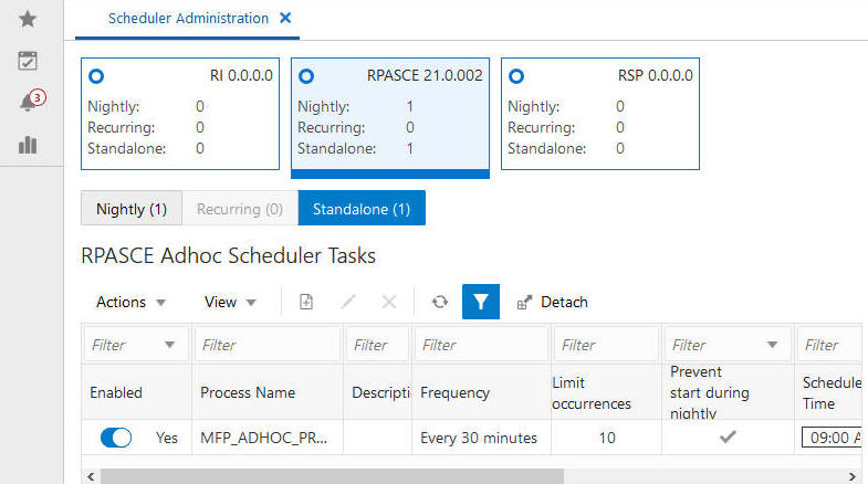

The batch scheduling is done through the Scheduler Administration page. The Nightly batch, shown in Figure 8-10, is run every day, and only the start time can be scheduled. The Standalone batch, shown in Figure 8-11, has more scheduling flexibility, and it is used to schedule the ad-hoc jobs. Both frequency and start time can be specified.

| Field Name | Value | Note |
JobName |
Meaningful job name with underscores ( for example, MFP_DAILY_JOB) |
Description |
Description of the job (for example, MFP daily batch job) |
RmsBatch |
Leave blank |
ScriptFolder |
Leave blank |
RmsWrapper |
Leave blank |
ParameterValue |
solution=#SysOpt.mfpName||batchid={batch_control_set}||loglevel=#SysOpt.logLevel||rpastoday=#JobCtxt.businessDate||exclusive=1 |
The batch control set name must be defined in the batch control file of RPASCE Batch Framework. The parameters are explained in "POM Batch Administration". |
ApplicationName |
Must be one of the pre-defined application names in the spreadsheet (for example, MFP) |
Modules |
Must be one of the pre-defined module names in the spreadsheet (for example, MFP_Daily) |
FixedParameterInd |
Y |
ParameterUpdated |
N |
SkipOnError |
N |
JobType |
RPAS |
Fixed value to indicate RPAS web service is used for this job. |

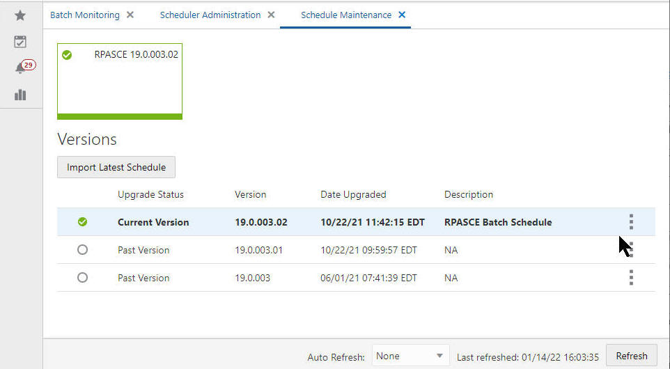

After the custom spreadsheet is ready, it can be imported to the Schedule Maintenance page of the POM website, shown in Figure 8-12.
