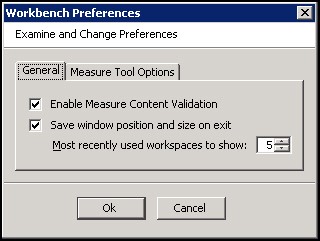

Setting Tools Preferences
Settings made here apply to all configuration projects created or viewed with the tool.
Navigate: From the File menu, select Tools Preferences. The Workbench Preferences window opens.
Perform the following steps to modify the Workbench Preferences.
Select the General tab.
Enable Measure Content Validation – Activating this check box enables the immediate validation of measure properties when configuration measure information is created or modified. This process can impact the performance of the RPASCE Configuration Tools. If this box is not checked, the manual Measure Content Validation icon is enabled on the Rule Definition toolbar. See the Rule Definition Tool for details.
Save window position and size on exit – Activating this check box enables the RPASCE Configuration Tools to be launched in either full or minimized view based on the status in which the configuration administrator last exited the application. If the application is exited in a minimized view, the size of the window is also maintained when the RPASCE Configuration Tools is re-launched.
Most Recently used workspaces to show – Use the up and down arrows to specify the number of configurations to be displayed in the Most Recently Used list displayed in the File menu window. This list allows the configuration administrator easy selection of a recently viewed configuration.

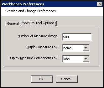

Select the Measure Manager Options tab.
Figure 2-5 Workbook Preferences - Measure Tool Options
Description of "Figure 2-5 Workbook Preferences - Measure Tool Options"-
Number of Measures/Page – Select the number of measures to display per page in the Measure Manager Tool. The default is 500.
Display Measures by – Displays measures either by their name or label in various locations of the Tools. The default setting is name.
Display Measure Components by – Display measure components (in the Measure Manager tool) either by name or by label. The default setting is label.
Click OK to save any changes and close the window.
