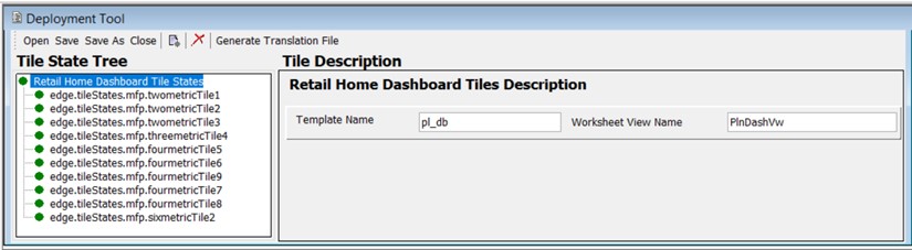

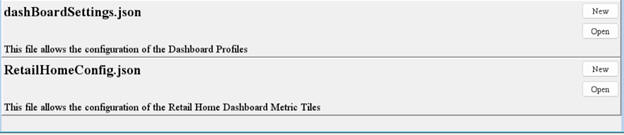

The Deployment Tool supports the creation, inspection and modification of the following RPASCE deployment resources:
  • Dashboard Settings Resource (dashboardSettings.json)
  • Retail Home Dashboard Settings (RetailHomeConfigs.json)
For each of these resources, Dashboard Settings and Retail Home Dashboard Settings, the following functionality is available:

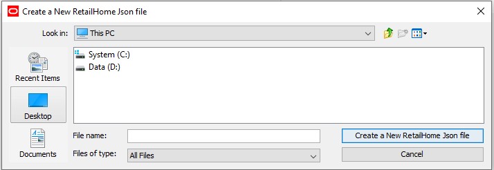

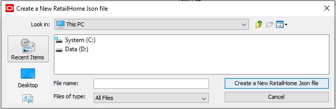

Creation of New Resource
Perform the following steps to create a new resource.

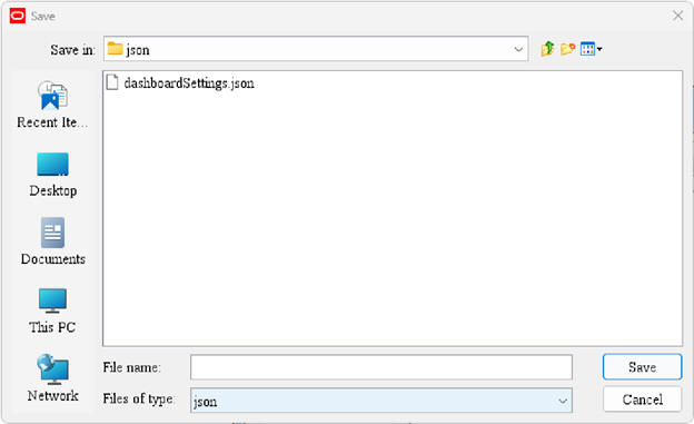

  1. Upon launching the Deployment Tool from the Utilities menu of the Configuration Tool, the user will select to create a new resource of the desired type.
  2. Using the UI controls present in the view designed for the desired resource, the user will enter the information contained within the resource.
  3. The user saves the created resource as a file on the user's local system.
  4. Once saved, the resource must be transferred to the system containing the RPASCE application or upon which the RPASCE application will be created as a manual process. The information can then be applied to the application using the method appropriate for the resource.
Figure 12-1 Saving a New Resource
Description of Figure 12-1 follows
Description of "Figure 12-1 Saving a New Resource"

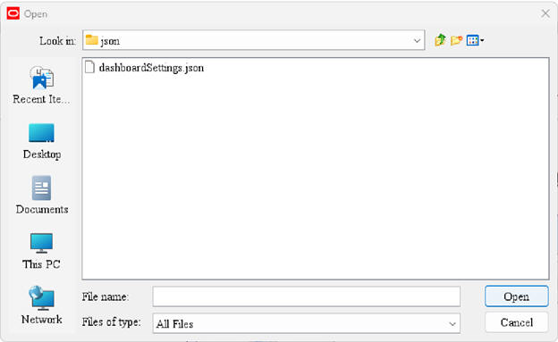

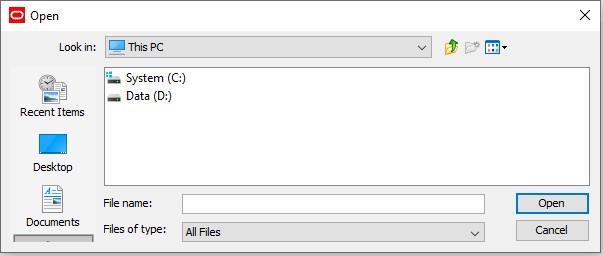

  1. The original resource file must be transferred from the system containing the RPASCE application to the user's local system.
  2. Upon launching the Deployment Tool from the Utilities menu of the Configuration Tool, the user will select to open an existing resource of the desired type. When prompted by the tool, the user will select the file on their local system.
    Figure 12-2 Open Window for Opening an Existing Resource
    Description of Figure 12-2 follows
    Description of "Figure 12-2 Open Window for Opening an Existing Resource"

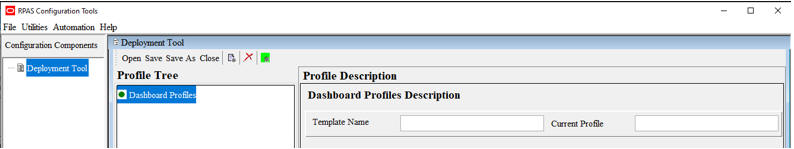

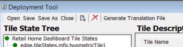

User Interface
The Configuration Tools is extended with an option to open the Deployment Tool. This option is accessed as a menu item in the Utilities menu of the Configuration Tools workbench. Once opened, the Deployment Tool is represented within the Configuration Manager tree to allow users to navigate between it and any other open tools. Selecting the Deployment Tool menu item when the tool is already open will cause the tool to close; if any resource is currently being edited within the tool, the user will be prompted to save this resource before closing.
When first opened, the Deployment Tool presents the user with the set of deployment resources it supports. For each resource, the user can select between creating a new resource and opening an existing resource file.
When a new resource is created or an existing resource is opened, the Deployment Tool changes to present a resource-specific set of UI controls that can be used to specify the information for that specific resource. The user can then modify the resource and upon saving the specified information will be translated into the appropriate format. The functionality of each of these resources is described in detail in the following pages.
Navigate: In the Configuration Tools workbench pane, select Utilities and then Deployment Tool.
Result: The Deployment Tool window opens in the workspace.

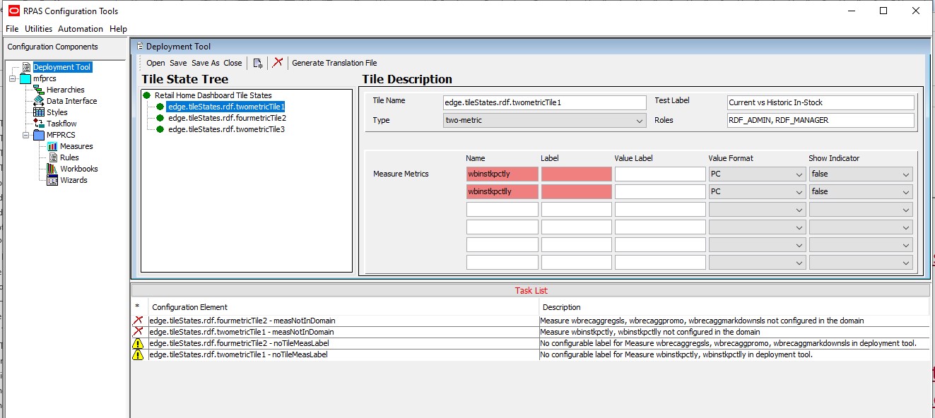

Figure 12-4 Deployment Tool Window
Description of Figure 12-4 follows
Description of "Figure 12-4 Deployment Tool Window"

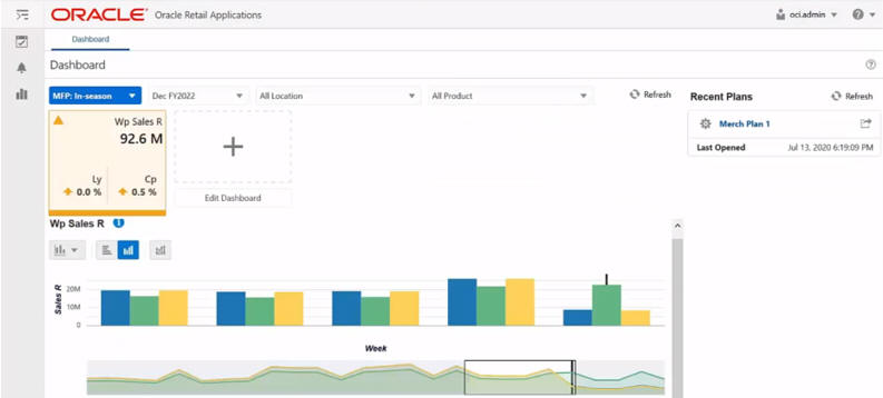

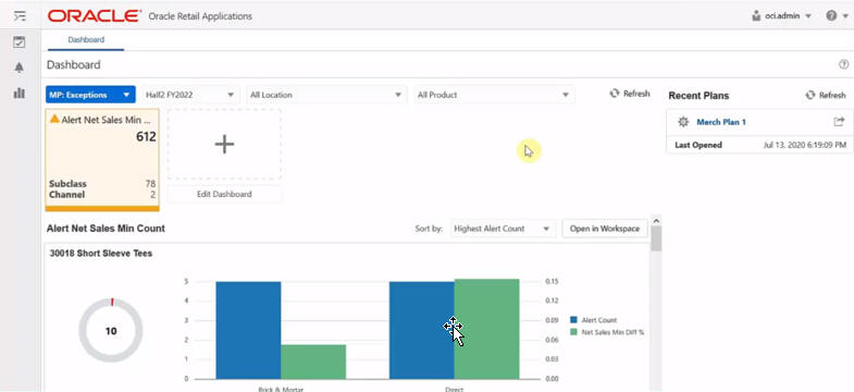

The RPASCE platform contains a home page that users view and interact with when logging into the system. This page is called the Dashbord, and it provides summary information in the form of health-check metrics about a user's plans as well as summary information about exceptions present in that user's area of responsibility.
The Dashboard provides at-a-glance information in order to offer guidance to the user about areas of their information that require attention. This allows users to better organize the time and effort they spend in the application.
Within the system, a Dashboard is a hybrid of a traditional workbook containing the information backing the display and a new view representation consisting of information provided in a set of tiles, each of which can be selected to provide supporting information. The supporting information is presented in charts that display lower-level information about the summary information presented within the tile.
Because the dashboard is a hybrid of traditional RPASCE workbooks and a new visual representation, the process of configuring an RPASCE Dashboard consists of two components. First, a workbook must be configured in the application that defines the data available within the dashboard and how it is created and maintained within that workbook. Second, a resource file that defines the presentation layer configuration that determines how that information is made available in the form of tiles. Their detail charts must be created and deployed to the client tier in a manner like existing taskflow resources.

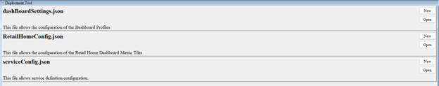

DashboardSettings.json View
The DashboardSettings.json View can be used to create, delete, and modify the contents of a Dashboard Settings file resource using a set of actions represented through buttons, menu items, and text forms. This information is organized around a set of entities that describe the view layer of the Dashboard, such as dashboard profiles and metric and exception tiles.
By representing this information in a user interface, the tool allows users to work with an organized form of the information that can be easily navigated and modified. Then, through the Save action, the information present within the interface can be written out into the appropriately formatted JSON file by the tool, allowing uers to concentrate on the content and allowing the tool to manage the encoding process.
The DashboardSettings.json View can be accessed from the main Deployment Tool screen through the DashboardSettings.json item. Users can either select New to initially create a Dashboard Setting configuration or select Open to load an existing resource.
Figure 12-5 DashboardSettings.json Option in Deployment Tool
Description of Figure 12-5 follows
Description of "Figure 12-5 DashboardSettings.json Option in Deployment Tool"
To access an existing resource, click Open which is located in the upper right-hand corner of the DashboardSettings.json entry. The user is presented with the files saved on their local system.
Once a dashboard settings resource is opened, its contents will be loaded into the DashboardSettings.json View.

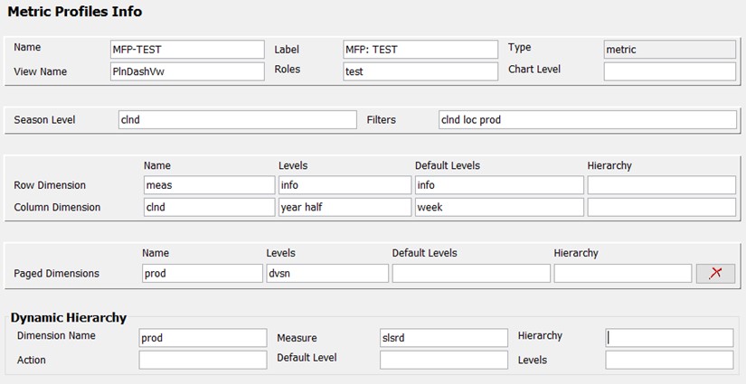

Metric Profile Element
A Metric Profile represents a collection of tiles containing metric information accessible by a user within the Dashboard. Each user typically has access to one or more profiles, depending on that user's role, and each profile aligns with an aspect of their role's responsibility. For example, users of planning applications may have access to both Pre-Season and In-Season Dashboard profiles that contain information about upcoming or current seasons, respectively. Users can select which of the profiles they wish to view through a selector control in the RPASCE Client.
Metric Profiles contain information in the form of tiles that provide summary information about their area of the business. This information often takes the form of Key Product Indicators or other health-check metrics such as actual performance versus performance in prior periods or versus the planned performance.
Metric Profiles contain not only the set of tiles that are associated with that profile but also a set of common information that defines how the Dashboard is presented when that profile is selected.
Figure 12-7 Metric Profile Information in the DashboardSettings.json View
Description of Figure 12-7 follows
Description of "Figure 12-7 Metric Profile Information in the DashboardSettings.json View"
The set of properties defined for a Metric Profile is:
  • Name–an internal identifier for the profile.
  • Label–the user facing label for the profile.
  • Type–the type of profile will be metric. This field is read-only.
  • ViewName–the name of the view configured in the dashboard workbook that supports this profile.
  • ChartLevel–the default level to use in filters for detail charts in this profile.
  • Filters–the whitespace-separated list of dimensions that must be presented as filters in the dashboard when this profile is being displayed. In order to accommodate positions with differing position label lengths, each dimension may optionally provide a width value in the format <dimension>:<length>.
  • Dynamic Hierarchy- used to create hierarchical roll-ups based upon the attribute values of positions.
Additionally, the view contains information describing how to lay out dimensions across the row, column, and page axes of the detail chart. Each profile contains one Row Dimension, one Column Dimension, and as many additional paged dimensions as are needed, based upon the intersection of the view configured in the View Name.
The properties defined for a dimension entry are:
  • Name–the name of the dimension being assigned.
  • Levels–the set of levels in the assigned dimension that must be made available in the chart filter controls.
  • Default Level–the initial level in the dimension that must be selected within the chart filter controls.

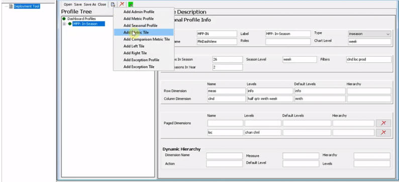

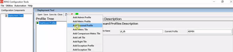

To add a new metric profile to the dashboard settings configuration, click Add Metric Profile action (located under Add) from the toolbar. A new profile entry is added to the navigation pane and selected in the content pane so that its information can be entered.
To remove an existing metric profile from the dashboard settings configuration, select the profile and click Remove from the toolbar. A confirmation window opens.
Click Yes to remove the current metric profile from the configuration.

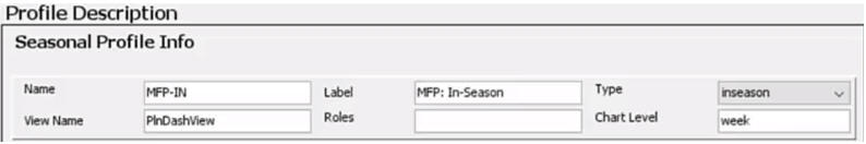

Seasonal Profile Element
The properties defined for a Seasonal Profile are:
  • Type–the type of profile. Supported types include preseason, inseason, and exceptions. Seasonal profiles must use either preseason or inseason from the drop-down field.
  • Num Pos In Season–the number of positions in the seasonLevel that make a season.
  • Num Seasons In Year–the number of seasons in a calendar year. In cases where the product of the numPosInSeason and NumSeasonInYear values does not align with a calendar year, the dashboard will build with a logged warning.
  • Dynamic Hierarchy–used to create hierarchical roll-ups based upon the attribute values of positions.

To add a new metric profile to the dashboard settings configuration, click Add Seasonal Profile (located beneath Add) from the toolbar. A new profile entry is added to the navigation pane and selected in the content pane so that its information can be entered.
Click Yes to remove the current seasonal profile from the configuration.

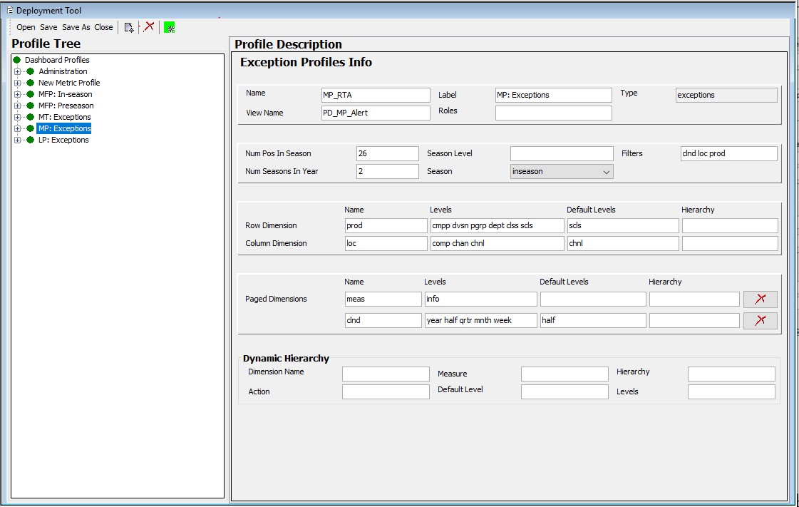

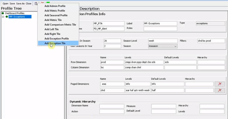

Exception Profile Element

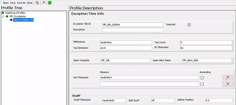

An Exception Profile represents a collection of tiles containing exception information accessible by a user within the Dashboard. As with Metric Profiles, a configuration can contain multiple Exception Profiles, and different users may have access to one or more of the available profiles, based upon their role.
Unlike Metric Profiles, Exception Profiles containing tiles that report on the count and nature of exceptions as defined by the application are intended, in an exception-driven planning model, to provide guidance to the user about what aspects of the business require their time and attention.
Exception Profiles contain not only the set of tiles that are associated with that profile but also a set of common information that defines how the Dashboard as a whole is presented when that profile is selected.
Figure 12-9 Exception Profile Information in the DashboardSettings.jsonView
Description of Figure 12-9 follows
Description of "Figure 12-9 Exception Profile Information in the DashboardSettings.jsonView"
The properties defined for an exception profile are:
  • Label the user-facing label for the profile.
  • Type–the type of profile is exceptions. This is a read-only field.
  • seasonLevel - the level in the calendar dimension used to define a season in conjunction with the numPosInSeason and numSeasonInYear attributes (for example, week)
  • season - the seasonality timeframe that this Exception dashboard profile can show. This season property can be set to either inseason, preseason, or both. If none is specified, then this property defaults to inseason.
  • Filters-the whitespace-separated list of dimensions that must be presented as filters in the dashboard when this profile is being displayed. In order to accommodate positions with differing position label lengths, each dimension may optionally provide a width value in the format <dimension>:<length>.

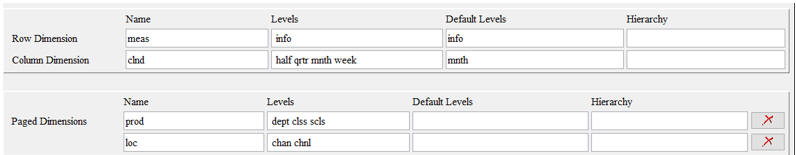

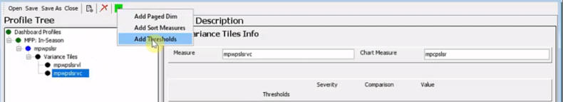

When created, a Dashboard Profile (Metric/Seasonal/Exception) contains no Page Dimension entries. Click Add Page Dimensions (inside the asterisk button from the tool bar) to add entries.
Click Remove (located within the page dimension entry) to remove Page Dimension entries for the Dashboard Profile (Metric/Seasonal/Exception).
Figure 12-10 Page Dimension Entry Showing Remove
Description of Figure 12-10 follows
Description of "Figure 12-10 Page Dimension Entry Showing Remove"
  • Level– the set of levels in the assigned dimension that must be made available in the chart filter controls.
  • Hierarchy–the hierarchy (for dimensions with multiple hierarchies) to be used within the filters of the dashboard.

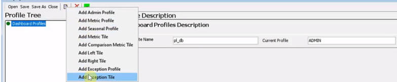

To add a new exception profile to the dashboard settings configuration, click Add Exception Profile (located beneath Add) from the toolbar. A new profile entry is added to the navigation pane and selected in the content pane so that its information can be entered.
To remove an existing exception profile from the dashboard settings configuration, select the profile and click Remove in the toolbar. A confirmation window opens.
Click Yes to remove the current exception profile from the configuration.

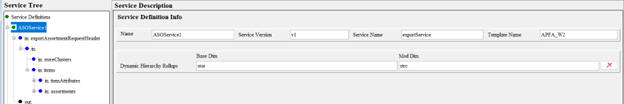

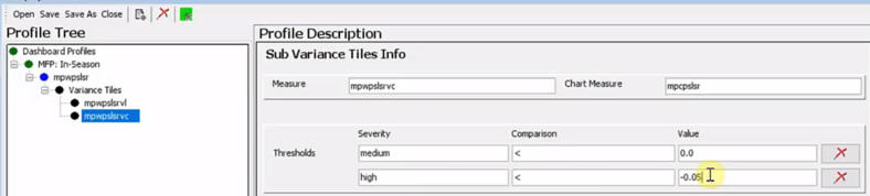

Dynamic Hierarchy Element
Dynamic Hierarchy represents the following information:
  • Dimension Name–this name must match with either of the row, column or paged dimensions. This indicates to which dimension the dynamic hierarchy is linked.
  • Measure–the name of the measure that is meant to hold the user's selection of the attribute to be used in the attribute roll-up.
  • Hierarchy–the hierarchy that contains the attribute roll-up. The dashboard only supports the use of a single hierarchy (for dimensions with multiple hierarchies) within the chart filters.
  • Action–the menuId property of the menu item that performs the dynamic hierarchy operation in the workbook. This value is accessible in both the tmpl.cfg file generated for the dashboard workbook as well as in the .xml file that contains the configuration of the dashboard workbook.
  • Default Level–the default level to display in the filters of the dashboard when the dynamic hierarchy is active.
  • Levels–a JSON array of the levels present within the hierarchy created by the dynamic hierarchy operation.

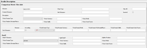

Comparison Metric Tile Element
The properties defined for a Comparison Metric Tile are:
Figure 12-13 Comparison Metric Tile Information in the Dashboard Settings JSON View
Description of Figure 12-13 follows
Description of "Figure 12-13 Comparison Metric Tile Information in the Dashboard Settings JSON View"
  • Measure–the name of the measure that is the primary metric displayed in the tile.
  • Content Measures –an optional list of measures to be used within the supporting chart for this tile. If no value is given, then the measures used in the tile will be displayed within the chart.
  • Chart Type–the type of chart to display for this metric tile. Supported values are bar and line.
  • Sub Measures–an optional list of measures to be displayed underneath the main metric within the tile. Space on the tile constrains the maximum number of subMeasures to three.
  • Inserted–true if the tile must be initially visible in the profile. Users may show and hide available tiles from within the Client.
  • Tiles ID - a string that serves as a unique identifier for the tile. This property can be used when more than one metric tile contains information for a single measure (for example, the same base value with different comparison metrics in each tile). This property is optional; if a value is not provided, the value for measure will be used. However, when multiple tiles use a single measure, the UI may not be able to provide the correct information for things such as tile description.
  • Description - a short description of the information provided by the tile that can be displayed in the tile info Window.
  • Sort Measures–an optional list of measures that can be used to sort the information displayed within the chart. The contents of the sortMeasures array are a list of JSON objects with the following properties:
    • Measure–The name of the measure that is used to order the chart.
    • Ascending–True or false, depending on whether the ordering must be ascending (true) or descending (false).
  • DualY–a JSON object used to support the use of dual-Y axis scales. By specifying the dualY property, it is possible to display a secondary set of values with independent scaling, either within the same chart as other measures or in a secondary chart displaying underneath the primary chart. The properties supported by DualY are:
    • measure – A list of measures to display in a splitY chart.
    • splitDualY– Either on or off. When on, the dualY measures displays in a separate chart. When off, a single chart with two y-axis scales will be displayed.
    • splitterPosition–When splitDualY is set to on, this value will provide the ratio of space on the y axis to be given to each of the displayed charts. Valid values are 0 to 1.
The Comparison Metric Tile element can contain yAxisFormat. For yAxisFormat properties, see "Configuring the Unit of Measurement Display in Dashboards".
To add a new comparison metric tile to the current metric profile, click Add Comparison Metric Tile (located beneath Add) in the toolbar. A new tile entry is added to the navigation pane and selected in the content pane so that its information can be entered.
To remove an existing comparison metric tile from the dashboard settings configuration, select the tile and click Remove in the toolbar.
The confirmation window opens.
Click Yes to remove the comparison metric tile from the configuration.

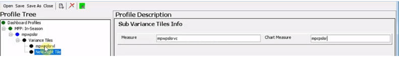

Within the Sub Variance Tiles Info panel is located the Thresholds entity. It has the following three fields:
  • Severity–sets the severity level to high, medium or low based on the severity
  • Comparison–sets the comparison operators (‘>', ‘<', ‘=')
  • Value–sets the severity value
Thresholds entry can be removed by clicking the Remove button () located within each threshold's entry.
The properties defined for a Left Variance or Right Variance element are:
  • Measure–the measure containing the value to display in the tile and use for the evaluation of thresholds.
  • Plan–a short label to identify the supporting value in the tile.
  • Chart Measure–the measure whose data should be displayed within the detail chart for this tile when it is selected.

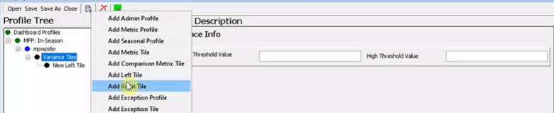

To add a supporting metric to a tile, select the tile's variance element and click either Add Left Tile or Add Right Tile (located beneath Add) in the toolbar (to create an entry for the left or right slots, respectively). A new left or right variance element is added to the navigation pane and selected in the content pane so that its information can be entered.
To remove an existing left or right variance element from the configuration, select the element and click Remove in the toolbar. A confirmation window opens.
Click Yes to remove the selected left or right variance element from the configuration.

Example 1: Creating a Dashboard Seasonal Profile
The process for creating Metric and Seasonal Profiles are very similar. This example describes the creation of a seasonal profile, including the definition of one metric tile within that profile. Starting from an (nearly) empty file, each step of the profile creation process using the Configuration Deployment Tool is described.
Creating a Seasonal Profile
From the Configurator, select New to initially create a Dashboard Setting Configuration or select Open to load an existing resource and then delete the content of that resource in order to create the blank one. Figure 12-17 shows a blank Dashboard Setting Configuration.
Figure 12-17 Blank Dashboard Setting Configuration
Description of Figure 12-17 follows
Description of "Figure 12-17 Blank Dashboard Setting Configuration"
Next, create a new Seasonal Profile, shown in Figure 12-18.
Figure 12-19 shows an In-Season profile created with the name MFP-IN and the label MFP: In-Season to match. The view to be displayed in the Dashboard workbook has a View Name of PlnDashView. This profile is available to all MFP application users and is not restricted to a particular single role, so the Roles field is left blank. In order to restrict the profile view to MFP planners only, the Roles field must be filled with the role of MFP planners’ user group. The level to be displayed in the charts for the time series is the week level, so the value of week is entered into the Chart Level field. Data is most commonly viewed as a time series at week level.
Figure 12-19 Profile Description
Description of Figure 12-19 follows
Description of "Figure 12-19 Profile Description"
Because the Seasonal Profile is selected, the dashboard will draw a time horizon based on seasonality. Two fields must be configured. Seasonal type can be either the current period (InSeason type) or in the coming period (PreSeason type). In Figure 12-19, the Configurator selected the Inseason type. The season must be defined, as shown in Figure 12-20 The configuration divides a fiscal year into two seasons in which each season has 26 weeks. The filters available at the top of the Dashboard UI are clnd loc prod for a standard three-dimensional Dashboard workbook.
Next, define how to lay out dimensions across the row, column, and page axis of the detail chart in the Dashboard view. Each profile contains one row dimension, one column dimension, and as many additional paged dimensions as needed, based upon the intersection of the view configured in the View Name field. In Figure 12-21, Row Dimension is at meas dimension and info is the default level. If no levels are specified, the lowest level will be used as the default for the display. The Hierarchy field was originally designed to tell the Dashboard which branch the branch hierarchy to use; however, the Dashboard can now determine this automatically, and this field is often left blank.
Since this is a seasonal profile, the Column Dimension field is set to clnd to display calendar on the x-Axis in order to see time series. The Levels field is used to determine at which levels the dashboard displays the data inside the chart. In Figure 12-21, there are four level options available: half, qrtr, mnth, and week. To see aggregated data for the default level, enter mnth.
Next, configure the dimensions Product and Location. They are configured as page dimensions. Since by default there is only one Paged Dimension object in the blank profile, a second Paged Dimension object is added. The Default Levels fields are left blank, which means the lowest level specified in the Levels field will be used as the default.
Figure 12-21 Configure Dimensions
Description of Figure 12-21 follows
Description of "Figure 12-21 Configure Dimensions"
This seasonal profile does not use dynamic hierarchy, so the Dynamic Hierarchy fields are left blank. If dynamic hierarchy is used, values must be entered into the Dynamic Hierarchy fields. Users must enter the name of dimension affected by the dynamic hierarchy into the Dimension Name field, the measure containing the information for setting up the dynamic hierarchy mapping into the Measure field, the hierarchy that representing the branch inside the dimension that uses the dynamic hierarchy, the menu ID of the menu item into the Action field, the Default Levels, and Levels. See Seasonal Profile Element for details.

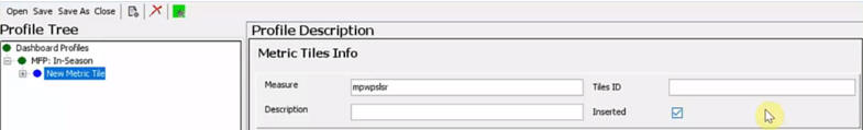

Creating a Metric Tile
Next, right click the MFP: In-Season profile and select Add Metric Tile to add a new metric tile, as shown in Figure 12-22.
Figure 12-22 Create Metric Tile
Description of Figure 12-22 follows
Description of "Figure 12-22 Create Metric Tile"
In the Metric Tile Info interface shown in Figure 12-23, enter the name of measure for the tile. If the dashboard is to be used in a Retail Home implementation, the tile must be uniquely identified and the Tiles ID field requires a unique name, since more than one tile may reference the same measure. However, since this is not the case in the current example, the Tiles ID field is left blank. The Inserted check box is selected, indicating that this tile is visible by default in the Dashboard UI and no editing for setting visible tiles is required.
Next, add additional metrics for the tile. Click the + sign next to the new metric tile to display the Variance Tiles menu item and select it to add the variance tile. Supplement the main metric tile by adding a left tile and a right tile.
The left tile is used to compare the current year sales with the last year sales. The measure name mpwpslsvl shown in Figure 12-25 is the variance of the current year sales in comparison to last year sales; that is the value shown in the tile itself. The measure that holds the historical sales data will be visible inside the chart.
The right tile, shown in Figure 12-26, displays the comparison to the current plan. As before, the measure appearing in the tile is the actual variance itself (mpwpslsrvs), but inside the chart, the metric that holds current sales data mpcpslsr is displayed.
The final step is specifying the thresholds. Thresholds can be specified for either the left tile or the right tile. In Figure 12-27, the right tile has two thresholds, one medium and the other severe or high, for the variance to the current plan. Right click the right tile (mpwpslsrvc tile) shown in Figure 12-27, then click Add Thresholds to add one threshold. Repeat this step to add the second threshold.
Figure 12-27 Specify Thresholds
Description of Figure 12-27 follows
Description of "Figure 12-27 Specify Thresholds"
The first threshold is a medium threshold. If sales do not perform to the plan, the variance is less than 0, and the Dashboard UI flags it as medium error. The badge inside the tile on Dashboard UI will show that it is not performing up to the current plan.
The second threshold is a high threshold. If the variance is more than five percent less than the plan, then it is flagged as a high error. The red badge in the UI indicates this, as shown in Figure 12-28.
The results of the Dashboard Seasonal Profile configuration are shown in Figure 12-29.
Figure 12-29 Dashboard UI for the MFP In-Season Profile
Description of Figure 12-29 follows
Description of "Figure 12-29 Dashboard UI for the MFP In-Season Profile"

Creating an Exception Profile
As in Example 1: Creating a Dashboard Seasonal Profile, starting from an (nearly) empty file, this example describes the steps to create the exception profile. For greater detail regarding the components used, see Example 1.
Figure 12-30 Add Exception Tile
Description of Figure 12-30 follows
Description of "Figure 12-30 Add Exception Tile"
Complete the fields in the Exception Profiles Info interface as described in this section. The Type field is pre-populated with exceptions. A view name, profile name, and profile label are provided. The Roles field is left blank so that the Dashboard profile view is available for all users of the application.
The standard, two half seasons with 26 weeks within each season, is configured. A fiscal year contains two seasons. The filters used to range data in the Dashboard UI contain clnd loc prod. The Exception Profile supports performing exception-based processes in pre-season planning. Users can select the inseason, pre-season, or both as the season type. As in the Seasonal Metric Profile, if inseason is selected, the Dashboard will center itself in the time period containing today. If preseason is selected, it will determine which period today is in and will center on the upcoming time period so that users can resolve exceptions in the preseason planning.
The Product dimension is configured as the Row Dimension and Location as the Column Dimension. That means that the exceptions are first grouped by product, then further grouped by location. The Levels contain levels available in Filters that users can range down. As in the Metric Profile, the hierarchy field is usually left blank since the Dashboard can determine the value.
The paged dimensions have two dimensions, one at meas and the other at clnd. The default level is at dimension half, a higher level, so that users can drill down the data to lower levels defined within the Levels field.
This configured Exception profile does not use the Dynamic Hierarchy feature. If the Dynamic Hierarchy is used, then the corresponding information must be entered.
Creating an Exception Tile
Right click the MP:Exception profile and select Add Exception Tile from the drop-down list, as shown in Figure 12-31.
Figure 12-31 Adding an Exception Tile
Description of Figure 12-31 follows
Description of "Figure 12-31 Adding an Exception Tile"

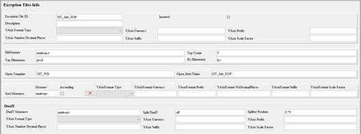

The alert of interest in is the Min Sales count. Enter the corresponding information is entered into the Exception Tiles Info interface. See Exception Profile Element for a detailed explanation of each component.
To begin, an explicit Tile ID is required for every Exception Tile (but not necessarily for a Metric Tile). The Inserted check box is selected by default so that this tile is visible in the Dashboard UI.
The HitMeasure field has the measure name mpalnslscn, indicating the measure containing the exception hit count information for the tile. The Top Dimension entered is the Product dimension, and By Dimension is Location dimension. The Top Dimension and By Dimension override the settings in the profiles if they are different. Note that in the example, these two settings are the same. The TopCount is set to 5 so that when users view the alert hits by product and location dimensions, they will start out with the top five products in the RPASCE UI display.
Next, configure the ability to launch out of the Dashboard into the workbook in order to resolve exceptions displayed in the tile. Enter the workbook template to be launched into the Open Template. Enter the real time alert name into the Open Alert Name.
In addition to simply ranking the display based on those products that have the most alert hits, users can also use Sort Measures to group data based on the metric values. In this example, the check box for Ascending is deselected for the first sort measure, so the data is sorted in descending order.
The DualY section is optional. Once configured, it is used to display a secondary metric inside the chart when the user is looking at the information. The DualY section contains an optional configuration to display alert hits on a different scale via a split DualY. With Split DualY, instead of one chart, users see a distinct, secondary chart that stacks on the other in the RPASCE UI display. In this example, the Split DualY is not used, and the field contains off and Splitter Position 0.0.
Figure 12-32 Exception Tile Info
Description of Figure 12-32 follows
Description of "Figure 12-32 Exception Tile Info"
Dashboard Exception Profile Instance in the RPASCE UI
Figure 12-33 shows the Dashboard instance in the RPASCE UI. In the MP: Exceptions profile, users can view the exception Tile, the Location, Product and the optional levels within each hierarchy. Users can launch the workbook from the Open in Workspace option. The Sort By option contains an additional sorting metric specified by the Sort Measure configuration. Alert hits are broken out first by product, then by location dimension. The second metric Net Sales Min Diff % plugged into the DualY configuration is also in the chart. There is one range for the alert hit and a second range for the diff percentage.
Figure 12-33 Dashboard Instance
Description of Figure 12-33 follows
Description of "Figure 12-33 Dashboard Instance"

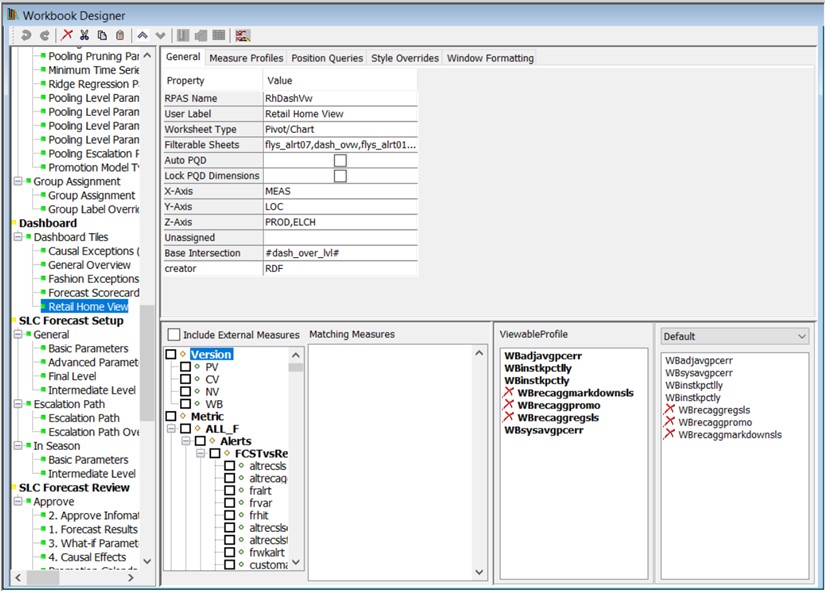

    Figure 12-34 Retail Home Worksheet Added to the Regular Dashboard Workbook
    Description of Figure 12-34 follows
    Description of "Figure 12-34 Retail Home Worksheet Added to the Regular Dashboard Workbook"
  2. Create the Retail Home configuration file resource.
    This file resource, often called the Retail Home Dashboard Settings file, is a JSON encoded text document that contains information about the dashboard tile states and their tiles that is used by the client to organize and present the data contained within the dashboard workbook. The Deployment Tool contains an interface for the creation of the content of the Retail Home Dashboard Settings resource. Using this tool, the person performing the configuration can interact with a graphical user interface that is similar to other Configuration Tools-based interfaces and the tool will generate the appropriate JSON file content. Like other Configuration Tools interfaces, this allows the people performing the configuration to focus on what information they want to present in the configuration (as defined in terms of measures, RPASCE views, and so on) and let the tool manage the generation of the appropriate file resources.
RetailHomeConfig.json View
The RetailHomeConifgs.json View can be used to create, delete, and modify the contents of a Retail Home Dashboard Settings file resource using a set of actions represented through buttons, menu items, and text forms. This information is organized around a set of entities that describe the view layer of the Retail Home Dashboard, such as dashboard tile states and metric tiles.
By representing this information in a user interface, the tool allows users to work with an organized form of the information that can be easily navigated and modified. Then, through the Save action, the information present within the interface can be written into the appropriately formatted JSON file by the tool, allowing users to concentrate on the content and allowing the tool to manage the encoding process.
The RetailHomeConfig.json View can be accessed from the main Deployment Tool screen through the RetailHomeConfig.json item.
Figure 12-35 RetailHomeConfig.json View
Description of Figure 12-35 follows
Description of "Figure 12-35 RetailHomeConfig.json View"
RetailHomeConfig.json Option in Deployment Tool
To access an existing resource, the user selects Open, located in the upper right-hand corner of the RetailHomeConfig.json entry. The user is presented with the files saved on the local system. The user can also use the New action to create a new Retail Home Dashboard Settings resource. Select New and the following window displays. The user can specify the name of the Retail Home JSON file. If the file name does not end with a .json suffix, Tools will add it automatically.
Figure 12-36 Create a New RetailHome JSON File Window
Description of Figure 12-36 follows
Description of "Figure 12-36 Create a New RetailHome JSON File Window"
Once a dashboard settings resource opens, its contents are loaded into the RetailHomeConfig.json View.
Figure 12-37 RetailHomeConfig.json View with Loaded Resource
Description of Figure 12-37 follows
Description of "Figure 12-37 RetailHomeConfig.json View with Loaded Resource"
Within the RetailHomeConfig.json view, users are presented with a navigation pane on the left, containing a tree structure of the entities making up a Retail Home dashboard settings configuration such as dashboard tilestates and the tiles they contain. When an entity is selected within the navigation pane, its information is loaded into the content pane on the right. This allows users to view and modify that entity's information. Metric tiles can be created and deleted through actions present on the top toolbar.

The tree root on the left side of the Navigation pane defines the template name, worksheet view name, and the tileStates.
Example Template and Worksheet Configuration for Retail Home Dashboard
Figure 12-38 Example Template and Worksheet Configuration for Retail Home Dashboard
Description of Figure 12-38 follows
Description of "Figure 12-38 Example Template and Worksheet Configuration for Retail Home Dashboard"

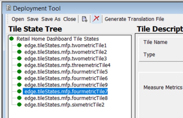

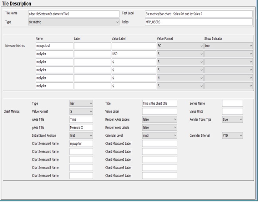

Metric Tile Definition
The Tilestates can contain one or more metric tile objects that are displayed in the right-side Tile Description pane.
The set of properties defined for a Metric Tile is:
  • name – A required property. It is the tile ID, string identifier. This must be unique across all the metric tiles.
  • type – A required property, indicating metric tile type. It must be two-metric, four-metric, or six-metric. Two-metric means one to two measures, and no chart. Four-metric means one to four measures and an optional chart. Six-metric means one to six measures and an optional chart. In brief, the only difference between the 4-metric type and the 6-metric type is that 6-metric displays up to six measures and 4-metric shows only the first four.
  • testLabel – A required property. Title of the tile. Used only in the test harness. In Retail Home it is the application name (same for all tiles in the application).
  • roles – A required property. A list of role names separated with a comma whose users are authorized to see this tile in Retail Home. Not used in the test harness.
  • measures – A required property. A list of JSON array objects. A list of one or more measure metrics to be displayed in the tile. Specify one to two measures for two-metric, one to four measures for four-metric, and one to six measures for six-metric.
  • chart – An optional property. An object defining a chart to be displayed underneath the metrics. The chart is only displayed in four- and six-metric tiles.
Here is an example of the JSON format illustration of a metric tile.
"name": "tile1",
            "type": "four-metric",
            "testLabel": "Four metrics/area chart - Sales Rvl and Ly Sales R",
            "roles":"MFP_PLANNERS, MFP_USERS",
            "measures": [ ... ],
            "chart": { ... }
Users can add or delete a metric tile using the top menu item.
Figure 12-40 Add or Delete a Metric Tile
Description of Figure 12-40 follows
Description of "Figure 12-40 Add or Delete a Metric Tile"
To add a new metric tile to the Retail Home dashboard settings configuration, highlight a Metric Tile in the left navigation pane, click Add New Node (located beneath Add) from the toolbar. A new tile entry is added to the navigation pane and selected in the content pane so that its information can be entered.
To remove an existing metric pane from the Retail Home dashboard settings configuration, select the tile and click Remove from the toolbar. The confirmation window opens. Click Yes to confirm.

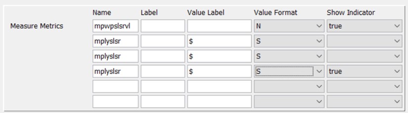

Measure Metrics Definition
The Measure Metrics section can contain multiple Measure objects. The properties defined for a Measure object are:
  • name - A required property. The RPASCE name of the measure. No extended measure.
  • Label - An optional property for the measure label override. If not specified, the RPASCE measure label will be used. If MultiSolutionBundle.properties has a resource key entry called <tile-id>.<measure-name>.retailhome.measure.label then that is used. In other words, measure labels can be localized for retail home purposes. See “Generate Translation File" section for details about the translation of labels.
  • valueLabel - An optional property. An additional label to display underneath the measure value.
  • valueFormat - An optional property for measure value Format. The drop-down list contains blank, PC, S, and N. These represent: PC - Percent (.01 = 1%), S - Short (1000 = 1K), N - Number (1000 = 1,000).
  • showIndicator - An optional property. True or False. By default, this property is false. This flag controls whether the up or the down icon is displayed in the dashboard.
Here is the JSON format for one Measure object.
                "name": "mplyslsr",
                "label": "Measure Label Override",
                "valueLabel": "$",
                "valueFormat": "S",
                "showIndicator": "true"
Here is an example of an array of tile measure objects. Note that some optional properties are not specified for certain tile measures.
"measures": [
          "name": "mpwpslsrvl",
          "valueFormat": "N"
          "name": "mplyslsr",
          "valueLabel": "$",
          "valueFormat": "S"
          "name": "mplyslsr",
          "valueLabel": "$",
          "valueFormat": "S"
Figure 12-41 shows the measure definition section in the content pane.
Figure 12-41 Measure Metrics Section Example
Description of Figure 12-41 follows
Description of "Figure 12-41 Measure Metrics Section Example "
You can select the optional Value Format and Show Indicator from their lists.

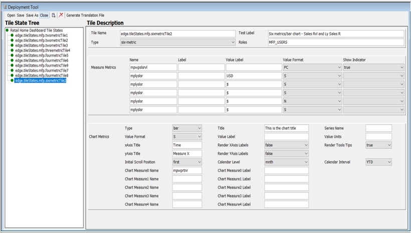

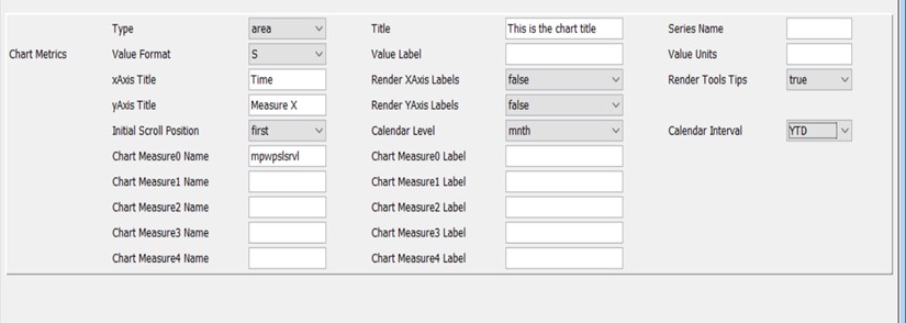

Chart
The Chart metrics is an optional JSON object used with four-metric and six-metric types only. If no chart is configured for the Retail Home Dashboard Settings, all fields in the Chart section must be left blank.
Figure 12-42 Chart Metrics Section
Description of Figure 12-42 follows
Description of "Figure 12-42 Chart Metrics Section"
The properties defined for a Chart object are:
  • chartType - A required property. Values include line, bar, area, or total.
  • measures - A required property. An array of chart measure objects. One or more measures to plot in the chart. Only one measure is supported for line/bar/area charts. These charts display the measure's values over the weeks or months before the current date, from the current year.
  • Totals chart is unique. You must specify at least two measures. The totals chart shows the values of the measures rolled up across all time, side by side in the horizontal bar. The maximum number of chart measures that can be specified is five. See next section for a discussion of the measure object format.
  • title - An optional property. The title displays above the chart.
  • renderTooltips - Optional. Hide or show tooltips on the chart. Default is true.
  • seriesName - Optional. True or False. By default, this property is false. This flag controls whether the up or the down icon is displayed in the Label for the tooltip. Applies to line, bar, and area charts.
  • valueFormat - Optional. Formats the output of values in the chart. Takes the same values as metrics items.
  • valueLabel - Optional. Prefix for values. Applies to total charts only.
  • valueUnits - Optional. Suffix for values. Applies to total charts only.
  • xAxisTitle - Optional. Label for the x-axis. Applies to line, bar, and area charts.
  • renderXAxisLabels - Optional. Default is false. Show or hide tick labels on the x-axis. Applies to line, bar, and area charts.
  • yAxisTitle - Optional. Label for the y-axis. Applies to line, bar, and area charts.
  • renderYAxisLabels - Optional. Default is false. Show or hide tick labels on the y-axis. Applies to line, bar, and area charts.
  • initialScrollPosition - Optional. The end of the chart to start at if there are too many items to show at once. Options are first and last. Default is first. Applies to line, bar, and area charts.
  • calendarLevel - Required if the Chart metric is configured. Defaults to the level name corresponding to month. (In MFP it is MNTH, for example). Users can select week or mnth from the drop-down list.
  • calendarInterval - Required if the Chart metric is configured. Currently, only YTD is supported.

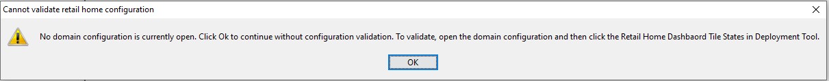

To validate Retail Home Dashboard Settings with its application configuration, open the application configuration first in the Configuration Tools before clicking the Open or New button in the Retail Home View of the Deployment Tool. Otherwise, a window will display to warn the User.
Figure 12-43 Cannot Validate Retail Home Configuration Window
Description of Figure 12-43 follows
Description of "Figure 12-43 Cannot Validate Retail Home Configuration Window"

Note that, as for all other tools TaskList error/warning messages in general, users can still save the Retail Home Dashboard Settings before the validation Tasklist error/warnings are completely resolved.
Figure 12-46 Retail Home Dashboard Settings Validation Errors and Warnings
Description of Figure 12-46 follows
Description of "Figure 12-46 Retail Home Dashboard Settings Validation Errors and Warnings "

The Retail Home Dashboard Configuration tool provides a menu button Generate Translation File in the upper right menu to pull translation labels from the Retail Home Dashboard Configuration. This button must only be used when any change to the RetailHomeConfig.json has been made and saved. Click this button to generate a base resource file called RHResources.properties. This file is generated within the same directory where the RetailHomeConfig.json file is stored. The resource file RHResources.properties can be translated into various languages/locales and accessed at run-time by the Retail Home web service through the Java ResourceBundle APIs.
Figure 12-47 Generate Translation File Menu Button
Description of Figure 12-47 follows
Description of "Figure 12-47 Generate Translation File Menu Button"

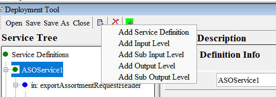

Figure 12-48 Custom Menu Arguments
This image shows custom menu arguments.
The customer menus, Export to ASO and Request to ASO, contain the service definitions #ASOService1 and #ASOService2, respectively, for the web service calls between AP and ASO.
As a general requirement, the web service expects the data to be passed in a structured way.
The content used for one web service call is defined in one service definition, for example, ASOService1. One service definition contains the web service name, input, and output information. Users must define them in the Service Config Tool.

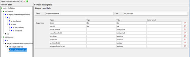

The service definition resource, often called the “Service Config Definitions” file, is usually named as “serviceConfig.json”. It is a JSON encoded text document that contains information about the service config definitions, their input and output argument levels, and the items within each level. The Service Config Settings Tool allows users to graphically configure and validate it against the application configuration. The serviceConfig.json is then stored in PDS during deployment and processed by PL/SQL.

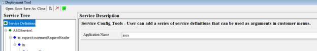

ServiceConfig.json View
The ServiceConfig.json view can be used to create, delete, and modify the contents of all service definitions within one application. Each application can only have one serviceConfig.json file. This tool can be accessed from the main Deployment Tool screen through the serviceConfig.json item. Users can either select New to initially create a Service Setting configuration or select Open to load an existing resource.
To validate against the application configuration where the custom menu is to be defined, open that application configuration first before working in the Service Config Tool.
Figure 12-49 Service Config Tool
This image shows service config tool.
Once a Service Config resource is opened, its contents will be loaded into the serviceConfig.json View.
Figure 12-50 ServiceConfig.json View with Loaded Resource
This image sows serviceconfig.json view with loaded resource.
Within the serviceConfig.json view, users are presented with a navigation pane on the left, containing a tree structure of the entities making up a service settings configuration, such as service definition and the levels and sub-levels they contain. When an entity is selected within the navigation pane, its information is loaded into the content pane on the right. This allows users to view and modify that entity's information. Definitions and levels can be created and deleted through actions present on the top toolbar.
ServiceConfig.json Resource Contents
The following elements make up the contents and are described in these sections:

Note: Users can use the menu button and the asterisk to dynamically add new various components. Users must highlight the right component in the left tree structure first before right-clicking the menu buttons.
Figure 12-51 Adding a New Tree Node in Left Service Tree
This image shows new tree node.

Service Definitions Element
This is the root node of the Service Tree. Users must enter the name of application into the Application Name field. Without it, the Service Config tool cannot validate the measures or dimensions entered against the application configuration where the custom menu refers these service definitions.
Figure 12-53 Service Definitions Root
This image shows service definitions root.
Service Definition Element
A service definition represents a collection of components containing the web service information and the top-level components.
Figure 12-54 ASO Service1 Service Definition
This image shows the ASO service1 service definition.
The set of properties defined for a service definition is:
  • Name – an identifier for the definition, used in the custom menu argument.
  • Service Version – the version in the web service URL to be constructed (for example, v1).
  • Service Name - the actual name of this service (for example, exportService). The RPASCE server constructs the final web service URL by appending “v1/exportService” to the base URL retrieved elsewhere.
  • Template Name – the name of the workbook template where the custom menu using this service is configured.
  • Dynamic Hierarchy Rollups – Optional element. If the workbook contains a dynamic hierarchy and the users want to send data on those levels,the users must configure the Base Dim and Modified Dim of that dynamic hierarchy.
  • Input Items – Optional element. The root input items. The data is scalar and does not have a level. See the Input Item section for more details.
  • Output Items – Optional element. The top output items. The data is scalar and does not have a level. See the Output Item section for more details.

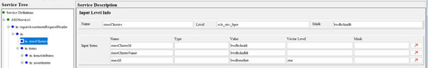

Input Level Element
An Input Level element represents a collection of input data arguments at a specific level. One input level can contain a sub-level, and a sub-level can contain other sub-levels, and so on. Given that RPASCE measure has a limitation on the number of dimensionalities, the nesting depth is not unlimited. These embedded levels provide better grouping of the data. For example, if the service top input level is at SCLS, its sub-level can be at MNTH_SCLS, and the third level input level can be configured at MNTH_SCLS_STOR.
The input items are optional components here. Users can add multiple input items by right-clicking the top menu button to add one input item at a time.
Figure 12-55 Input Level Element
This image shows input level element.
Here is a list of the properties defined for an input level element:
  • Name – an identifier for this input level (for example, exportAssortmentRequestHeader),
  • Level – the intersection for this input level, which must be an intersection name (for example, SKU_, SKU_STOR).
  • Mask – Optional. The measure name of the mask for this input level.
  • Input Items – Optional element. The input data items at this input level. See the Input Item section for more details.

Figure 12-56 Output Level Element
This image show output level element
Here is a list of the properties defined for an Output Level element:
  • Name – an identifier for this output level. This field can be left empty
  • Level – the intersection for this output level, which must be an intersection name (for example, SKU_, SKU_STOR, USER).
  • Output Items – Optional element. The output data items at this output level. See the Output Items section for more details.
