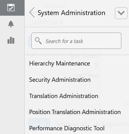

To access the Hierarchy Maintenance Wizard:

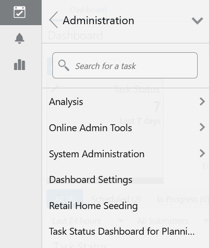

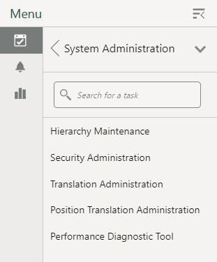

                           On the main page, click Tasks, then select Administration. The Administration group appears.
                           In the Administration group, select System Administration.

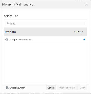

                           In the System Administration group, select Hierarchy Maintenance. A plan dialog box appears.

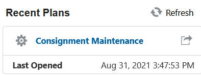

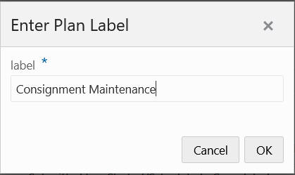

                           Click Create New Plan to create a new segment. If it is the first segment, the dialog box for entering the label will appear. Otherwise, click Create New Plan, as shown in Figure 4-4, to enter the label for the new segment.
                           Provide a label for the segment.

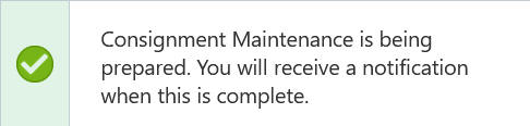

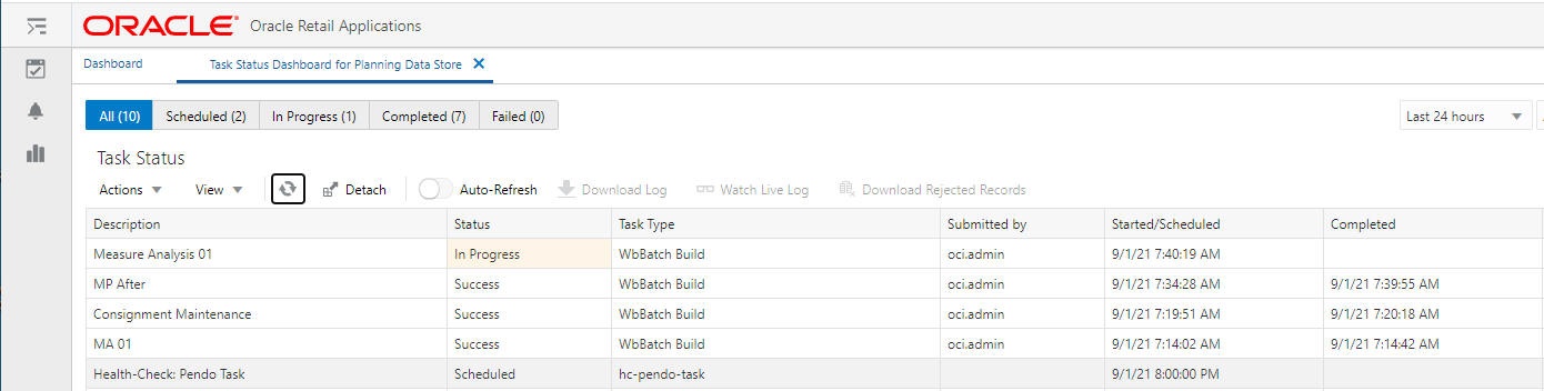

                           The RPASCE server processes the request. Upon completion, a notification will be sent to the user interface, as shown in Figure 4-6 and a link to open the segment will be available in the Recent Plans box, shown in Figure 4-7.
                           Click the link to open the segment.

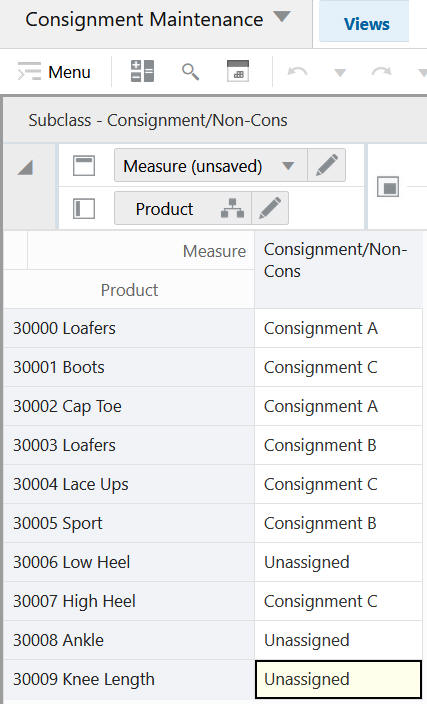

The Hierarchy Maintenance view displays the position assignment fields for the selected custom dimension. Edit the cells associated with the custom dimension as required.

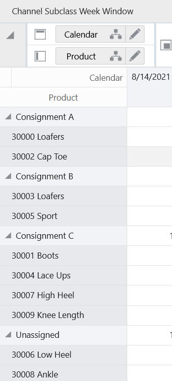

Returning to the example dimension Consignment: You want to classify each selected subclass in your segment as either a Consignment A, a Consignment B, or a Consignment C. This example provides only three positions, or values, in the Consignment dimension; however, you can enter any character string in an individual subclass's Consignment cell. This new string is treated as a separate user-defined grouping. If this is the first time a particular subclass has been mapped to the Consignment dimension, the label assigned to that subclass will not yet be defined. The Consignment field is automatically filled with "Unassigned."
Assign labels to each product with regard to the Consignment dimension. In the following example, products that were previously Unassigned are now designated as Consignment A, B, or C.
The RPASCE system is case sensitive when a new position label is entered in the Hierarchy Maintenance segment. After the segment is committed, the typing of the group name is not case sensitive. For example, Consignment B can later be entered as consignment b after the Consignment B group label has been committed.
After making the Consignment A, Consignment B, or Consignment C designations for the selected subclasses, you must calculate and commit the segment for any changes to take effect.
For this example, labels have now been assigned to the various positions within the Consignment/Non-Cons dimension, and selected products in the product hierarchy have been classified with regard to the custom dimension.
Figure 4-9 displays the results when you access a quick menu in a wizard and change the rollup to the Consignment/Non-Cons dimension. The products shown here are classified according to the position values (Consignment A, Consignment B, or Consignment C) that were assigned while maintaining the Consignment/Non-Cons dimension.
Figure 4-9 Consignment/Non-Cons Dimension Results

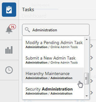

                           In the taskflow, select Administration. The Administration activity appears with all the subtasks.
                           Click Hierarchy Maintenance.
                              Click System Administration.
                              Click Security Administration.

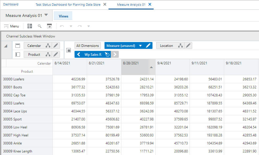

Measure Analysis Workbook
The Measure Analysis view allows the user to view specific measure data for the positions selected from the measure's associated hierarchies. Each Measure Analysis view is displayed at a different intersection, depending on the measure selections made in the wizard. This intersection is shown in the view title bar.
Although a common use of the Measure Analysis workbook is to view actual sales data, the workbook is not restricted to presenting sales data alone. The user can view any data loaded into the RPASCE master database, such as selling prices, shipments, and orders. The Measure Analysis Wizard provides a list of all stored measures that have an insertable measure property set to true. The user simply chooses the measures to be displayed in the new workbook.
Measure Analysis View
The Measure Analysis view allows the user to view the chosen measure data for the positions selected from the measure's associated hierarchies. Each Measure Analysis view is displayed at a different dimensional intersection, depending on the measure selections made in the wizard. This dimensional intersection is shown in the view title bar.
Figure 4-15 shows a Measure Analysis view that displays Sales data for several items in a particular store. The location/product/calendar dimensional intersection of this view, as shown in the title bar, is SubClass, Channel, WEEK. The Sales measure, because it is registered as a read/write measure, can be edited in this view. However, only an administration user can commit overwrites to writable measures in this workbook.
Accessing Measure Analysis
This section describes the process for accessing Measure Analysis.

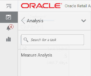

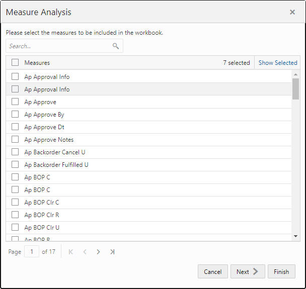

                           Click Measure Analysis.
                           The segment dialog box opens. Select Create New Plan and enter the label of the segment.

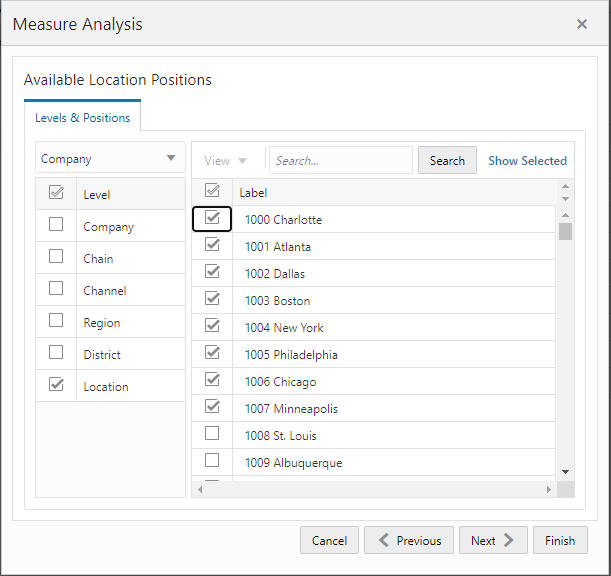

                           A Measure Analysis Wizard window appears. Only measures that are accessible to current users and have the insertable property set to true are displayed. Select the measures to be included in the workbook.
                           Based on the common base intersection of all the measures selected., a sequence of Hierarchy Selection wizards is displayed. Use these wizards to select the positions to be included in the workbook. The Location Selection wizard (as an example) is shown in Figure 4-19.
                           Use the wizards to make the appropriate selections and click Finish. A segment is created, as shown in Figure 4-20. You will receive a notification once the segment is built. You can open it from Recent Plans, as shown in Figure 4-21.
                           Click the segment name to open the newly created Measure Analysis segment. The segment has one window per intersection, named with the level names. All measures that have the same base intersection will be added into the same window. You cane edit the measure at the base level if the measure's base state is Write and at the aggregated level if the measure's agg state is Write, provided a valid defSpread method has been configured.
Reviewing and Editing Sales or Other Registered Measure Data
                           The segment dialog box opens. Select Create New Plan, and enter the label of the segment. A Measure Analysis Wizard window appears. Note: To open an existing Measure Analysis workbook, users can open the segment dialog box from step 3, and then go to step 8.
                           In the Workbook Wizard window, select the measures you want to include in the new workbook. You can use the Search field to filter the list of items if it is available. Use the check boxes to select items or use the All options to select or deselect items in the multi-select list.
                           Click Next. Based on each hierarchy specified in the base intersection of the selected measures, a hierarchy wizard appears.
                           In the hierarchy wizard, select the relevant positions and then click Next. Repeat this step for each hierarchy wizard.
                           Click Finish. A segment is created, and you will receive a notification once the segment is built and can open it from recent plans.
                           On the Measure Analysis View(s), view the stored data associated with the measures and hierarchy positions selected in the wizard. Make any changes as required. As an administrator, you can commit the changes.

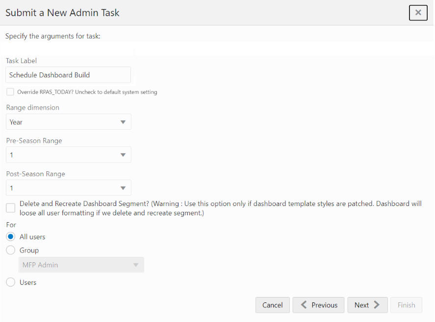

Schedule Dashboard Build
The Dashboard is a feature in RPASCE that is loaded when a user first logs into the system. The dashboard gives you access to key statistics. You can use the dashboard to analyze the health of the business. The dashboard must be refreshed periodically, as new products and locations are added. This typically happens weekly, but depends on your administrator's settings. The measure data of existing products and locations in the dashboard can be refreshed at any time to view updated changes.
The dashboard is supported by a workbook template that must be configured based on the customer business. It also requires the configuration of a JSON file using the Config Tools and uploaded during the building of the application. See Oracle Retail Predictive Application Server Cloud Edition Configuration Tools User Guide for more information.
The dashboard workspace can be built using Schedule Dashboard Build, which can be accessed from the System Administration Tasks Online Admin task group.
The following options are available:
For the configured GA dashboard profiles, the preferred selections are Range dimension: Half, Pre-Season Range: 1, and Post-Season Range: 1
                        Task Label. Enter the name of the build task in order to review the status of a build.
                        Override RPAS_TODAY (Optional). Select the check box to indicate that the task level RPAS_TODAY has priority over the application level RPAS_TODAY.
                        Range dimension. The Calendar dimension against which the dashboard is pre-ranged.
                        Pre-Season Range. The number of periods of the Range level that must be included before RPAS_TODAY.
                        Post-Season Range. The number of periods of the Range level that must be included after RPAS_TODAY.
                        Delete and Recreate Dashboard Segment. Use only if the dashboard template styles are patched. The use of this option results in the loss of all dashboard formats. Note that if the Delete and Recreate Dashboard Segment is checked, the segment will not be deleted if the user is currently logged into the application. The task does not fail, but this message will be in the log: "Unable to delete the dashboard segment for the User." The effect of this is that the user will not see the dashboard template style changes (such as adding a new view) which necessitated the Delete and Recreate.
                        Users. Select who can access the dashboard: All Users or User Groups.
