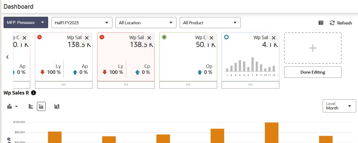

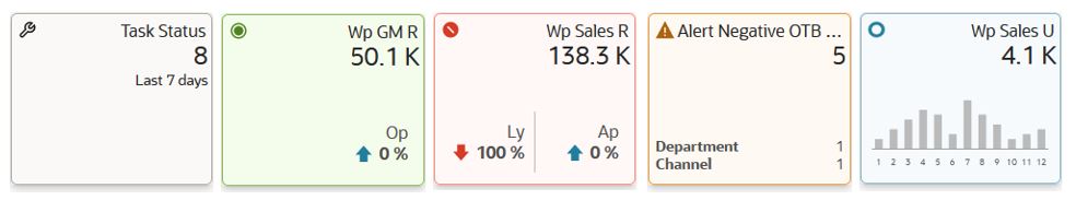

Dashboard information comes packaged in metric tiles. These tiles are arranged at the top of the dashboard on a carousel (a set of components that can scroll horizontally).
These metrics can include KPIs, as well as basic metrics such as sales figures. In many cases, the information present in a metric tile is supplemented with one or two additional metrics. These often serve as references to provide a contextual indication of how the value presented compares to some other value. These comparison metrics can be the corresponding values for the prior period or some planned performance expectations.
Figure 4-2 Example Metric Variance Tile
There are several styles of metric tiles. Figure 4-2 represents a variance tile. A variance tile shows one or more measures representing the absolute or percent differences between two quantities. Some tiles can represent information. An informational tile just displays the existing measure data.
Every tile has certain common characteristics. For example,
  • Value. In Figure 4-2, Wp GM R is the title.
  • An aggregate quantity. In Figure 4-2, 9.4% and 0%. This number reflects the filter selections.
  • Comparison Values. When defining comparison metrics in configuration, it is desirable to provide configured thresholds.
  • A color state and icon. When the value of the metric is greater or lesser than a configured threshold, the color of the metric tile indicates:
    • Blue: no defined thresholds for tile
    • Green: threshold defined but values within the boundaries of the thresholds
    • Yellow: values exceed the defined medium threshold but within the boundaries of the defined severe threshold
    • Red: values exceed the defined severe threshold
    When an application is configured with tile color state information, the information badge displays next to the title in the chart area. Clicking the information badge shows information on the configured thresholds.

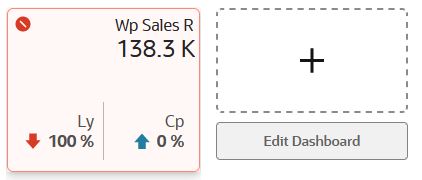

    In Figure 4-3, Wp GM R is shown in a red octagon (indicating a problem) because the working plan value is 0% below the Last Year value. The grey tile is used for administrative information.
    Figure 4-3 Tiles Showing Color State and Icon

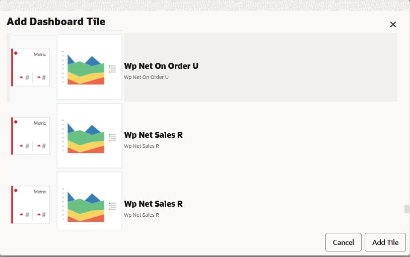

Adding a New Tile
You can add a metric tile from an existing pool of tiles. To add a new tile, click Plus on the right hand side of the metric tile carousel (some scrolling may be required).
Figure 4-5 Add New Tile
Add New Tile
This brings up a window showing all available metric tiles. Click the desired tile and click Add Tile. The tile is added to your tile carousel.
Figure 4-6 Available Metric Tiles

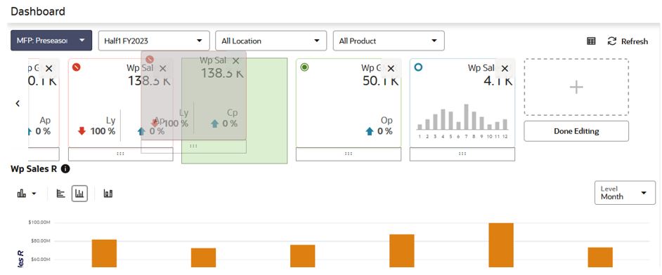

Changing the Display Order
You can change the order in which tiles are displayed. To do this, the metric tile carousel must be in edit mode. To access edit mode, click Edit Dashboard under the Plus icon to the far right of the carousel. Once in edit mode, each tile displays a drag bar at the bottom of the tile. You can drag the tile to the place you want it on the carousel and drop it.
Figure 4-7 Changing the Display Order
Removing a Tile
To remove a tile, enter edit mode by clicking the Edit Dashboard. In addition to the drag bar, each tile also displays a Delete icon in the upper right corner. Click Delete to remove the measure. Note that the measure can still be added from the metric tile pool.
All changes to the metric tile carousel are automatically remembered by RPASCE. The system remembers the desired order and content until you change it.
Figure 4-8 Removing a Tile
Removing a Tile

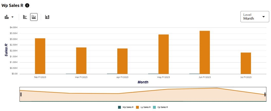

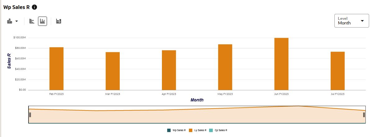

Main Chart
Selecting a tile displays detailed information for the measures represented by the tile in the main chart area. The information is presented with time on the horizontal axis and the measure quantity on the vertical axis.
If you use zoom on the main chart or scroll through it, it might extend beyond the scope of the top filter and RPASCE displays this message, Dashboard chart is out of sync with Calendar filter. The Calendar label in the message will be based on the dimension used on X-axis. A link to Sync the chart to match the top filter selection is provided with to the message.
The number of data points for charts are configurable. See the Oracle Retail Predictive Application Server Cloud Edition Administration Guide for further details.
Figure 4-9 Main Chart
Main Chart

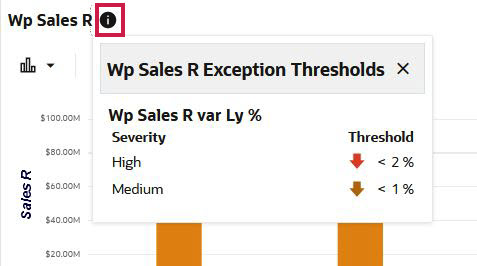

Information Badge
The metric information badge on the dashboard is available next to the metric name. Click the Information icon, as shown in Figure 4-10, to display more detailed information, such as the thresholds that determine the tile's priority-state and the color when a tile is selected. This information can help you determine the magnitude and importance of a plan variance.
Figure 4-10 Information Badge
Information Badge
Modifying the Chart Type
Click Chart to display the List of values that show the allowed chart types that you can select and view in the specific chart view.
Figure 4-11 Modifying the Chart Type

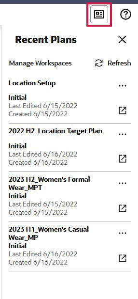

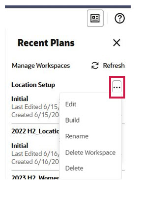

Recent Plans
You can view and select from a list of most recently visited workspaces by choosing a workspace from the Recent Plan/Workspaces section in the top right of the screen. This does not list all available workspaces, only the most recent. Use Refresh to update the list with the most recent plans. You can collapse or expand the recent plans list by using the Recent Plans icon. The Recent Plans icon provides more space to view the chart and assist in reviewing the dashboard.
Figure 4-14 Recent Plans
Recent Plans
By clicking the Action Menu icon next to each plan, you can perform the following actions:
  • Edit - opens the wizard for the corresponding workspace for you to make edits in the position selection
  • Build - initiates the building process for the corresponding workspace
  • Rename - renames the corresponding workspace
  • Delete Workspace - only deletes the workspace and retains the segment which allows you to save the selections made during wizard selection
  • Delete - deletes the corresponding segment
Recent Plans displays the Last Edited and Created dates for the workspace. The Last Edited date is the last modified date of the workbook and the Created date is the date when the workbook was created. Click the plan name to open the workspace within the application window or click the Launch in Separate Tab icon to open it in a new browser tab.
Figure 4-15 Recent Plans Action Menu

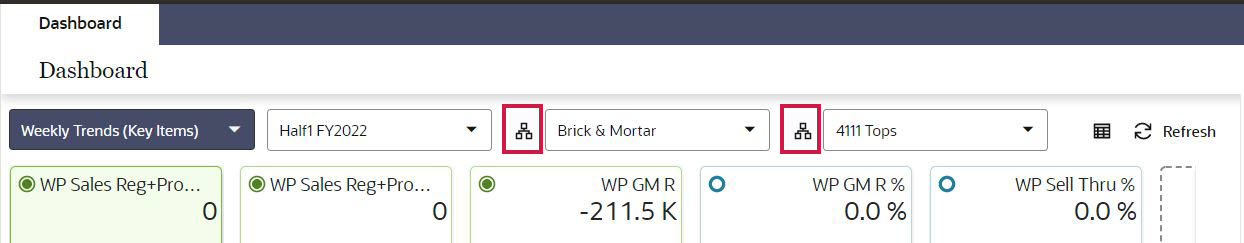

Dynamic Hierarchy Roll Up
The dynamic roll up of the Dashboard using the required product attributes and the roll up of data happen dynamically within the dashboard. This helps the planner to view the dashboard using different product attributes and to analyze how to view the data. The placeholder positions created might have some of the attributes unassigned with values, so there is also support for the unassigned values and the roll up happens accordingly for the selected attribute values.
Figure 4-16 Dynamic Hierarchy Roll Up
Dynamic Hierarchy Roll-Up

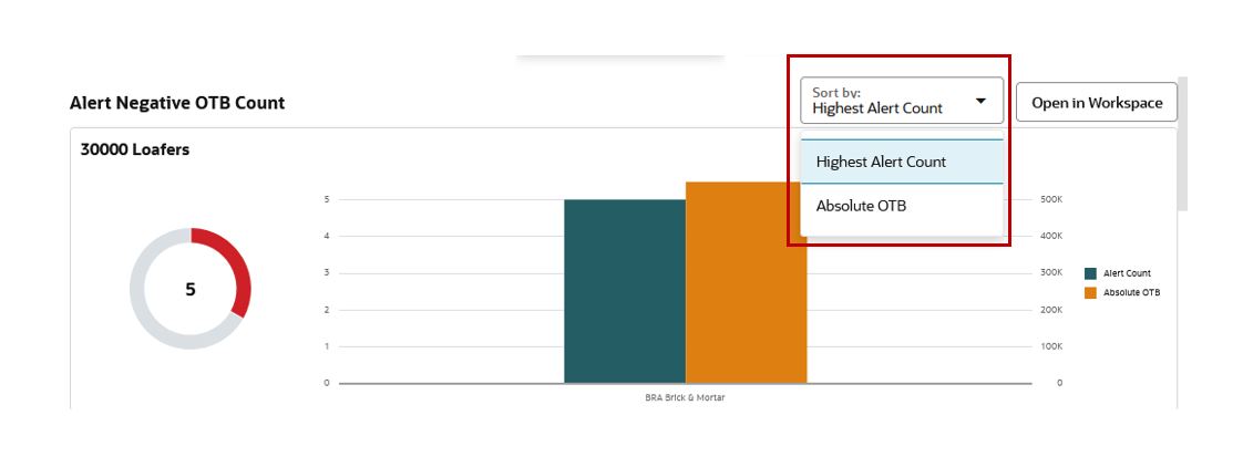

Sort on Dashboard
In the charts, you can sort the positions on the X axis by an available measure. You can also sort by Alert count in case of exception dashboard profile.
Figure 4-17 Sort on Dashboard

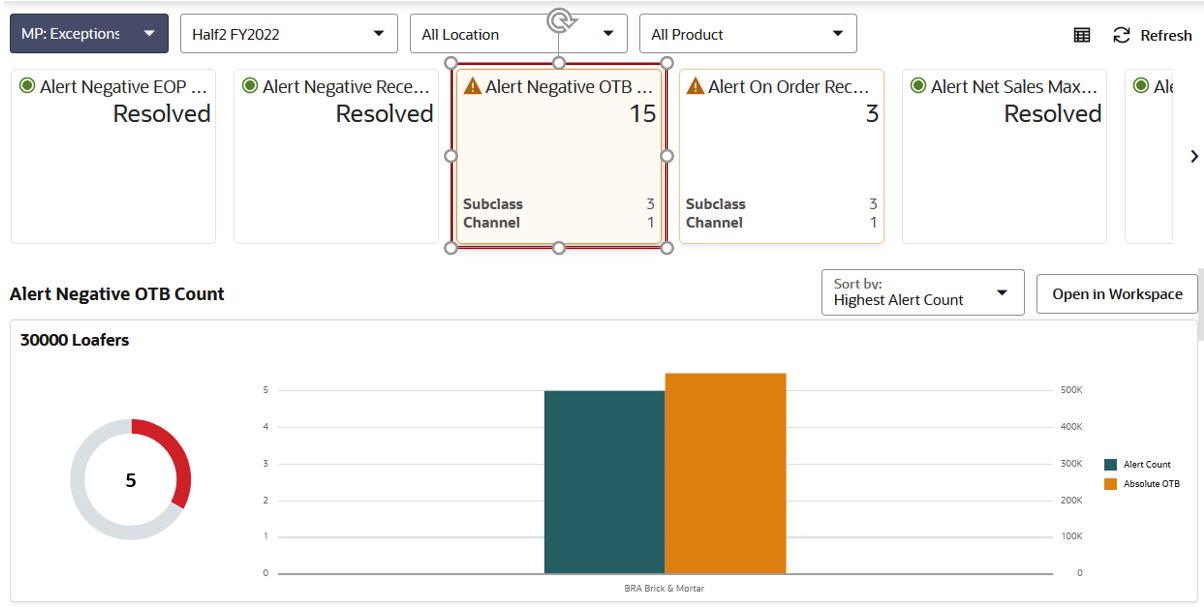

Exception tiles provide a summary of how many exceptional conditions exist within the plans you created and provide secondary information describing roughly the distribution of the exceptions across the data segments.
As shown in Figure 4-19, the selected tile has a total of 15 exceptions at three different subclasses. In the detail section under Alert Inventory Validation Count you can see four different graphs, one for each subclass with locations as the legend.
Figure 4-19 Exception Tile Summary

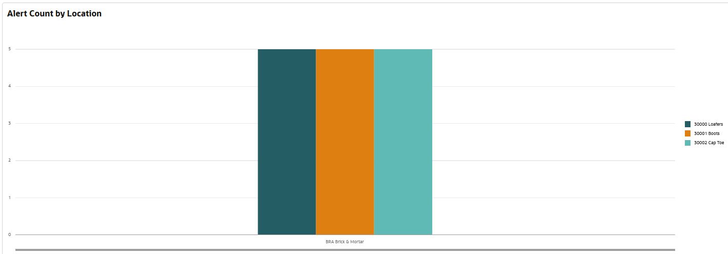

The detail pane associated with an Exception Tile provide a more granular description of the location of exceptions and leverages dashboard filtering to allow you to direct the sequence in which to visit the exceptions.
As shown in Figure 4-20, the selected alert has total five exceptions for three sub-classes across location. You can see in the detail section graph for Alert Count by Location with legend as the subclass.
Figure 4-20 Exception Summary Example

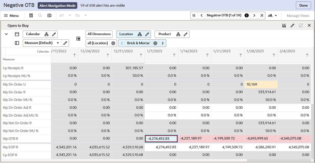

You can resolve the exceptions by launching directly into the respective workbook. Figure 4-21 shows the example workbook with alerts highlighted. When all the exceptions are resolved, you will see the notification message on the Exception Dashboard. Figure 4-22 shows the example of the notification message.
Figure 4-21 Resolve Exceptions
Resolve Exceptions

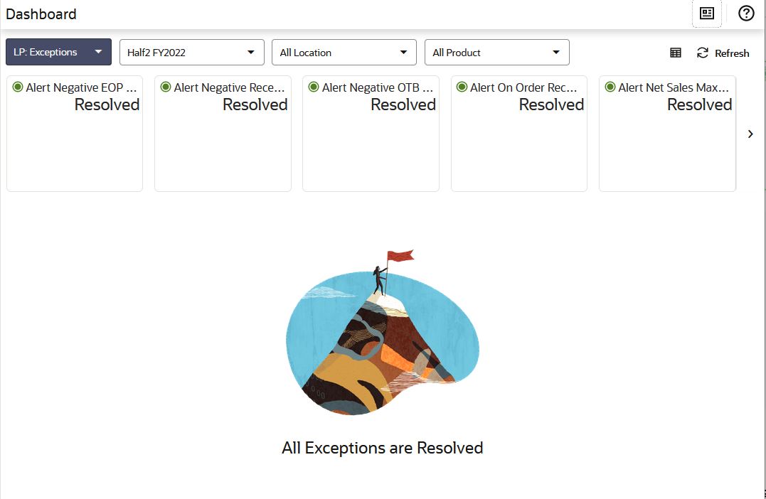

Figure 4-22 All Exceptions Resolved Message

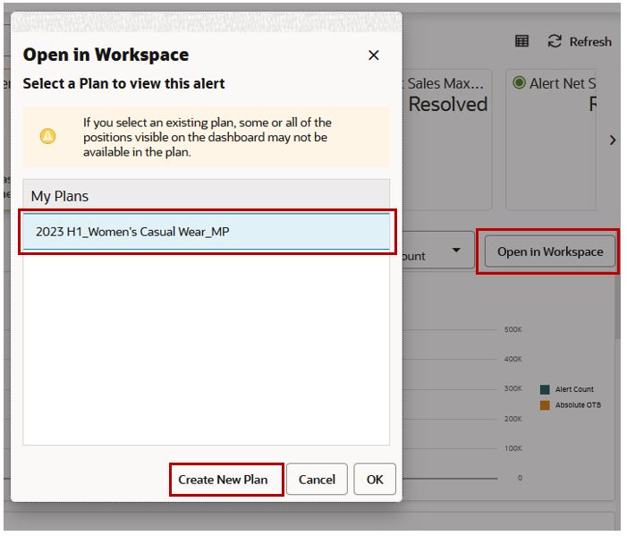

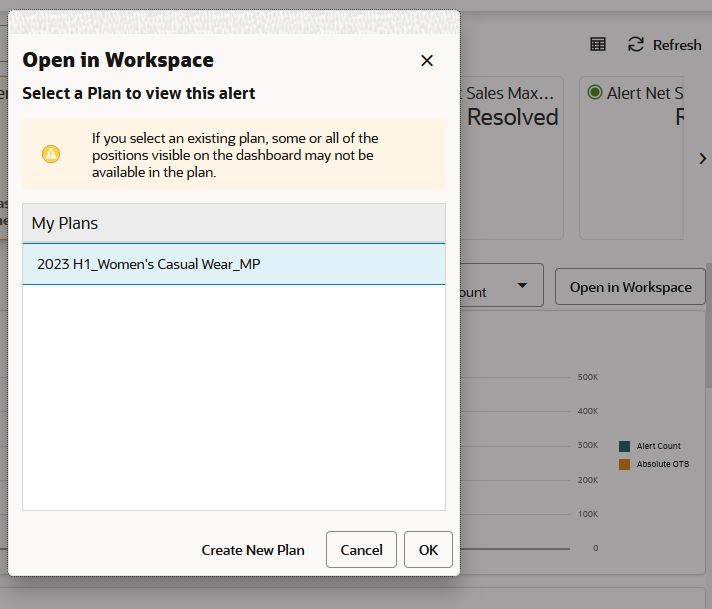

Creating and Opening Exceptions in Workspace
When you interact with the dashboard, you see summary information detailing the status of the data for which you are responsible. The dashboard provides access to all of the data visible to you and provides a set of filter controls you can use to limit the scope of reporting to a meaningful portion of that data (for example, a single department or class).
When examining the metrics and exception counts in the dashboard, you can resolve issues or adapt your plans to actual results by launching a taskflow workspace that is associated with an exception displayed in the dashboard.
You can do one of the following actions:
  • Open a pre-built segment workspace.
    You can launch a segment workspace that has already been built with the selected alert. The workspace focuses on data from the positions selected in dashboard filters.
    Click Open in Workspace to access the window. Select the plan in which you want to view the alert and then click OK. The workspace opens in alert navigation mode. If you select a plan that is missing some or all of the positions selected in the dashboard filters, you see a warning snackbar.
    Figure 4-23 Create or Open Workspace
  • Create a new segment workspace.
    You can define a new segment workspace to work with. The new segment is built with the positions selected in the dashboard filters. The workspace then opens with the selected alert.
    Click Open in Workspace to access the window. Click Create New Plan and complete the process to create the segment while verifying the selections. When no calendar dimension is supported, you can select from an available pre-range mask to filter only the calendar positions in the wizard. Once the plan is built, you can open the workspace and resolve the alert in Alert Navigation mode. The workbook opens in Alert Navigation mode.
See Real Time Alerts for more information on alert navigation.
