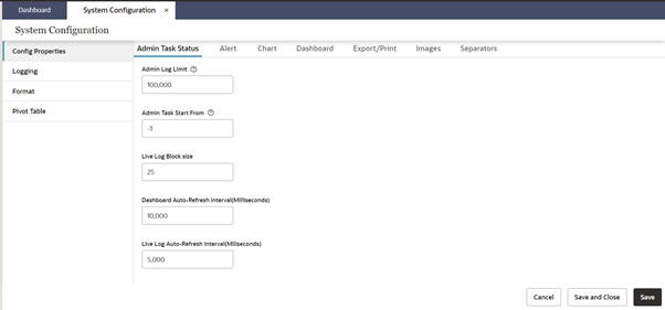

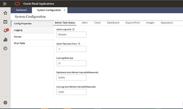

Admin Task Status
Use this tab, shown in Figure 16-3, to update the properties related to administration task status. The following properties can be updated:
                        Admin log Limit - Specify the number of lines in the administration logs. The range of permitted values is between 5,000 and 200,000.
                        Admin Task start from - Define the logging start from start (0) or end (-1) of the file.
                        Live Log Block Size - Enter the block size of the live log. The range of permitted values is between 20 and 30.
                        Use short name for entities - Toggle button to indicate whether you require short names for the entities in the status.
                        Dashboard Auto-Refresh interval - Update the auto-refresh interval time for the administration dashboard in milliseconds. The range of permitted values is between 1,000 and 86,400,000.
                        Live Log Auto-Refresh interval - Update the auto-refresh interval time for the live log. This is in milliseconds. The range of permitted values is between 1,000 and 86,400,000.

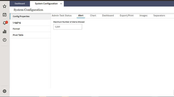

Alert
Use this tab, shown in Figure 16-4, to update the alert properties. You can update the maximum number of alerts allowed. The range of permitted values is between 1,000 and 10,000 alerts.
By default, the alerts displayed in the Select drop-down list are sorted by the ascending order of priority assigned to each alert during alert configuration. To change the default behavior, enable the Disable Priority Sorting on the Alerts property in Systems Configuration. You access this property in the Additional Setting Tab under Oracle Support Administration. The default setting for Disable Priority Sorting on Alerts is false. When default sorting is disabled, the alerts will be sorted as defined in the setting value of Disable Default Sorting.
Figure 16-5 Disable Priority Sorting

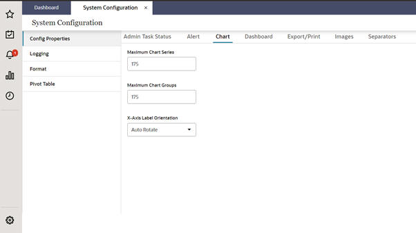

Chart
Use this tab, shown in Figure 16-6, to update the chart properties. The following properties can be updated:
                        Maximum chart series - The maximum number of series allowed in charts. The range of permitted values is between 100 and 200.
                        Maximum chart group - The maximum number of groups allowed to plot in charts. The range of permitted values is between 100 and 200.
                        X-axis Label Orientation - Select x-axis label orientation. The auto-rotate option is used to select the orientation of the x-axis labels, depending on the number of items in charts. The horizontal orientation option is used to display the x-axis label horizontally.

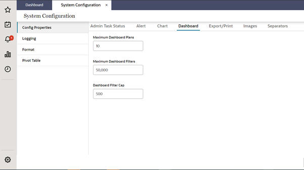

Dashboard
Use this tab, shown in Figure 16-7, to update the properties related to dashboards.
                        Maximum Dashboard Plans - The maximum number of plans for a dashboard. The range of permitted values is between 0 and 50.
                        Maximum Dashboard Filter - The maximum number of filters permitted in a dashboard. The range of permitted values is between 0 and 100,000.
                        Dashboard Filter Cap - The filter cap for a dashboard. The range of permitted values is between 0 and 1,000.

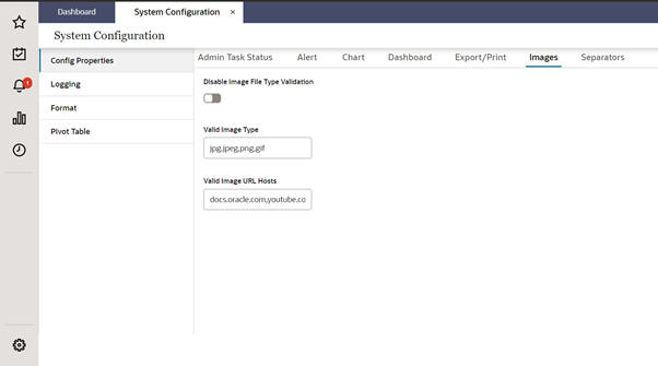

Images
Use this tab, shown in Figure 16-9, to update the following image-related properties.
                        Disable Image file type Validation - Toggle button to indicate whether or not you require file type validation for the images in your system.
                        Valid image type - The image file types that are valid for your application.
                        Valid Image URL hosts - The valid URL hosts for your application.

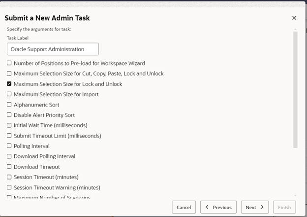

Maximum Selection Size for Lock and Unlock
Figure 16-11 Maximum Selection Size for Lock and Unlock
Figure 16-12 Maximum Selection Size Setting
Figure 16-13 Additional Settings Tab
Maximum Selection Size for Cut, Copy, Paste
From Submit Admin Task, select Oracle Support Administration and click Next. Then, select Maximum Selection Size for Cut, Copy, Paste and click Next and then Submit.
This sets the maximum selection size for lock and unlock operations. The range of permitted values is between 5,000 and 15,000. The default value is 8500.

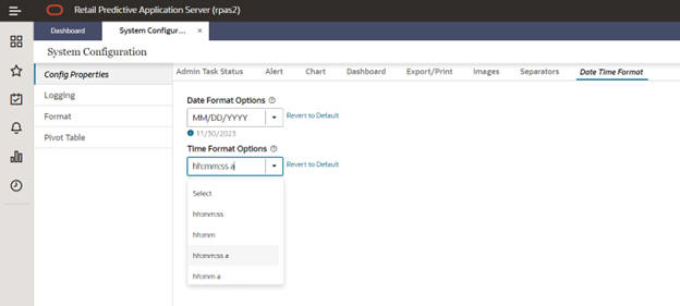

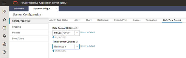

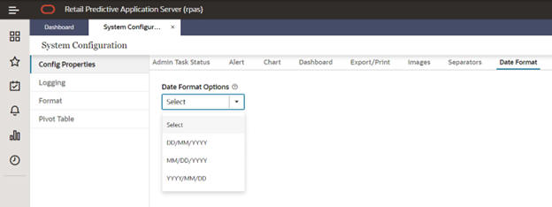

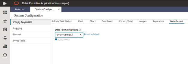

Date Time Format
This tab provides a Date Format option and a Time Format option.
                              DD/MM/YYYY
                              MM/DD/YYYY
                              YYYY/MM/DD
Figure 16-15 Date Format Option
When the user applies the date format, the change is applied to the Pivot Table, the Recent Plan, the Last Commit (bottom bar), and the Admin Dashboard.
Figure 16-16 Sample Date Option
The Time Format option provides a global format settings for time that is independent of language of application. The user can change the time format as required and the selected format will be applied to the application for all users.
                              hh:mm:ss
                              hh:mm
                              hh:mm:ss a
                              hh:mm a
Figure 16-17 Time Format Option

Selecting an option also displays the sample time format that will be applied.
Figure 16-18 Sample Time Format

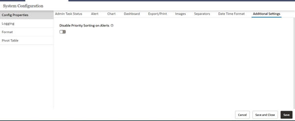

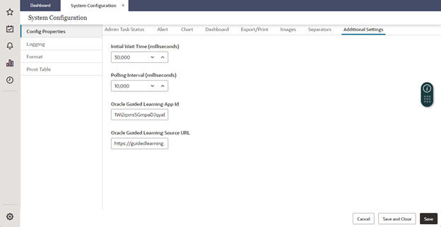

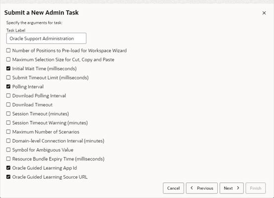

Additional Settings

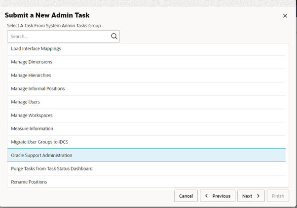

This tab, shown in Figure 16-21, is hidden by default and can be accessed via Online Admin Tools.

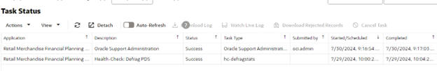

                        Launch Online Admin Tools and select the System Admin Tasks. Click Next.
                        Select Oracle Support Administration, as shown in Figure 16-19. Figure 16-19 Oracle Support Administration
 Description of "Figure 16-19 Oracle Support Administration"
                        Select the appropriate settings, as shown in Figure 16-20, and submit the task. Figure 16-20 Oracle Support Administration Settings
 Description of "Figure 16-20 Oracle Support Administration Settings"
                        Once the task is complete, the Additional Settings tab, shown in Figure 16-21, becomes visible and the settings/configuration properties selected in the task are available.
Oracle Guided Learning
Customers can realize their cloud application's value more quickly with Oracle's Digital Adoption Platform, Oracle Guided Learning (OGL). OGL accelerates user adoption with guided and contextual learning and also helps to manage continuous business change. In an OGL-enabled environment, users will see guided content from Oracle.
Customers can further customize the content as per their business need. There are two new properties under Additional Settings to configure for OGL, shown in Figure 16-20:
                        Oracle Guided Learning App ID- the unique identifier for your OGL account
                        Oracle Guided Learning Source URL - source from which to pull the guides and content

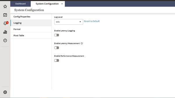

Logging

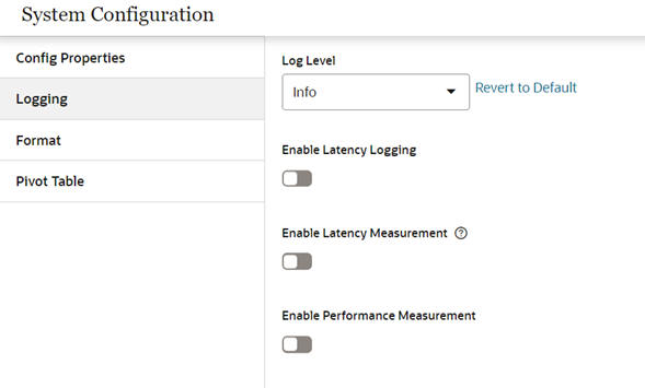

Use this tab, shown in Figure 16-22, to set the log level and enable/disable latency-logging, latency-measurements, and performance-measurements. You must save and log in again in order for the changes to take effect.
Log Level
Use the log level drop-down list to select appropriate log levels. The RPASCE Client application supports the following log levels.
Table 16-1 Log Levels
| Log Level Name | Log Level Definition |
| Off | Used to turn off all logs. |
| Fatal | Used to log severe errors that require immediate attention. These situations either impact the normal operation of the entire application or a component within the application. |
| Error | Used to log errors. Critical errors and information are logged at this level. |
| Warn | Used to log messages regarding potentially harmful situations. These situations do not affect the running of the RPASCE Client application, but may not give the desired result. For this reason, it is preferable to warn the user about such situations. |
| Audit | Used to log messages that indicate a change, including workbook builds, save, commit, and so on. Most of these may already be reflected in the UI or are available on Admin Task Status. |
| Info | Used to log general information about user actions and main events (for example, if the login was successful or not). This is the default log level. |
| Profile | Used to log performance characteristics of user actions. |
| Debug | Used for debug logging. At this level, more logging occurs than at the other levels. Debug information that can help in application debugging is provided at this level. This must only be used for debugging purposes, as the number of logs generated may cause performance issues. When a customer wishes to report a defect, customer support can advise the customer to turn on logging at this level, run the problem scenario, capture the logs, and attach them to the trouble report. |
| Verbose | Used for very detailed logging. At this level, more logging occurs than at the debug level. Fine-grained information that can help in application debugging is provided at this level. This must be used only for debugging purposes, as the number of logs generated may cause performance issues. When a customer wishes to report a defect, customer support can advise the customer to turn on logging at this level, run the problem scenario, capture the logs, and attach them to the trouble report. |
| All | Used to turn on all the logging. |

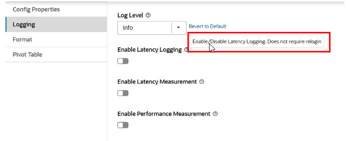

Enable Latency Logging
Use the toggle button to enable or disable latency logging. Once enabled, the network latency from the user browser to the application is measured and logged at defined intervals. This can help the customer administrator to work with Oracle support on any network latency-related performance issues.
Enable Latency Measurement

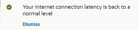

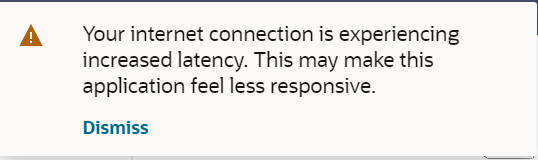

Use the toggle button to enable or disable latency measurement. Latency measurements depends on Latency Logging and so that must also be enabled, along with latency measurements.
Once this is enabled, users will see the following warning when their network latency exceeds certain thresholds.
They will see the following information once their network latency returns to normal.
Enable Performance Measurement
Use the toggle button to enable or disable performance measurement. Once this is enabled, the performance timing icon appears on the left task menu (after the user logs in again). The performance values for the current user can be exported or displayed using appropriate sub-menu links.

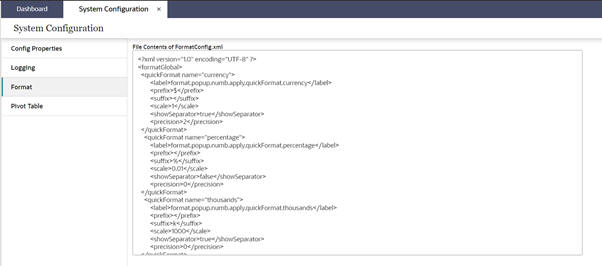

Format
Use this tab, shown in Figure 16-25, to change the FormatConfig.xml file, which controls the formatting properties for the application (that is, currency, percentage, and millions separator).
To save your changes, click Save or Save & Close.
To apply the saved changes, you must re-log into the application.
Figure 16-25 File Contents of FormatConfig.xml
Description of "Figure 16-25 File Contents of FormatConfig.xml"

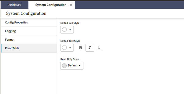

Pivot Table
Use this tab, shown in Figure 16-26, to change the format style of edited uncalculated cells. You can update the color of the edited cell background, edited cell text color, and style.

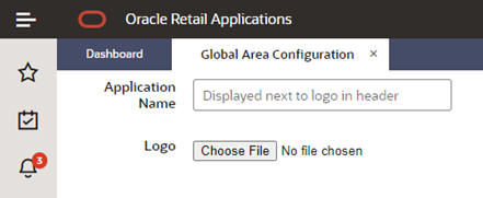

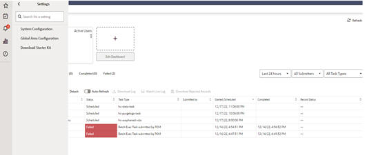

Global Area Configuration
The Global Area Configuration page allows an administration user to configure certain components of the branding area, including the application name and the logo.
The PLATFORM_SERVICES_ADMINISTRATOR_ABSTRACT group must be assigned to the user in IDCS or OCI IAM or the user will experience a 403 forbidden error after attempting to save.
Figure 16-27 Global Area Configuration Page
Description of "Figure 16-27 Global Area Configuration Page"
The Global Area Configuration page can be reached through the Settings menu (Settings > User Interface > Global Area Configuration). After making changes, including updating the application name and uploading the logo, on this page, click Save or Save and Close to apply the new settings. To revert to the default settings, remove the custom value and click Save.

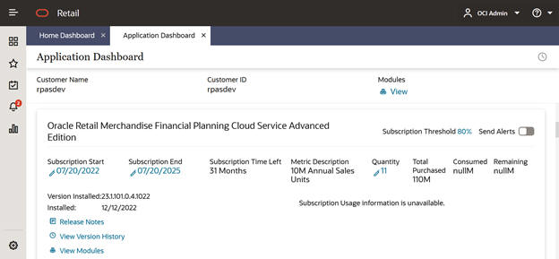

Monitoring Subscription Usage in Retail Home
All Oracle Retail cloud service subscriptions include a subscription metric that defines in some way the capacity of the systems provisioned as a part of the subscription. The actual metric varies across Oracle Retail cloud services.
For RPASCE applications, the subscription metric is tens of millions of annual sales in units, or 10M annual Sales Units, as it often appears.Users with administrative rights for Retail Home can view information on the quantity of units defined for their subscription and see information on actual usage over time for RPASCE application subscriptions (and any other Oracle Retail cloud service subscriptions) as well as for the AI Foundation component that is a part of every Oracle Retail cloud service subscription.This information is accessible on the Application Dashboard screen of Retail Home, shown in Figure 16-29.
Figure 16-29 Retail Home Application Dashboard
Description of "Figure 16-29 Retail Home Application Dashboard"
For more information on accessing the Application Dashboard, as well as information on the information presented on that screen, refer to the chapter "Application Dashboard" of the Oracle Retail Home Administration Guide.

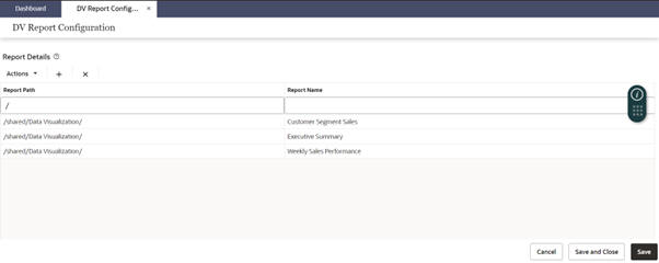

DV Report Configuration
An administrative user can use the DV Report Configuration page to configure Data Visualization (DV) Reports that are created in the Oracle Analytics DV Environment. The user can add, rename, and delete DV Reports. The user can access the DV Report Configuration feature from the Settings icon available at the bottom of the left sidebar menu, as shown in Figure 25.
Figure 16-30 DV Report Configuration
Indicators for Report Details provide a brief description of report path and report name properties. Log into the Oracle Analytics DV environment to obtain the report path and report name. DV Reports in the Oracle Analytics environment are stored with or without subdirectories under My Folders or Shared Folders as the parent directory. The report path for the Shared Folders starts with /shared and My Folders starts with /users.
Figure 16-31 DV Report Environment Path
You can add and delete reports using either the + / x buttons or the Action menus..
Figure 16-32 DV Reports Adding and Deleting
Once you have configured your reports, click Save or Save & Close to save your changes. Note that, o apply the saved changes, you must re-log into the application.
Images and Contextual Help
Valid Hosts: Users can specify a web URL as the source of an image(s) (typically the content management server) or source for contextual help. Due to security reasons, the RPASCE client will only use images or contextual help links from these configured hosts. Users are only allowed to enter URLs from the hosts defined by this setting in System Configuration.
The dimension for which the images are to be displayed must have a dimension attribute measure registered of type string that has the UI Type property set to media. For example, consider that the name of the dimension attribute measure is addvskupimgt for dimension skup. The measure must beloaded into PDS using Load Fact Data.
70063172,"<image id=""main"" label=""Front""><url size=""thumb"">http://127.0.0.1:7001/contentserver/imgfetch/1000396_Front_full.jpg</url></image>" 73137693,"<image id=""main"" label=""Front""><url size=""thumb"">http://127.0.0.1:7001/contentserver/imgfetch/CardiganLS.jpg</url></image>" 96880516,"<image id=""main"" label=""Front""><url size=""thumb"">http://127.0.0.1:7001/contentserver/imgfetch/1000399_Front_full.jpg 88805005,http://127.0.0.1:7001/contentserver/imgfetch/1000378_Front_full.jpg 72939751,http://127.0.0.1:7001/contentserver/imgfetch/1000439_Front_full.jpg 96666402,http://127.0.0.1:7001/contentserver/imgfetch/1000440_Back_full.jpg
The use of the double quotes in the lines above is the standard way of escaping double quotes in any RPASCE measure's csv input files.
Configuration Settings Not Requiring Relogging
| Logging | Log Level |
| Enable Latency Logging | |
| Enable Latency Measurement | |
| Enable Performance Measurement | |
| Format | File Contents of FormatConfig.xml |
| Pivot Table | Edited Cell Style |
| Edited Text Style | |
| Read Only Style | |
| Admin Task Status | Admin Log Limit |
| Admin Task Start From | |
| Live Log Block Size |
Examples:
Figure 16-33 Latency Logging
Figure 16-34 Pivot Table
