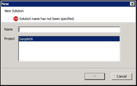

Navigate: From the File menu, select New and then Solution. The Figure 4-1 opens.
In the Name field, enter the name of the solution.
In the Project field, select the project in which the solution is to belong. Multiple projects will be listed if multiple projects are currently open.
Click OK to save any changes and close the window.

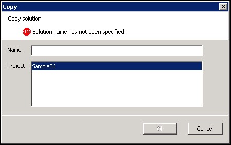

Copy a Solution
Complete the following steps to copy a solution.
Select the solution to be copied.
Right-click in the Configuration Components pane and click Copy. The Copy solution window opens.
Type the new name for the solution in the text box.
This is the name that the solution is called after it has been copied.
Select the project where the solution is to be copied.
Click Finish to save the copied solution in the specified project.

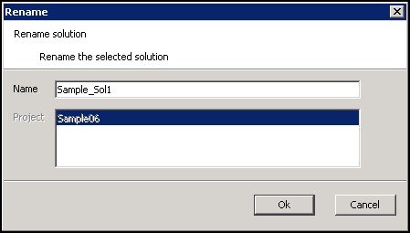

Rename a Solution
Complete the following steps to rename a solution.
Select the solution to be renamed.
Right-click in the Configuration Components pane and select Rename. The Figure 4-3 opens.
Delete the old name from the resulting field and type the new name.
Click OK to save the new name.

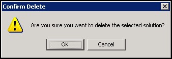

Delete a Solution
Complete the following steps to delete a solution.
Select the solution to be deleted.
Right-click in the Configuration Components pane. The Figure 4-5 opens.
Click OK to complete the deletion.

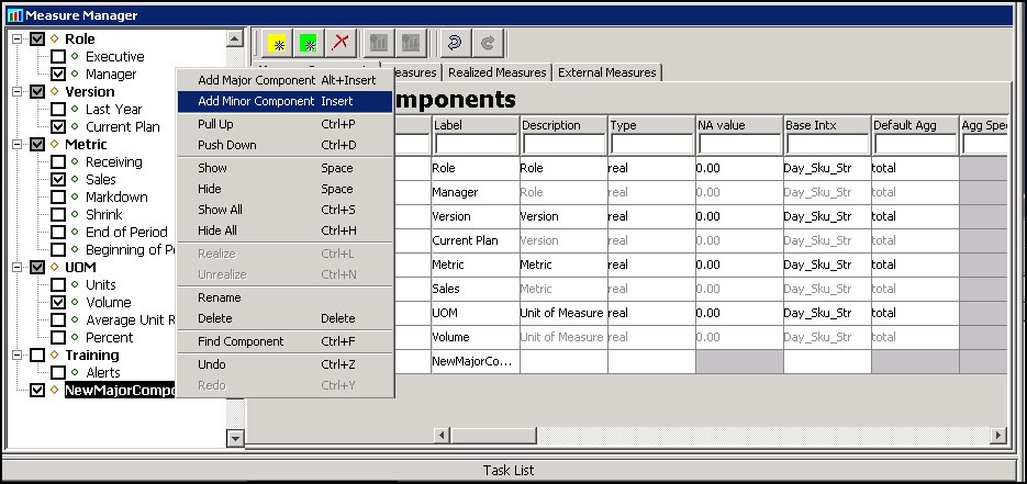

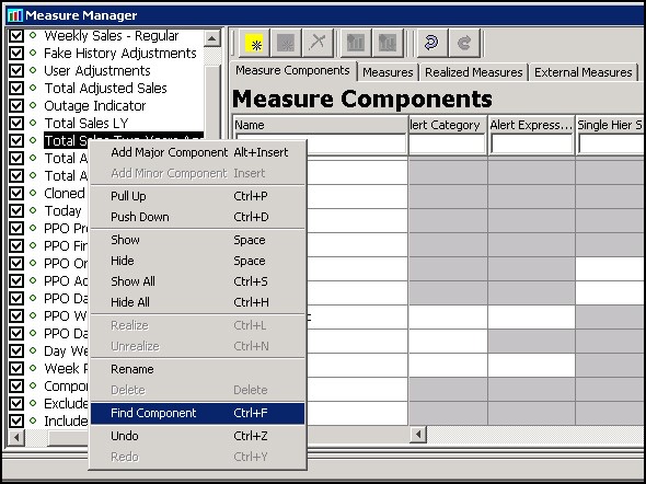

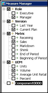

Create a Major Component
Complete the following steps to create a major component.

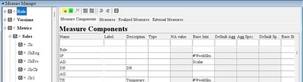

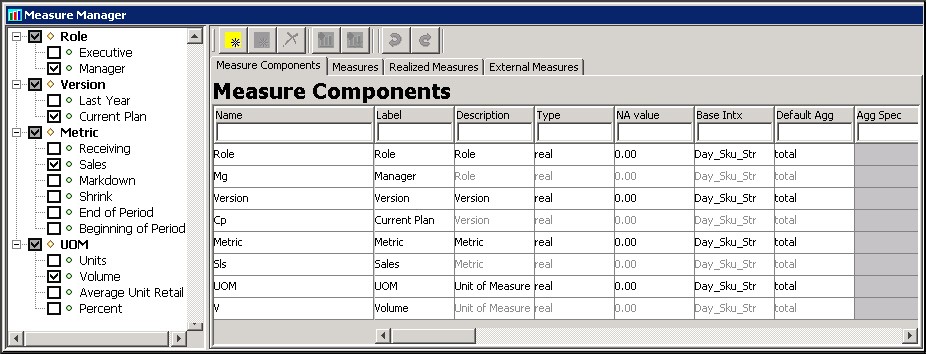

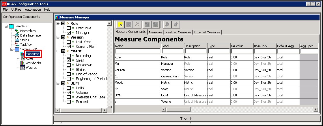

Navigate: In the Configuration Components pane, select Project then Solution then, Measures and then the Measure Components tab. The Measure Manager window opens in the workspace.
Figure 4-7 Measure Manager Window - Measure Components Tab
Description of "Figure 4-7 Measure Manager Window - Measure Components Tab"
Right-click in the left-hand pane of the Measure Manager window and select Add Major Component or click Add Major Component. The major component displays in the Measure Manager navigation tree with a default name.
Figure 4-8 Measure Manager Navigation Tree
Description of "Figure 4-8 Measure Manager Navigation Tree" -
To change the component name, right-click on the component and select Rename, or select the component from the navigation tree and then modify its Label field from the Measure Components tab.
Create a Minor Component
Complete the following steps to create a minor component.
Figure 4-9 Major Measure Component Selected
Description of "Figure 4-9 Major Measure Component Selected"
Select the major or minor component that the new minor component is to be added beneath. In Figure 4-9, NewMajorComponent is selected.
Choose one of the following methods:
Right-click the Measure Definition navigation tree and select Add Minor Component.
Click Add Minor Component.
Press Insert.
The minor component displays in the Measure Manager navigation tree with a default name.
To change the name, right-click on the component from the navigation tree and select Rename. You can also select the component from the navigation tree and modify the Label field from the Measure Components tab.

Once components have been created, open the Measure Manager and select the Measure Components tab.
Select the major or minor components you want to view from the Measure Manager navigation tree. The selected components display in the Measure Components tab.
Specify the information for the component properties (for example, Name, Label, Description, and so on), which will apply to the measures that are inheriting property values from the component.
The values that are entered for major components are inherited by the child minor components and the auto-generated measures. Not all properties need to be entered for all components. Properties that are grayed out in the component properties table cannot have a value in the current context. Typically, this is based on the data type of the measure. For example, only components of Boolean data type can have an alert category or an alert expression.

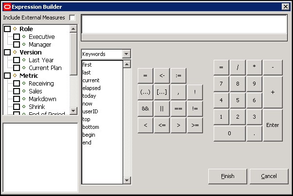

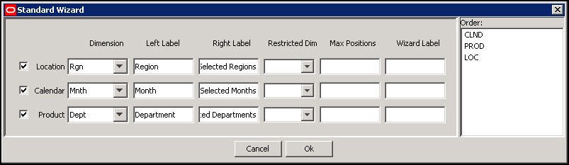

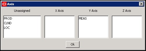

An agg spec can be typed in or built through a window (double-click the agg spec editor or select Ctrl-Space to launch it).
This window looks very similar to the standard wizard for workbooks. On the right, the ordering of hierarchies in the intersection of the measure is set by dragging the hierarchies in the list. On the left, a separate aggregation type is selected for each hierarchy. For the most part, these are the aggregation types that are available for the measure based on its type.

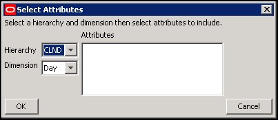

Dim Attr Name (optional field)
This is only to be used if the measure is set to be a dimension attribute measure. When a dimension attribute is displayed within the RPASCE Client, the Dim Attr Name will be used in place of the measure name. If no Dim Attr Name is supplied, the RPASCE Client displays the measure name.
Dim Attr Label (optional field)
This is only to be used if the measure is set to be a dimension attribute measure. When a dimension attribute is displayed within the RPASCE Client, the Dim Attr Label will be used in place of the measure label. If no Dim Attr Label is supplied, the RPASCE Client displays the measure label.

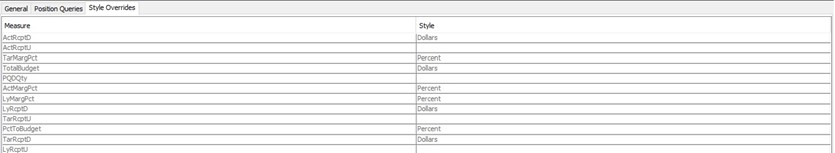

Style
One of the styles defined within the style tool may be specified as the default style to be used to display measures based on this component inside the User Interface. See the section on the Style Manager for details on the specification of style information.

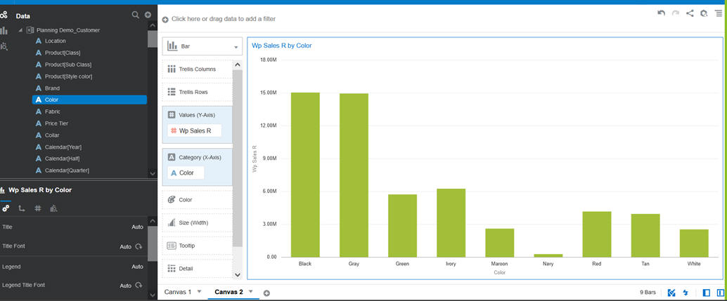

Enable Viewing Fact Data by Dimension Attributes in Data Visualization (DV)
Figure 4-14 An Example of Viewing Sales Data by Color Attributes in DV
The one-dimensional and two-dimensional attribute measures must have the Report Category values configured; the following assumptions and requirements apply.

Move Components
From the Measure Manager navigation tree, select the component to be moved.
Drag the component to the new location and release it.
A minor component cannot be moved to a different major component.
The configuration administrator cannot move a component so that it would be a descendent of another component that is used in the specification of a realized measure.
Push Components Down
From the Measure Manager navigation tree, select the component to be pushed down.
Right-click in the Measure Definition menu and select Push Down.
The component is pushed down one level in the component hierarchy, and a new component is created to take the place of the pushed down component.
A major component cannot be pushed down.
Pull Components Up
From the Measure Manager navigation tree, select the component to be pulled up.
Right-click and select Pull Up. The component is pulled up one level in the component hierarchy.
A minor component cannot be pulled up to become a major component, nor can a major component be pulled up.
Display or Hide Components
To display information about a component, select the check box next to the component name.
To hide information about a component, clear the check box next to the component name.
Selecting or clearing a check box for a major or minor component causes the check boxes for all minor components underneath it to be selected or cleared. This check box is also used to enable a component so it becomes active when measures are generated.
Find a Component
Right-click in the Measure Manager navigation tree and select Find Component. The Input window opens.
Type in the name of the desired component and click OK. The tree will scroll to bring the specified component into view.
Select the desired component.
The full name (case sensitive) of the component is required in order to find it. If there is no component with the exact name entered, the tree will not scroll.
Rename a Component
Navigate: From the Measure Manager navigation tree, select the component to be renamed.
Right-click in the Measure Manager navigation tree and select Rename. Type the new name for the component.
Double-click the component and type the new name.
Select and change the name of the component in the Measure Component tab.
Changing the name of a component results in a change in the name of any measure that inherits from the component unless the measure has overridden the name property.
Remove Components
Navigate: From the Measure Manager navigation tree, select the component to be removed.
Click Remove Component.
Press Delete.
Right-click in the Measure Manager navigation tree and select Delete.
The component is removed from the solution.
It is not possible to remove a component that is used (or that has a descendent component that is used) in the specification of a measure.

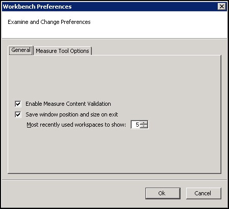

Disabling Measure Content Validation
For some cases you may disable the full validation (for instance, when performing a number of changes to measure properties that require switching back and forth between multiple tools). Validation can then be manually initiated from the Rule Definition window by selecting Perform measure content validation from the Rule Definition toolbar. Complete the following procedure to turn off real-time validation.
Select File and then Tools Preferences. The Workbench Preferences window opens.
Figure 4-17 Workbench Preferences – General Tab
Description of "Figure 4-17 Workbench Preferences – General Tab" -
Clear the Enable Measure Content Validation check box.
Click OK.

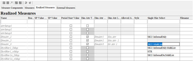

Working with Measures
Measure Manager Overview
The Measure Manager allows you to create and name measures by selecting major and minor components that are already defined. By default, the measures inherit the properties that are defined for the components. To create a measure, select the components that will be used to construct measures. The Measure Manager will generate measures for all of the combinations of selected components. This saves you from the tedious task of manually creating all required measures.
You may then override the properties for individual measures by entering them the same way as on the Measure Components tab. Once properties are overridden at the measure level, changes made at the component level will no longer spread down to that measure as it will retain the overridden value. An overridden value can also be restored to its inherited value or you may override an inherited value to be unspecified.
When a measure is auto-generated by the Measure Manager, it cannot be edited or used in any other configuration component such as rules and workbooks until it is realized. A measure does not need to be realized if it is not going to be used.

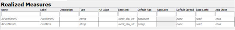

The Measures tab displays all auto-generated measures for the selected components.
The Realized Measures tab only displays those measures that are realized.
Figure 4-20 Measure Manager Realized Measures Tab
Description of "Figure 4-20 Measure Manager Realized Measures Tab"

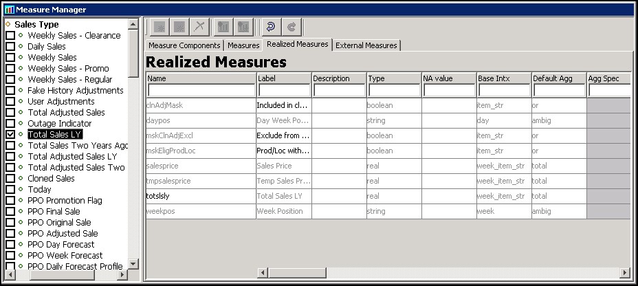

Realized and Unrealized Measures
Complete the following steps to access the Measure Manager window - Measures Tab.
Navigate: In the Configuration Components pane, select Project, then Solution, and then Measures. The Measure Manager window opens in the workspace.
Select the Measures tab.
In the components tree, select the check boxes for the components that will be filtered. The Measure Manager will show measures using all the combinations of selected components. This process filters the list of prototype measures that are shown from all combinations of components to the combinations of components that have been selected. It uses those components to determine which prototype measures to show.

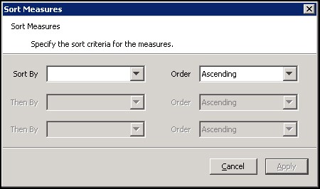

Sort Measures by Property Value
In the Realized Measures tab, measures can be sorted by property value.
Select the Realized Measures tab.
Hold down the control key (Ctrl) and click in the filter field at the top of the table for the property of the measures to be sorted.
The measures are sorted in alphabetical order according to the value of the property.
Filter Measures by Property Value
In the Realized Measure tabs, the configuration administrator can filter measures by property value.
In the Realized Measures tab, click in the filter field at the top of the table for the property of the measures to be filtered.
Enter the value on which ti filter the measures.
This field is case sensitive.

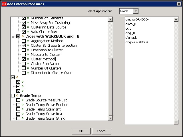

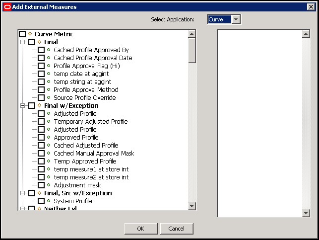

External Measures
Under most circumstances, measures exist only within the solution in which they are defined. When working with a project with multiple solutions, it is sometimes desirable to make use of a measure defined in a different solution. The Measure Manager allows the import of a measure defined in a different solution (but not a different project) into the current solution. These measures (called external measures) then become visible in the External Measures tab of the Measure Manager. Within this tab, it is possible to modify certain measure properties so that the use of the measure in the Solution into which it has been imported will differ from its use in the Solution in which it was originally defined. For example, the configuration administrator may want to modify a writable measure so that it is read-only in the solution into which it is imported.
Figure 4-22 Measure Manager External Measures Tab
Description of "Figure 4-22 Measure Manager External Measures Tab"
Within the Measure Selectors present in the Rule and Workbook tools and the Expression Builder, there is a check box named Include External Measures. When this check box is selected, the Measure Selector will include those measures that were imported into the solution in addition to those that are present due to component selections in the Measure Selector.
The following properties may be overridden for an external measure:
Label
Description
Base State
Agg State
UI Type
Range

Select the External Measures tab, and click Import Measure on the toolbar. The Figure 4-23 opens.
In the Add External Measures window, select the solution in which the desired measure is defined.
Use the measure selector (left-hand side) to select the measures to import.
Figure 4-24 Selecting Measures to Be Imported
Description of "Figure 4-24 Selecting Measures to Be Imported"External measures that are already imported display in bold.
From the right-hand list, select the measure to import and click OK. The selected measures display in the External Measure tab.

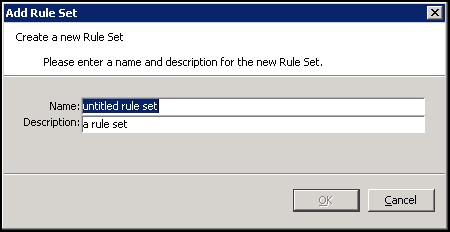

Create a Rule Set
Navigate: In the Configuration Components pane, select Project, then Solution, and then Rules. The Rule Definition window opens in the workspace.
From the toolbar, click New and select Rule Set, or select Create/Rule Set from the right-click menu. The Figure 4-26 opens.
Complete the following:
In the Name field, enter the name of the rule set.
A rule set name can be a maximum of ten alphanumeric or underscore characters. It must not have a name that is the same as any other rule set that exists in the project.
In the Description field, enter a description of the rule set.
Click OK to save any changes and close the window. The rule set displays in the Rules navigation tree.

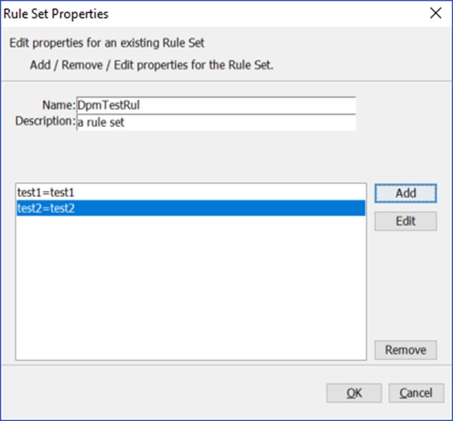

Edit Rule Set Properties
In the Rule Definition window, select the rule set, right click, select Edit Properties, then select Rule Set. The Rule Set Properties Window opens in the workspace.

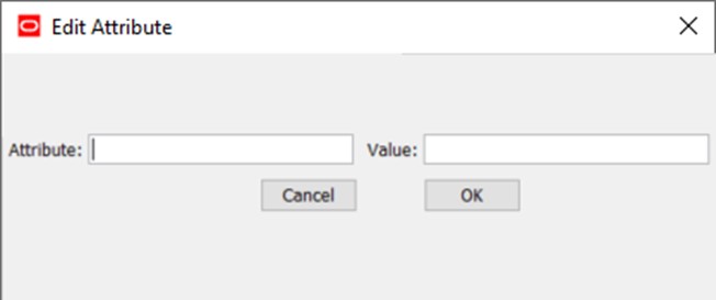

In the Rule Set Properties window, Click Add to open the Edit Attribute window in order to add a new rule set attribute.
Figure 4-28 Rule Set Edit Attribute Window
Description of "Figure 4-28 Rule Set Edit Attribute Window" -
To edit an existing rule set attribute, select the attribute/value pair and then click Edit. The Edit Attribute window opens in the workspace. The window is pre-populated with the selected rule set attribute and value that the users can edit.
To remove an existing rule set attribute, select the attribute/value pair and then click Remove.

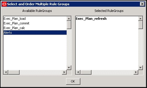

The Configuration Tools and RPASCE support the use of multiple refresh rule groups. Within the rule tool, there is the ability to create multiple refresh rule groups within a rule set. These multiple refresh rule groups can then be assigned to a workbook template using the Workbook Designer, and they will be available for selection within the RPASCE Client.
A workbook contains all of the rule groups in a single rule set, so if multiple refresh rule groups are required in a workbook, they must all be in the same rule set.
You may consider naming rule groups so the usage of the refresh rule groups are reflected in their names, such as
refresh_all,refresh_actuals, andrefresh_manager.

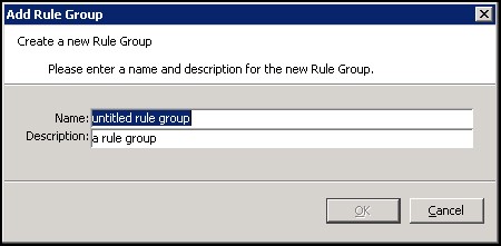

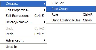

Create a Rule Group
Navigate: In the Configuration Components pane, select Project, then Solution, and then Rules. The Figure 4-29 opens in the workspace.
In the Rule Definition window, select the rule set to be used to create a new rule group.
From the toolbar, click New and select Rule Group, or select Create – Rule Group from the right-click menu.
The Figure 4-31 opens.
In the Name field, enter the name of the rule group.
A rule group name can be a maximum of 16 alphanumeric or underscore characters. It must not have a name that is the same as any other rule group that exists in the project.
In the Description field, enter a description of the rule group.
Click OK to save any changes and close the window. The new rule group displays in the Rule Definition tree window.

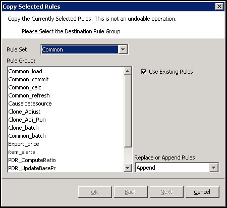

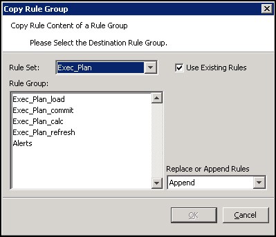

Copy a Rule Group
If two rule groups are similar, it may be beneficial to copy one rule group into the other to prevent having to create a rule group from scratch. When copying the rules of a rule group into another rule group, it is possible to specify whether existing rules will be used or copies of the rules will be created. The Use Existing Rules check box defaults to using any existing rules in the rule pool. If this check box is selected, the copy rule group operation will use the same rules that the source rule group has. If this check box is unchecked, the copy rule group operation will create copies of the rules and use those copies for appending to or replacing rules in the destination rule group.
The rule group to be copied into must already exist. A new rule group cannot be created through this process.
In the Rule Definition window, select the rule group to be copied.
From the toolbar, click Advanced, and select Copy Rule Group. The Copy Rule Group window opens.
Using the Rule Set list, select the destination rule set.
From the Rule Group area, select the desired destination rule group.
Using the Replace or Append Rules list, select either:
Replace – To overwrite all rules that already exist in the destination rule group.
Append – To add to the rules already in the destination rule group.
Click OK. The Confirm Operation window opens.
Click OK. The rules are copied to the selected rule group.

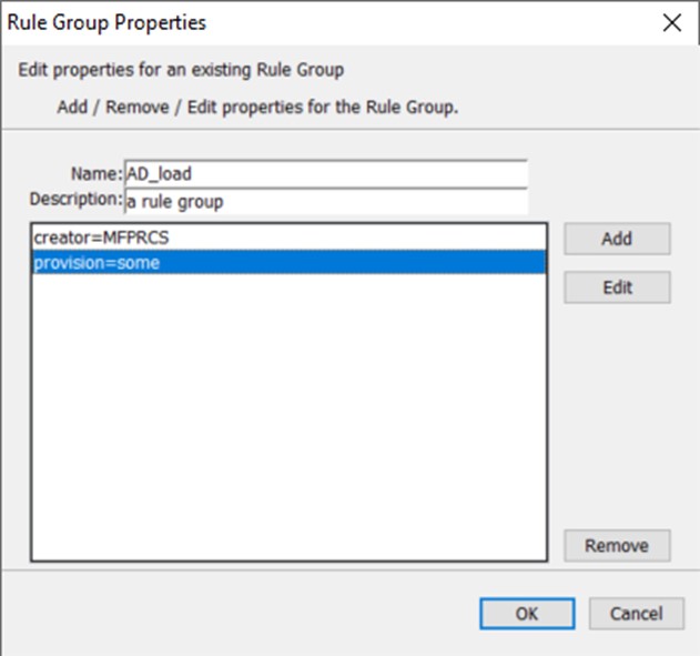

Edit Rule Group Properties
In the Rule Definition window, find the rule set containing the rule group to be modified. Select the rule group, right click, select Edit Properties, then select Rule Group. The Figure 4-33 opens in the workspace.

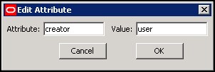

In the Rule Group Properties window, click Add to open the Edit Attribute window in order to add a new rule group attribute.
Figure 4-34 Rule Group Edit Attribute Window
Description of "Figure 4-34 Rule Group Edit Attribute Window" -
To edit an existing rule group attribute, select the attribute/value pair and then click Edit. The Edit Attribute window opens in the workspace. The window is pre-populated with the selected rule group attribute and value that the user can edit.
To remove an existing rule group attribute, select the attribute/value pair and then click Remove.
Measure Validation in the Rule Definition Window
If Enable Measure Content Validation is not selected in the Workbench Preferences window, measure content validation is turned off in the Measure Manager. Measure validation must be manually initiated in the rule tool. See Measure Validation within the Measure Manager.
From the Rule Definition window, click Perform Measure Content Validation on the Rule Definition toolbar.

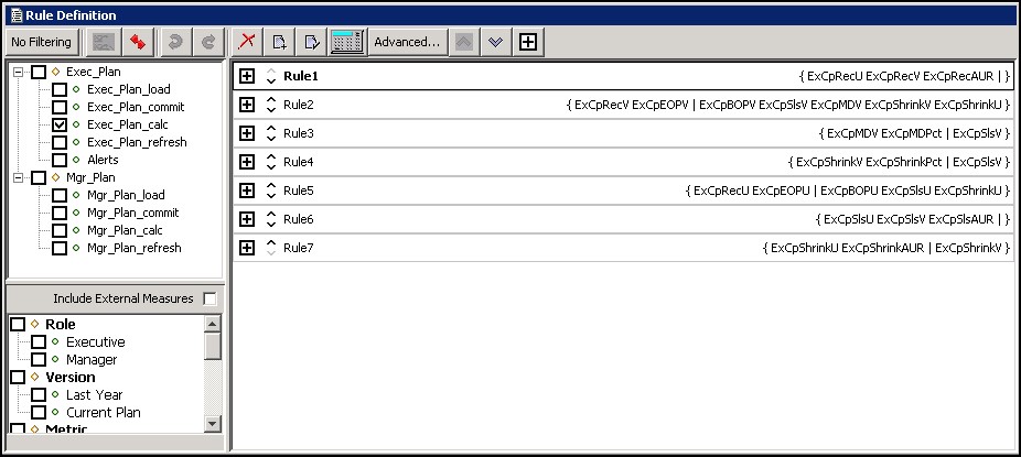

Rule Definition
The Rule Definition tool allows the configuration administrator to define, organize, and manage rule sets, rule groups, and rules. It also allows for the creation of expressions and addition of expressions to rules.
Rules are groups of expressions that describe the relationship between measures.
When a rule has multiple expressions, those expressions are given a priority sequence to help the calculation engine select a calculation path that follows business priorities. When given a choice, the calculation engine will always select the highest priority expression in the rule that is available to be selected. Considerable care should be taken in the design of rules to ensure that appropriate expression priorities are established. The business priority may vary from implementation to implementation, and it may vary from one type of plan to another in the same implementation.
Rules are also given a priority sequence within a rule group to help the calculation engine select a calculation path that follows business priorities. When given a choice, the calculation engine will always select the highest priority rule that needs to be calculated.
Those who are configuring the calculation requirements of a solution are expected to fully understand the operation of the RPASCE calculation engine.

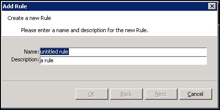

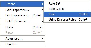

Create a Rule and Add It to a Rule Group
Complete the following steps to create a rule and add it to a Rule Group.
In the Rule Definition window, select the rule group in which you want to create a rule. If you want the rule to be created in a particular position in the sequence of rules in the rule group, select the rule before which you want the new rule to be placed. The new rule will be created higher than the selected rule.
From the toolbar, click New and select Rule.
Click Create..., then Rule from the right-click menu.
Press Ctrl+R.
The Figure 4-36 opens.
In the Name field, enter the name of the rule.
A rule name can be a maximum of 24 alphanumeric or underscore characters. It must not have a name that is the same as any other rule that exists in the project. Rule names may start with a letter or an underscore but may not start with the letter r or R followed by a number.
In the Description field, enter a description of the rule.
Click Next. The Expression Builder window of the Add Rule window opens.

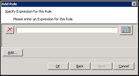

Figure 4-37 Specify Expression for Add Rule
Description of "Figure 4-37 Specify Expression for Add Rule" -

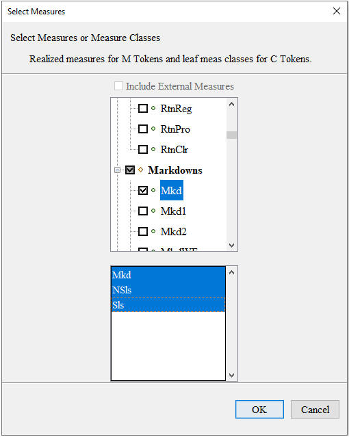

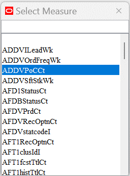

Type the expression in the input box or complete the following to use the Expression Builder.

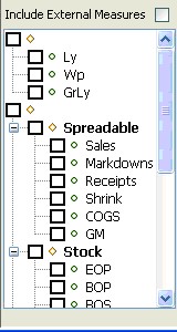

Click Expression Builder (located to the right of the text box). The Expression Builder window opens.
In the upper left-hand pane, select the measure components to filter measures to be visible for pasting into the expression. If External Measures are required in the expression, check the Include External Measures check box. Realized measures meeting the filtering conditions are displayed in the lower left-hand pane.
Figure 4-39 Include External Measures Check Box
Description of "Figure 4-39 Include External Measures Check Box" -
In the lower left-hand pane, double-click any measures to be used in the expression to get the measure name pasted at the insertion point in the expression.

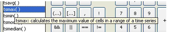

Place the mouse over the name of a function, procedure, keyword, or modifier to see a tooltip that explains its function.
From the drop-down list, select a category of functions, procedures, keywords, or modifiers. Double-click on a specific function, procedure, keyword, or modifier to be used in the expression, and (if appropriate) outline syntax pasted at the insertion point in the expression.

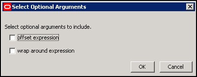

The outline syntax of a function, procedure, keyword, or modifier is pasted with components of the syntax separated with braces {}. When the insertion point is in a component of the outline syntax in the expression, you will see a description of the component at the bottom of the expression window. When the insertion point is in a component of the outline syntax, anything that is entered or pasted replaces the whole component.
If the function, procedure, keyword, or modifier that is pasted has optional arguments (for example, the cover function has optional arguments for an offset expression and a wrap-around expression), you will be presented with the following window to select which of the optional arguments to use in the expression. Note that all arguments are positional, so if a later argument is selected, all earlier arguments will be automatically selected. If an earlier argument is cleared, then all later arguments are automatically cleared.
Figure 4-44 Select Optional Arguments Window
Description of "Figure 4-44 Select Optional Arguments Window"If the function, procedure, keyword, or modifier that is pasted has repeating arguments (for example the min function finds the minimum of a variable number of expressions), a window opens to select how many of the repeating arguments to use in the expression.
Use the keyboard or buttons to add the appropriate mathematical operators and constants to construct the expression.
When you have defined the expression as needed, click Finish and close the window.
If an invalid expression is created, a warning message is displayed.
To add further expressions to the rule, click Add, and repeat the process of entering an expression.

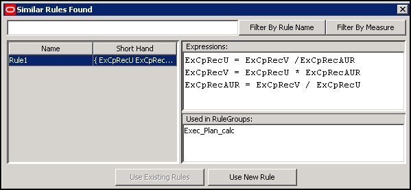

If the newly defined rule's expressions use exactly the same measures as another rule that already exists in the Rule Pool, the Figure 4-45 opens. The window shows all rules that use exactly the same measures as the newly defined rule. This provides you with an opportunity to use an existing rule from the Rule Pool or to continue with the new rule. The Similar Rules Found window allows you to view rules, associated expressions, and rule groups that contain the rules. The rule table may be filtered based on the rule name or by measure. Click Use Existing Rule or Use New Rule to save changes and close the window.
The new rule is placed preceding the rule that was selected at the start of the process in the sequence of rules in the rule group or at the end of the rule group if no rule was selected.
If Use Existing Rule or Use New Rule is not selected and the window is closed manually, a new rule is created.

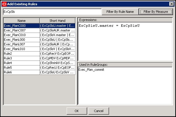

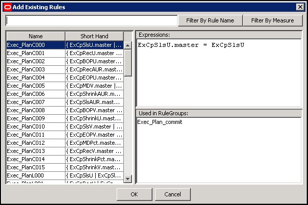

Add an Existing Rule to a Rule Group
Using the Add Existing Rules window, you may select multiple rules to add to a rule group. If at least one of the selected rules is already in the rule group, the OK button will gray out disallowing the operation until that rule is cleared. When multiple rules are selected, the expression and rule group displays will go blank. However, if there is only one selected rule, the rule's expressions and the list of rule groups that use the rule will be displayed.
In the Rule Definition window, select the rule group to be used to add an existing rule. If the rule is to be placed in a particular position in the sequence of rules in the rule group, select the rule in which the new rule is to precede.
From the toolbar, click New and select Using Existing Rule.
Select Create – Using Existing Rule from the right-click menu.
Press Ctrl+P.
The Figure 4-46 opens.
Filter by Rule Name or by Measure and view the associated expressions to find the correct rule. Filtering means that all data are compared, but only matching data is allowed to pass through. In order to filter by Rule Name or by Measure, type a filter string (for instance, ExCpSls in the input box directly under the Title Bar. Click Filter by Measure, and only those measures with ExCpSls display.
Click the rule in the table to select it.
Click OK to save changes and close the window.
The rule is placed higher than the rule that was selected at the start of the process in the sequence of rules in the rule group or at the end of the rule group if no rule was selected.

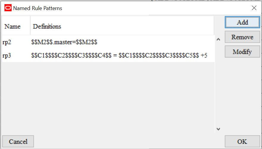

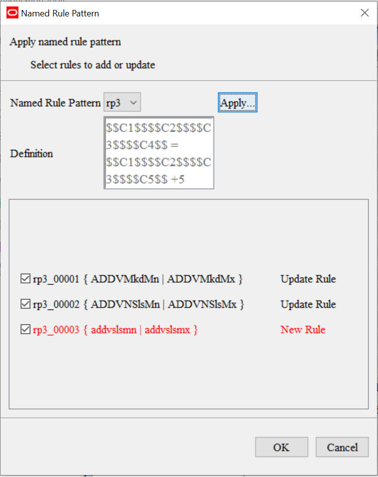

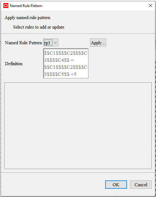

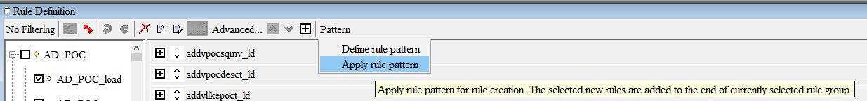

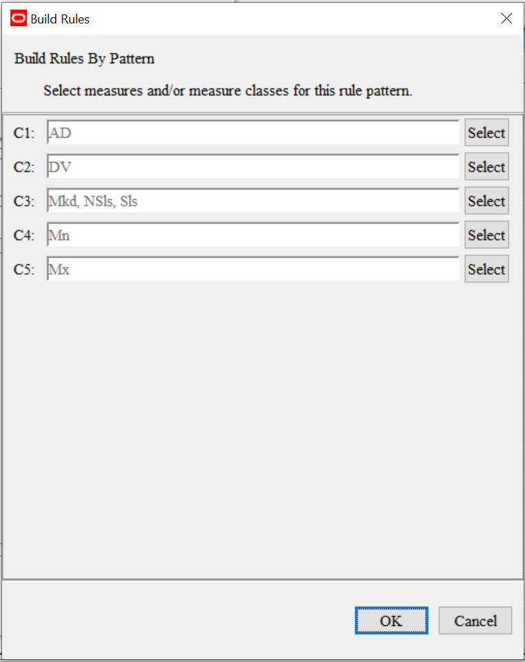

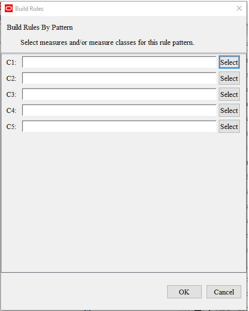

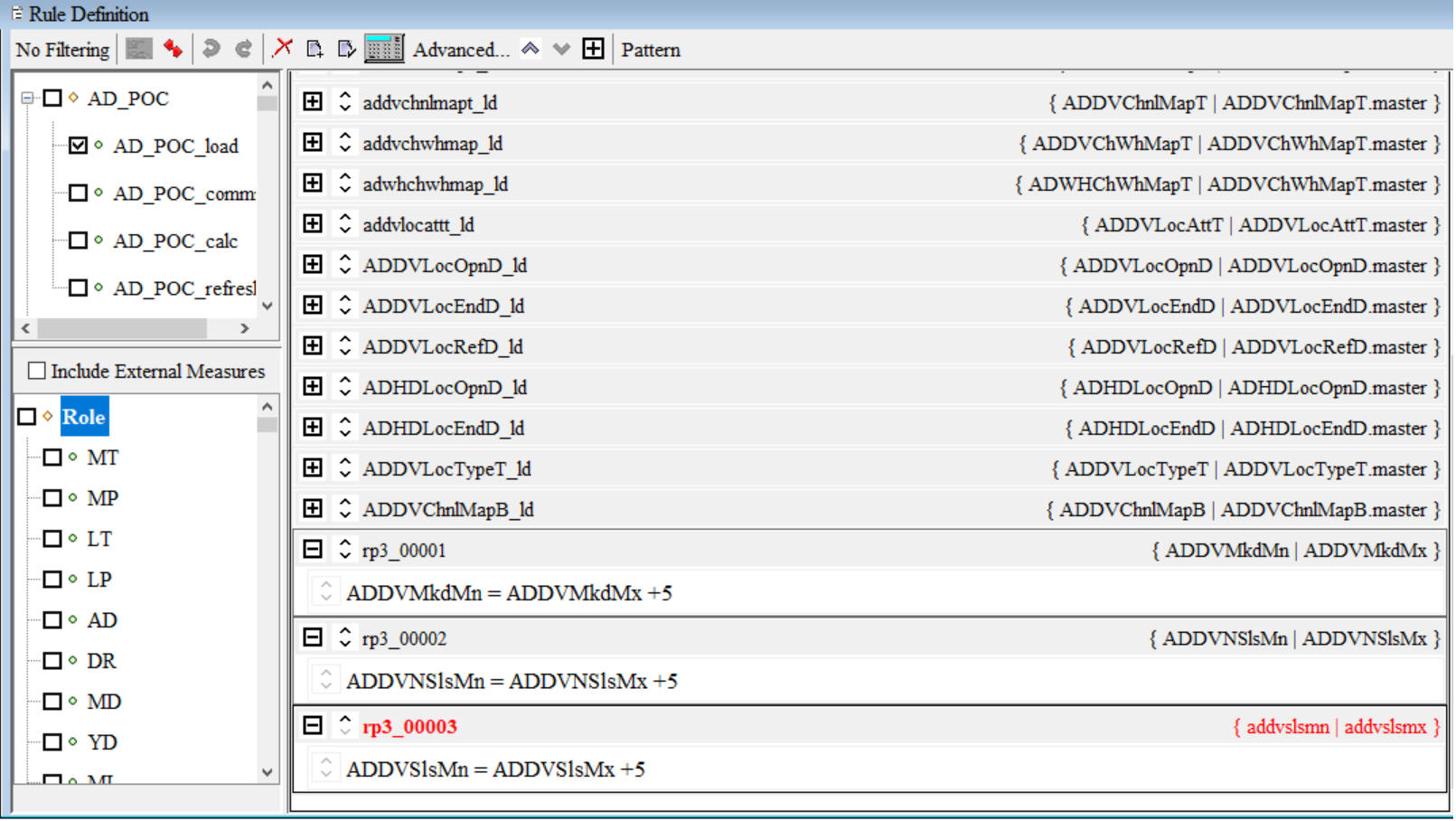

Apply a Rule Pattern to Create New Rules or to Update Existing Rules
The Apply Rule Pattern functionality allows you to create new rules or update existing rules according to a pattern established by a selected base or template rule. The rule tool recognizes inherent similarities or patterns in measure components used in some rules when compared to the base or template rule. Based on these similarities, the rule tool allows for the creation of new rules or update of existing rules to fit the pattern set by the base or template rule.
When the Apply Pattern capability is enabled, there is a possibility that some of the New or Updated rules will have the same expressions as a rule that already exists in the rule pool. If this happens, the Similar Rules Found window opens and provides the option of using the existing rule or actually creating a new one.
In the Rule Definition window, select any rule group that contains the rule to use as the pattern basis.
Select the rule whose pattern is to be used as a basis for creating or updating rules.
From the toolbar, click Advanced and then select Apply Pattern, or right-click and select Advanced and then, Apply Pattern.
A Figure 4-48 opens containing a set of rules that are presented for selection. This set is composed of rules whose measures follow the selected rule's pattern in terms of the individual measure components used. The set of rules are composed of potential new rules or potential updated rules.
You can click the four corners of the Apply Rule Pattern window to see the resize arrow. You can resize the window by dragging the arrow.
Example:
Consider a configuration with three components in the measure naming scheme:
a version (such as Wp)
a metric (such as Shrink)
a unit of measure (such as V)
If the selected base rule is:
{ WpShrinkU WpShrinkAUR | WpShrinkV }
...then the rules:
Rule1: { WpSlsU WpSlsV WpSlsAUR | }
...and
Rule2: { WpRecU WpRecV WpRecC | }
