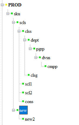

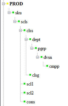

The following example shows PROD hierarchy in original configuration, and some changes made to it.
Figure 6-1 shows the original configuration.
Figure 6-2 shows an example of adding new dimensions (new, new2) to construct a new branch off the existing hierarchy.

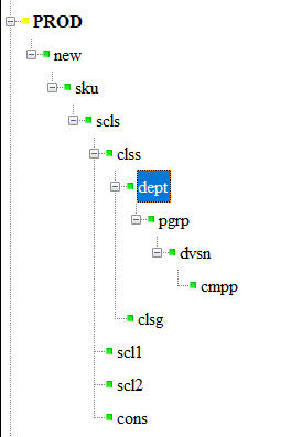

Figure 6-3 and Figure 6-4 show more examples of adding new dimensions in two cases.
Figure 6-3 Adding New Dimensions - Example 1
Description of "Figure 6-3 Adding New Dimensions - Example 1"
Figure 6-4 Adding New Dimensions - Example 2
Description of "Figure 6-4 Adding New Dimensions - Example 2"
