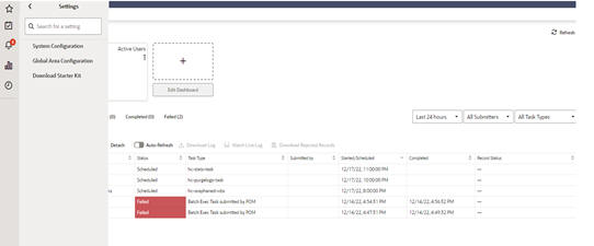

System Configuration
System Configuration provides administrators with the capability to update client-side system properties from the application. The administrator can now update various properties relating to administration status tasks, alert, chart, dashboard, export, image, logging, and separators, and format properties from the application. This feature lets you manage and support your team's operational needs.
The administration user can access the self-service feature from the Settings icon available at the bottom of the left sidebar menu.
Figure 16-1 Self-Service Feature
Description of Figure 16-1 follows
Description of "Figure 16-1 Self-Service Feature"

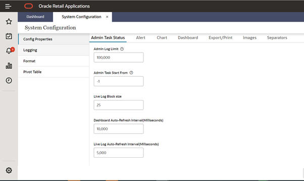

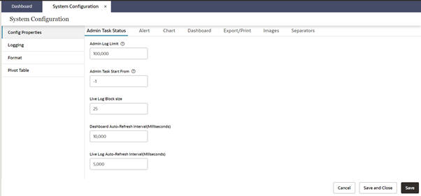

Admin Task Status
Use this tab, shown in Figure 16-3, to update the properties related to administration task status. The following properties can be updated:
  • Admin log Limit - Specify the number of lines in the administration logs. The range of permitted values is between 5,000 and 200,000.
  • Admin Task start from - Define the logging start from start (0) or end (-1) of the file.
  • Live Log Block Size - Enter the block size of the live log. The range of permitted values is between 20 and 30.
  • Use short name for entities - Toggle button to indicate whether you require short names for the entities in the status.
  • Dashboard Auto-Refresh interval - Update the auto-refresh interval time for the administration dashboard in milliseconds. The range of permitted values is between 1,000 and 86,400,000.
  • Live Log Auto-Refresh interval - Update the auto-refresh interval time for the live log. This is in milliseconds. The range of permitted values is between 1,000 and 86,400,000.

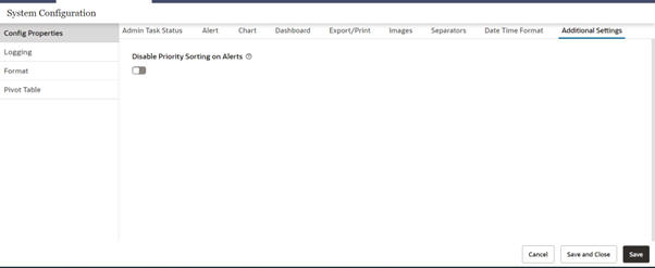

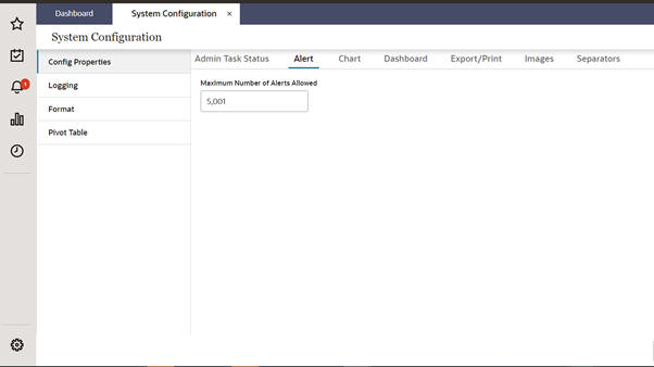

Alert
Use this tab, shown in Figure 16-4, to update the alert properties. You can update the maximum number of alerts allowed. The range of permitted values is between 1,000 and 10,000 alerts.
By default, the alerts displayed in the Select drop-down list are sorted by the ascending order of priority assigned to each alert during alert configuration. To change the default behavior, enable the Disable Priority Sorting on the Alerts property in Systems Configuration. You access this property in the Additional Setting Tab under Oracle Support Administration. The default setting for Disable Priority Sorting on Alerts is false. When default sorting is disabled, the alerts will be sorted as defined in the setting value of Disable Default Sorting.
Figure 16-5 Disable Priority Sorting
This image shows disable priority sorting.

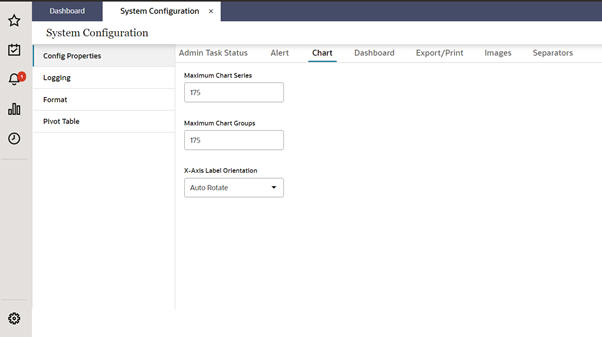

Chart
Use this tab, shown in Figure 16-6, to update the chart properties. The following properties can be updated:
  • Maximum chart series - The maximum number of series allowed in charts. The range of permitted values is between 100 and 200.
  • Maximum chart group - The maximum number of groups allowed to plot in charts. The range of permitted values is between 100 and 200.
  • X-axis Label Orientation - Select x-axis label orientation. The auto-rotate option is used to select the orientation of the x-axis labels, depending on the number of items in charts. The horizontal orientation option is used to display the x-axis label horizontally.

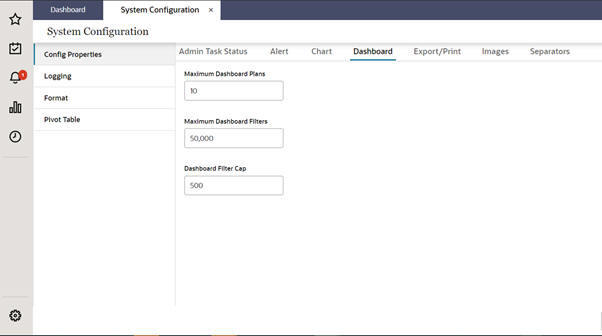

Dashboard
Use this tab, shown in Figure 16-7, to update the properties related to dashboards.
  • Maximum Dashboard Plans - The maximum number of plans for a dashboard. The range of permitted values is between 0 and 50.
  • Maximum Dashboard Filter - The maximum number of filters permitted in a dashboard. The range of permitted values is between 0 and 100,000.
  • Dashboard Filter Cap - The filter cap for a dashboard. The range of permitted values is between 0 and 1,000.

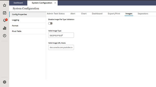

Images
Use this tab, shown in Figure 16-9, to update the following image-related properties.
  • Disable Image file type Validation - Toggle button to indicate whether or not you require file type validation for the images in your system.
  • Valid image type - The image file types that are valid for your application.
  • Valid Image URL hosts - The valid URL hosts for your application.

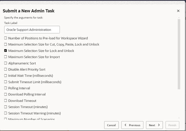

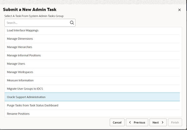

Maximum Selection Size for Lock and Unlock
From Submit Admin Task, select Oracle Support Administration and click Next. Then, select Maximum Selection Size for Lock and Unlock and click Next and then Submit.
Figure 16-11 Maximum Selection Size for Lock and Unlock
This image shows the maximum selection size option.
Once the task is complete, you can update the setting in the System Configuration screen.

Maximum Selection Size for Cut, Copy, Paste
From Submit Admin Task, select Oracle Support Administration and click Next. Then, select Maximum Selection Size for Cut, Copy, Paste and click Next and then Submit.
This sets the maximum selection size for lock and unlock operations. The range of permitted values is between 5,000 and 15,000. The default value is 8500.

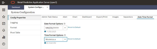

Date Time Format
This tab provides a Date Format option and a Time Format option.

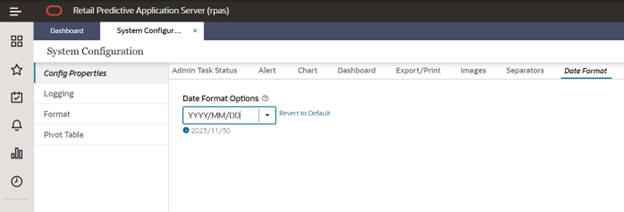

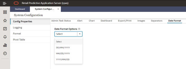

Use the Date Format option to specify a global date format that overrides the format specified in the application. The format selected is applied to the application for all users. Three formats are available:
  • DD/MM/YYYY
  • MM/DD/YYYY
  • YYYY/MM/DD
Figure 16-15 Date Format OptionThis image shows the date format tab.
When the user applies the date format, the change is applied to the Pivot Table, the Recent Plan, the Last Commit (bottom bar), and the Admin Dashboard.
When you select an option, the sample date format to be applied is displayed.
Figure 16-16 Sample Date OptionThis image shows a sample date option.

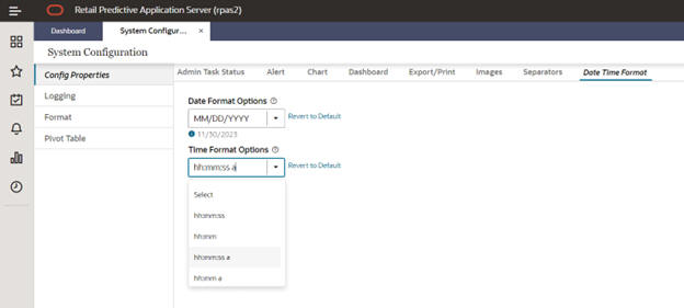

The Time Format option provides a global format settings for time that is independent of language of application. The user can change the time format as required and the selected format will be applied to the application for all users.
A user can select one of the four time formats from the drop-down list to override the time format in the application:
  • hh:mm:ss
  • hh:mm
  • hh:mm:ss a
  • hh:mm a
Figure 16-17 Time Format Option
This image shows the time format option.
The format the user selects are applied to:
  • Pivot Table
  • Last Commit (bottom bar)
  • Admin Dashboard
Selecting an option also displays the sample time format that will be applied.
Figure 16-18 Sample Time Format
This image shows the sample time format.

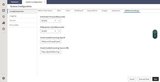

Additional Settings
This tab, shown in Figure 16-21, is hidden by default and can be accessed via Online Admin Tools.
  1. Launch Online Admin Tools and select the System Admin Tasks. Click Next.
  2. Select Oracle Support Administration, as shown in Figure 16-19.
    Figure 16-19 Oracle Support Administration
    Description of Figure 16-19 follows
    Description of "Figure 16-19 Oracle Support Administration"

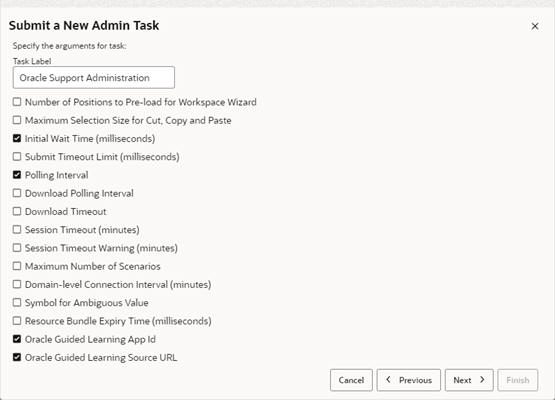

  3. Select the appropriate settings, as shown in Figure 16-20, and submit the task.
    Figure 16-20 Oracle Support Administration Settings
    Description of Figure 16-20 follows
    Description of "Figure 16-20 Oracle Support Administration Settings"

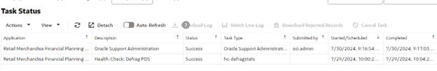

  4. Once the task is complete, the Additional Settings tab, shown in Figure 16-21, becomes visible and the settings/configuration properties selected in the task are available.
    Figure 16-21 Additional Settings Tab
    Description of Figure 16-21 follows
    Description of "Figure 16-21 Additional Settings Tab"
Oracle Guided Learning
Customers can realize their cloud application's value more quickly with Oracle's Digital Adoption Platform, Oracle Guided Learning (OGL). OGL accelerates user adoption with guided and contextual learning and also helps to manage continuous business change. In an OGL-enabled environment, users will see guided content from Oracle.
Customers can further customize the content as per their business need. There are two new properties under Additional Settings to configure for OGL, shown in Figure 16-20:
  • Oracle Guided Learning App ID- the unique identifier for your OGL account
  • Oracle Guided Learning Source URL - source from which to pull the guides and content

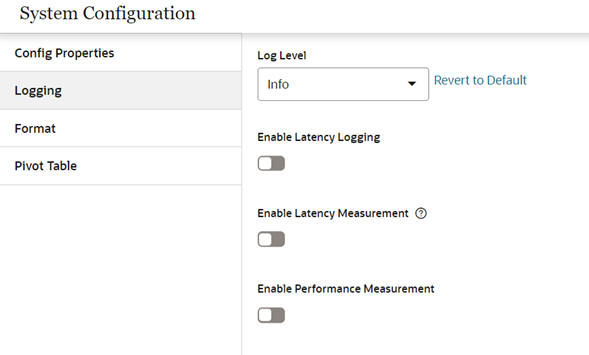

Logging

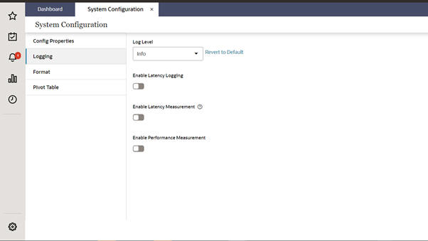

Use this tab, shown in Figure 16-22, to set the log level and enable/disable latency-logging, latency-measurements, and performance-measurements. You must save and log in again in order for the changes to take effect.
Log Level
Use the log level drop-down list to select appropriate log levels. The RPASCE Client application supports the following log levels.

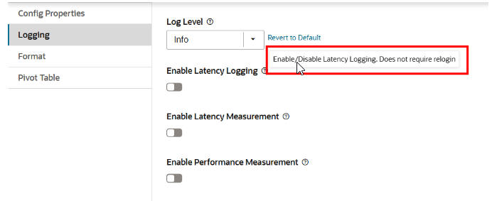

Enable Latency Logging
Use the toggle button to enable or disable latency logging. Once enabled, the network latency from the user browser to the application is measured and logged at defined intervals. This can help the customer administrator to work with Oracle support on any network latency-related performance issues.
Enable Latency Measurement

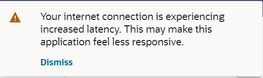

Use the toggle button to enable or disable latency measurement. Latency measurements depends on Latency Logging and so that must also be enabled, along with latency measurements.
Once this is enabled, users will see the following warning when their network latency exceeds certain thresholds.
Figure 16-23 Network Latency Warning
Description of Figure 16-23 follows
Description of "Figure 16-23 Network Latency Warning"

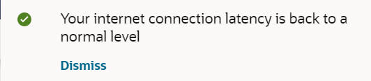

They will see the following information once their network latency returns to normal.
Figure 16-24 Normal Network Latency
Description of Figure 16-24 follows
Description of "Figure 16-24 Normal Network Latency"
Enable Performance Measurement
Use the toggle button to enable or disable performance measurement. Once this is enabled, the performance timing icon appears on the left task menu (after the user logs in again). The performance values for the current user can be exported or displayed using appropriate sub-menu links.

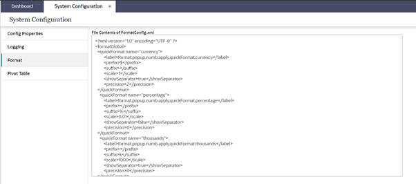

Format
Use this tab, shown in Figure 16-25, to change the FormatConfig.xml file, which controls the formatting properties for the application (that is, currency, percentage, and millions separator).
To save your changes, click Save or Save & Close.
To apply the saved changes, you must re-log into the application.
Figure 16-25 File Contents of FormatConfig.xml
Description of Figure 16-25 follows
Description of "Figure 16-25 File Contents of FormatConfig.xml"

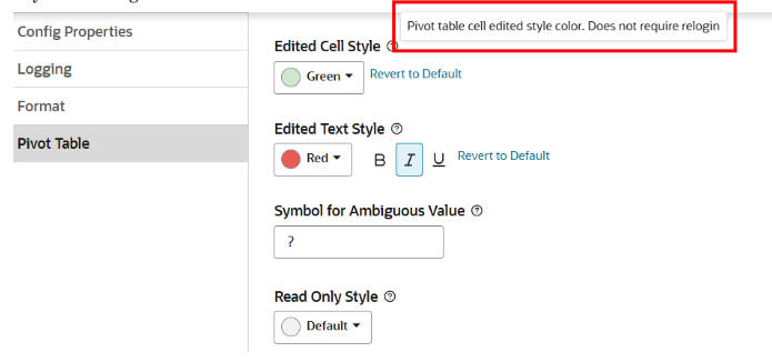

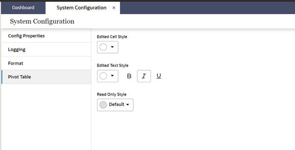

Use this tab, shown in Figure 16-26, to change the format style of edited uncalculated cells. You can update the color of the edited cell background, edited cell text color, and style.
Note the following:

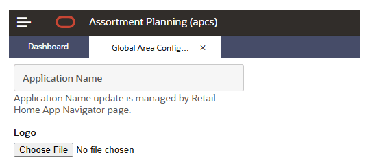

Global Area Configuration
The Global Area Configuration page allows an administration user to configure certain components of the branding area, including the application name and the logo.
The PLATFORM_SERVICES_ADMINISTRATOR_ABSTRACT group must be assigned to the user in IDCS or OCI IAM or the user will experience a 403 forbidden error after attempting to save.
Figure 16-27 Global Area Configuration Page
The Global Area Configuration page can be reached through the Settings menu (from Settings go to System Configuration then go to Global Area Configuration). The application name update is centrally managed within Retail Home, while the logo can be updated from this screen. After making changes, click Save or Save and Close to apply the updated logo. To revert to the default logo, remove the custom logo and click Save.

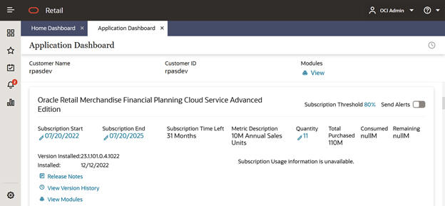

Monitoring Subscription Usage in Retail Home
All Oracle Retail cloud service subscriptions include a subscription metric that defines in some way the capacity of the systems provisioned as a part of the subscription. The actual metric varies across Oracle Retail cloud services.
For RPASCE applications, the subscription metric is tens of millions of annual sales in units, or 10M annual Sales Units, as it often appears.Users with administrative rights for Retail Home can view information on the quantity of units defined for their subscription and see information on actual usage over time for RPASCE application subscriptions (and any other Oracle Retail cloud service subscriptions) as well as for the AI Foundation component that is a part of every Oracle Retail cloud service subscription.This information is accessible on the Application Dashboard screen of Retail Home, shown in Figure 16-29.
Figure 16-29 Retail Home Application Dashboard
Description of Figure 16-29 follows
Description of "Figure 16-29 Retail Home Application Dashboard"
For more information on accessing the Application Dashboard, as well as information on the information presented on that screen, refer to the chapter "Application Dashboard" of the Oracle Retail Home Administration Guide.

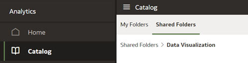

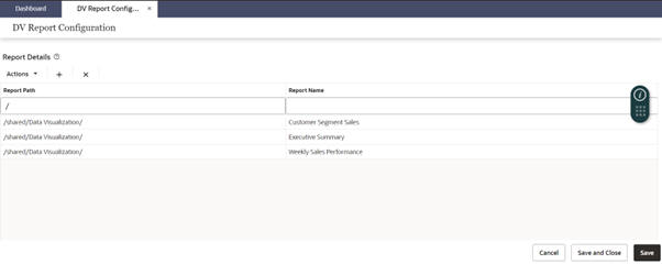

DV Report Configuration
An administrative user can use the DV Report Configuration page to configure Data Visualization (DV) Reports that are created in the Oracle Analytics DV Environment. The user can add, rename, and delete DV Reports. The user can access the DV Report Configuration feature from the Settings icon available at the bottom of the left sidebar menu, as shown in Figure 25.
Figure 16-30 DV Report Configuration
This image shows the dv report configuration
Indicators for Report Details provide a brief description of report path and report name properties. Log into the Oracle Analytics DV environment to obtain the report path and report name. DV Reports in the Oracle Analytics environment are stored with or without subdirectories under My Folders or Shared Folders as the parent directory. The report path for the Shared Folders starts with /shared and My Folders starts with /users.
Figure 16-31 DV Report Environment Path
This image shows the dv report environment path.
You can add and delete reports using either the + / x buttons or the Action menus..
Figure 16-32 DV Reports Adding and Deleting
This image shows adding and deleting functionality for dv reports.
Once you have configured your reports, click Save or Save & Close to save your changes. Note that, o apply the saved changes, you must re-log into the application.
Images and Contextual Help
Valid Hosts: Users can specify a web URL as the source of an image(s) (typically the content management server) or source for contextual help. Due to security reasons, the RPASCE client will only use images or contextual help links from these configured hosts. Users are only allowed to enter URLs from the hosts defined by this setting in System Configuration.
The dimension for which the images are to be displayed must have a dimension attribute measure registered of type string that has the UI Type property set to media. For example, consider that the name of the dimension attribute measure is addvskupimgt for dimension skup. The measure must beloaded into PDS using Load Fact Data.
Each record in the input file is a position ID followed by the image URL wrapped in the <image> tag. The example input file below is in the .csv format and hence named addvskupimgt.csv.ovr.
70063172,"<image id=""main"" label=""Front""><url
size=""thumb"">http://127.0.0.1:7001/contentserver/imgfetch/1000396_Front_full.jpg</url></image>"
73137693,"<image id=""main"" label=""Front""><url
size=""thumb"">http://127.0.0.1:7001/contentserver/imgfetch/CardiganLS.jpg</url></image>"
96880516,"<image id=""main"" label=""Front""><url
size=""thumb"">http://127.0.0.1:7001/contentserver/imgfetch/1000399_Front_full.jpg
88805005,http://127.0.0.1:7001/contentserver/imgfetch/1000378_Front_full.jpg
72939751,http://127.0.0.1:7001/contentserver/imgfetch/1000439_Front_full.jpg
96666402,http://127.0.0.1:7001/contentserver/imgfetch/1000440_Back_full.jpg
The use of the double quotes in the lines above is the standard way of escaping double quotes in any RPASCE measure's csv input files.
Configuration Settings Not Requiring Relogging
The following configuration settings do not require relogging.
Logging Log Level
Format File Contents of FormatConfig.xml
Pivot Table Edited Cell Style
Edited Text Style
Read Only Style
Admin Task Status Admin Log Limit
Admin Task Start From
Live Log Block Size
Examples:
Figure 16-33 Latency Logging
This image shows latency logging.
Figure 16-34 Pivot Table
This image shows pivot table.
