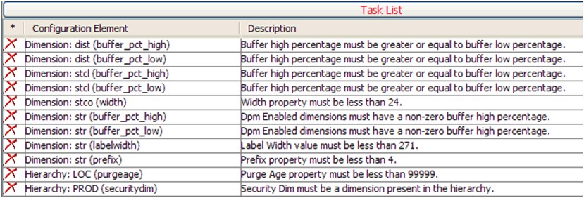

Task List
The Task List provides a centralized view of errors and warnings that are issued as a result of information input by the user. Use the information in the Task List as a guide for correcting errors or omissions in the Project.
The Task List title bar serves as a status indicator. If the title Task List is displayed in red, the Task List contains items that need the user's attention. If there are no errors or warnings, the title will be displayed in black.
The title bar can also be used to show or hide the Task List. If the Task List is visible, click anywhere on the title bar to hide the list and move the title bar to the bottom of the window. If it is hidden, click anywhere on the title bar to display the Task List. The amount of space used by the task list sub-pane can also be changed by dragging the separator located above the task list title bar.
The Task List has three columns:
The first column indicates the nature of the Task List item.
Indicates an error.
Indicates a warning.
The second column identifies the configuration element involved.
The third column provides a detailed description of the issue.
Figure 2-2 shows a sample task list.
Errors typically indicate definite validation problems, which are shown in red in the tool where the configuration setting is made. When the user fixes the erroneous condition, the Task List automatically removes the error listing for that condition. Warnings indicate the possibility of a problem occurring, and the user is advised to inspect the suspected element to ensure that everything is in order. Since warnings are more general than errors the Task List will not remove them automatically. The user is provided with options to remove errors and warnings through a right-click menu.
More validation details could be found in the ConfigTools Workbench log file. The exact location of this log file is in the Cygwin shell where the ConfigTools is run.

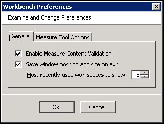

Navigate: From the File menu, select Tools Preferences. The Workbench Preferences window opens.
Perform the following steps to modify the Workbench Preferences.
Select the General tab.
Enable Measure Content Validation – Activating this check box enables the immediate validation of measure properties when configuration measure information is created or modified. This process can impact the performance of the RPASCE Configuration Tools. If this box is not checked, the manual Measure Content Validation icon is enabled on the Rule Definition toolbar. See the Rule Definition Tool for details.
Save window position and size on exit – Activating this check box enables the RPASCE Configuration Tools to be launched in either full or minimized view based on the status in which the configuration administrator last exited the application. If the application is exited in a minimized view, the size of the window is also maintained when the RPASCE Configuration Tools is re-launched.
Most Recently used workspaces to show – Use the up and down arrows to specify the number of configurations to be displayed in the Most Recently Used list displayed in the File menu window. This list allows the configuration administrator easy selection of a recently viewed configuration.

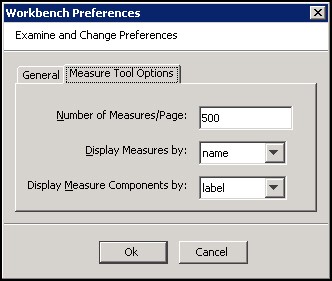

Select the Measure Manager Options tab.
Figure 2-6 Workbook Preferences - Measure Tool Options
Description of "Figure 2-6 Workbook Preferences - Measure Tool Options"-
Number of Measures/Page – Select the number of measures to display per page in the Measure Manager Tool. The default is 500.
Display Measures by – Displays measures either by their name or label in various locations of the Tools. The default setting is name.
Display Measure Components by – Display measure components (in the Measure Manager tool) either by name or by label. The default setting is label.
Click OK to save any changes and close the window.
