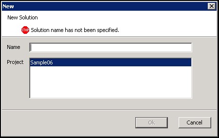

Navigate: From the File menu, select New and then Solution. The Figure 4-1 opens.
  1. In the Name field, enter the name of the solution.
  2. In the Project field, select the project in which the solution is to belong. Multiple projects will be listed if multiple projects are currently open.
  3. Click OK to save any changes and close the window.

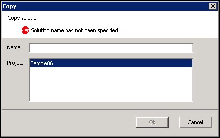

Copy a Solution
Complete the following steps to copy a solution.
  1. Select the solution to be copied.
  2. Right-click in the Configuration Components pane and click Copy. The Copy solution window opens.
    Figure 4-2 Copy Solution Window
    Description of Figure 4-2 follows
    Description of "Figure 4-2 Copy Solution Window"
  3. Type the new name for the solution in the text box.
    This is the name that the solution is called after it has been copied.
  4. Select the project where the solution is to be copied.
  5. Click Finish to save the copied solution in the specified project.

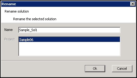

Rename a Solution
Complete the following steps to rename a solution.
  1. Select the solution to be renamed.
  2. Right-click in the Configuration Components pane and select Rename. The Figure 4-3 opens.
  3. Delete the old name from the resulting field and type the new name.
  4. Click OK to save the new name.

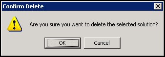

Delete a Solution
Complete the following steps to delete a solution.
Select the solution to be deleted.
Right-click in the Configuration Components pane. The Figure 4-5 opens.
Figure 4-5 Confirm Delete Window
Description of Figure 4-5 follows
Description of "Figure 4-5 Confirm Delete Window"
Click OK to complete the deletion.

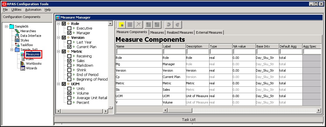

Measures and Components
This section describes:

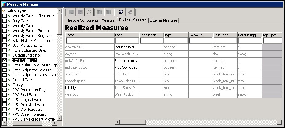

Measure Manager

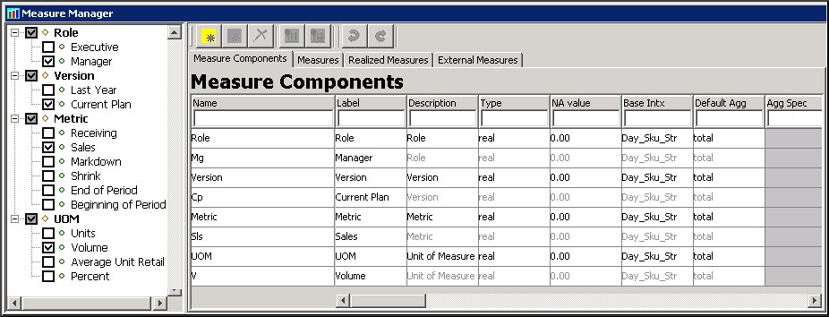

The Measure Manager window allows you to define major and minor components of measures and to specify properties for each component. Once the component structure is defined, the Measure Manager generates measures by combining the components that are selected. You may then select (realize) the valid measures and further update the properties for individual measures.
Figure 4-6 Measure Manager Window
Description of Figure 4-6 follows
Description of "Figure 4-6 Measure Manager Window"

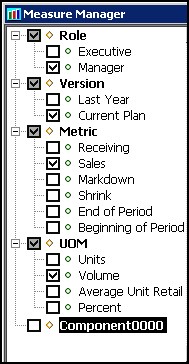

Measure Components
A major component is the highest level in the component inheritance hierarchy. Properties defined at this level are inherited by all minor components that are created under the major component.
Within each major component, you can create one or more minor components. You can also create a minor component under a minor component and also modify properties at the minor component level.
Once major and minor components are defined, the Measure Manager generates measures that are based on the combination of selected components. These measures cannot be used elsewhere in the configuration tools until the valid prototype measures are realized.
Components have no structural impact on the built solutions, and they are not exposed to end users. Components are intended to be a convenience to aid the configuration administrator to easily group measures together and to set measure properties at higher levels.
Component Process
The following steps describe the component process.
  1. Create major components, from which measures are composed.
  2. Create minor components, which are sub-groupings or specific items in a major component.
  3. Define measure properties at the major component level. The minor components will inherit the properties associated with the major component they belong within.
  4. If necessary, modify the measure properties at the minor component level.

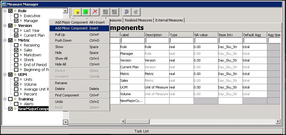

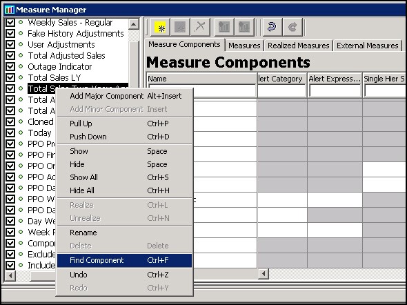

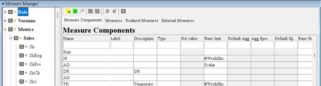

Create a Major Component
Complete the following steps to create a major component.
Navigate: In the Configuration Components pane, select Project then Solution then, Measures and then the Measure Components tab. The Measure Manager window opens in the workspace.
Figure 4-7 Measure Manager Window - Measure Components Tab
Description of Figure 4-7 follows
Description of "Figure 4-7 Measure Manager Window - Measure Components Tab"
  1. Right-click in the left-hand pane of the Measure Manager window and select Add Major Component or click Add Major Component. The major component displays in the Measure Manager navigation tree with a default name.
    Figure 4-8 Measure Manager Navigation Tree
    Description of Figure 4-8 follows
    Description of "Figure 4-8 Measure Manager Navigation Tree"
  2. To change the component name, right-click on the component and select Rename, or select the component from the navigation tree and then modify its Label field from the Measure Components tab.
Create a Minor Component
Complete the following steps to create a minor component.
Figure 4-9 Major Measure Component Selected
Description of Figure 4-9 follows
Description of "Figure 4-9 Major Measure Component Selected"
  1. Select the major or minor component that the new minor component is to be added beneath. In Figure 4-9, NewMajorComponent is selected.
  2. Choose one of the following methods:
    • Right-click the Measure Definition navigation tree and select Add Minor Component.
    • Click Add Minor Component.
    • Press Insert.
    The minor component displays in the Measure Manager navigation tree with a default name.
    Figure 4-10 New Minor Component
    Description of Figure 4-10 follows
    Description of "Figure 4-10 New Minor Component"
  3. To change the name, right-click on the component from the navigation tree and select Rename. You can also select the component from the navigation tree and modify the Label field from the Measure Components tab.

Measure Component Properties
This section describes the fields displayed in the Measure Components tab.
Name
The name (identifier) of a component is used to identify the component within the Configuration Tools. Measure names are built by concatenating the names of the components from which the measure is built. They are concatenated in the order (from top to bottom) of the sequence that the components display in the list of components. You can override the measure name by manually entering a new name in the Name field. Measure names can be up to 30 characters in length. They can include letters and numbers but must start with a letter.

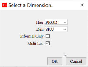

Single Hier Select
This property is only valid for components that have a Type (data type) of string and non-picklist. It specifies that cell contents are to be entered by users using the Single Select Widget. This is a widget in the RPASCE Client that presents the end user with a view of the positions along the dimension set in the configuration. The user may then select any single position. When a user double clicks the Single Hier Select field, a Select a Dimension window pops up where the user must select the hierarchy and dimension whose positions will be displayed to the user in the RPASCE Client.
Figure 4-12 Select a Dimension Window
Description of Figure 4-12 follows
Description of "Figure 4-12 Select a Dimension Window"

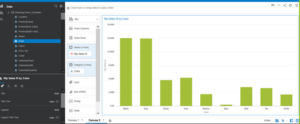

Enable Viewing Fact Data by Dimension Attributes in Data Visualization (DV)
To provide better support for attribute analysis, users can use RPASCE attributes as DV attributes when creating reports and visualizations. Either a one-dimensional or a two-dimensional attribute is used to join with other fact views in DV. The attributes are used to group data in a series, and the columns of a data source are treated as either metrics or attributes. See "Create Reporting Views in PDS" in the Oracle Retail Predictive Application Server Cloud Edition Administration Guide for details.
Figure 4-14 An Example of Viewing Sales Data by Color Attributes in DV
This image shows an example of viewing sales data by color attributes in DV.
The one-dimensional and two-dimensional attribute measures must have the Report Category values configured; the following assumptions and requirements apply.

Find a Component
  1. Right-click in the Measure Manager navigation tree and select Find Component. The Input window opens.
    Figure 4-15 Find Component Menu Option
    Description of Figure 4-15 follows
    Description of "Figure 4-15 Find Component Menu Option"
  2. Type in the name of the desired component and click OK. The tree will scroll to bring the specified component into view.
  3. Select the desired component.
    The full name (case sensitive) of the component is required in order to find it. If there is no component with the exact name entered, the tree will not scroll.
Rename a Component
Navigate: From the Measure Manager navigation tree, select the component to be renamed.
  • Right-click in the Measure Manager navigation tree and select Rename. Type the new name for the component.
  • Double-click the component and type the new name.
  • Select and change the name of the component in the Measure Component tab.
Changing the name of a component results in a change in the name of any measure that inherits from the component unless the measure has overridden the name property.

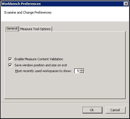

Disabling Measure Content Validation
For some cases you may disable the full validation (for instance, when performing a number of changes to measure properties that require switching back and forth between multiple tools). Validation can then be manually initiated from the Rule Definition window by selecting Perform measure content validation from the Rule Definition toolbar. Complete the following procedure to turn off real-time validation.
  1. Select File and then Tools Preferences. The Workbench Preferences window opens.
    Figure 4-17 Workbench Preferences – General Tab
    Description of Figure 4-17 follows
    Description of "Figure 4-17 Workbench Preferences – General Tab"
  2. Clear the Enable Measure Content Validation check box.
  3. Click OK.

Measure Manager Overview
The Measure Manager allows you to create and name measures by selecting major and minor components that are already defined. By default, the measures inherit the properties that are defined for the components. To create a measure, select the components that will be used to construct measures. The Measure Manager will generate measures for all of the combinations of selected components. This saves you from the tedious task of manually creating all required measures.
Figure 4-18 Measure Manager Components
Description of Figure 4-18 follows
Description of "Figure 4-18 Measure Manager Components"
You may then override the properties for individual measures by entering them the same way as on the Measure Components tab. Once properties are overridden at the measure level, changes made at the component level will no longer spread down to that measure as it will retain the overridden value. An overridden value can also be restored to its inherited value or you may override an inherited value to be unspecified.
When a measure is auto-generated by the Measure Manager, it cannot be edited or used in any other configuration component such as rules and workbooks until it is realized. A measure does not need to be realized if it is not going to be used.
The Measures tab displays all auto-generated measures for the selected components.

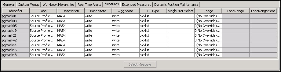

Figure 4-19 Measure Manager Measures Tab
Description of Figure 4-19 follows
Description of "Figure 4-19 Measure Manager Measures Tab"

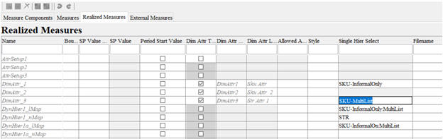

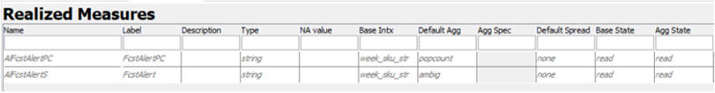

The Realized Measures tab only displays those measures that are realized.
Figure 4-20 Measure Manager Realized Measures Tab
Description of Figure 4-20 follows
Description of "Figure 4-20 Measure Manager Realized Measures Tab"
Realized and Unrealized Measures
Complete the following steps to access the Measure Manager window - Measures Tab.
Navigate: In the Configuration Components pane, select Project, then Solution, and then Measures. The Measure Manager window opens in the workspace.
  1. Select the Measures tab.
    Figure 4-21 Measure Manager Measures Tab
    Description of Figure 4-21 follows
    Description of "Figure 4-21 Measure Manager Measures Tab"
  2. In the components tree, select the check boxes for the components that will be filtered. The Measure Manager will show measures using all the combinations of selected components. This process filters the list of prototype measures that are shown from all combinations of components to the combinations of components that have been selected. It uses those components to determine which prototype measures to show.
Realizing a Measure
  1. Select the components that are used for the measures to be realized.
  2. Select the check box in the Realized column for each auto-generated measure to be realized.
Unrealizing a Measure
  1. Select the components that are used for the measures to be unrealized.
  2. Clear the check box in the Realized column for each auto-generated measure to be unrealized.
Rename a Measure
  1. Select the components that are used in the measures to be renamed.
  2. In the Measures tab, or the Realized Measures tab, click the name of the measure that is to be renamed.
  3. Type the new name for the measure.
    The measure must be realized before it can be renamed.
Show All Measures
Right-click in the Measure Manager window and select Show All.
Due to memory constraints when working with very large numbers of components, all auto-generated measures may not be displayed. In this case, the configuration administrator will receive an error message indicating that some measure components should be cleared.
Hide Measures by Component
  1. In the Measure Manager window, select the Measures tab.
    • Clear the check boxes next to the components to hide.
    • Select the component used in the measures to hide.
  3. Right-click in the Measure Manager navigation tree and select Hide or press the spacebar.
Hide All Measures
  2. Right-click the Measure Manager navigation tree, and select Hide All.
Sort Measures by Property Value
In the Realized Measures tab, measures can be sorted by property value.
  1. Select the Realized Measures tab.
  2. Hold down the control key (Ctrl) and click in the filter field at the top of the table for the property of the measures to be sorted.
    The measures are sorted in alphabetical order according to the value of the property.
Filter Measures by Property Value
In the Realized Measure tabs, the configuration administrator can filter measures by property value.
  1. In the Realized Measures tab, click in the filter field at the top of the table for the property of the measures to be filtered.
  2. Enter the value on which ti filter the measures.
    This field is case sensitive.

Figure 4-22 Measure Manager External Measures Tab
Description of Figure 4-22 follows
Description of "Figure 4-22 Measure Manager External Measures Tab"
Within the Measure Selectors present in the Rule and Workbook tools and the Expression Builder, there is a check box named Include External Measures. When this check box is selected, the Measure Selector will include those measures that were imported into the solution in addition to those that are present due to component selections in the Measure Selector.
The following properties may be overridden for an external measure:
  • Label
  • Description
  • Base State
  • Agg State
  • UI Type
  • Range

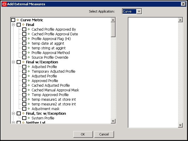

Import a Measure
You may only import a measure into a solution for a project that has at least one other solution.

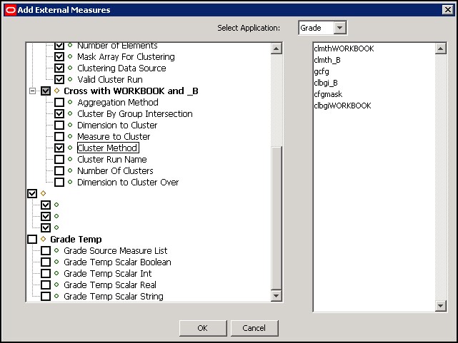

  1. Select the External Measures tab, and click Import Measure on the toolbar. The Figure 4-23 opens.
    Figure 4-23 Add External Measures Window
    Description of Figure 4-23 follows
    Description of "Figure 4-23 Add External Measures Window"
  2. In the Add External Measures window, select the solution in which the desired measure is defined.
  3. Use the measure selector (left-hand side) to select the measures to import.
    Figure 4-24 Selecting Measures to Be Imported
    Description of Figure 4-24 follows
    Description of "Figure 4-24 Selecting Measures to Be Imported"
    External measures that are already imported display in bold.
  4. From the right-hand list, select the measure to import and click OK. The selected measures display in the External Measure tab.

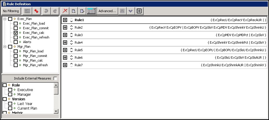

Navigate: In the Configuration Components pane, select Project, then Solution, and then Rules. The Rule Definition window opens in the workspace.
Figure 4-25 Rule Definition Window
Description of Figure 4-25 follows
Description of "Figure 4-25 Rule Definition Window"

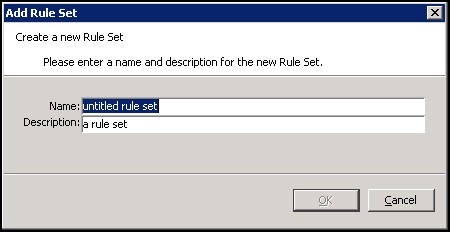

  1. From the toolbar, click New and select Rule Set, or select Create/Rule Set from the right-click menu. The Figure 4-26 opens.
    Figure 4-26 Add Rule Set Window
    Description of Figure 4-26 follows
    Description of "Figure 4-26 Add Rule Set Window"
  2. Complete the following:
    1. In the Name field, enter the name of the rule set.
      A rule set name can be a maximum of ten alphanumeric or underscore characters. It must not have a name that is the same as any other rule set that exists in the project.
    2. In the Description field, enter a description of the rule set.
    3. Click OK to save any changes and close the window. The rule set displays in the Rules navigation tree.

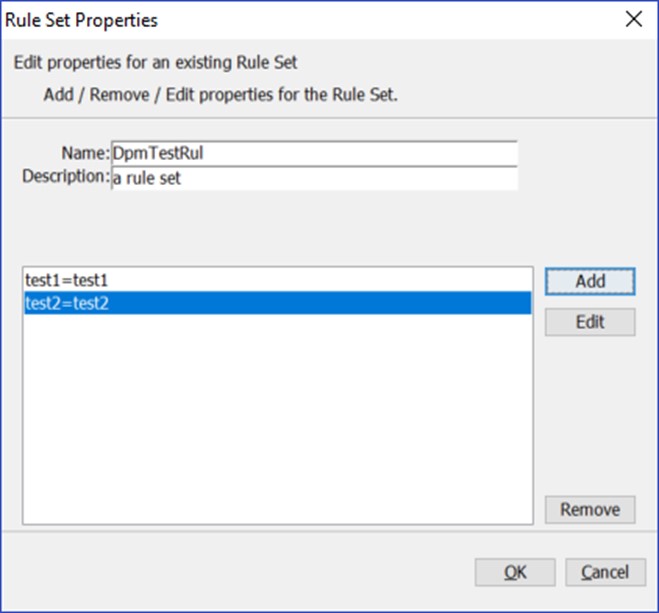

Edit Rule Set Properties
  1. In the Rule Definition window, select the rule set, right click, select Edit Properties, then select Rule Set. The Rule Set Properties Window opens in the workspace.
    Figure 4-27 Rule Set Properties Window
    Description of Figure 4-27 follows
    Description of "Figure 4-27 Rule Set Properties Window"

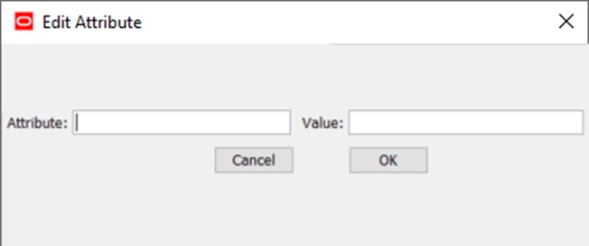

  2. In the Rule Set Properties window, Click Add to open the Edit Attribute window in order to add a new rule set attribute.
    Figure 4-28 Rule Set Edit Attribute Window
    Description of Figure 4-28 follows
    Description of "Figure 4-28 Rule Set Edit Attribute Window"
  3. To edit an existing rule set attribute, select the attribute/value pair and then click Edit. The Edit Attribute window opens in the workspace. The window is pre-populated with the selected rule set attribute and value that the users can edit.
  4. To remove an existing rule set attribute, select the attribute/value pair and then click Remove.

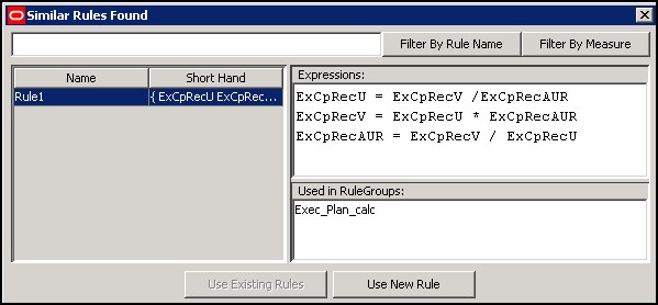

Within a solution, there may be many rules defined, and each rule is validated individually. Rules within a rule group are also validated in the context of all the other rules in that rule group. While a rule may be perfectly valid syntactically, it may not be valid within the context of a particular rule group. In Rule group validation, each rule in a rule group must represent a completely different measure relationship, which means that the following restrictions apply:
  • No two rules in a rule group may use exactly the same collection of measures. If such a condition were allowed, the calculation engine would be unable to calculate either of the rules, because they would be dependent upon each other, so neither could be calculated first. This is explicitly validated in the rule tool.
  • For similar reasons, a rule normally does not use a collection of measures that is a subset of the collection of measures in another rule. If the measures that are only in the larger rule were all changed, the situation would be equivalent to the previous one. There are circumstances where this technique is valuable. For example, in a load rule group where there may be a rule to load a measure from the PDS, but other rules that include that measure. In this case, this condition is not explicitly validated.
  • There must be one (and only one) expression that calculates a recalc measure used in a rule group.
  • Other than in the special circumstance of a rule constructed from multiple result functions or procedures, a measure may only be on the left-hand side of one expression in a rule.

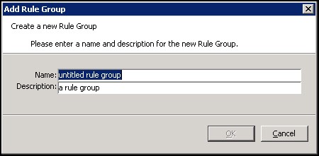

Create a Rule Group
Navigate: In the Configuration Components pane, select Project, then Solution, and then Rules. The Figure 4-29 opens in the workspace.
Figure 4-29 Rule Definition Window
Description of Figure 4-29 follows
Description of "Figure 4-29 Rule Definition Window"
  1. In the Rule Definition window, select the rule set to be used to create a new rule group.

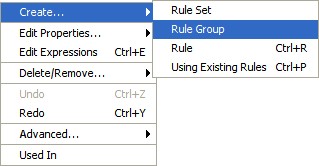

  2. From the toolbar, click New and select Rule Group, or select Create – Rule Group from the right-click menu.
    Figure 4-30 Rule Group Menu Option
    Description of Figure 4-30 follows
    Description of "Figure 4-30 Rule Group Menu Option"
    The Figure 4-31 opens.
    Figure 4-31 Add Rule Group Window
    Description of Figure 4-31 follows
    Description of "Figure 4-31 Add Rule Group Window"
  3. Complete the following:
    1. In the Name field, enter the name of the rule group.
      A rule group name can be a maximum of 16 alphanumeric or underscore characters. It must not have a name that is the same as any other rule group that exists in the project.
    2. In the Description field, enter a description of the rule group.
    3. Click OK to save any changes and close the window. The new rule group displays in the Rule Definition tree window.

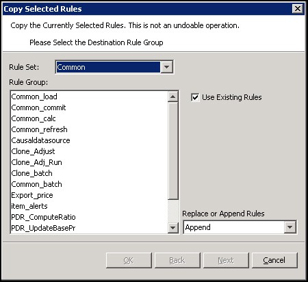

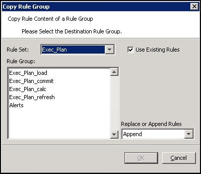

Copy a Rule Group
If two rule groups are similar, it may be beneficial to copy one rule group into the other to prevent having to create a rule group from scratch. When copying the rules of a rule group into another rule group, it is possible to specify whether existing rules will be used or copies of the rules will be created. The Use Existing Rules check box defaults to using any existing rules in the rule pool. If this check box is selected, the copy rule group operation will use the same rules that the source rule group has. If this check box is unchecked, the copy rule group operation will create copies of the rules and use those copies for appending to or replacing rules in the destination rule group.
The rule group to be copied into must already exist. A new rule group cannot be created through this process.
  1. In the Rule Definition window, select the rule group to be copied.
  2. From the toolbar, click Advanced, and select Copy Rule Group. The Copy Rule Group window opens.
    Figure 4-32 Copy Rule Group Window
    Description of Figure 4-32 follows
    Description of "Figure 4-32 Copy Rule Group Window"
    1. Using the Rule Set list, select the destination rule set.
    2. From the Rule Group area, select the desired destination rule group.
    3. Using the Replace or Append Rules list, select either:
      Replace – To overwrite all rules that already exist in the destination rule group.
      Append – To add to the rules already in the destination rule group.
    4. Click OK. The Confirm Operation window opens.
  4. Click OK. The rules are copied to the selected rule group.

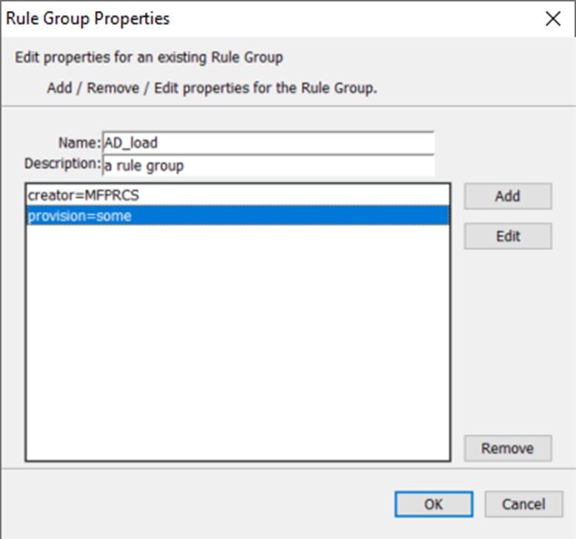

    Figure 4-33 Rule Group Properties Window
    Description of Figure 4-33 follows
    Description of "Figure 4-33 Rule Group Properties Window"

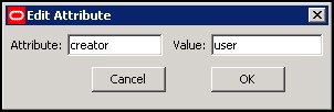

  2. In the Rule Group Properties window, click Add to open the Edit Attribute window in order to add a new rule group attribute.
    Figure 4-34 Rule Group Edit Attribute Window
    Description of Figure 4-34 follows
    Description of "Figure 4-34 Rule Group Edit Attribute Window"
  3. To edit an existing rule group attribute, select the attribute/value pair and then click Edit. The Edit Attribute window opens in the workspace. The window is pre-populated with the selected rule group attribute and value that the user can edit.
  4. To remove an existing rule group attribute, select the attribute/value pair and then click Remove.

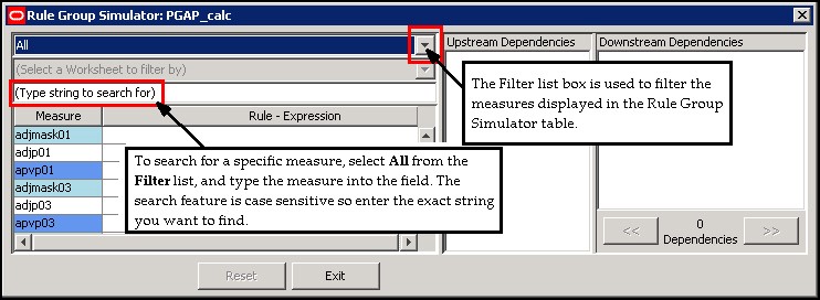

Measure Validation in the Rule Definition Window
If Enable Measure Content Validation is not selected in the Workbench Preferences window, measure content validation is turned off in the Measure Manager. Measure validation must be manually initiated in the rule tool. See Measure Validation within the Measure Manager.
From the Rule Definition window, click Perform Measure Content Validation on the Rule Definition toolbar.

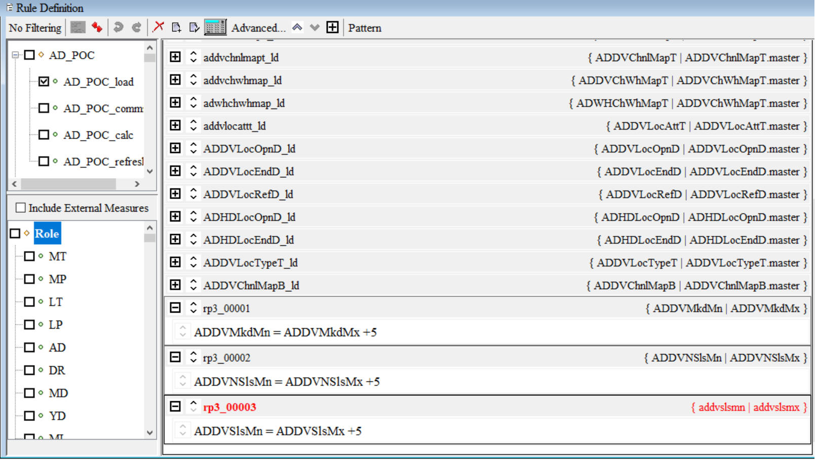

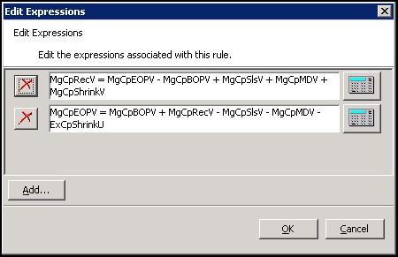

Rule Definition
The Rule Definition tool allows the configuration administrator to define, organize, and manage rule sets, rule groups, and rules. It also allows for the creation of expressions and addition of expressions to rules.
Rules are groups of expressions that describe the relationship between measures.
When a rule has multiple expressions, those expressions are given a priority sequence to help the calculation engine select a calculation path that follows business priorities. When given a choice, the calculation engine will always select the highest priority expression in the rule that is available to be selected. Considerable care should be taken in the design of rules to ensure that appropriate expression priorities are established. The business priority may vary from implementation to implementation, and it may vary from one type of plan to another in the same implementation.
Rules are also given a priority sequence within a rule group to help the calculation engine select a calculation path that follows business priorities. When given a choice, the calculation engine will always select the highest priority rule that needs to be calculated.
Those who are configuring the calculation requirements of a solution are expected to fully understand the operation of the RPASCE calculation engine.

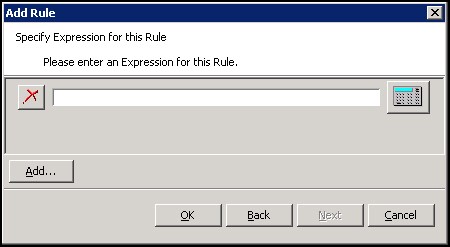

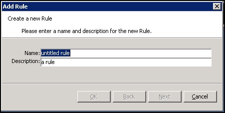

Create a Rule and Add It to a Rule Group
Complete the following steps to create a rule and add it to a Rule Group.
  1. In the Rule Definition window, select the rule group in which you want to create a rule. If you want the rule to be created in a particular position in the sequence of rules in the rule group, select the rule before which you want the new rule to be placed. The new rule will be created higher than the selected rule.

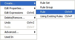

    • From the toolbar, click New and select Rule.
    • Click Create..., then Rule from the right-click menu.
    • Press Ctrl+R.
    The Figure 4-36 opens.

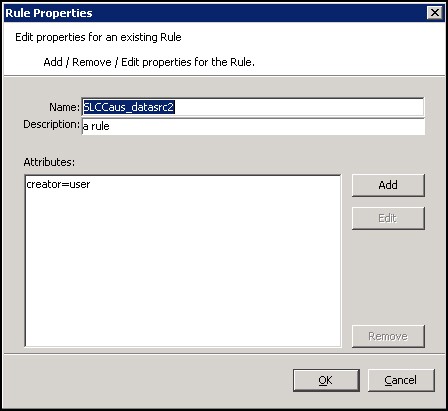

  3. In the Name field, enter the name of the rule.
    A rule name can be a maximum of 24 alphanumeric or underscore characters. It must not have a name that is the same as any other rule that exists in the project. Rule names may start with a letter or an underscore but may not start with the letter r or R followed by a number.

  5. Click Next. The Expression Builder window of the Add Rule window opens.
    Figure 4-37 Specify Expression for Add Rule
    Description of Figure 4-37 follows
    Description of "Figure 4-37 Specify Expression for Add Rule"

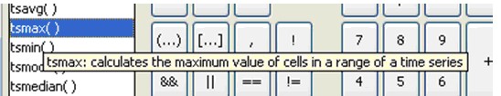

      Place the mouse over the name of a function, procedure, keyword, or modifier to see a tooltip that explains its function.
    4. From the drop-down list, select a category of functions, procedures, keywords, or modifiers. Double-click on a specific function, procedure, keyword, or modifier to be used in the expression, and (if appropriate) outline syntax pasted at the insertion point in the expression.
      Figure 4-42 Category Options List
      Description of Figure 4-42 follows
      Description of "Figure 4-42 Category Options List"
      The outline syntax of a function, procedure, keyword, or modifier is pasted with components of the syntax separated with braces {}. When the insertion point is in a component of the outline syntax in the expression, you will see a description of the component at the bottom of the expression window. When the insertion point is in a component of the outline syntax, anything that is entered or pasted replaces the whole component.

Add an Existing Rule to a Rule Group
Using the Add Existing Rules window, you may select multiple rules to add to a rule group. If at least one of the selected rules is already in the rule group, the OK button will gray out disallowing the operation until that rule is cleared. When multiple rules are selected, the expression and rule group displays will go blank. However, if there is only one selected rule, the rule's expressions and the list of rule groups that use the rule will be displayed.
  1. In the Rule Definition window, select the rule group to be used to add an existing rule. If the rule is to be placed in a particular position in the sequence of rules in the rule group, select the rule in which the new rule is to precede.
    • From the toolbar, click New and select Using Existing Rule.
    • Select Create – Using Existing Rule from the right-click menu.
    • Press Ctrl+P.
    The Figure 4-46 opens.
    Figure 4-46 Add Existing Rule Window
    Description of Figure 4-46 follows
    Description of "Figure 4-46 Add Existing Rule Window"
  3. Filter by Rule Name or by Measure and view the associated expressions to find the correct rule. Filtering means that all data are compared, but only matching data is allowed to pass through. In order to filter by Rule Name or by Measure, type a filter string (for instance, ExCpSls in the input box directly under the Title Bar. Click Filter by Measure, and only those measures with ExCpSls display.
  4. Click the rule in the table to select it.
  5. Click OK to save changes and close the window.
    The rule is placed higher than the rule that was selected at the start of the process in the sequence of rules in the rule group or at the end of the rule group if no rule was selected.

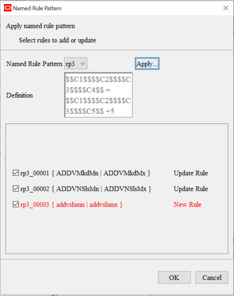

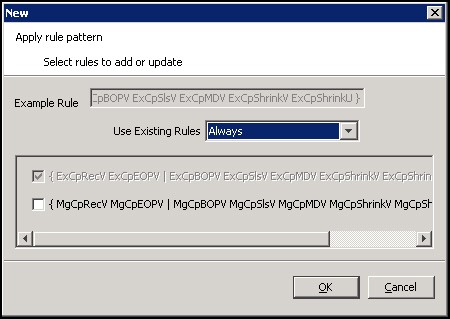

Apply a Rule Pattern to Create New Rules or to Update Existing Rules
The Apply Rule Pattern functionality allows you to create new rules or update existing rules according to a pattern established by a selected base or template rule. The rule tool recognizes inherent similarities or patterns in measure components used in some rules when compared to the base or template rule. Based on these similarities, the rule tool allows for the creation of new rules or update of existing rules to fit the pattern set by the base or template rule.
When the Apply Pattern capability is enabled, there is a possibility that some of the New or Updated rules will have the same expressions as a rule that already exists in the rule pool. If this happens, the Similar Rules Found window opens and provides the option of using the existing rule or actually creating a new one.
  1. In the Rule Definition window, select any rule group that contains the rule to use as the pattern basis.
  2. Select the rule whose pattern is to be used as a basis for creating or updating rules.
  3. From the toolbar, click Advanced and then select Apply Pattern, or right-click and select Advanced and then, Apply Pattern.
    A Figure 4-48 opens containing a set of rules that are presented for selection. This set is composed of rules whose measures follow the selected rule's pattern in terms of the individual measure components used. The set of rules are composed of potential new rules or potential updated rules.
    You can click the four corners of the Apply Rule Pattern window to see the resize arrow. You can resize the window by dragging the arrow.
    Figure 4-48 New Apply Rule Pattern Window
    Description of Figure 4-48 follows
    Description of "Figure 4-48 New Apply Rule Pattern Window"
    Example:
    Consider a configuration with three components in the measure naming scheme:
    • a version (such as Wp)
    • a metric (such as Shrink)
    • a unit of measure (such as V)
    If the selected base rule is:
    { WpShrinkU WpShrinkAUR | WpShrinkV }
    ...then the rules:
    Rule1: { WpSlsU WpSlsV WpSlsAUR | }
    ...and
    Rule2: { WpRecU WpRecV WpRecC | }
    ...would fit the pattern and be included in the list.
    Rule1 fits the pattern because its measures use the same measure components with the exception of the metric component. For the Metric component, the base rule uses Shrink, and Rule1 uses Sls consistently. In this case, the tool will present the rule:
    { WpSlsU WpSlsAUR | WpSlsV }
    ...as a possible update for Rule1.
    The update results in the conversion of Rule1 to a rule that uses the same measures as the original Rule1, but it has the expression pattern of the base rule.
    Rule2 fits the pattern because it uses the same Version as the base rule. For the Metric component, the base rule uses Shrink, and Rule2 uses Rec consistently. Unlike Rule1, Rule2 uses C as the Unit of Measure in one of its measures. This is not an exact fit like Rule1. In this case, the tool will present the rule { WpRecU WpRecAUR | WpRecV } as a possible new rule. Notice that this rule is forced to be an exact fit as Rule1 was.
  4. Select the rule replacement policy in the Use Existing Rules drop-down menu. This allows the user to select, on a rule-by-rule basis, which rules to reuse and which to re-create. By default, this is set to Always.
    • When Always is selected, rules that already exist elsewhere in the configuration will always be used in place of the newly generated rules.
    • When Never is selected, new rules will always be created, even if an identical rule already exists elsewhere in the configuration.
    • When Prompt is selected, the Rule Locator window will be presented for each rule whose expressions already exist elsewhere in the configuration.
  5. From the list of possible new and updated rules, select those to be updated or added to the rule group. In either case, if rule reuse is specified in Step 4, a new rule will not be created, but the rule existing elsewhere in the configuration will be used in its place.
  6. Click OK.
    A selected rule that is labeled New Rule will be added to the end of the rule group. The new rule's name will default to the template rule's name suffixed with a number to keep the name unique. A selected rule that is labeled Update Rule is already in the rule group and will be replaced. This means that the old rule will be removed and replaced with a new rule whose expressions follow the base rule's expression pattern. In both cases, the rule will follow the pattern of the base rule's expression.

Reordering Rules in a Rule Group
Complete the following steps to reorder rules in a Rule Group.
  1. In the Rule Definition window, select the rule group that contains the rules to reorder.
  2. Select the rule to reorder.
  3. Complete the following as needed:
    • Use the Up or Down arrows on the Rule Definition toolbar to move the rule up or down the list.
    • Click the up or down arrows to the left of the rule name to move the rule up or down the list.

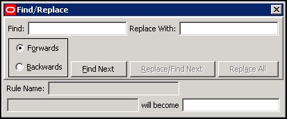

Copy Selected Rules to Another Rule Group
Complete the following steps to copy selected rules to another Rule Group.
When copying selected rules of a rule group into another rule group, it is possible to specify whether existing rules will be used or copies of the rules will be created. The Use Existing Rules check box defaults to using any existing rules in the rule pool. If this check box is selected, the copy selected rules operation will use the same rules that the source rule group has. If this check box is not selected, the copy selected rules operation will create copies of the rules and use those copies for appending to or replacing rules in the destination rule group.
When the user uses the Find/Replace feature, it is possible that a changed rule will have the same expressions as a rule that already exists in the rule pool. If the Use Existing Rules check box is selected, the Similar Rules Found window opens. You have the option of using the existing rule or creating a new one.
  1. Select the Rule Group that contains the rules to copy, and select the individual rules to be copied.
    To select multiple rules, press the Ctrl key and click the rules to select, or click one rule and hold Shift key as selecting another rule, which selects all rules between the two that have been selected. A selected rule is indicated by a bold rule name.
  2. Complete one of the following methods:
    • From the toolbar, click Advanced, and select Copy Selected Rules.
    • Select Advanced – Copy Selected Rules from the right-click menu.
    • Press Ctrl+C.
    The first Figure 4-56 opens.
    Figure 4-56 Copy Selected Rules Window (1)
    Description of Figure 4-56 follows
    Description of "Figure 4-56 Copy Selected Rules Window (1)"
  3. In the Rule Set field, select the copy's destination rule set.
  4. In the Rule Group area, select the desired copy's destination Rule Group.
  5. Check the Use Existing Rules check box if the rules should be added to the destination Rule Group. If the User Existing Rules check box is clear, copies of the selected rules are created for the destination Rule Group instead.
    If the Find or Replace functionality is used, copies are created for affected rules even if the Use Existing Rules check box is checked.
  6. In the Replace or Append Rules field, select:
    • Replace – To remove all rules that already exist in the destination rule group before the copy.
    • Append – To add to the rules already in the destination rule group.
  7. Click Next. The second Figure 4-57 opens. This window allows you to select or clear rules from those originally selected to copy when the check box beside the rule name is selected.
