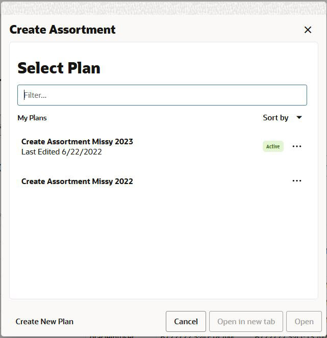

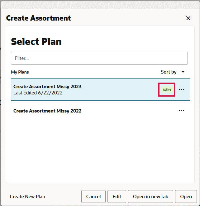

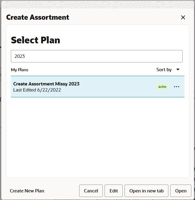

Figure 6-1 shows the segments that are already defined. You can create a new segment at any time by selecting the link in the lower left hand corner.
Active next to a segment means that the segment is active, that is, a workspace has already been built for that segment. This means that the workspace can be opened, either in this browser tab or another one.
Figure 6-2 Create Assortment Active Segment

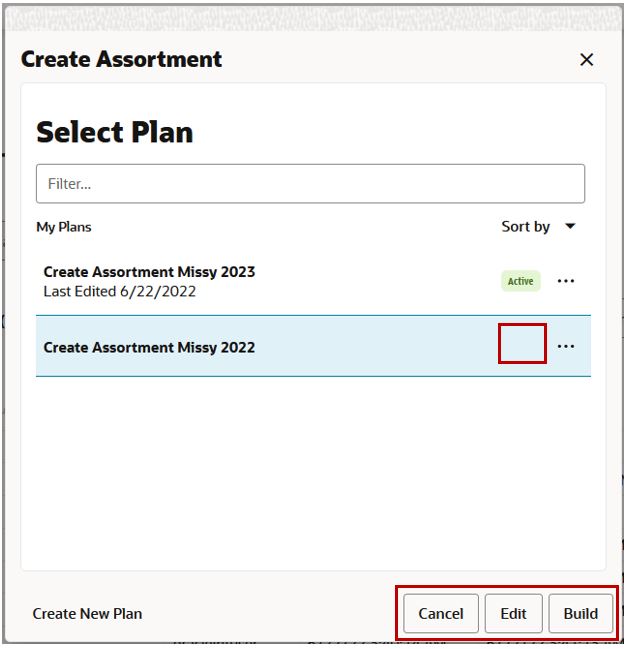

Conversely, a segment without Active, must have its associated workspace built before that workspace can be opened.
Figure 6-3 Create Assortment Inactive Segment

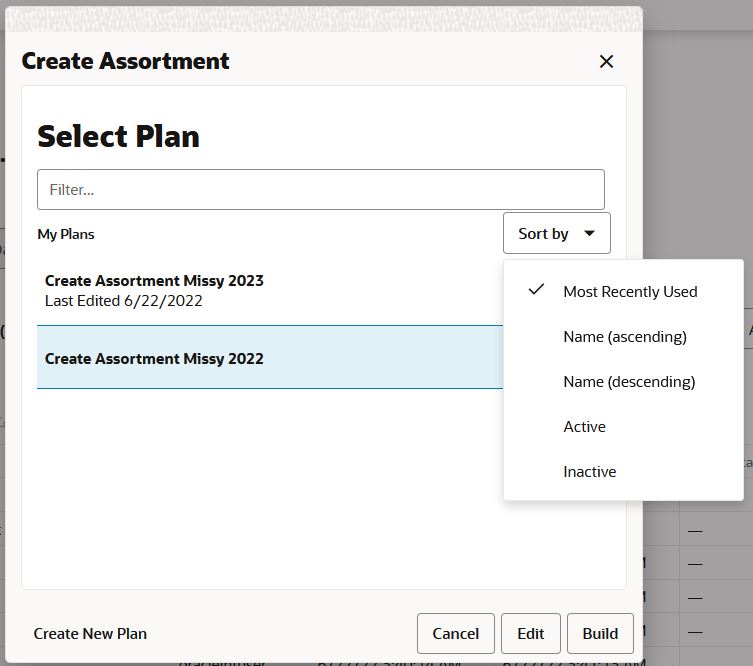

In order to find a particular segment, you can sort and filter the segment entries.
To sort the entries, select an option in the Sort by list.
Figure 6-4 Segments Sort By List
The Sort by options are:
  • Most Recently Used: The segments are displayed in the same order as they appear in the Most Recently Used section of the dashboard.
  • Name (ascending): The segments are sorted in alphabetical order.
  • Name (descending): The segments are sorted in reverse alphabetical order.
  • Active: The active segments are sorted alphabetically.
  • Inactive: The inactive segments are sorted alphabetically.

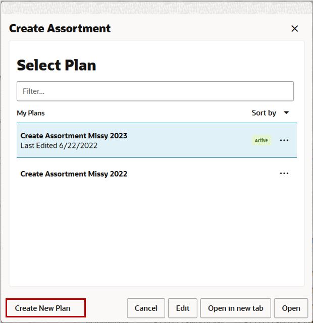

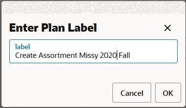

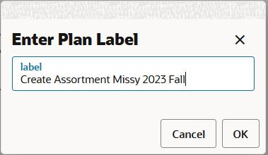

Creating a New Segment
If no segments exist, the Enter Plan Label window is opened using the Segment window. Enter the plan label and click OK. You see the Segment Wizard.
A new segment can be created either with Create New Plan button in the lower left corner. You are prompted for a label for that segment, and then taken to the Segment Wizard (see Wizards). If you select any of the segments, then the buttons, Edit, Open in new tab, and Open are enabled.
Figure 6-6 Create New Segment
Create New Segment

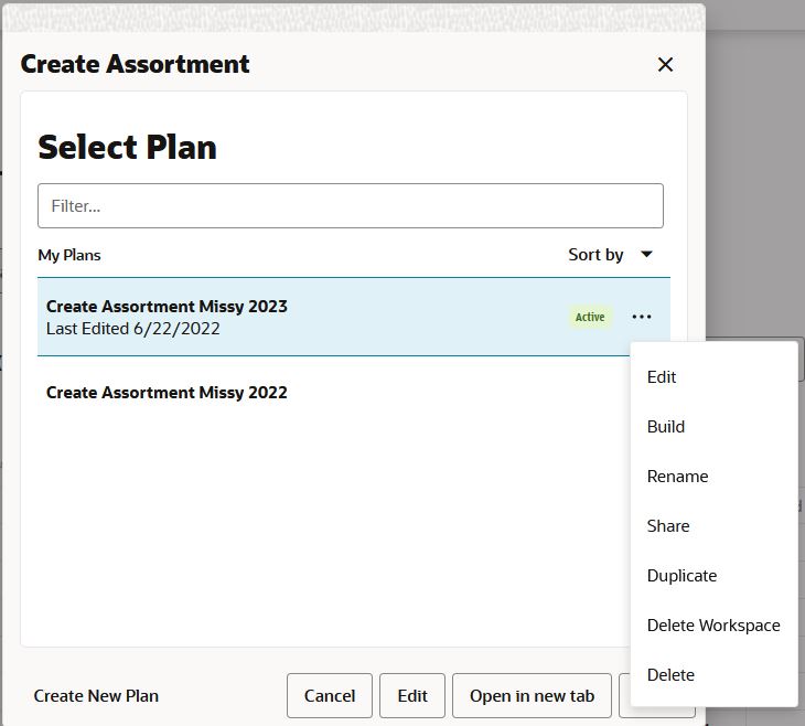

Action Menu
In order to take action on a segment, click the Action Menu icon next to the segment. A context menu appears, with these options: Edit, Build, Rename, Duplicate, Delete, Delete Workspace, and Share.
Figure 6-7 Segment Action Menu
Segment Action Menu

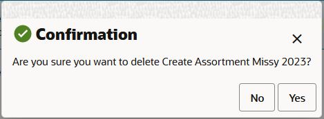

Deleting a Segment
In order to delete a segment, select Delete from the Action menu. At the confirmation window, click Yes to delete the segment. The workspace must be closed before it can be deleted.
Figure 6-8 Deleting a Segment
Deleting a Segment
Deleting a segment also deletes the workspace it is associated with. Ensure that you have finished working with the workspace and have committed the desired data before deleting the segment.

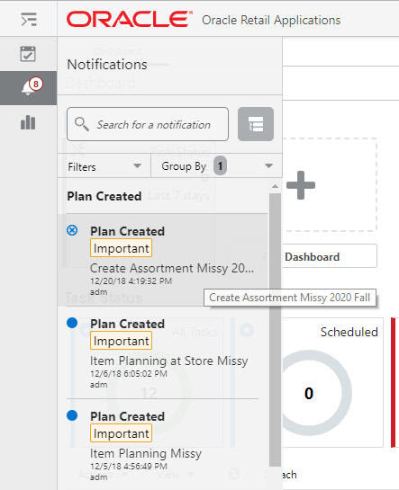

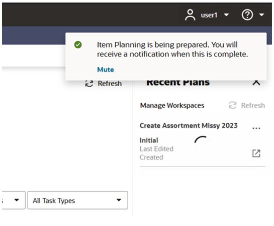

Building a Segment
In order to build a workspace for segment, select Build from the Action menu/segment window. The workspace begins building in the background (see Asynchronous Build).

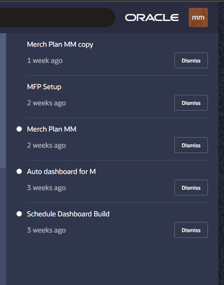

Note that once the segment is submitted for building, the segment is locked until the operation is completed. If any of the operations on the segment, such as open, edit, delete, build, or rename, are performed, then all of them will fail and an error similar to the following message appears, 'Create Assortment Missy2019' is being re-created and cannot be edited during this time. Try again in a few minutes, or check notifications to see when it can be edited again. If the problem persists, contact your administrator.
Users are generally notified about the segment build status in the notification. If the status has a value of Failed, contact the application administrator who can view the online administration task log files to determine the cause of the failure. Usually, the segment build process completes within a specified time with the arrival of the notification. If the user does not receive the notification within 24 hours, then the segments will be unlocked automatically.
Figure 6-9 Building a Segment
Building a Segment

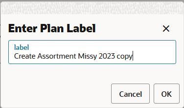

Duplicating a Segment
In order to duplicate a segment, select Duplicate from the context menu. The window prompts you for a new name and then copies the segment and displays it in the segment list. Any segment can be duplicated at any time.

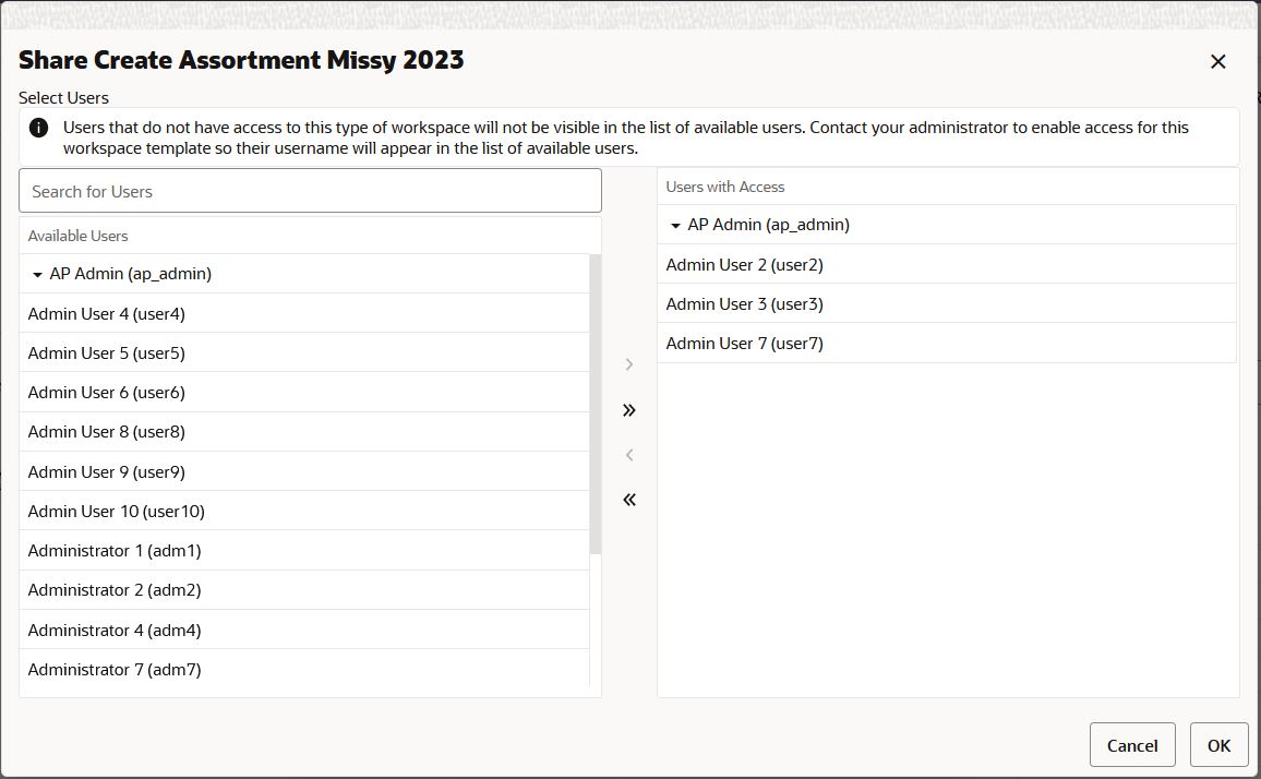

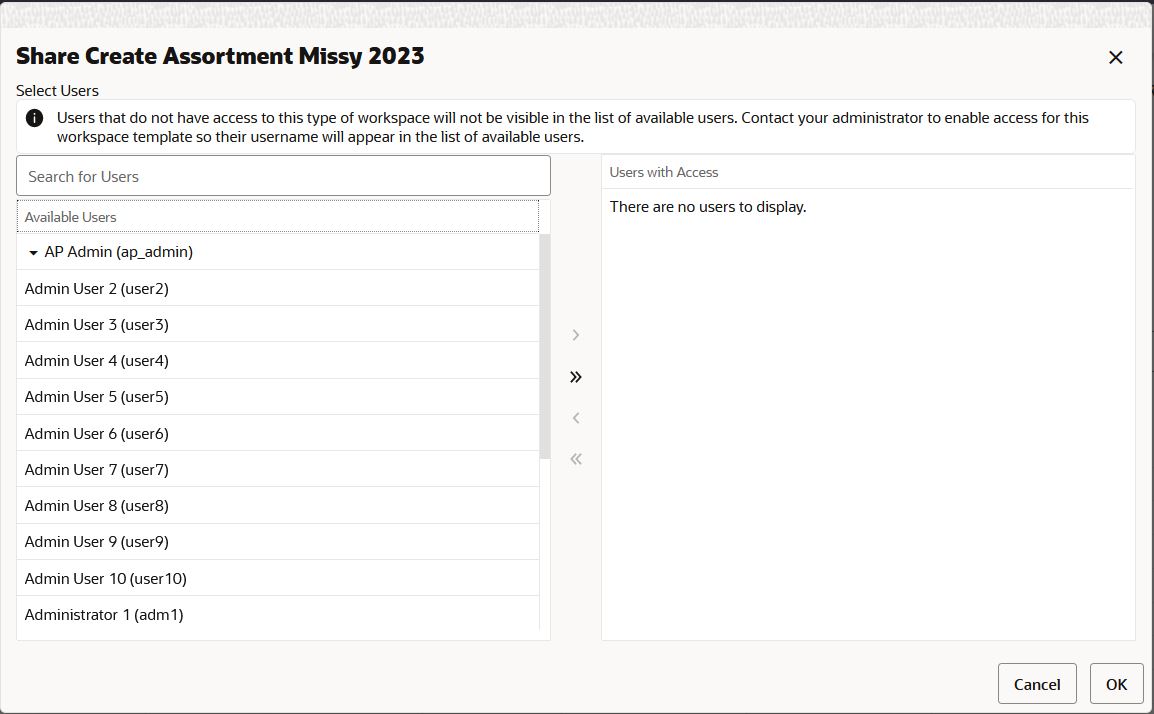

Sharing a Segment
The Sharing feature allows you to share a existing segment with another user who has similar rights for the templates and positions. Sharing of Segments makes the team collaboration easier. These scenarios in the following list are examples that could enhance the team productivity when you use this feature.
  • You are an assistant buyer who started a plan and you want to collaborate/finish with another Buyer.
  • You are an assistant buyer who created versions of what-if scenarios and wants to share with the Buyer.
  • You are a new associate that requires review or guidance from the manager in order to complete your plan.
  • You are going on vacation and a colleague will be monitoring your plans.
  • You are leaving the company and have work-in-progress that are not ready to commit (including what-if scenarios).
The following steps describe how you can share your existing segment with other users.
Next to the existing segment that you want to share, click the Action Menu and then click Share.
Figure 6-13 Share a Segment
Share a Segment
RPASCE displays the Figure 6-14 where you can select the user to share the segment with.
You can select one or more users to share the segment with. Locate users by using the Search for Users box. Move available users by selecting the user and then using the > arrow to move them to the Users with Access pane.
Remove access for users by selecting them and then use the < arrow to move them to the Available Users pane. Use the double arrows (either << or >>) to move all users between the panes.
Ensure that desired data has been committed to be properly shared with the other user.
In case of shared workspaces, when a Commit action is performed by any user (receiver or creator) after sharing, then the commit notifications is displayed to all the users.
Figure 6-14 Select Users Window
Select Users Window
The shared segment is available to the other users with access while creating the same segment under the same taskflow. Figure 6-15 shows the segment Create Assortment Missy 2023 that is available for the Admin User 2 (user2) under the same taskflow.
Figure 6-15 Select User to Share a Segment

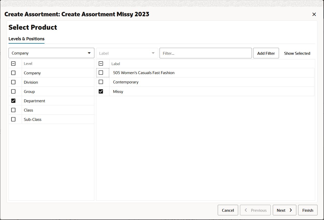

Wizards
When you select Create New or Edit in the Segments window, a wizard opens. The wizard take you through a set of screens to select the positions for each dimension in the workspace.
When you select Create New options, no level in the wizard is pre-selected and no position is shown in the position area. Only when you select a level, the positions for the respective level appear in the wizard.
Figure 6-16 Create New Plan Wizard

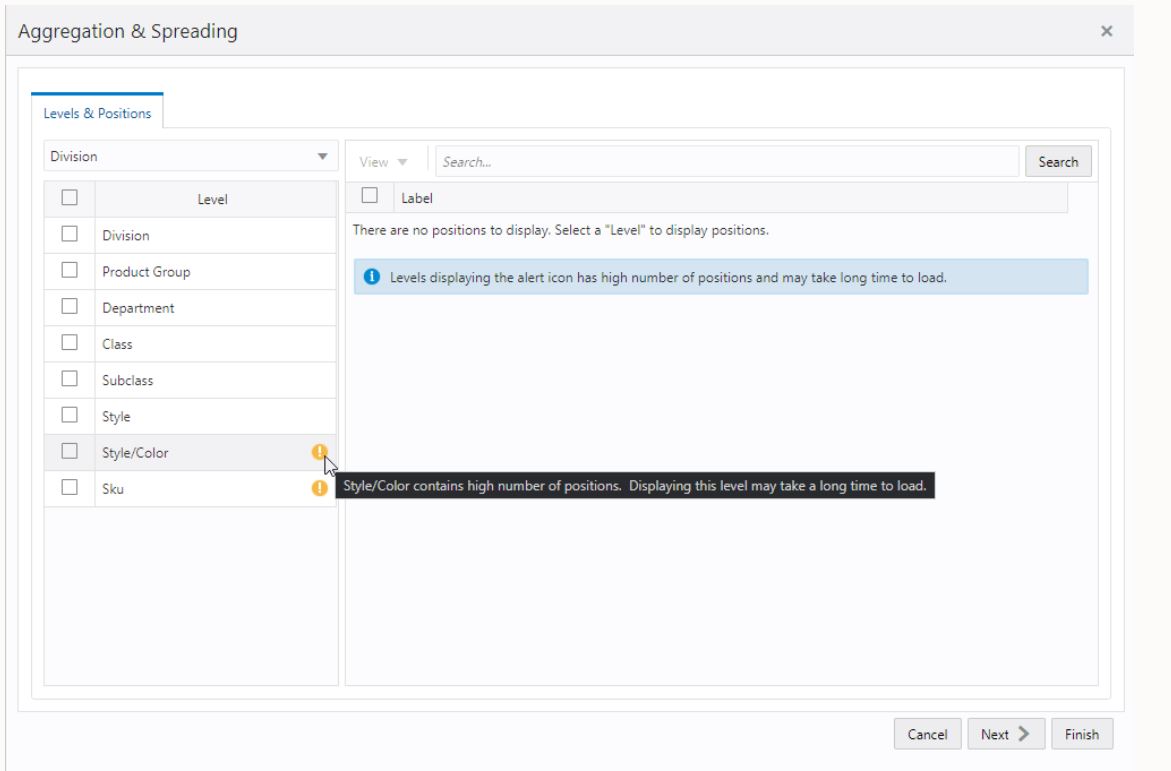

If any level has a higher number of positions than the position count threshold, then an alert icon appears next to the level and the position area displays a message, Levels displaying the alert icon have high number of positions and may take long time to load.
When you hover over the alert icon next to a level, it displays a message which states: The level contains high number of positions and displaying this position may take longer time to load. The default position count threshold is set at 50,000 positions. Positions with more than 50,000, are considered higher and the alert icon appears next to the level. The position count is configurable by an administrator as per the requirement.
Unicode characters are accepted when creating the segment label.
Figure 6-17 Wizard with a High Number of Positions
To load positions faster into the wizard, choose a higher level in the wizard, such as department which has a fewer number of positions. You can still select the level with alert icon if you need to select or clear positions at that level, but it may take time for wizard to load those positions.
When you create a new segment again, the wizard step defaults to the last selections. If the prior selections made in wizard are at the child level with a high position count, then it will impact the loading time of wizard. To improve the wizard loading time, choose to work with higher levels with less position count. This improves the position loading time when you open the wizard the next time.
When the positions display in the wizard, the non-calendar positions are sorted alphabetically by default based on the Label attribute. The Calendar positions are sorted chronologically.
When you select the Edit option, the wizard is pre-populated with the saved selections from the segment. This option is useful when a new workspace must be created with the same products and locations, but for a different time period, such as next week or quarter.

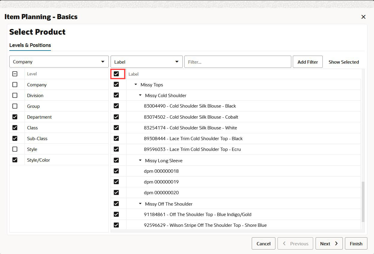

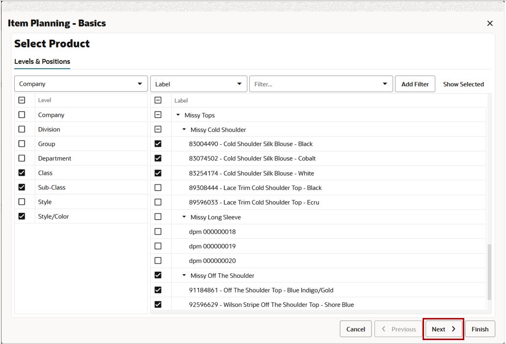

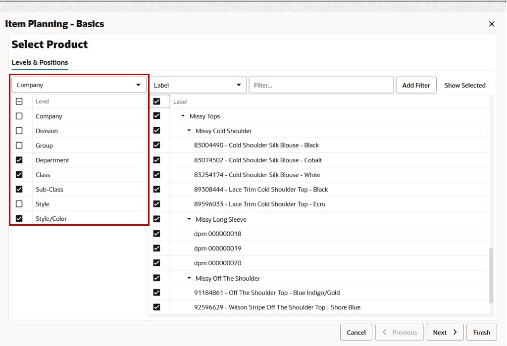

Level and Position Selector
To select a level or position, complete the following steps.
  1. Once in the wizard, select the positions for each dimension by selecting the checkbox next to the position.
    You can view alternate branches of the hierarchy or dimension by using the Branch Selector list. When you select a different branch in the list, you will notice that different dimensions are displayed in the Levels and Dimensions area.
    If you select a large number of positions, it may impact the time required for the workspace to open. Select only the positions required for the current task.
    Figure 6-18 Select Positions
    Select Positions
  2. To select all positions, click the top of the column next to all the positions.
    Figure 6-19 Select All Positions
  3. To change the level of the positions to select from, place a check next to the desired level in the top left of the screen.
    Figure 6-20 Change Position Levels

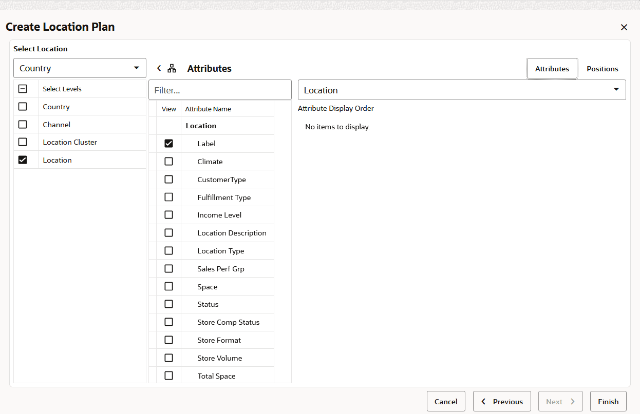

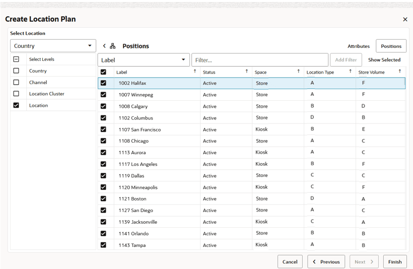

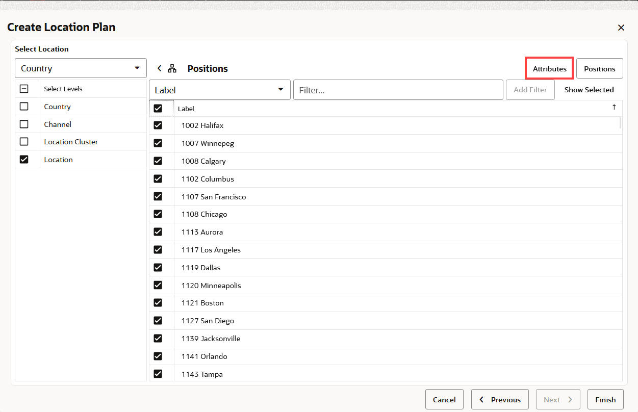

Display Attributes to Select Positions
You can display attributes on the wizard against the positions from Attribute tab located in the top right corner. By displaying the attributes, you can select the positions based on the attributes. For example, store location based on the attributes, like store, start date, climate, status, and so on. Or you can select the style color with the color attribute, black.
To display attributes for positions, follow these steps:
  1. Select the Attributes tab that is located next to the Position tab in the top right corner.
    Figure 6-21 Attributes Tab on the Wizard
    Attributes Tab on Wizard
  2. Using the Attributes tab, you can see the list of attributes listed for the selected position level. You can select attributed to display on the Position tab. The selected attributes display in the right-hand side section.
    You can re-order the attribute sequence by dragging and dropping the attribute tiles.
    The sort option is not available on the wizard’s Attributes tab.

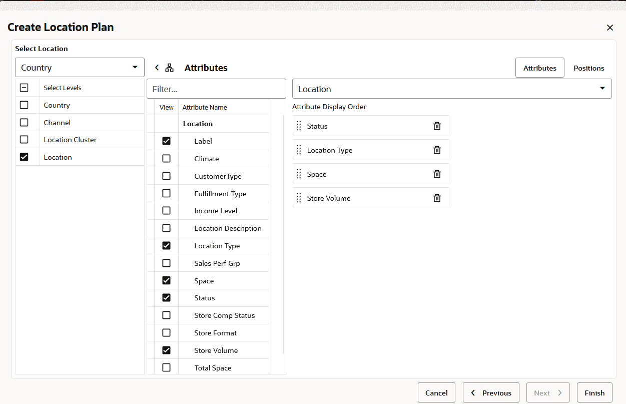

    Figure 6-22 Attributes List for the Selected Level
    Figure 6-23 Select Attributes to Display
  3. The selected attributes display against the position levels on the Position Tab. You can sort the attributes displayed on the wizard using the Sort arrow which is available on the header for the attribute.
    You can select and display attributes for more than one position level based on the requirements.
    The applied sorting is not reflected in the workbook pivot table. This sorting enables you to make a quick selection of positions in the wizard.
    Figure 6-24 Attributes Displayed against the Position Using the Wizard

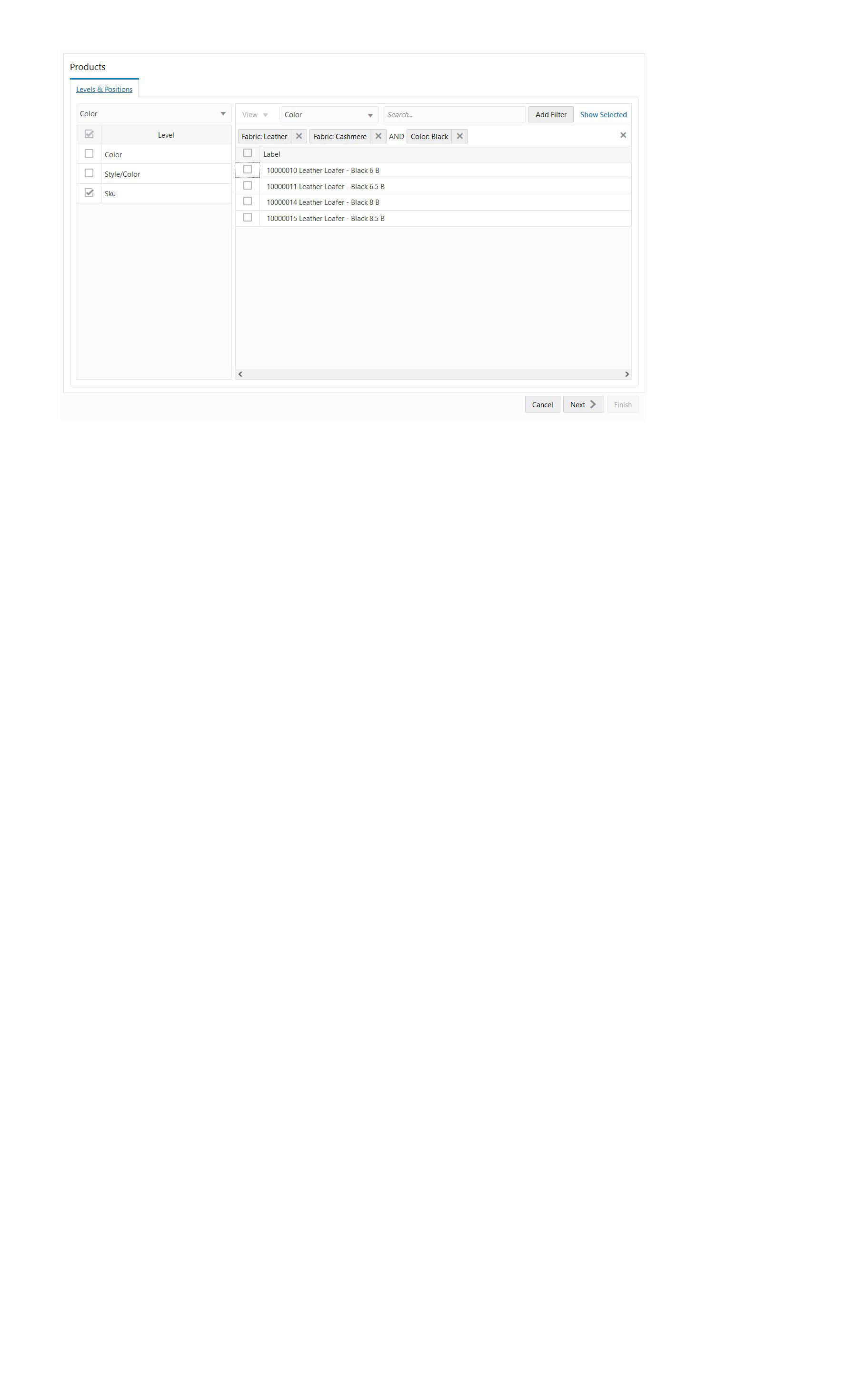

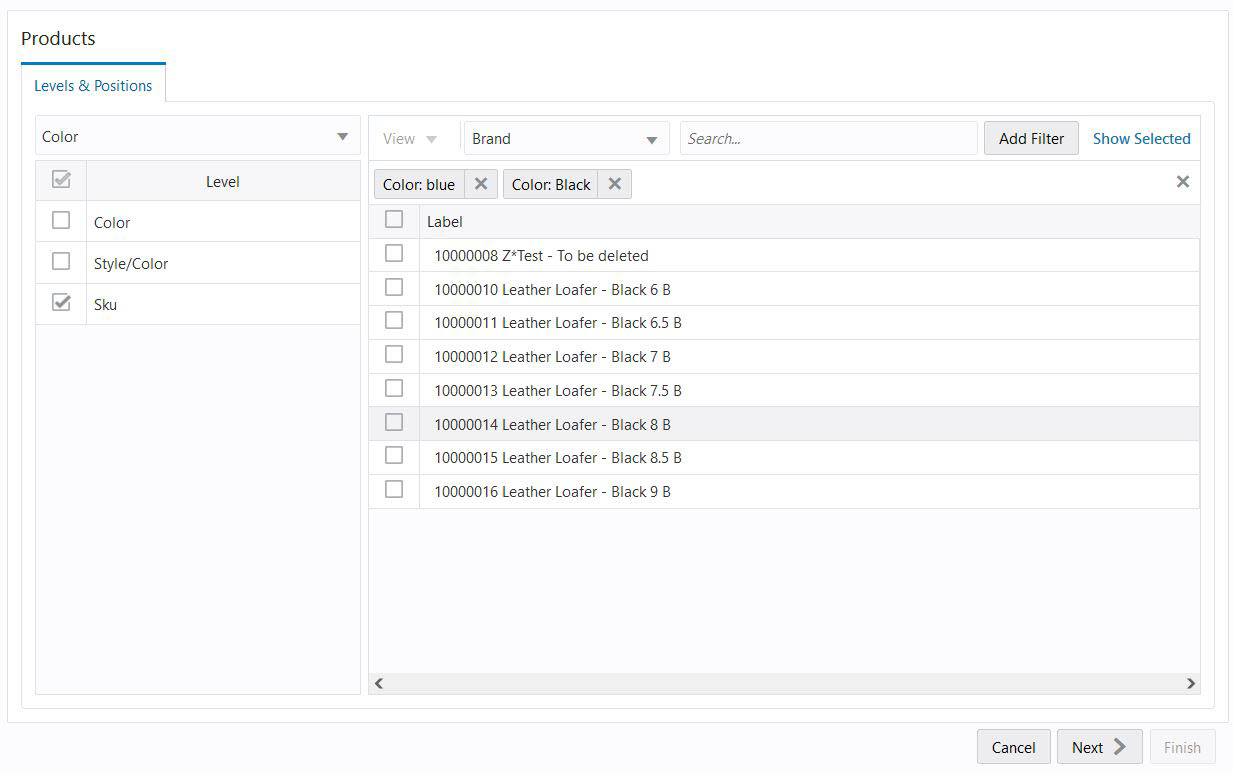

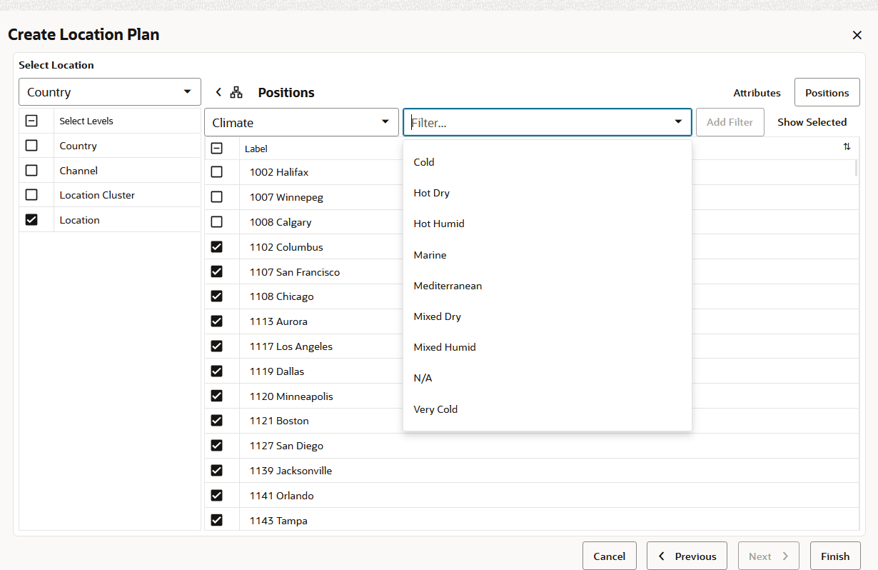

Filter Positions by Attribute
You can filter the positions by attributes when you create your plan. This allows you to examine the different options that you care about and make decisions. The attribute filter is visible only when attributes are associated with at least one of the selected levels. The filter list is by default set to the label attribute.
Select the required attribute as a filter and search for the positions that have the attribute value you selected. You can search positions with more than one attribute. This helps you group the positions in the wizard based on attributes. The OR logic is applied when multiple positions are selected within same Attribute group. For example, if you search for positions with attribute colors of black and red, then the result displays all of the positions with the color red and the color black. The AND logic is applied for positions when 2 Attribute Groups are defined. For example, if you search for the position with the Brand X and the color Blue then the result positions are of the Brand X and the color Blue.
Once you have selected the desired attribute Once you have selected the desired attribute from the drop-down list, a list of attribute values associated with the attribute is displayed as the list in the filter area as shown in Figure 6-26. Then you can select the attribute value and click Add Filter. You can add multiple attribute filters in this manner.
Figure 6-26 Attribute Values Displayed for the Selected Attribute
Figure 6-27 Filter Position - Single Attribute
Figure 6-28 Filter Position - Multiple Attributes

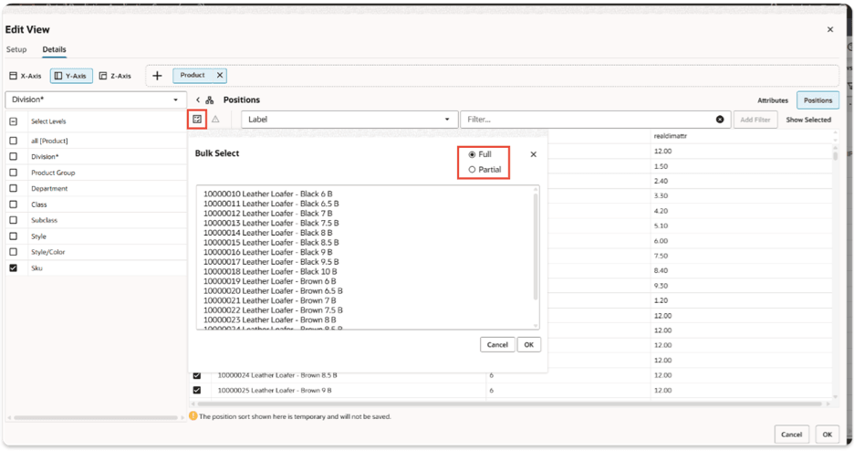

Bulk Select Positions
The Bulk Select option in the wizard allows users to quickly select multiple positions at once by pasting a list of labels into the Bulk Position Selection dialog box. Users can choose between partial match, which selects positions containing the entered text, or full match, which selects only exact matches. A minimum of four characters must be entered to initiate matching, and all positions that meet the criteria will be automatically selected. Labels that do not correspond to available positions are displayed in the dialog for review, enabling users to refine their criteria and try again. Bulk Select is available only when a single level in the hierarchy is chosen, and it is disabled if multiple levels are selected. This feature is particularly useful for multi-selecting positions at any level, streamlining the process of managing large sets of labels efficiently.
Figure 6-29 Bulk Select Option in the Wizard
Bulk Select Option

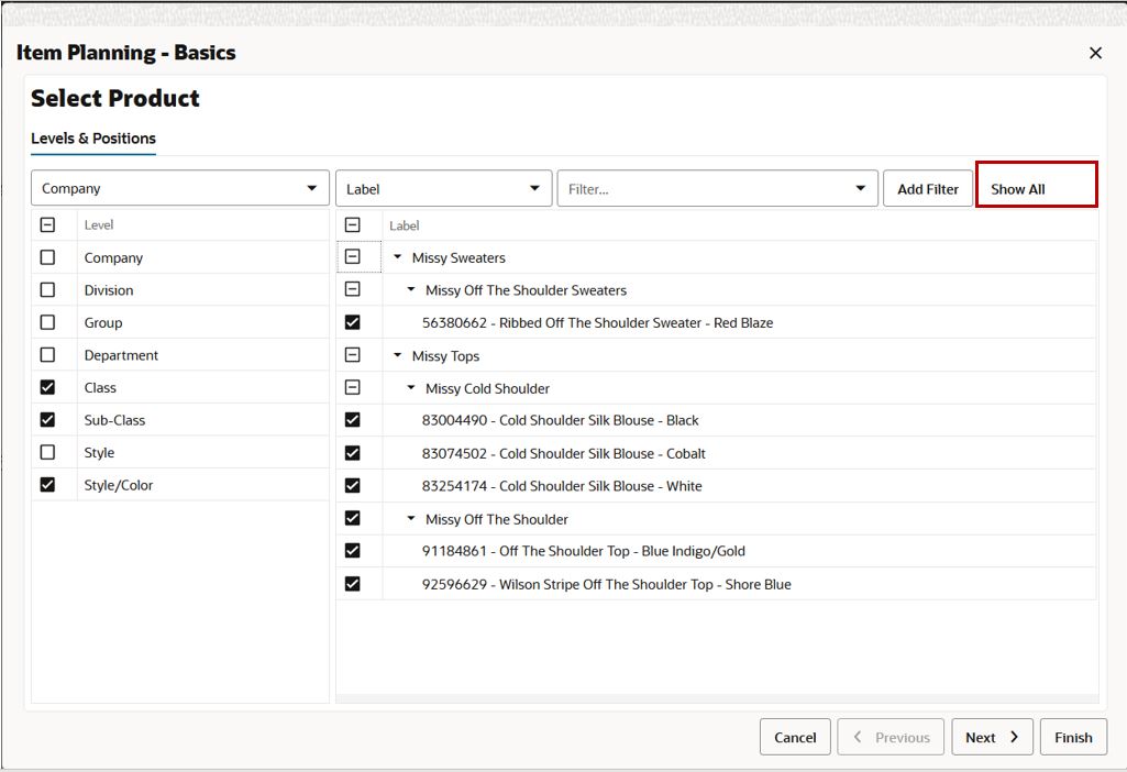

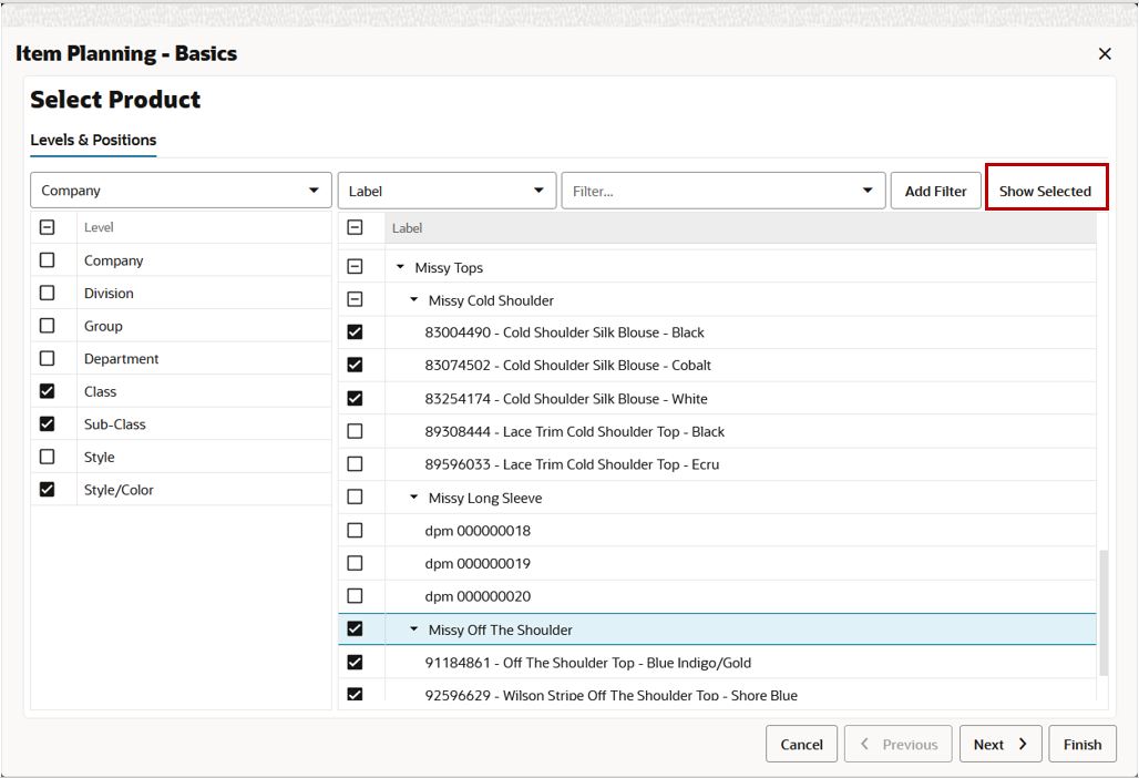

Show Selected Items
You can see the positions selected in wizard with the Show Selected link within the wizard. This can help you in understand what needs to be included in your plan and allows you to display only selected positions in wizard. Click the Show Selected link to see the list of positions selected along with their parents roll up. When there is no position selected, the Show Selected link displays a message that there is no data to display.
Click the Show All link to bring back all the positions of the wizard
If an attribute filter is applied, then the Show Selected link displays only the position matching the filter criteria which is already selected.
Figure 6-30 Show Selected Link
Show Selected Link
Figure 6-31 Show All
Show All
Next, Previous, Finish
Once you have made your position selections for a dimension, click Next or Previous to move to the next or previous dimension selection screen. If all positions for all dimensions have been selected, click Finish to complete the workspace build and close the wizard.
Figure 6-32 Next Dimension
Next Dimension

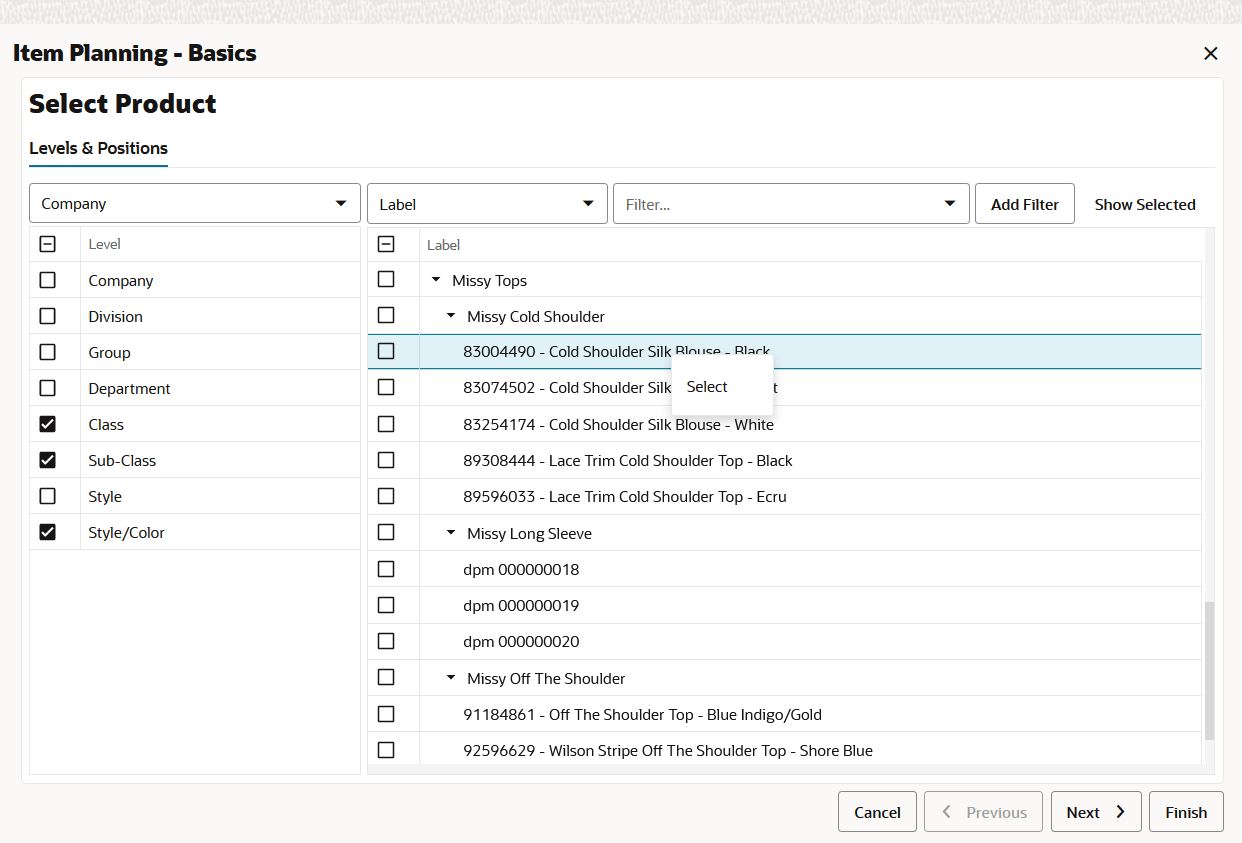

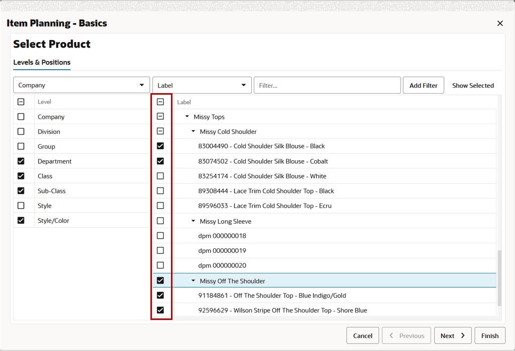

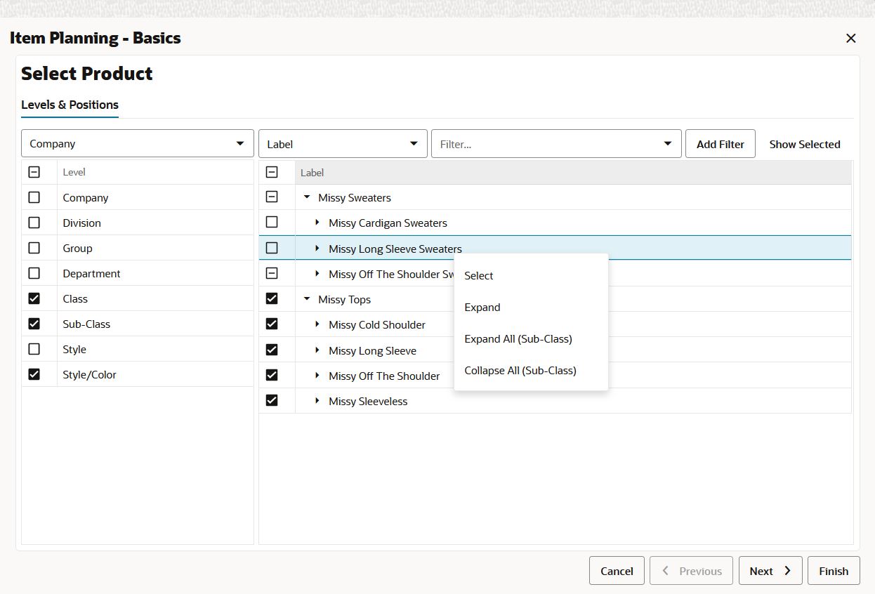

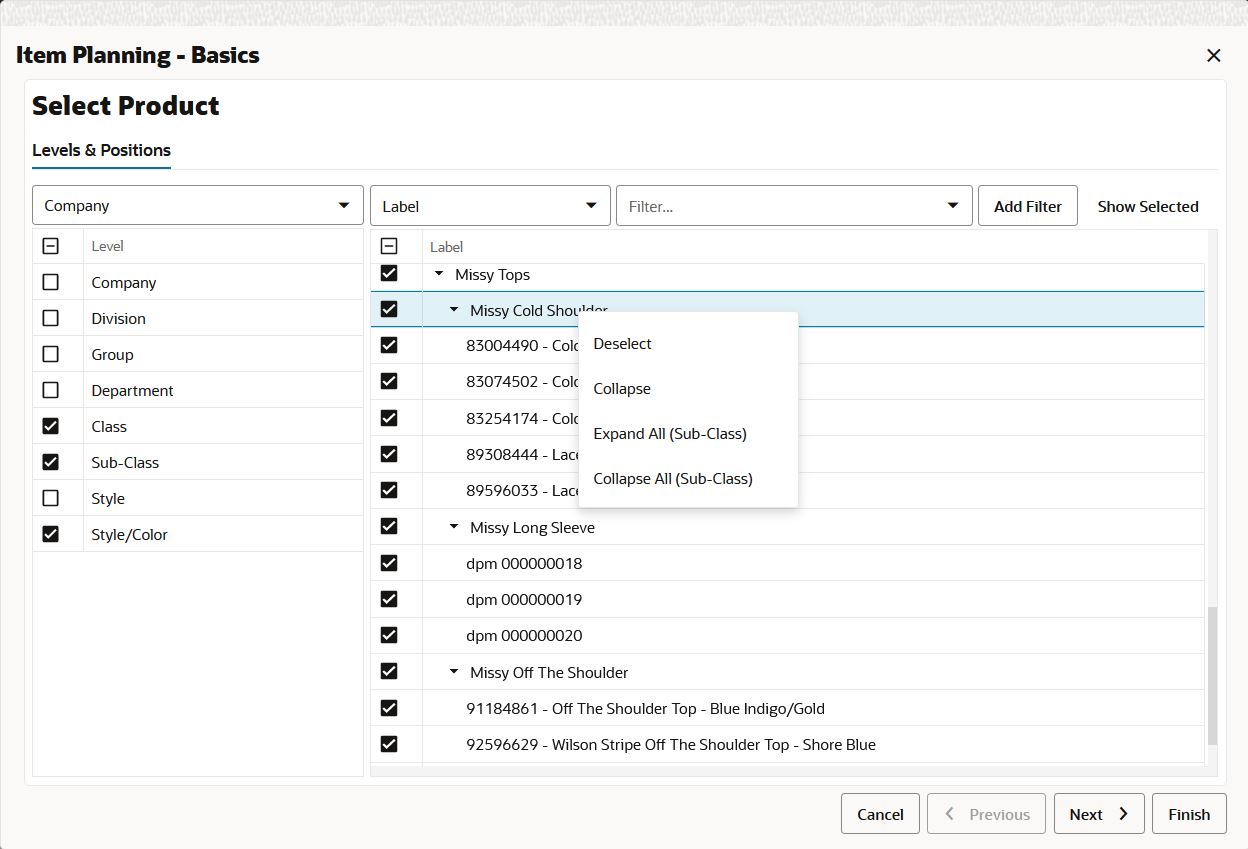

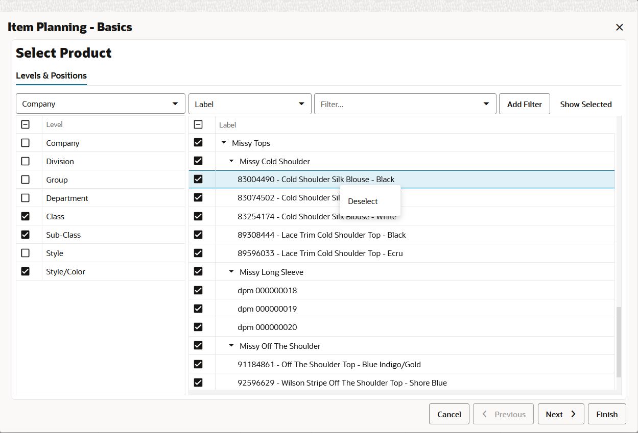

Select and Deselect Positions in the Wizard
You can also select and deselect positions using the context menu (right-click) option. This option is an alternative to select or deselect positions in wizard. You can use context menu option to select or deselect multiple positions simultaneously.
To select a position, right-click on the position and choose Select. Similarly, to deselect a position, right-click on a selected position and choose Deselect.
When you want to select or deselect multiple positions, select multiple positions by Using a mouse drag with a Shift or Ctrl key and right-click to opt for Select or Deselect positions.
Figure 6-33 Wizard Context Menu Select Position
Figure 6-34 Wizard Context Menu Deselect Position

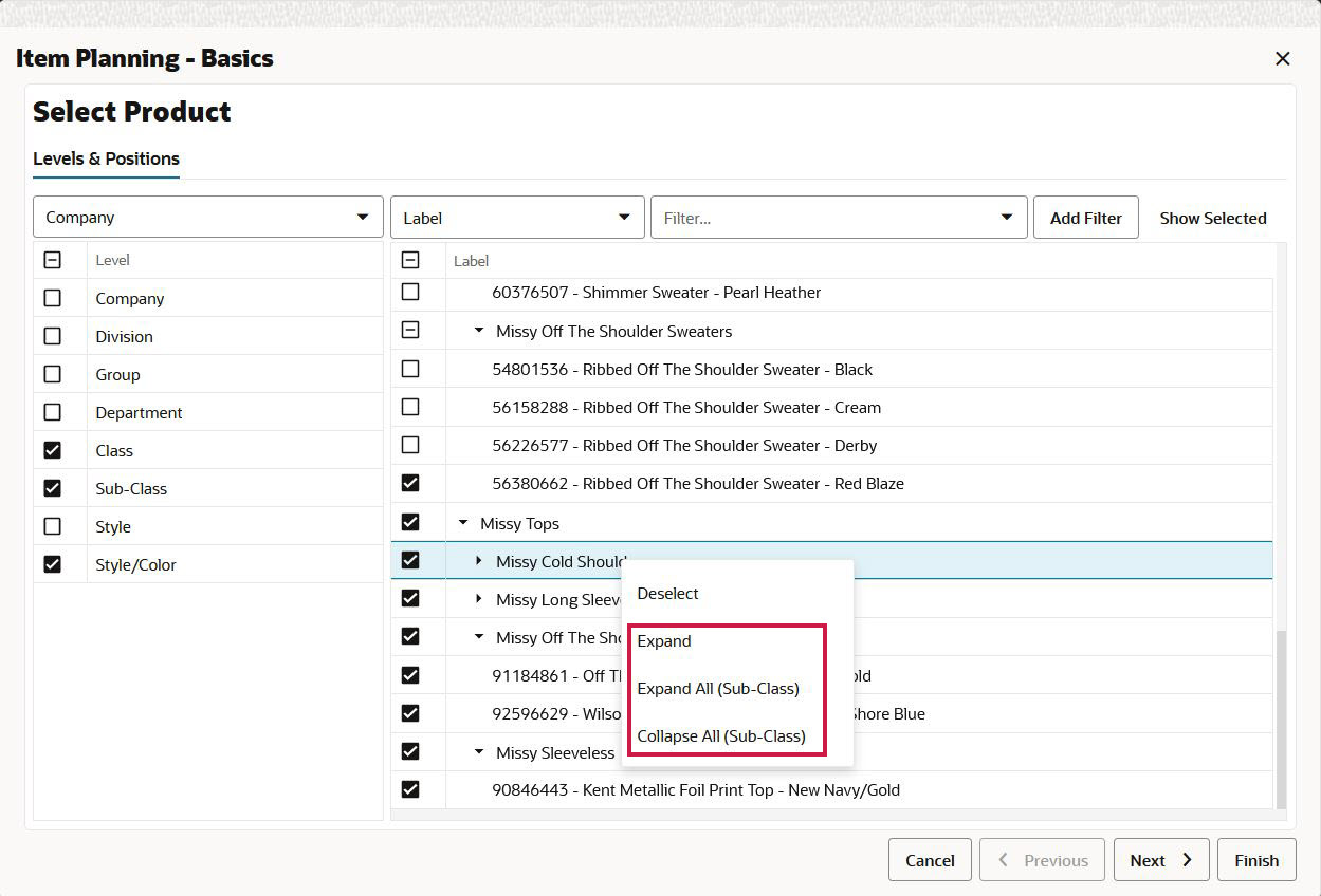

Collapsing and Expanding Positions in the Wizard
Collapse functionality allows a planner to group the child level positions to parent level. Expand functionality allows a planner to drill-down parent level to view all the child level positions. Collapse and expand function helps you to see all the positions in edit view that is meaningful to you.
To collapse or expand the dimension position you can use context menu (right-click) option. You can right-click on a parent level position and select Expand to see all of the child positions. Similarly, to group the child level position, you can right-click on the parent position and select Collapse.
Figure 6-35 Wizard Expand Position Level
Figure 6-36 Wizard Collapse Position Level
Collapse All and Expand All
The same functionality of collapse has been extended to Collapse All which collapses all the child level positions for the selected dimension level in wizard. And Expand all function expands all the child level position for the selected dimension level in wizard. The selected dimension level is specified next to Collapse All or Expand All in the context menu. With this function, you can quickly collapse or expand view the list of positions as desired.
Figure 6-37 Wizard Collapse All
Wizard Collapse All
Figure 6-38 Wizard Expand All
Wizard Expand All

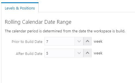

  2. Set the Rolling Calendar Date Range.
    Figure 6-40 Rolling Calendar Date Range
    1. In the Prior to Build Date field, either use the arrows or enter the desired number to select the number of time periods in relation to today's date for the start period. For instance, if the workbook's lowest calendar level is week and you want the time period to begin seven weeks in the past from today's date, you would enter 7.
    2. In the After Build Date field, either use the arrows or enter the number of weeks in relation to today's date that you want the time period to end.
Asynchronous Build
Click Finish and the workspace begins building in the background. You can work on other tasks and workspaces while this is occurring. When the workspace build is complete, you will receive a Toast notification. You can see the status of the task in Administration dashboard under Administration Profile.
Figure 6-41 Asynchronous Build
Asynchronous Build
When you select a workspace from the Tasks module, the Segment window is displayed.
Figure 6-42 Asynchronous Build Notification
